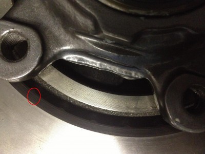

1. 239mm disc replaced with 257mm disc from an alfa 164 Twin Spark

The disc needed a slight chamfer machining on the inner edge to clear the hub lugs - I have heard that Punto GT discs may not need this work doing.

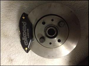

The calipers used are Wilwood Powerlite four pot with 1.38" pistons.
With both nearly a doubling in piston area and disc radius increased 7.5% the braking effect should be increased over standard. As stated before, this will fit under 13 inch revos with no fouling issues.

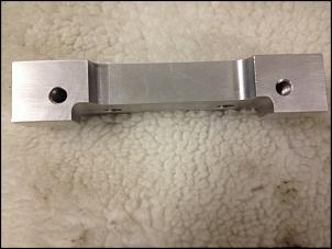

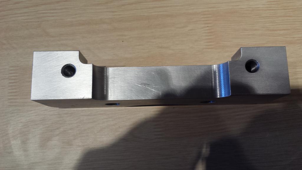

The discs are fitted to the hubs with a custom made adaptor.
I made up a dummy in wood, checked the measurements and clearances (three times..) and then got a local engineering company to cnc a pair out of aluminium. It's probably more chunky than it needs to be but it does the job.

This photo shows the installation from the driveshaft side

Re: My brake upgrade
Thanks for this.
Could I have the measurements or do you think the machine shop would make another pair?
I'll do both - I probably won't have the info until this time next week as I am on the road this week - is that ok?
Thanks, any info is appreciated as and when you have time, thanks again.
