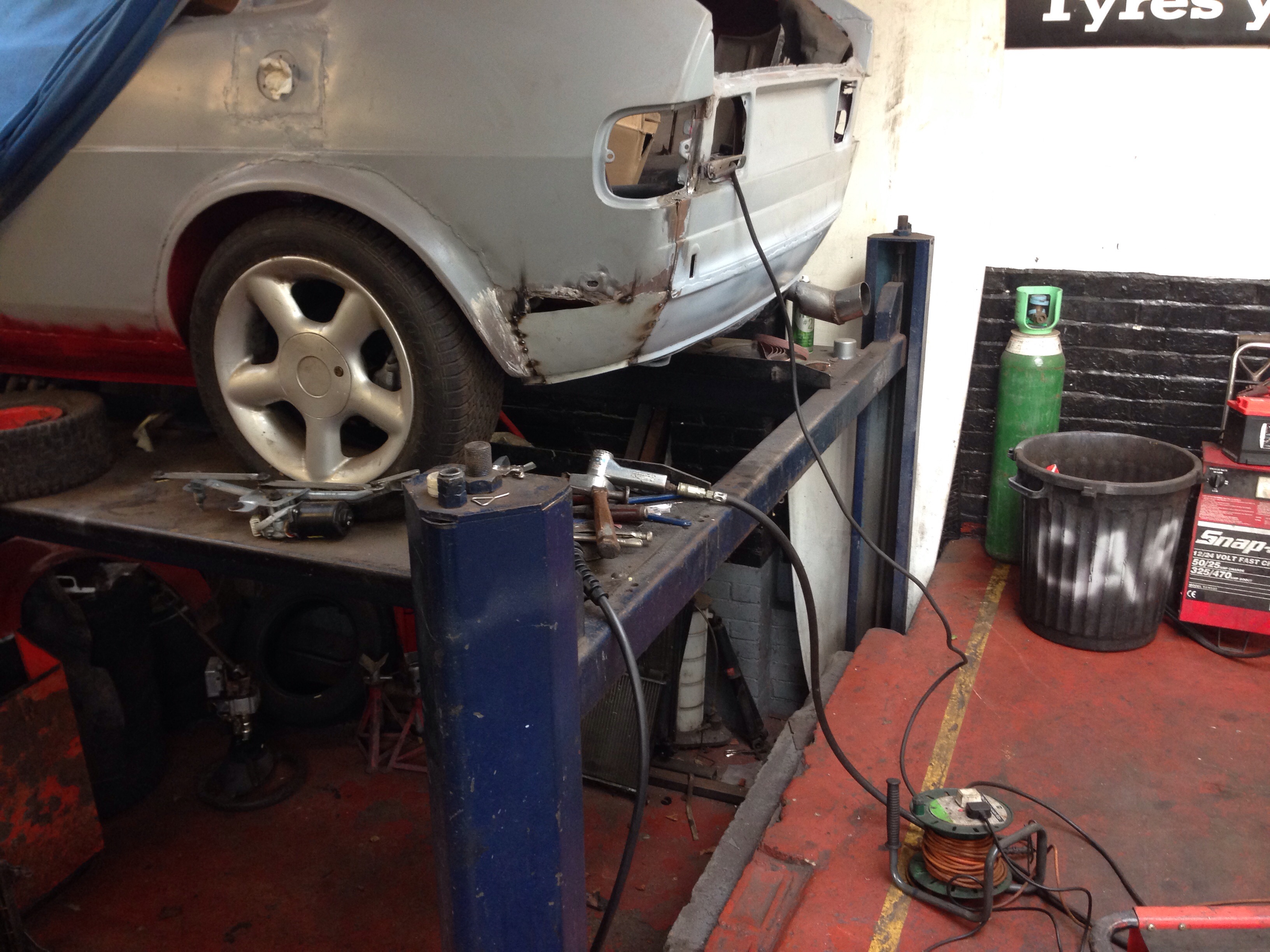

More done this lunch time

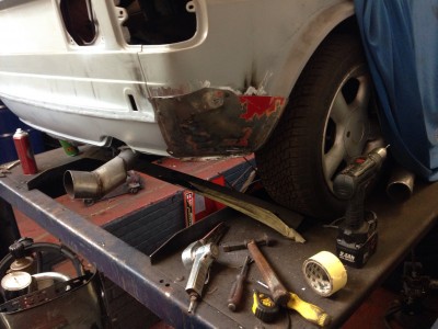

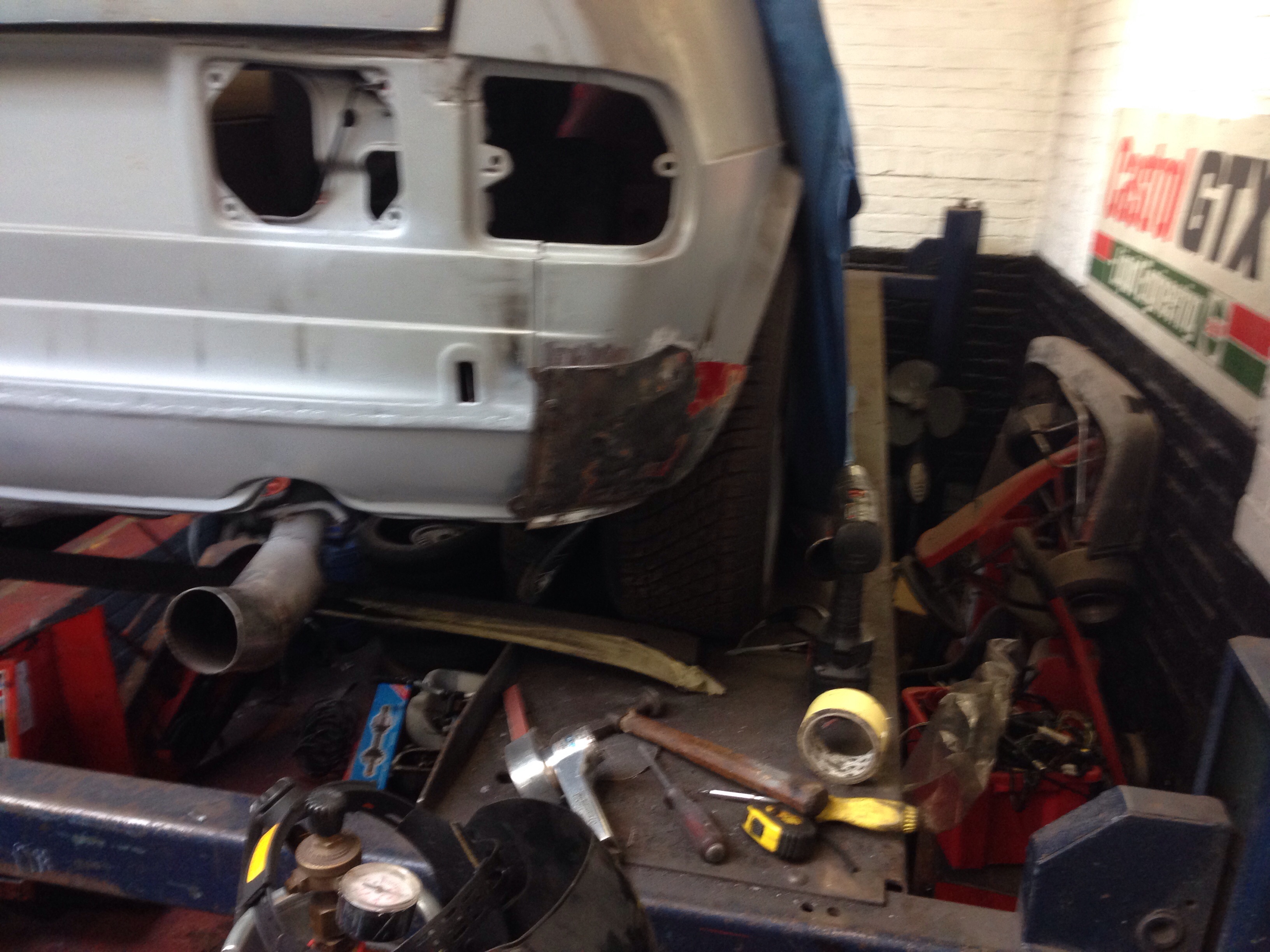

Last bit on n/s/r light
Only the o/s to do now then rear ended working all done
Until I find some more!!!

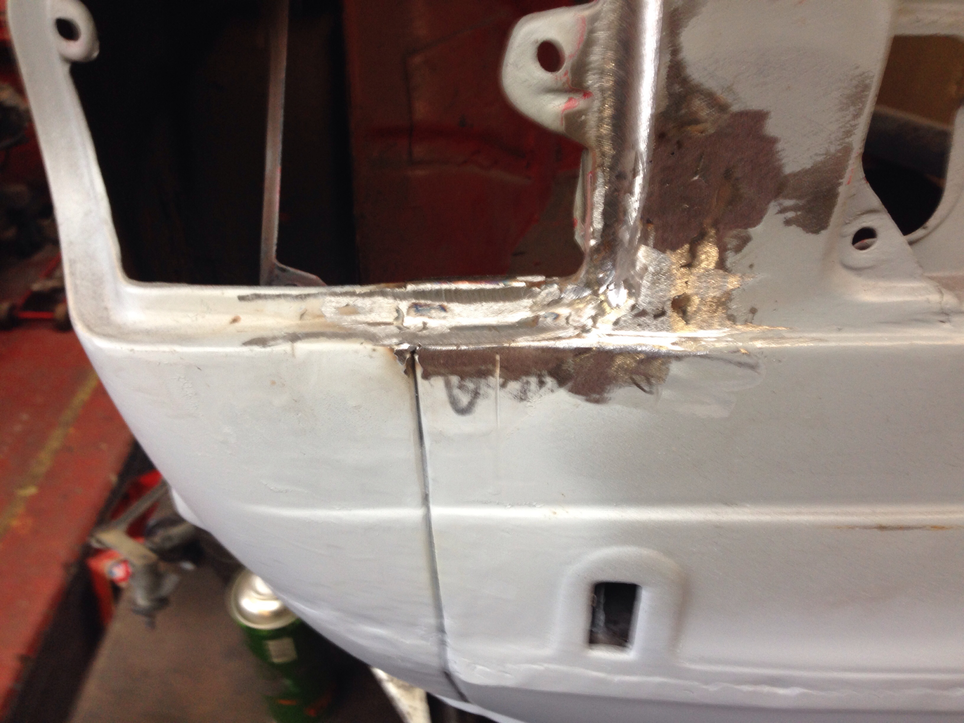

Re: TIX

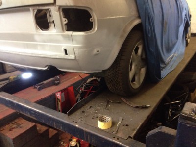

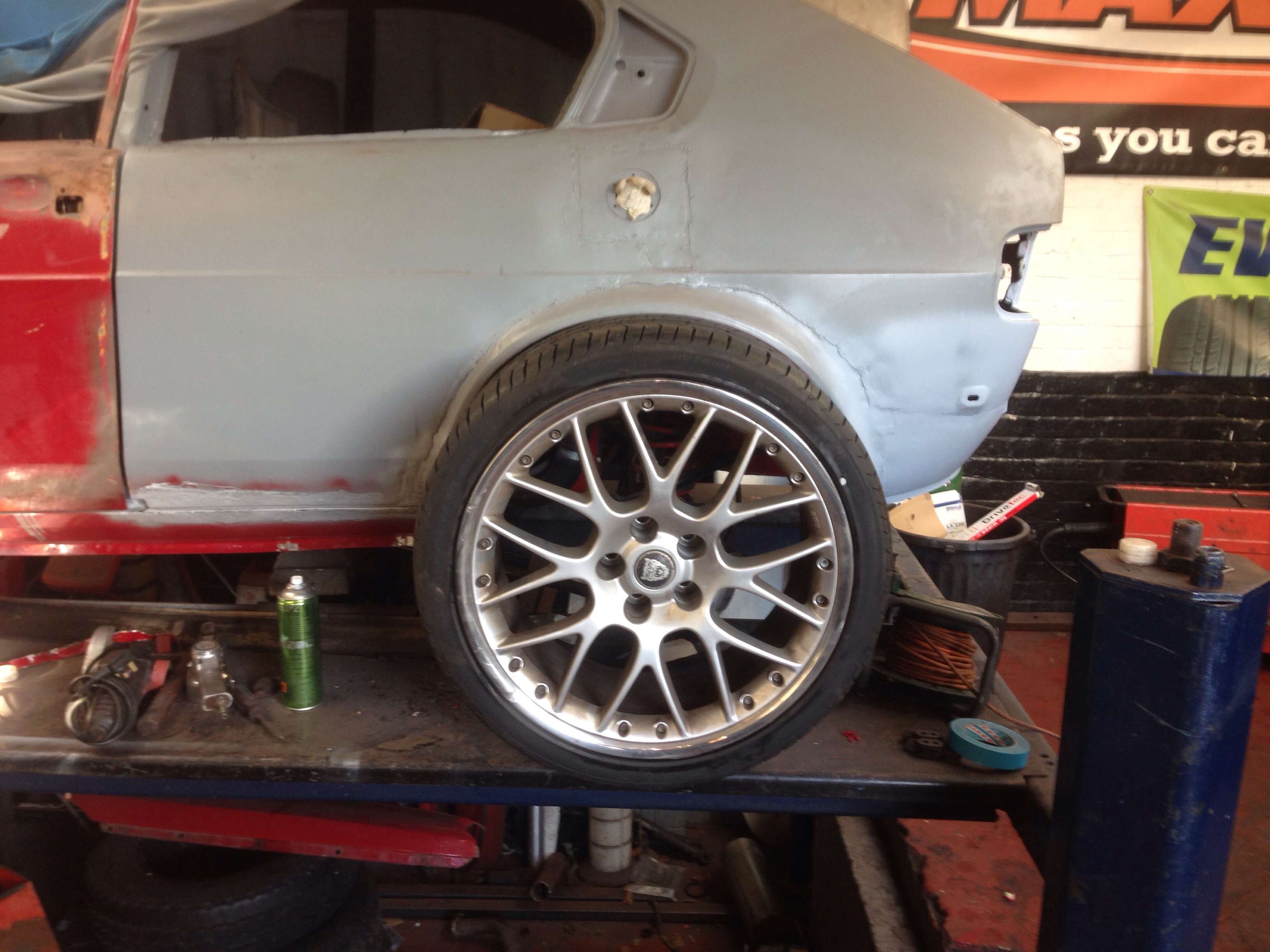

Post by Simonsud »
Making n/s/f wing fit o/s/r

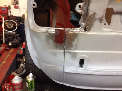

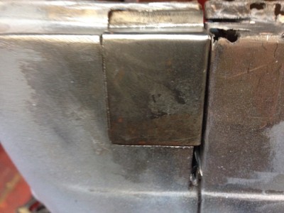

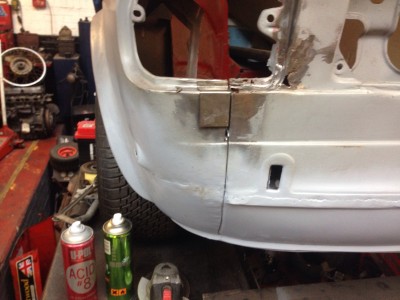

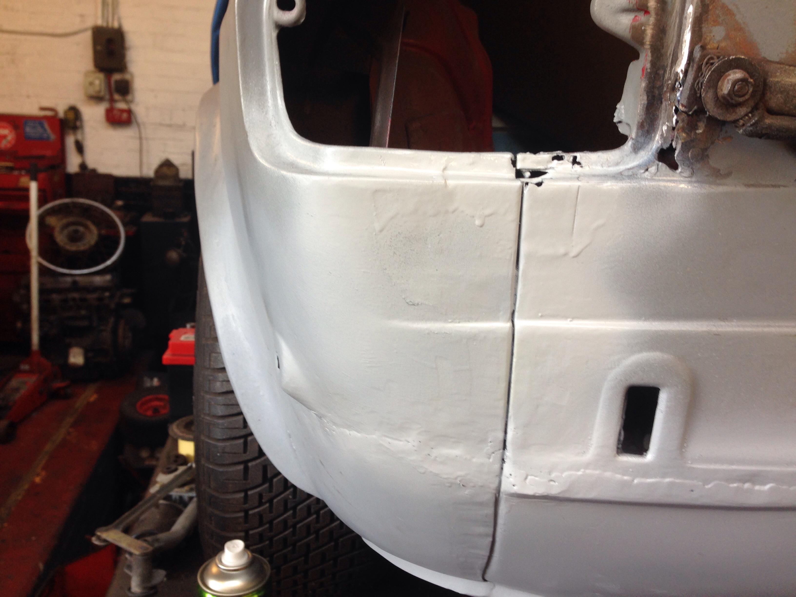

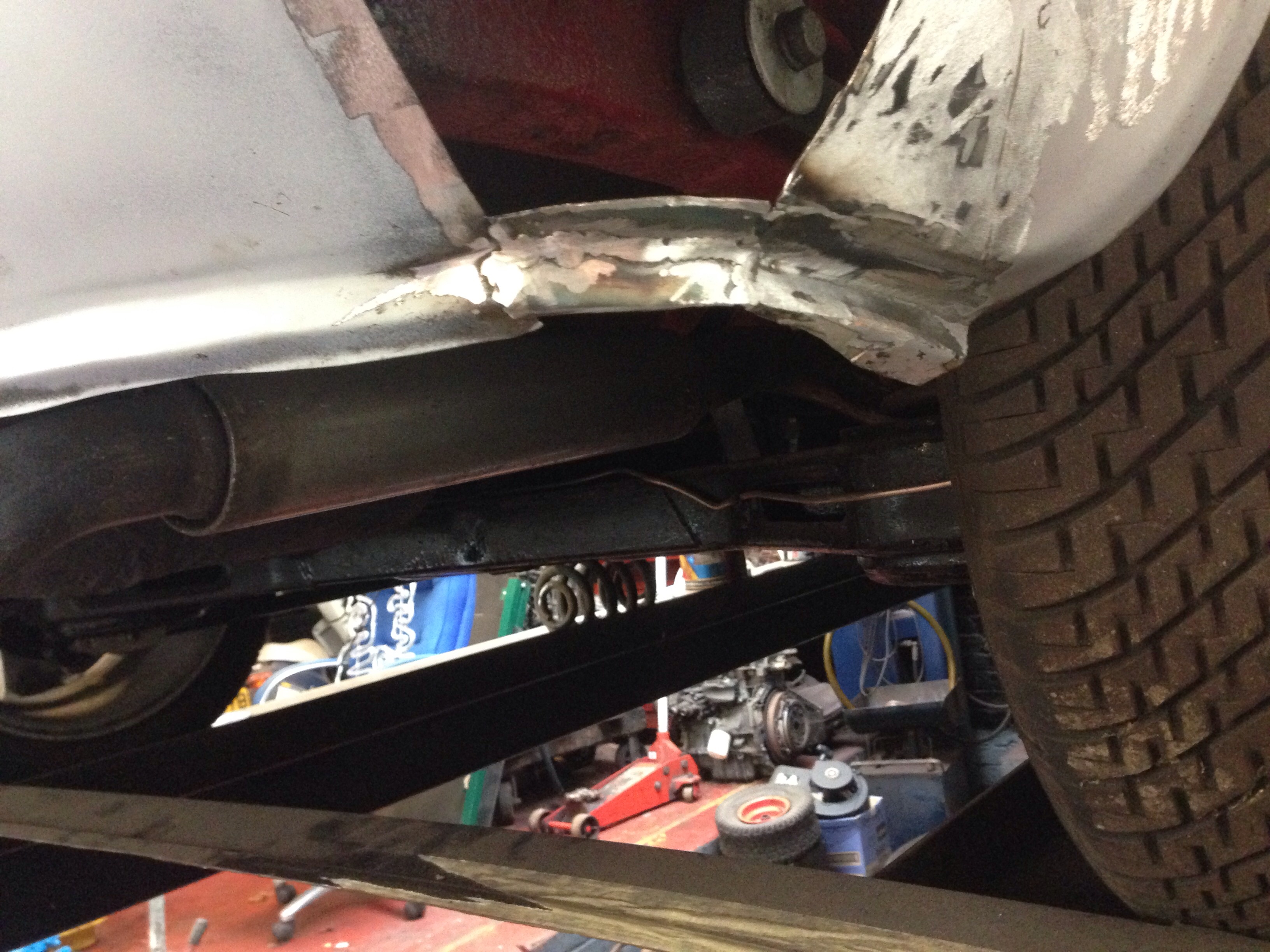

Post by Simonsud »

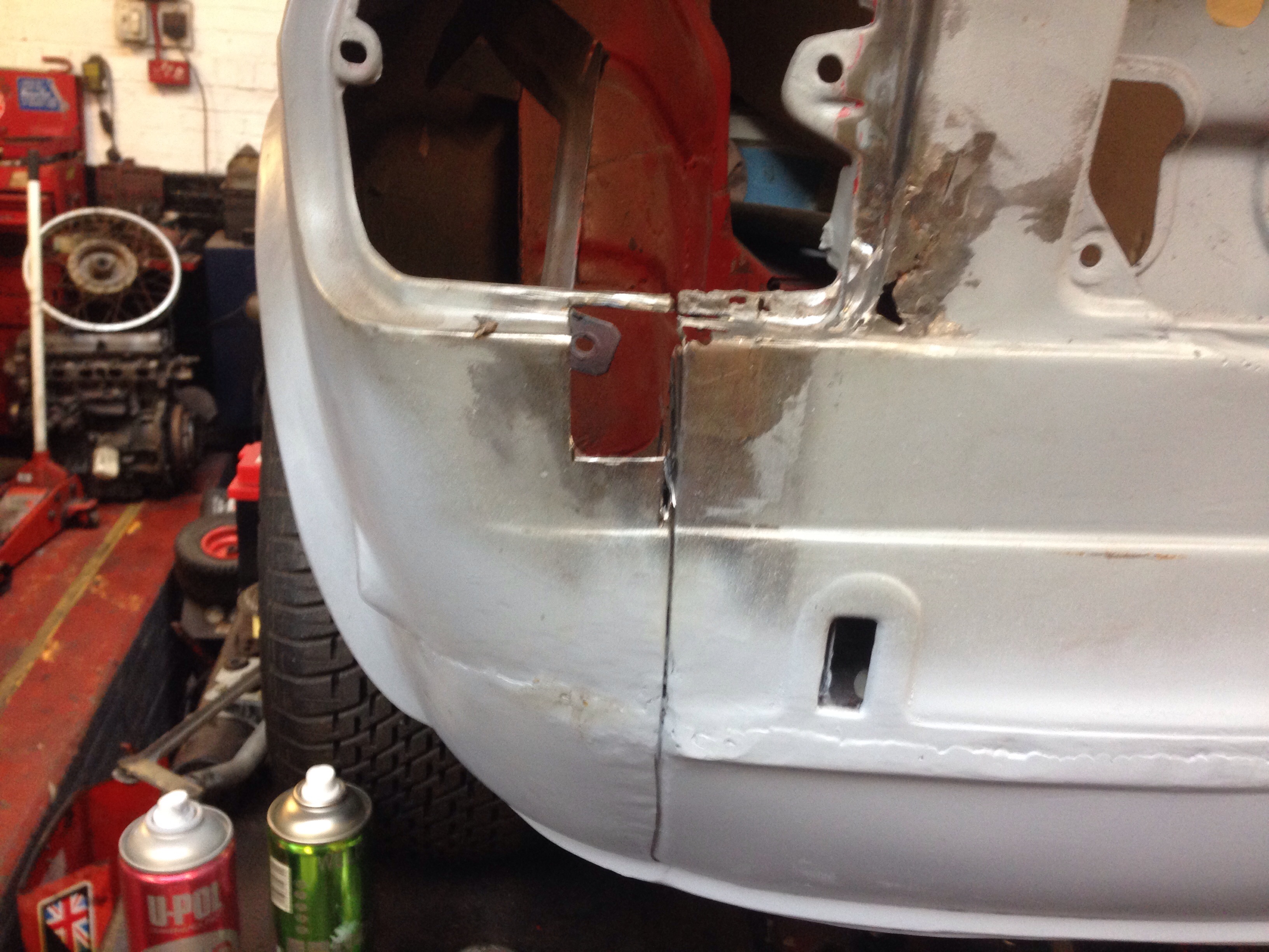

But more done had to make lower lip in sections couldn't get panel shape quite right so this was best option panel now cut down and ready to weld

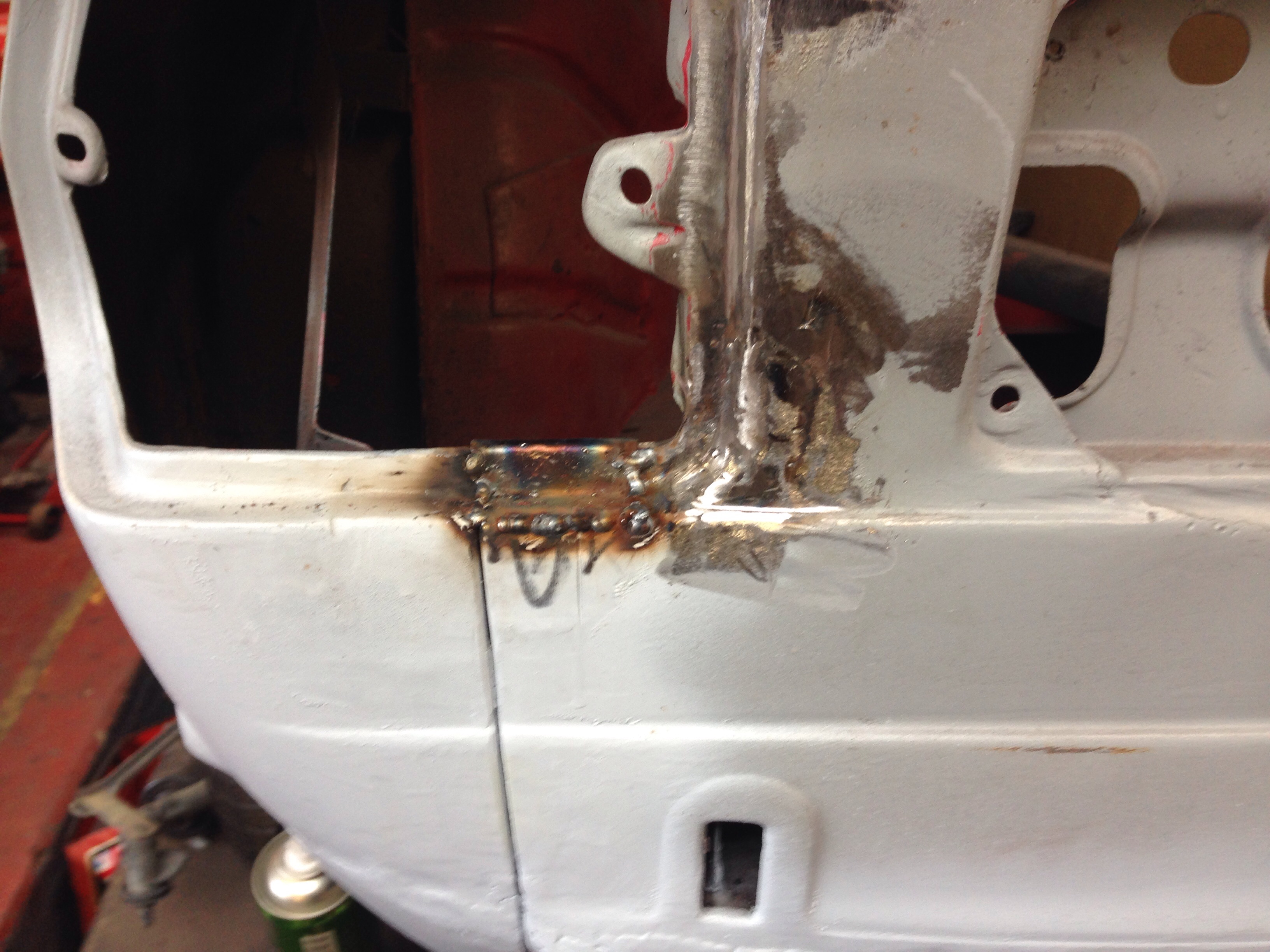

Post by Simonsud »
Rear panel all welded just need to seal up inside and stone chip then back end all done

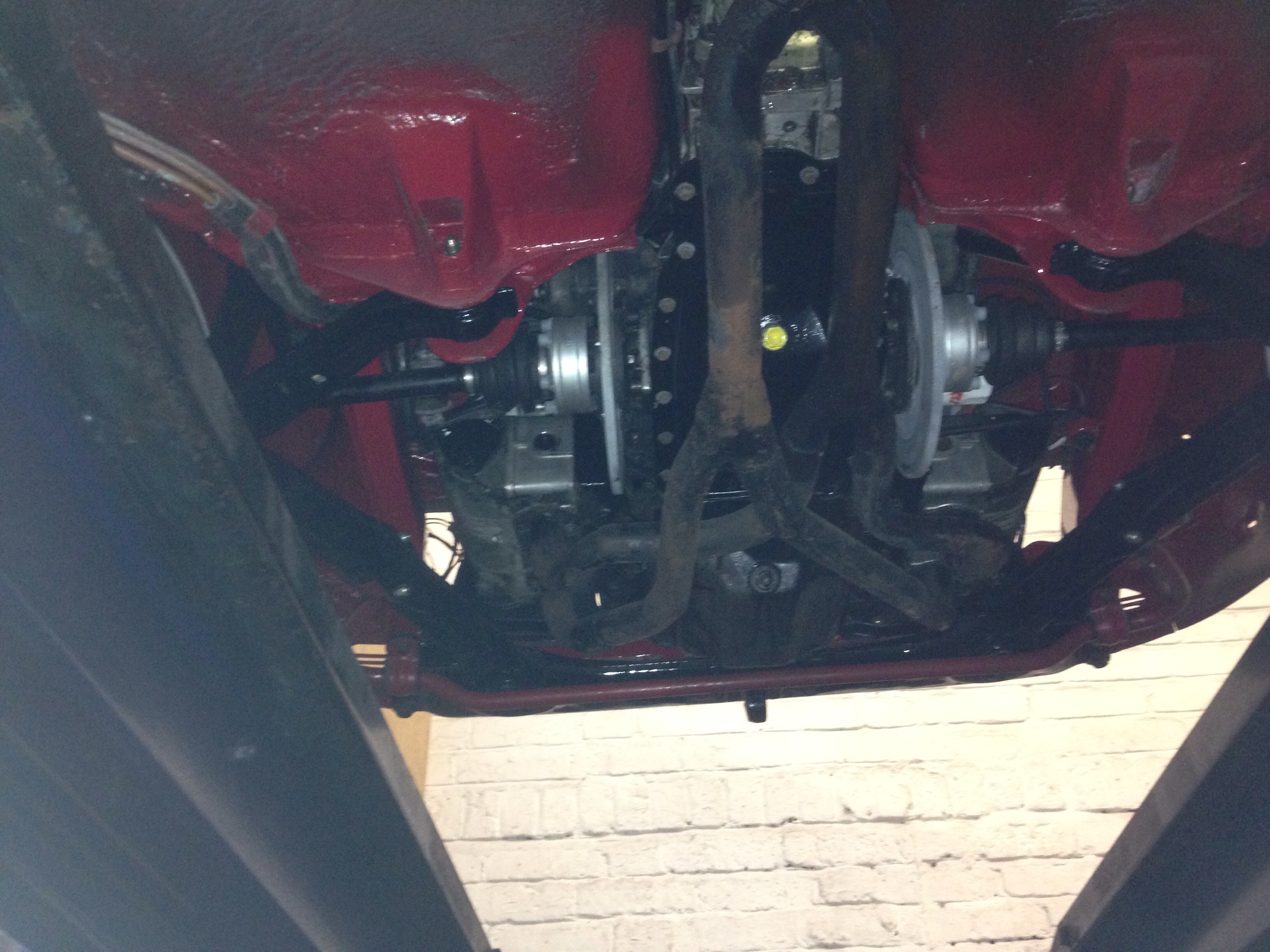

Posts: 331
Re: TIX
Post by Simonsud »

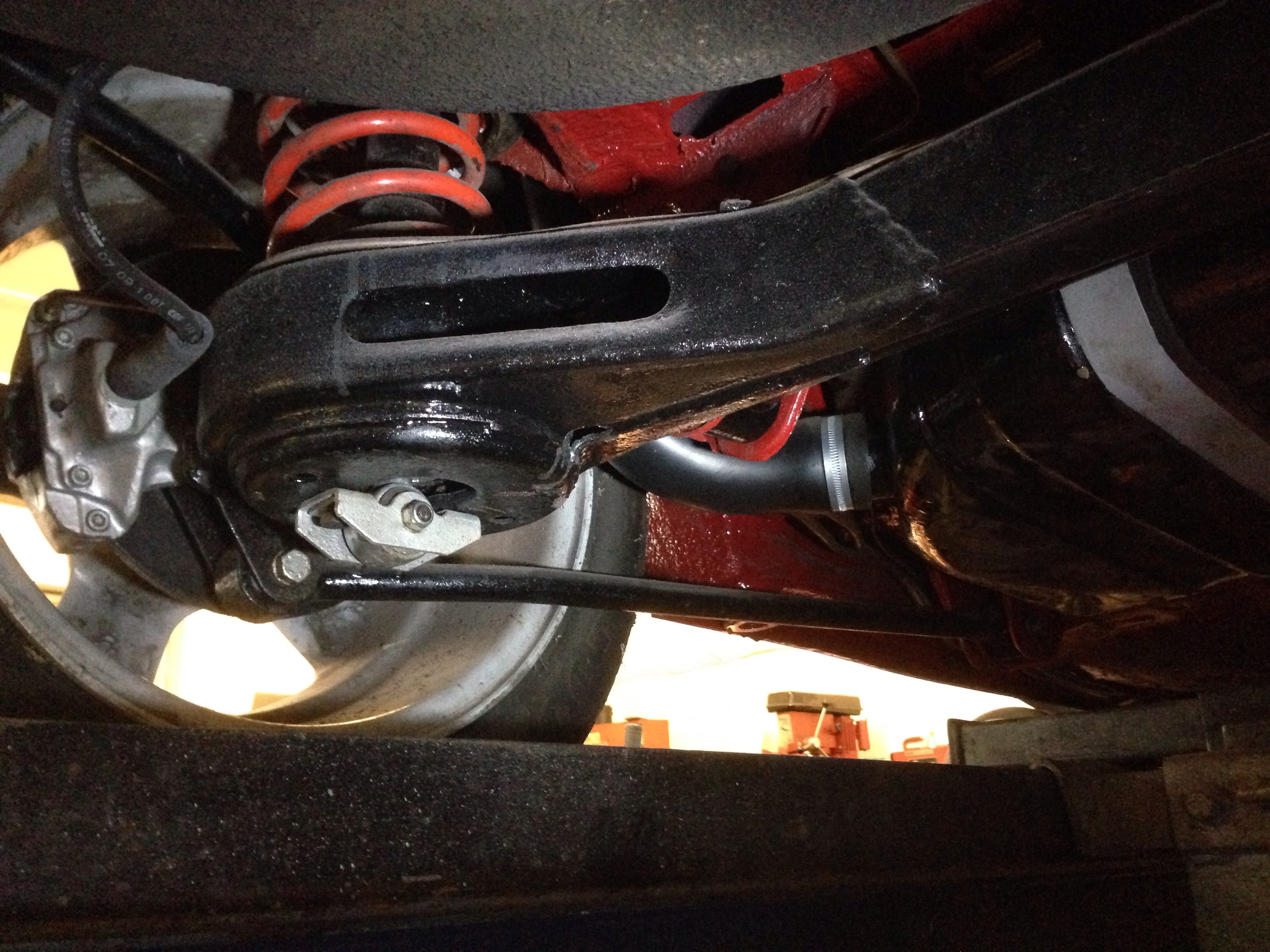

Getting there
this is how the rest of underside looks need the top to look the same
Re: TIX
Looking good chap 8-)

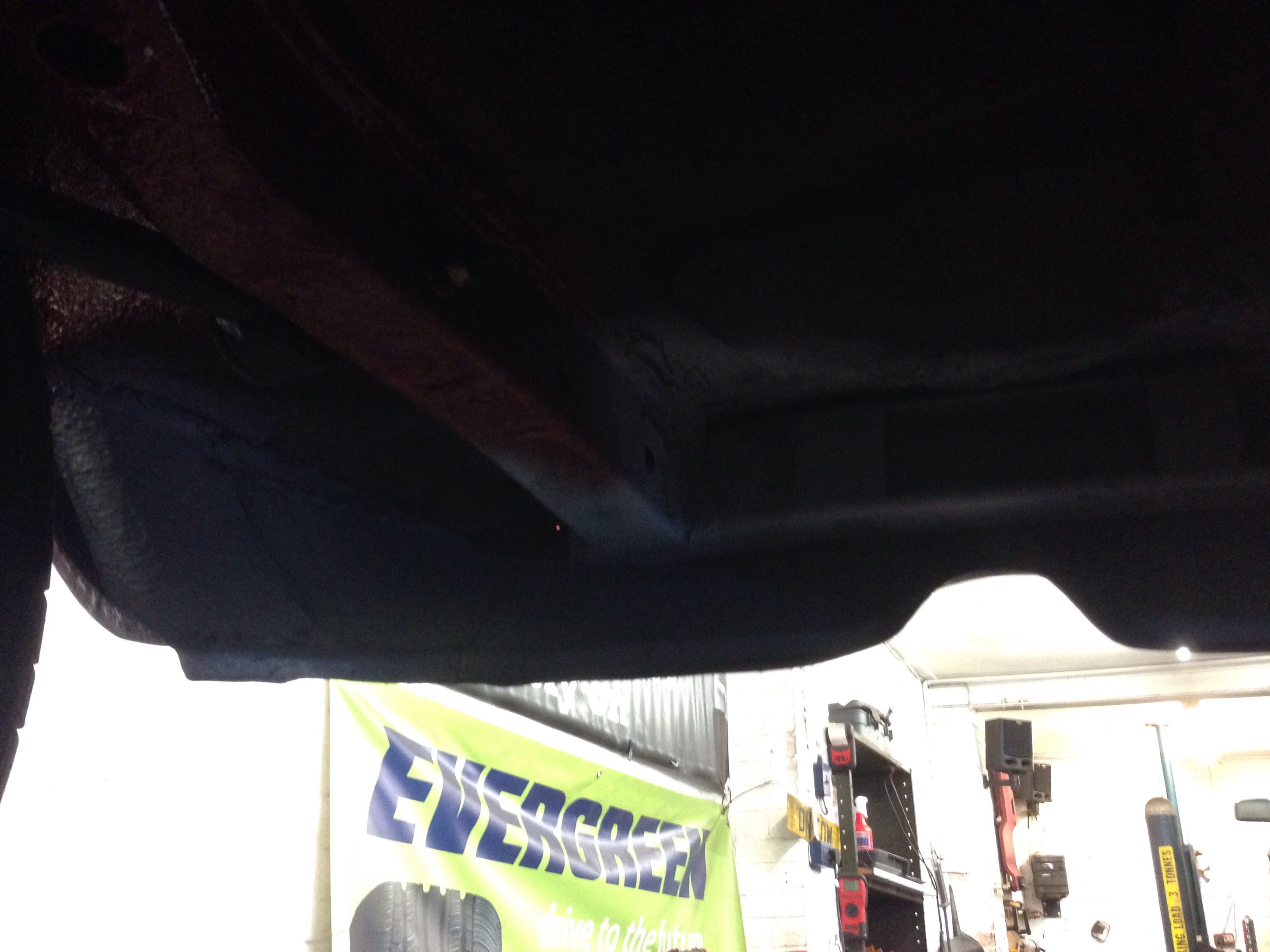

Post by Simonsud »

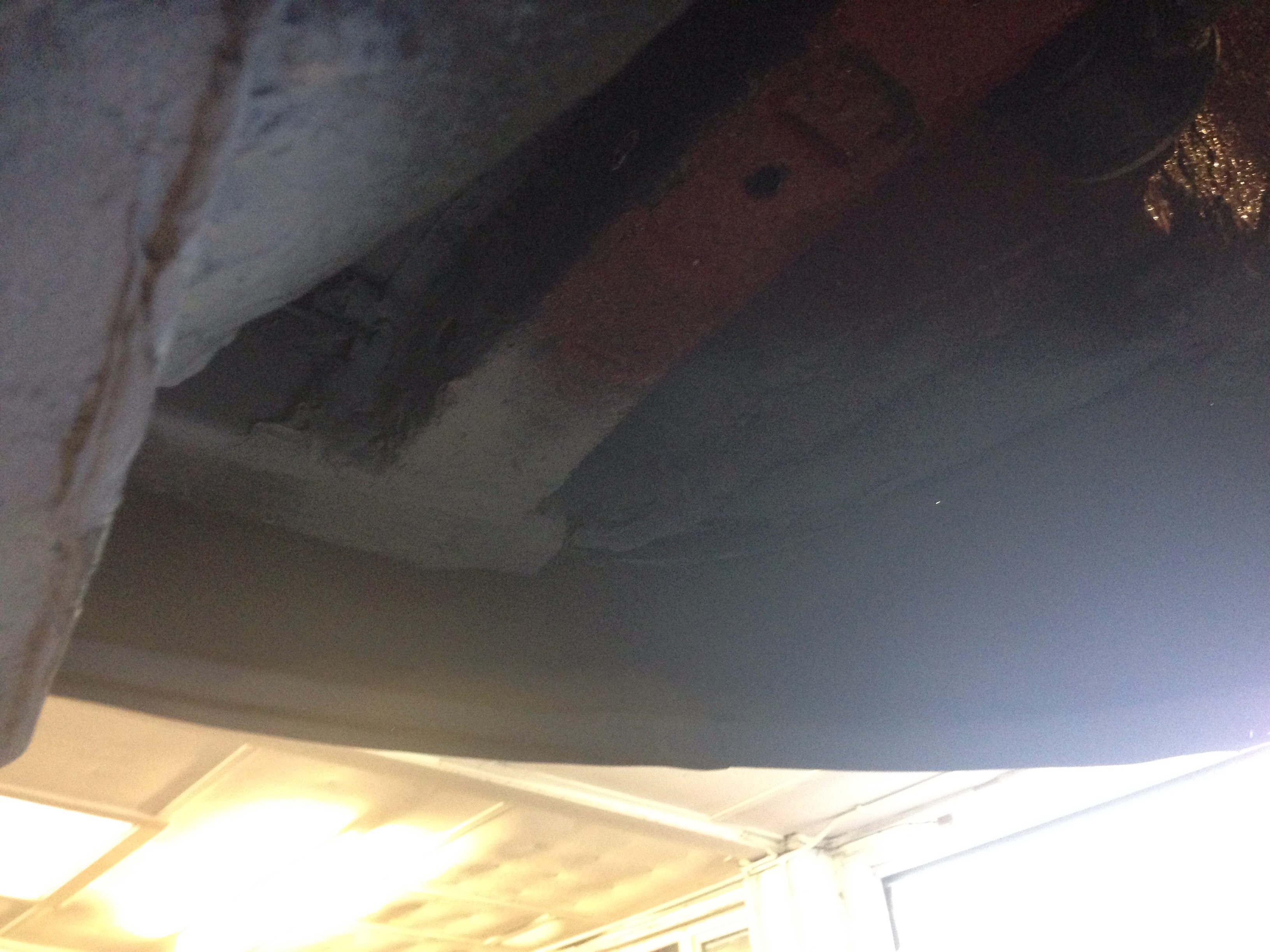

All sealed up and coated using upol raptor tinted with Alfa Rosso 530 colour comes out slightly off as raptor is a not clear but a transparent off white
This is what I used tintable load liner

Post by Simonsud »
Kegsti66 wrote:Hi Simon, that raptor stuff looks a good drop of goo !
Is it hard when it sets ? Wished I had used it on my car.
Good luck on the project.
It's very hard wearing but also flexible it's main use is for pickup truck beds so it's design to with stand lots of hard use its better than any spray sealer or stone chip that I've come across

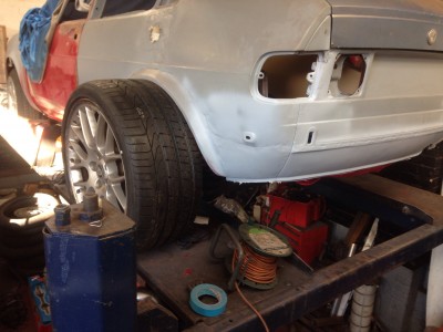

Post by Simonsud »
But more arch work required how good are the arch rollers on eBay
285/30/20
285/30/20
20x10
20x10
Posts: 2891
Re: TIX
I think you will need to do more than roll the arch to fit them. :o :shock:
You forget how small wheels used to be. :lol:
Re: TIX
:shock: yeah it's grinder time if you want to fit tho's :lol:
P.s shrewbeedooo has an arch roller ;)

Post by SteffenJ3316V »
Are you serious about fitting 20" wheels? It will drive horrible on them and the car will be very slow :shock:
Re: TIX
Hmm, BBS RS, 5 stud pattern, and BIG with it!
and you spent so long rebuilding the right arches on it! :D
BS25
Posts: 291
Location: Cheshire
Re: TIX
Post by BS25 »
:o They are huge! Gearing and ride height affect of the 20" diameter aside, Suds definitely work best on 195/205 width tyres (normal road tyres) and upto 15" diameter. For softer performance tyres you can easily get away with 185's unless you have lots of power. On wide tyres they lose their poise and adjustability - yes there's plenty of grip but much less feel. Some of that will also be a huge increase in unsprung weight - at least 2 x standard due to those wheels being strong enough for a car more akin to the weight of a big BMW/Mercedes.
Nice looking wheels though! :)
Simonsud
Posts: 331
Re: TIX
Post by Simonsud »
Don't worry to much about the wheels they are from a 2006 jag XJR that I've been working on . I had just fitted four new tyres and walked passed Alfa from tyre bay and tried them in the arch for a laugh
I'am sticking with the rim stock 100+ wheels I fitted in the 90s 7x15 with 195/50/15 but I'am on the look out for some cheap 15 fiat wheels that I will get banded to 7x15 and fit s2 wheel centres

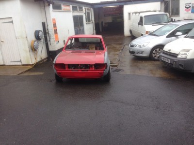

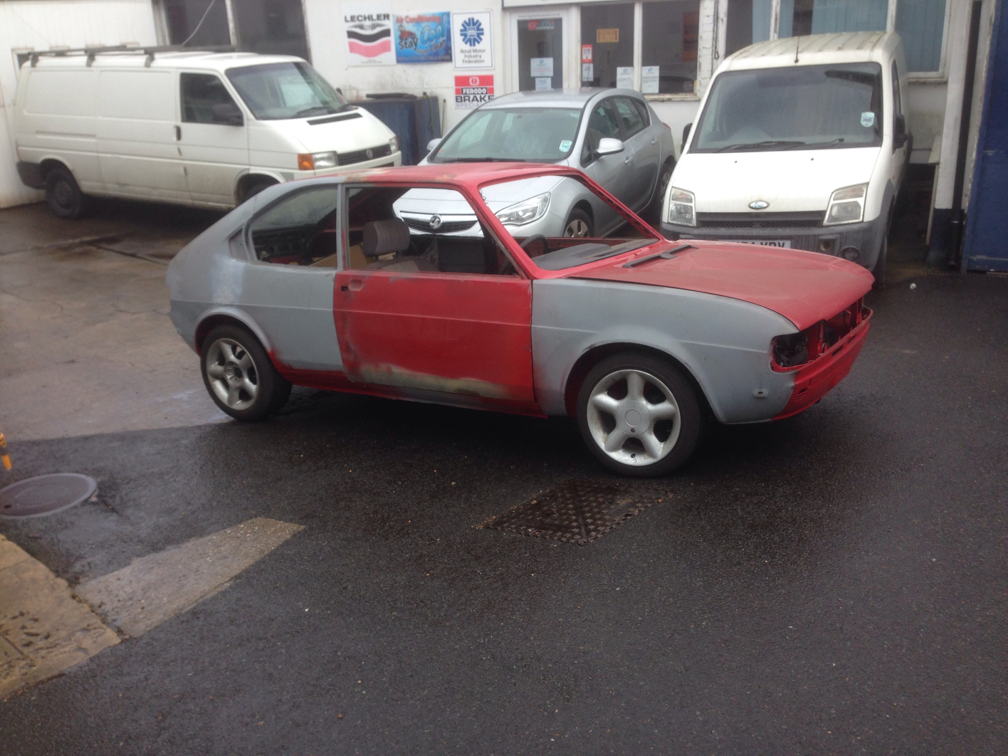

Post by Simonsud »

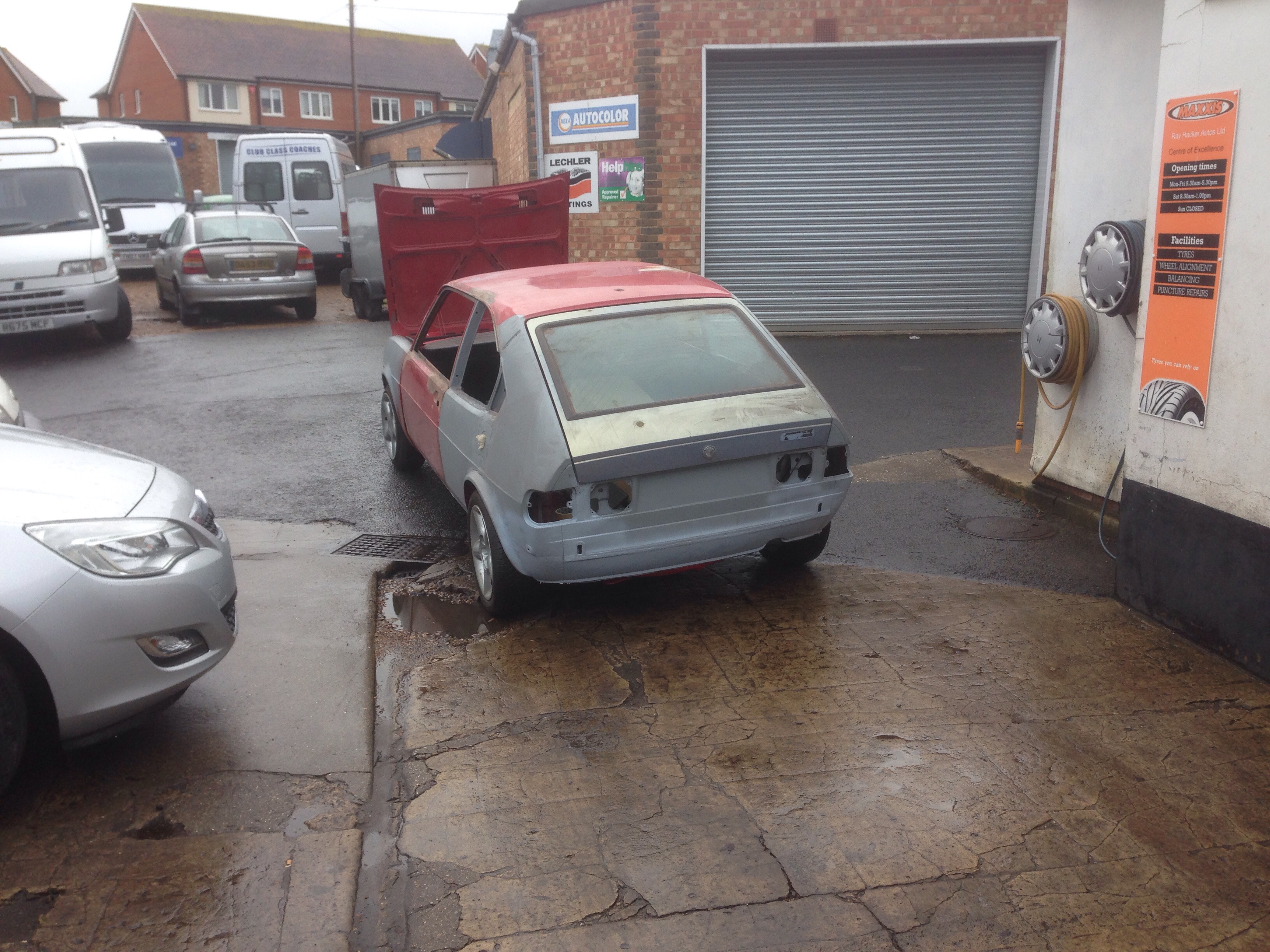

Went for a spin in the car today
Well drove it round the yard and turned it around on the ramp
It does sound nice really need to finish it

Post by Simonsud »
Back where it belongs another step closer
Put away for another day
Re: TIX
always nice to grab a sneaky test drive :D

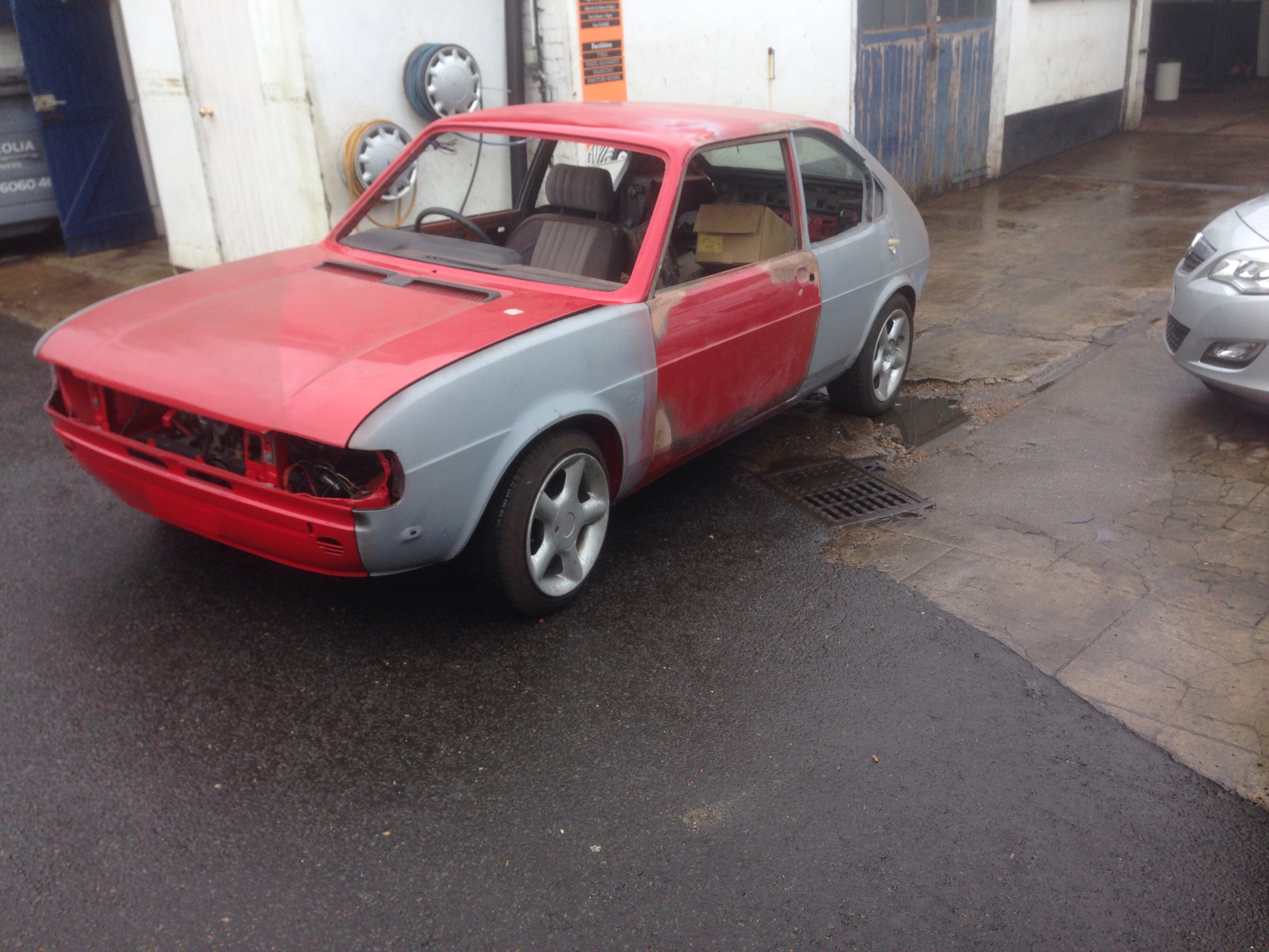

Posts: 331
Re: TIX
Post by Simonsud »
It was good and in the photos it looks like a bit of filler and it's ready to paint but the reality is there's so much time needed on getting door gaps and other panel gaps right before I can even think about paint prep
