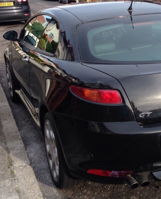

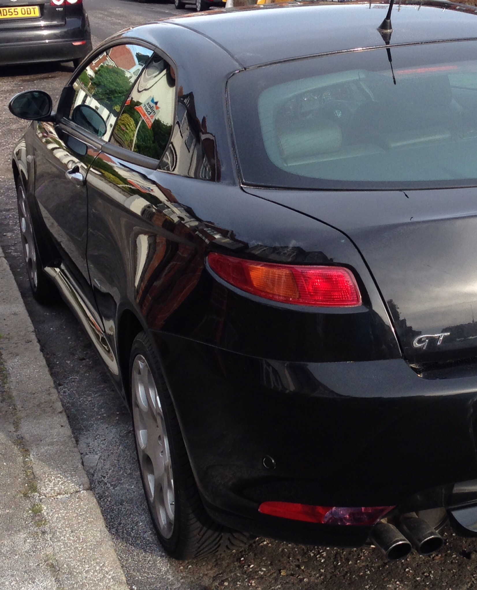

Re: Machine Polishing Help/Advice Needed
Good luck chap
Just let the machine do the work, but watch what your doing! Even pros cock up. When I polished the gt. I went through the edge of filler cap :oops: :lol:
