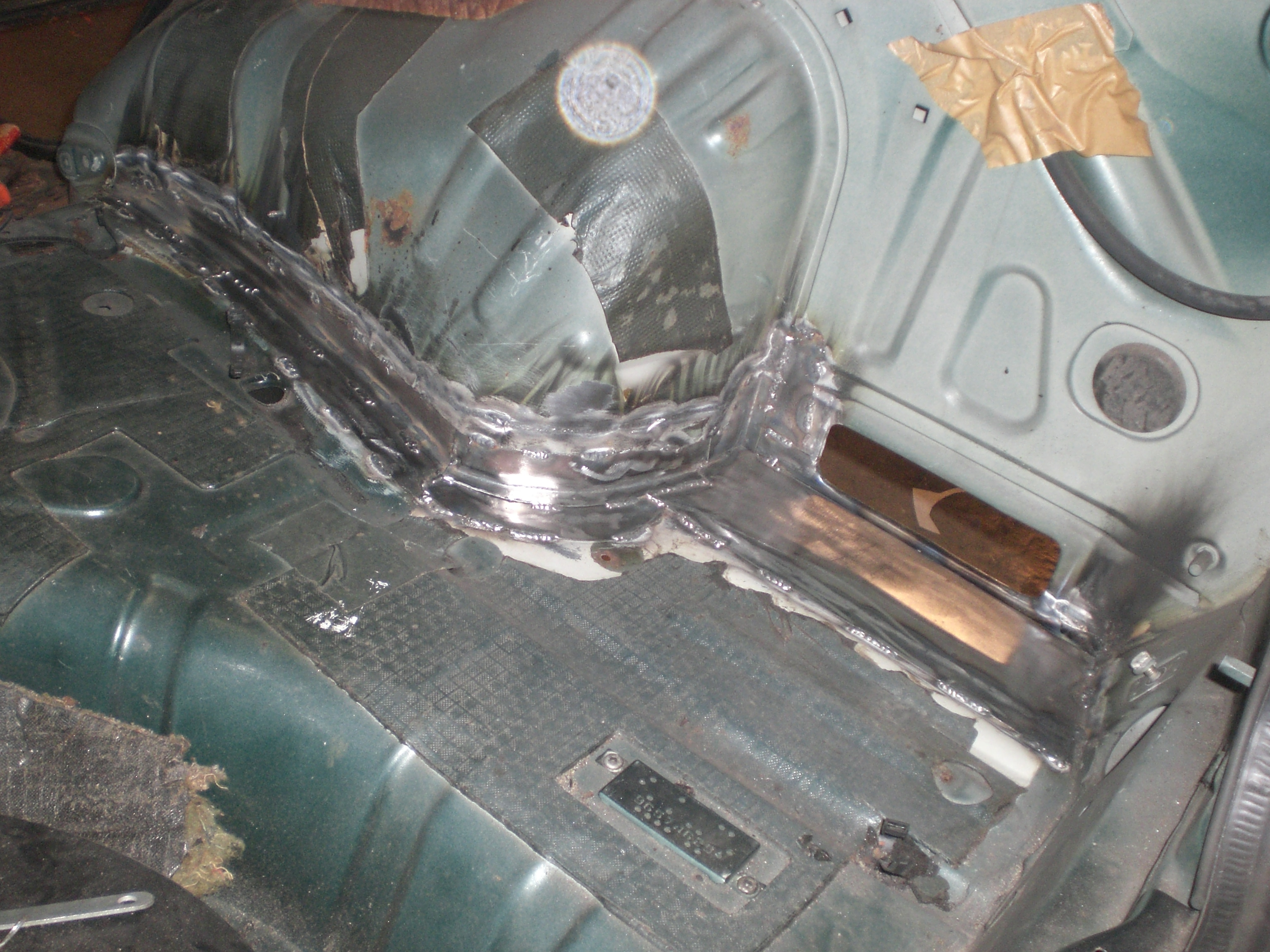

Been waiting for some time to tackle the rust on the 155, this afternoon I got chance to make a start.
Passenger side got the vote to be tackled first, rot wasn't evident all the way along to start with, until a bit of digging showed corroded seams all the way to the seat belt anchorage so the grinder soon made a nice wide channel to fresh steel.
Boot bit didn't go too far over towards the middle so quite a simple thing to repair.
Just got to make up some bumper mounts, not unlike the integrale ones funnily enough, plus box in the lower portion of the rear quarter, where all the water has been getting in and causing all the issues!
Aiming for this to be a quick repair, simple plates, primed/seam sealed then stoneguard and some paint. Nothing more drastic.

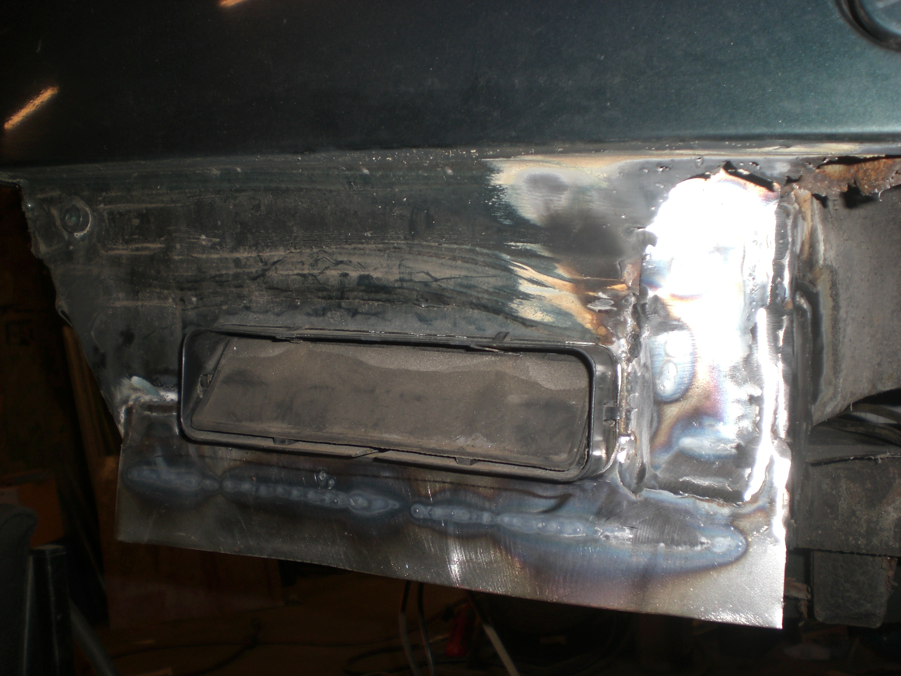

New years day so up to do some more welding
drivers side had more rot really than the passenger side, also complications of the filler neck and side vent to get around
rot didn't go too far back luckily enough, gladly it's soon solid metal so welding isn't like trying to stitch a wet paper bag!
first job was at the back end to make a plate for the boot floor
then the job to make the opening for the side vent complete with rolled flange so the clips get the correct purchase to hold the vent in place

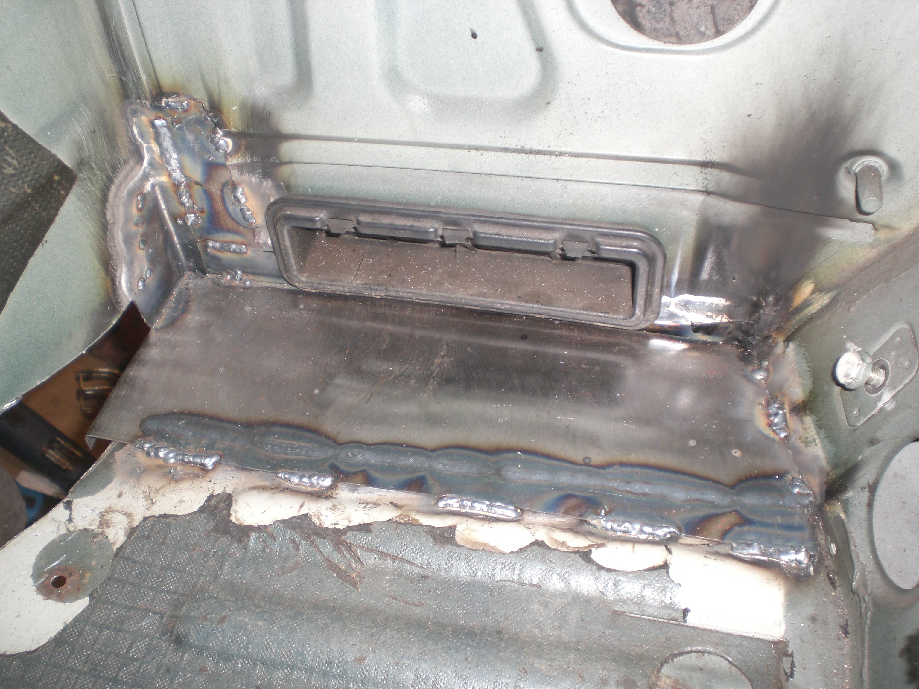

section to the inner arch was next, boot floor needed extending out too as the gap was too wide
section at the front near the seat belt mount needs chopping out then the outer arch will get boxed in along with the back of the filler neck hole. last job to make up a bumper mount.

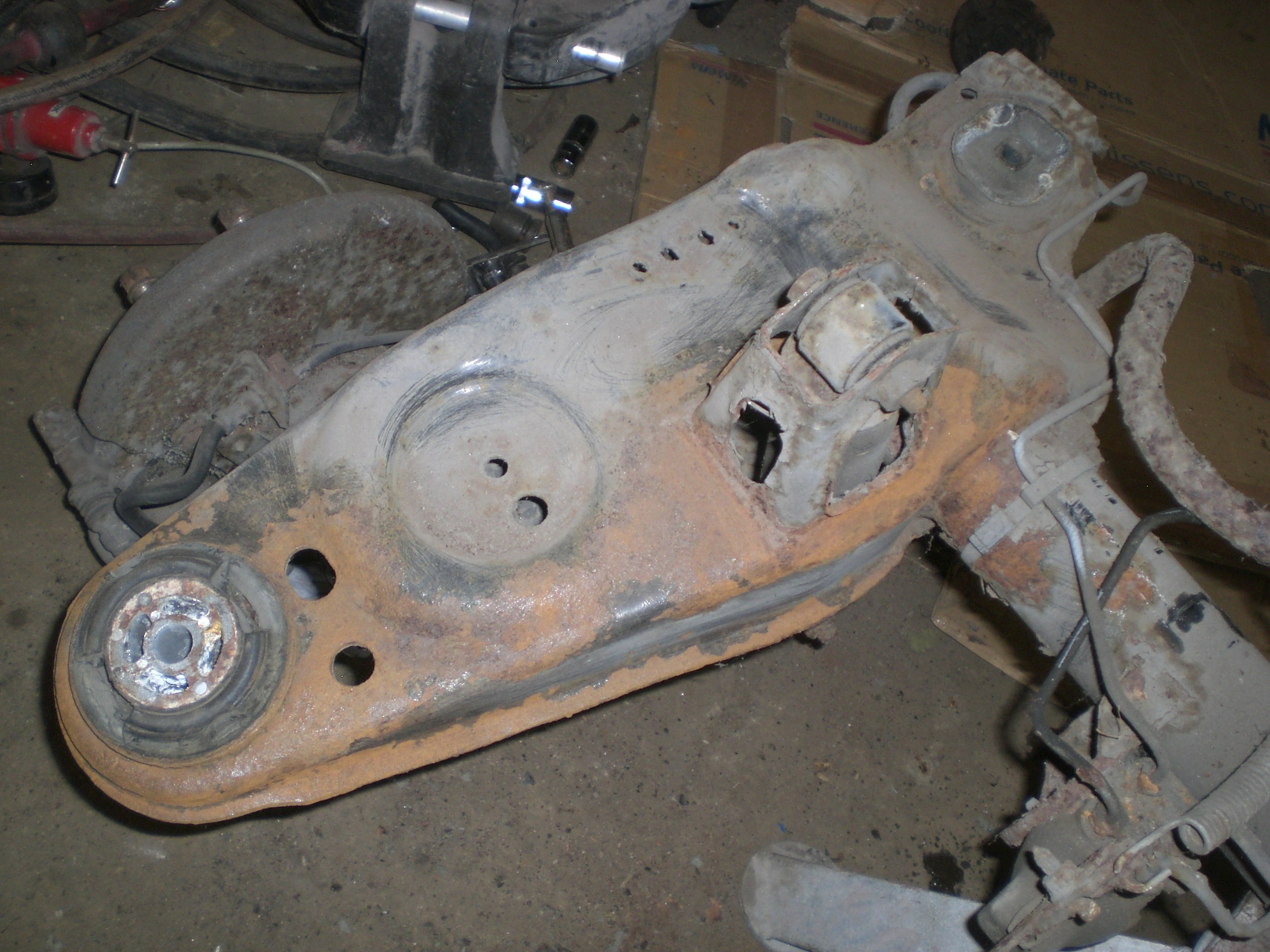

with everything going on I've neglected the 155 a bit, seems it was back in Feb that I last did anything....
so with a couple of hours spare tonight I set about making myself more work
there is a patch of rust on the rear subframe that needed welding, I could have done it in situ but I then spotted an other bit further around which wouldn't have been so easy.
as the tank is out it's only the hand-brake cables and pipes to disconnect then 4 bolts and the whole thing comes down, seems childish not to attend to it whilst access so easy
the rest of the frame just has surface rust so i'll clean it, treat it then soak it in waxoyl once I've replaced all the brake pipes
need to get the car mobile again, it's sat on stands for too long...

I welded up the rear subframe mount at the weekend then gave it a coat of paint.

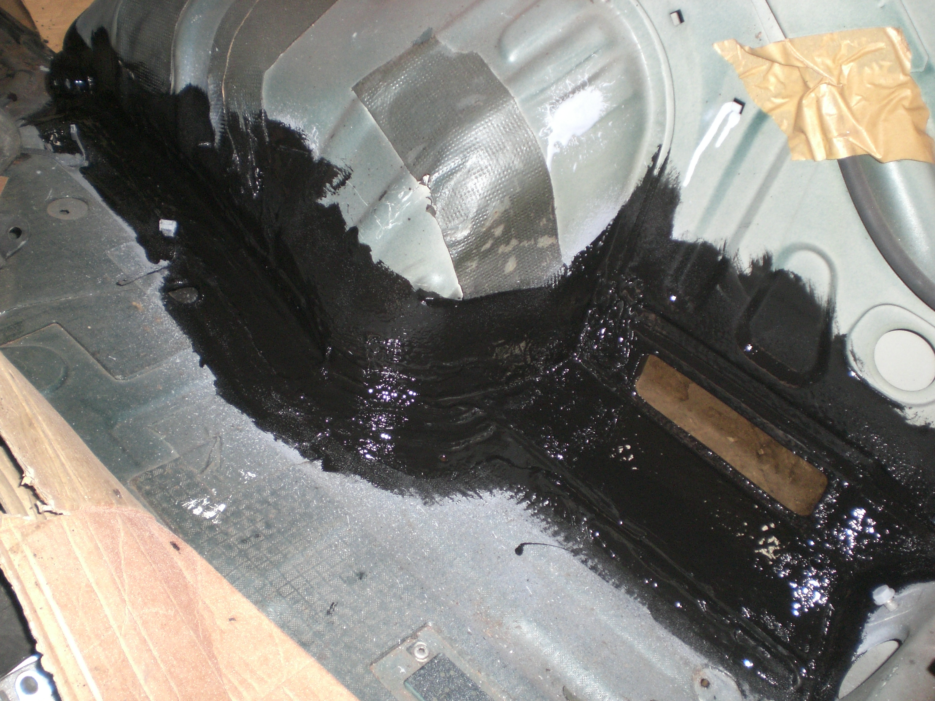

The rear inner arches I'd stoneguarded last week, now that has all dried off nicely and I've found time I brush painted all the arches and the parts I welded earlier in the year. This enamel paint is easy to slap on with a 50mm brush and allows a really good layer to go on, as well as over yourself!
As you can see I have also given the inner repairs a good dose of the black paint too, all the better for keeping moisture at bay.

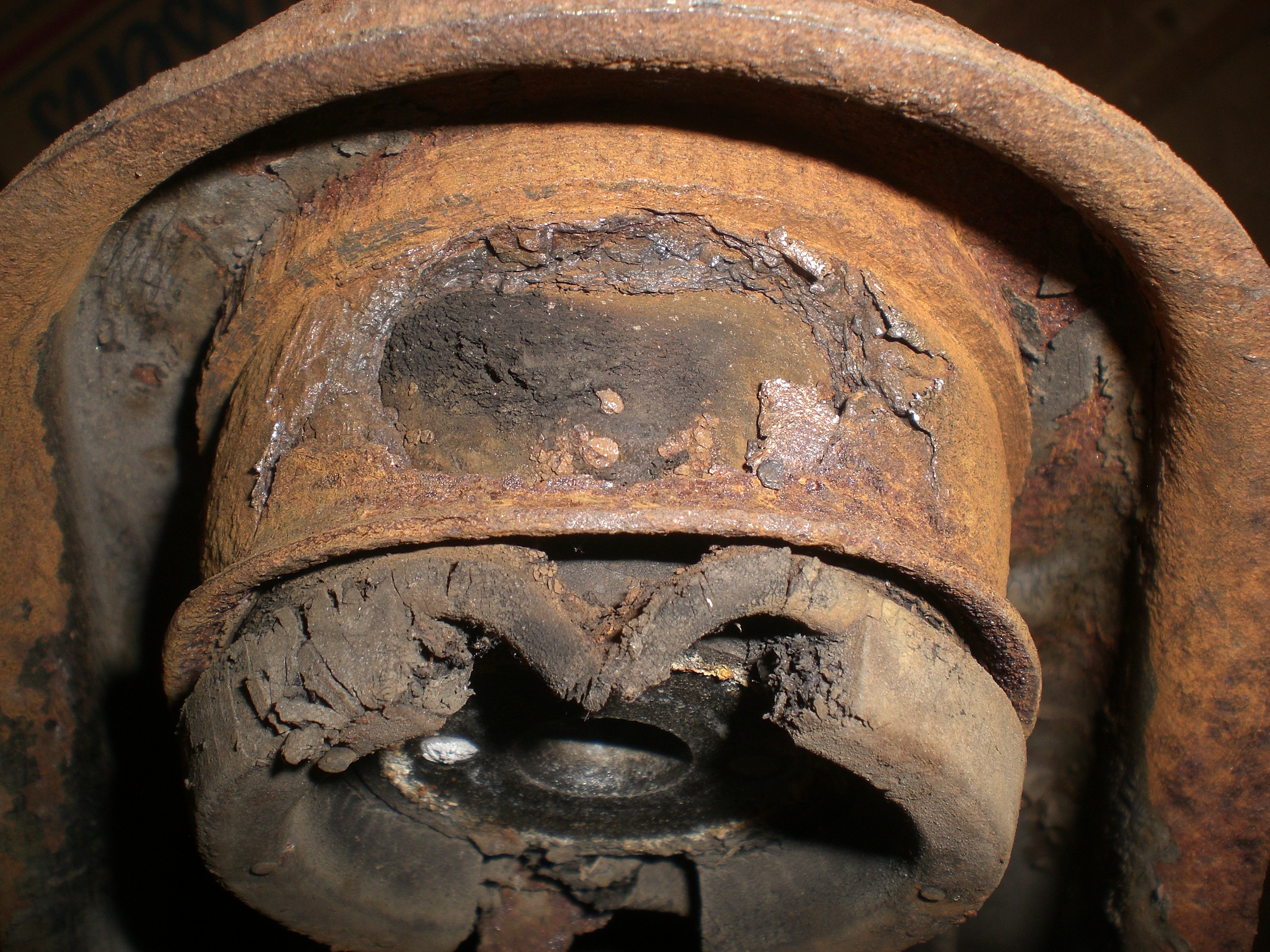

Got the rear axle fitted this afternoon. $ bolts hold it against the chassis rails. On my own so thought it'd be a bit wobbly on trolley jacks so came up with a solution...
2 old bolts had their heads chopped off and got welded to some threaded bar...these were then inserted into diagonal corners in the chassis which made great guides as the axle got jacked up, then insert the 2 normal bolts then take out the guide studs, simple!
Bit of angled section used to keep things in line as they are welded...
