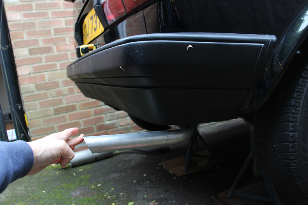

I ordered one from Peter at http://www.alfasud-parts.co.uk. It arrived today. I suspended it to check fit, and I was mighty pissed off to find its massive can was only 2cm from the rear suspension beam, compared with 8cm for the original. So it would clash over bumps and would probably be dangerous over big ones. The tail pipe was also much longer. So I looked up the part number stamped on it: MTS 65180, which is for a 33 1.7IE sportwagon according to the MTS catalogue http://www.mtsspa.com/catalogue.aspx. Unbelievable. So it's going back for a full refund. And I have to cancel my Saturday MoT :(
1.7 can is longer, meaning it overlaps the beam axle
1.7 can hangs much lower
1.7 can has insufficient clearance
1.5 can - how it should be
Long tailpipe for estate 33 (not a big deal to shorten)

I ended up buying this one: http://www.ebay.co.uk/itm/332146612412 - It's OK, but I had to bend the tailpipe down a bit to stop it fouling the bumper.
