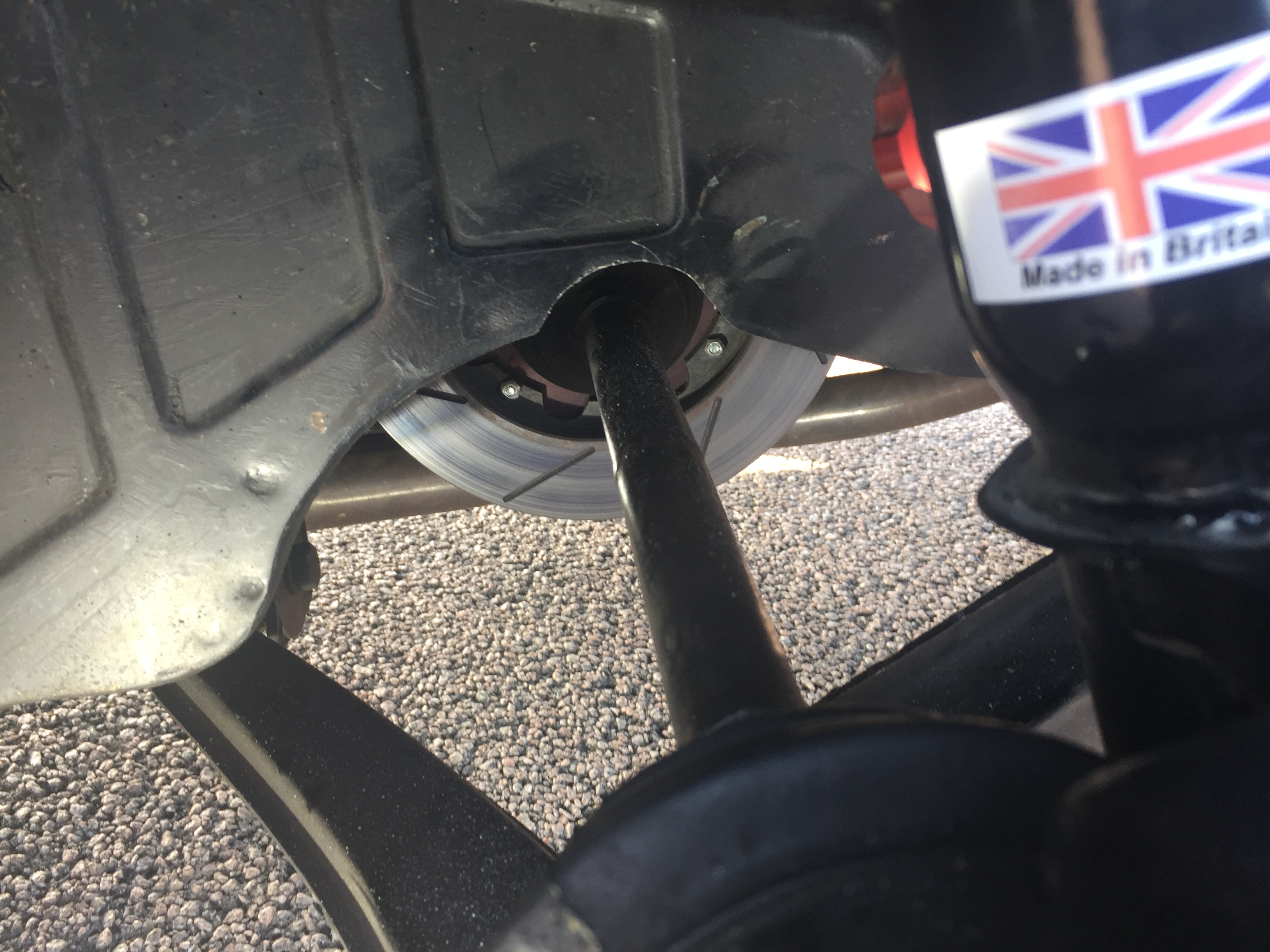

Watched the video back and there is a nasty vibration that is particularly bad in the bends. I am suspecting the near side CV joint took a hammering when the suspension arm broke.
I won't race tomorrow unless I can fix it.
Two complete overhauled driveshafts in the boot
and great advice from Tom.
6am start on the job. Race at 11:45am!

Posted: Sun Apr 09, 2017 6:55 am
by Marlow Sud
Hi guys,
When I spoke to Tom last night he said "just check the driveshafts are not rubbing on the body. They do that when lowered and with hard cornering."
Jacked the front end up and the cv joint play and action on full lock was fine. Checked the driveshafts and this was the offside one.
Poor little car has been getting a lot of abuse from me.
The nearside one is fine. The other lower suspension arm looks ok for one race before I change it.
I will sort the body rub when everyone wakes up in the paddock. Although not ideal, the driveshaft is pretty beefy so I won't fret that it's a bit smaller diameter where it has rubbed.
Good to go!

More clearance with a half round file:
