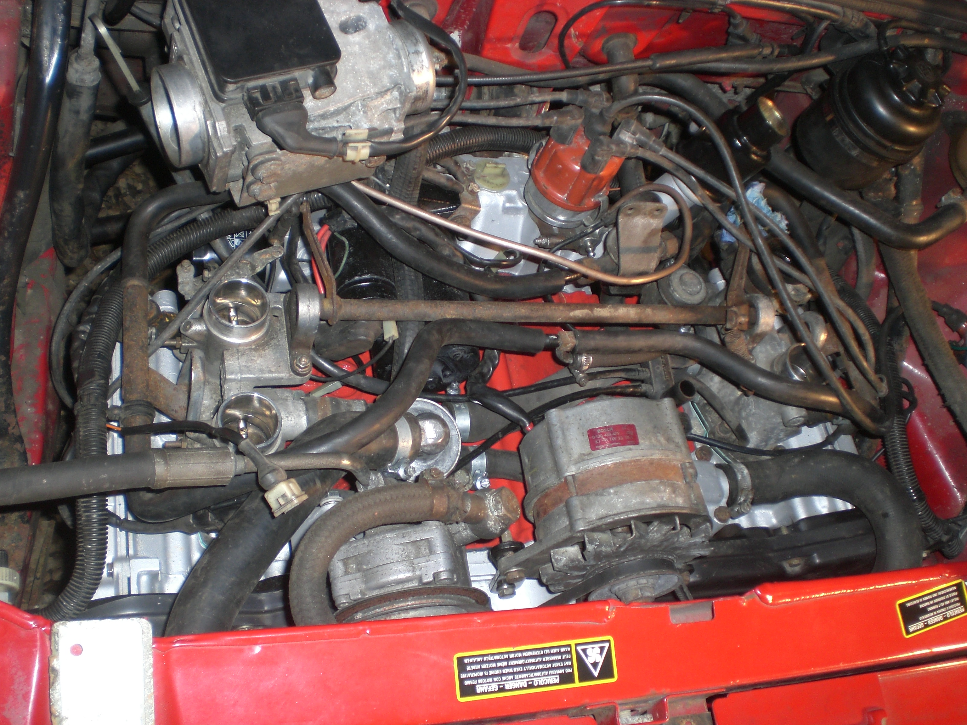

although the engine was in place last night there was an awful lot of stuff to fit. none of the water system was in place, no fuel parts, TB's were only in place for somewhere to hook the hoist!
so with all the bits and pieces fitted back on i eventually got to the point of trying to coax it into life, often takes a bit of fiddling with things, but this time it just started like it'd never been out!

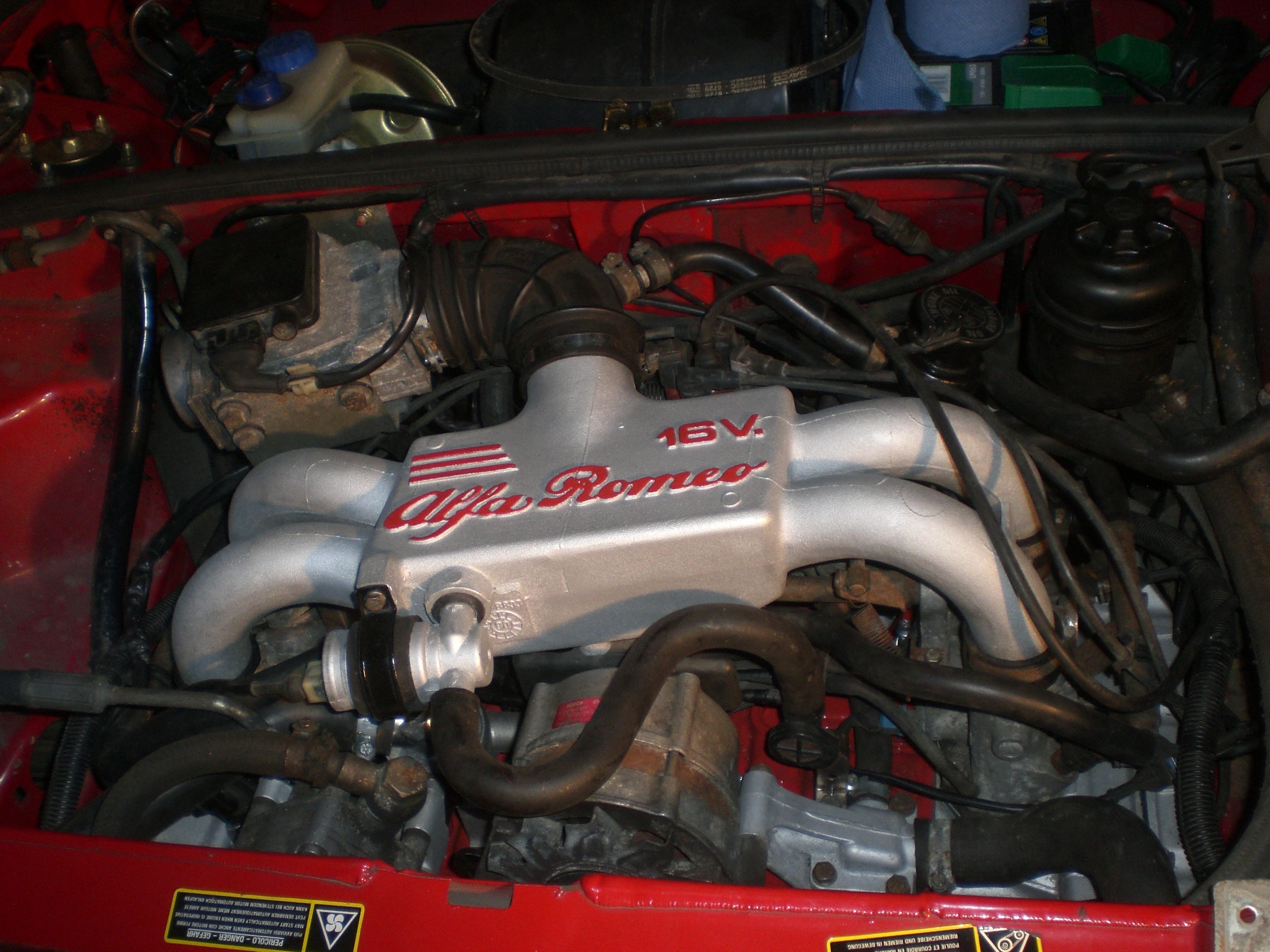

this engine already idles and picks up better than the old one did, can't wait to get a few miles on it.
my lad rob did some painting on the inlet manifold today too, can't resist a bit of red as all the paint on the block disapears when stuff goes back in!
