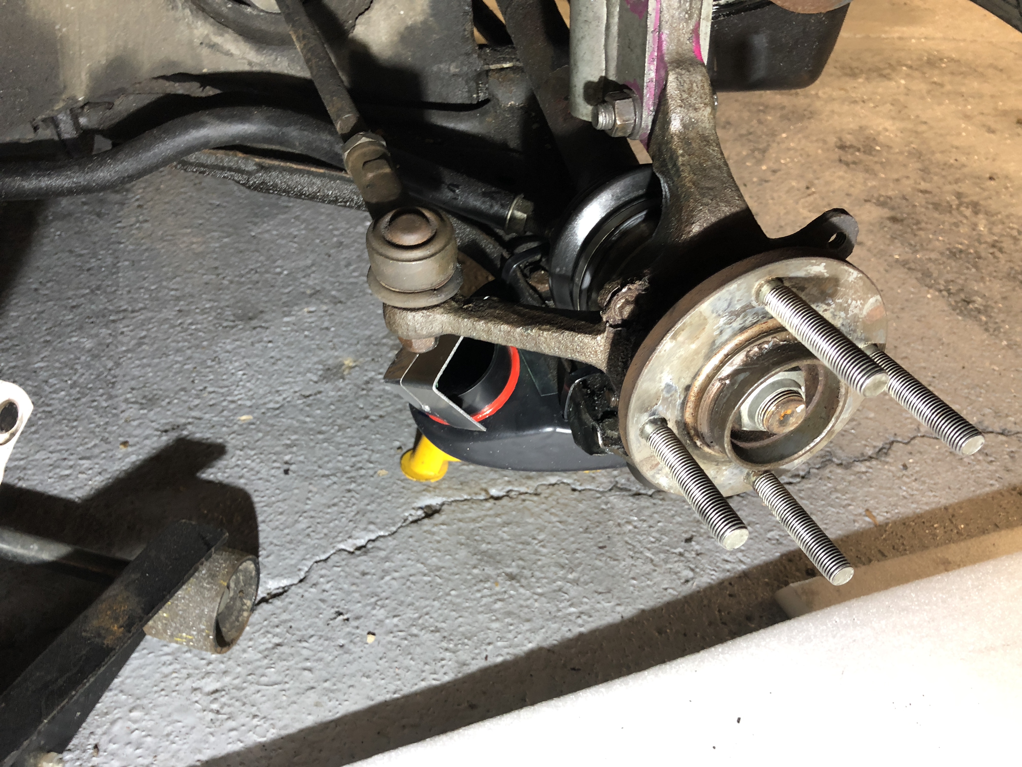

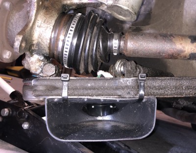

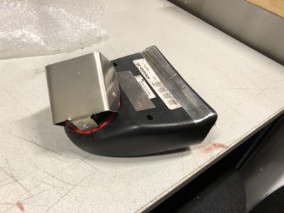

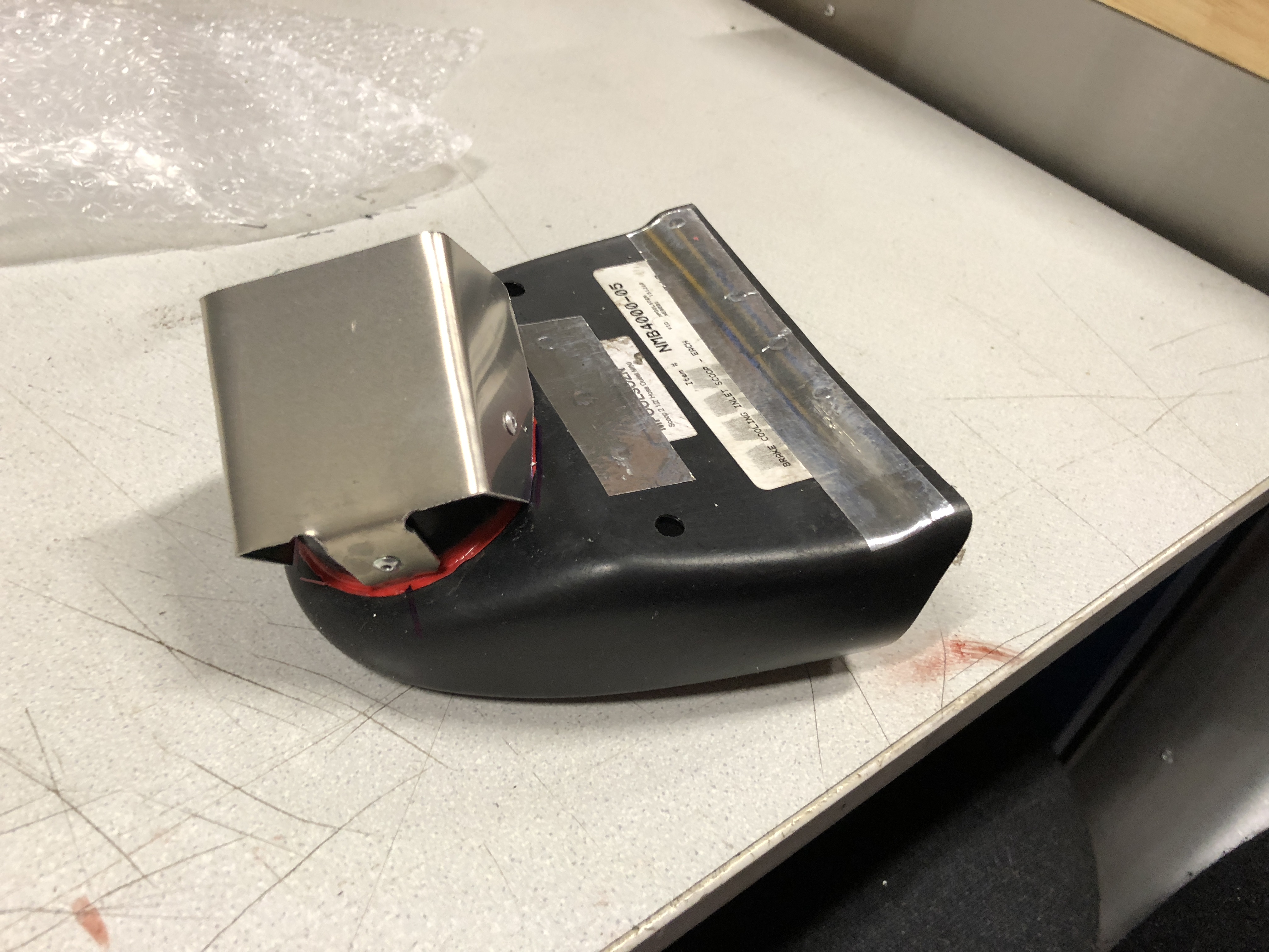

The brakes were getting really hot. Lots of rising smoke when I left the track and had to hold it on the brakes to talk to an official.

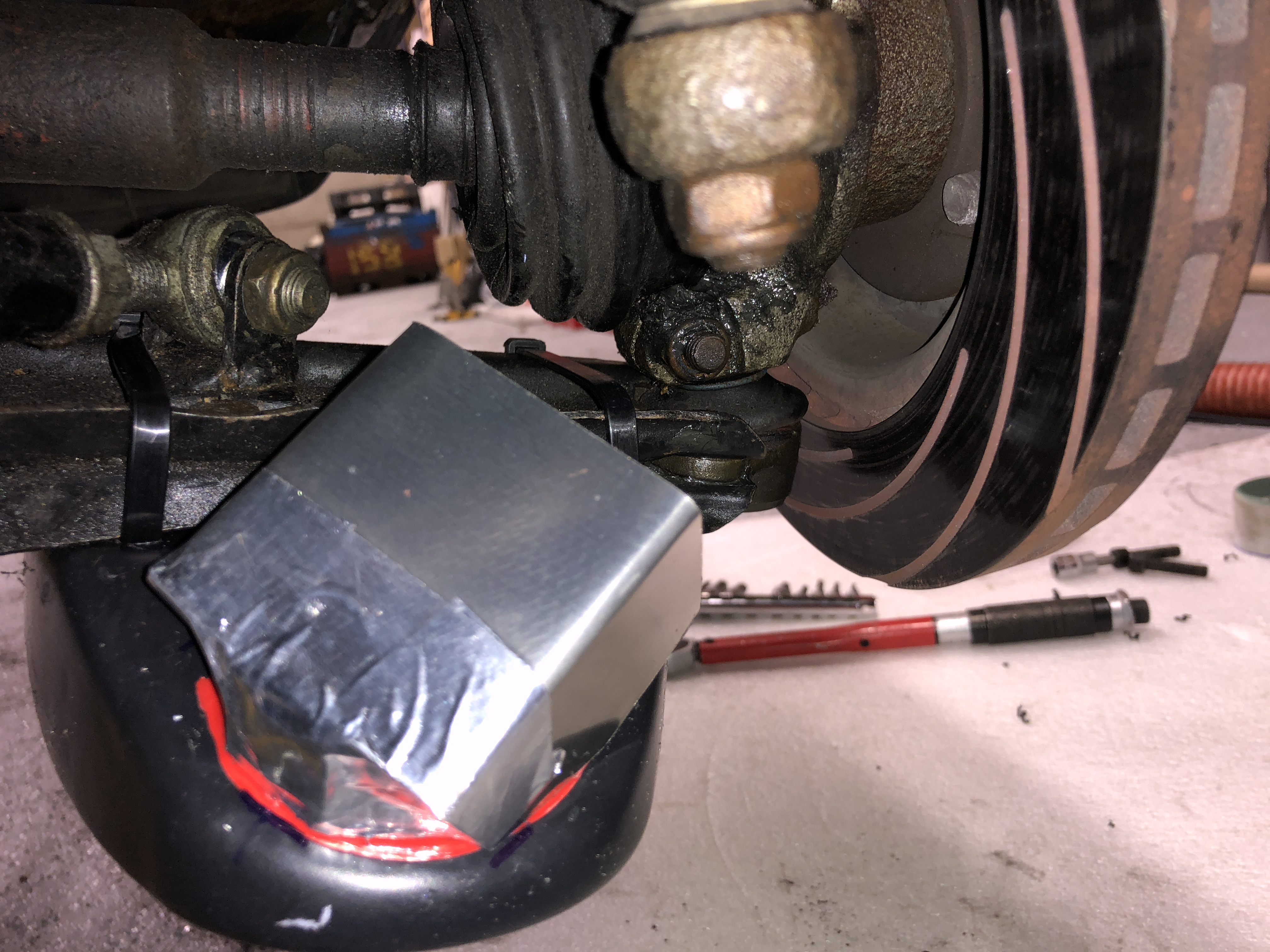

I have fitted the old dust pan style scoops but space is pretty limited so I made up some little alloy deflectors.
This CV joint boot had tywraps on it so it had flung grease everywhere. I have the proper bands and tool on the way to sort this.
I took the opportunity to check the pads and de-glaze the Discs.
The dust pans should make a difference.

Hi Simon,Lets hope they can try and shift some of that heat.
Discs look good, that was a nice mod. 8-)

Hi Keith
Got a new tool and the CV joint cuff bands today. It does a lovely job. Ordered the tool and bands on Amazon Prime yesterday!

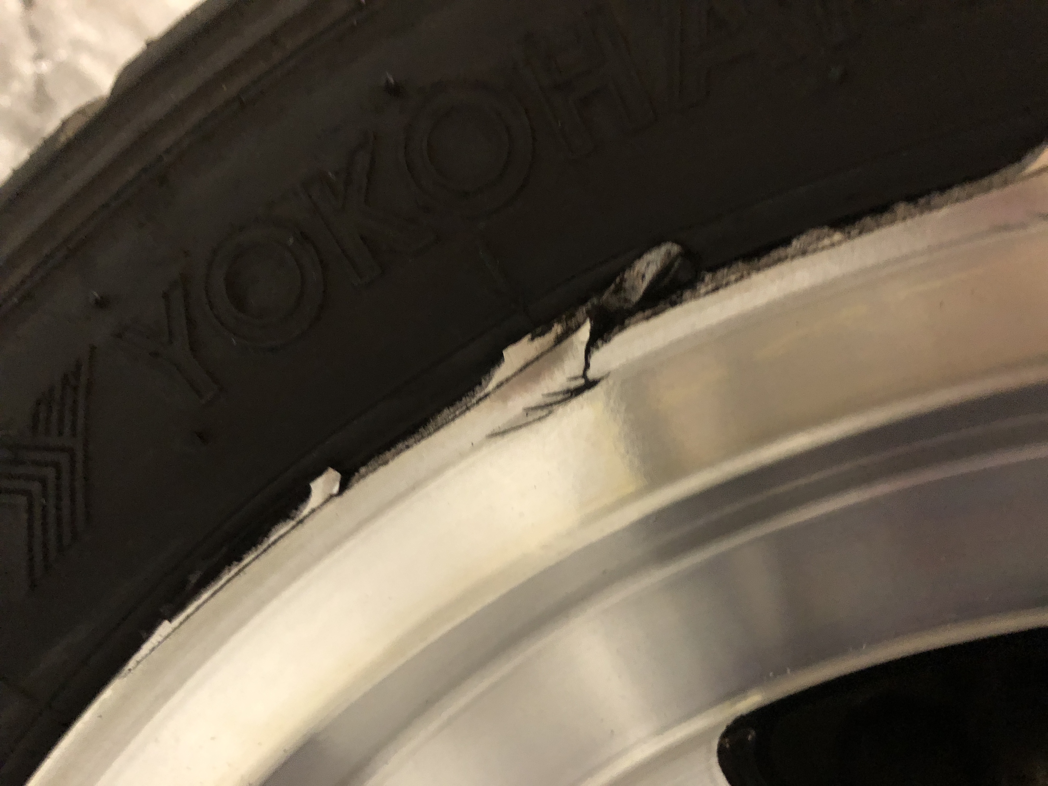

Hi Shrew,

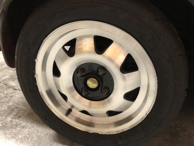

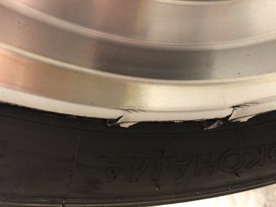

As a wheel guru, can this wheel be weld repaired?
Any advice greatly received.
alfettagtam
Posts: 53
Re: Escort Hunter Killer
Post by alfettagtam »
Yes, it is possible to fix something like this. BUT, you need the right place to do the job.
There is just one here in Christchurch, NZ but that's not much help to you!

Hi AlfettaGTAM,
I have found an alloy wheel welding company close by in High Wycombe. I will let you know what they say.

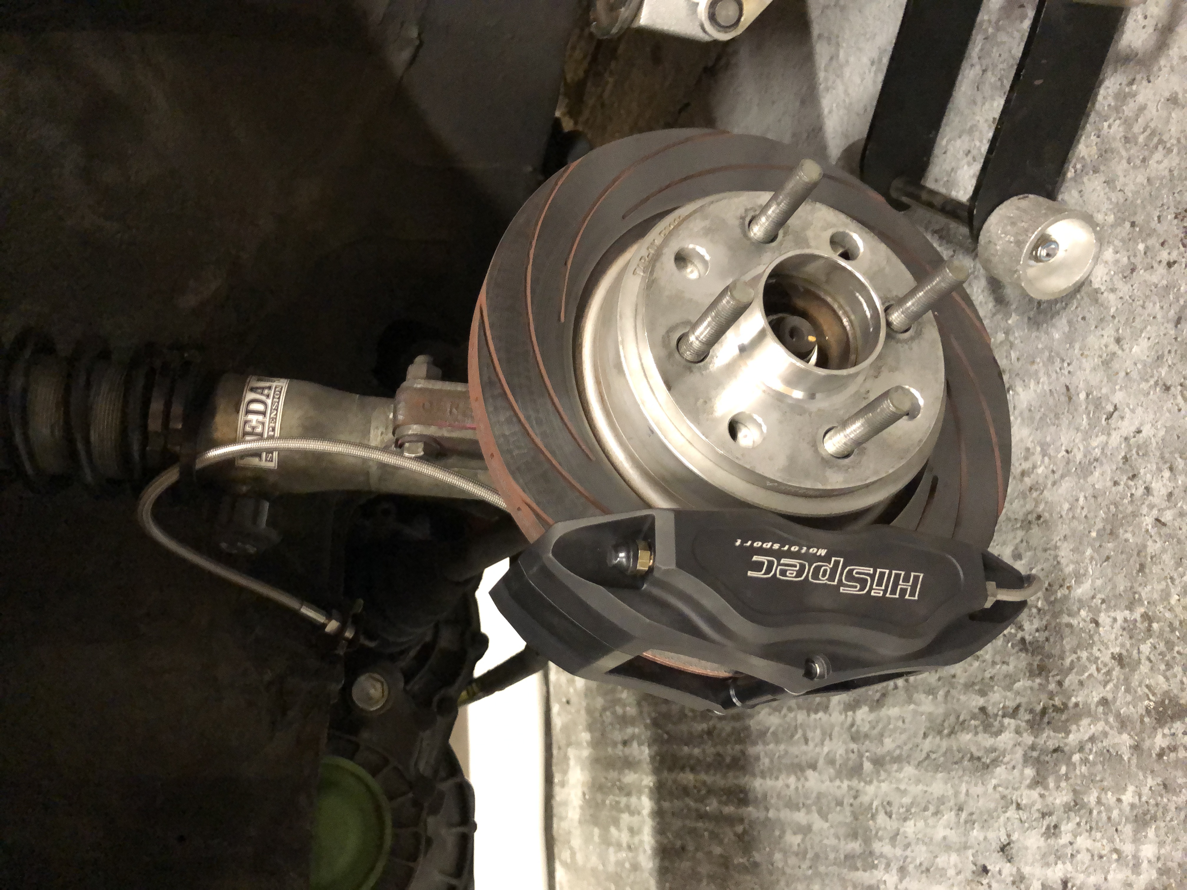

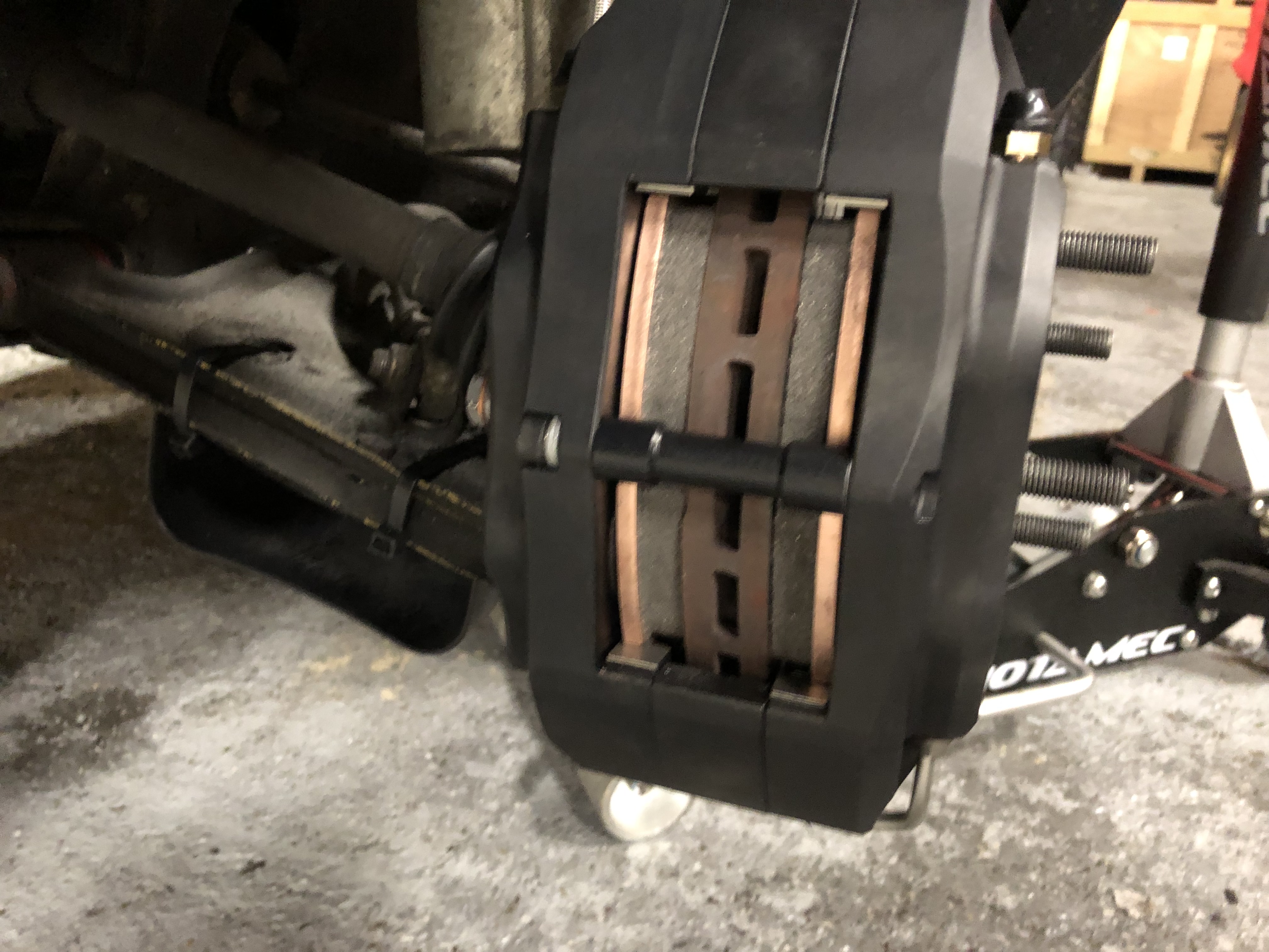

From looking at some other peoples videos I make smoke when braking. The brakes smoke like crazy when I have finished a race. I assumed they were just getting hot but my brake fluid level for the front brakes was getting lower.
I think the front caliper piston seals are leaking fluid on to the back of very hot pads.
Anyway, the calipers are old Wilwoods so time for new ones.
I took the opportunity to fit new braided hoses and the pads are RC6.
Should stop better now and no more smoke.

The rc6 are excellent, initial bite is 5 times better than the ferodo ds3000. You might find you go slower per lap initially as the brakes are stopping you more than you were used to before !

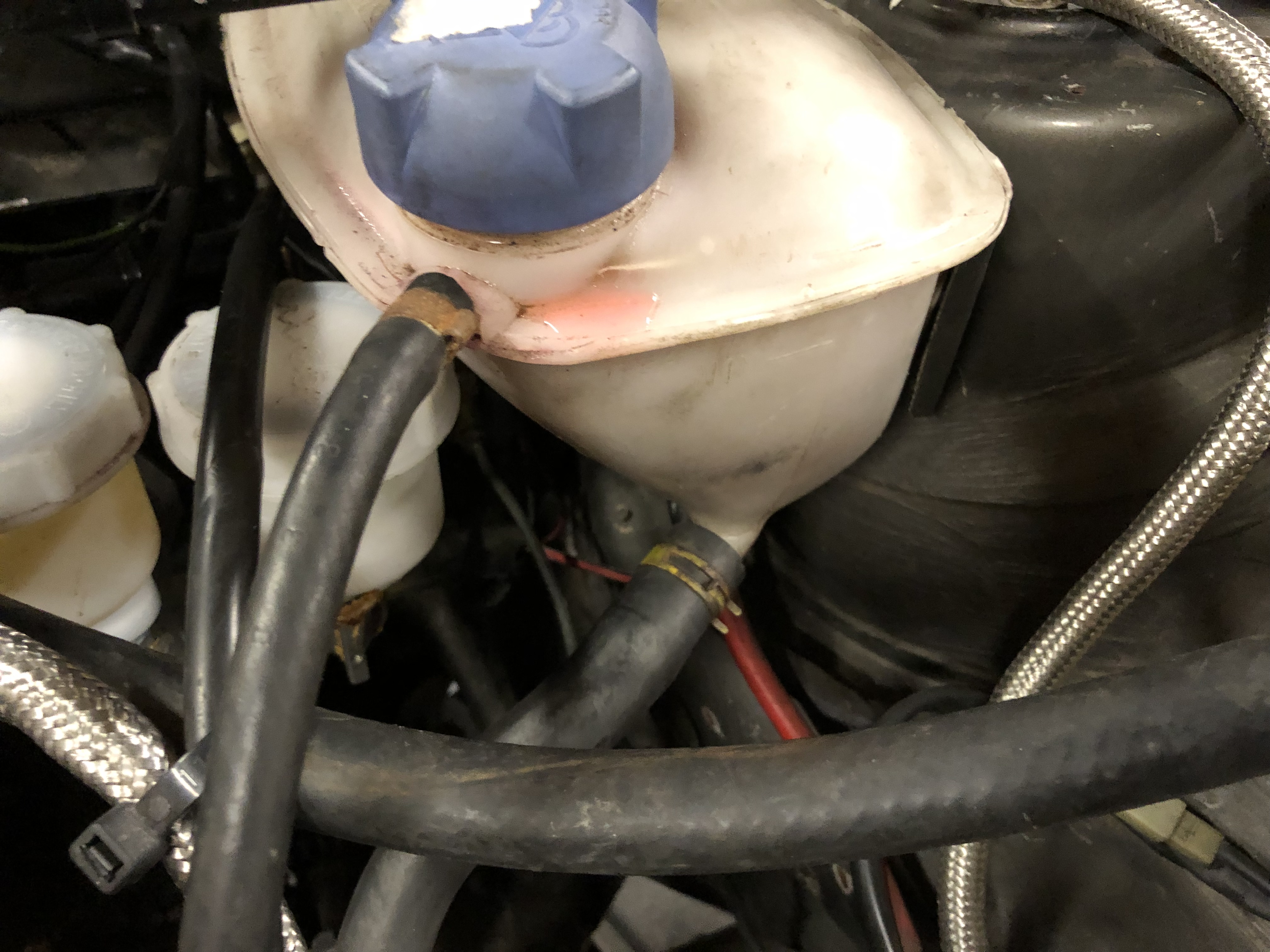

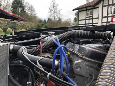

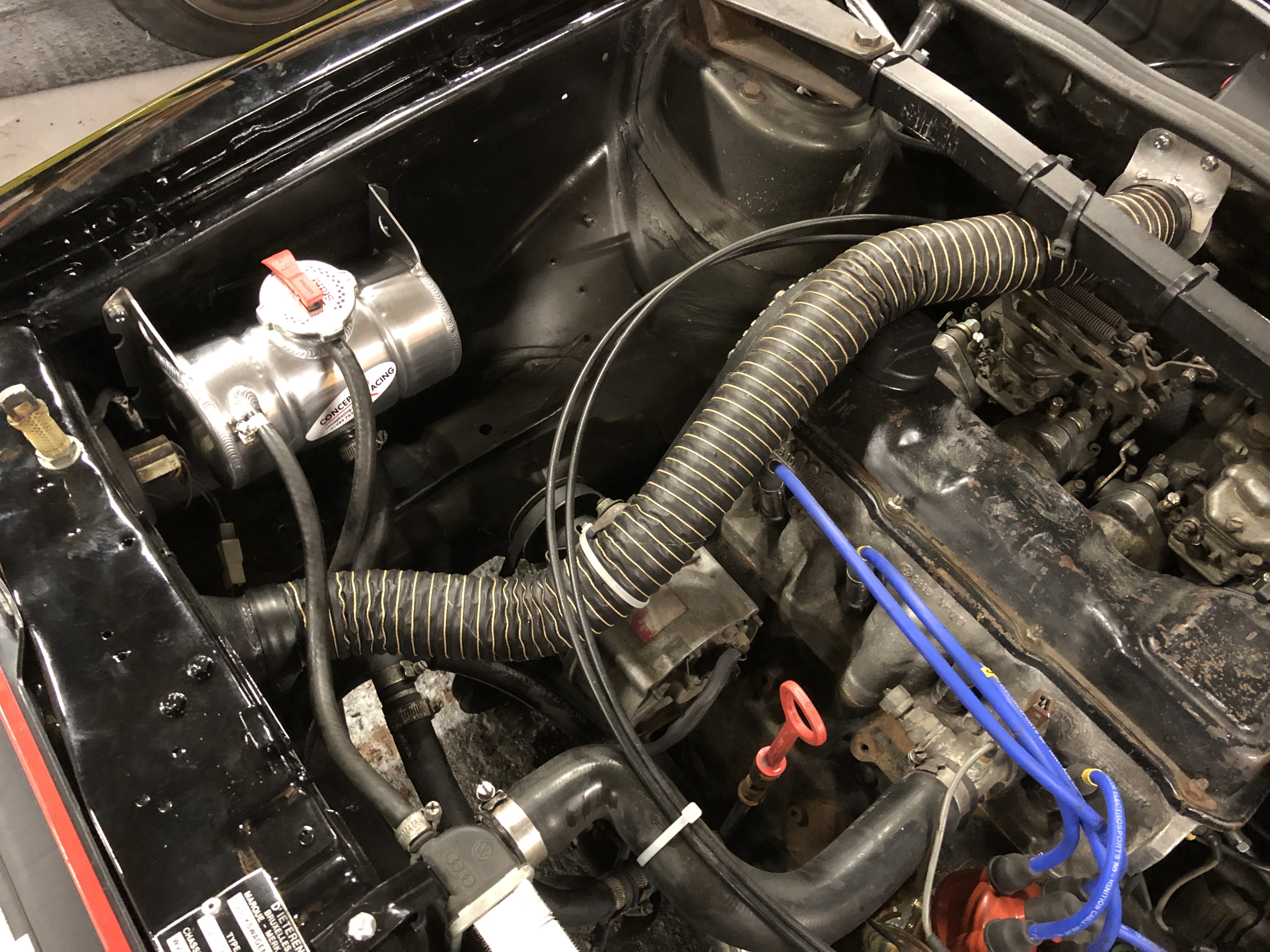

My header tank fouls my brake master cylinders as follows:
I took the opportunity today of replacing it with a nice alloy Concept Racing one:
That header tank Simon, looks a bit low?
For it to work it needs to be higher than the rad and more importantly, the head so that air comes to the tank and not sit in the parts you don't want air..
Love the nice big brakes though
Posts: 976
Post by Marlow Sud »
It’s a fair point Kev.
I will check it out to ensure it is higher than the top of the rad and the cylinder head cooling passages.
Last thing you want is an air lock in the head mate!
Hopefully I'll be able to catch up this summer somewhere to see the car out on track 8-)
Posts: 976
The header tank is now high enough Kev.
