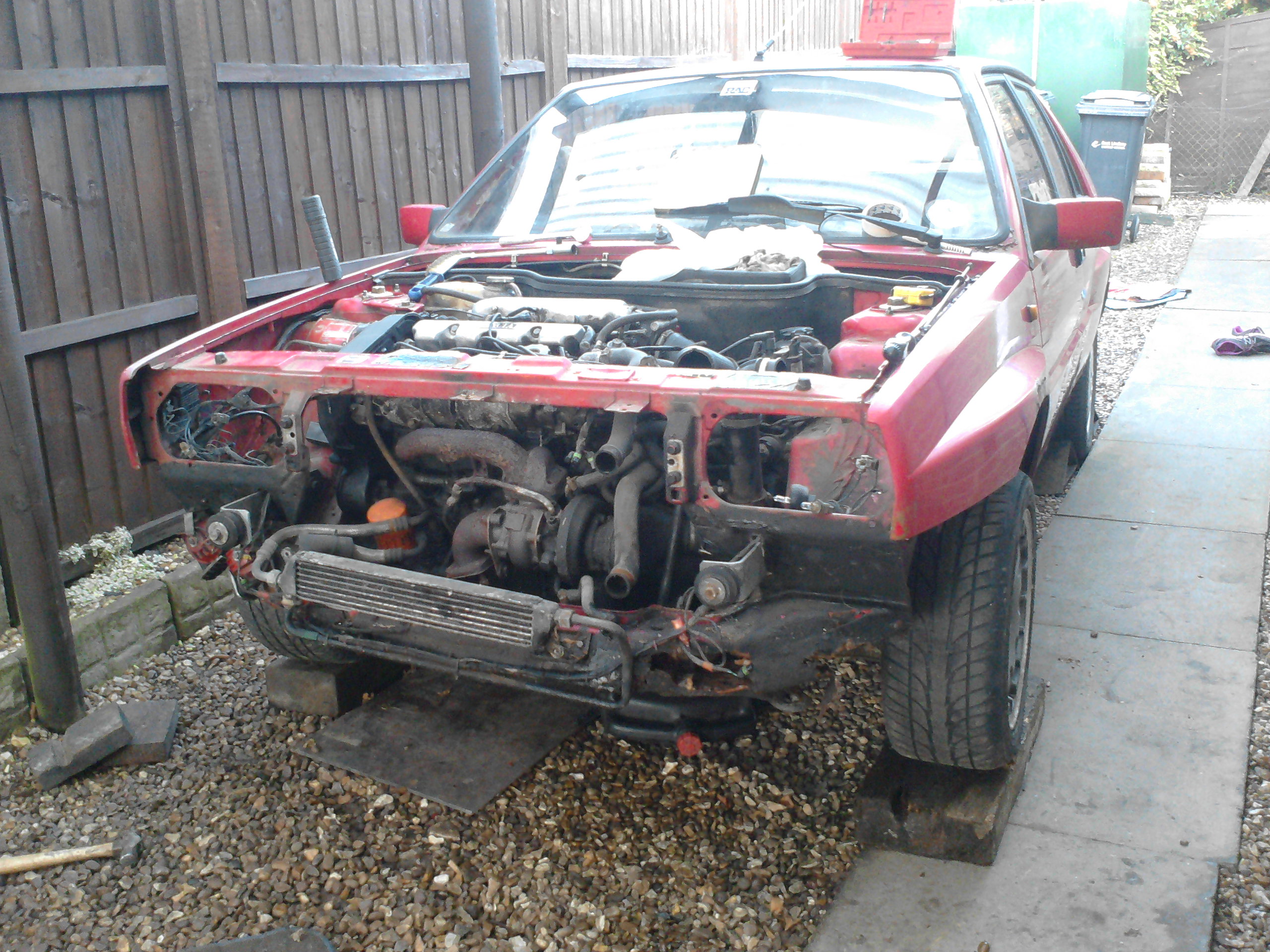

the transfer 'box is now off once the front shafts were removed. the workshop manual only listed a few bolts holding it in....shame they didn't mention all the others that hod in in!
most pipes and cables, gear linkages etc are removed. only left the electrical connections in place until the last minute as I don't want to leave it long in this damp air with them un-plugged.
as it sits now there's just the small matter of craning it all to the floor, separating the gearbox off the engine then the engine itself should be able to be lifted out through the top.
it is IMPOSSIBLE to lift it out the top with the gearbox still attached. chassis rails, engine stabiliser mounts, brakes master cylinder etc all sit in the way of it going upwards as one.
it'll be fun trying to get this lot back in place in a freshly painted engine bay.......

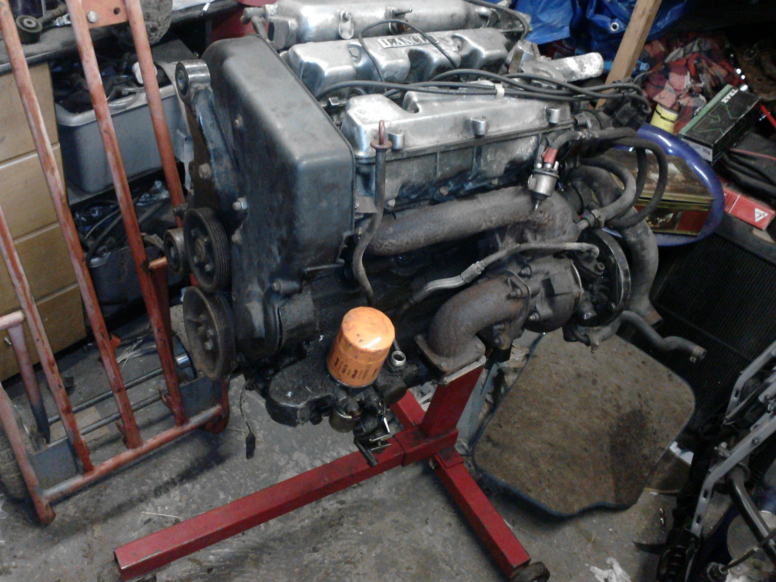

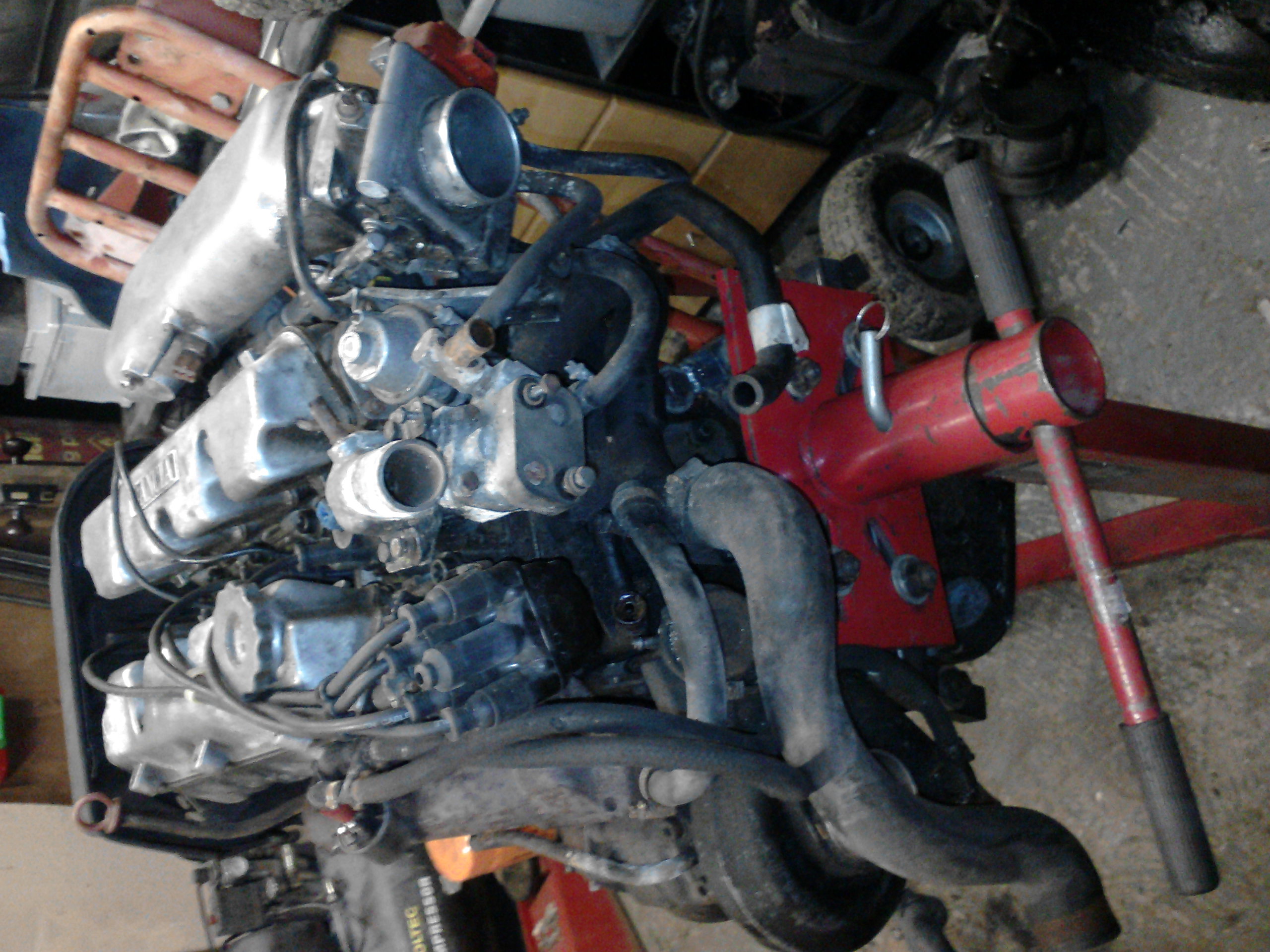

]engine is out now, in fact it was a week or so ago, just not got around to posting.

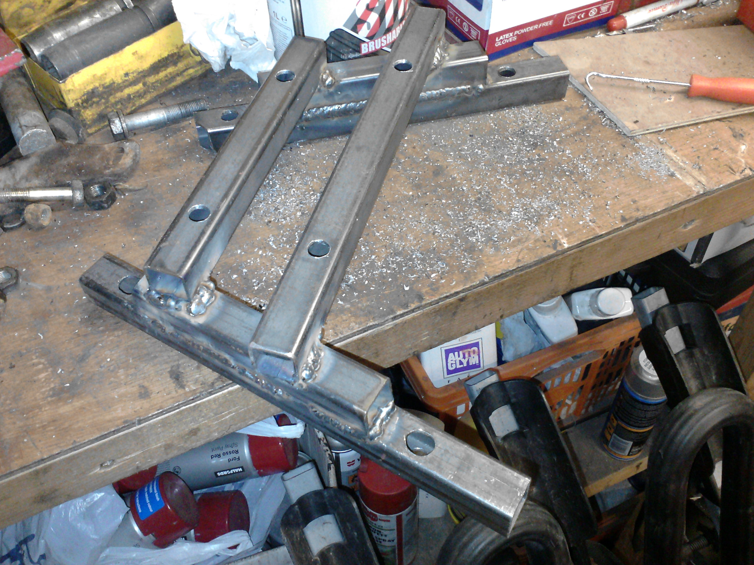

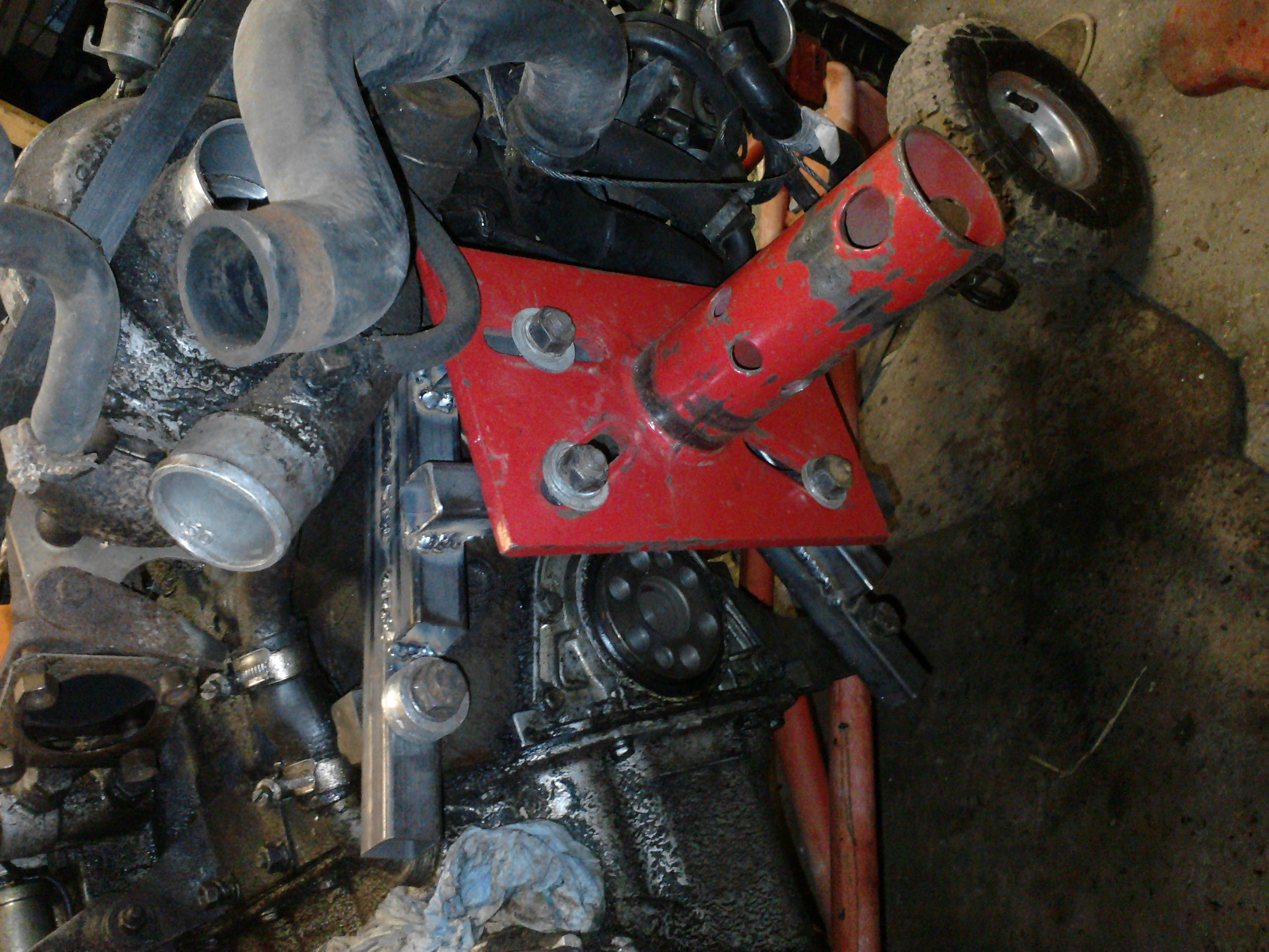

to get the engine up on the stand meant making up another adapter plate as the arms wouldn't fit where I wanted them to and leave room for the rear crank seal housing to be removed.
some left over box section and I now have the spindle mounted. just need to fit a few little gussets to help strengthen the joints
little workshop up the road from me at my mate jims is about ready now so the car will be moved there when I get chance, then the chopping can start

finished the gussets for the frame adapter tonight so lifted it all up on the engine crane and slid the stand onto the bracket then lowered it all down
happy to report it didn't fall to the ground!
still got to decide how far the strip down goes but i'm sure it'll end up being a full rebuild....

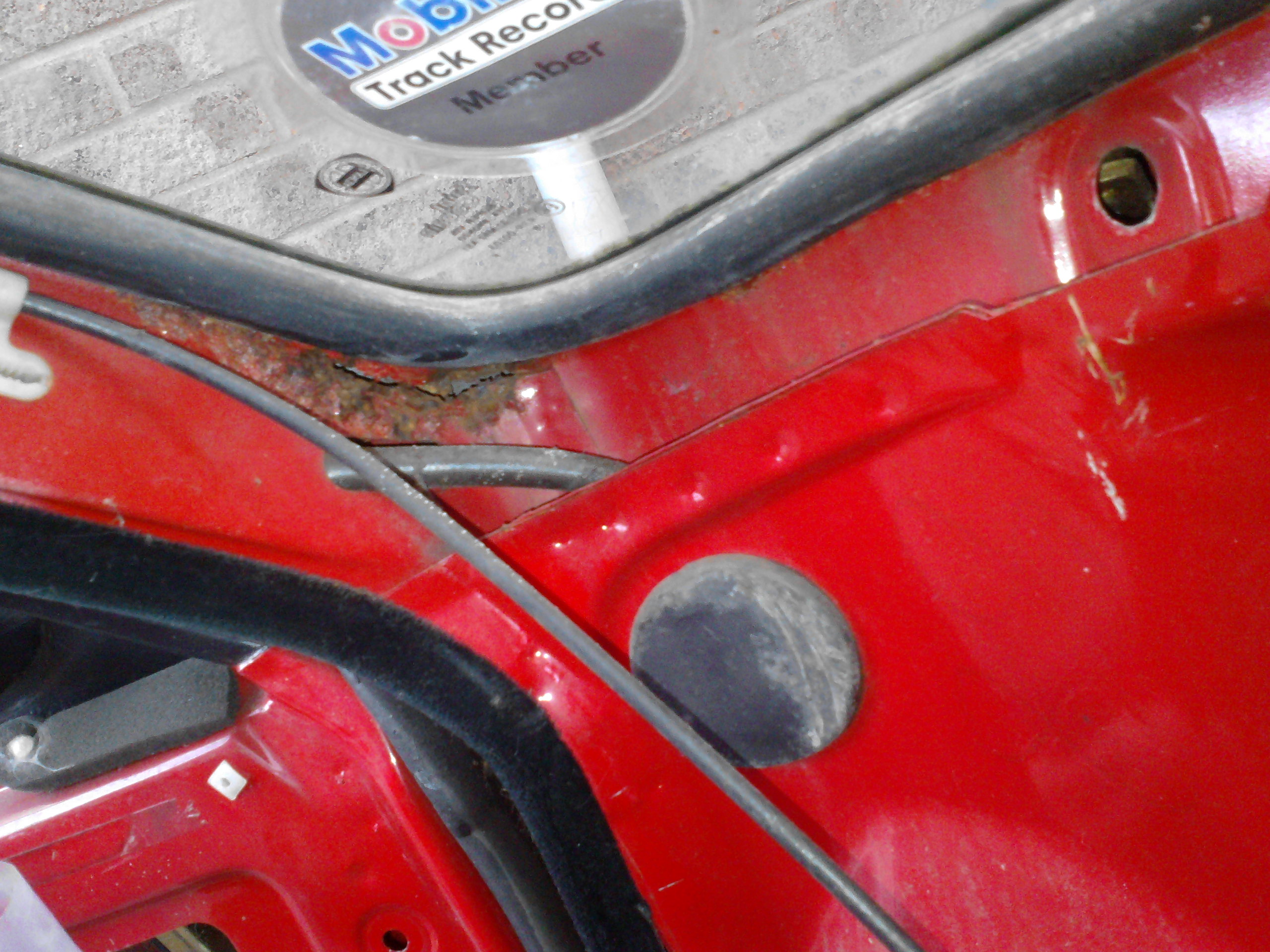

so with the day free and after half an hour of sitting idle I set about the integrale again as it's off away next weekend to jims where i'll be chopping it up properly.

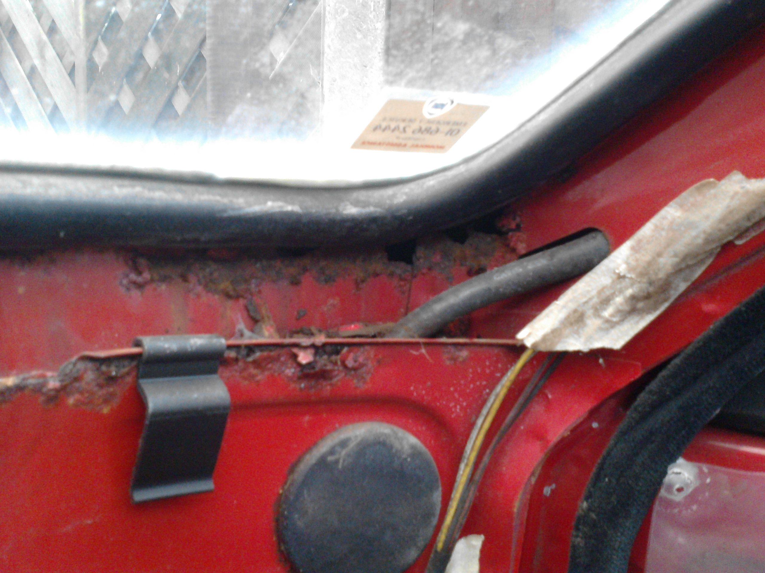

so I set about taking the dashboard out which wasn't too bad a job in the end but blimey, there's a whole heap of wires behind there!
found some usual and not unexpected more rust holes around the screen corners but not to worry, i'll be changing the whole scuttle top panel anyway to make the wipers park on the right side, and get rid of some holes
with that out the engine bay was then tidied up a little as there will be a fair amount of chopping out going on in there.

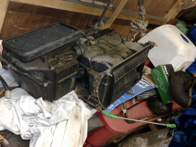

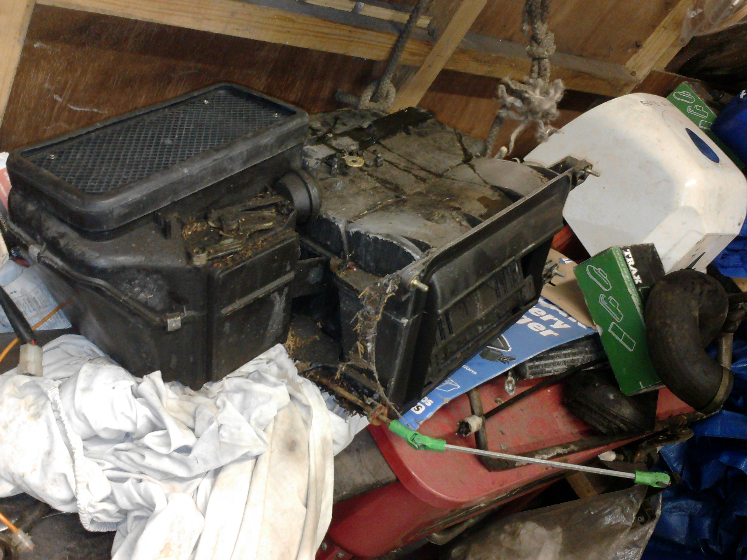

heater box looks like it could do with a full refurb so I've taken that down the shed rather than in the loft where most of the other parts have ended up for now.
note the lovely little universal joints in the heater linkages, guess even with fiat writing the cheques they didn't fully shake off the over engineering aspects

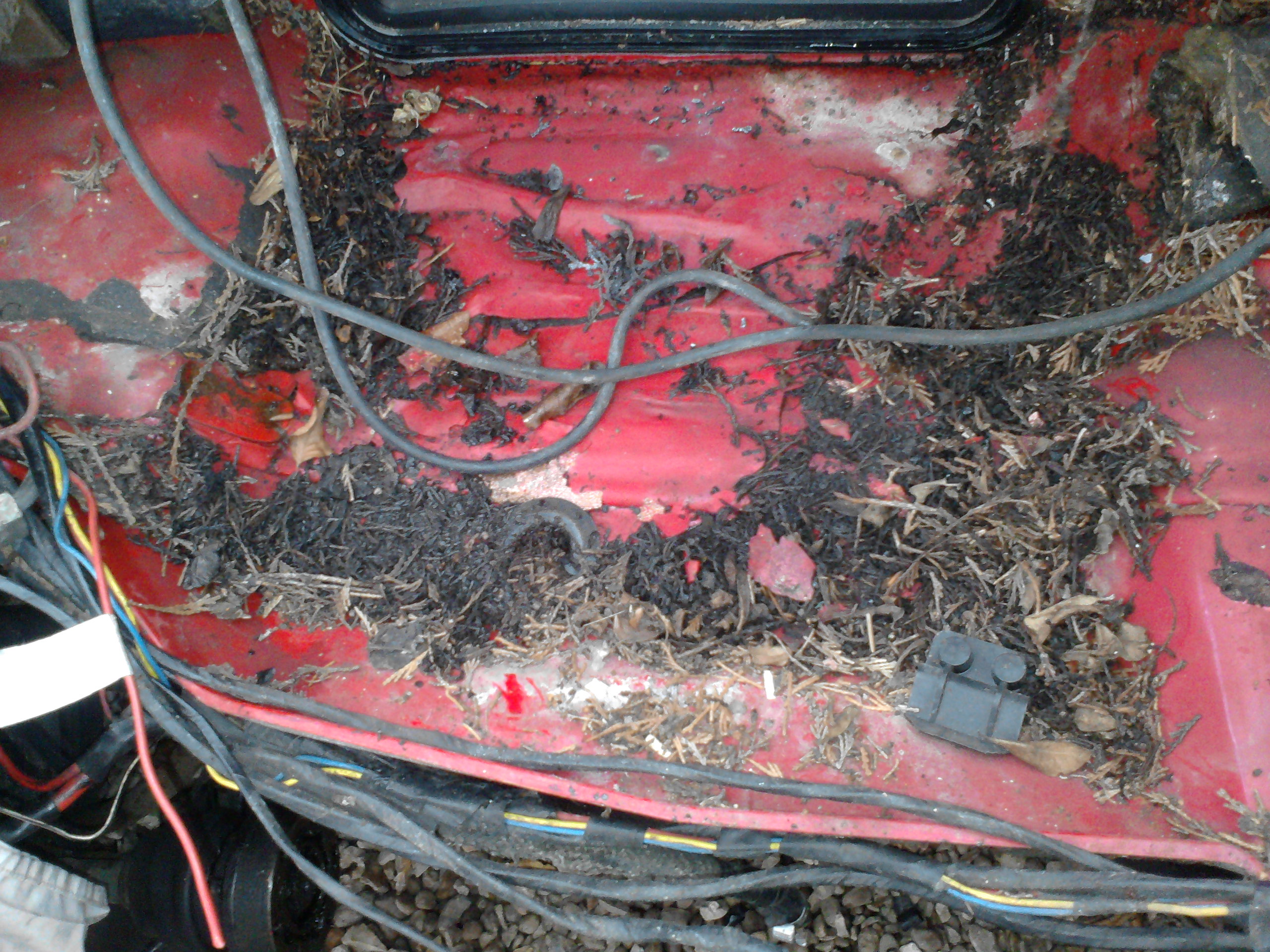

with the heater box out it's clear to see that the rainwater drain hadn't been doing its job for a while, another source for water getting into the car although thankfully it doesn't look to have caused any rot issues....

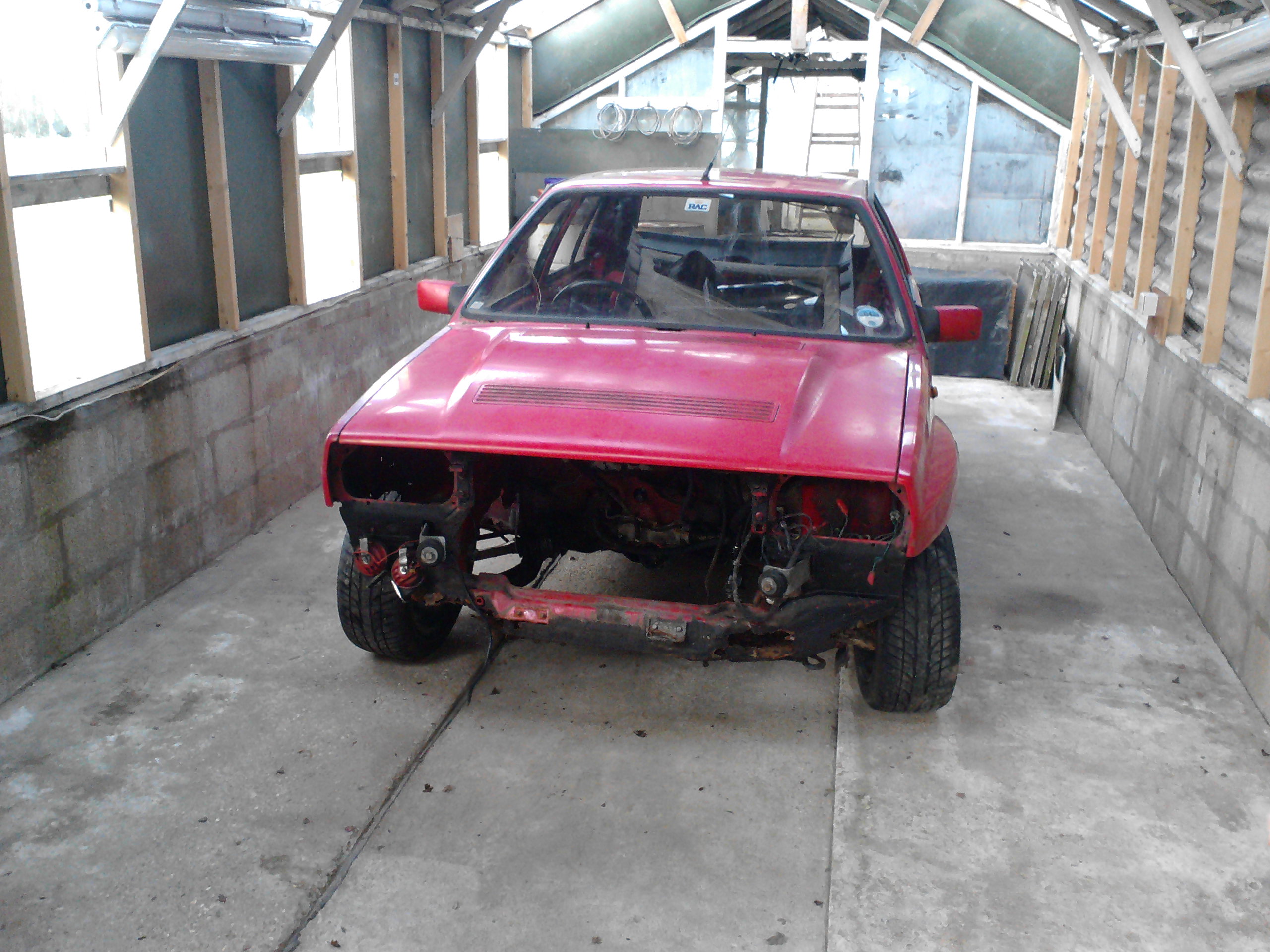

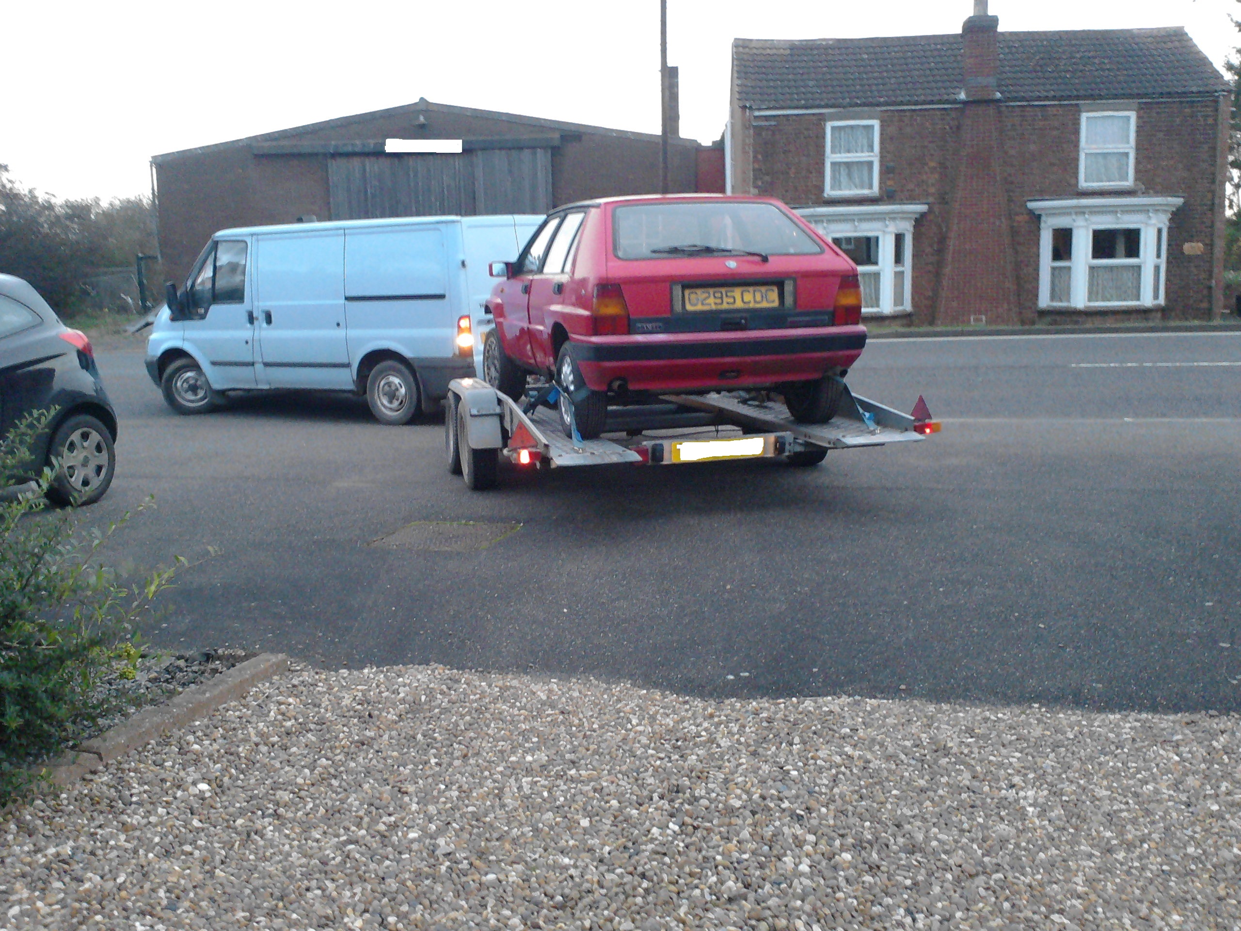

she's gone to her hospital this morning, my mate has kindly converted a shed for us to use to get the 'grale back to full fitness.
thanks to my mate steve for moving it at 8am on a sunday morning, pretty sure the neighbours didn't mind us making a racket loading it
was a bugger to push forwards as the tie rods are still off the car, hence the toe out measured in inches rather than mm's
didn't mind going backwards though so that saved the grass pushing it to the workshop
