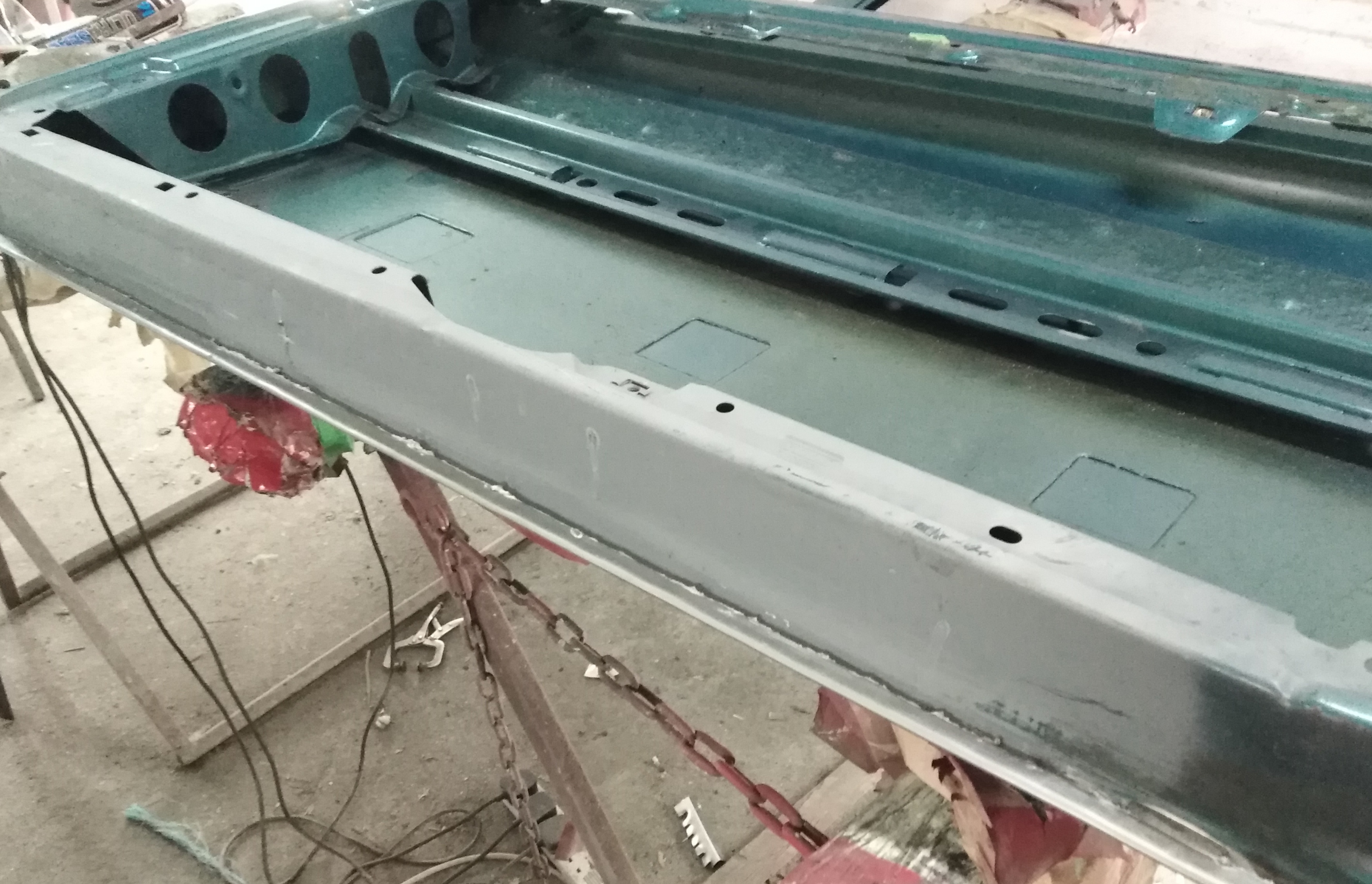

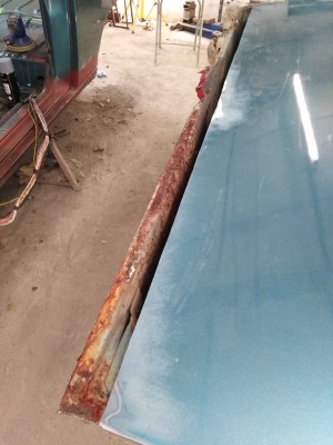

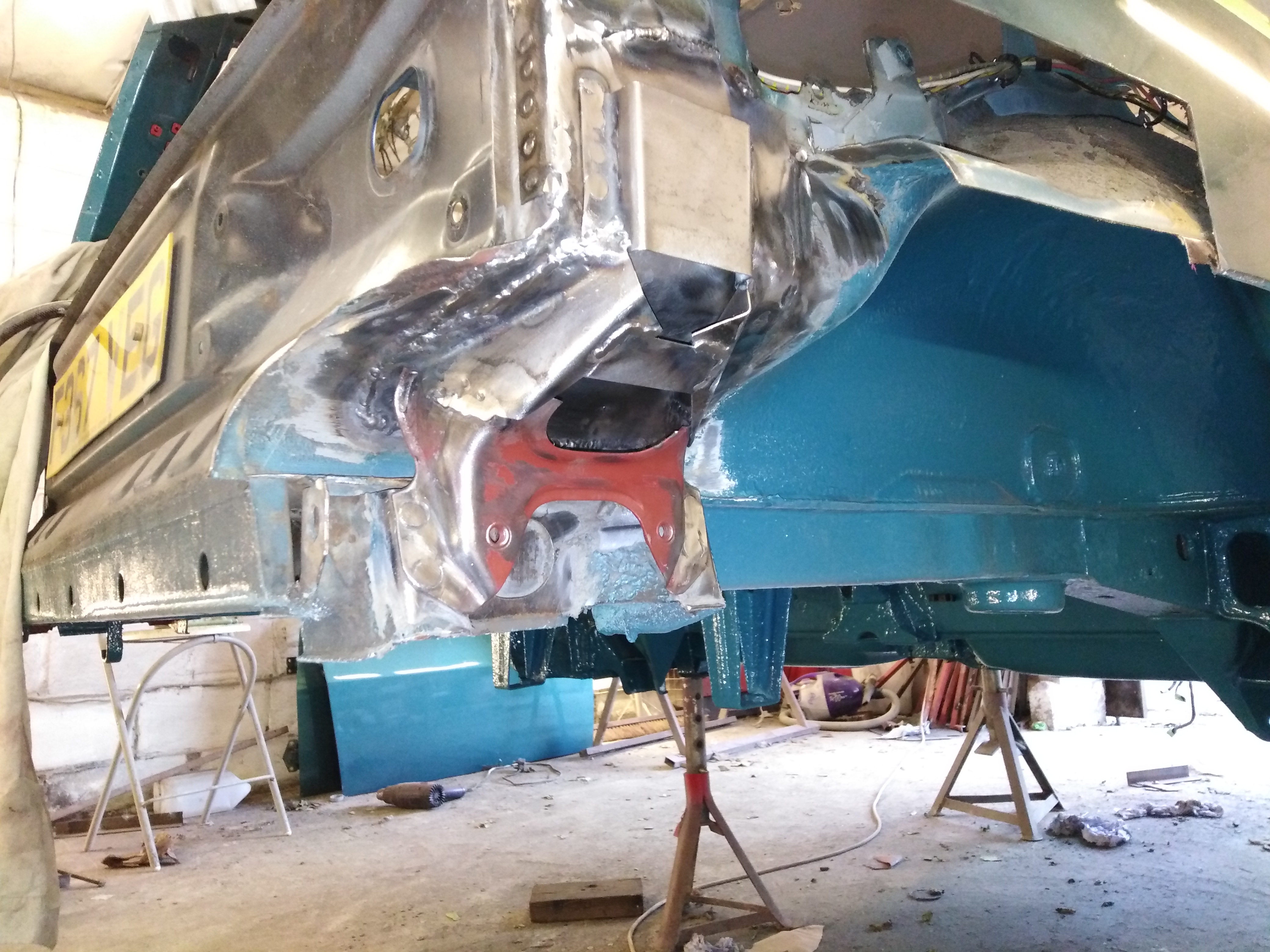

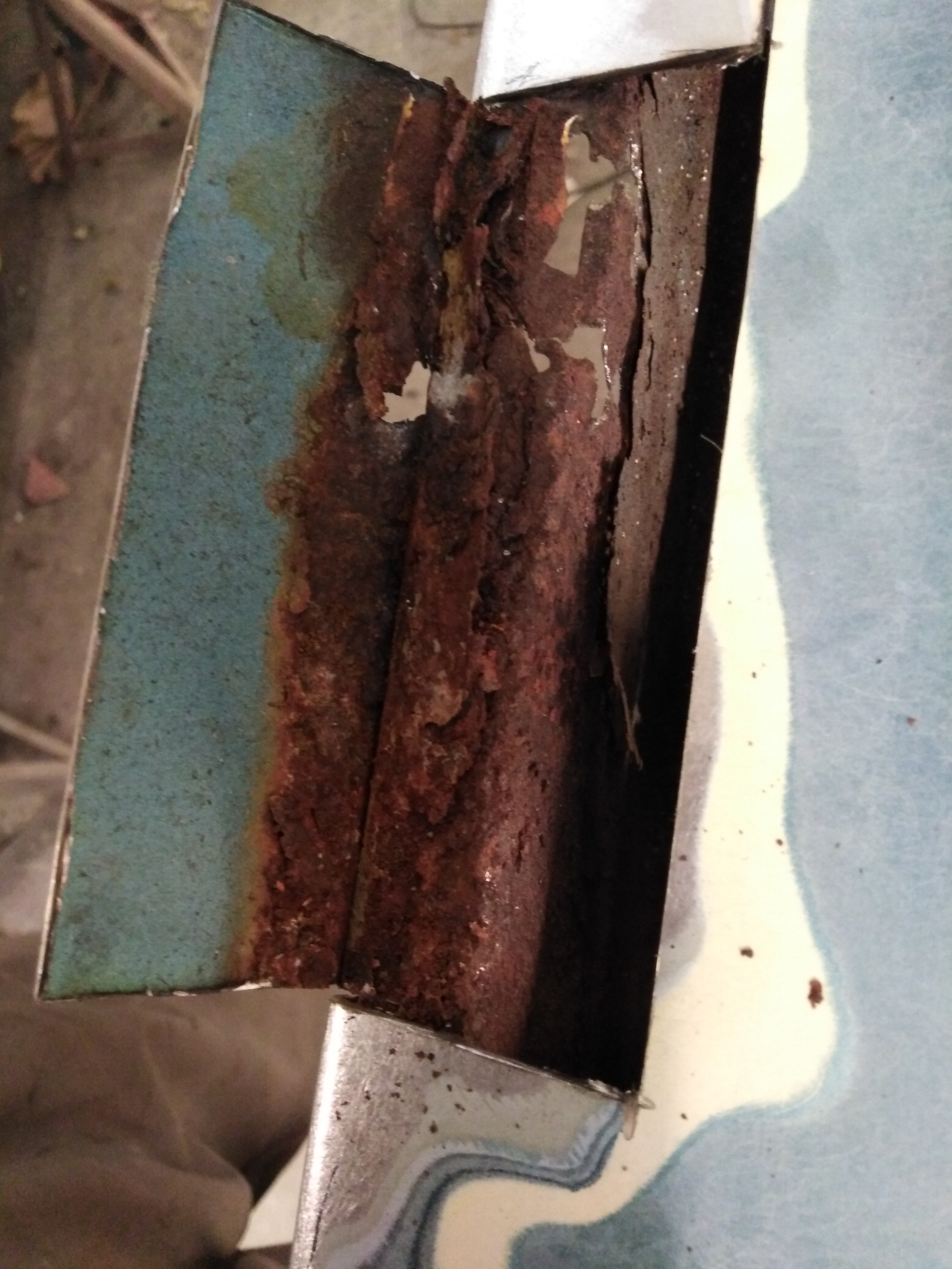

Bumper bracket reinforcer had more rot at the top end than I'd like, especially as this side bracket is also the towing eye, so a new top half will be made.
Underside has some surface rust which the electrolysis method will sort out.
Should be able to get 3 full days on the car next week so I need my arse kicking if this side isn't done and I'm chopping the windscreen surround out..

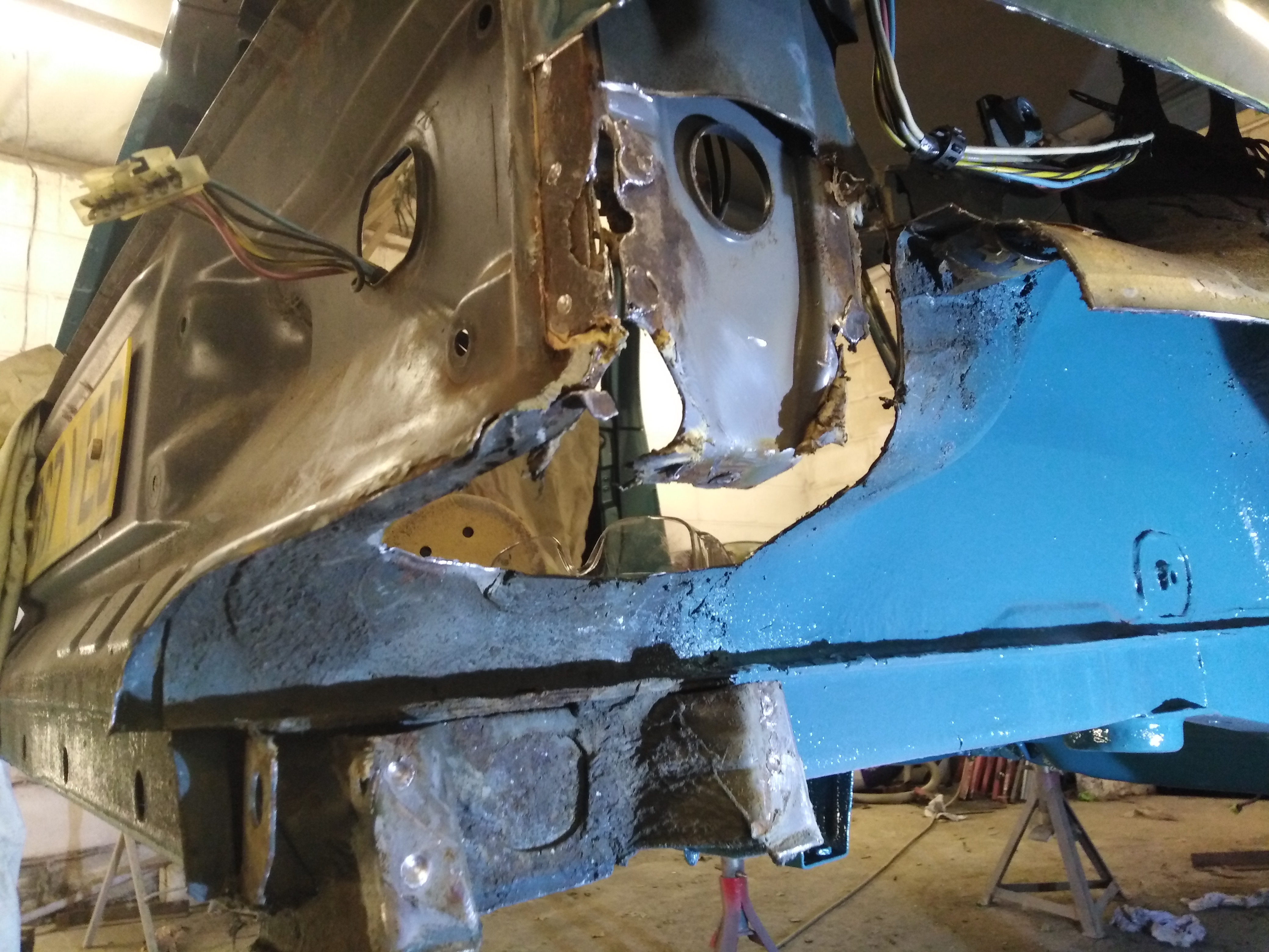

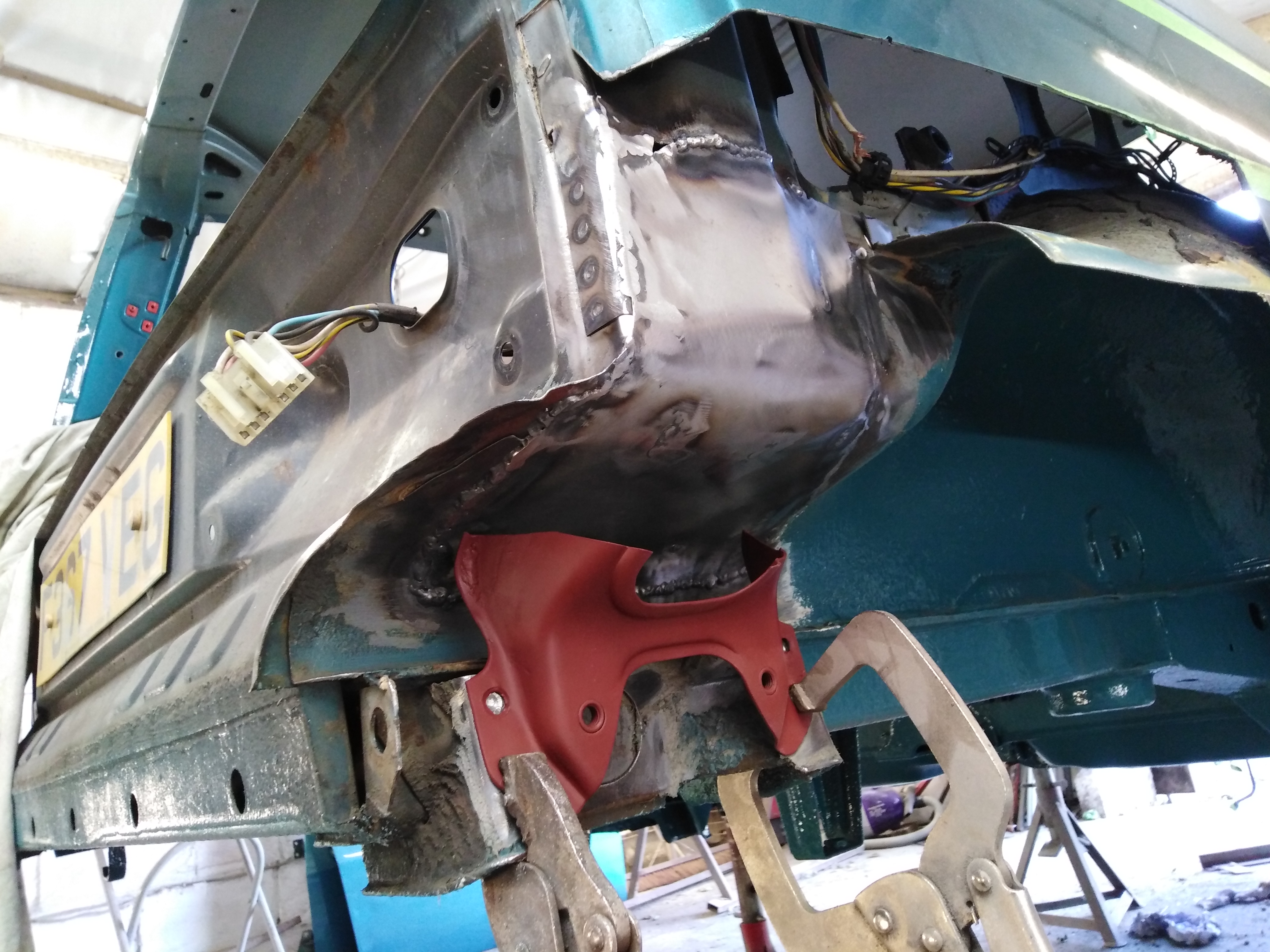

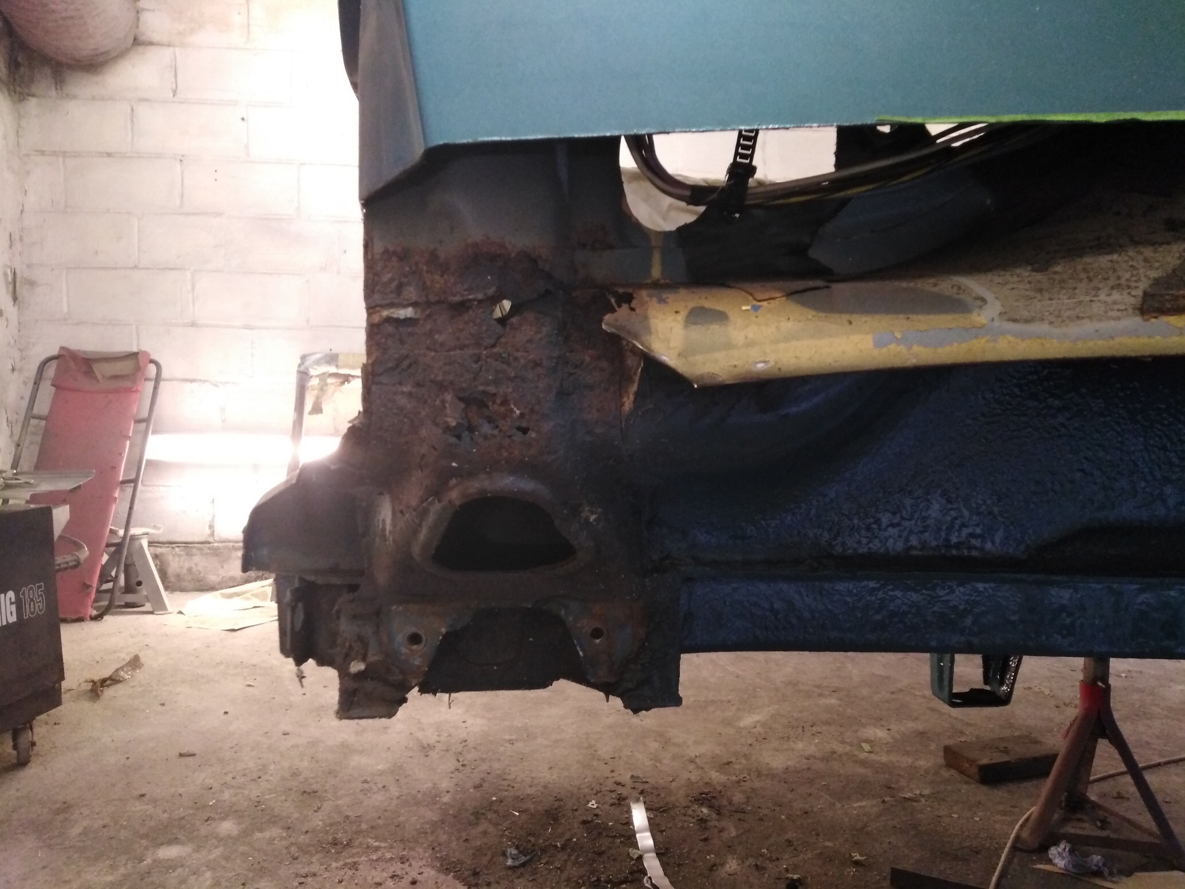

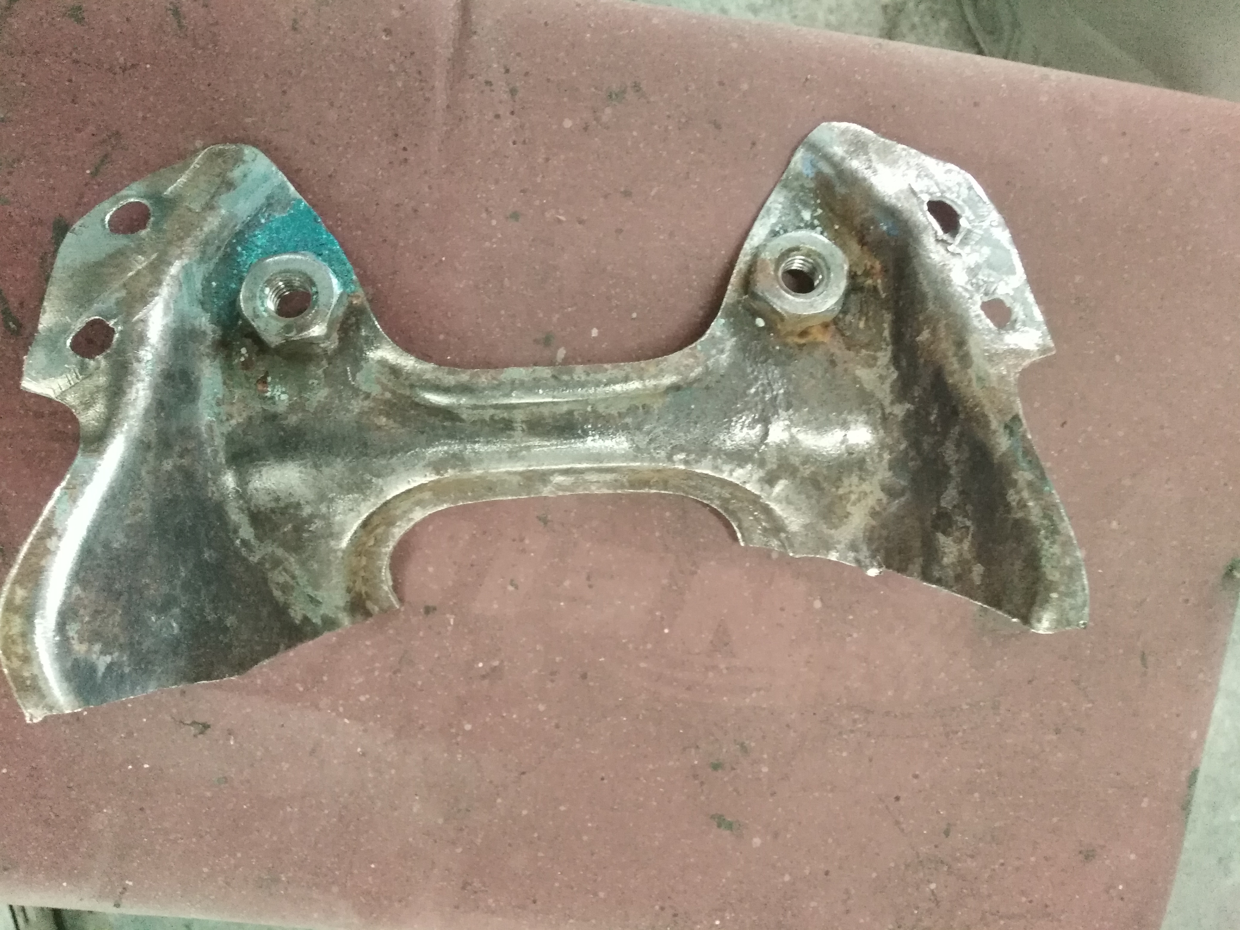

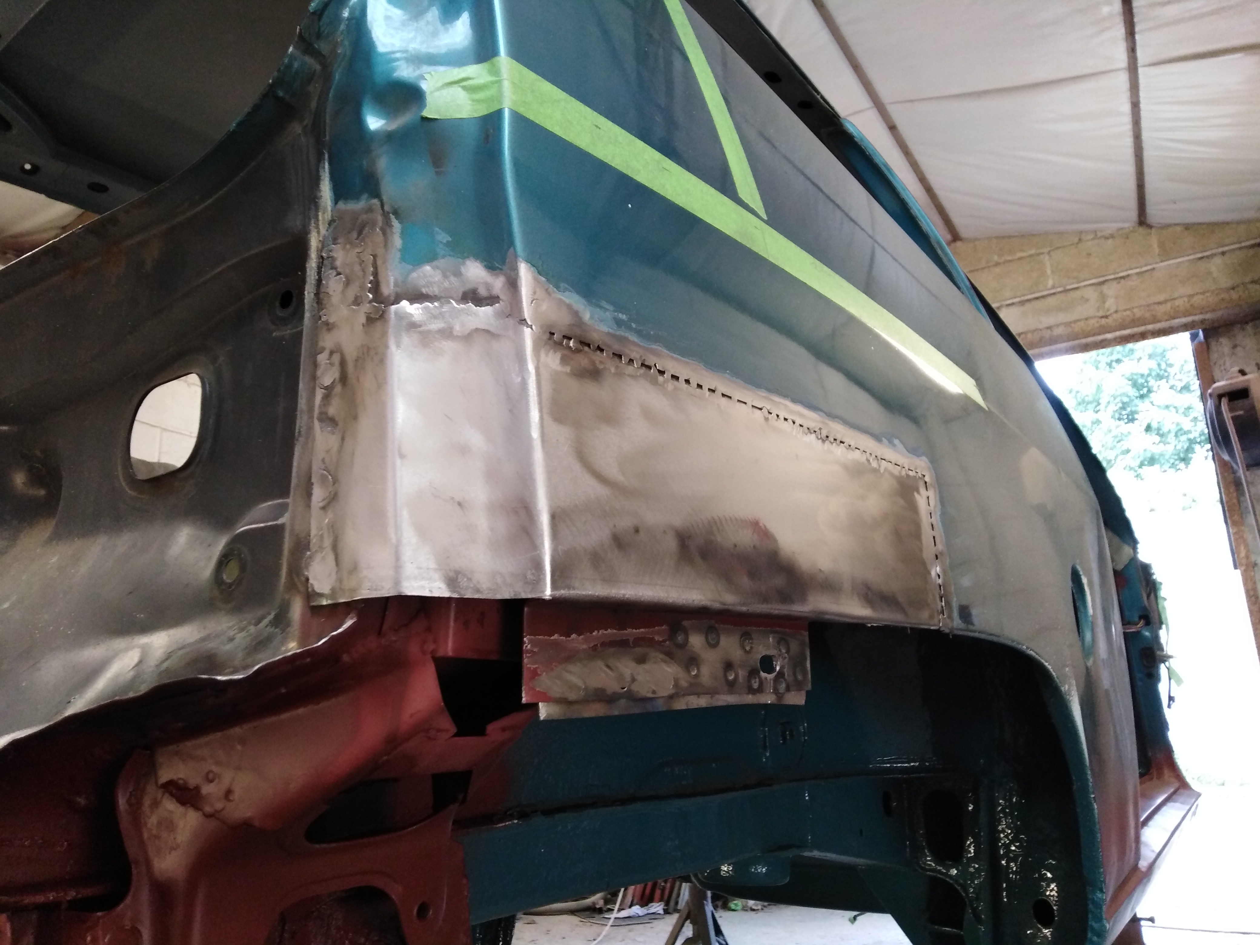

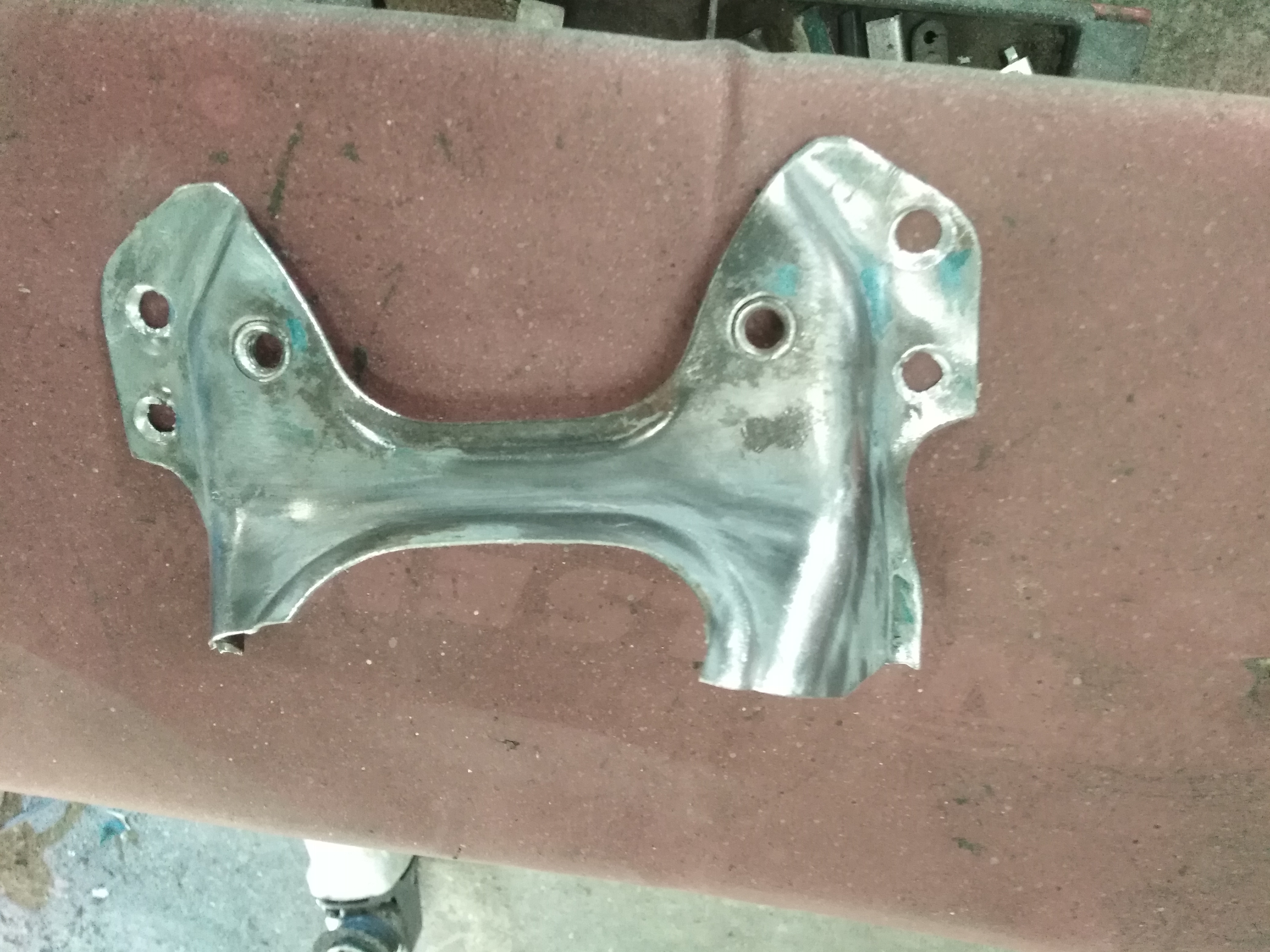

Made a start on the drivers rear quarter today, had to dig through the same amount of layers as the other side before finding solid steel again. But I got there.
Repaired the reinforcer bracket as before, then made and fitted a new inner lower repair section.
The bumper bracket wasn't so good as I mentioned before, only the bottom half was salvageable but at least that was the important bit. Made up some strong sections and spot welded before seam welding them together, this side is also for the towing eye so needs to be strong..

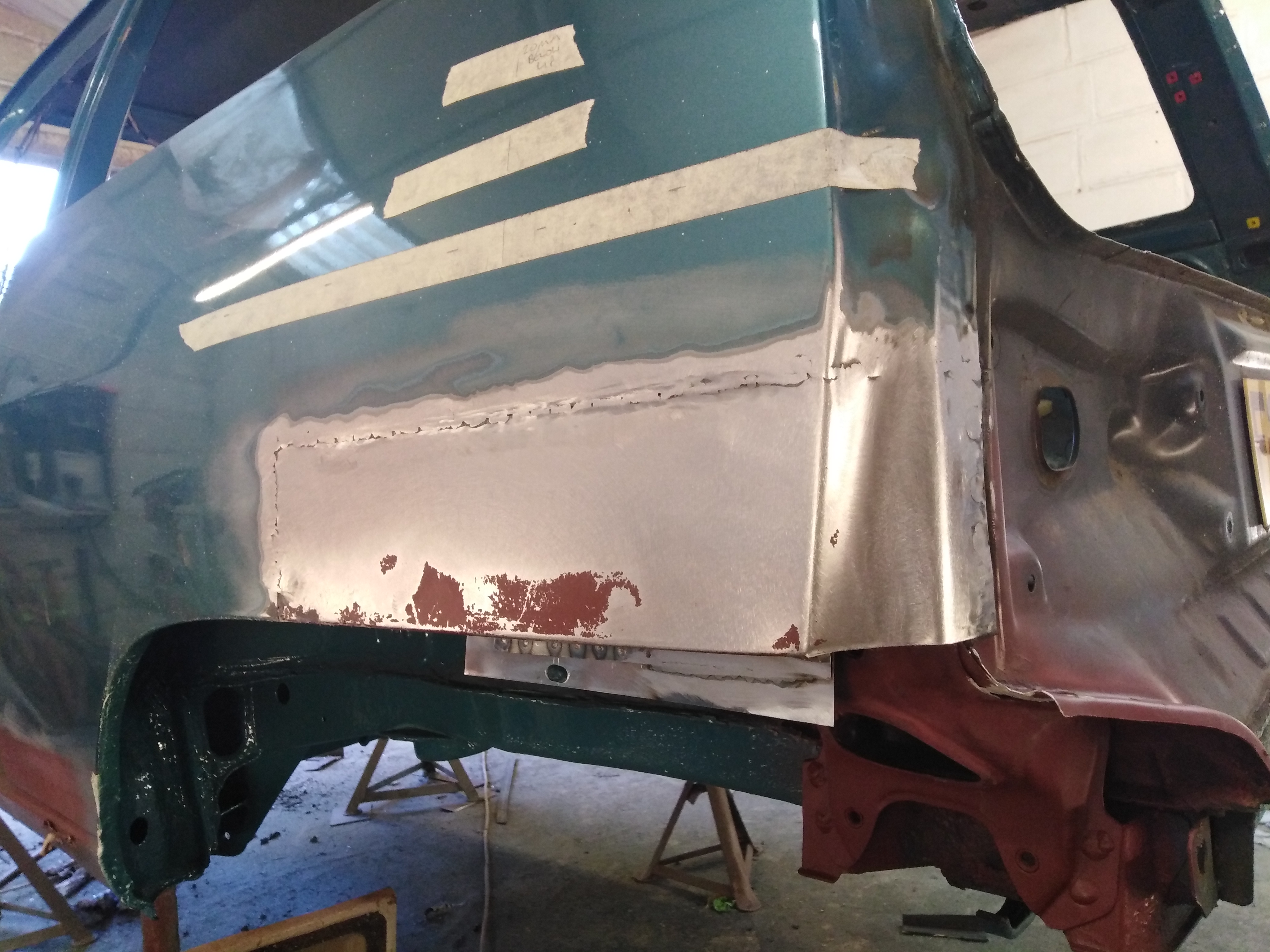

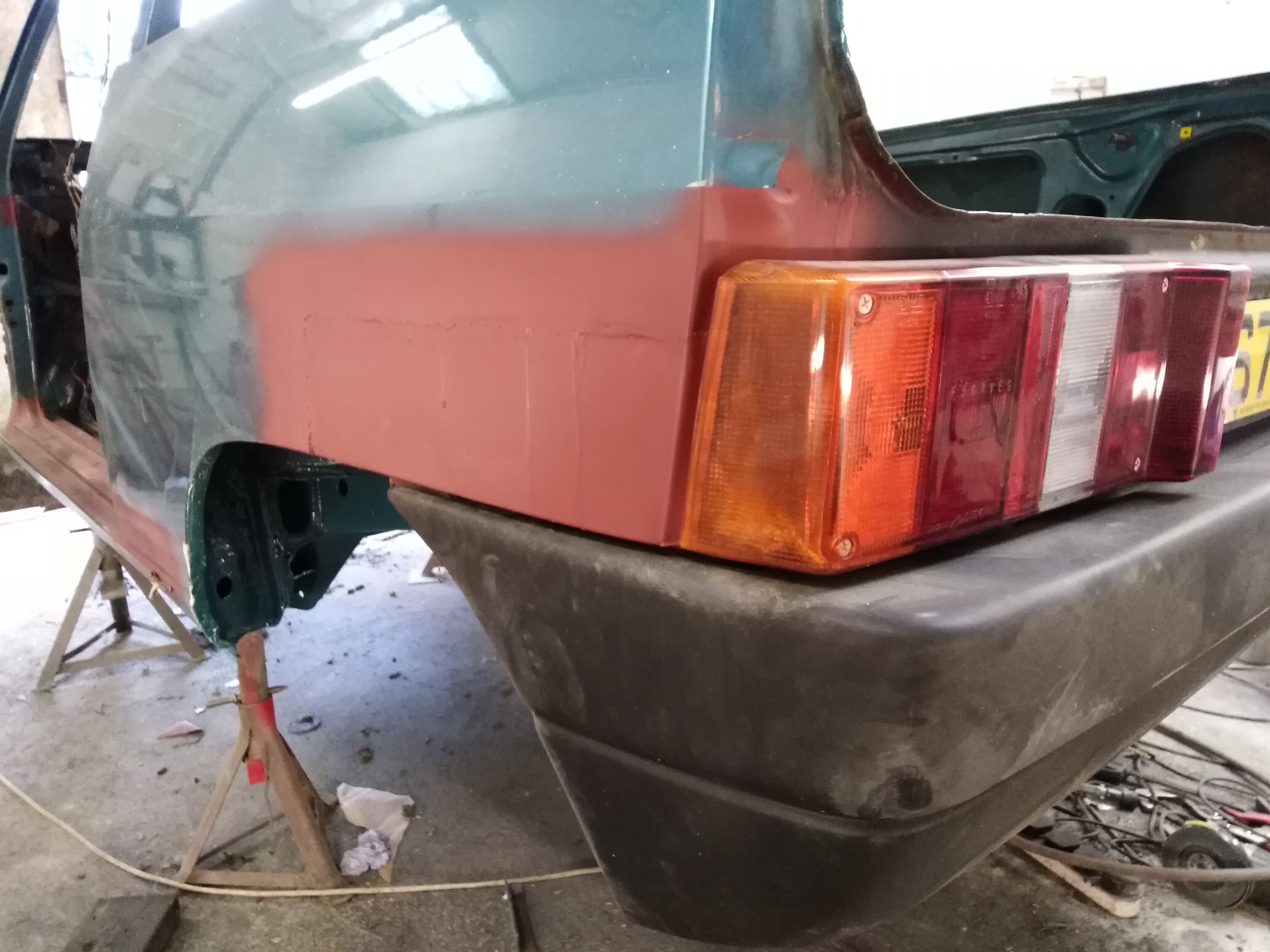

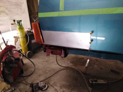

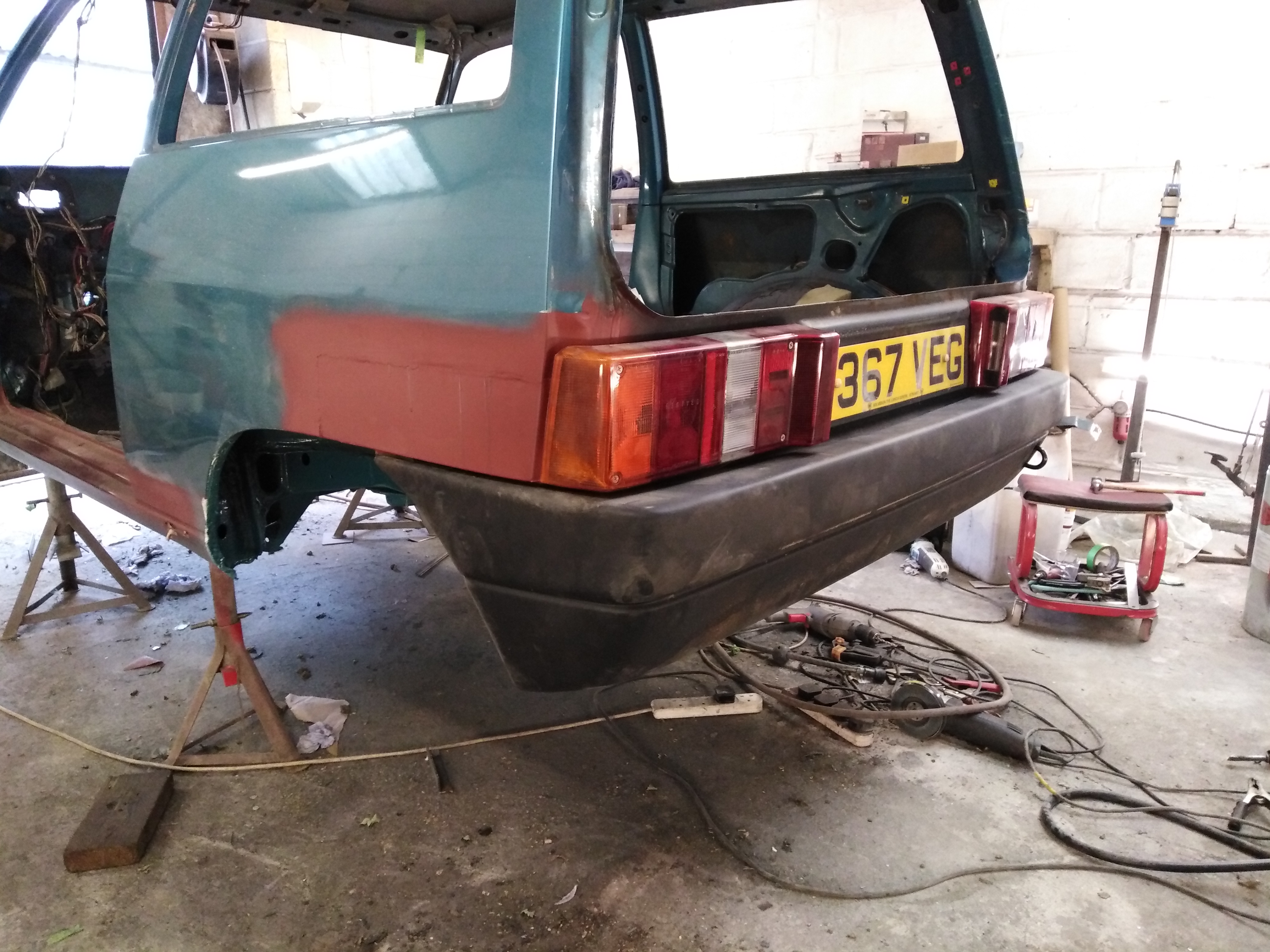

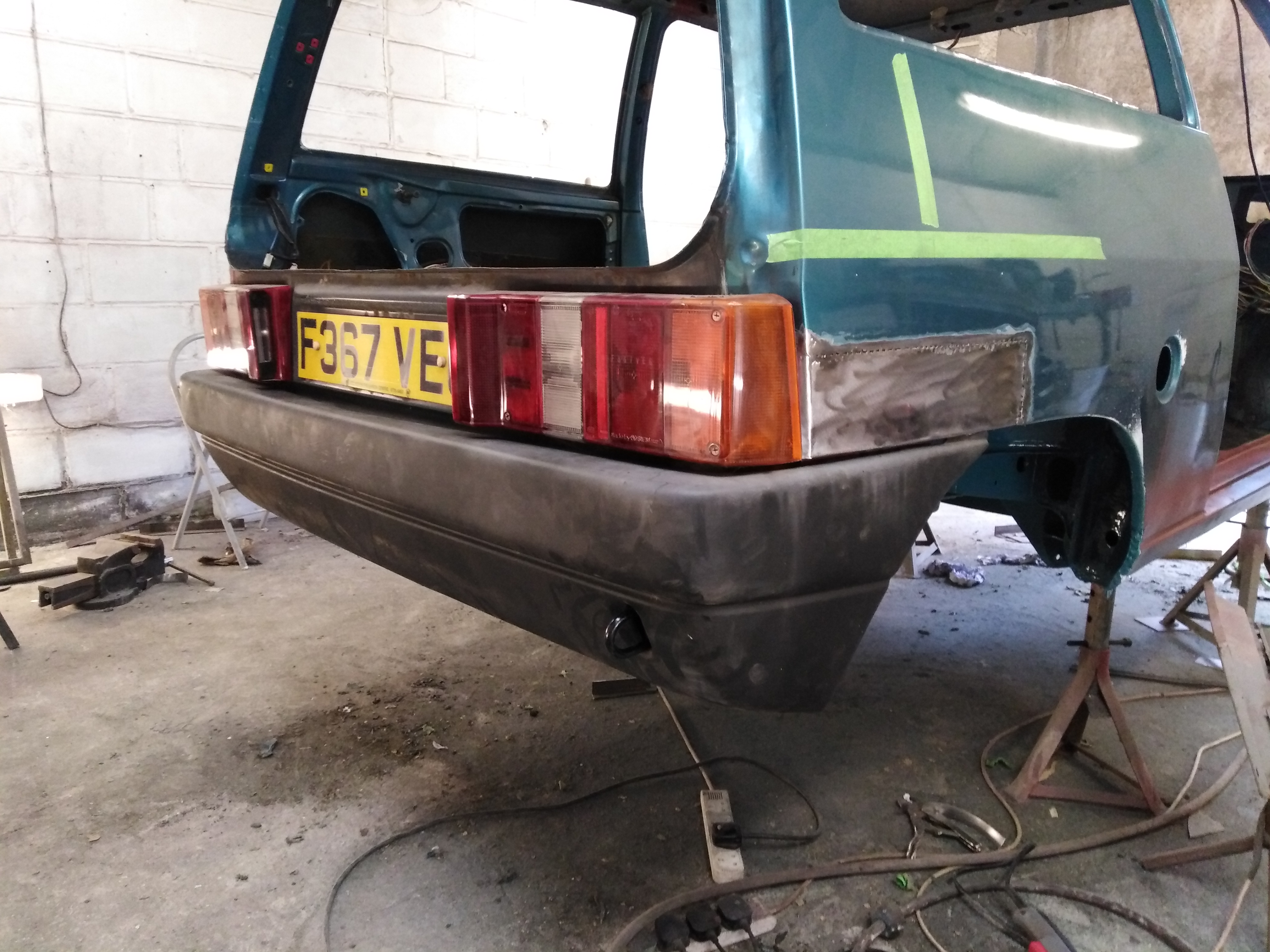

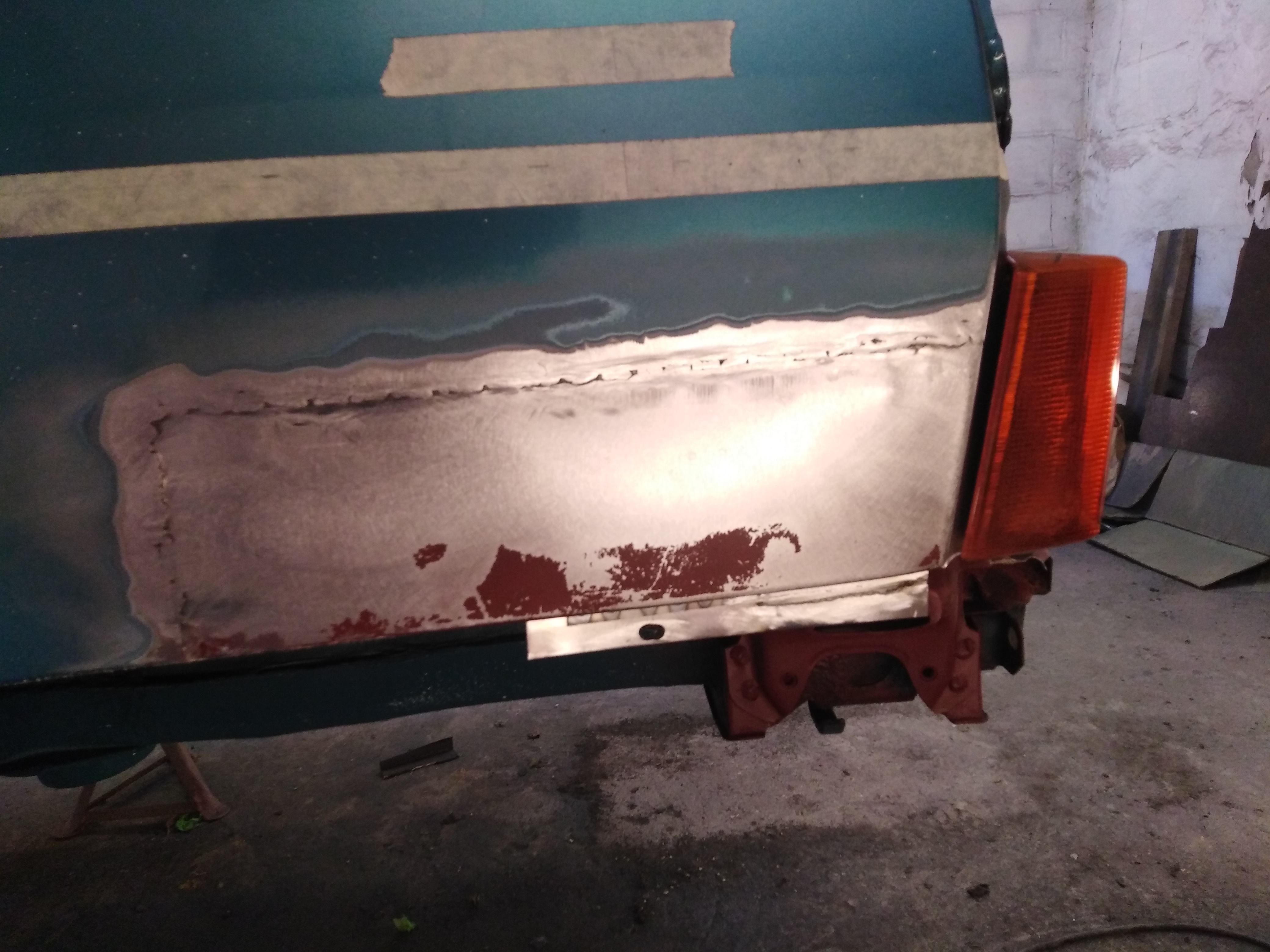

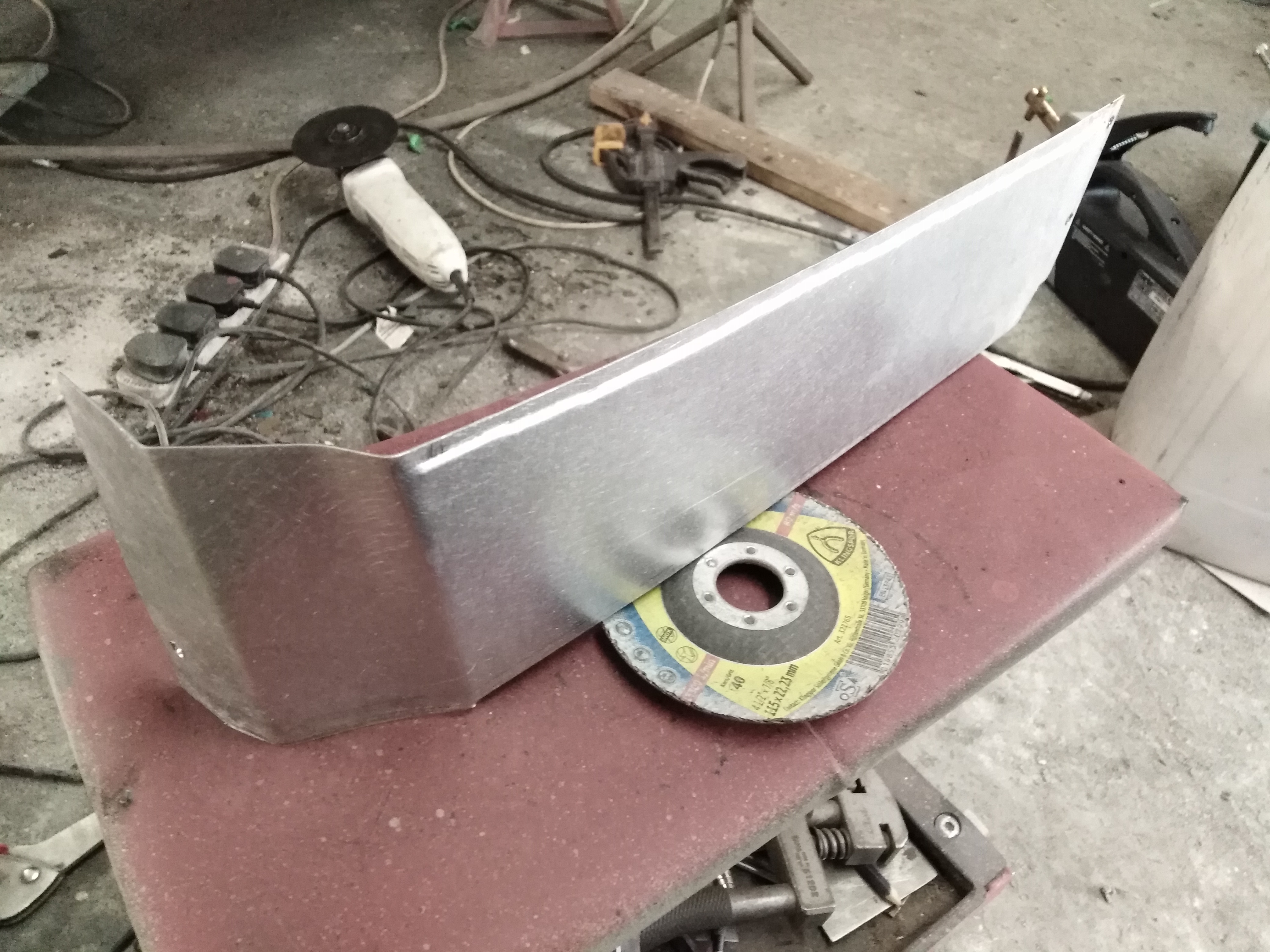

Had time then to make up the outer skin, curved at the bottom as before using the same cardboard template.
Alignment gained using the rear light unit which after all is what needs to be right.
Got tomorrow on the car so I'll make up the inner sections before the outer gets welded into place.
Re: Kev's workshop projects
Inner section repaired, which again was a bit awkward as you need to make a section blind, behind the outer section so it kept having to be taken off and gradually make the inner bits.
Eventually though it all lined up so once that was welded into place the outer skin could go on.
Trial fitting of the bumper and lights came as a relief that it all lined up just nice! All the measuring and template making paid off.
Next visit I get to start the windscreen surround repairs... Should be nice!
Actually it shouldn't be too bad a problem, apart from the section with the vents in, hoping that doesn't stretch down the "fingers"..

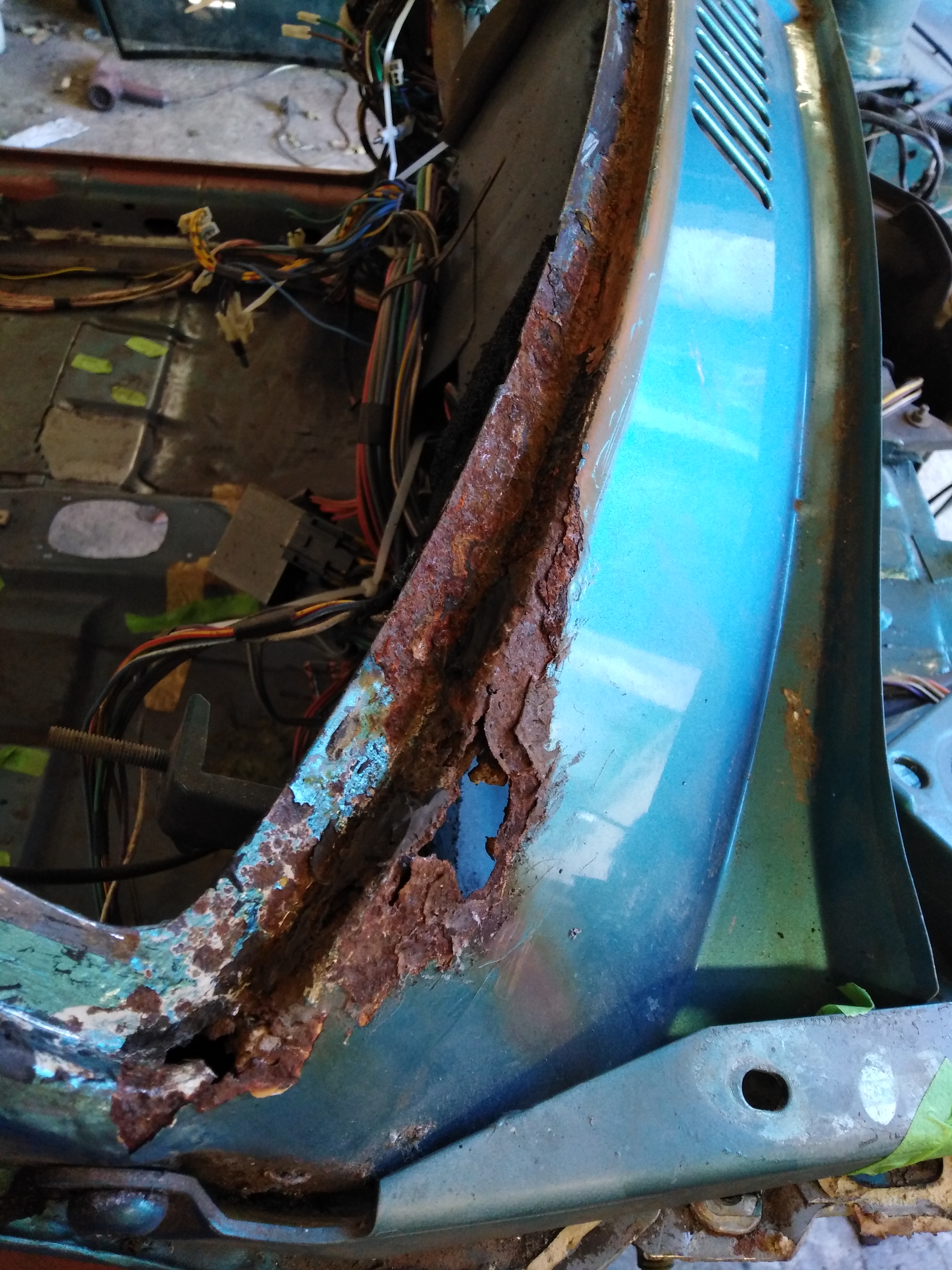

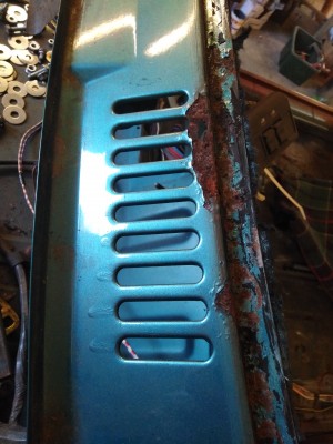

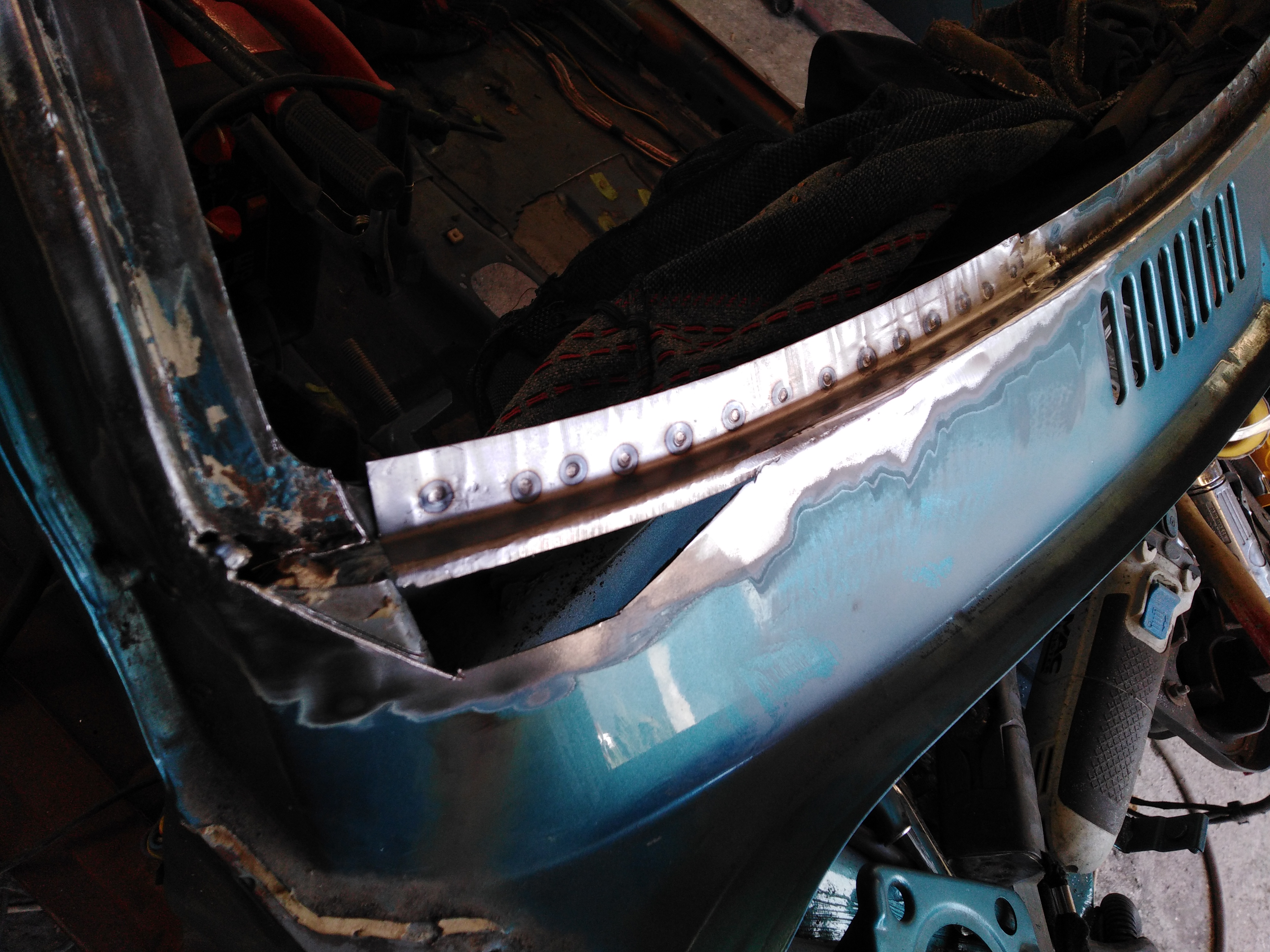

Lowered the car down a bit now so I can get at the windscreen surround.

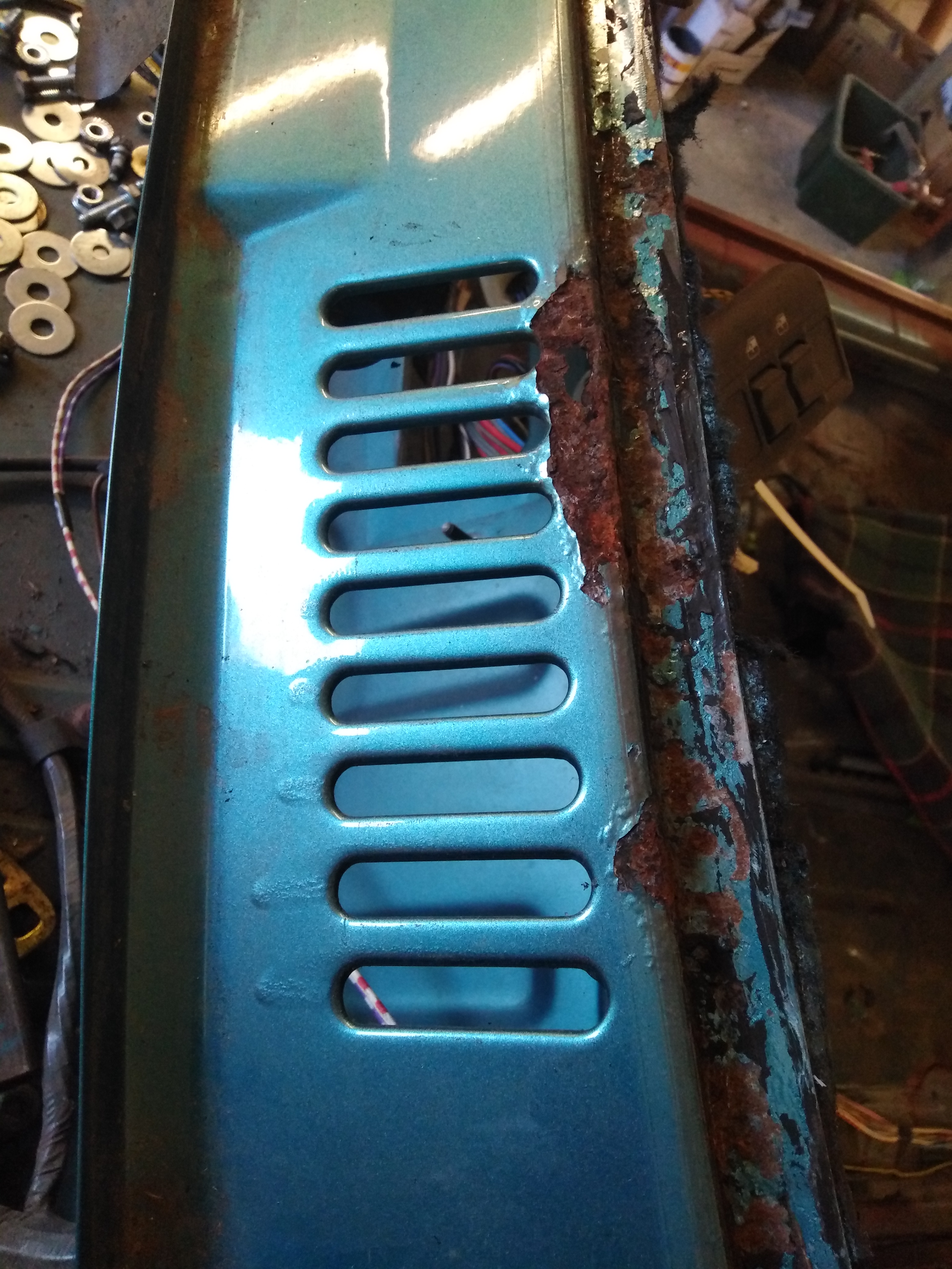

Trying to figure out how to make a repair section where the vents are, tried a few ideas but none successful enough, have come up with a new plan to make another jig.. Another time.
With that in hand I started on the easier section, relatively speaking. The 'screen flange section curves in a couple of directions so not a simple folded repair as it all needed to be shaped so more sections to allow for manipulation.
Looked a bit grotty even before the' screen came out. I'd put some silicon in there in an attempt to keep rainwater at bay..
Section of rusty bit cut away, new repair piece awaiting welding.
Then infill the triangular hole and a bit around the bottom corner, that's one section done!

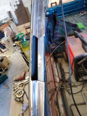

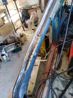

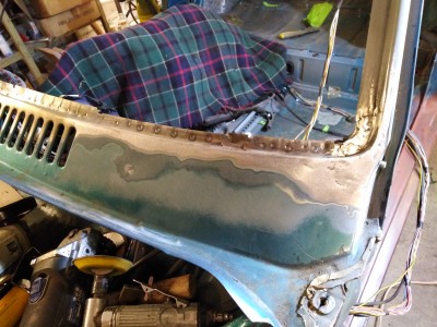

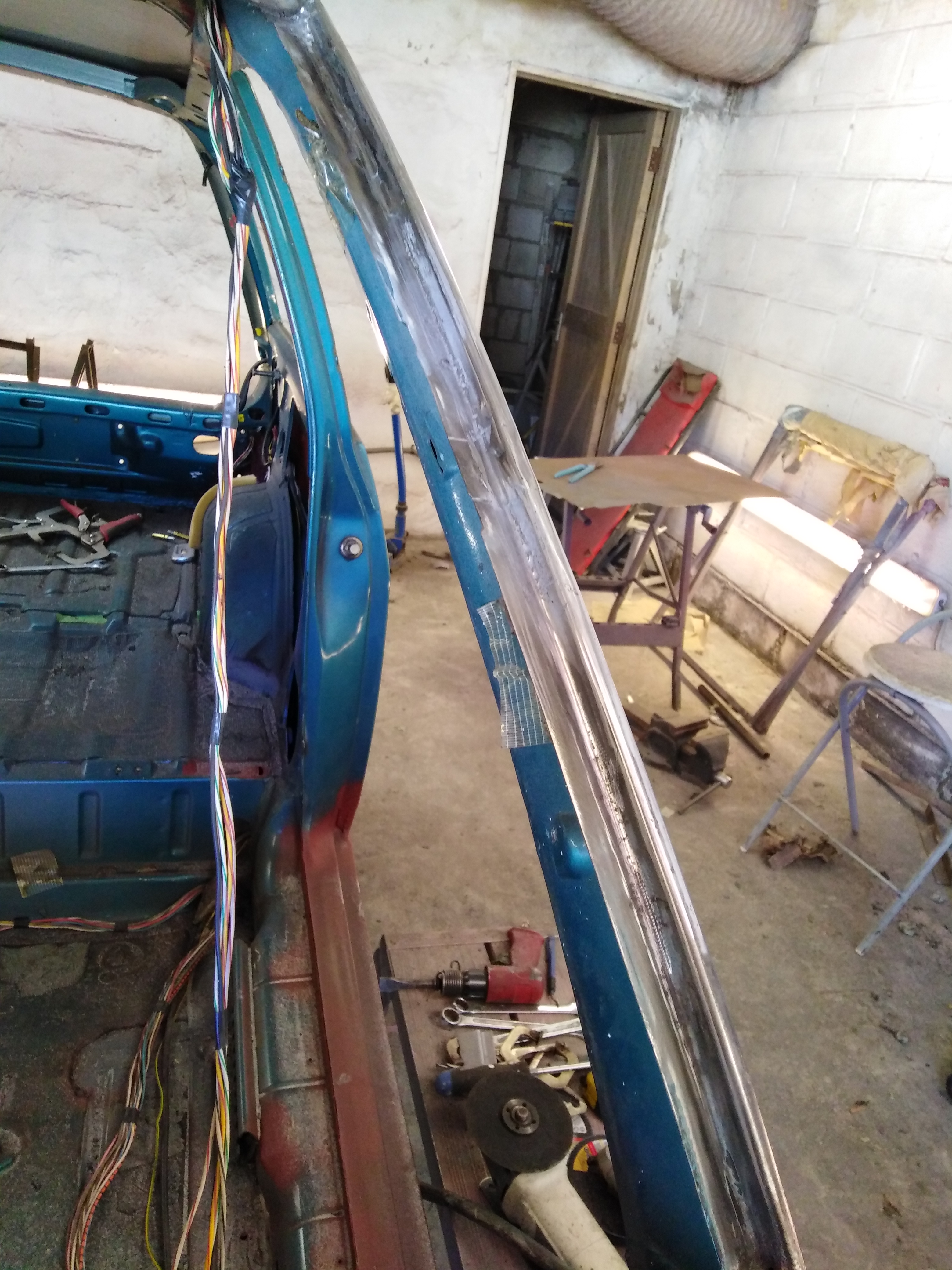

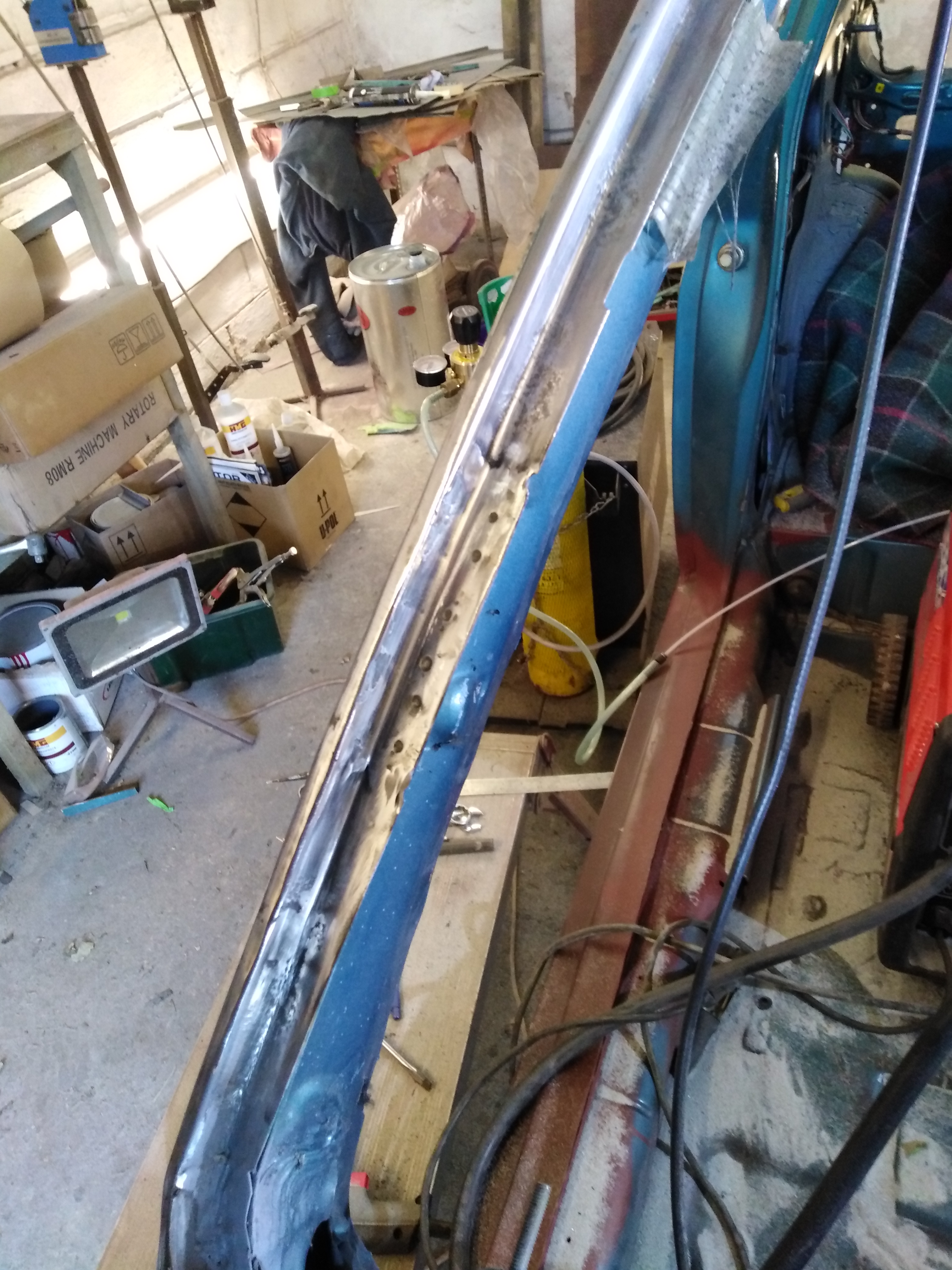

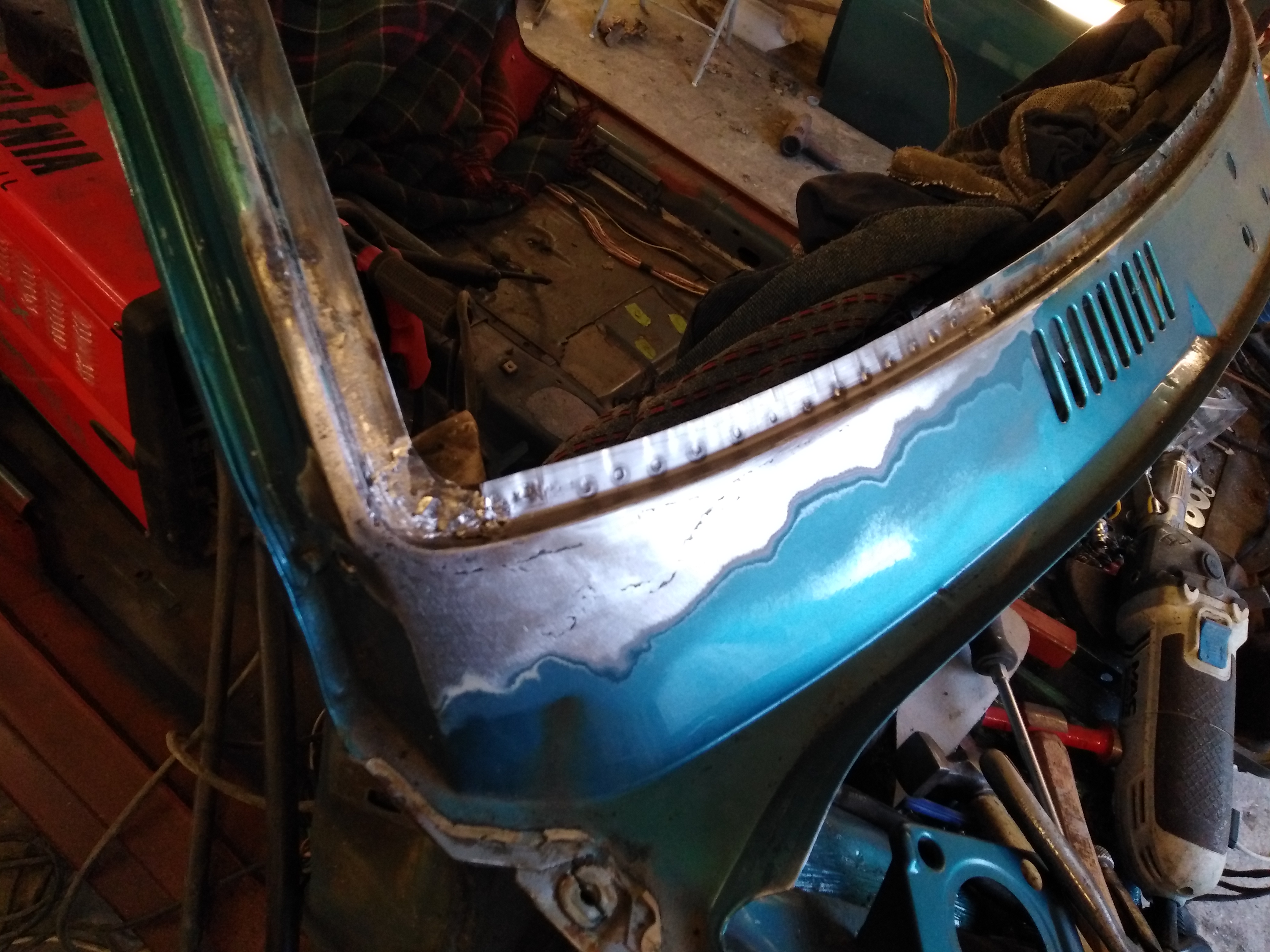

Started on my trip around the windscreen surround today, drivers side pillar first job.
Most of it cleaned up pretty well, knotted wheel and grit blaster did most of the work. Small bits to weld so a decent result really.
All welded up, loving my spot welder
Top section was god all the way across after all the cleaning, bingo
Passenger pillar wasn't too bad, just a couple of bits needed welding.
Just the passneger bottom corner then the bit around the vent...

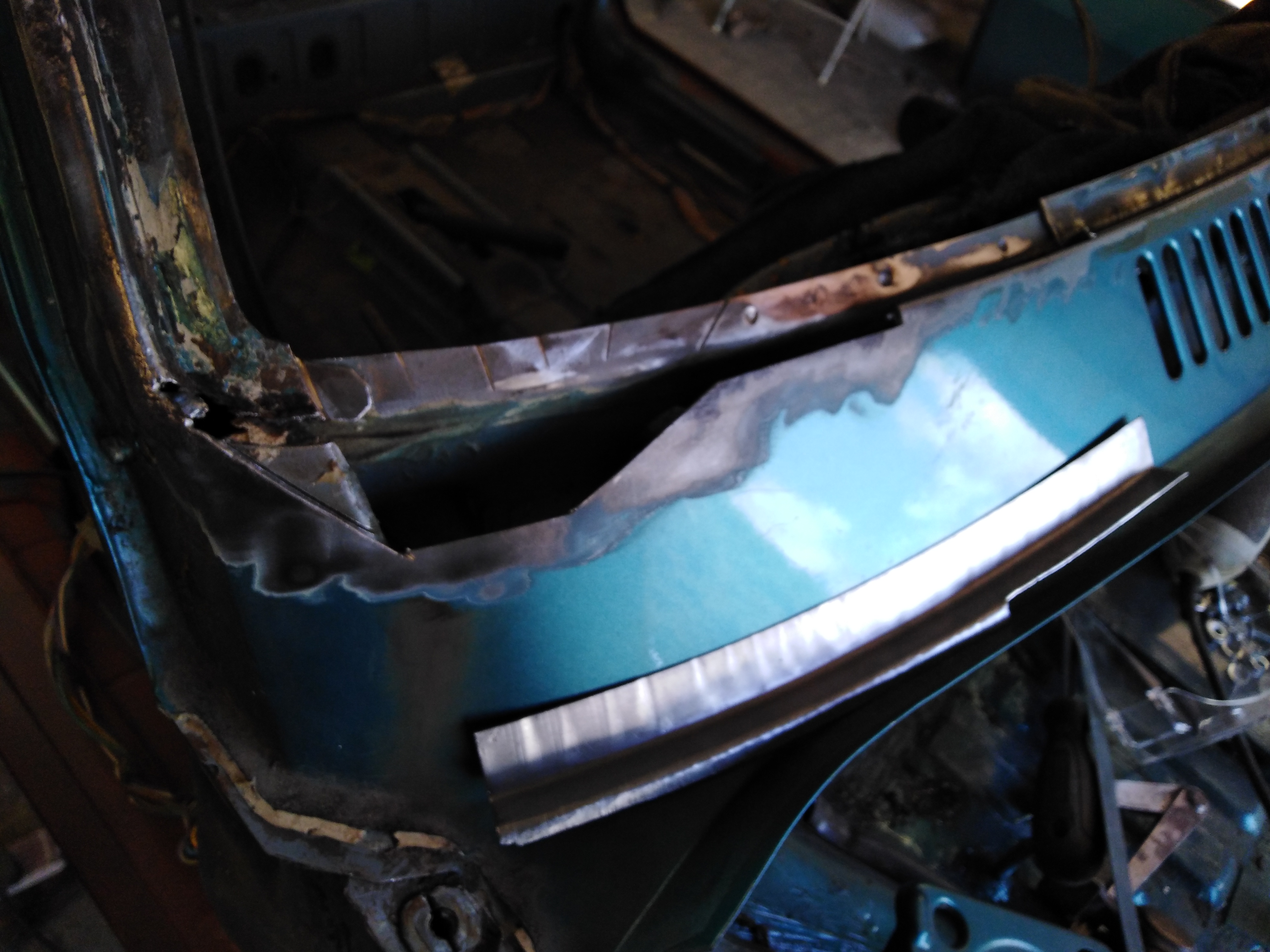

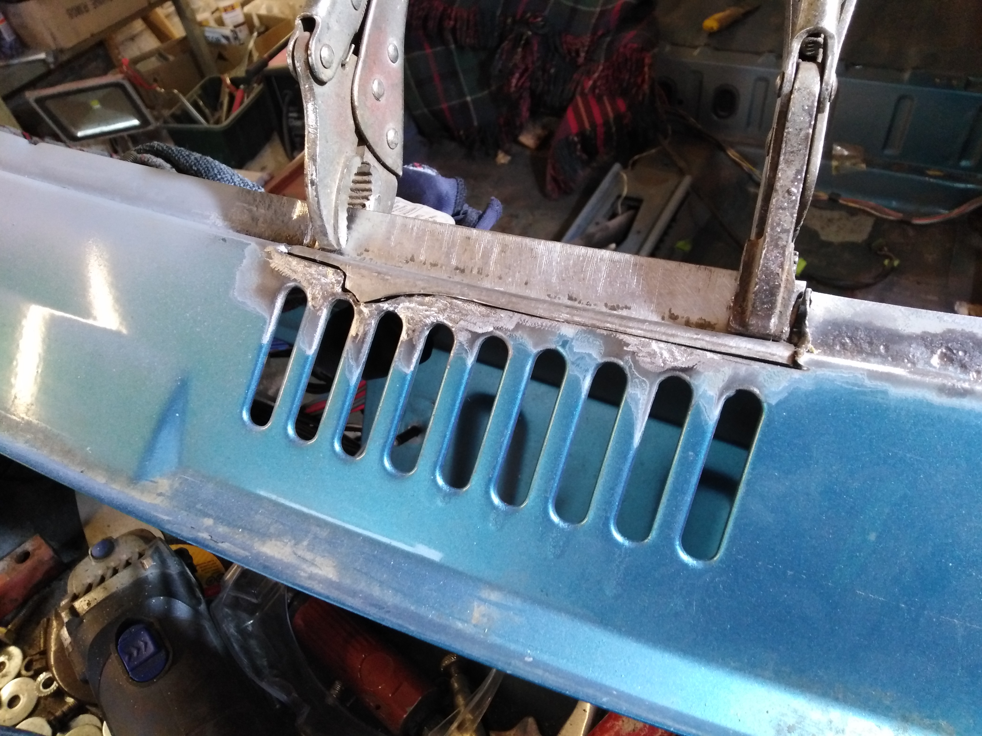

I'd tried making a jig to make a section with the slots, almost works and on reflection I know how I could make it work by trapping the steel between two jigs rather than trying to form it using just an underneath jig..
All academic now, had to grow a pair and just get on with it

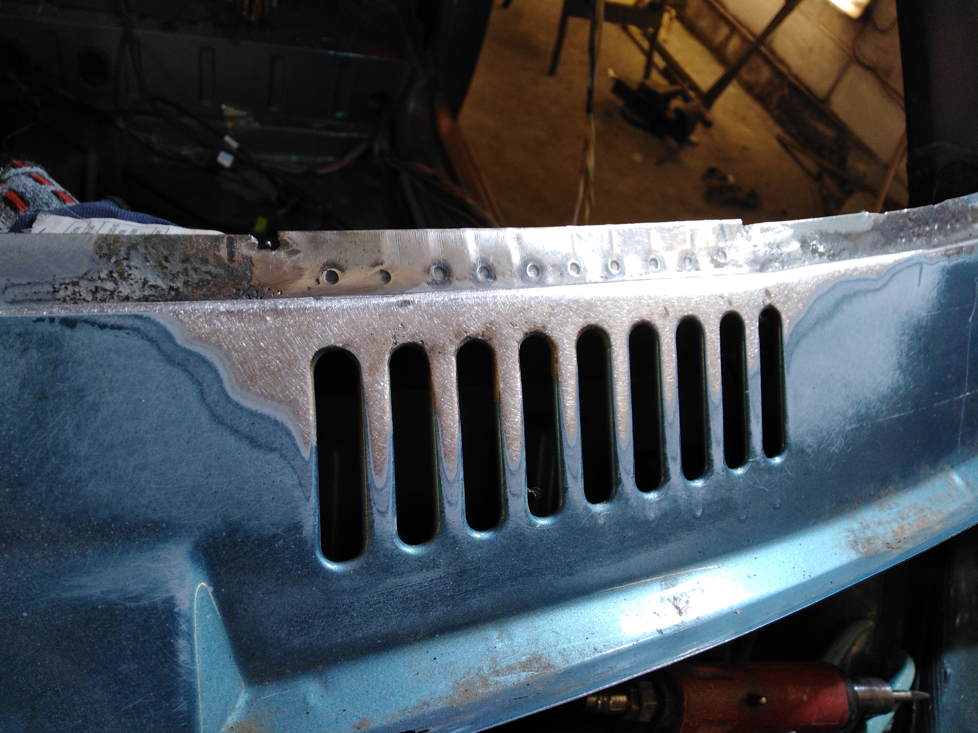

Cleaned the panel back as far as I dared whilst keeping the shape of the vents, thankfully the rust stopped short of going in the curves but didn't leave a lot of material to weld to.
Plate made up with the necessary curves to follow the curved screen flange in both directions, not easy in a patch that is folded twice as the central piece needed to curve, but it got manipulated enough in the end.
Then the shape cut to match the remaining piece of bulkhead..

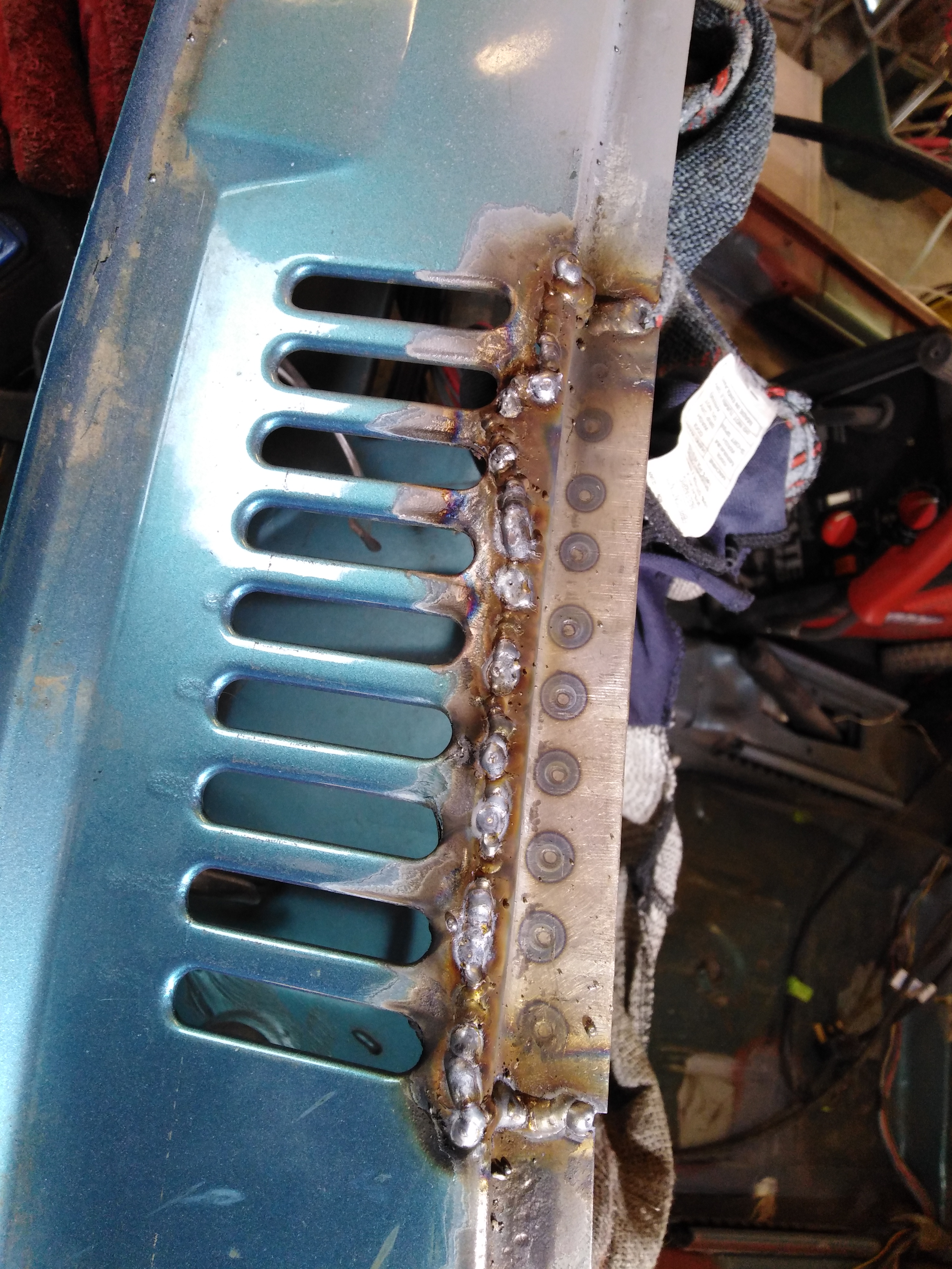

Welding was very gently done in small dabs, overlaid to allow it to melt down into the joint.
Equally careful grinding back as all too easy to take away the surrounding material, thin areas got re-welded.

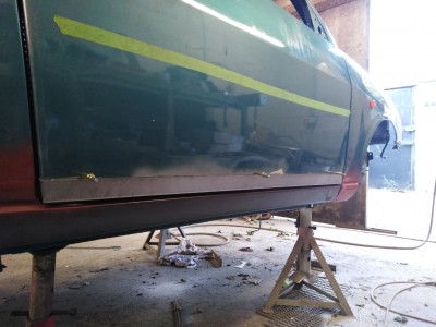

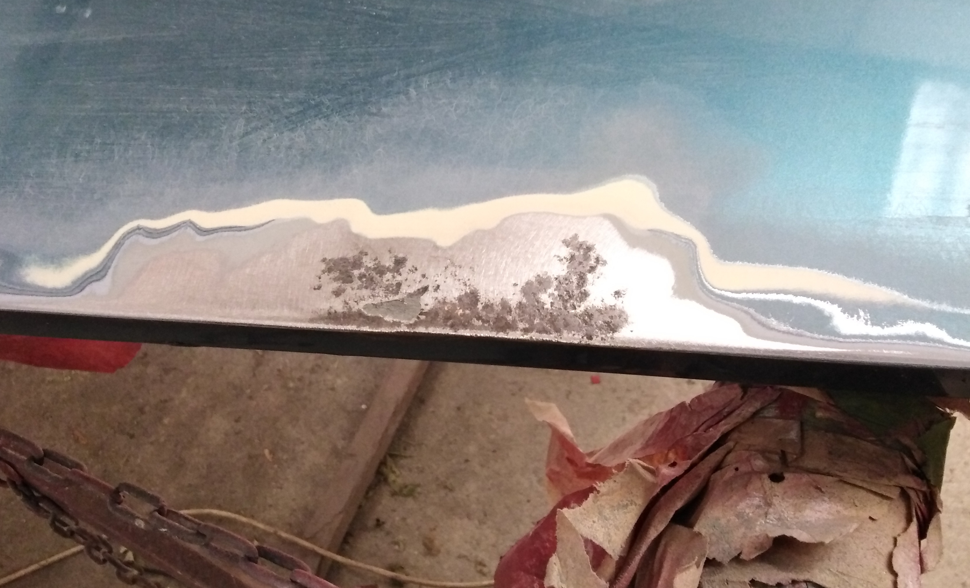

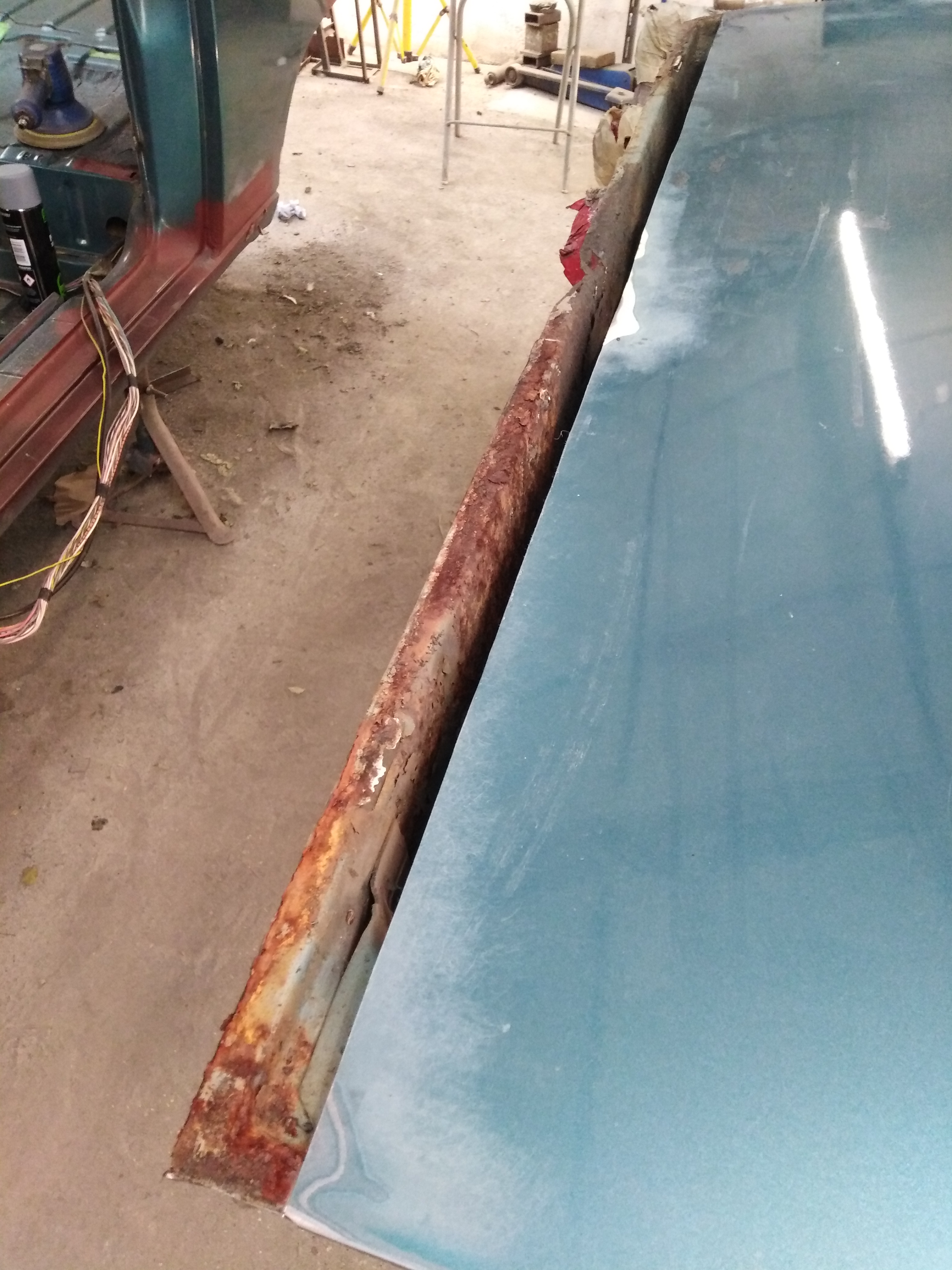

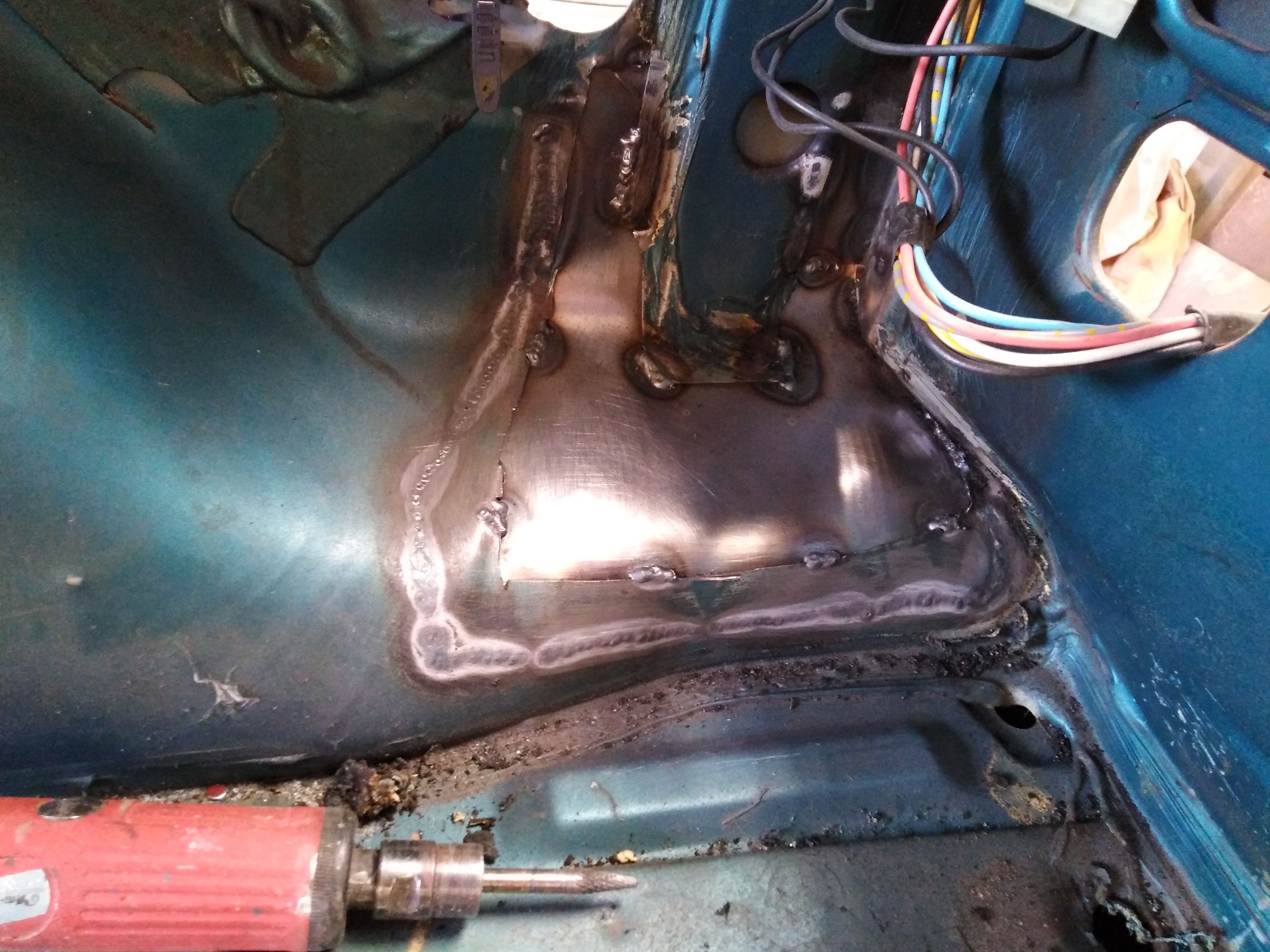

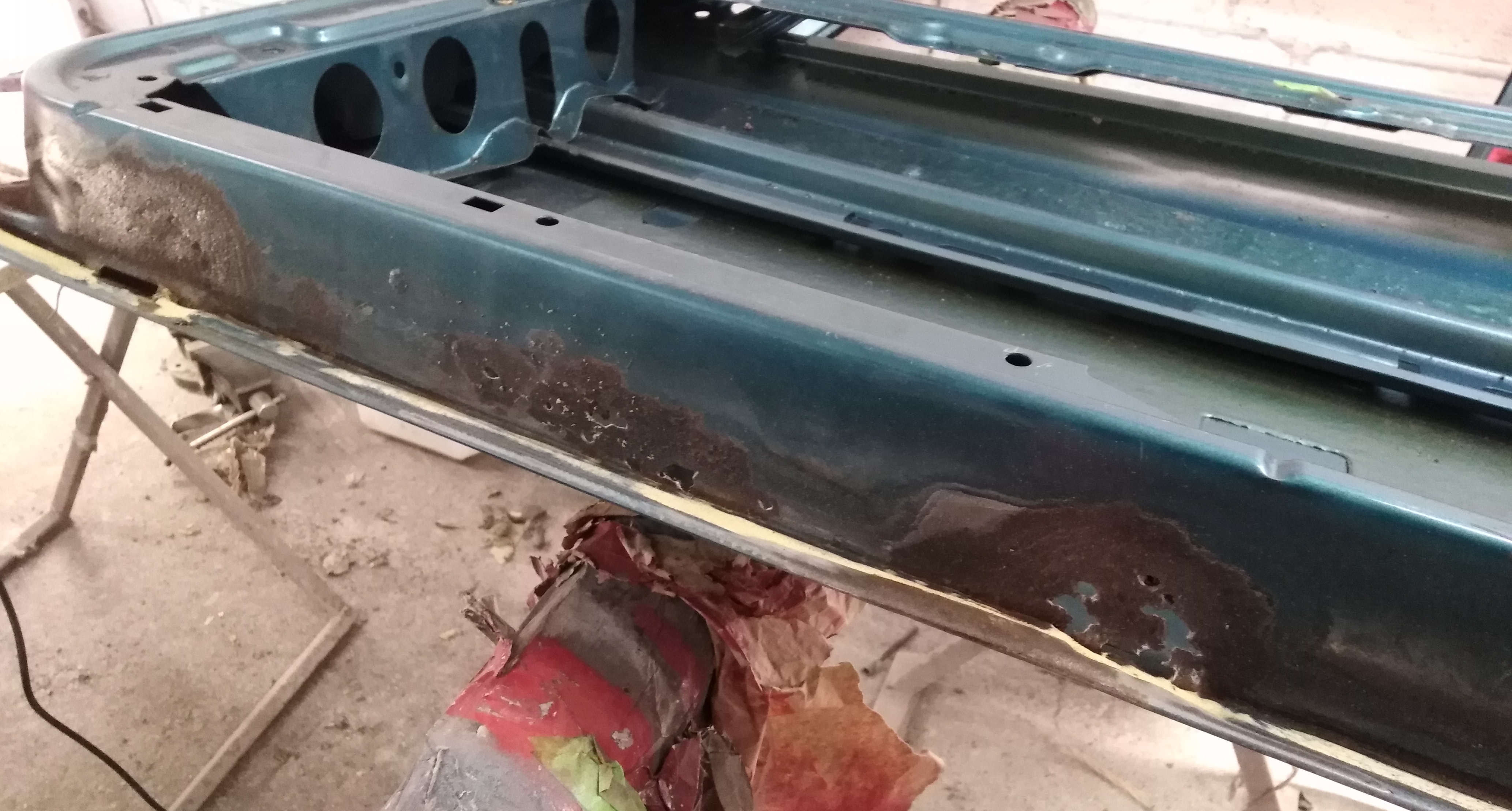

Drivers door had a scab on the outside and some rust on the bottom plate, nothing too serious you'd think
On looking inside the door though it was clear the bottom plate rust carried on into the seam, the outer section peeled back confirmed that.. Nothing for it but to cut the full length of the outer skin off.

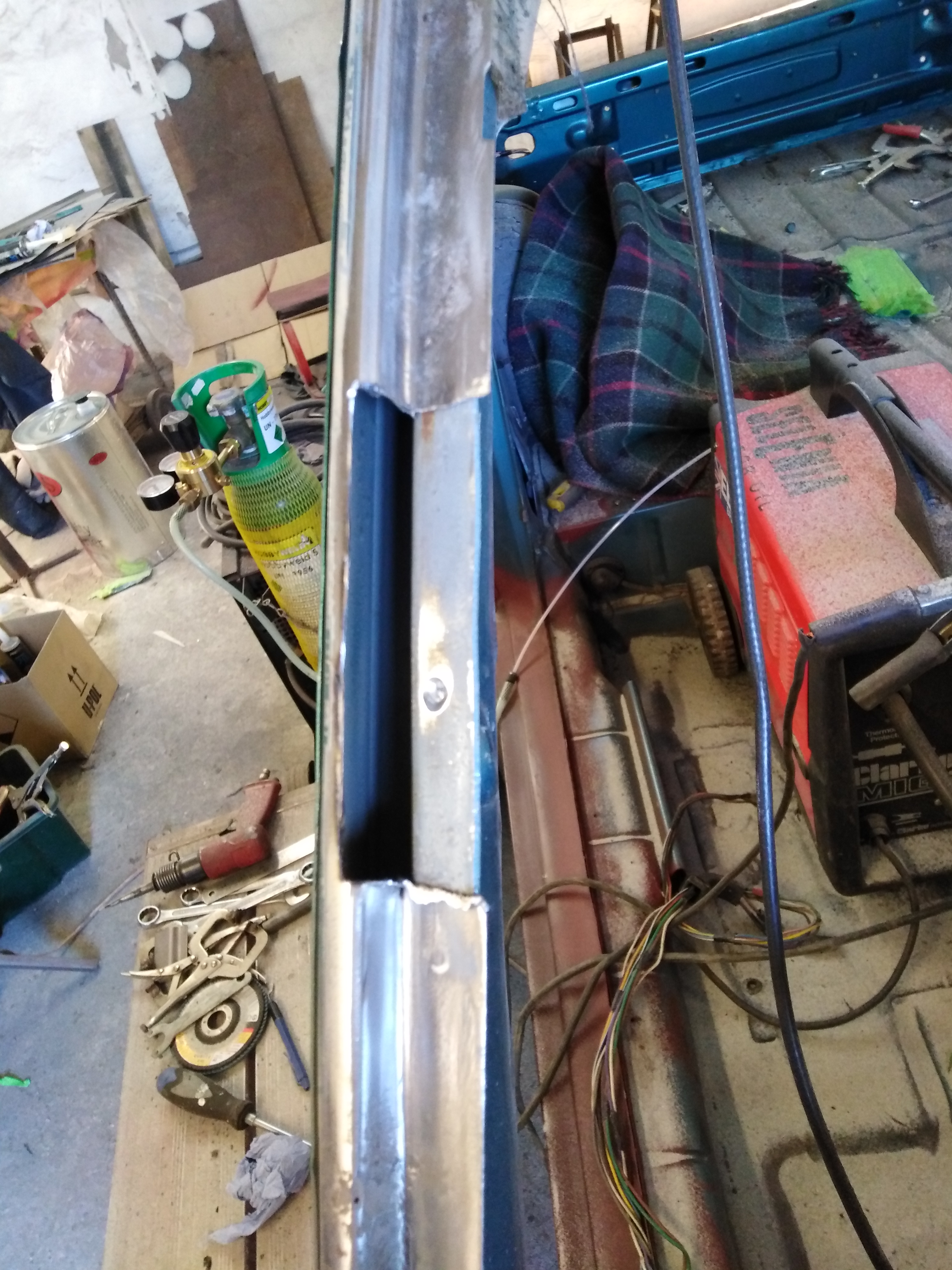

Bottom plate repaired including further around the forward edge up towards the door card aperture.
Then the new outer skin repair being lined up with the door and wing back on the car so it can be fitted in the correct place, located with clico fasteners so when the door comes off for fitting the plate the location is easily repeated.
All welded into place to the skin and folded with sealant along the bottom edge.

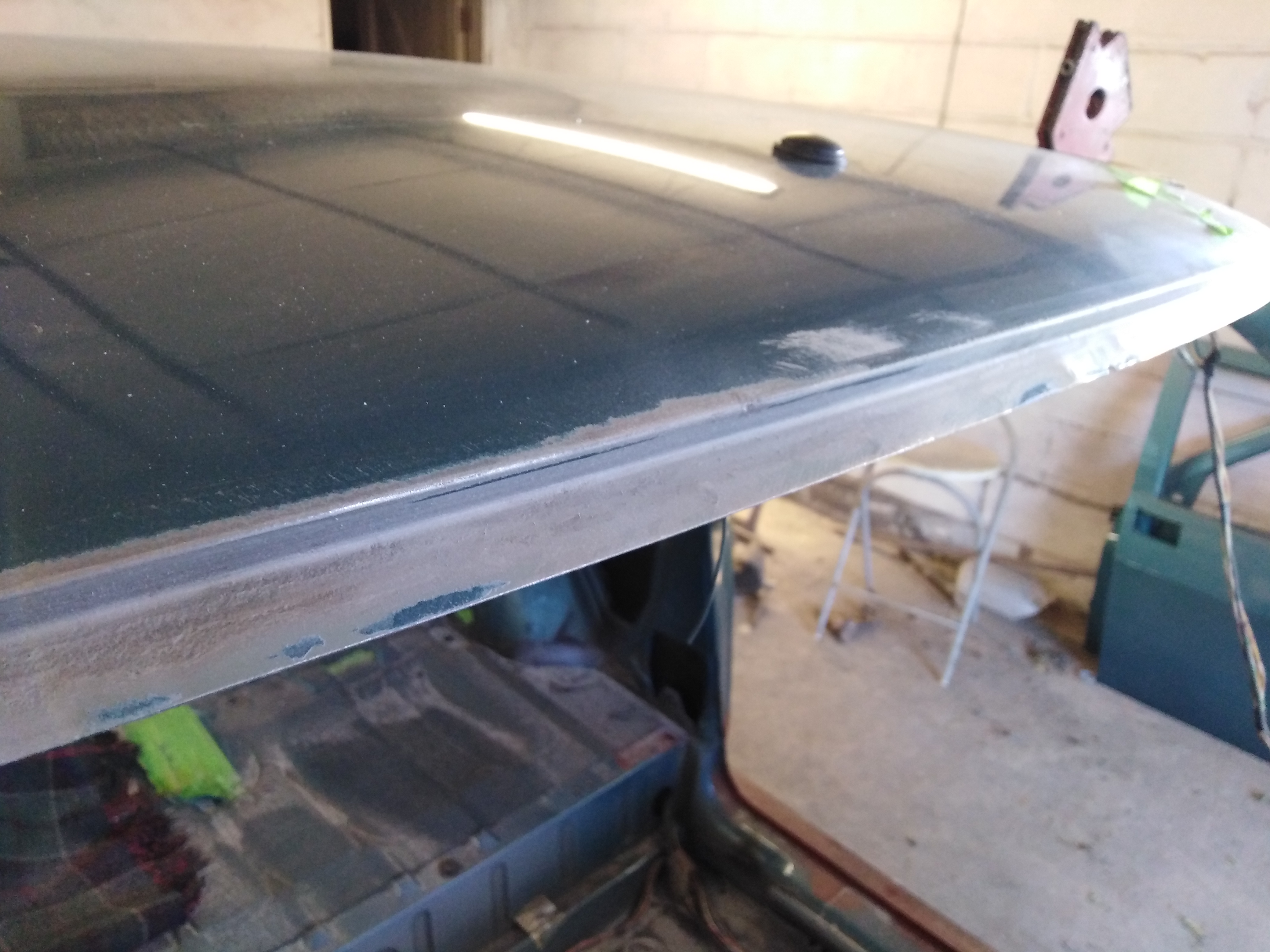

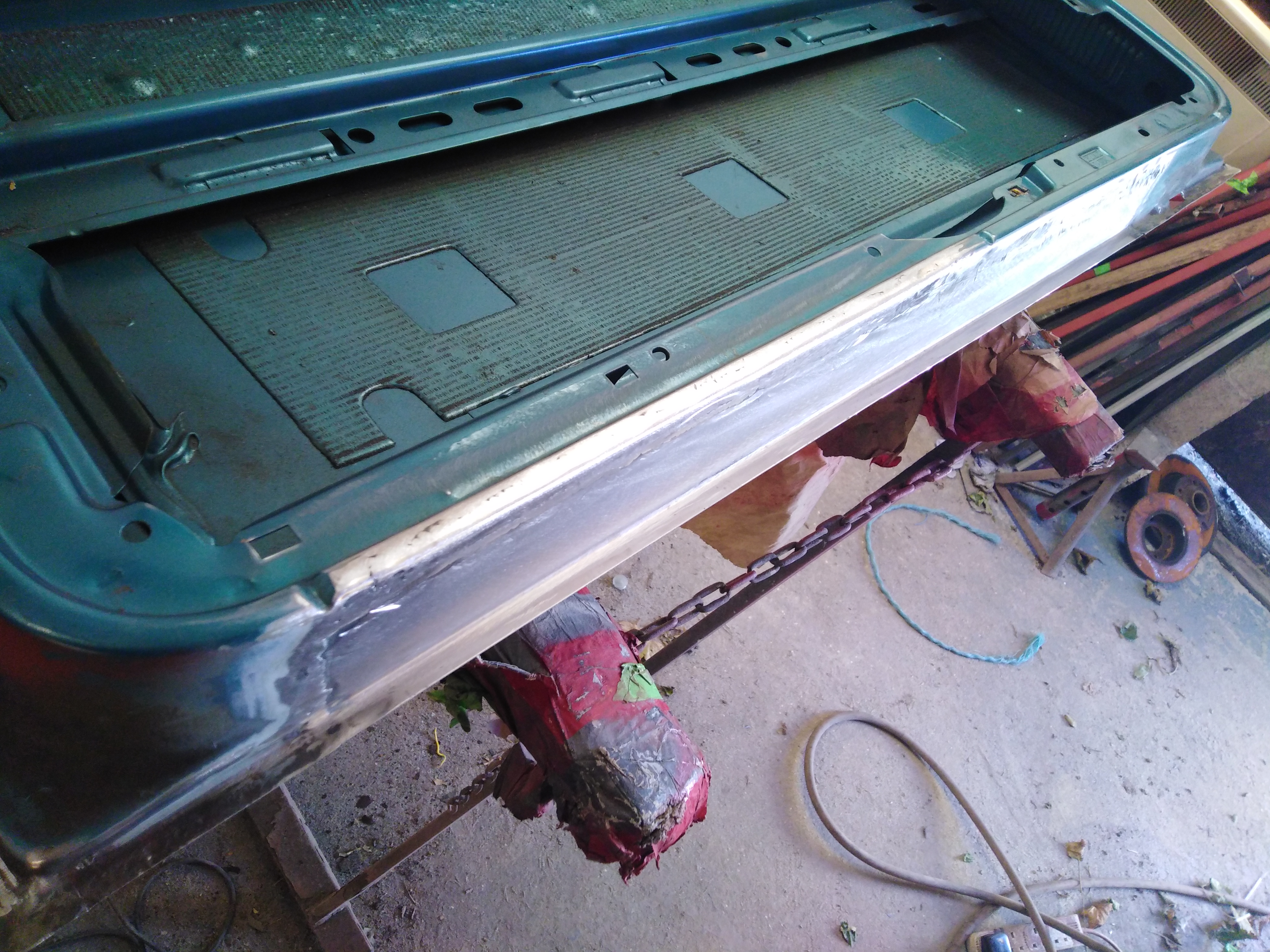

Getting to the point where the welder can have a rest now, think there's a bit on the hatch but that's the last...

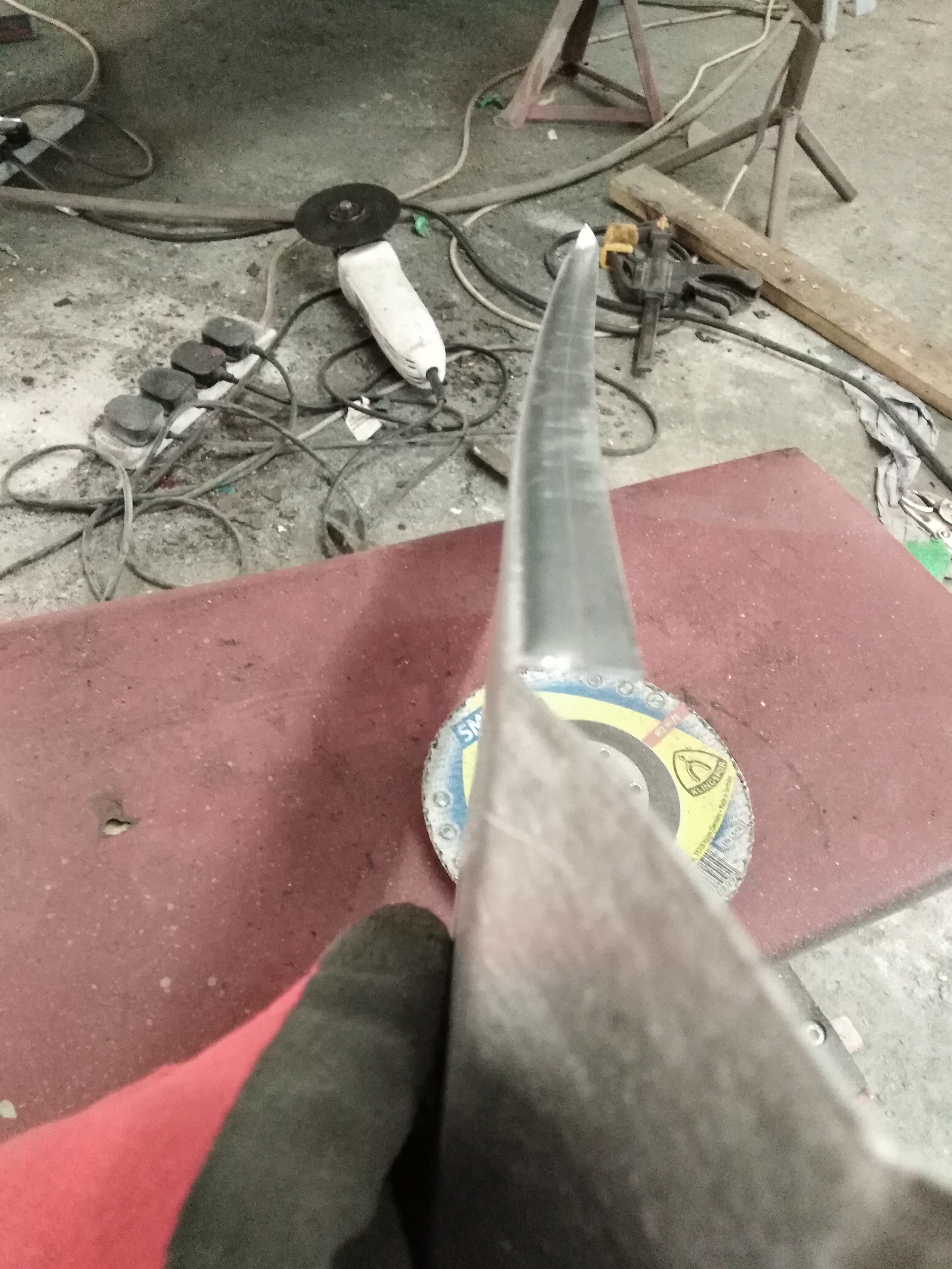

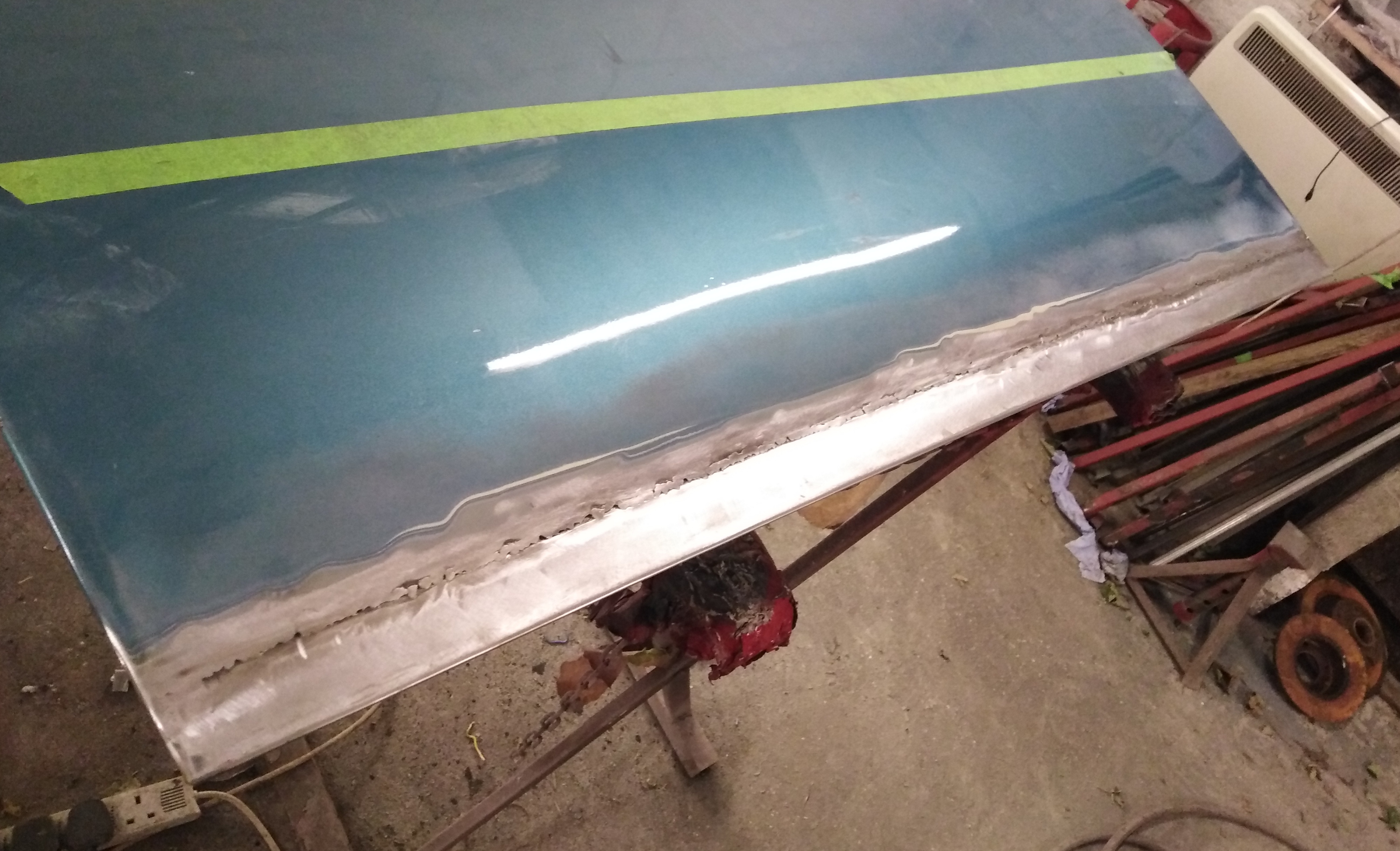

Looks good Kev, - how do you weld the full length of the door without it buckling ??
John.
John.
I dont'! It distorts even just using small tacks, just have to accept it and try and straighten it out as best you can.
On the fabrication course I went on a few years back I asked the guy how he'd stop distortion when doing door bottom repairs. He answered by saying he wouldn't ever repair a door bottom as distortion is impossible to prevent, he would make a whole new door skin instead!
One solution pointed out to me by my friend Chris whose Dad restores Capris' is to use a spot welder on the joggled flange which I agreed would be much more resistant to warping and potentially a stronger join as appose to welding one edge. I need to get some different arms for mine to allow cranked finger type arms to get into the tight spaces.
- Posts: 804

Outside face of the weld I put a thin layer of fibre glass filler as its waterproof before using regular body filler for shaping.
Important bit is preventing moisture getting into the repair in the future.
