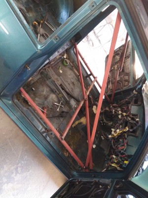

I started to chop the outer sill off at home a while back, thought it wouldn't take long. But of course the joint to the floor wasn't very good and it needed more repairs behind the wing bottom, I wasn't going to rush and lash it up so it sat at home until it could be done right.
Now it's at the unit I came to the conclusion that I may as well do it fully properly now rather than just the sills, I'm not that keen on welding upside down either so it's getting stripped out fully so I can get it on the tilter frame and have it upside down and at all angles.
Of course that means everything out, engine and interior etc..
Once I'd tidied the unit up today (amazing how messy the unit gets, only me in there so nobody else to blame...) then the first task wa sto brace the body shell as it has a fair but of flex, more than I've seen in other cars. When jacking up one corner the doors became out of line and awkward to open and shut. What is vital is to have the car in a position of structural solidity so that when it's welded it is in the right position! With braces welded across the door opening, laterally and diagonally but the crucial one from the bottom of the A post up to the top of the B post then the shell was solid again. You can jack it up behind the front wheel now, same side rear wheel off the ground too and the doors still open and close lovely. Now once the outer sills are cut off the car will keep its shape.
With the car now sturdy the work on stripping things out could carry on. A few bits off but as ever 10 hour days never seem to be enough. Engine and gearbox out in the morning hopefully then back axle and fuel tank, can then set about seeing how to attach the frames each end.
A few other bits to come off, rear hatch and front 'screen for example but the effort will be worth it when I start welding it stood up 8-)

I did manage to get the car attached to the tilter on Thursday, dropped the ball a bit by greasing the pivots on the frame as they'd gone rusty, thought it'd help it rotate smooth only for it to want to tip sideways then belly up! Not helped by the front screen still in which has over balanced it making it slightly top heavy.
This afternoon by the time I could get back to the car, first task to come up with a solution to the kamikaze car, stop it playing dead all the time.
Solution I have come up with was to weld a few pieces of box to the frame
This then allows me to have a slightly smaller, tight fitting piece of box as a peg which can be fitted as a stopper, frame goes around and stops safely at the desired angle of attack.
