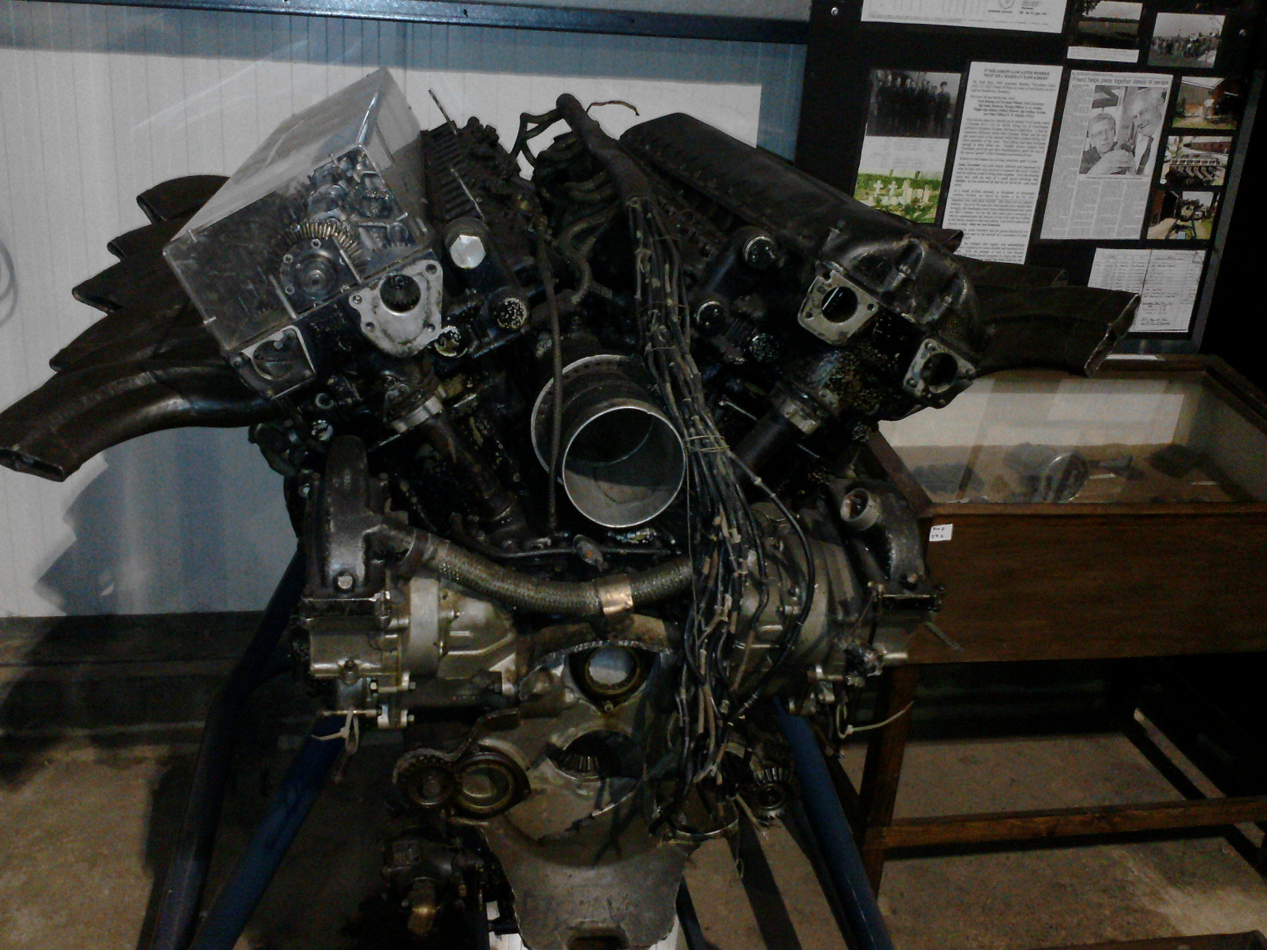

Re: Kev's workshop projects
Of course it wasn't the merlin design
That has a central overhead cam operating rocker arms operating the 4 valve heads..
The engine I was thinking of is this one, can't remember which manufacturer but seem to think German so probably messerschmitt or something

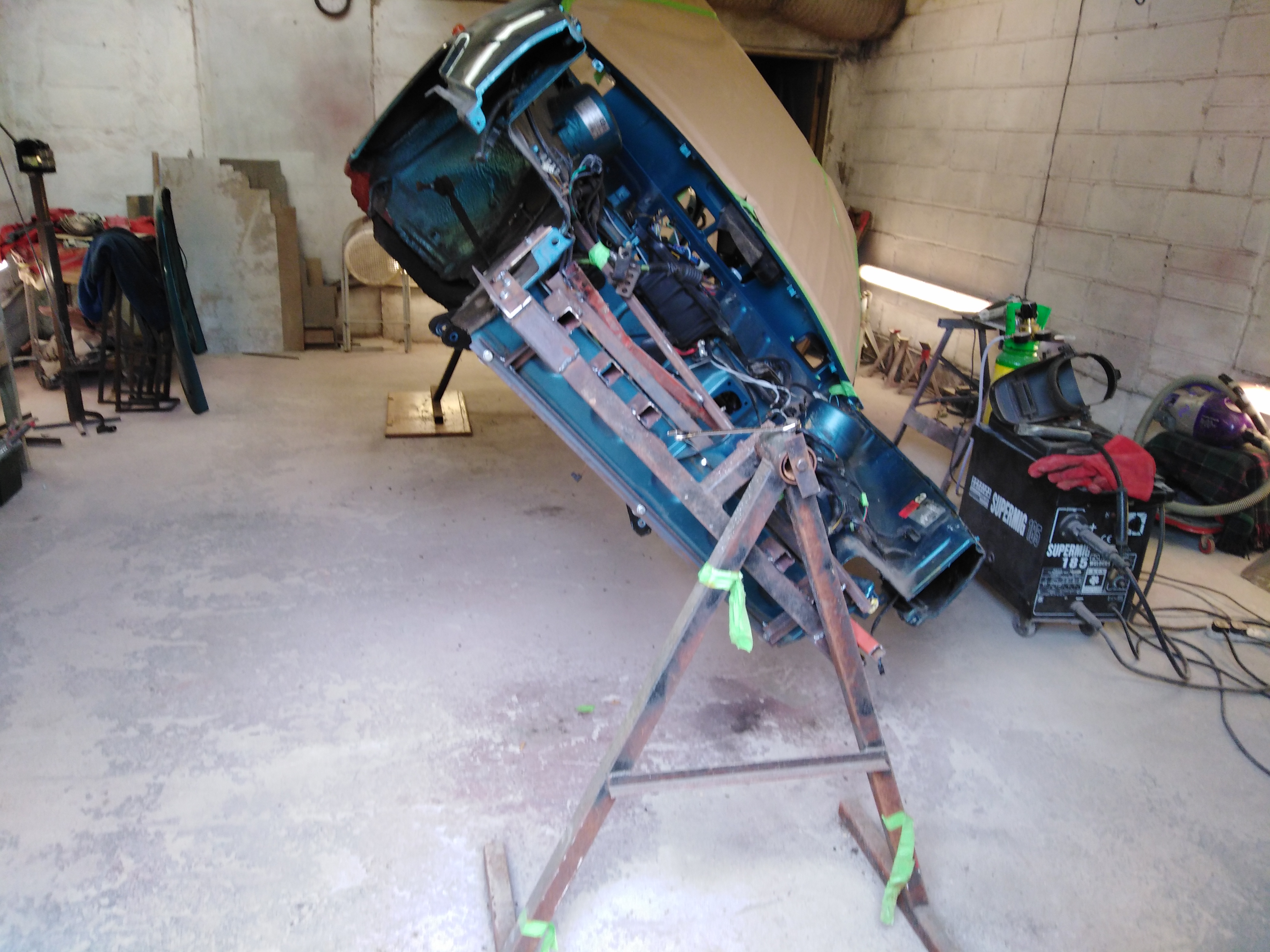

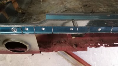

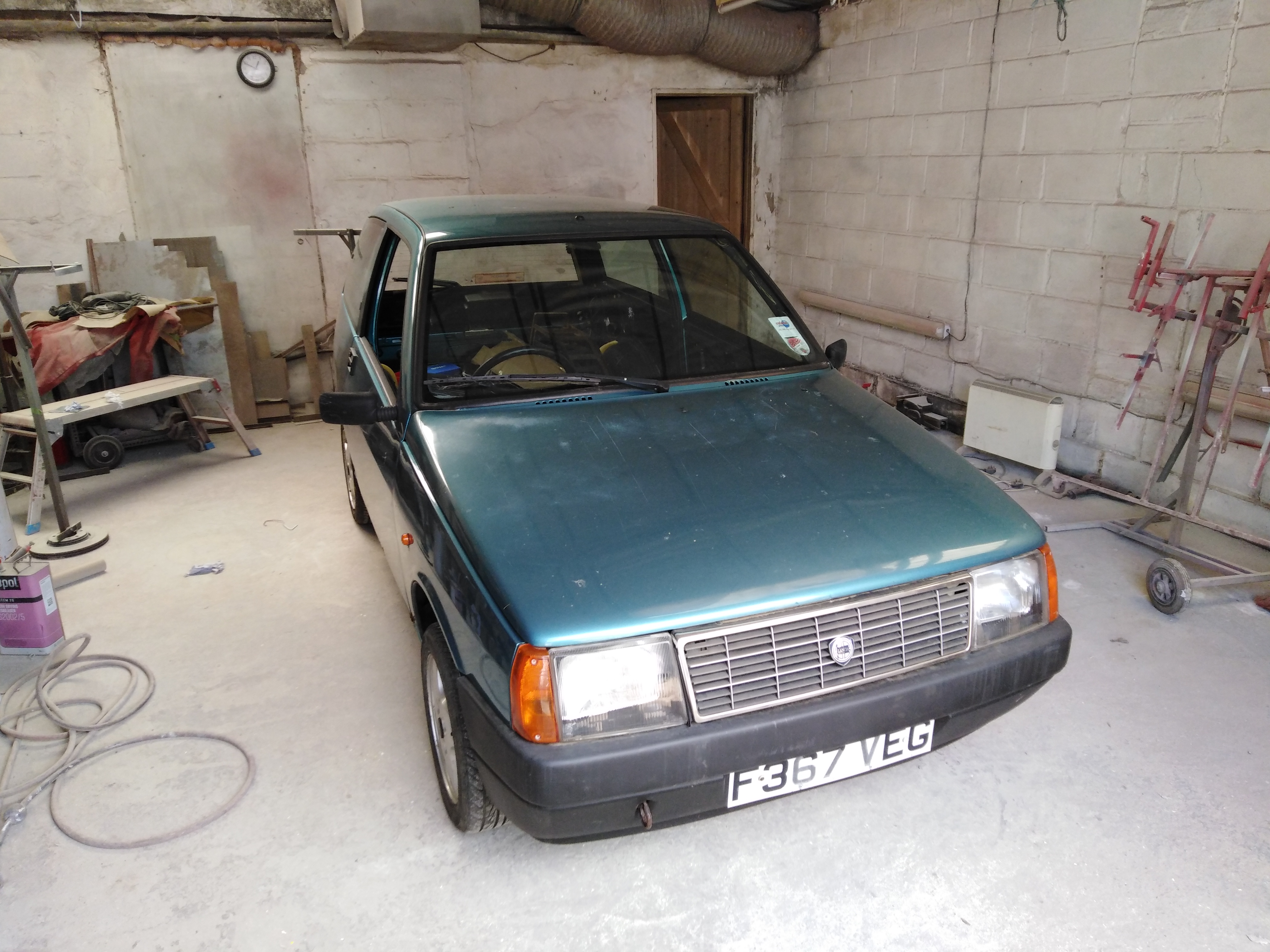

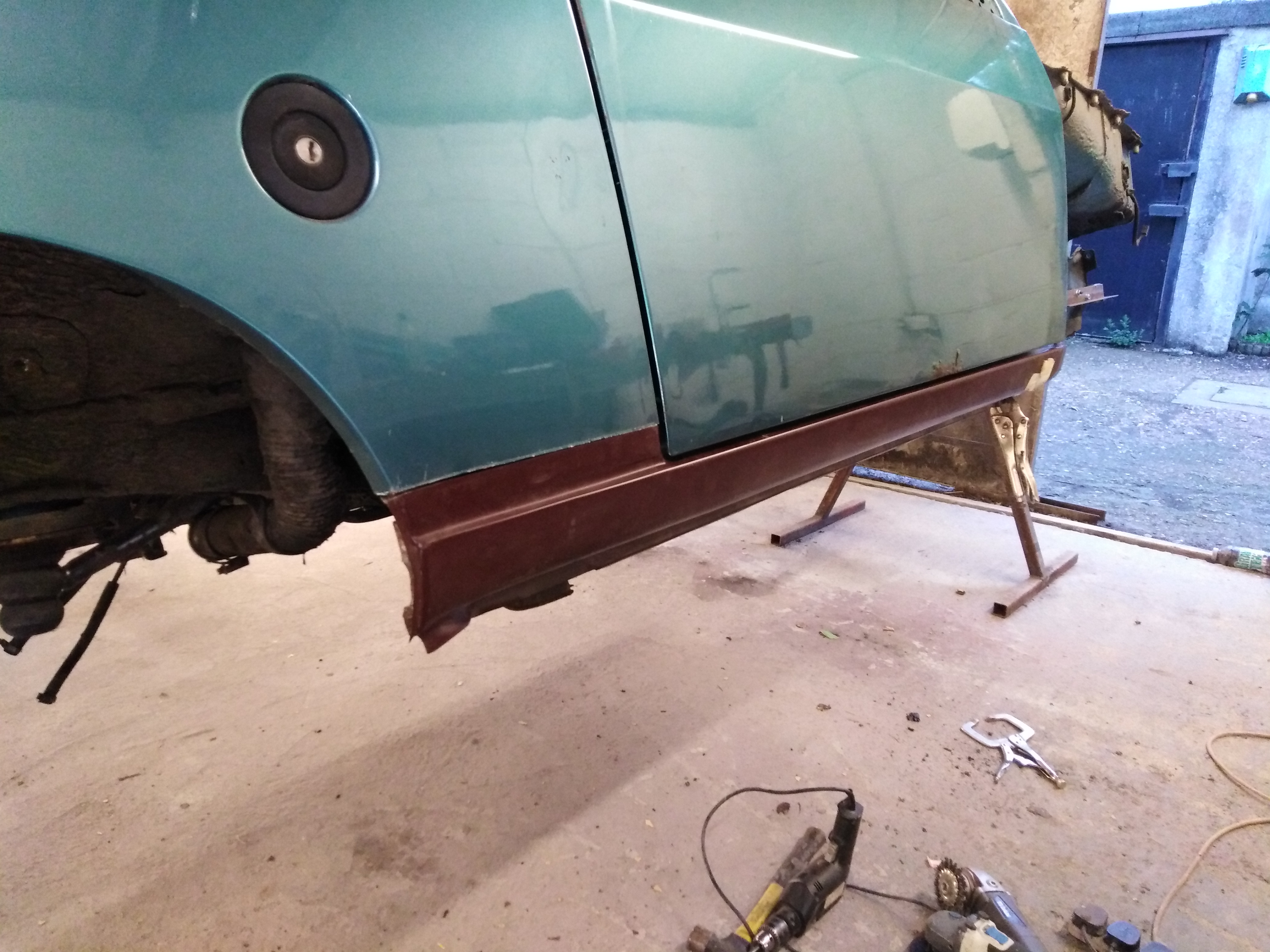

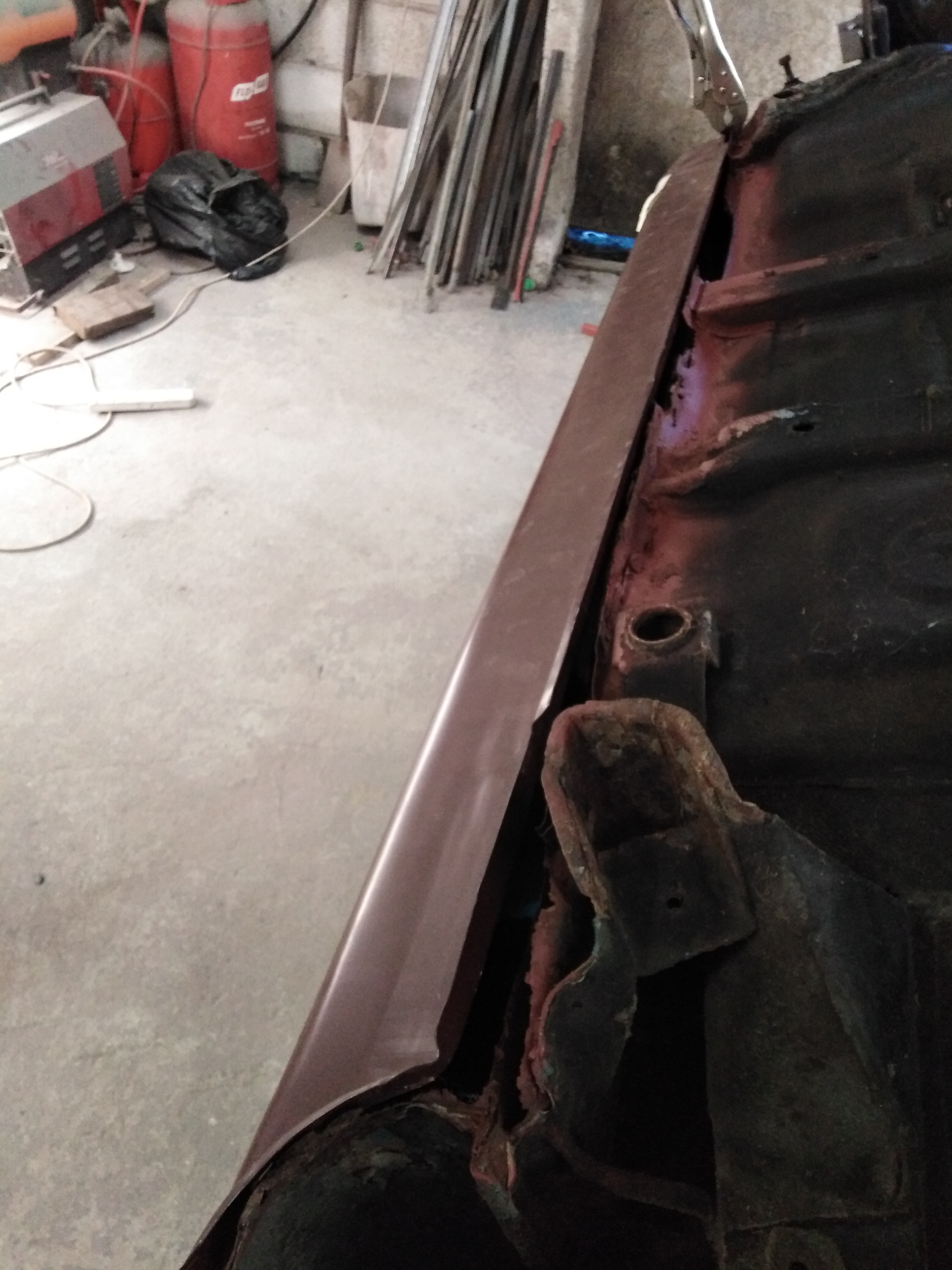

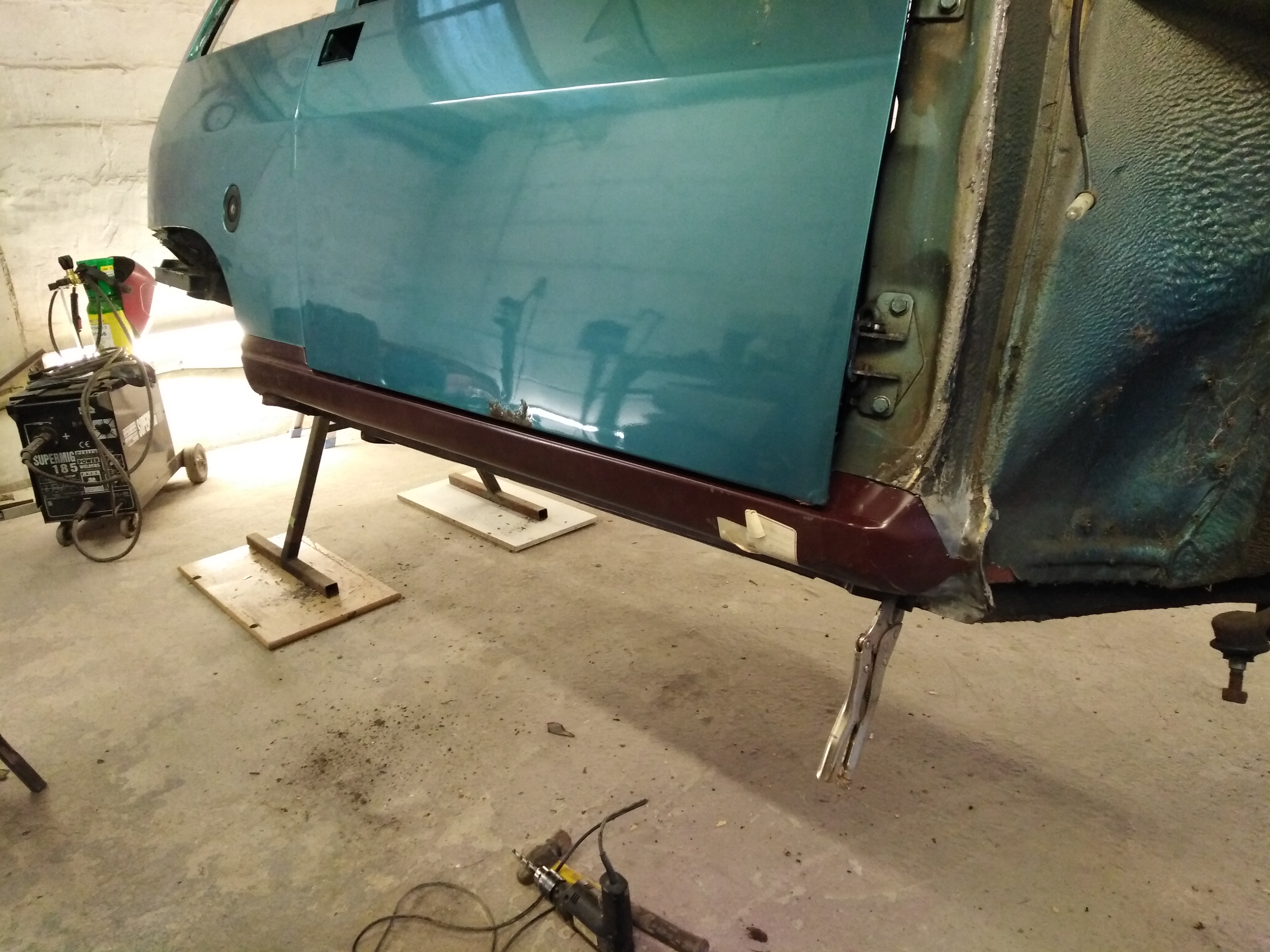

The plan was a quick job...
I started to chop the outer sill off at home a while back, thought it wouldn't take long. But of course the joint to the floor wasn't very good and it needed more repairs behind the wing bottom, I wasn't going to rush and lash it up so it sat at home until it could be done right.
Now it's at the unit I came to the conclusion that I may as well do it fully properly now rather than just the sills, I'm not that keen on welding upside down either so it's getting stripped out fully so I can get it on the tilter frame and have it upside down and at all angles.
Of course that means everything out, engine and interior etc..

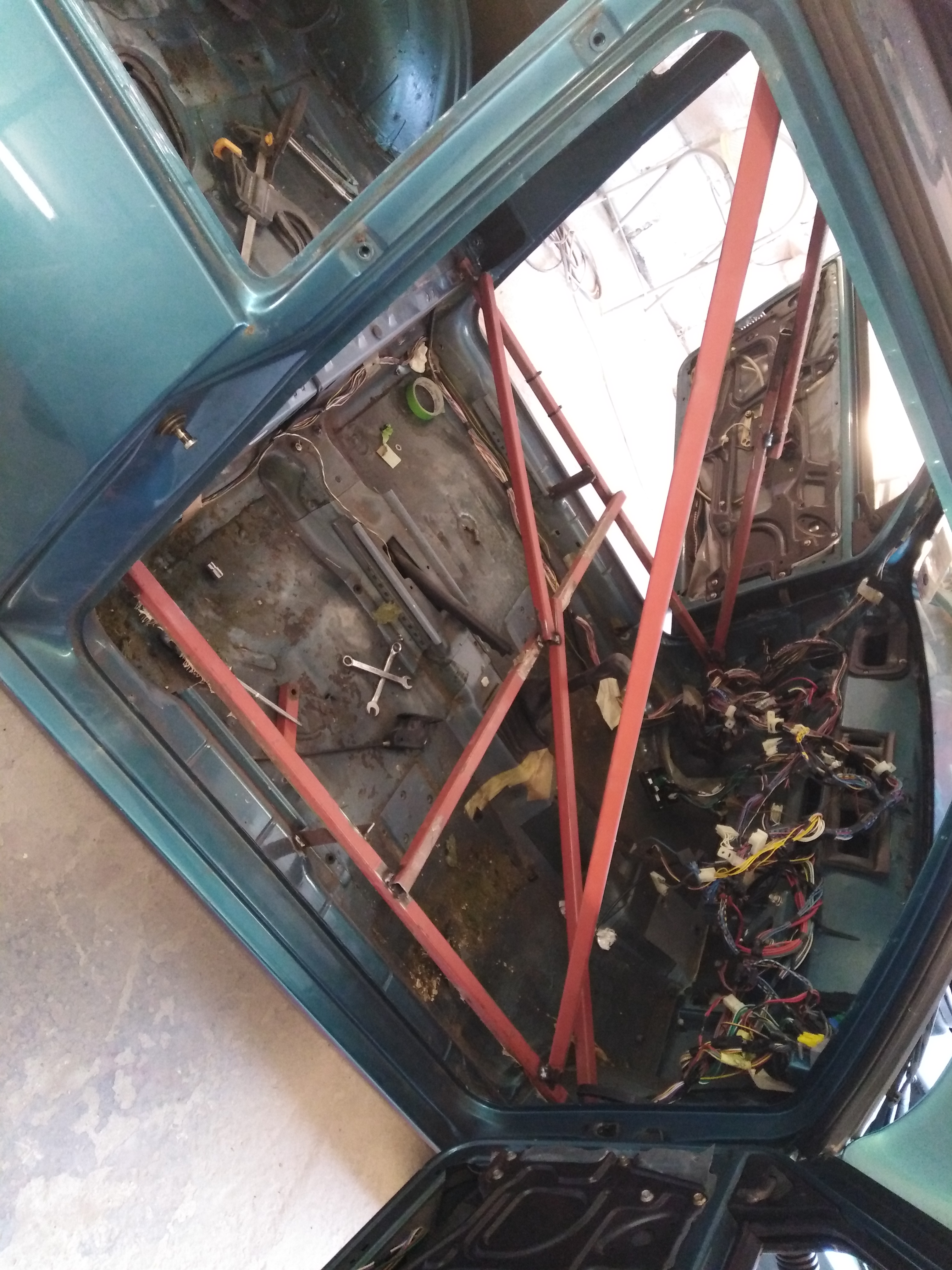

Once I'd tidied the unit up today (amazing how messy the unit gets, only me in there so nobody else to blame...) then the first task wa sto brace the body shell as it has a fair but of flex, more than I've seen in other cars. When jacking up one corner the doors became out of line and awkward to open and shut. What is vital is to have the car in a position of structural solidity so that when it's welded it is in the right position! With braces welded across the door opening, laterally and diagonally but the crucial one from the bottom of the A post up to the top of the B post then the shell was solid again. You can jack it up behind the front wheel now, same side rear wheel off the ground too and the doors still open and close lovely. Now once the outer sills are cut off the car will keep its shape.
With the car now sturdy the work on stripping things out could carry on. A few bits off but as ever 10 hour days never seem to be enough. Engine and gearbox out in the morning hopefully then back axle and fuel tank, can then set about seeing how to attach the frames each end.
A few other bits to come off, rear hatch and front 'screen for example but the effort will be worth it when I start welding it stood up

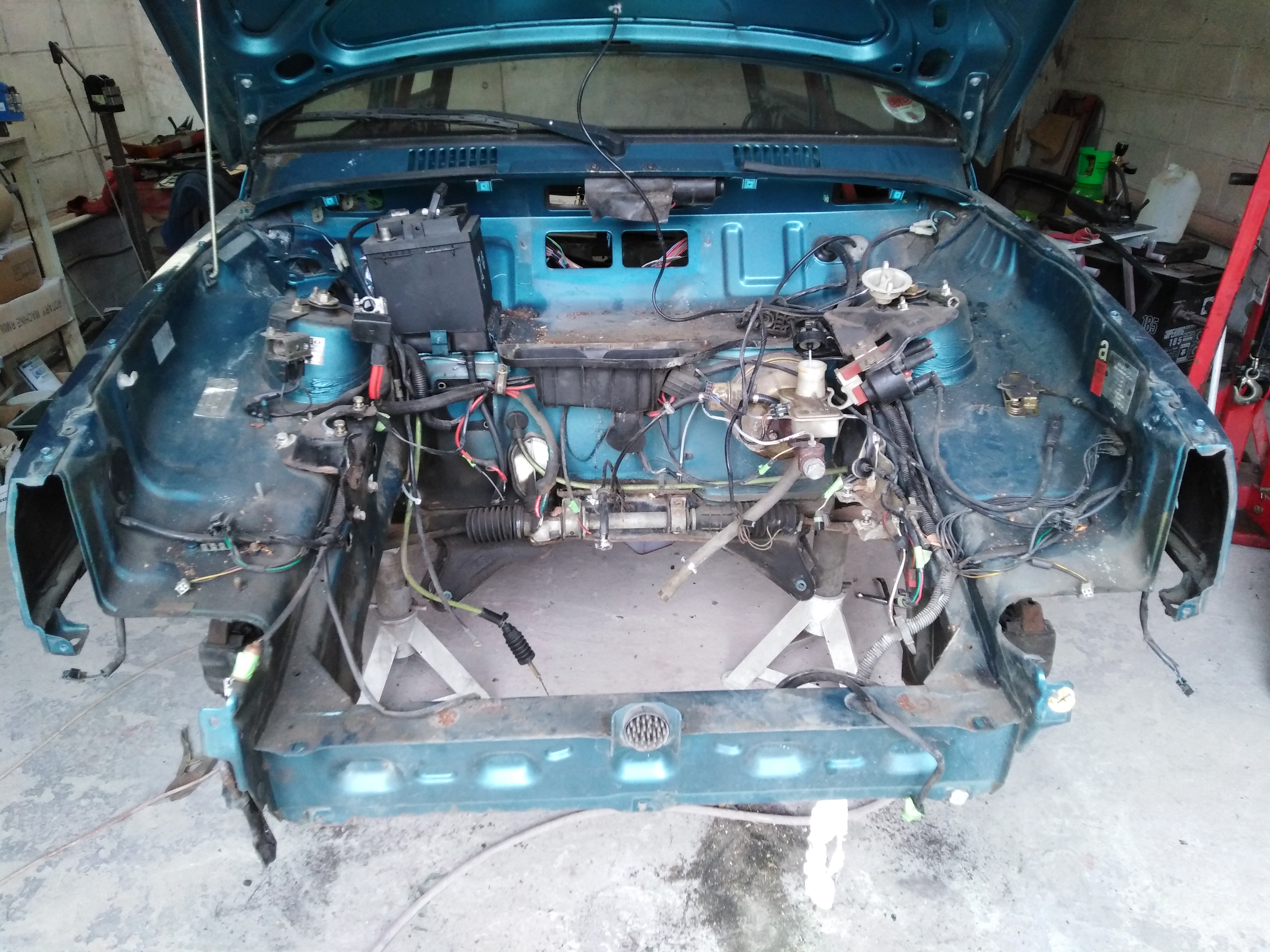

Anyways, task was to get the engine and gearbox out before allowing myself to knock off for dinner.. Nice to have something to aim for
Enough out of the engine bay for now, may decide to strip it all out when it's painting time and do the engine bay even though I hadn't planned to..
This afternoon the back end needed stripping out. Rear axle came out OK, all bolts coming out without issue. I'll get the axle blasted and powder coated I think, or may just spray it. Like getting things blasted and coated though as saves me the hassle! Take him rusty crud and a couple weeks later it's smooth and shiny
As ever the fittings into plastic were the awkward ones, rear bumper mounting bolts spinning in the housings. Nothing that the grinder had any fear for though, although means I've some mounting bolts to make.. Ah well.
Rear hatch, lights etc all out so rear end about as light as possible.
As small a car as it is there isn't half a lot of parts taken off
I need to make some shelving tomorrow to store them in the big unit, out of the way of the welding and painting to come..

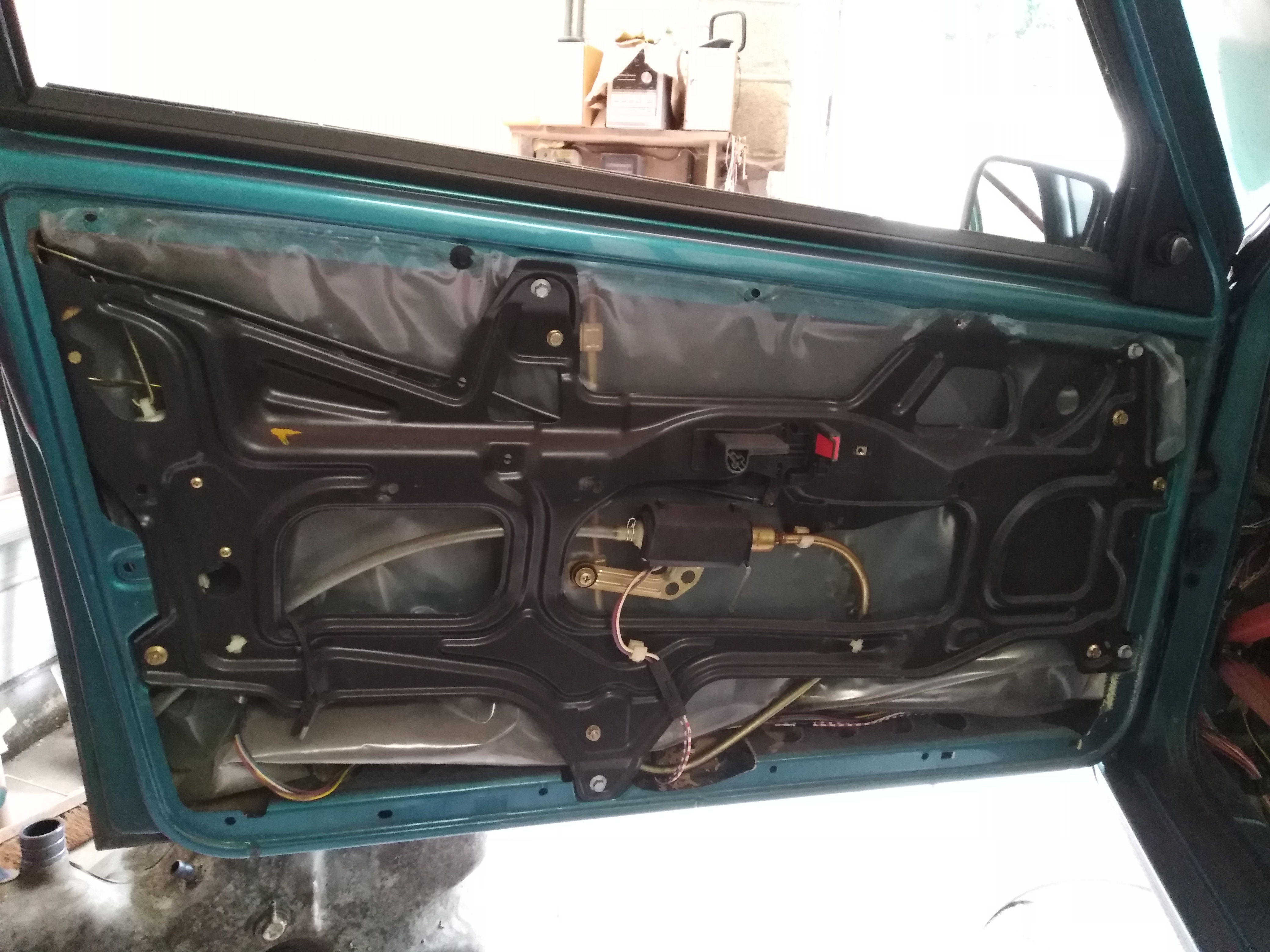

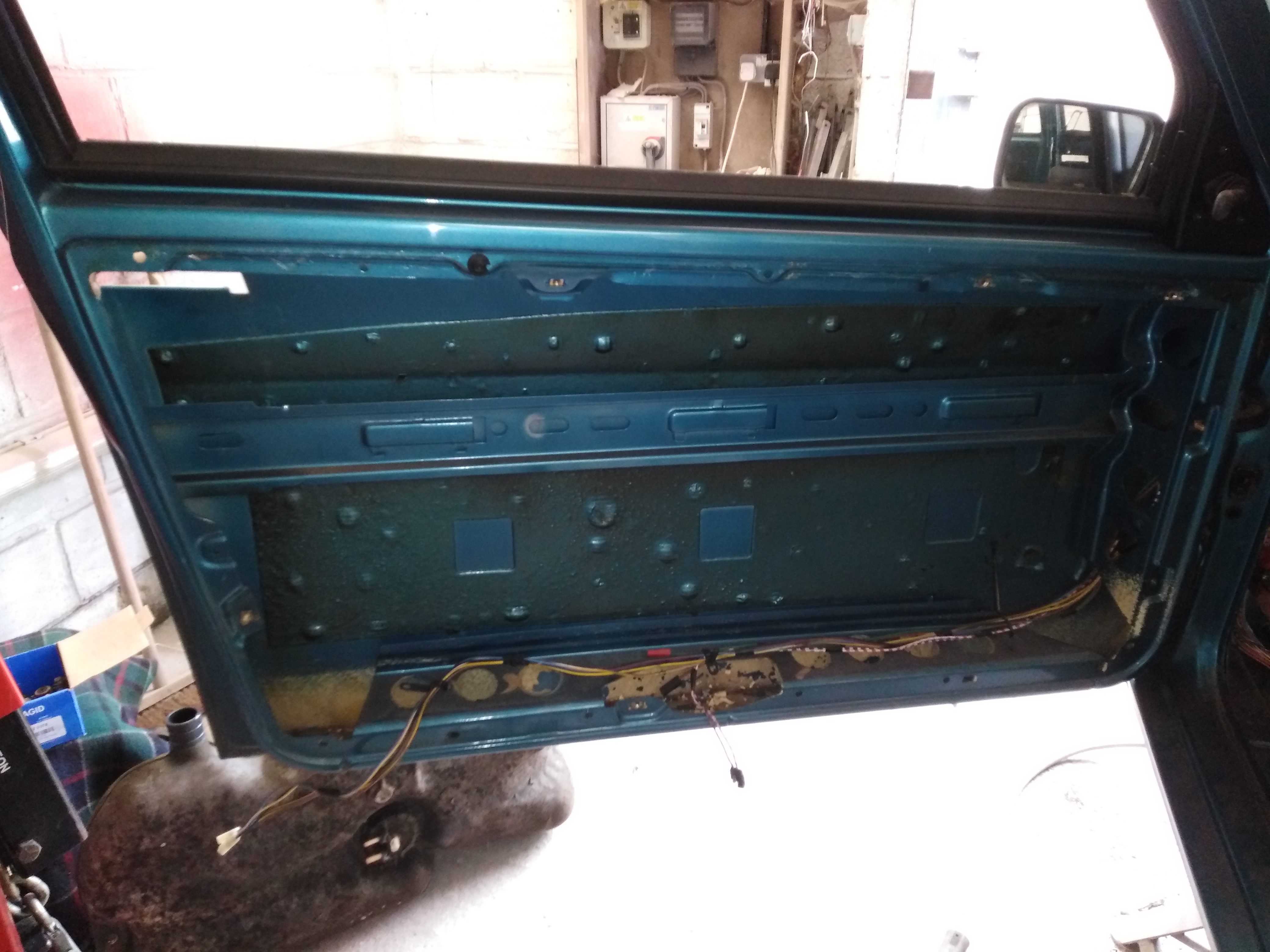

How about this for a neat bit of design.
I needed to strip the doors, take the weight out and for repairs and paint in the future.
Normally taking door handles, electric window motor and regulator, central locking etc is a PITA and fiddly.
This looked no better.
Consulting the Lancia workshop manual was a godsend...
Simply one screw and the outer handle can be slid out, 2 screws and the door latch comes off..
Then there are 4 bolts and 2 nuts around the black frame and the whole lot comes off in one, window reg, glass, door handles and lock, the lot...
Just leaves an empty door!
Takes a couple of minutes and all out.

Some things have moved on eh mate
Good idea, I only recently found out that you can unbolt the door skins on VW Golfs
Didn't know that about the door skins, guess it's trying to cut down on repair times..

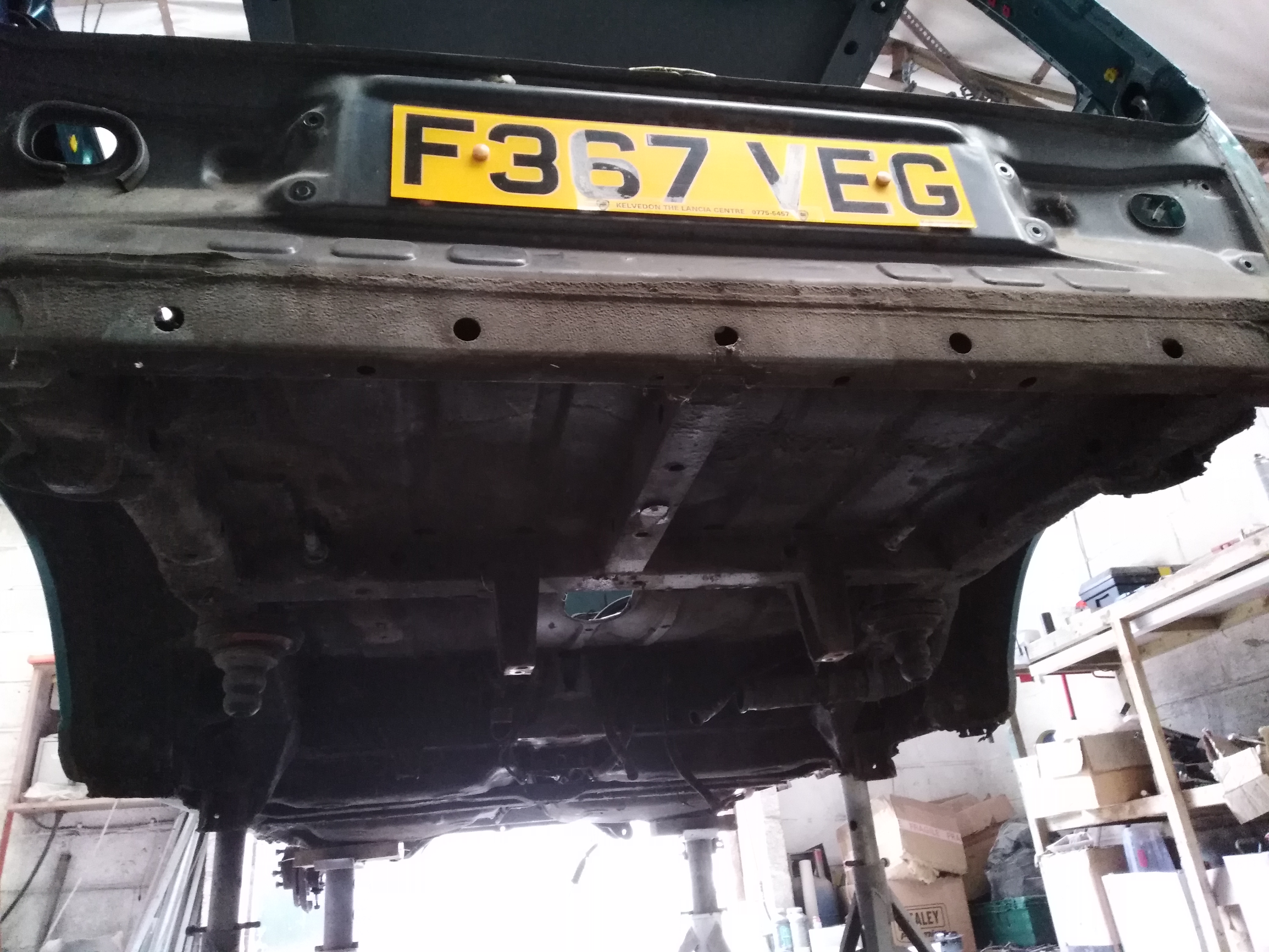

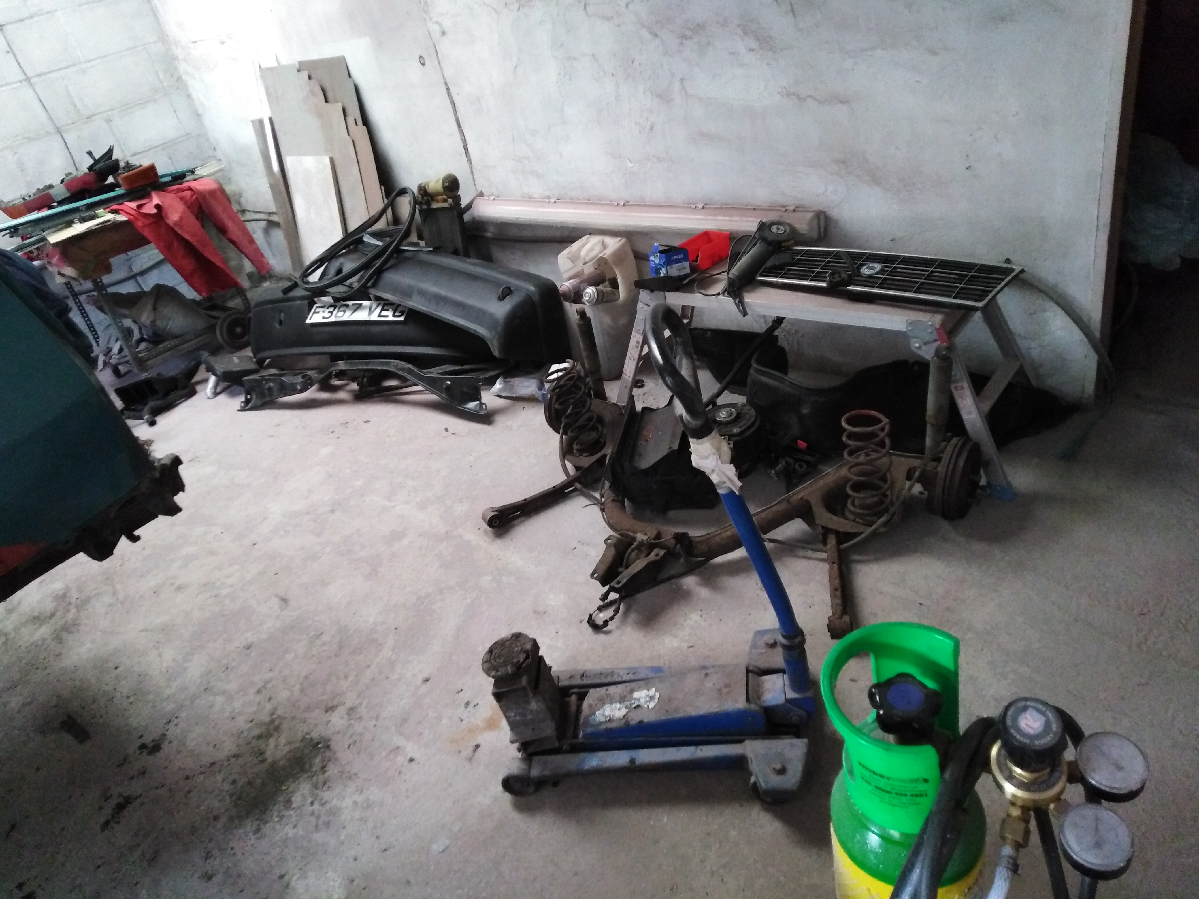

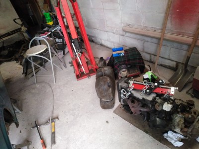

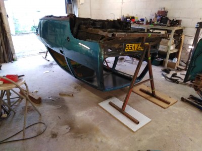

Got nothing much done today, well to the car anyway.
I've had a pile of shelves sat in the unit since back end of last year, but not much use in a pile.
The fact I also have a small unit with a big pile of Y10 parts meant action was needed,
So this morning I set about making some storage, nice set of shelving now to store all the parts and more in the big unit away from all the filler dust as much as any paint spray. Perfect, should have done it ages ago!

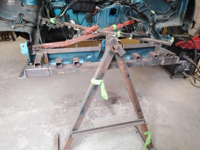

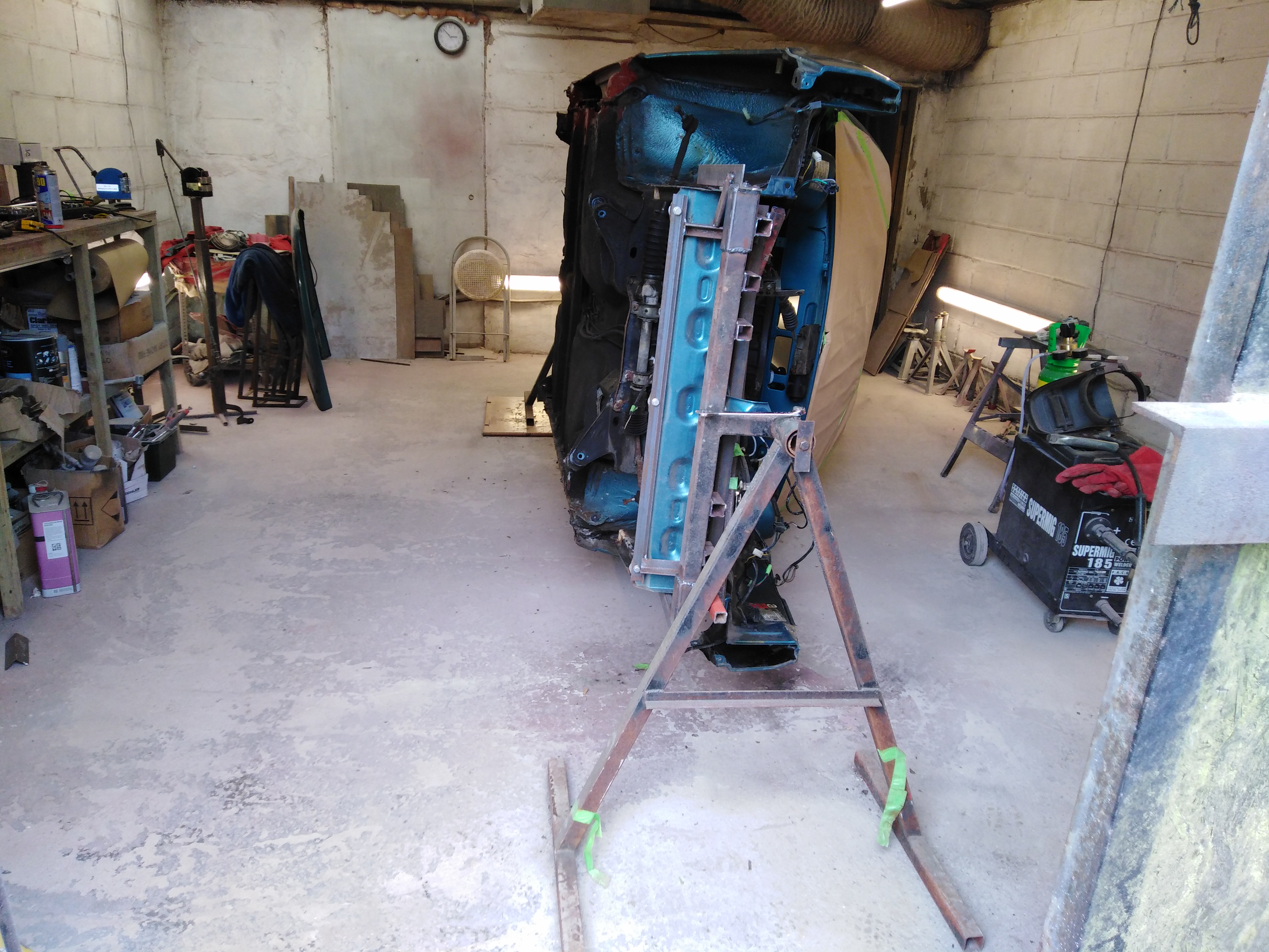

With all the parts stashed away and the engine/gearbox trolleyed away too I did manage to make a start on fitting the bracketry for the A frames....
Tomorrow it should be upside-down time....
I did manage to get the car attached to the tilter on Thursday, dropped the ball a bit by greasing the pivots on the frame as they'd gone rusty, thought it'd help it rotate smooth only for it to want to tip sideways then belly up! Not helped by the front screen still in which has over balanced it making it slightly top heavy.
This afternoon by the time I could get back to the car, first task to come up with a solution to the kamikaze car, stop it playing dead all the time.
Solution I have come up with was to weld a few pieces of box to the frame
This then allows me to have a slightly smaller, tight fitting piece of box as a peg which can be fitted as a stopper, frame goes around and stops safely at the desired angle of attack.

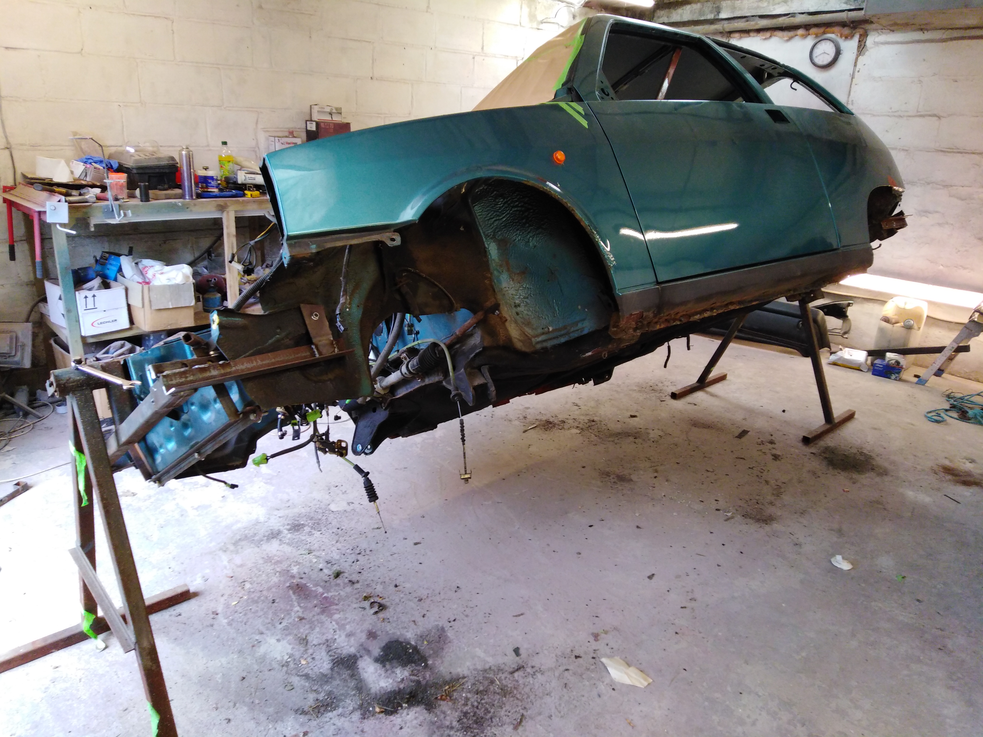

Started the task of chopping out the old sill and cutting the new one to suit, just make sure to not cut too much off!
Got the alignment nice now even if just with clamps. Won't be welding anytime soon as it's just to find out where it needs to be so I can make a bottom edge to attach it to!
New sill is a nice one and has the swage line for the rear quarter panel so it can be joined above it saving the hassle of damaging then rebuilding the line.
As you can see though the bottom edge is a bit lacking, so that will need making first
At least with the topside aligned I know where to make it up to..
Shame I'm back to work next week or I'd be able to make some progress. Never mind, it'll happen.

The inner face and bottom lip need a fair bit of sorting, around the rear suspension mount too as well as the lower rear arch. But being able to do it without sparks, rust and old underseal falling in your ears and eyes will almost make it a pleasure.... almost..

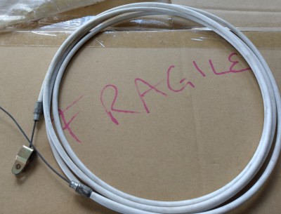

Kev, is this a Imp cable? Was with some of my cycle stuff but says imp on the packet !
Could be a handbrake cable mate, I'll send a pic to Rob, he'll know
Throttle cable Rob says.
