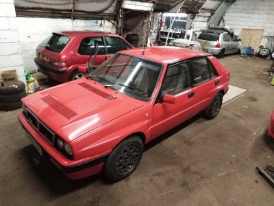

Whilst outside it said hello to my latest daily driver!
A pair of cars now with twin exhaust pipes

When did you get the Giulietta Kev, has anything gone or is the fleet just getting bigger?
What spec is it, I guess you have stuck with diesel, 170bhp?
Recently taken custody of one myself. Getting use to it now, and rather pleased with it.
Makes the 'Grale look tiny.

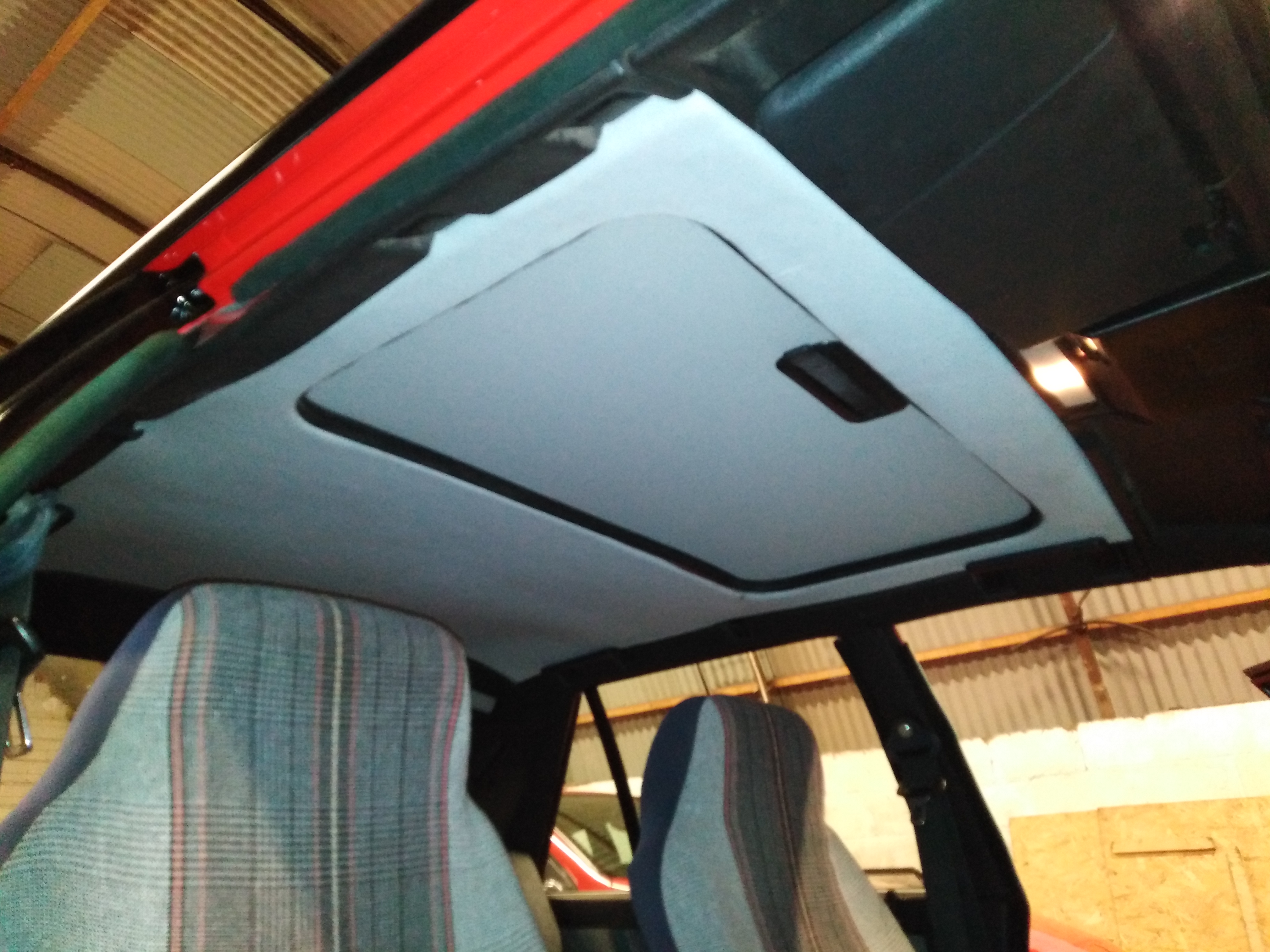

Getting a few jobs ticked off the list, it's a long list!

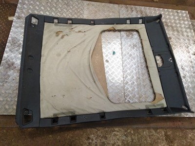

One of the dreaded jobs though was the roof lining which is material glued to the cardboard type shaped liner. The foam backing had all rotted off leaving a saggy mess.
The rubber edges are all screwed together from behind, trapping the material.
First attempt to glue the material down resulted in a lot of creases and an aborted screwed up mess.
Luckily I'd ordered enough material to do the panel and the sunroof so still had half left, of course I now had non for the sunroof!
Rerun went better though, after I'd peeled off all the old glue residue and bits of foam, a little bobbly but more than acceptable.
Left it like this for the glue to have a good spell at drying before cutting out the sunroof opening and gluing the material over the opening.

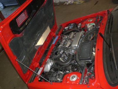

Under the bonnet is pretty much sorted now, airbox finally back in with freshly cut to size silicon inlet hose, Lancia ones NLA but a standard 60mm pipe has done the trick once cut to length.

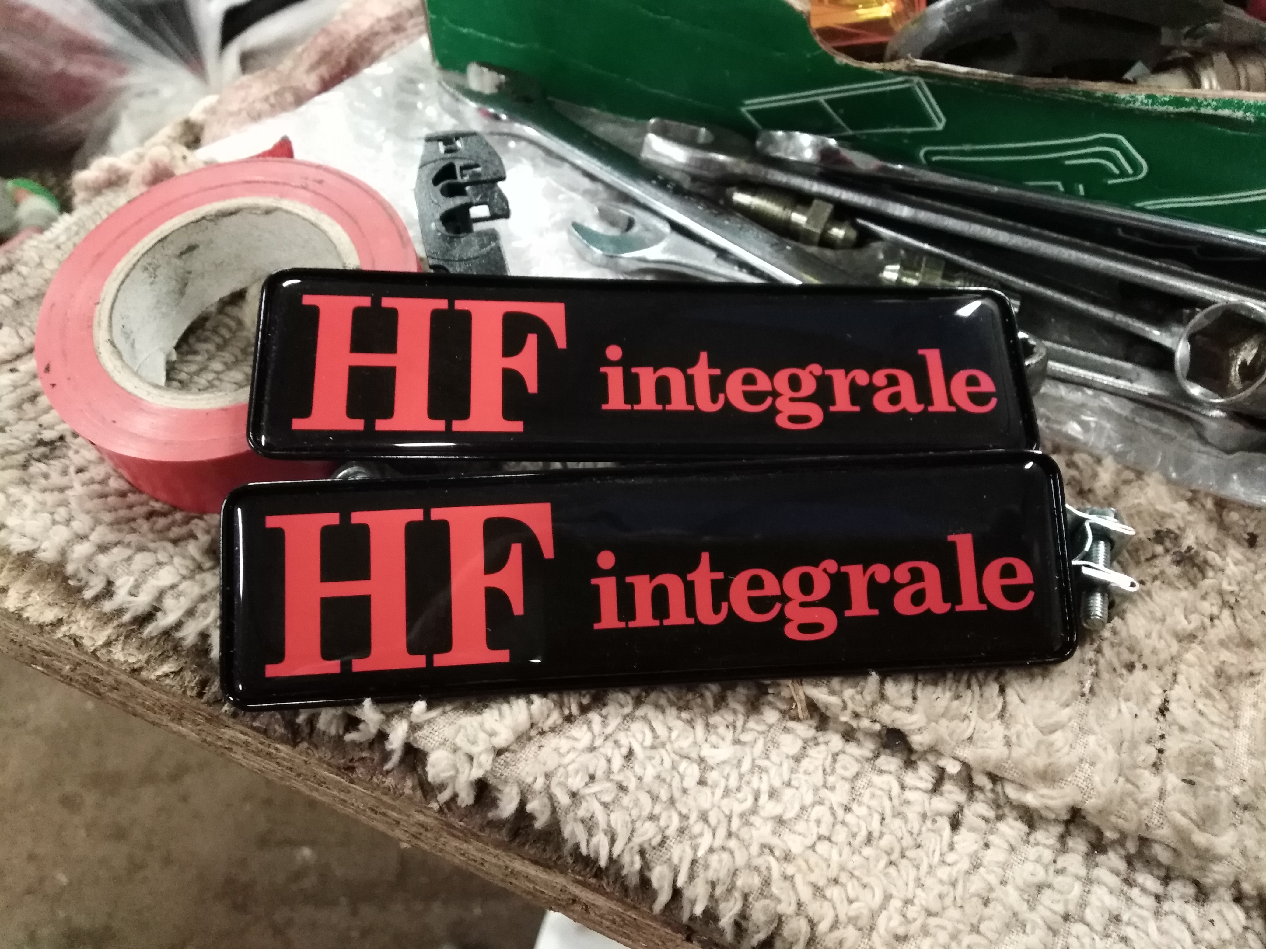

The sticker set has brightened things up a little, chassis plate rivetted back on.
I got hold of an alloy heat/water deflector for the front bonnet vent. It's a bit of a bad design really putting a vent there, water can run into the engine bay over the distributor cap! This vent channels any water away from the sparks but also will allow air travelling through the top of the radiator an easy route out through the bonnet when on the move. I've had to cut the bonnet liner to suit which is drying out having had a good wash.
The roof lining is back in the car so I could now get all the interior lights working along with the clock panel that mounts near the rear view mirror.

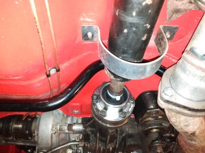

Fitted up the powerflex anti-roll bar bushes to replace the ones I'd previously fitted which didn't allow the little clamps to go onto the roll bar. The powerflex ones are a bigger bore to allow the OE half moon sleeves to sit on the bar inside the bush to let the clamps go on to the sleeve ends to prevent sideways movement.
The front of the propshaft had a bracket which looks like it's there if the front joint fails so it collects the flailing propshaft. The original was so thin and rusty that it wouldn't stand up to a breeze let alone a flailing prop!
As I had some 3mm steel I cut some out and made a guard.
Sits here, off now so I could paint it. Should at least be a bit more capable of surviving the task at hand!
I tried fitting the aerial that I have had for a while but it turned out that a cheap aerial is a crap aerial, it was useless so went in the bin.
Got the panel to make for the sunroof then it'll be about watertight so can at last get a wash!
Tons of small jobs done, too small to mention, but all take time to sort.

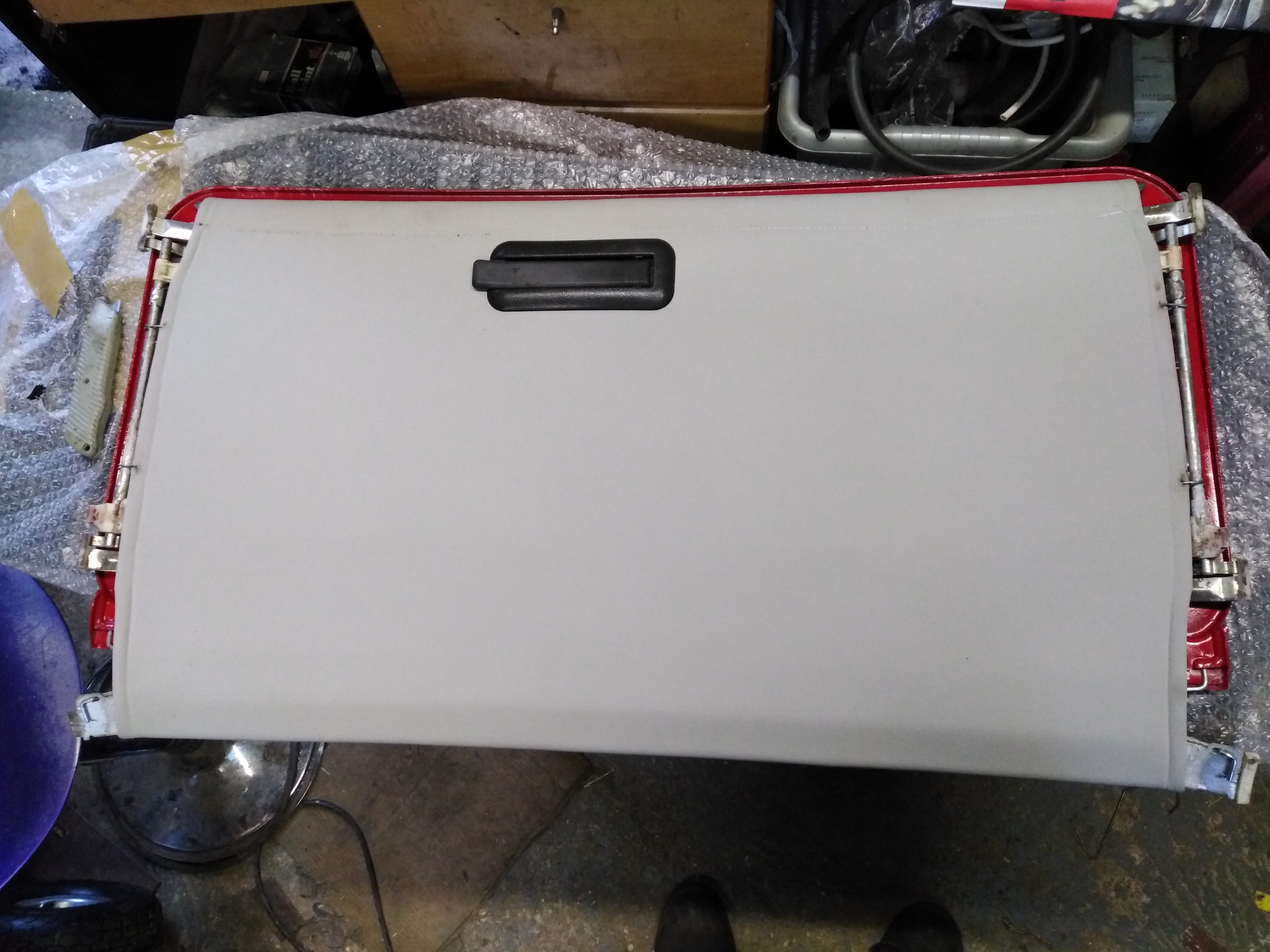

Don't ever anyone tell her, but the Mrs has done a good job on sewing a panel together for the underside of the sliding sunroof.
Fitted it all up tonight, just about the right amount of tension on the rods within the edge pieces.
i'll fit the seal then it can go in the car which should just about make it watertight so can at last be washed!

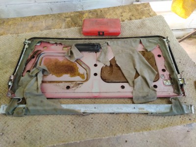

Seems like the same manual sunroof as I've got in my (still for sale!) Beta Coupe.
When I'm closing mine, I have to push the sunroof upwards to get it to sit flush with the roof.
Very difficult to see the mechanism with the sunroof in place......
Any clues on whats wrong with it!
alfadave wrote:Seems like the same manual sunroof as I've got in my (still for sale!) Beta Coupe.
Dunno Dave, I'll have a look and see......probably find out when it comes to putting mine back in!

Got the roof lining back in which I trimmed to reasonable effect myself, simple job to other people but a drama to me!

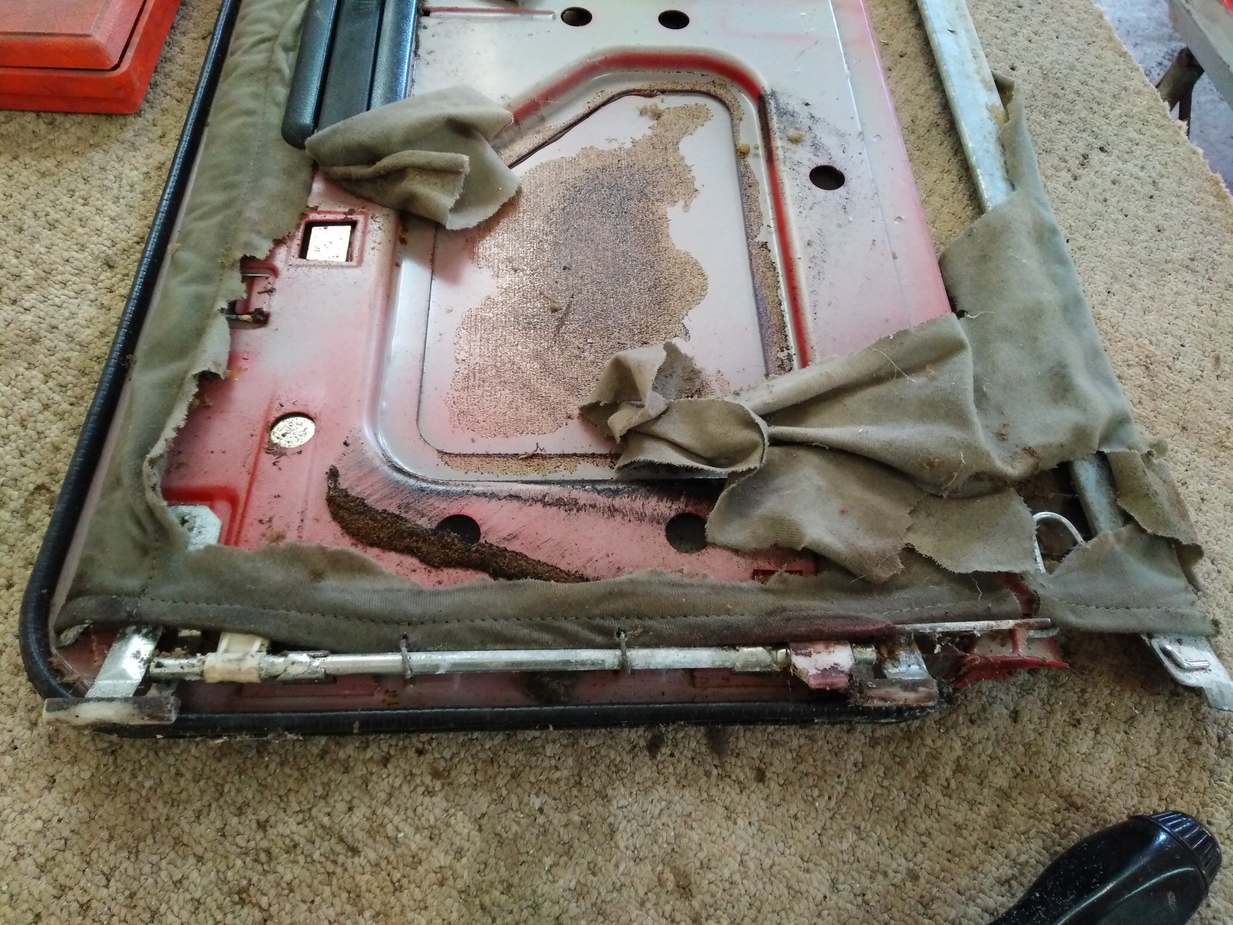

This is the underside of the sunroof panel Dave, may be the same as yours?
When you close the handle it pulls back on white plastic lugs at the end lifting the rear of the sunroof back up and locking it in place, maybe the plastic lugs have come off yours?

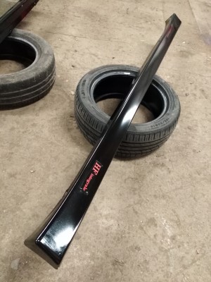

The side skirts I'd ignored for some time but time has come for them to be prepped. Driver side one had a couple of cracks in it so that got repaired aluminium mesh behind and super glue in the crack.
As they had faded fairly well and had some severe rust stains on them (not themselves obviously being plastic, but from the doors in its' previous life!) I decided to paint them with the same 2K satin black paint that I did the rest of the black trim with. Also had a fair collection of underseal caked to the underside which needed cleaning off.

Can't see any white lugs on my Beta sunroof Kev...
But really, its impossible to see in there.
I have to raise the front of the sunroof to get it to close flush.....but its no problem

The front wheelarches I've decided to spray with the protective wax to try and stop any rot coming back. After all the effort to seal and paint them it seems criminal to make a mess over them but as there is a plastic wheel arch liner in the fronts then washing them out with a hosepipe would be impossible, at least I know there'll be some protection should dirt and moisture get in behind the liners.
The sideskirts I'd painted last time were ready for the new badges...
All painted up in the same satin black after the cracks being repaired, I wanted a slightly poor finish to them rather than a smooth shiny finish so they will be left as is rather than flatted and polished.
Dangerously close to MoT time now....I'll talk to Chris tomorrow to see when he can do it for me...
