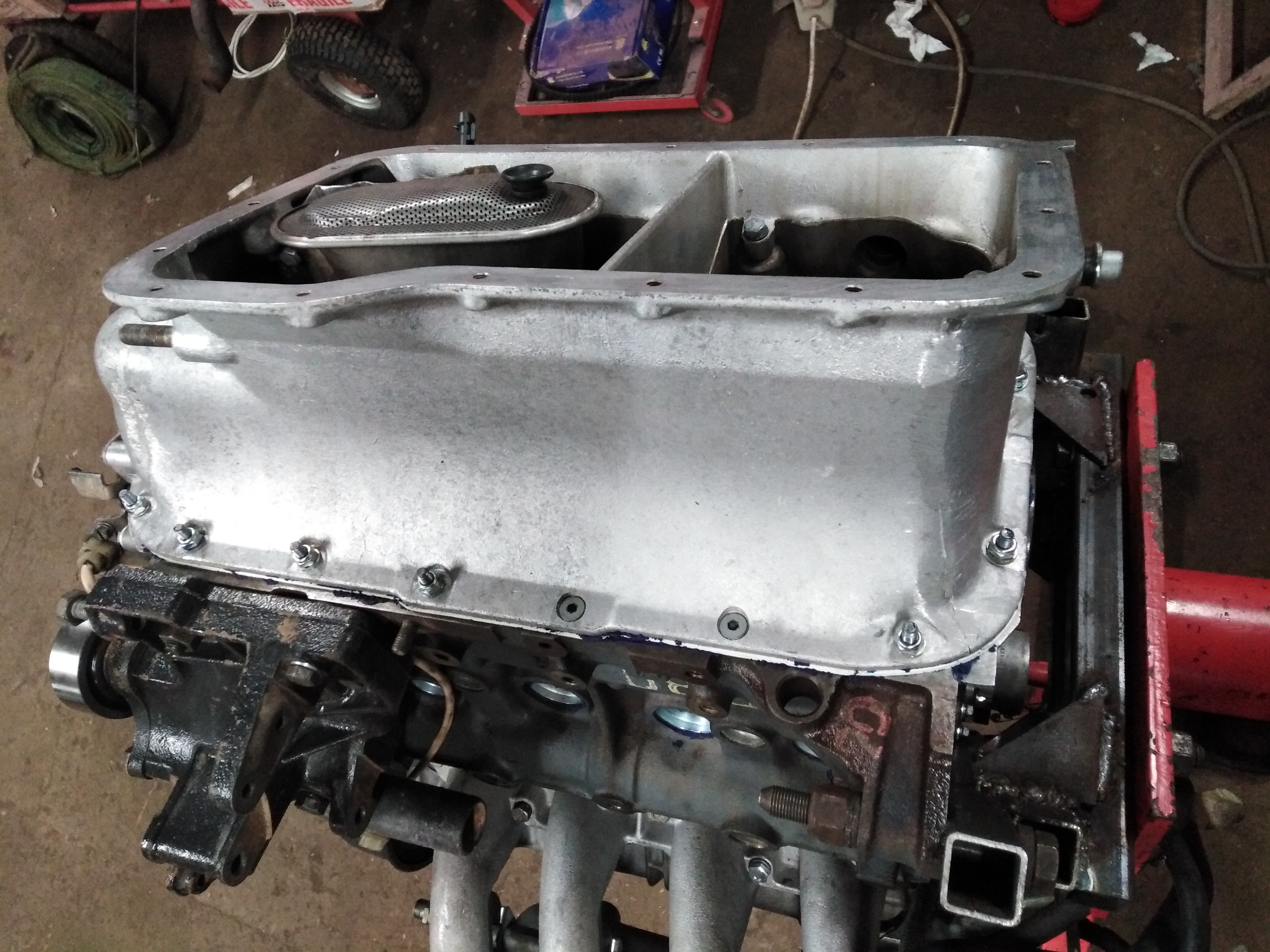

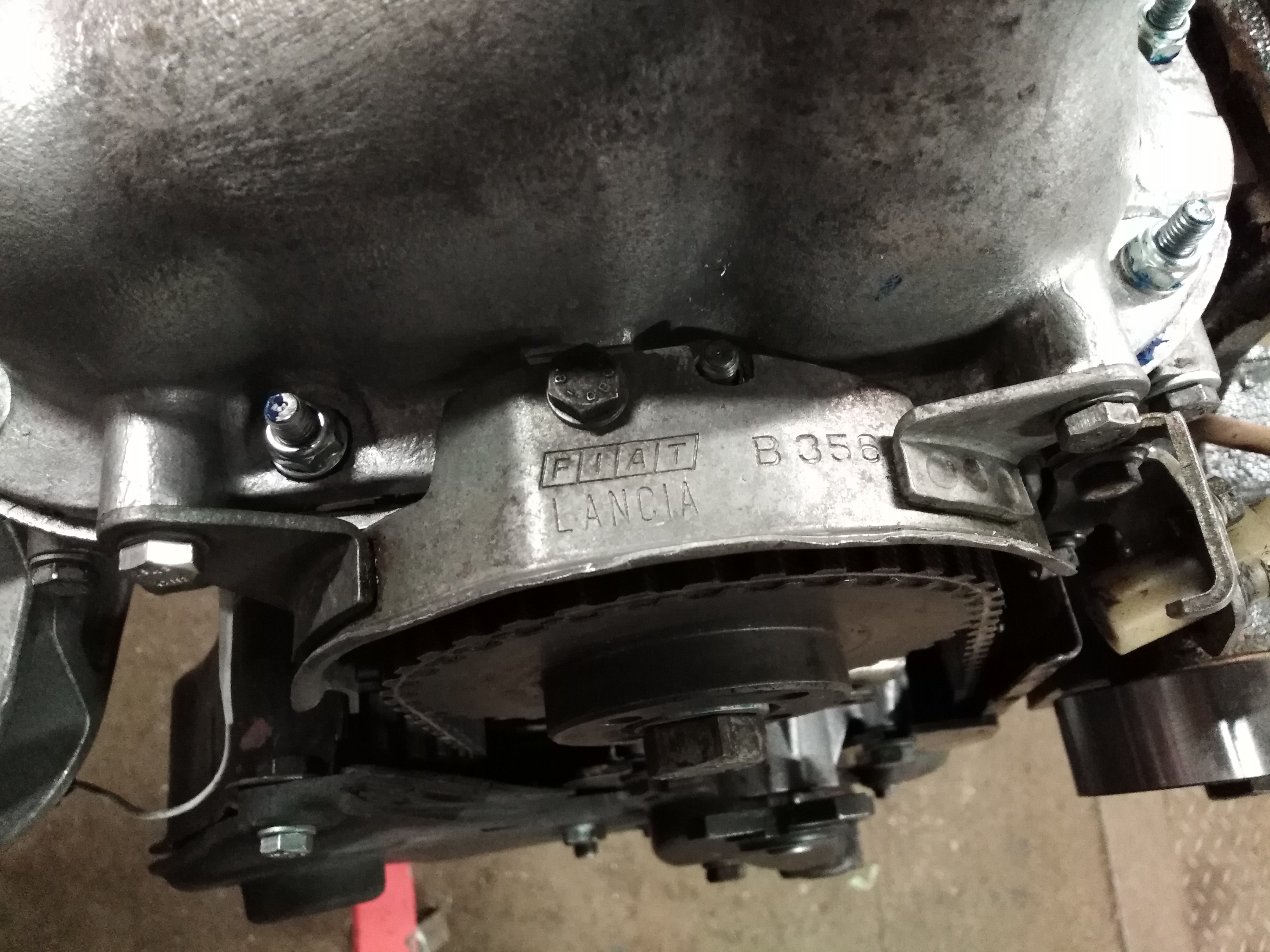

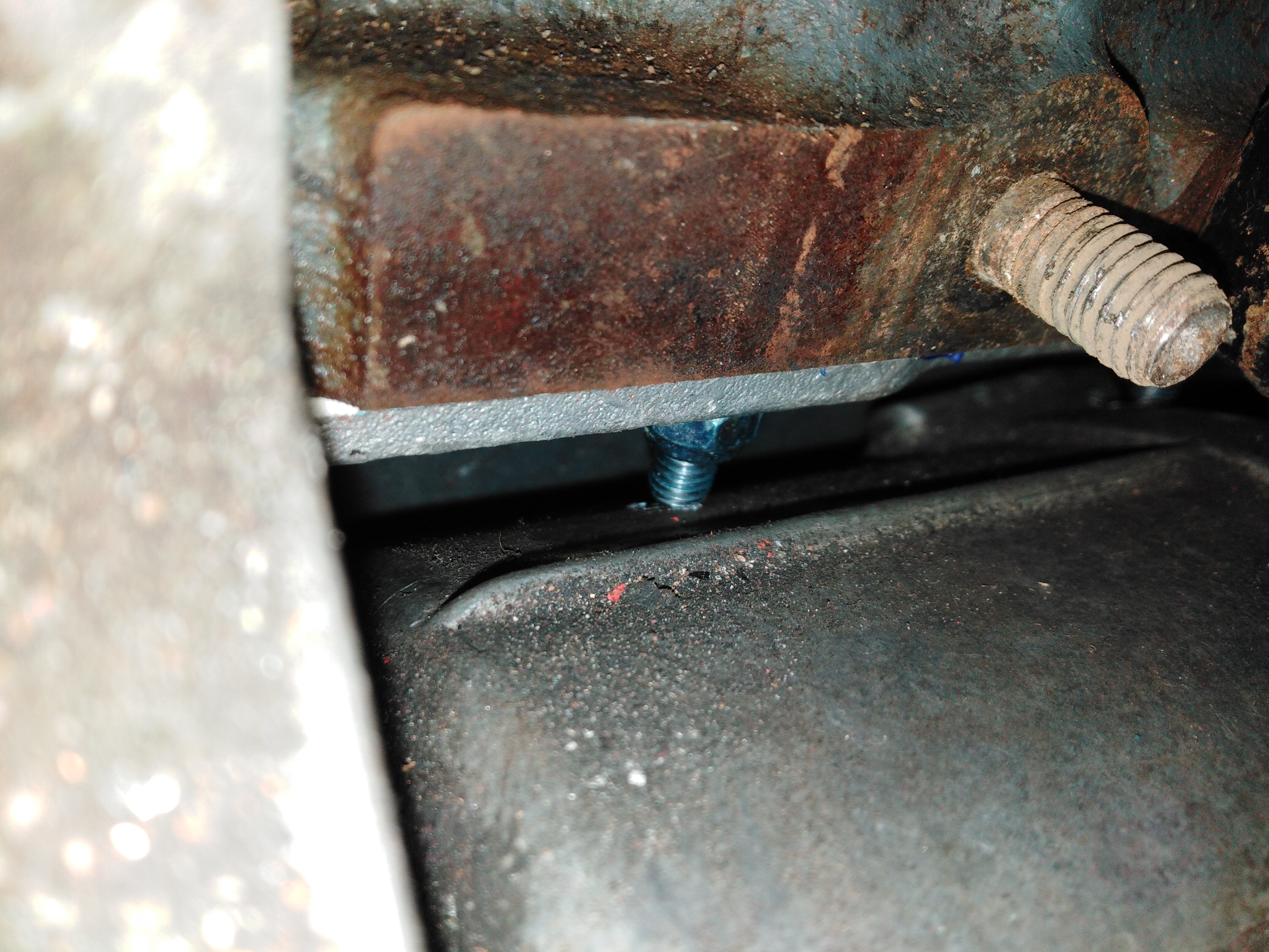

Studs finally sorted for the sump to block joint. Had to cut them a little bit shorter as they were bottoming out but all done in the end and threadlocked into place. 2 bolts were actually countersunk so left those as they were.
Had to make a little cut-out for the stud at the bottom belt cover though :D
It's taken a lot longer to sort out than I hoped but at least it's now done and should be leak free...
Happy with that I got the bottom sump plate to fit it then noticed the gasket for it was wrong, two steps forward one step back again....
Thankfully the mounting bracket could now be fitted at the cambelt end after the stud repairs.
With the larger diameter stud the plastic cambelt cover needed a little tweak but nothing to worry about.
Then as per usual I notice, where's the cover for the bottom half between the water pump and crank pulley?
I really can't recall taking one off but there are marks where one has been. A search online to see what it looks like brings no thoughts of seeing it, guess it probably never got replaced at some point on a belt change...something else to try and find, two steps forward one step back...
Got the thermostat, distributor and other assorted items fitted though so it's getting close to being ready to come off the stand and get back onto the gearbox...

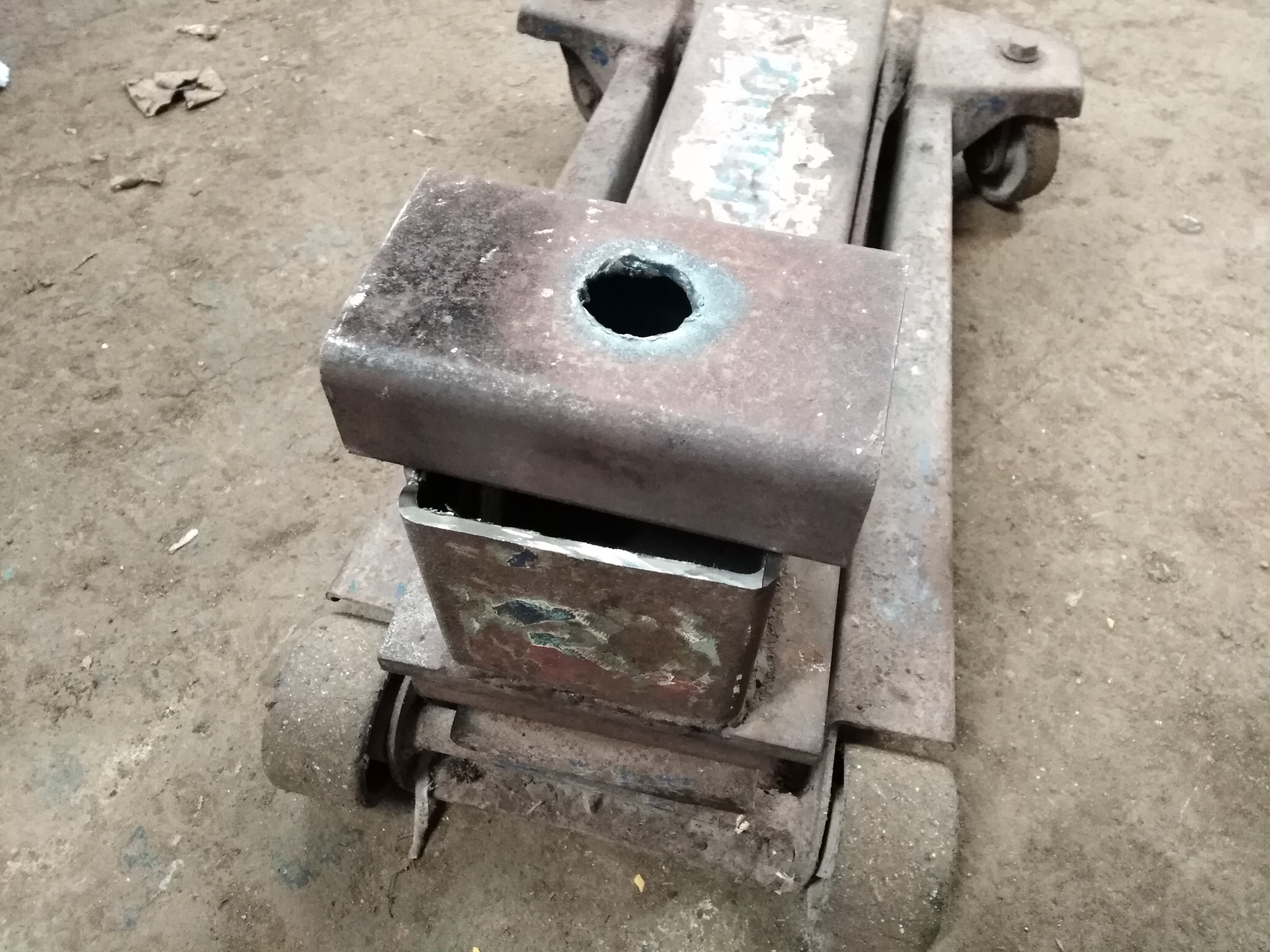

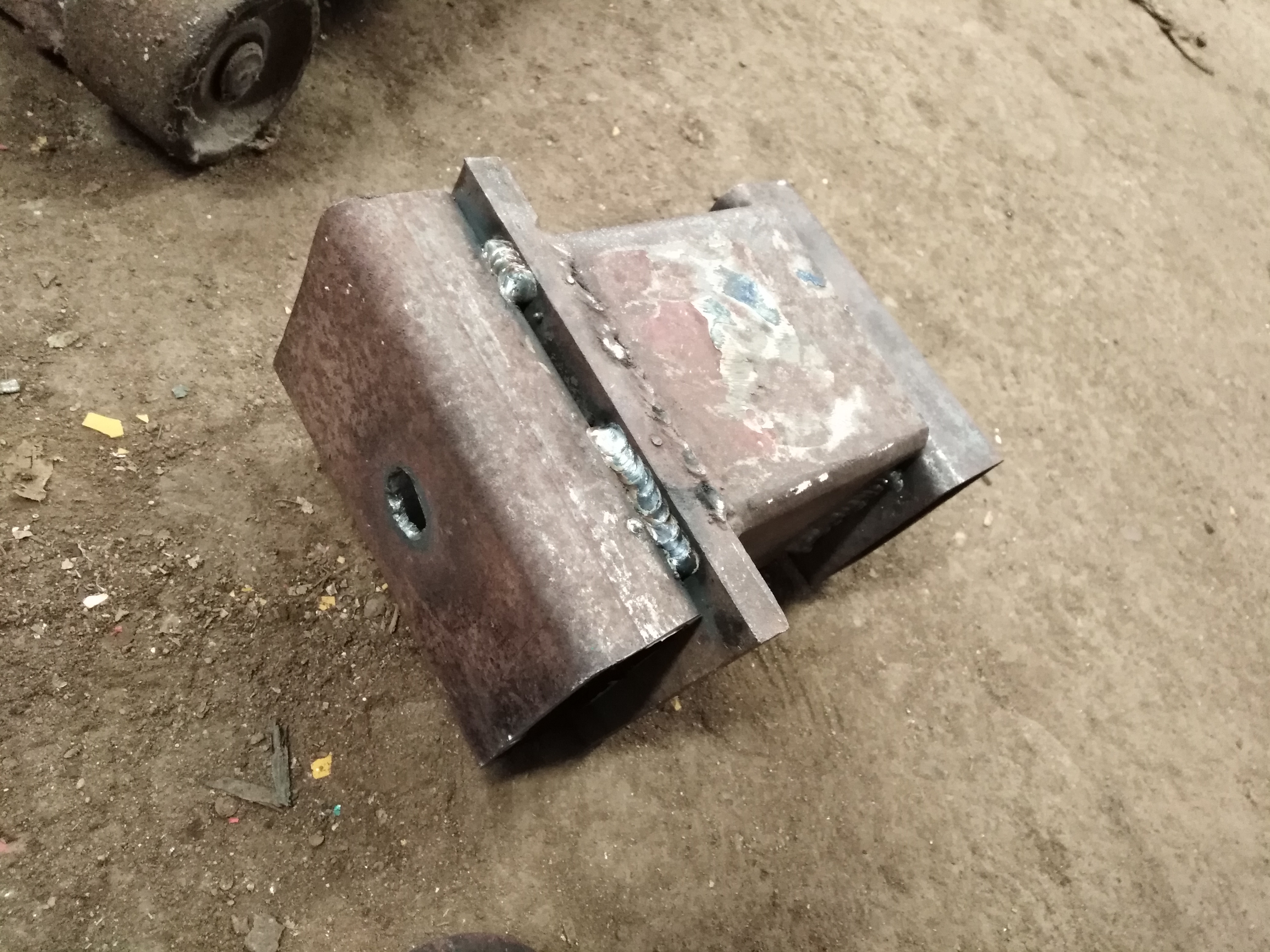

Did though come up with a solution to trying to get the car jacked higher.
Was gonna borrow one of Jims' high lift trolley jacks but fancied making a better solution, something I could use again.
A few bits of spare box section was welded together, remove the jack pad from the trolley jack and bolt the extension to it with a towbar bolt, nice and secure.
The jack pad can then go back on top of the extension, creates an extra 7.5" of lift.
Now to find the correct sump gasket and a cambelt lover cover...... :roll: ;)

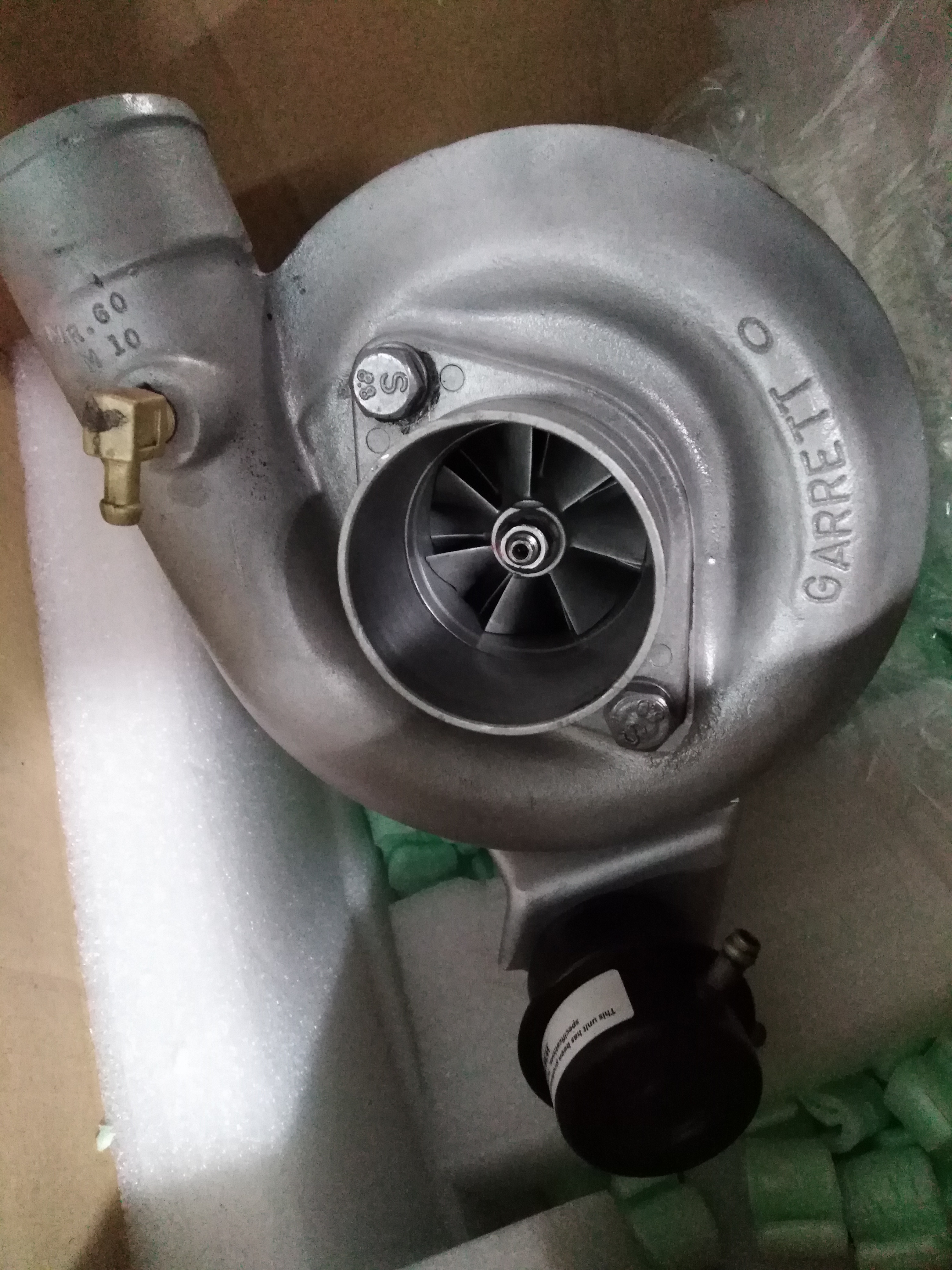

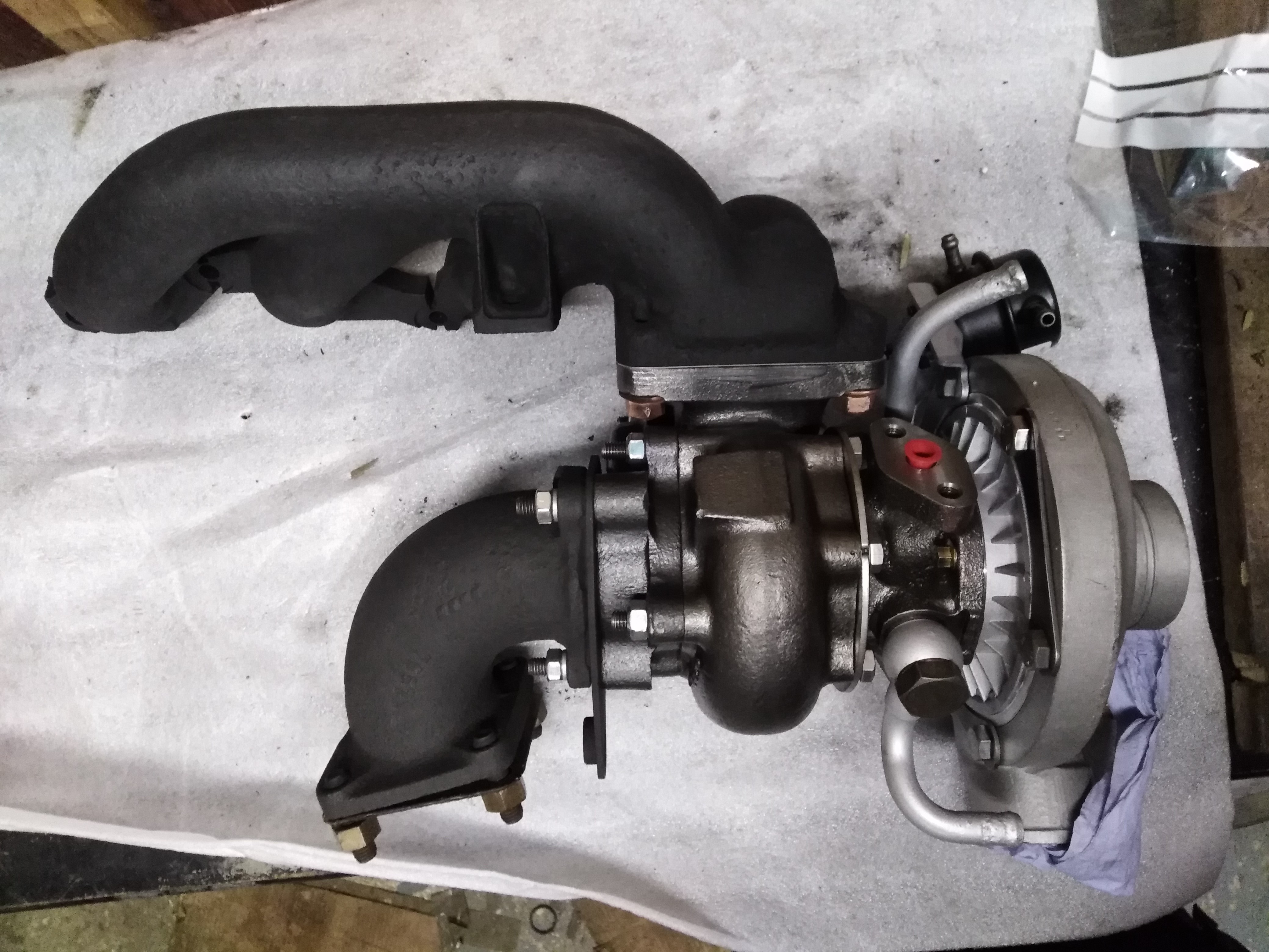

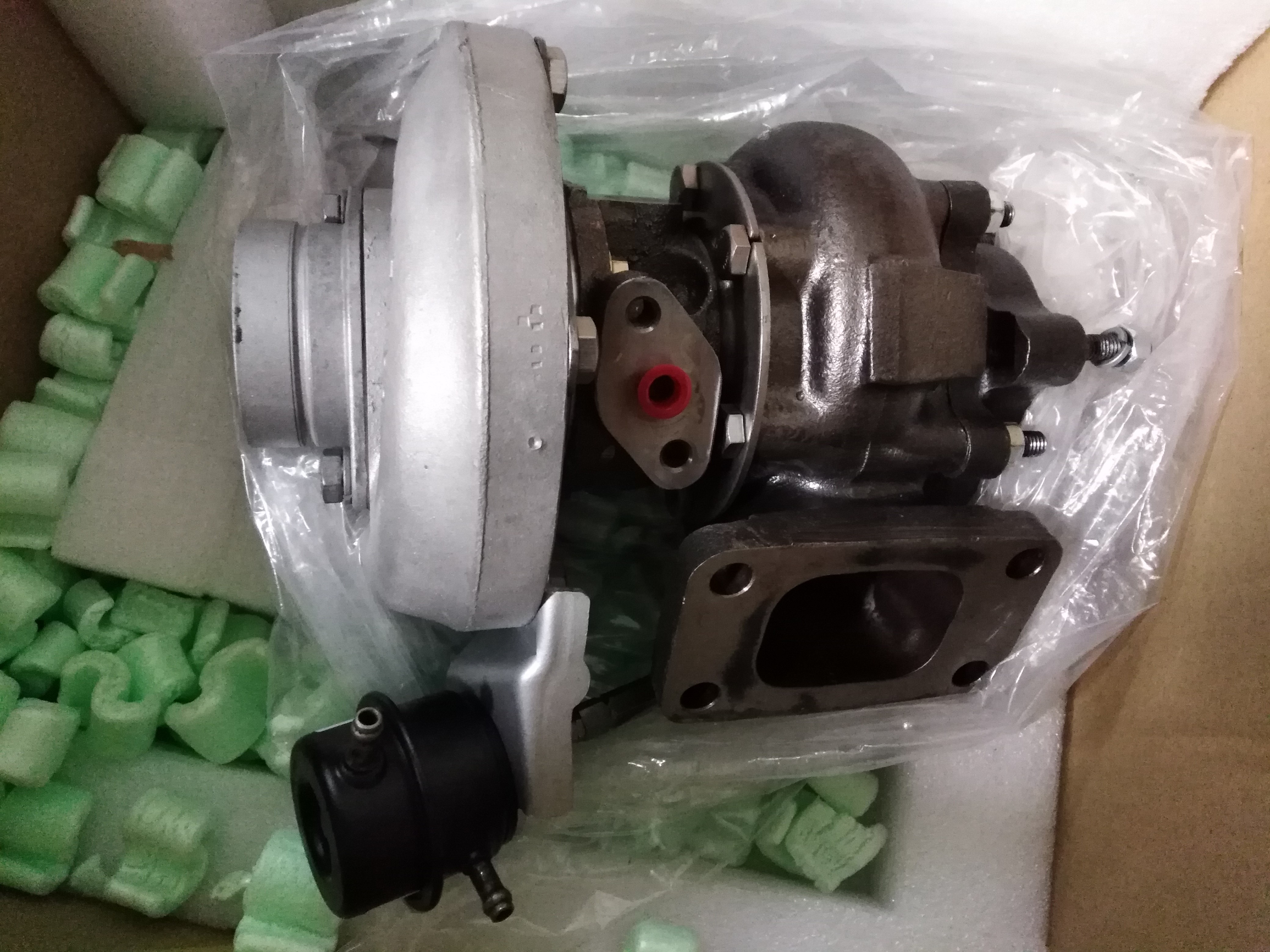

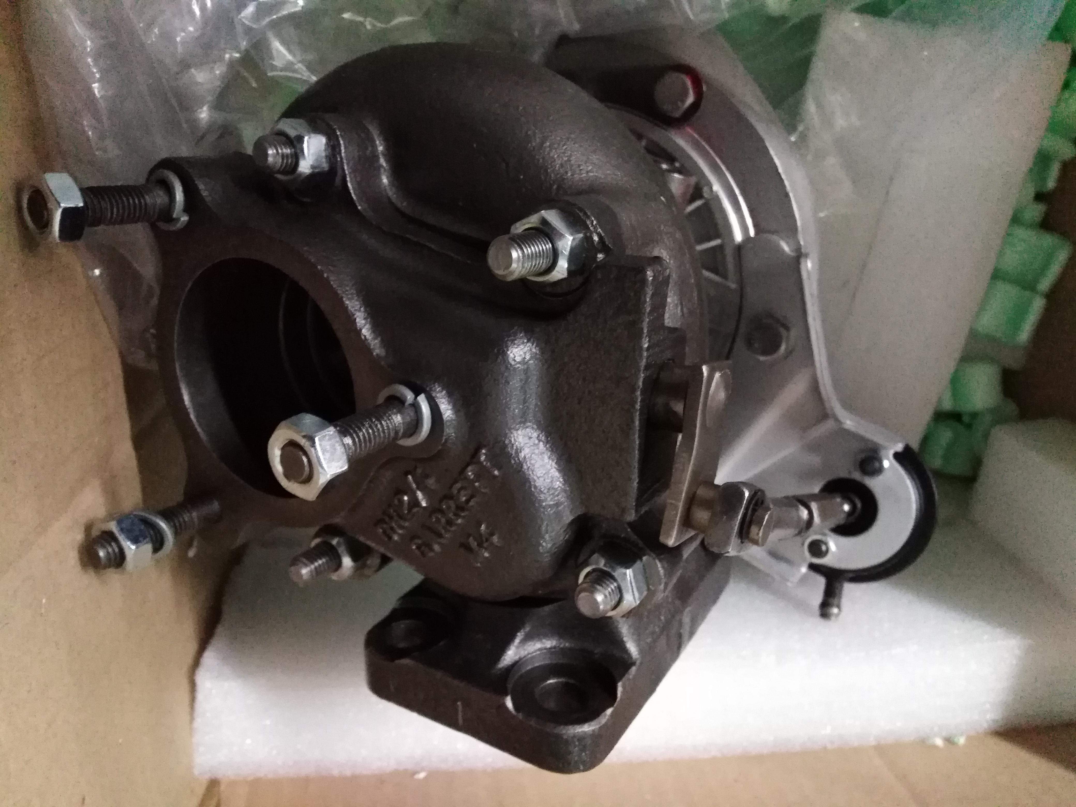

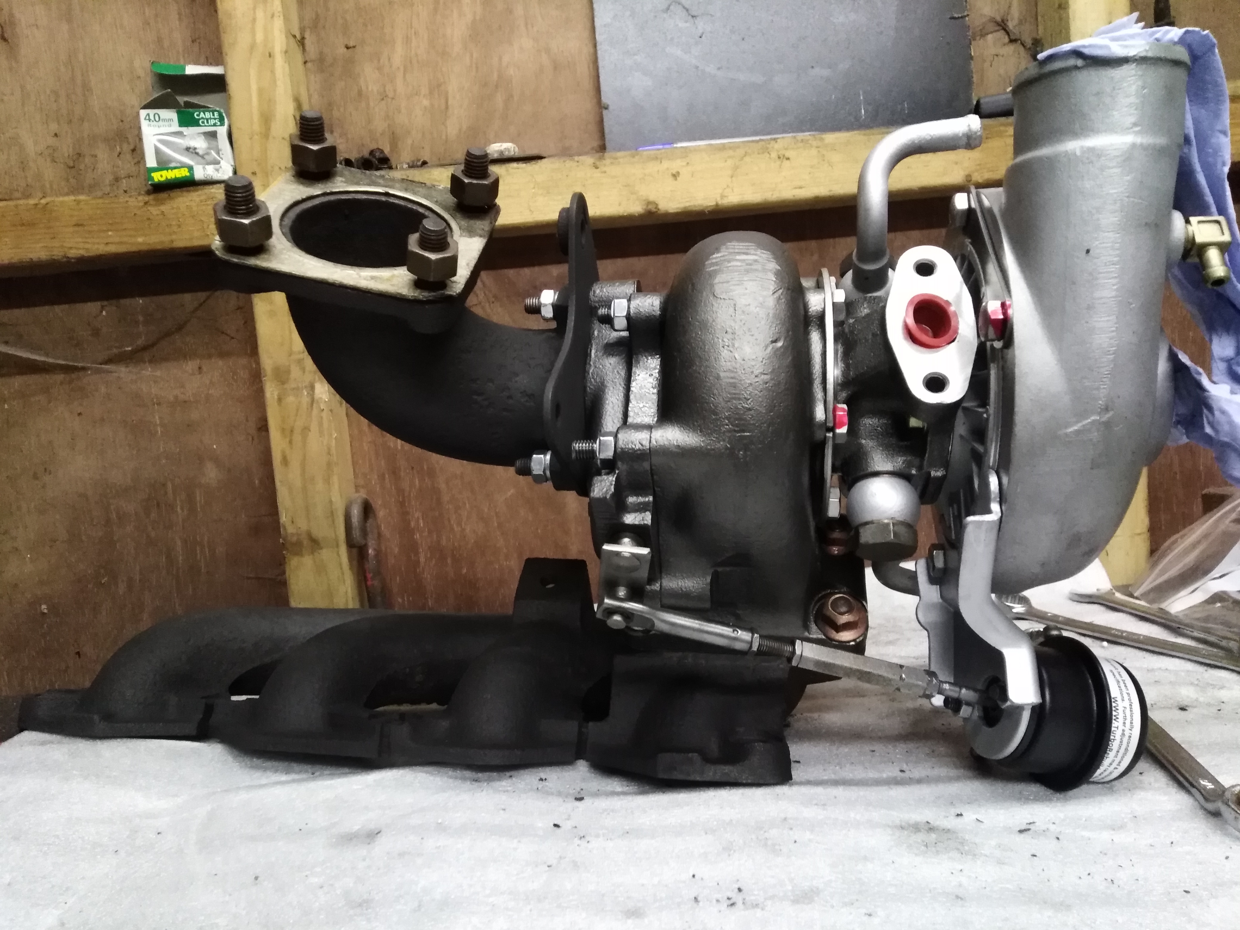

Postie arrived today bringing my turbo back to me, hoping to get near the end of the bigger bills...
I could have gone for a hybrid unit, bigger this and that but in the end I just got the original unit refurbished with a couple of upgrades. 360 degree bearings and step seals will allow me to fit a bigger exhaust in the future without causing oil blow by issues. It got a new bearing housing, all new bearings and seals, everything cleaned and checked, seized wastegate freed up and serviced, all high speed balanced and sent back to me for a shade over £250. Best price I could find an exchange unit for was £450 and that would be with standard seals and bearings so very happy with it.

KevJTD wrote:Postie arrived today bringing my turbo back to me, hoping to get near the end of the bigger bills...
I could have gone for a hybrid unit, bigger this and that but in the end I just got the original unit refurbished. 8-)
That looks nice Kev.
Hope to get on with my project soon. ;)
Yep looks good and that does seem a very reasonable price. Good decision.
Yes, really impressed with the service from them, British family run company and very knowledgeable and helpful.
https://www.turborebuild.co.uk/
I asked a few places and these guys ticked all the boxes, and of course the prices quoted were very reasonable indeed.
Getting it a bit future proof with the step seals seemed sensible.
I did think about going down the hybrid route but that's a never ending upgrade. Exhaust connections would have needed altering, then of course the turbo controlling would need adjusting to let it use the extra boost, which then leads to things like ECU upgrades, head gasket concerns, cam timing, clutch and transmission upgrades…..all for a few extra horses? I'm pretty sure it'll be enough as is

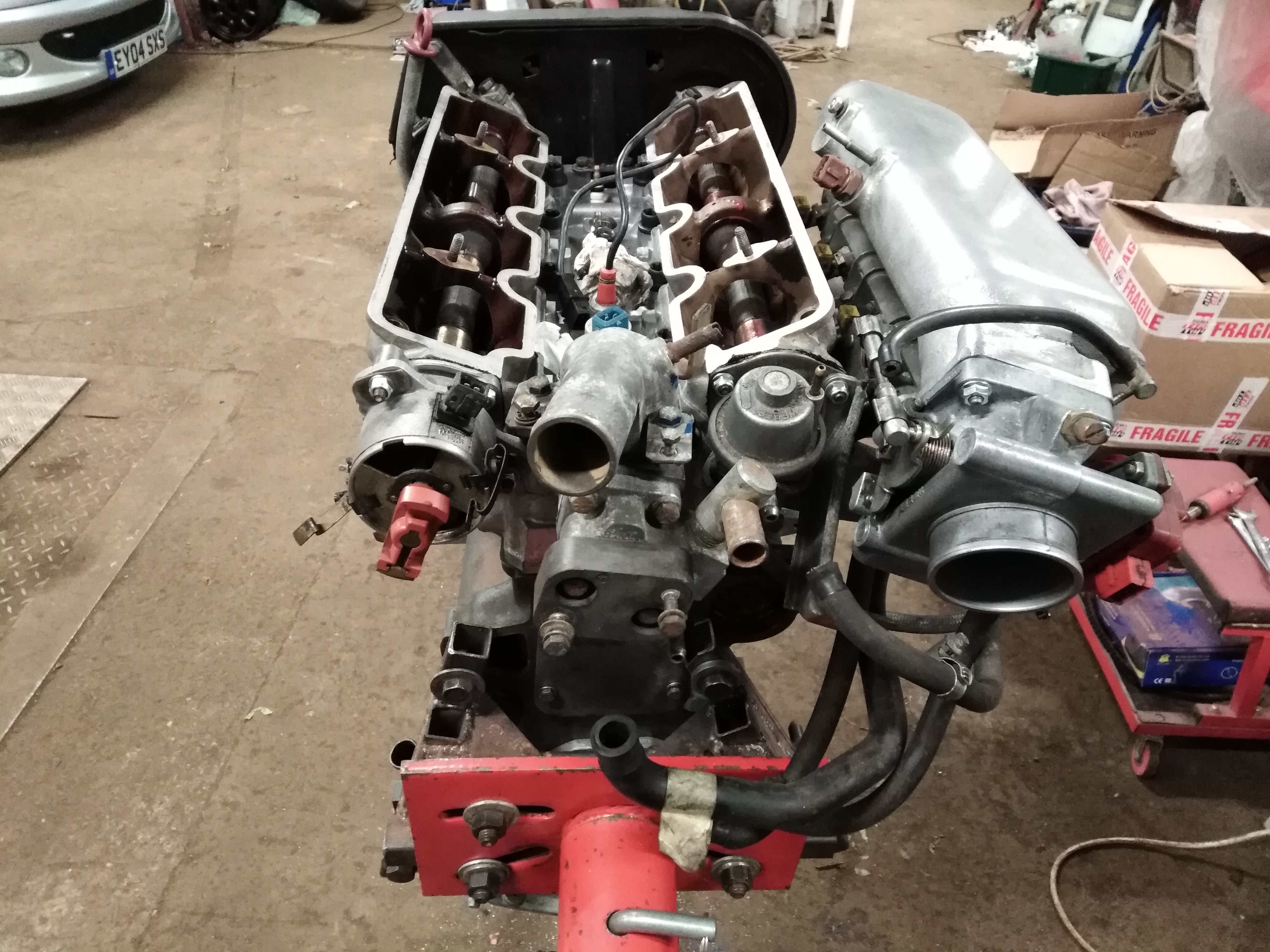

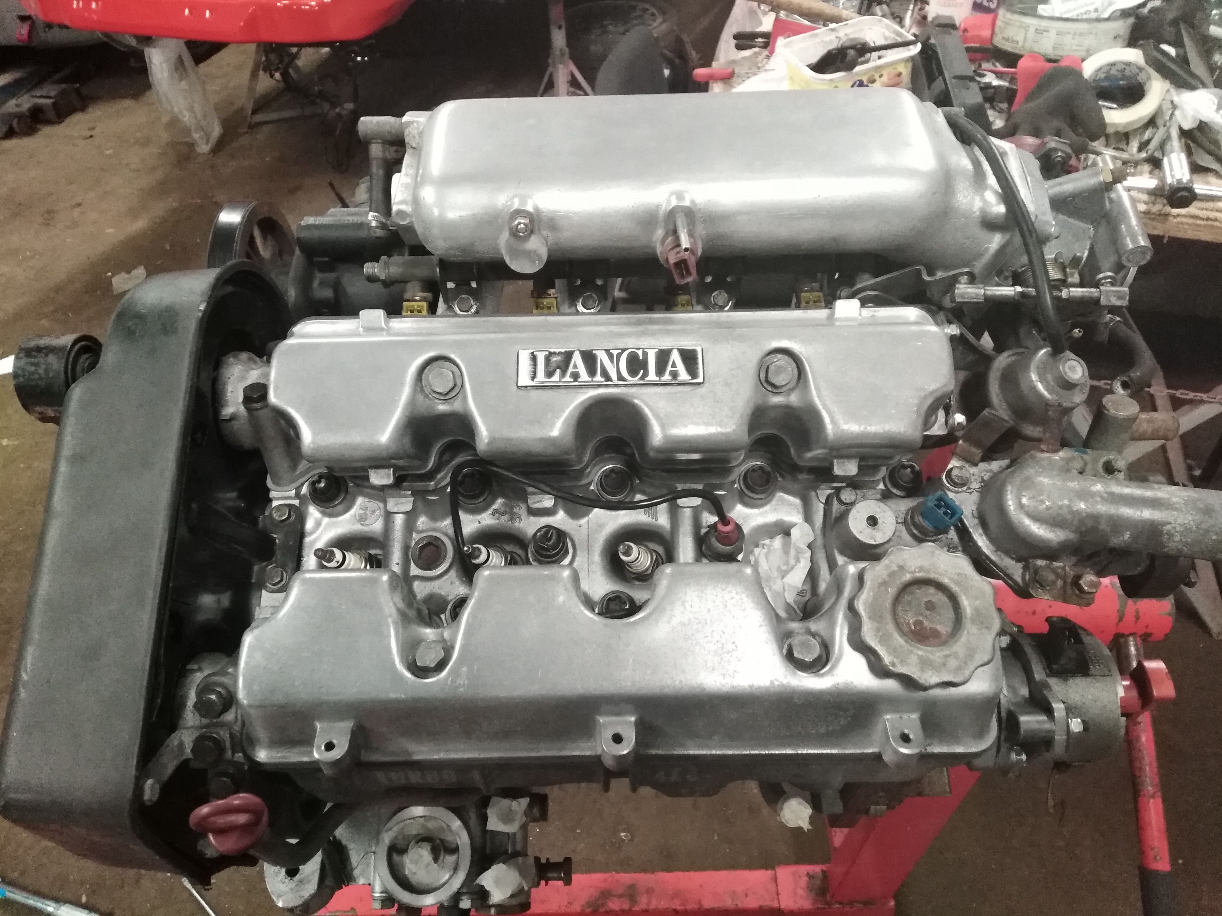

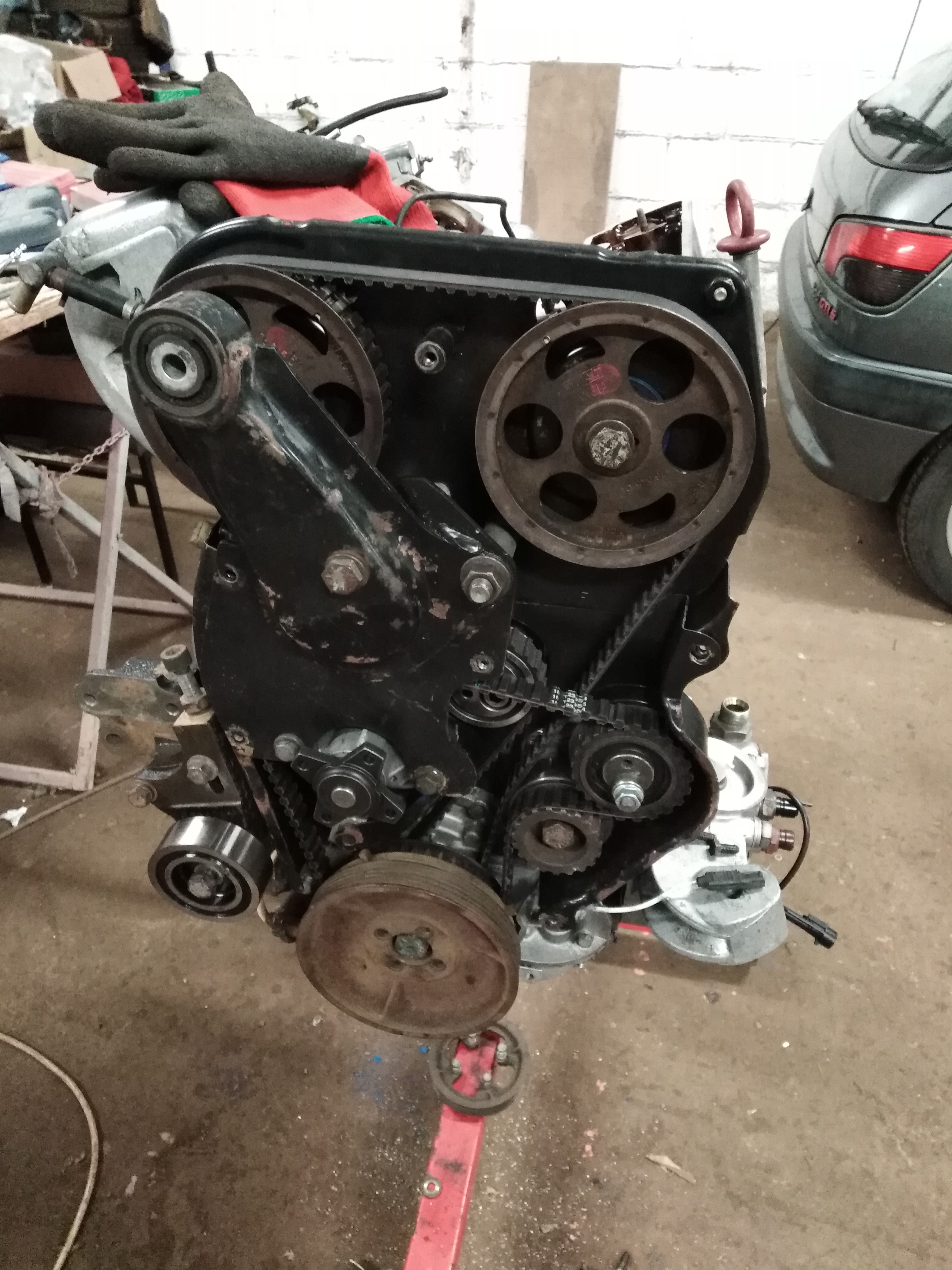

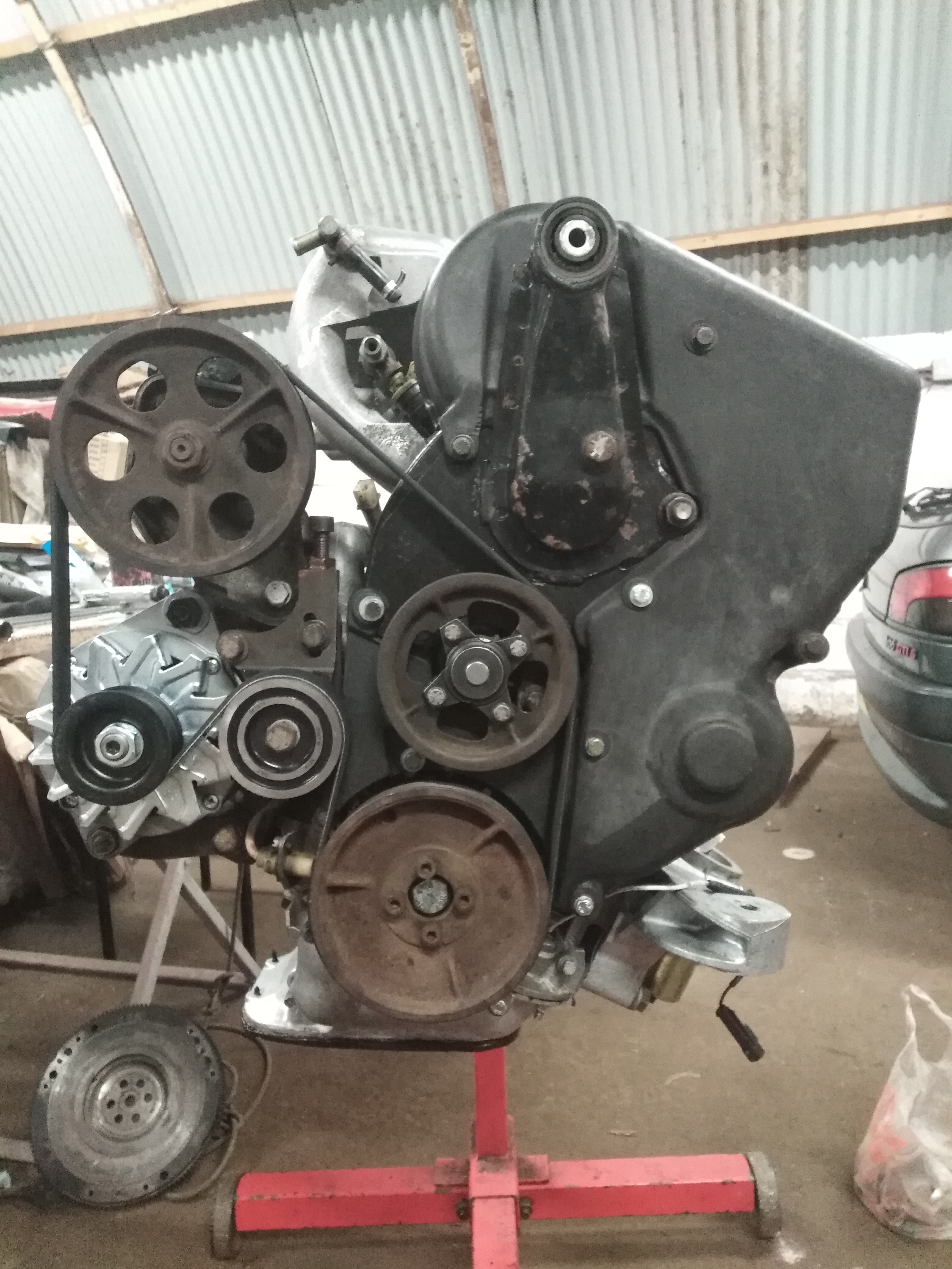

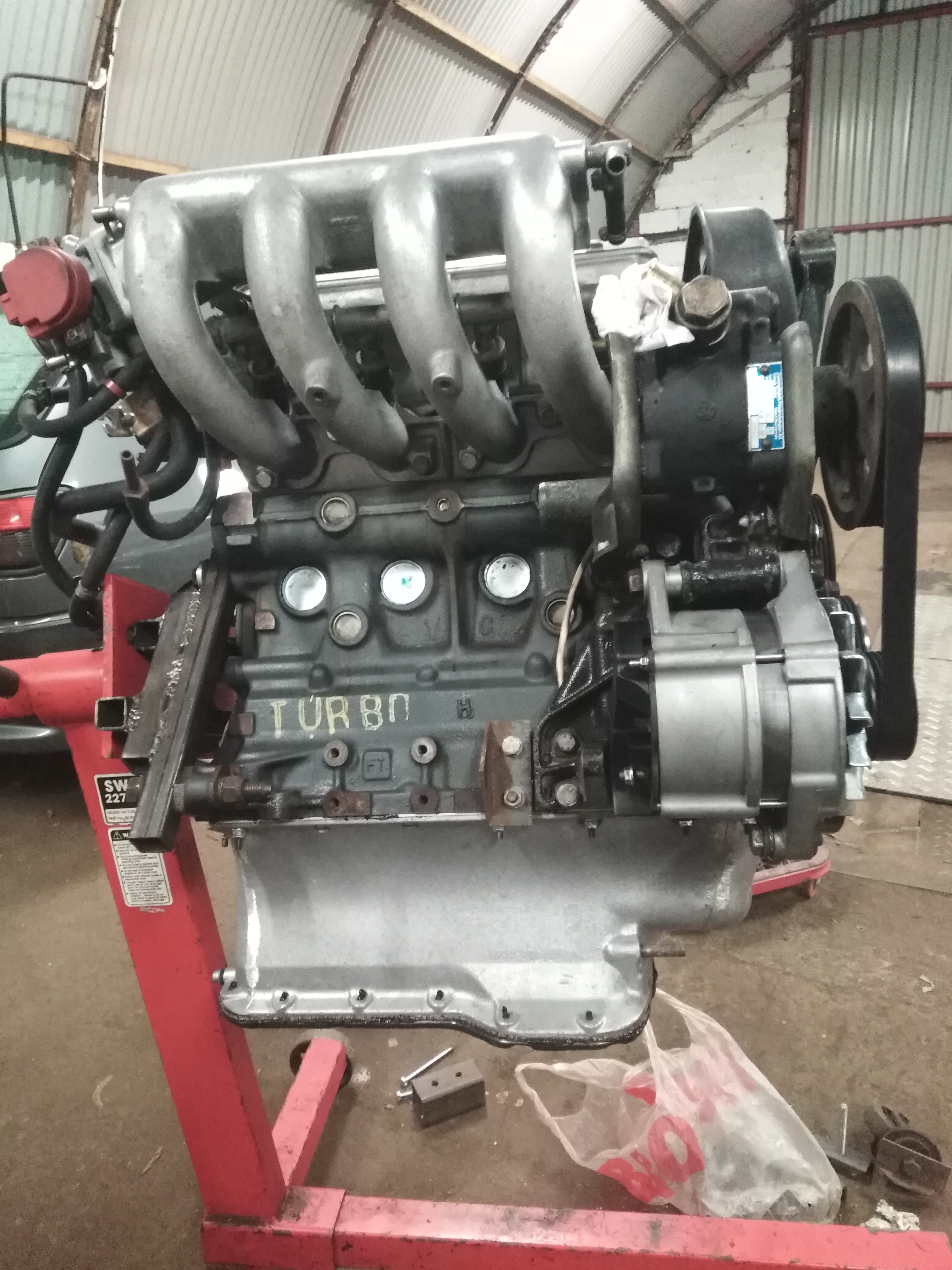

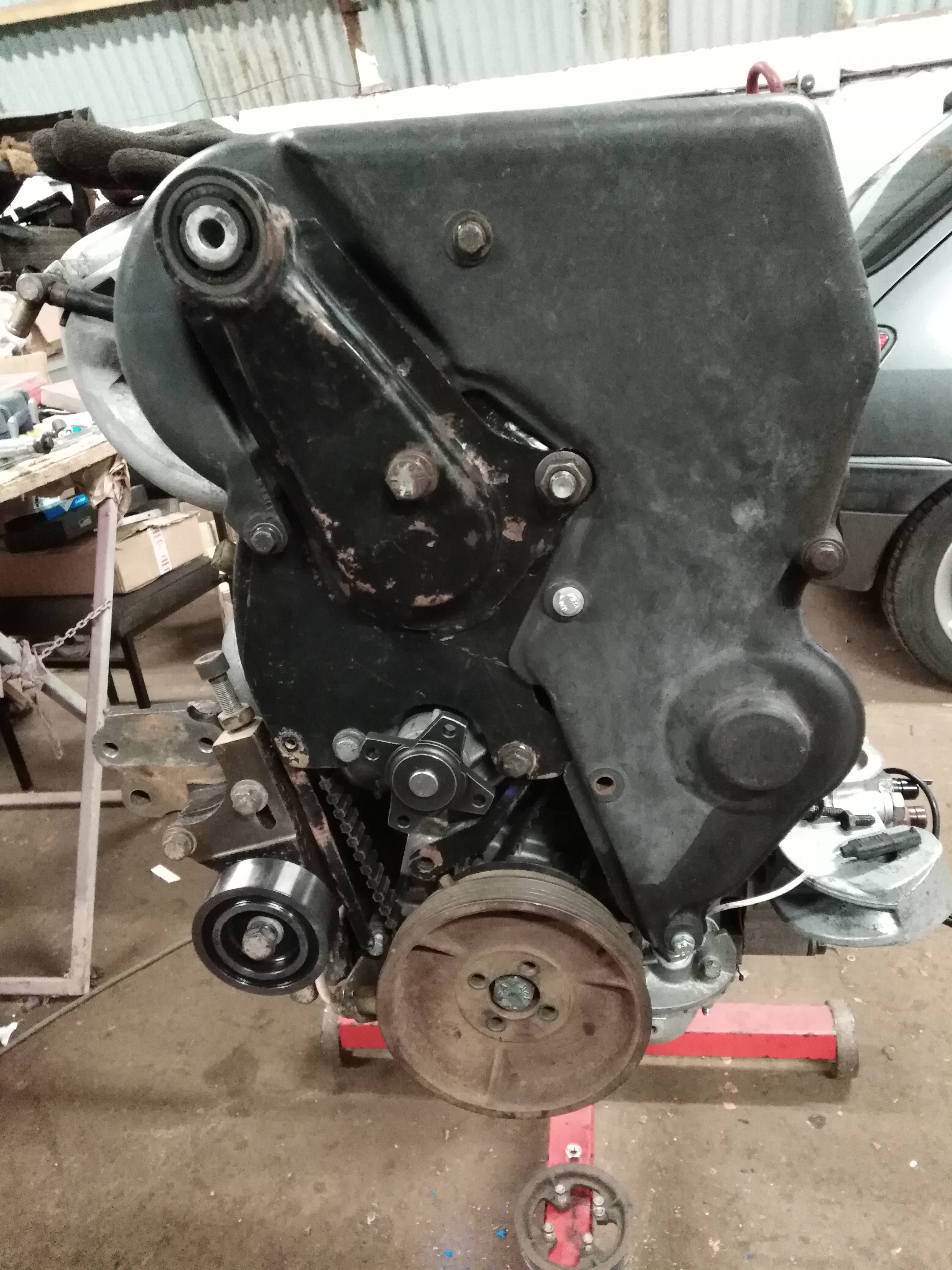

Got the engine fully back together at long last.
The lower sump gasket turned up yesterday so that was a simple enough job to fit.
I did manage to track down a new lower timing belt cover from Zagato Lancia in London after exhausting all possible sources for a used one, brand new Lancia one on the shelf was nice but £54 for a bit of plastic....still, cheaper than a stone jumping into the belt I guess
With the belts all safely housed the water pump pulley, crank pulley, freshly refurbished alternator and power steering pump could go on. That little guide pulley was another expensive bit, little more than a bearing but OE only, another £50 or so...parts are available for this car but they aint cheap!
Top end all sorted, cam covers only on loosely so when it comes to start up time I can pour fresh all over the cams before cranking over, there's loads of build lubricant on them now but every little helps.
I've started making plans now to get the engine off the stand and fit the flywheel and clutch back on, then the gearbox and transfer case can go back on. With the slanted engine it won't stand up on the sump, not that I really want the full weight of it one the sump anyway, so I'll fit some wheels to it on brackets I knocked up tonight. That will allow me to slide the assembly underneath without damaging the sump or the oil pickup.

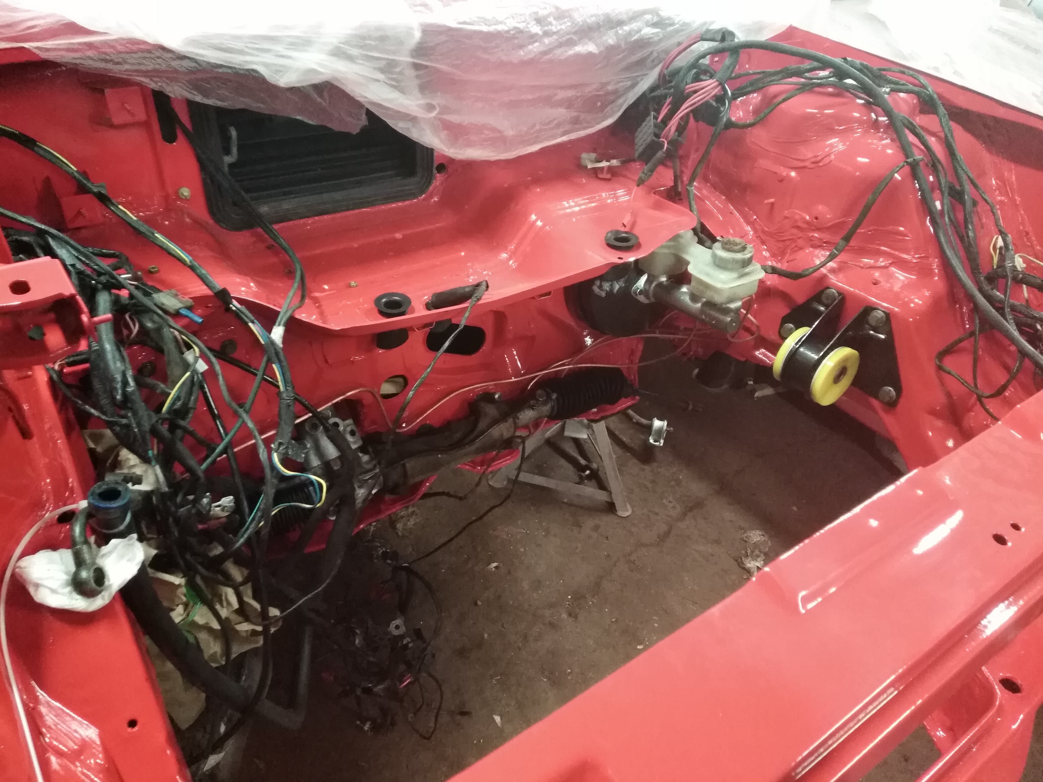

Started to get the engine bay ready now, master cylinder etc done, gearbox mounting with new poly push mounting ready to support the lot....anybody got any ideas where all these wires go? :D

Just looking at the brake servo and master cylinder I just can't help thinking 1, how low in the engine bay it seems to be and 2, with it on the left hand side must mean that there are some complicated linkage involved, as the pedals are on the right, which I guess are there already, so would it not have been an easy task to move to the right hand side at his stage and would it improve braking performance if you did? Just my curiosity really.

Yes, the master cylinder does sit reasonably low mate but not that much lower than most stuff, a lot of newer cars have higher reservoirs with pipes down to the cylinder, mostly they're on a similar level to the pedals.
There is a linkage system that transfers all the pedal movements across, not just the brakes but the clutch linkage also.
Can just about make it out here in this zoomed in picture...
Fiestas used to have a similar system, you can see the bulkhead flex on those when someone presses the brake..
Moving the master cylinder and servo over to the drivers side in theory wouldn't be too hard apart from the space it needs to occupy in the engine bay is taken up by other things, like the alternator and power steering pump! If you look at the pic of the engine built up the inlet manifold sits almost against the bulkhead lip, the power steering pump underneath it, where in theory the master cylinder would need to be.

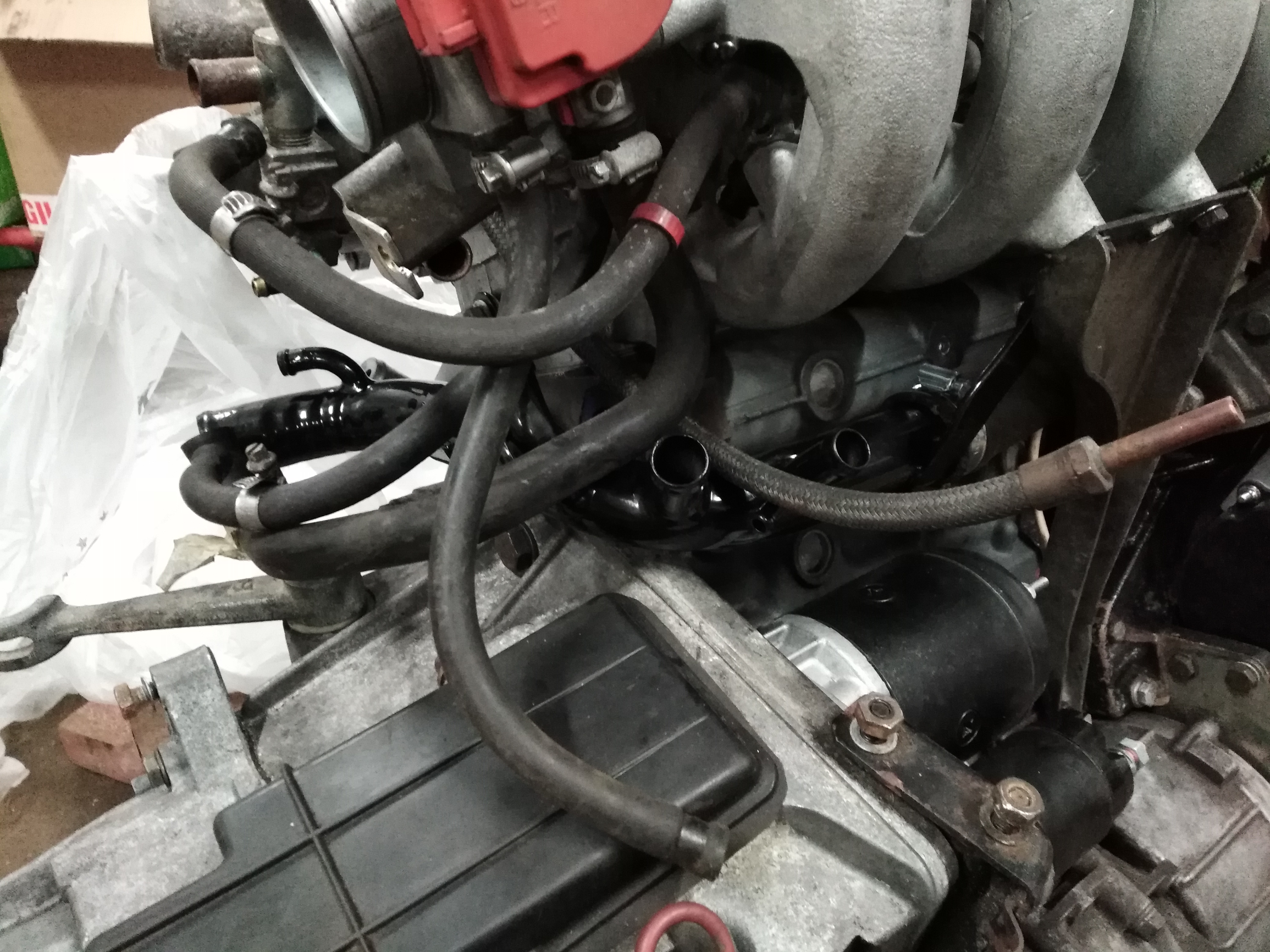

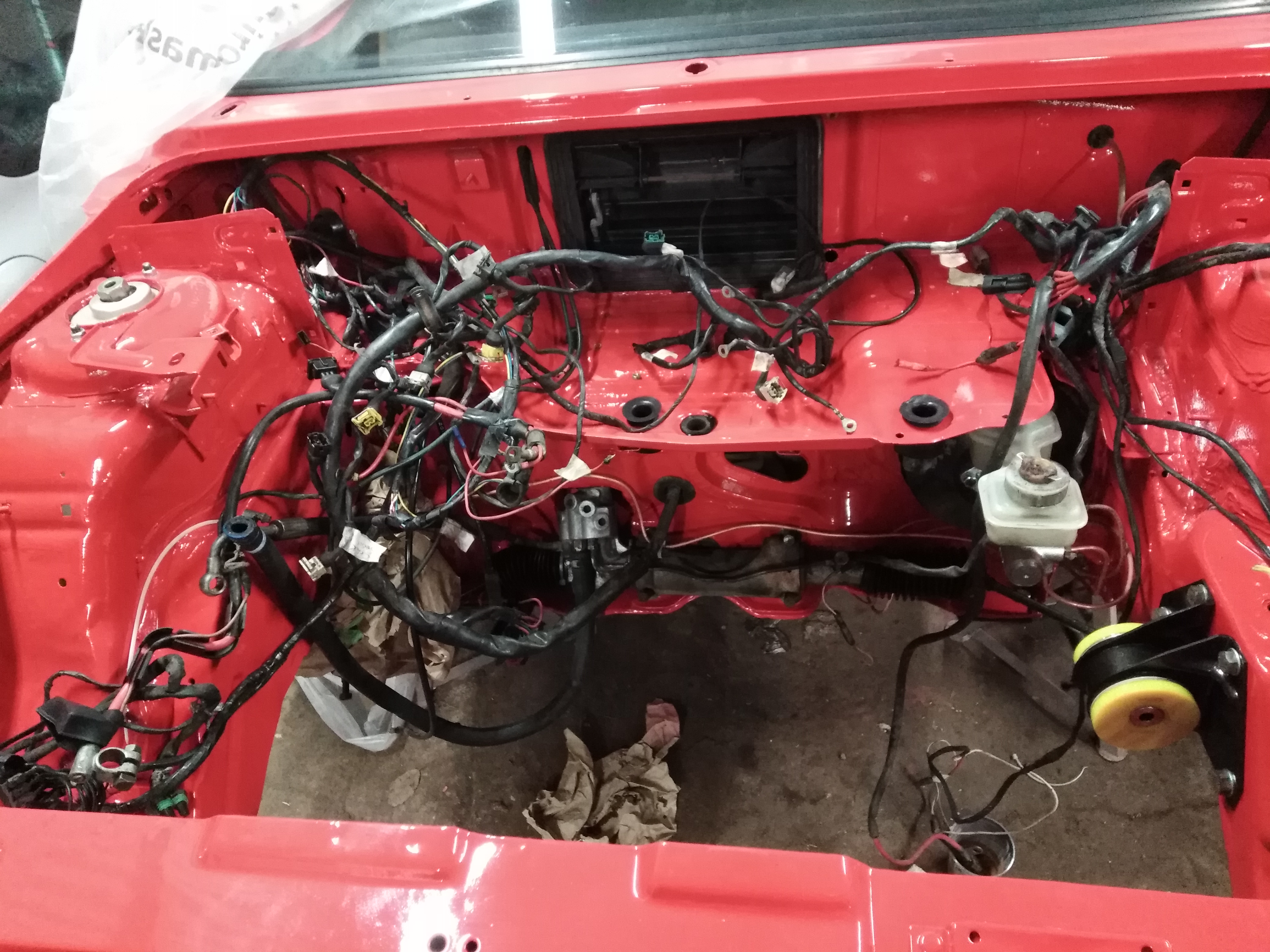

Ticking along...dawned on me that despite there being an abundance of wires already waiting to find home I still hadn't got things like the Injector connections, or anything much else engine related.
The ECU with it's wiring loom was sat in the car so that went in with the wiring loom to it running into the centre of the car, did kind of wonder what the big hole above the steering rack was for!
Thankfully though that meant I could follow and locate most if not all of the connections so much happier that I'll actually be able to connect things up...
The exhaust manifold and outlet elbow looked decidedly rusty with the freshly refurbished turbo to bolt onto it so although I've resisted going down the route of painting everything I did think a coat of manifold heat resistant paint wouldn't be a bad thing...
The water connections I'd already cleaned and painted again with high temp paint so with a fresh gasket and new self locking exhaust nuts I got it all back together.
The oil pipe connections are also painted but as the turbo has been assembled with oil within it, held back by the plastic bungs, I'll wait until it's on the car before they go on.
Fingers crossed I'll be able to reunite the engine with the gearbox and transfer box on Saturday then with my day off next Wednesday I aim to get the lot lifted back into place....

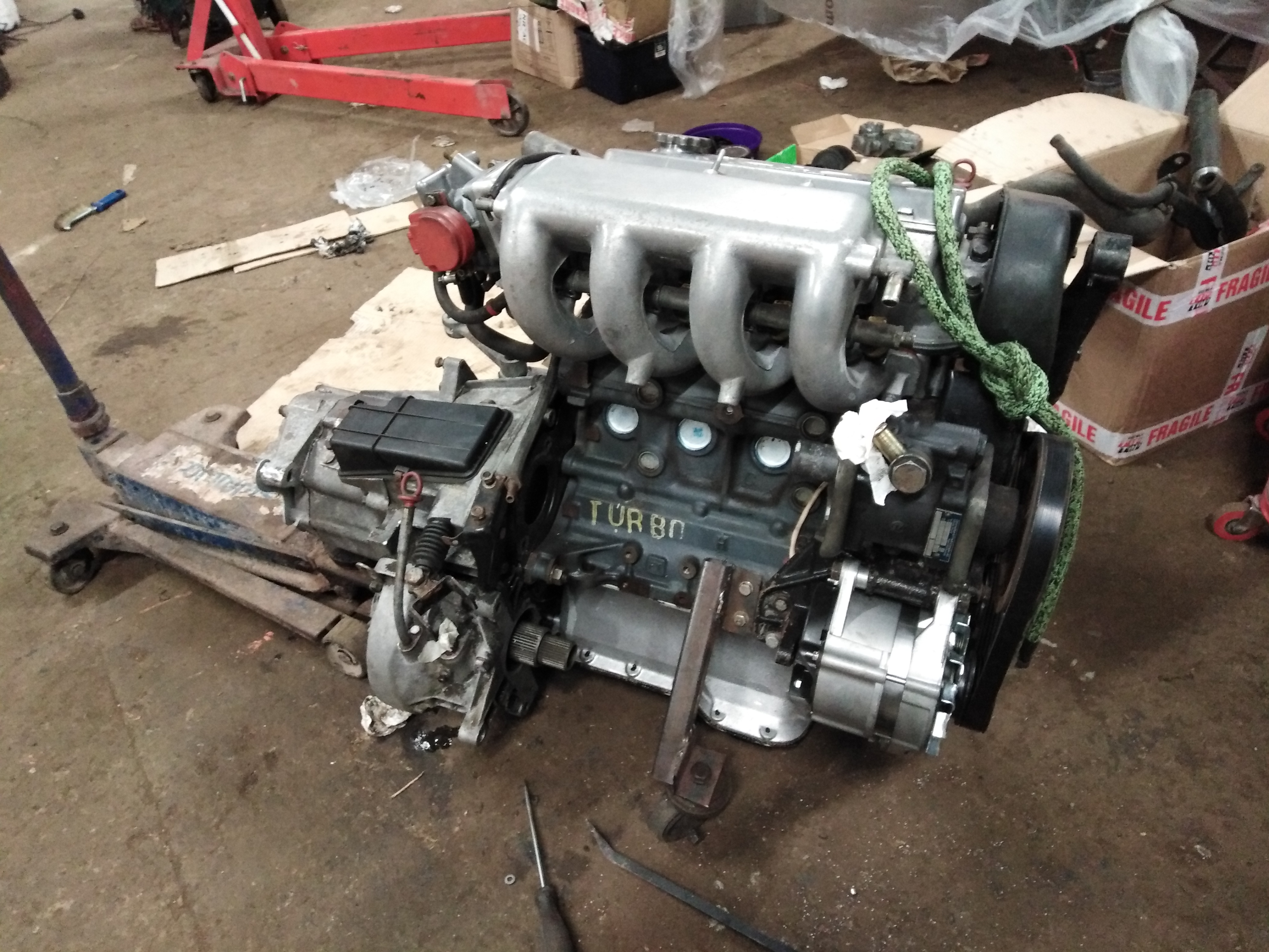

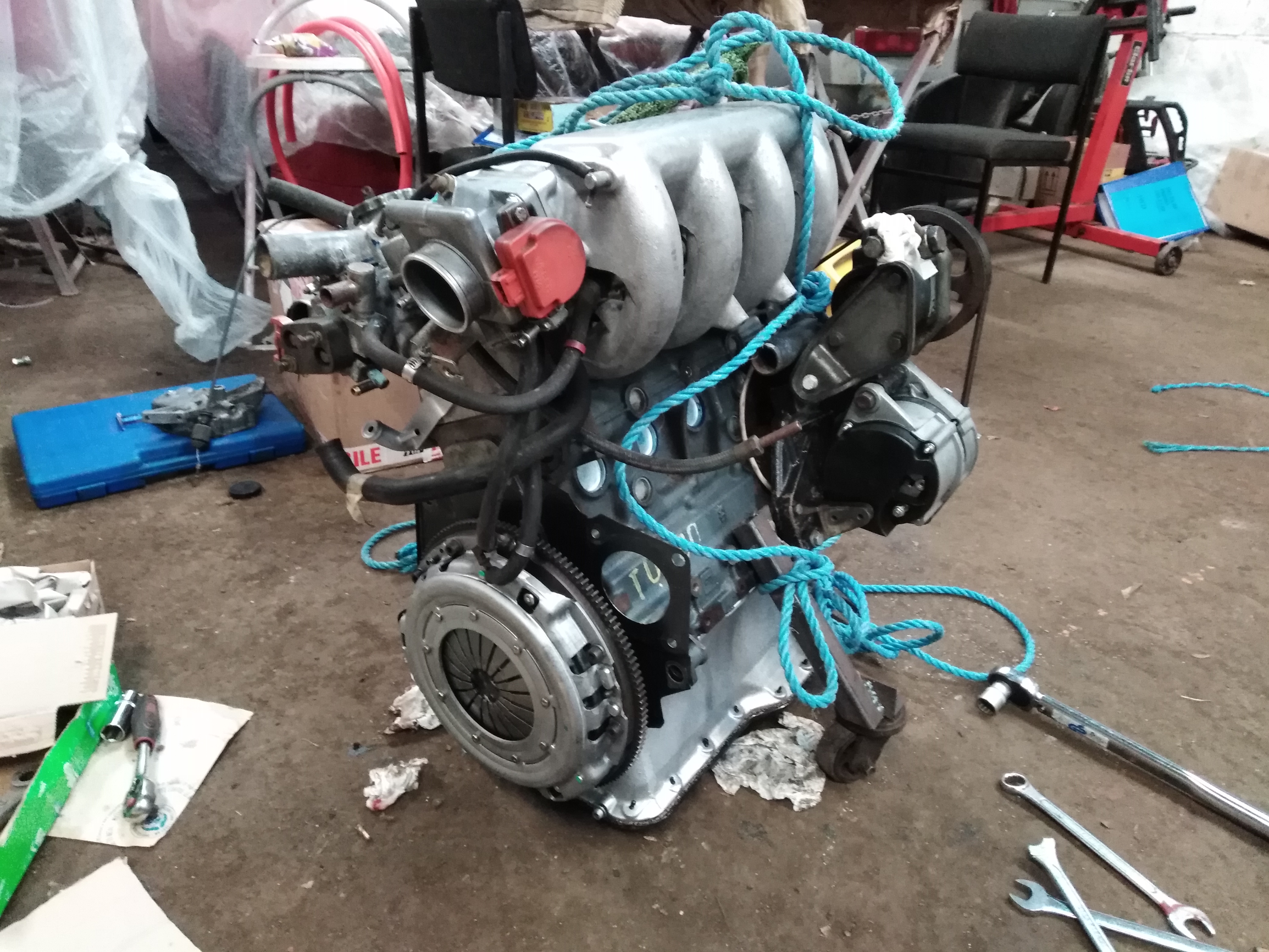

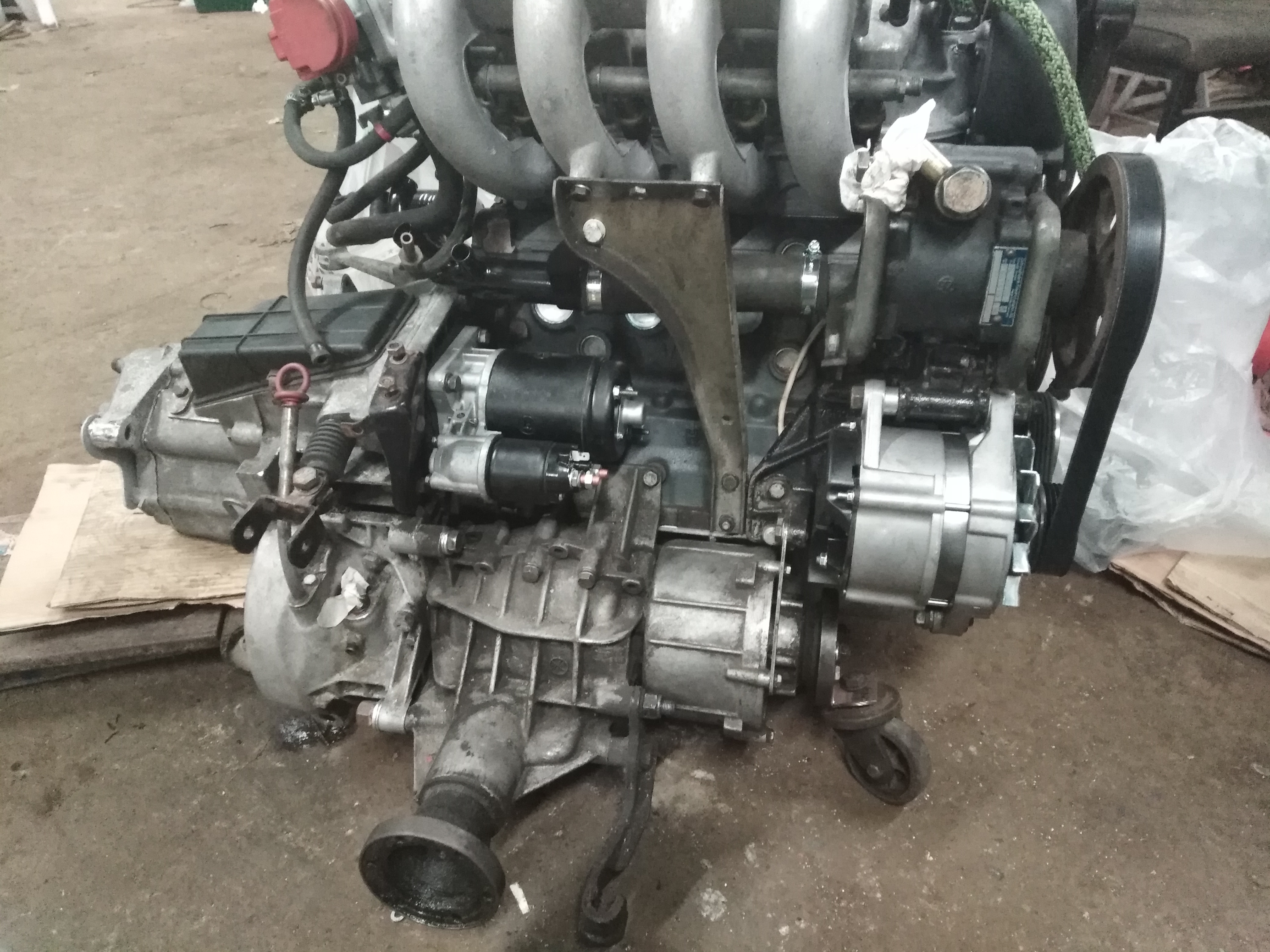

The engine is now off the stand so the flywheel and new clutch could go on.
Gearbox then needed the bellhousing cleaning out of years of clutch dust mingled in with some gearoil, a right mess!
New release bearing sleeve went on which holds the new input shaft seal. The old one had silicon sealant under it which is a sure sign of a previous leak, which I doubt was cured!
As Rob was still up at the unit I got him to help me slide the gearbox on.
Had to remove it again as I'd not fitted the lower half moon plate that goes between the gearbox and engine, unlike every other car it needed to be fitted to the engine first despite being bolted to the gearbox, fitting with gearbox in place was impossible!
Got the transfer case and its' new seal ready to fit, sorted out the bolts etc, apart from I couldn't find them all...must be here at home somewhere..
Then spotted my error of fitting the stabiliser leg completely in the way of the transfer box.
Had hoped to have everything ready to wheel under the car for Wednesday but little stumbling blocks keep halting progress...

Good to see a strong rope on that expensive engine. Keep battling and posting I am enjoying following this as the agony misses me completely. :lol:
Good luck to you. :D
Yes mate, nice strong rope doing its' job 8-)

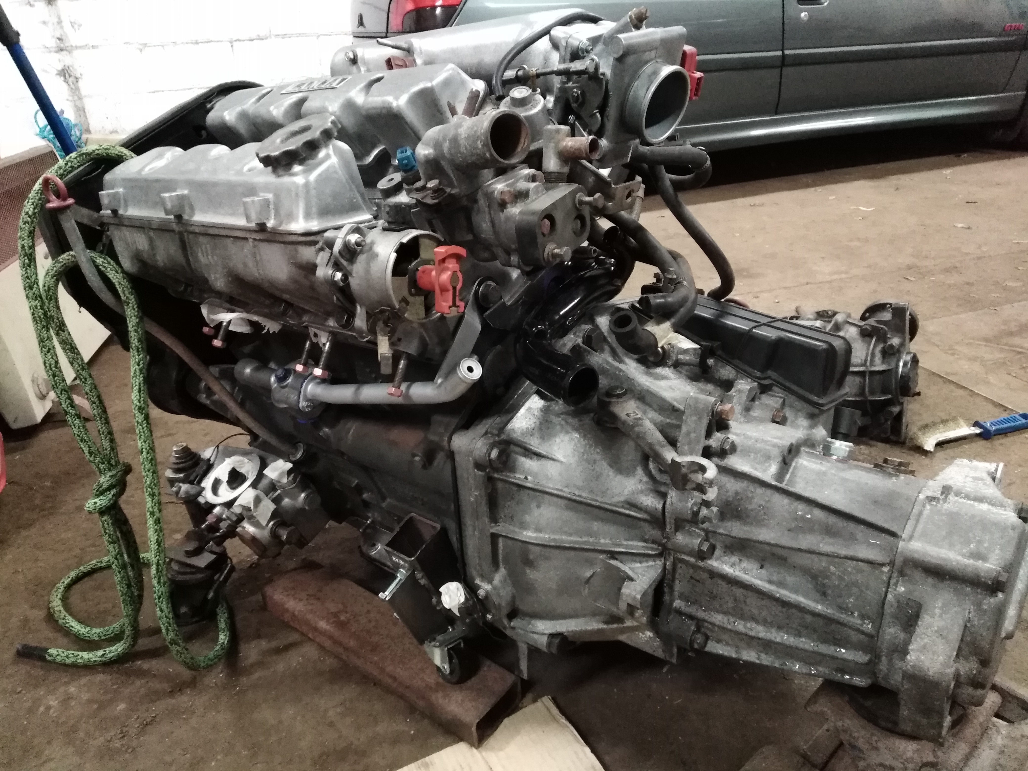

Decided that instead of a Sunday afternoon in front of the TV I ought to go have another look for the bits up at the unit, now I'd exhausted the loft and shed stores!
I fund the coil and a few other bits in the little spray unit, the integrale has only been in there as an almost bare shell for painting so how they ended up there I don't know, probably parts still in the car when it went to Jims' and then up to the unit.
The idle control valve plus the associated pipework for the intercooler etc were actually up with the car in a box, I found some new Samco hoses in the loft too which came with the car, bright blue so undecided on using them at the moment..
Still feel the bolts for the transfer box have disappeared somewhere but I found enough to do the job.
With everything cleaned up and ready to fit I tried to slide it all on but another own goal, the studs I fitted into the sump instead of bolts protruded down enough to foul on the transfer box to prevent alignment.
With the few threads cut off it all went on nicely at last.
Starter motor and support bracket on, new driveshaft seals so it's just about ready to be slid underneath the car for fitting..
The metal water pipe that runs behind the engine had rotted out on the original, I was lucky to find a very good used one which I had powder coated to ensure it lasts!
It really is quite a lump to be lifted up, not a chance in hell it would all go in from the top which I already knew, but there's some heavy lumps to be lifted into place...hopefully on Wednesday...
I don't like to do much work on a Sunday as you don't get a break but I'm happy I did this today instead of leaving it, not a bad weekends progress really despite the searching for parts!
