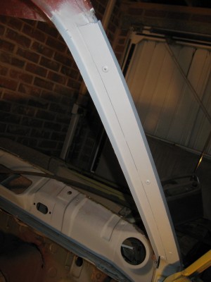

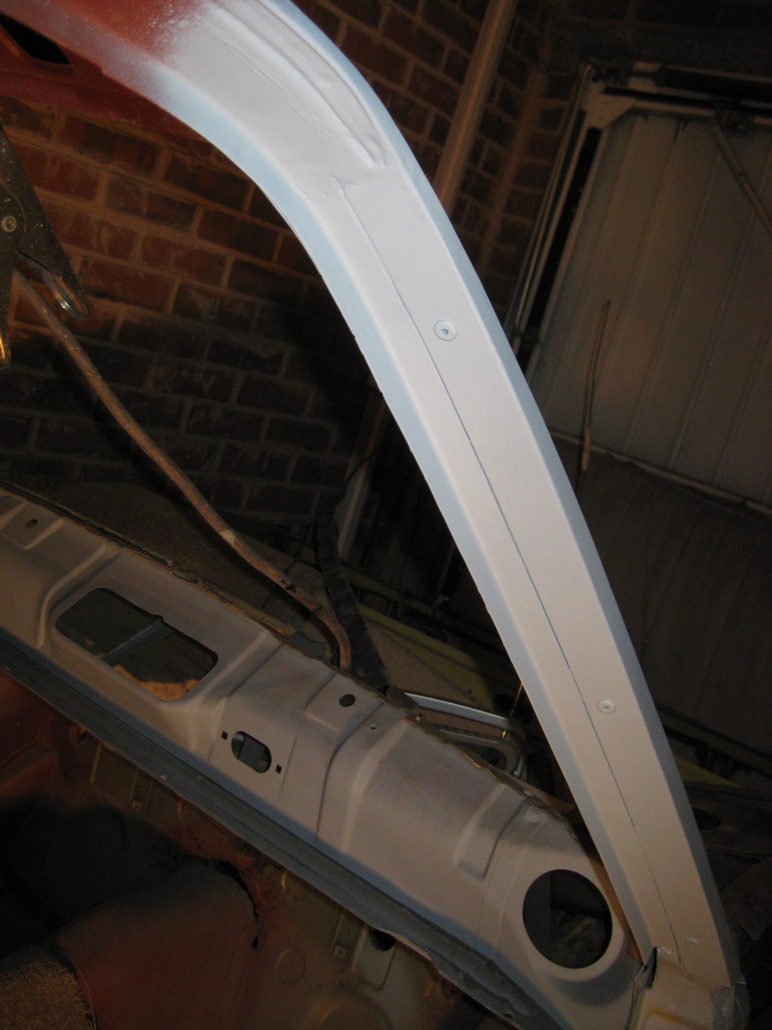

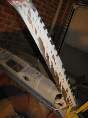

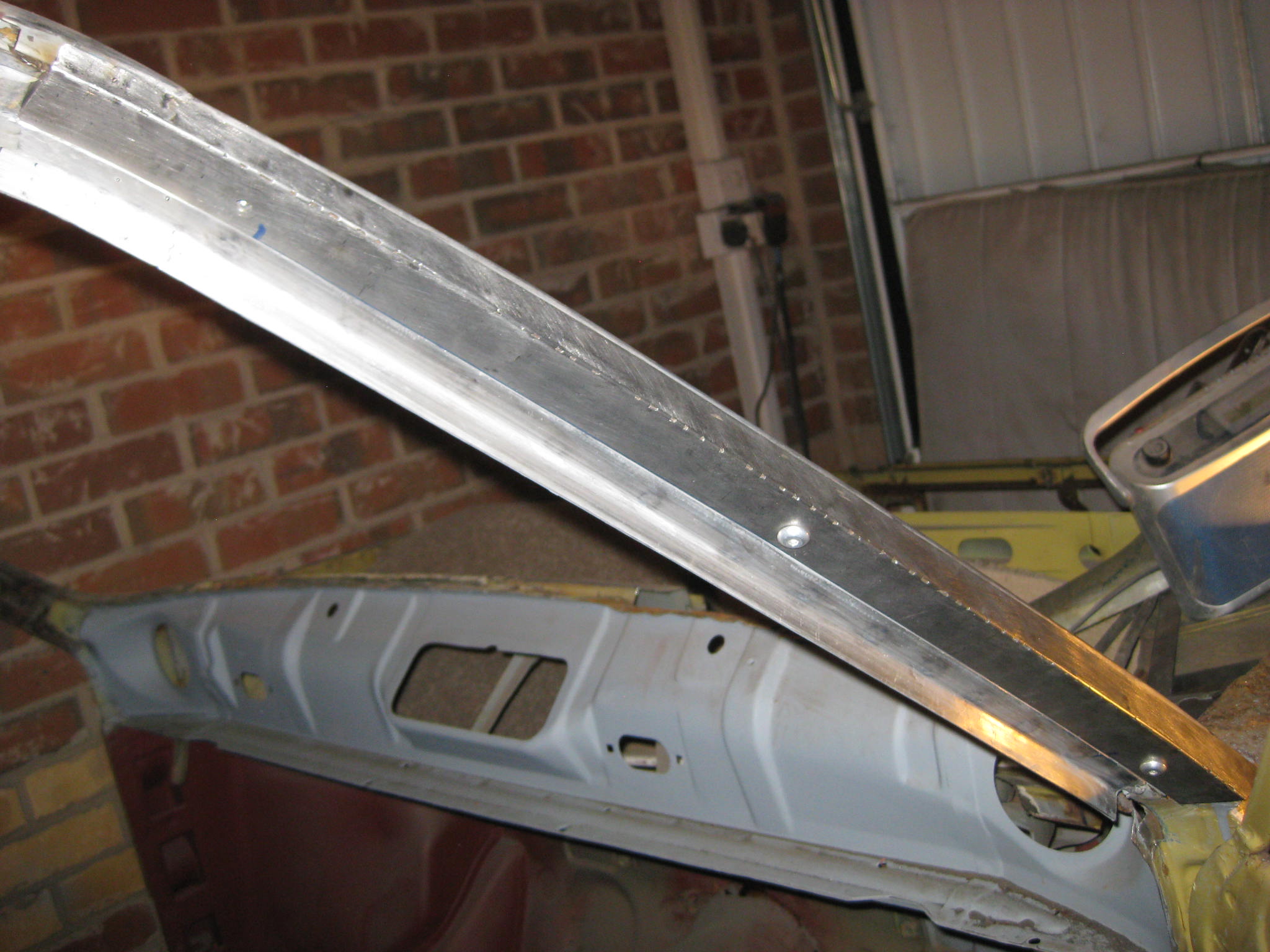

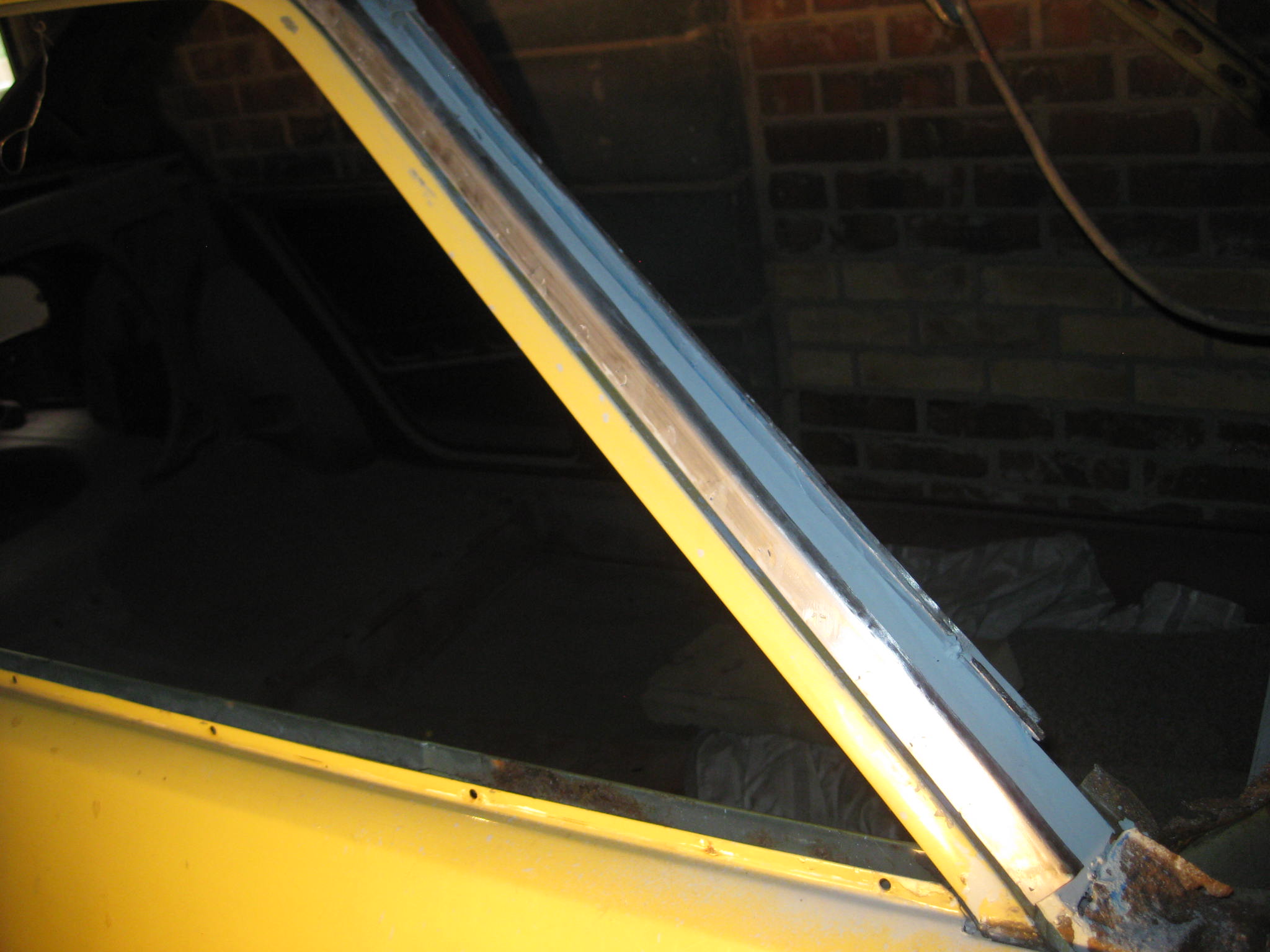

I managed to get a bit more work on this windscreen pillar over this last week, so here is an update......
I have made up the outer vertical section, welded it in slowly to prevent any distortion which is the problem with these type of areas, I usually use a wet rag to help to take the heat out of the metal after welding.
Then I spayed a load of etch primer in from the inside of the pillar while I still had good access knowing that some would burn off but not all especially if the area is cooled straight after welding, I then cleaned it off from the outside.

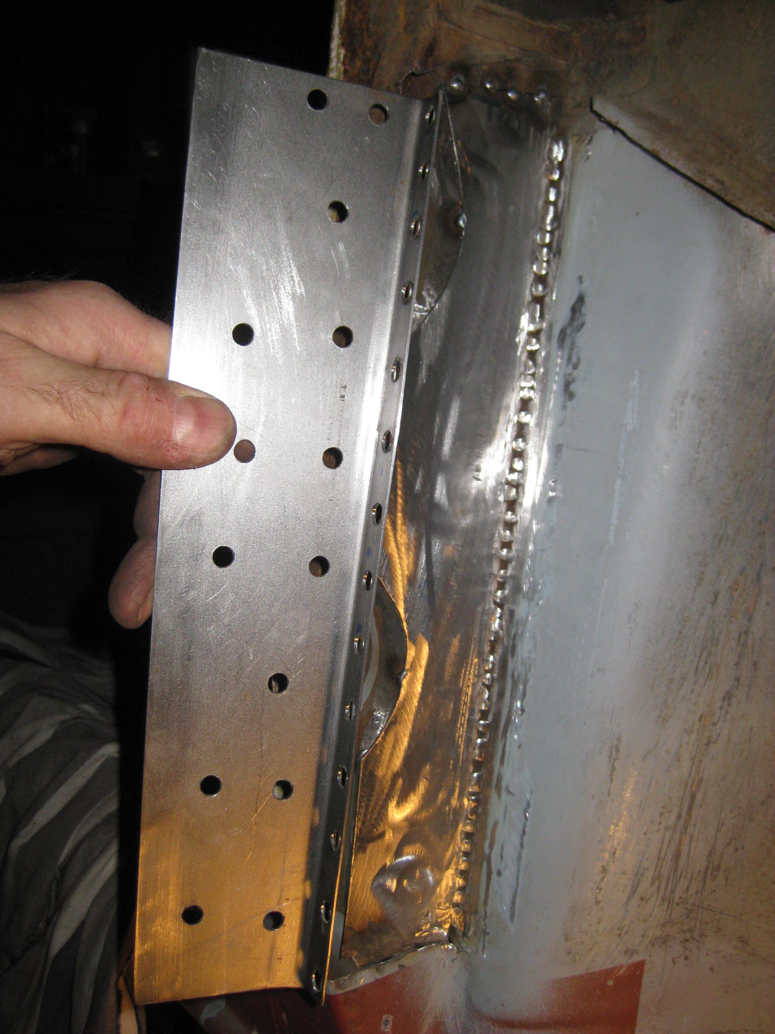

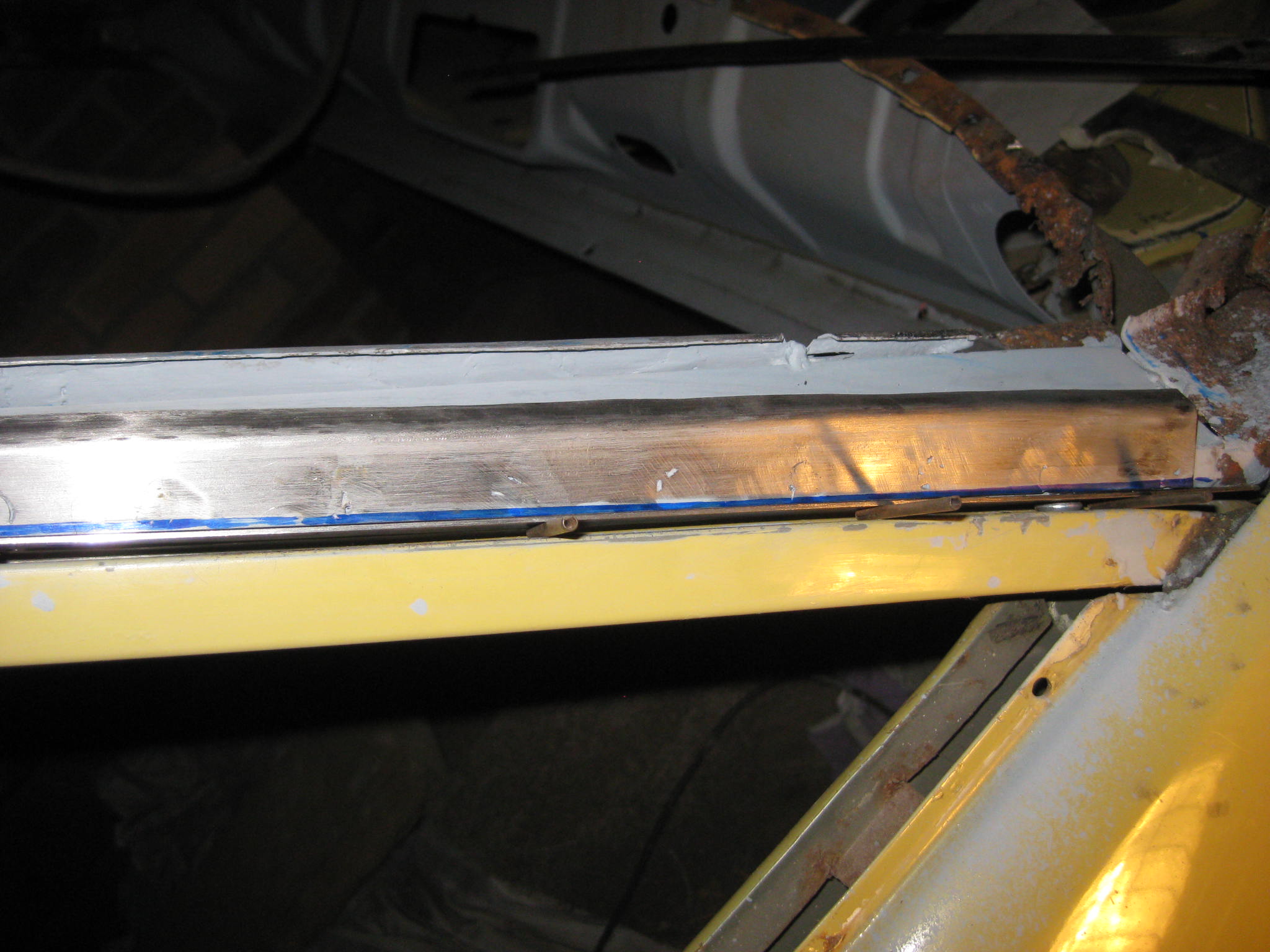

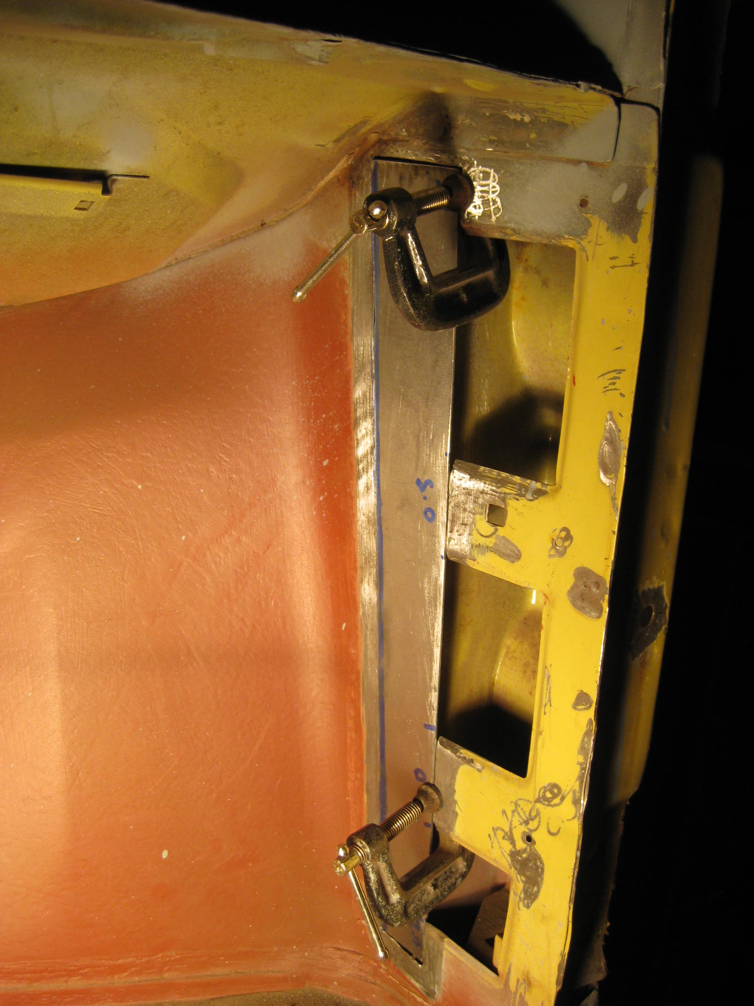

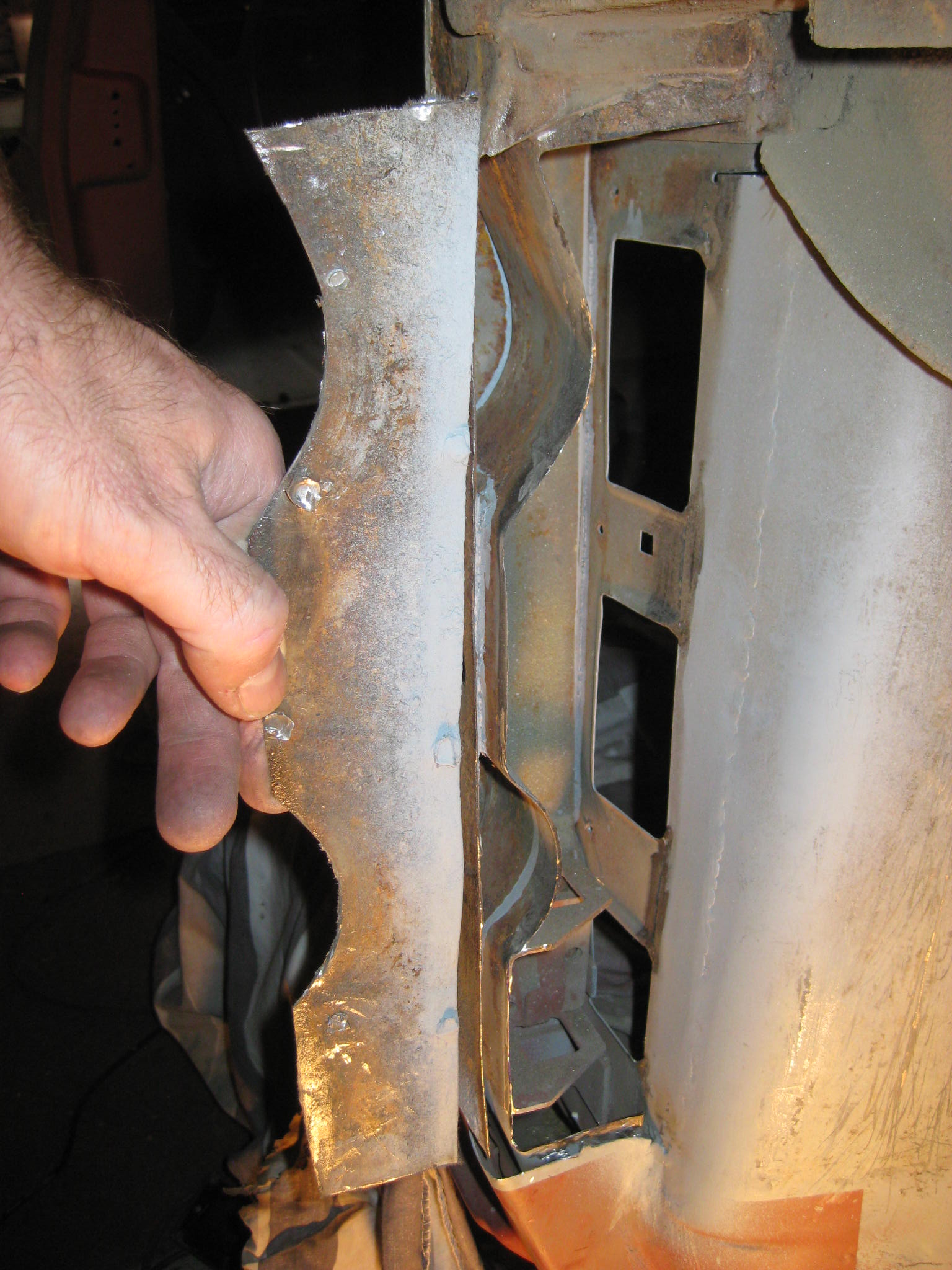

The next job was to make up that outer pop riveted on closure panel which was a complete nightmare due to the shape
I made this in 2 pieces
The next photo shows the inner flange in place and some spacers in place to maintain a door gap....
- Posts: 433
.... and the outer flange that I had already made up was tacked on and when I was sure it was correct more and more tacks were added from both sides and the panel was cooled as I was doing it with the old wet rag method
...... and after about 4 hours of of bench work, linishing back the welds, filing the welds etc. I ended up with this:
- Posts: 433

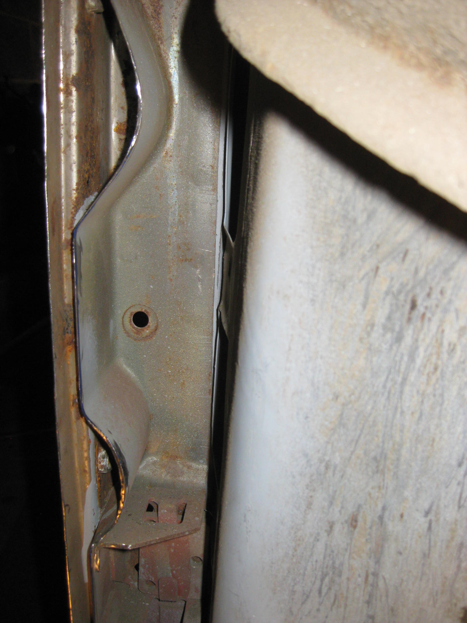

Once I was happy with this I added some etch primer and then some sealant and pop riveted it into place as it left the factory
- Posts: 433
Looks good, the next photo shows the outer edge.....
If I told any of you how long it took to make this panel up and get the shape right no-one would believe me......

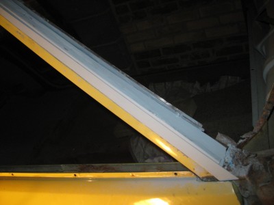

The next job is to complete the top of this panel to the roof in the rain gutter area and the front face of the pillar
I have now made up and fitted 3 of the 4 sides of this pillar and the inside strengthening panel so I'm getting there!!! I think

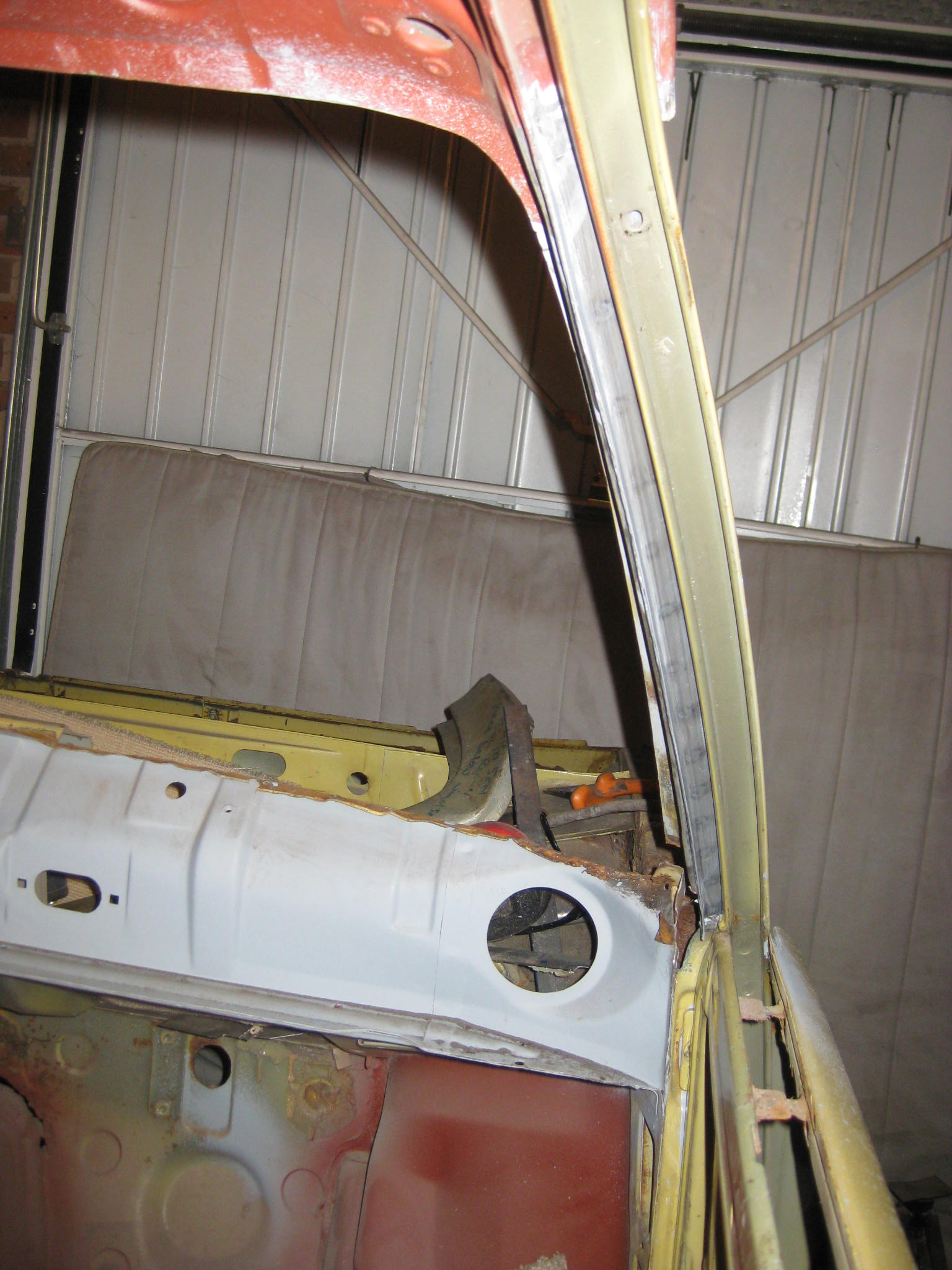

Ok chaps....
O/S front screen pillar work is now complete......
- Posts: 433

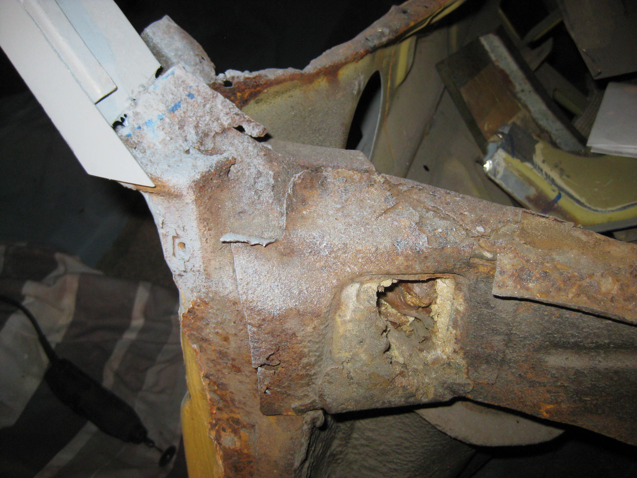

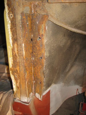

The next problem now is that there is nothing to fasten it to at the bottom, the pillar is currently tacked to badly corroded metal which will all need replacing.
- Posts: 433

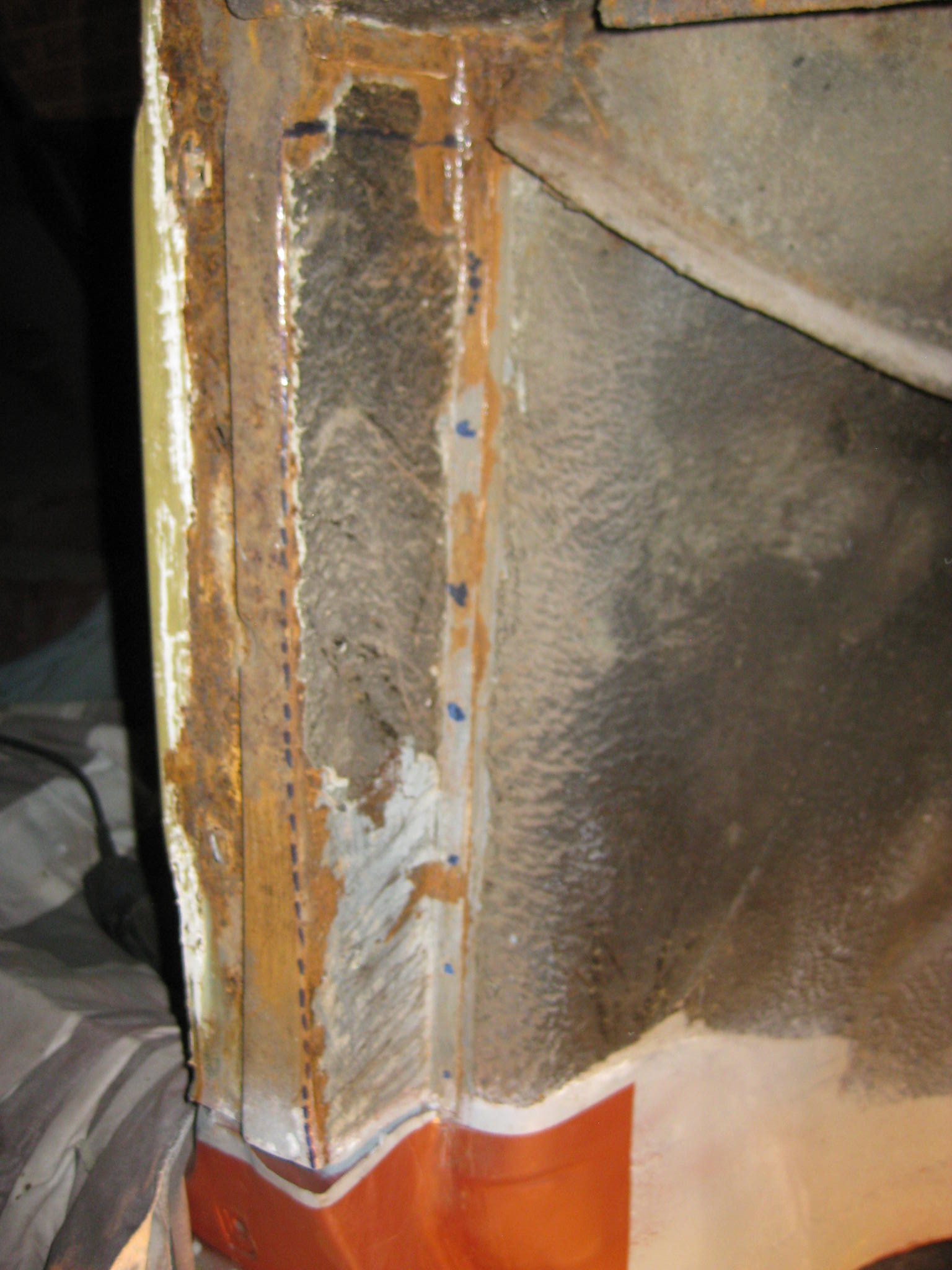

So, starting at the bottom of the 'A' post I need to work upwards to meet the bottom of the windscreen pillar, most visable areas of the 'A' post didn't look to bad but I know what will be inside
- Posts: 433

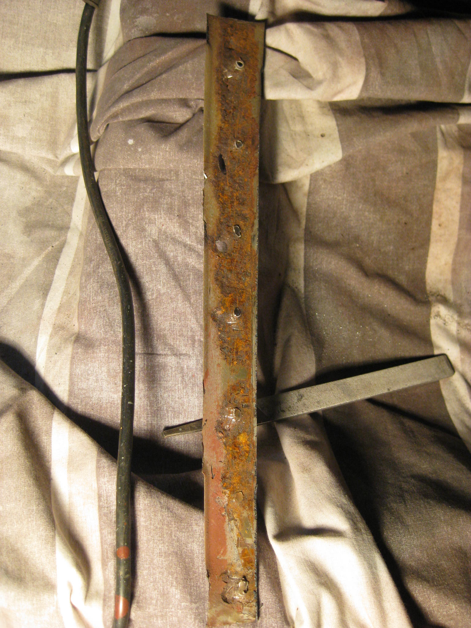

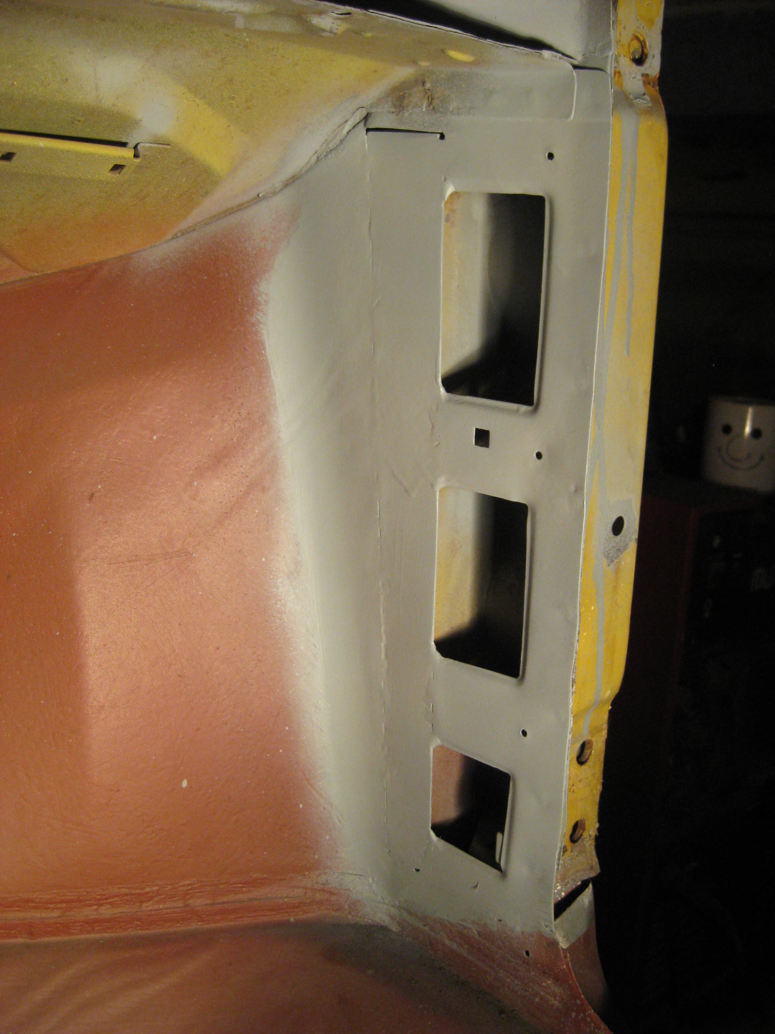

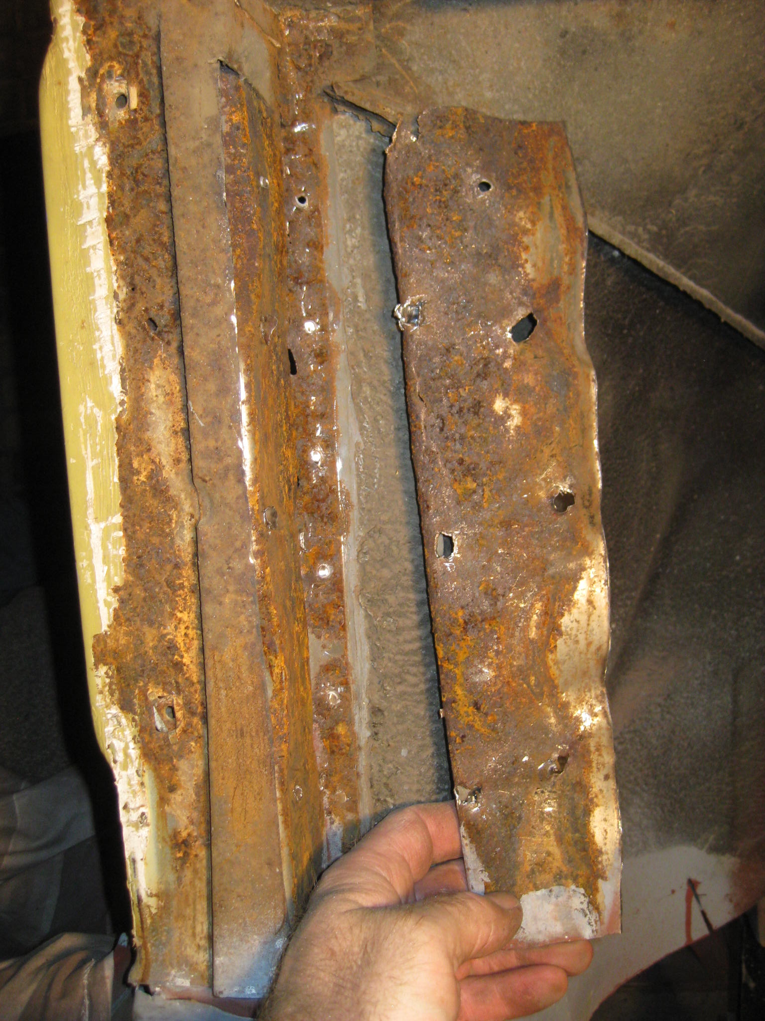

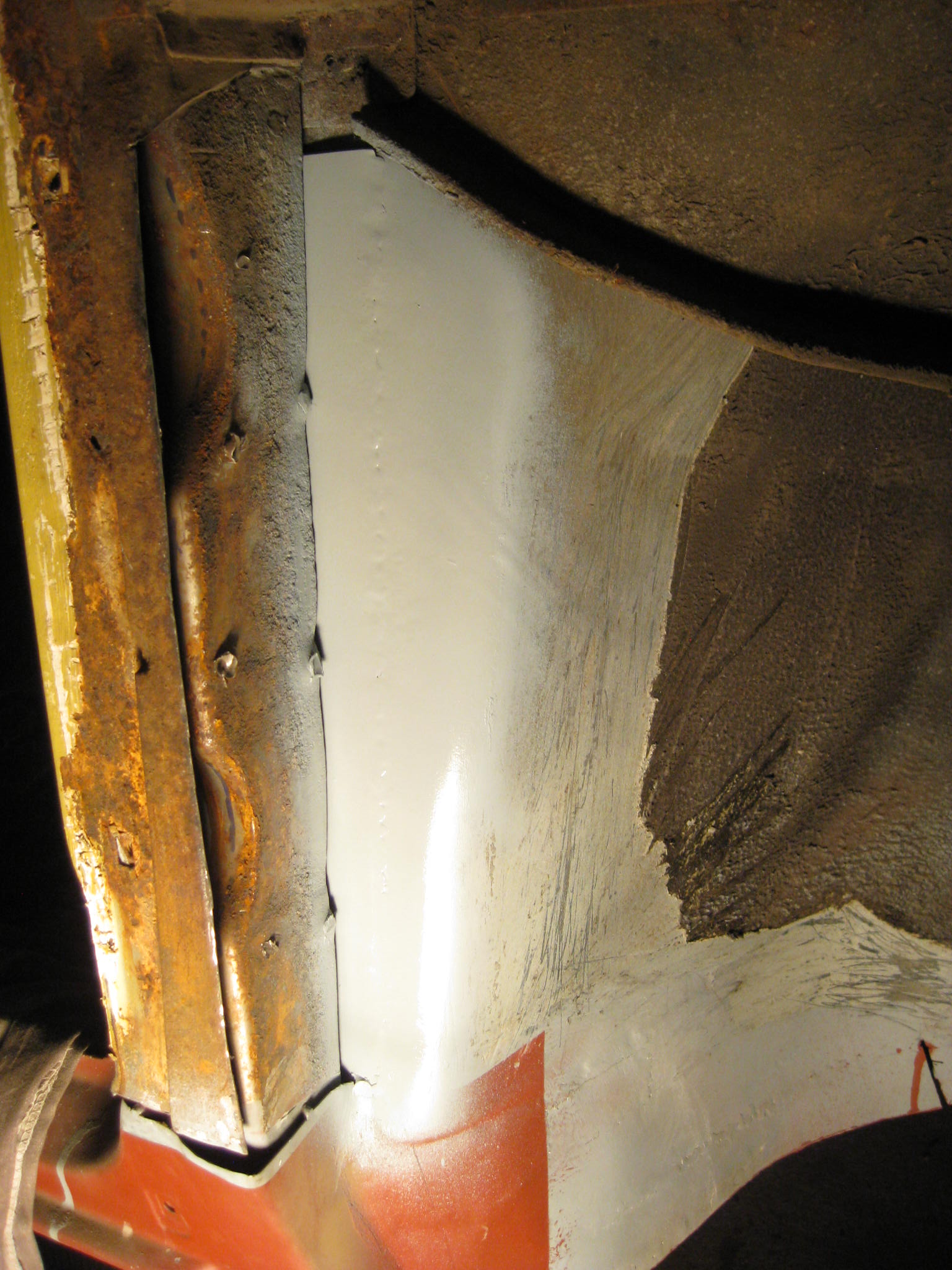

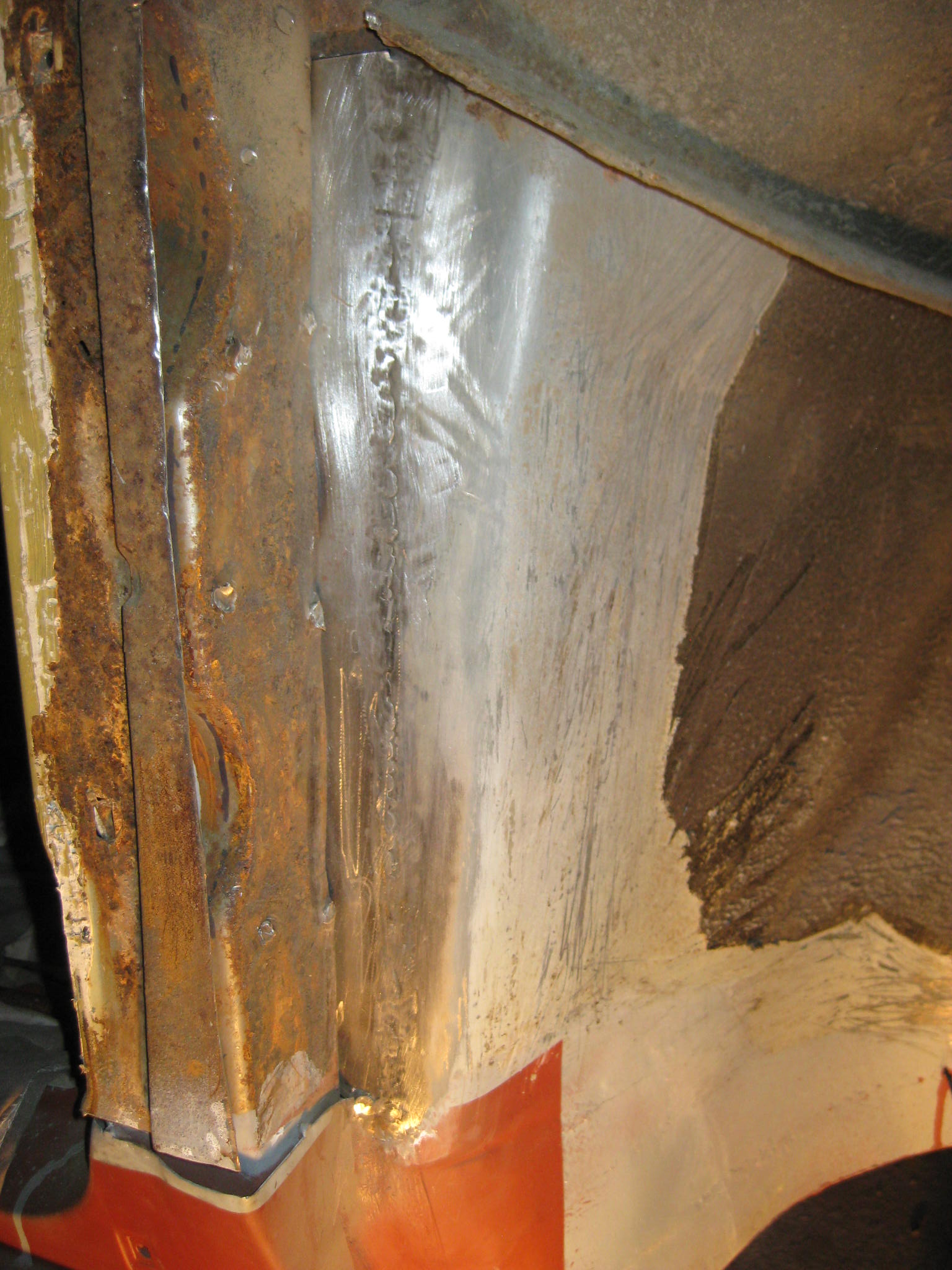

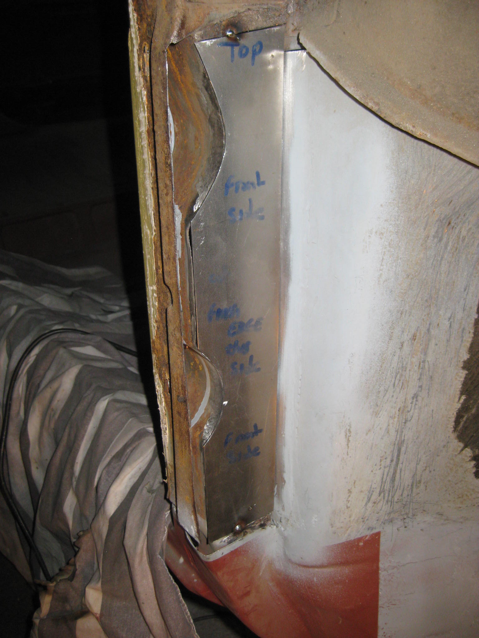

The inner wheel arch - inside of the 'A' post is the 1st. area to repair, I cut all the corrosion away and made up a new piece, tacked it in in stages to keep it all straight & flat, the last photo shows the metal that was removed.
- Posts: 433
- Posts: 433
Finally some etch primer was added, I know some of this will burn off as I move on with this repair but it helps me see the wood for the trees if you know what I mean

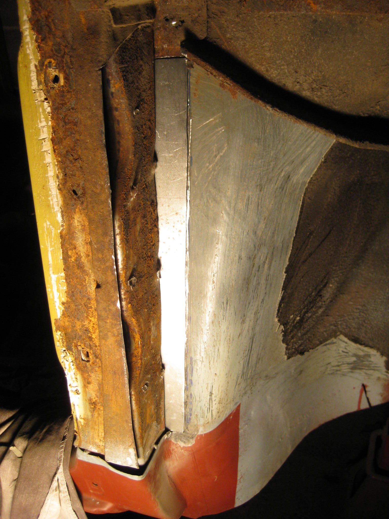

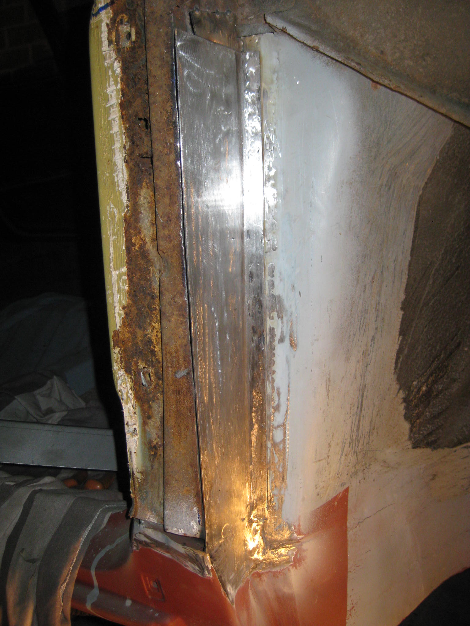

Time for an update....
This 'A' post is turning into another big job
As the inner section was also corroded this had to go as well as the outer...
Inside looks ok, back to some rust free metal finally!
- Posts: 433
Inner piece welded in place and welds ground back, outer piece made up and holes drilled to spot weld through
- Posts: 433
Outer piece in place welded up and ground back, looks good...
- Posts: 433

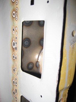

As I am using 1.0mm sheet its going to be rock solid when finished and also means I can crank up the current on the mig
Last two photos show weld penetration form the inside
nice when you can use the figures further round the gauge eh Adi! Crank it up son!
sterling work again mate, and quite correctly, this will be a whole lot beefier than orignally tinned together eh
well done dude, great to see these bits getting sorted
Looks perfect!
