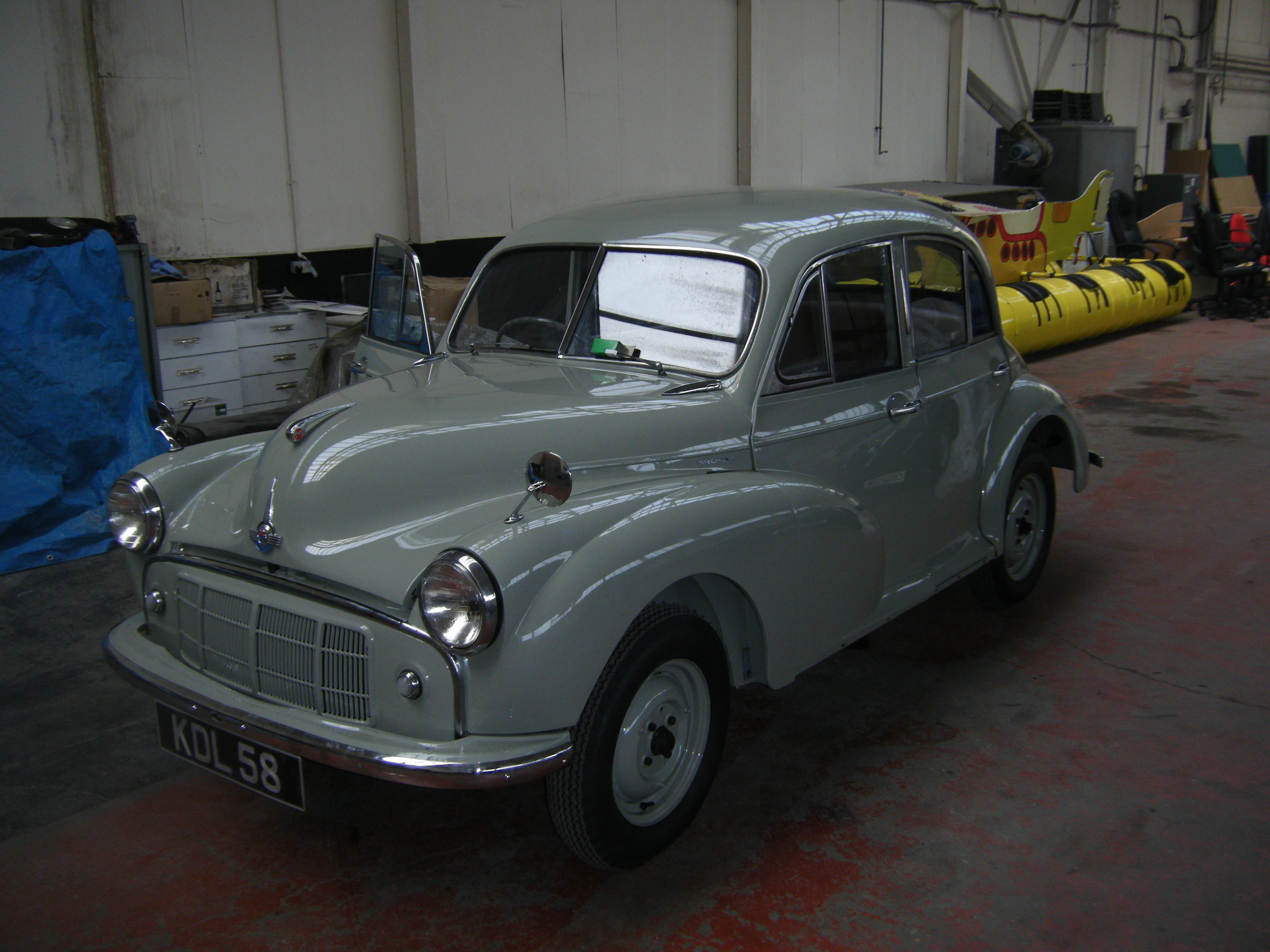

Well the Moggy has passed its MoT but it is so gutless with the 803cc engine! The Ford cross-flow sounds much more entertaining...... :lol:

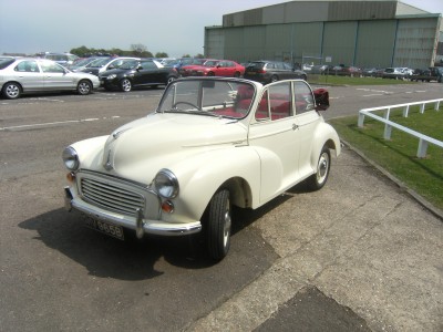

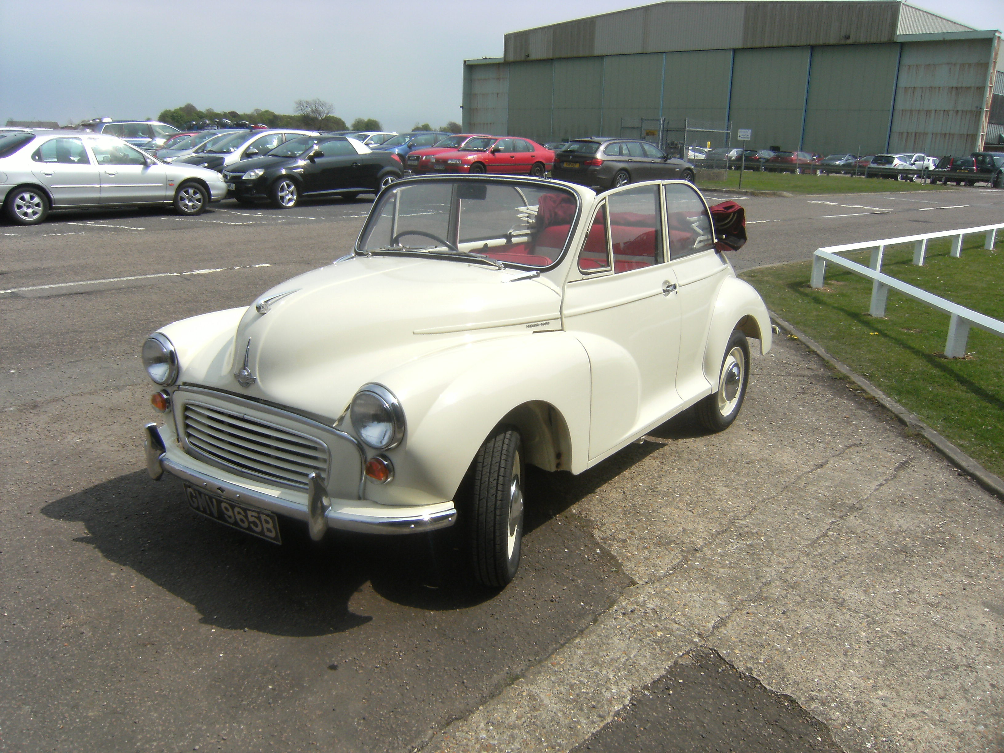

Driving the Morris down to the IoW - and driving back in the white convertible Morris that I built two years ago.
Posts: 2891
Looks a little gem 8-)

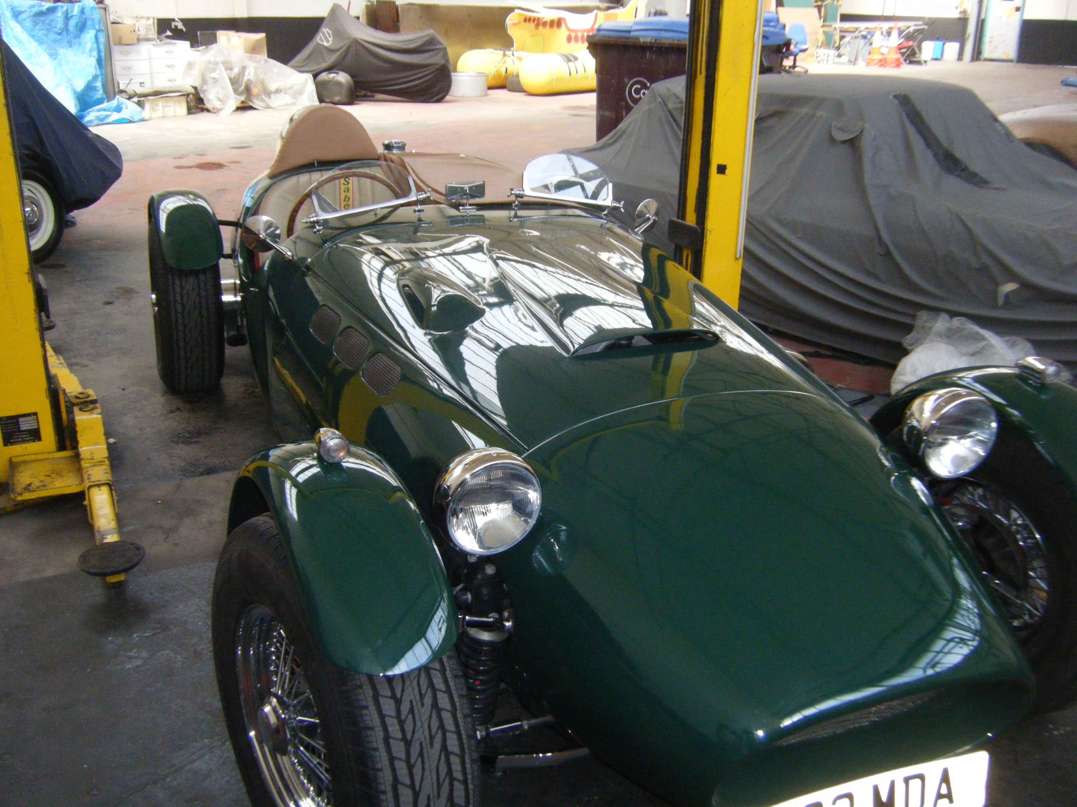

Yesterday I was finishing off the Ronart - taking off the IVA bits (round edges/soft caps/alloy wheels etc) and putting the pretty bits back on.

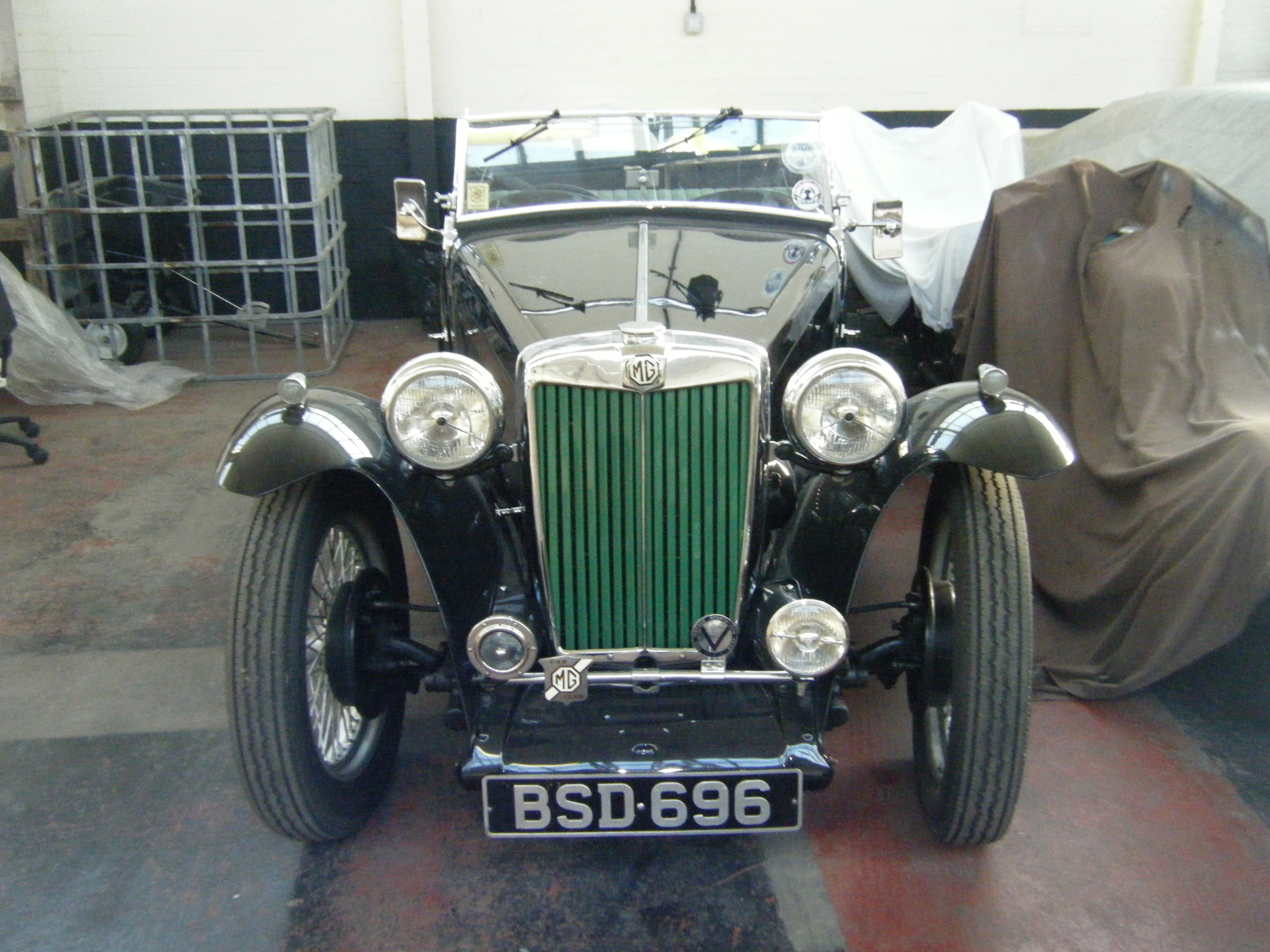

Yesturday I had to get an mot for this......

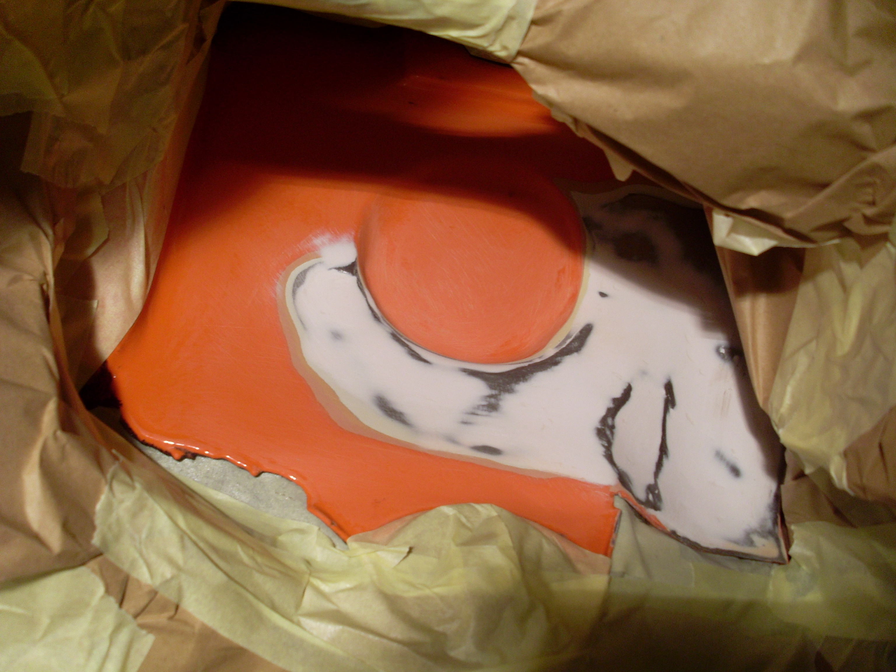

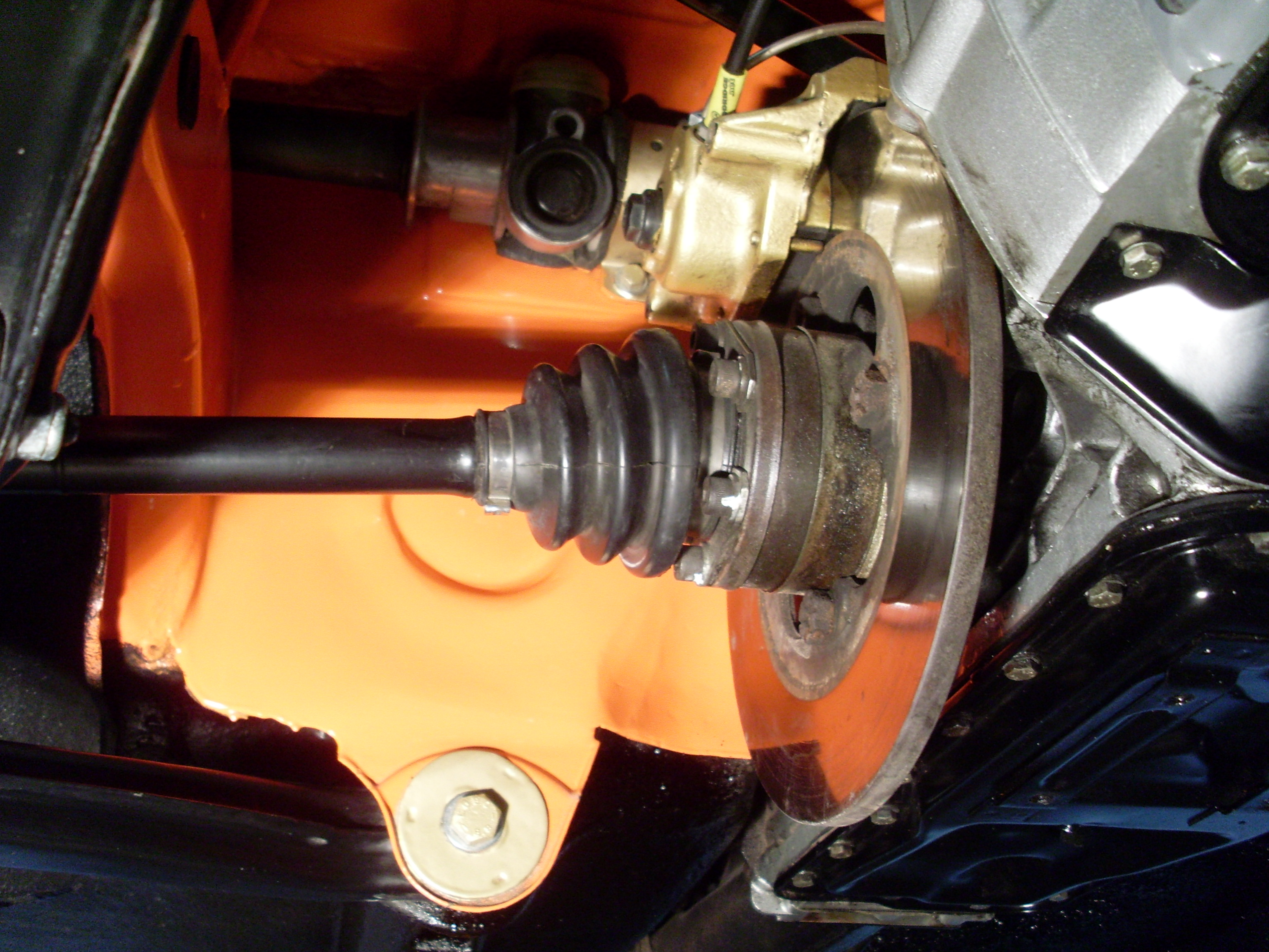

As Kev and Philip have mentioned on the "Suds in the sun" thread, it is not far away now.

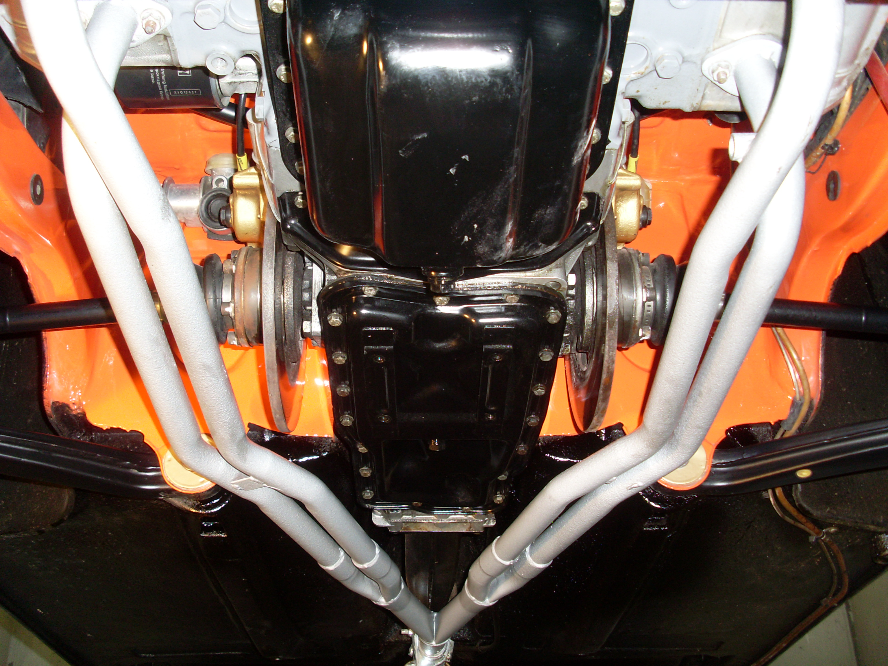

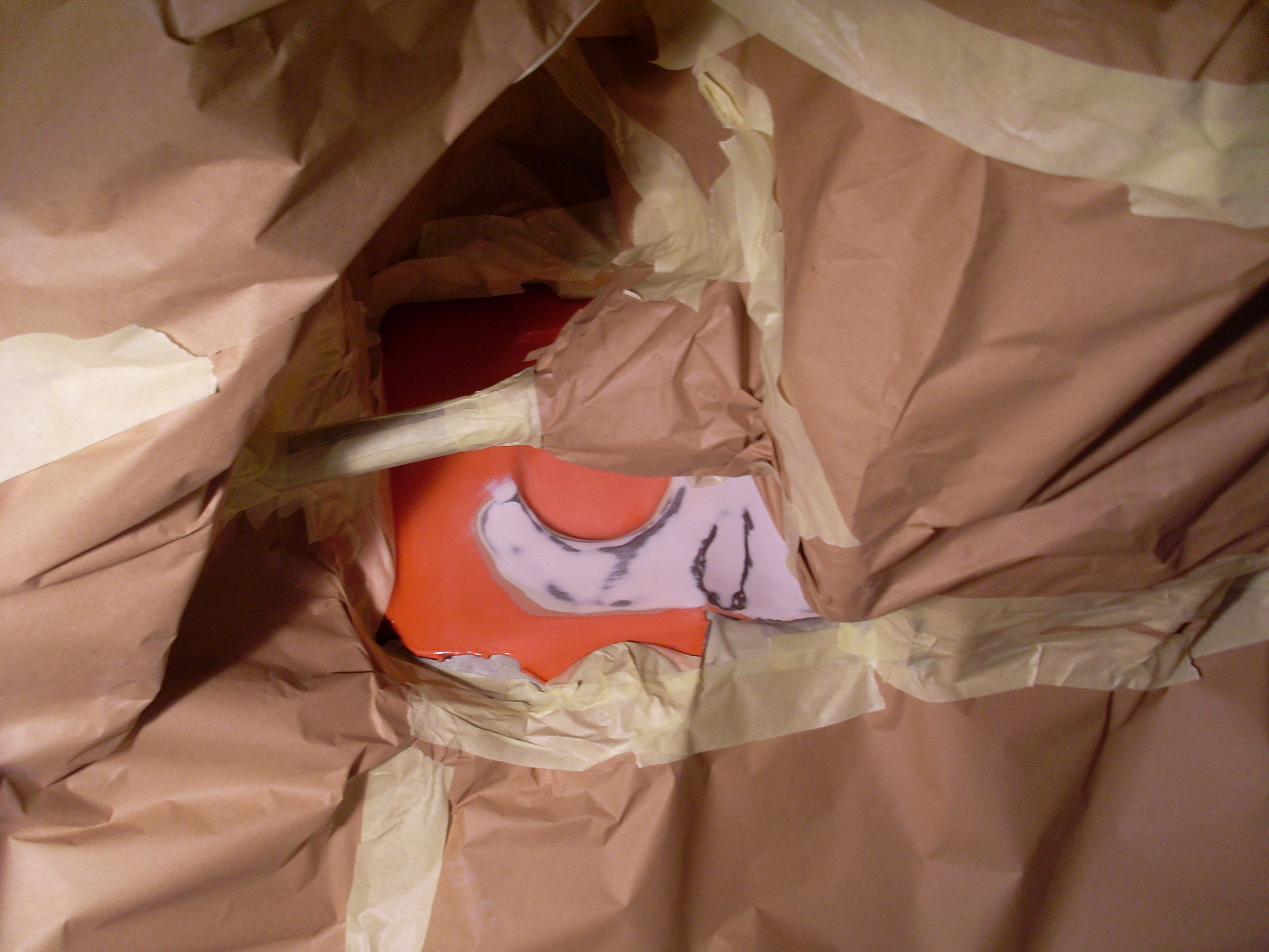

So I did a few local repairs in the engine bay.
I had been meaning to get them done as I overloaded the primer when restoring the shell. Over the years it has cracked and split open. :oops: :oops: :oops:
Pleased to say that when ground out there were no signs of splitting or corrosion, just product abuse.
So I got the old girl in the air and removed the exhaust to get access to the bulkhead. Awkward job to do with a fitted up engine bay but glad it is done.
Just need to clean the mess up now, still, I have two weeks............
top work mate, never knew you had an issue there :?:
think it was really just an excuse to clean the road dirt off myself ;)

Cheers guys,
I was aware of the cracks a while ago, but a couple of eagle eyes spotted them at Duxford. :o :o
It wasn't anything nasty, just overloaded product, but as we know Suds are prone to fracturing bulkhead and inner wing areas so I needed to address it as some folk my have thought the worse.

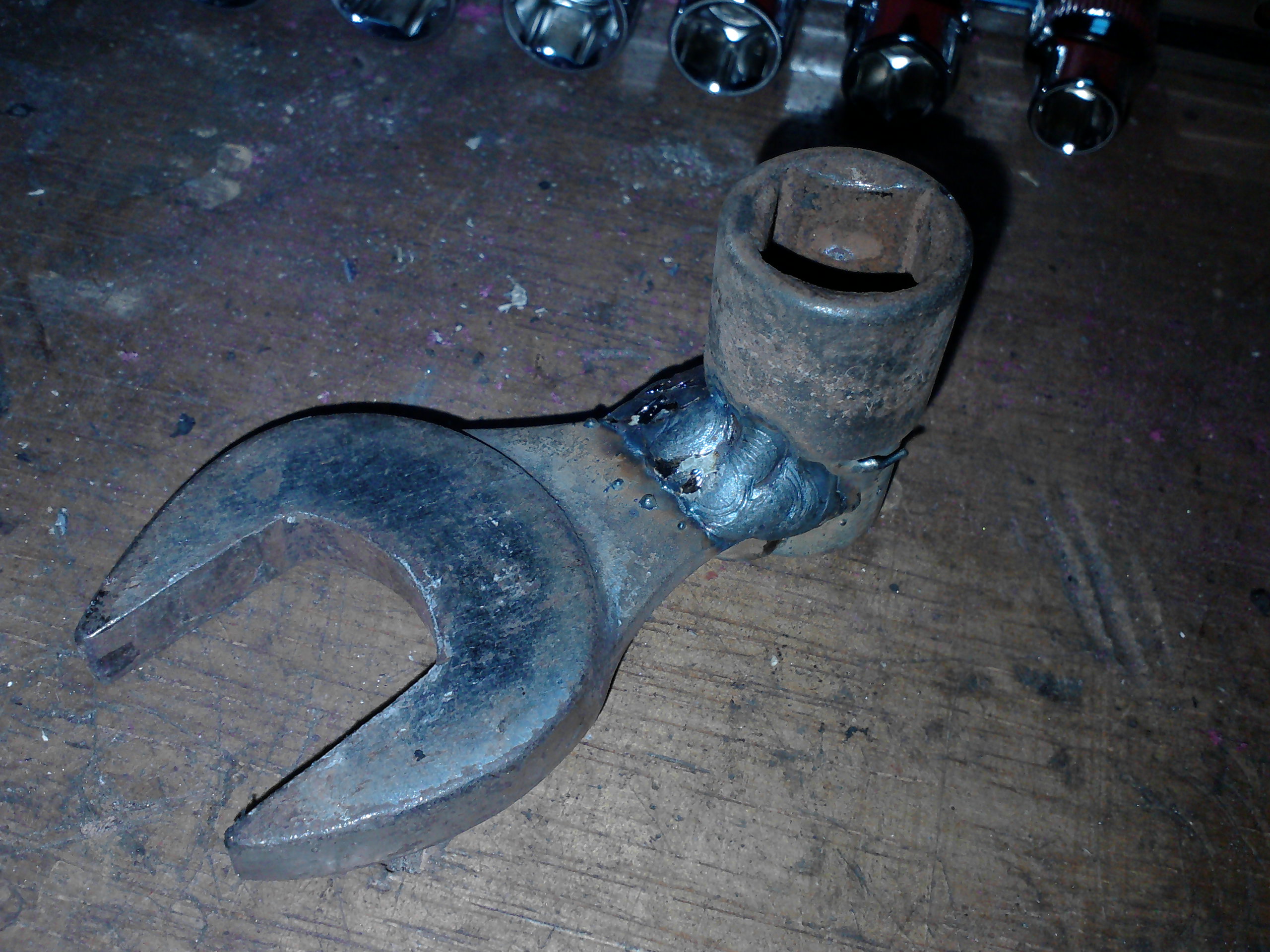

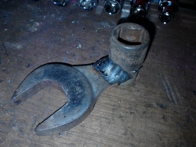

made up this little tool tonight, can you guess what it's used for?
Posts: 2891
Kev !! shouldn't this be on the puzzle post ?? :lol: :lol:
Looks about 17 mm.
Is it for the Lancia?
Pleased to hear you have sorted an Intergrale for yourself, another one for my dream garage :mrgreen: :mrgreen:
Tightening the bolts on Frankenstein's neck......?
lol, should have put it on the puzzle post, might have lasted a bit of time before you guys would recognise it's use.
it's a 22mm spanner chopped down with a 1/2" drive socket on it.
made it up to enable the oil pressure gauge sender to be removed without having to struggle with a long spanner, even less easy on a single carb engine than the twin.
long extension and the sender can be undone.
mine had packed up so swapped it out for a spare.
good excuse to take the car out for a spin :)

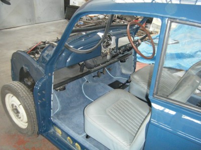

Back to my regular part time work - its another Morris Minor!
A Blue two door that I have stripped. The bodyshell has been resprayed and the panels are to be sprayed next week.

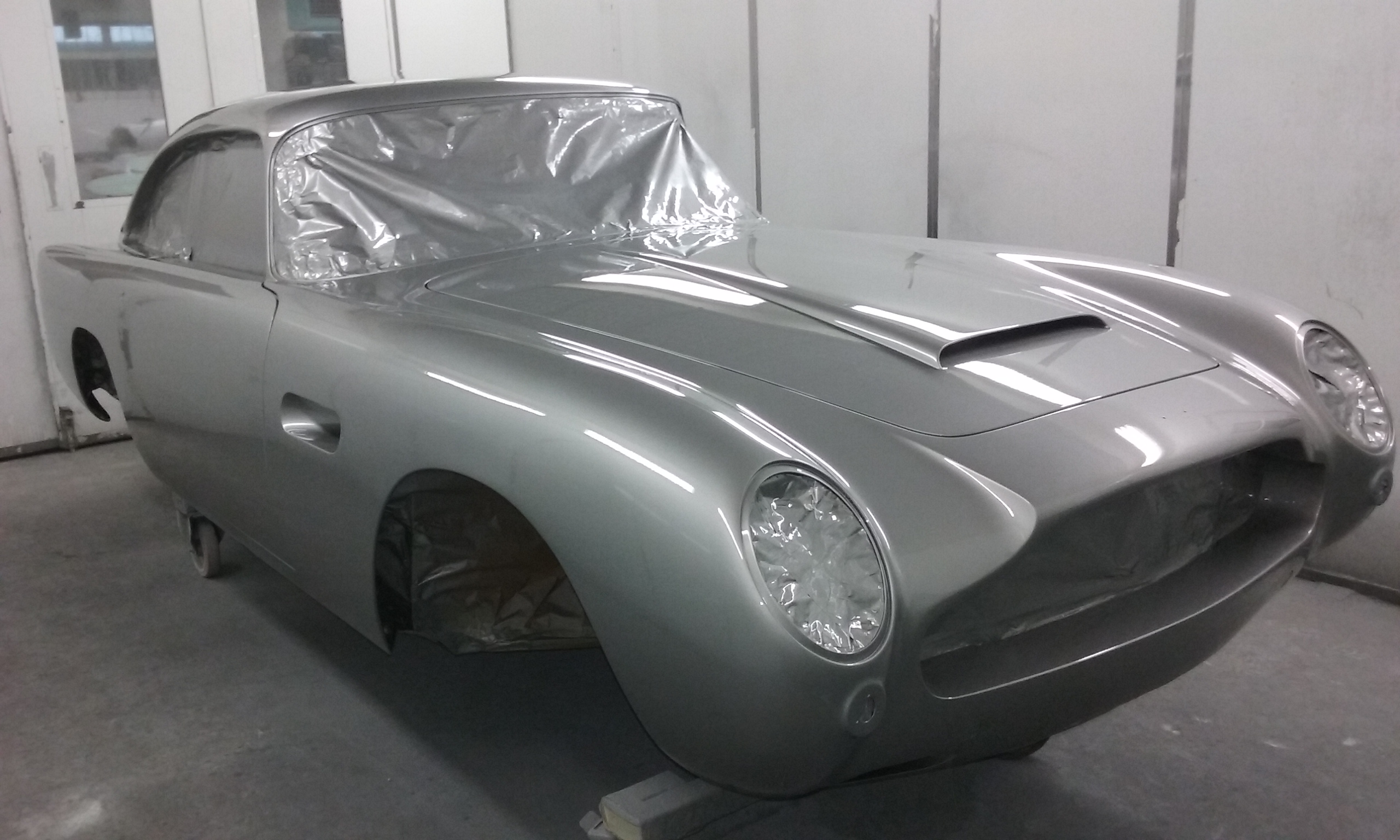

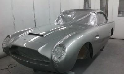

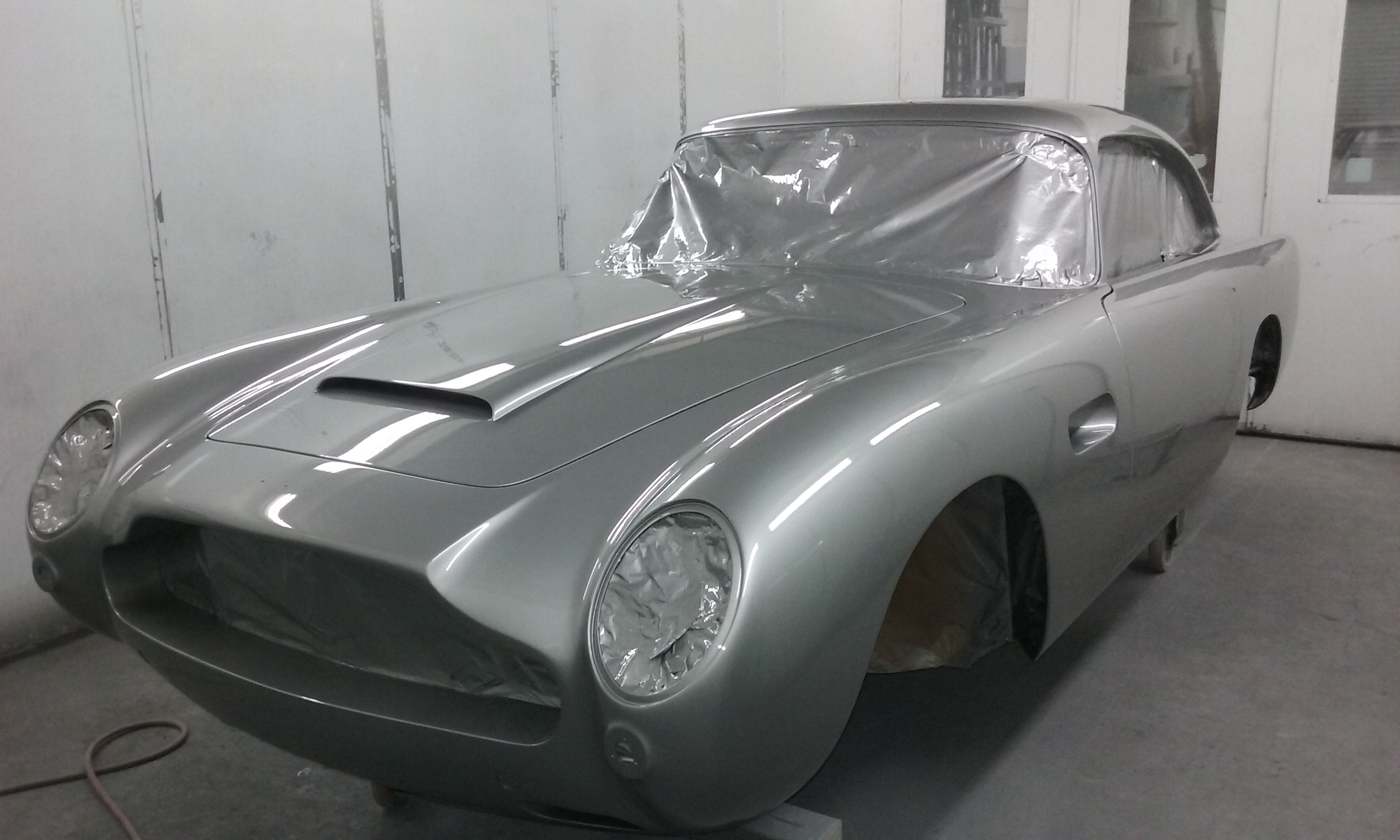

Have been on this for a few weeks now. Finally in colour and will start flat and polishing in a few days.
Wow! :o
What a beaut!
When can I pick it up :D
