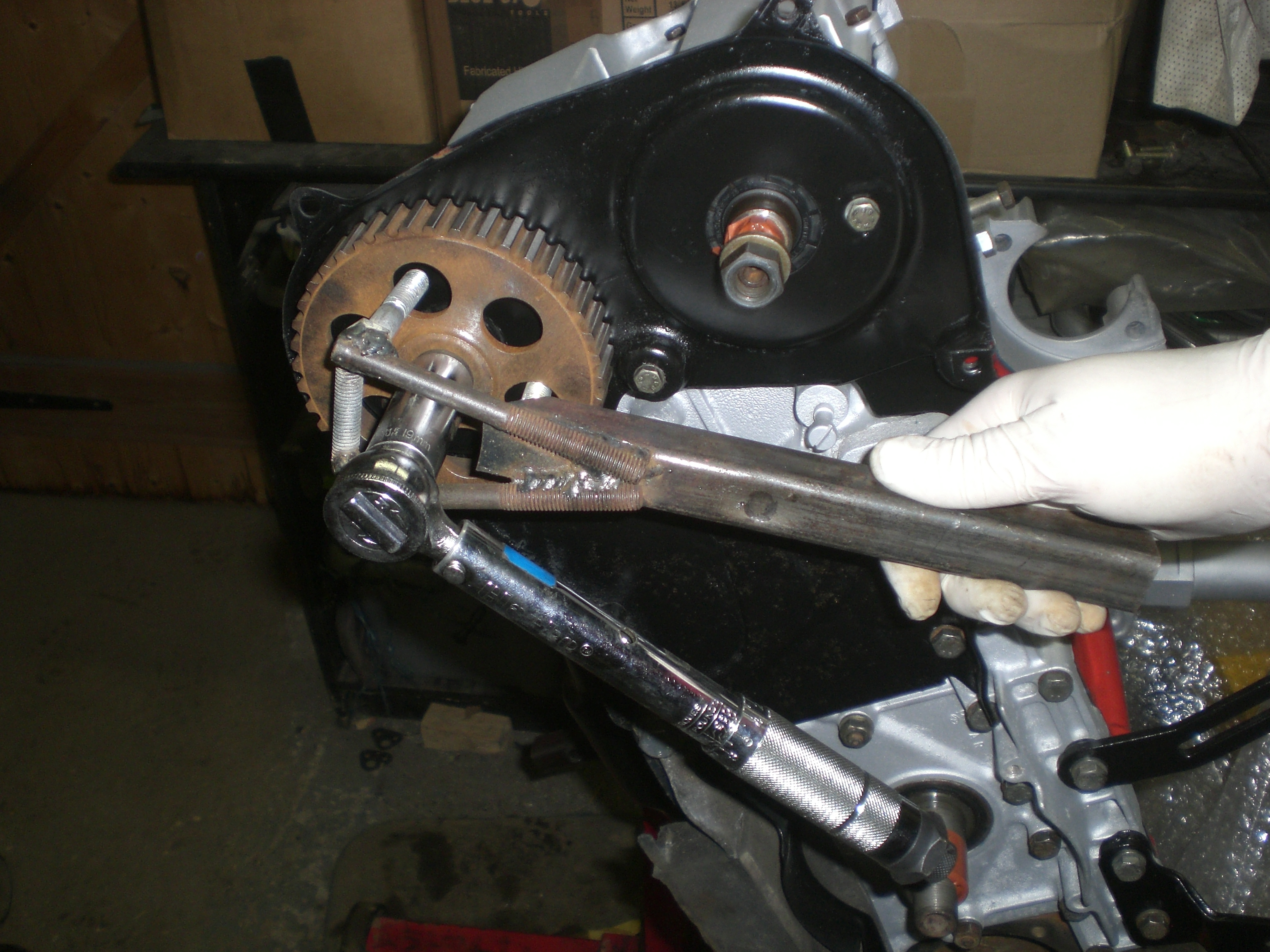

Kev,
how do you wind up the nuts on the cam wheels to 76 - 84Nm without the cams turning over?

ah.Edward wrote:Kev,
i've a special tool, well one i made, just for the job.
should be doing them tomorrow night

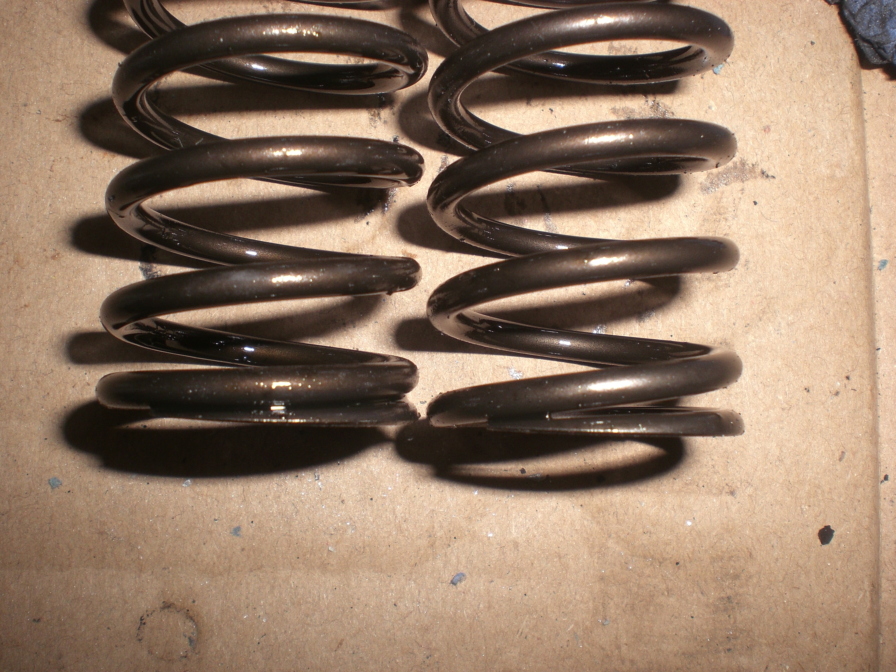

there has also been talk in the past of the valve springs being able to be fitted the wrong way up, they are more tightly bound one end than the other.
didn't know this myself until assembling the last 16V, hard to notice until you look closely.
this pic is of a pair of the outer springs (harder to notice on the inners, but they have the same difference) where the one on the left has a tighter bound spring, hence mass, at the bottom of the pic.
it should be fitted with the tighter part to the head, to do with unsprung weight apparently.
easiest way to see the difference is to look at how far along the oil bridges the gap, the tight end will have oil further round the spring, if you see what i mean

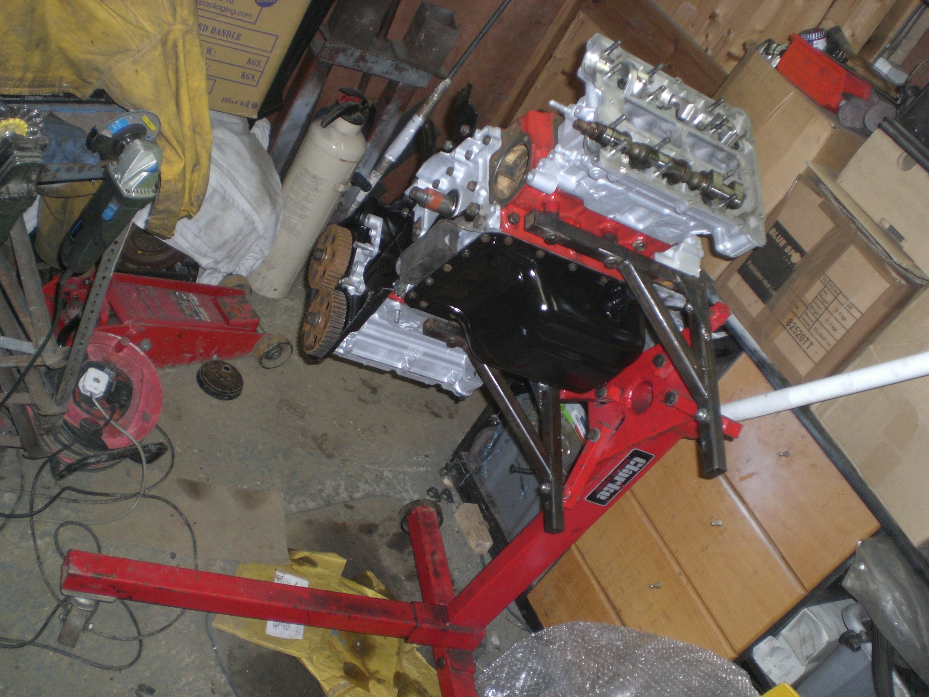

change of plan for tonight, couldn't fetch the 147 so an evening down the shed again..
other head was bolted on after the broken oil return fixing was drilled and tapped out.
cams installed but the inlet one gave me real grief, wouldn't remain smooth in turning when clamped down.
tried all sorts, even another camshaft, but still sticking.
this was on the head that was ok of course, so what the hell was going on?
then tried it in with no hydraulic followers, succes!
at least that showed it wasn't anything to do with the bearing caps or anything.
seems 2 of the followers were reluctant to compress enough, maybe being out for a while they'd shifted inside?
changed them for 2 good ones and hey presto, sorted.
kind of dampenned progress though.

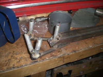

ed asked me about tightening the cam pulleys, not easy as the cams don't have any flats on them to get a big spanner on it.
you can jamb a screwdriver against one of the 10mm bolt heads behind the pulley, but it can be a bit tricky to hold and prevent damage.
i made up a little tool to fit in the holes in the pulley and allow a socket to go through the centre.
just made from bits of scrap and a few old bolts, does the job a treat.

the impact guns will loosen the nuts but i'd not trust them to be tight enough....or overtightenned...an i wouldn't use an impact gun with the belt still in place, not a new belt anyway, the shock loadings could do untold damage to the belt teeth
you can get away with poking a flat screwdriver through one of the holes and wedging it against one of the backplate hetaining bolt heads. but be careful, they can slip easily.
the tool i made is very simple to make and comes in handy for all engines

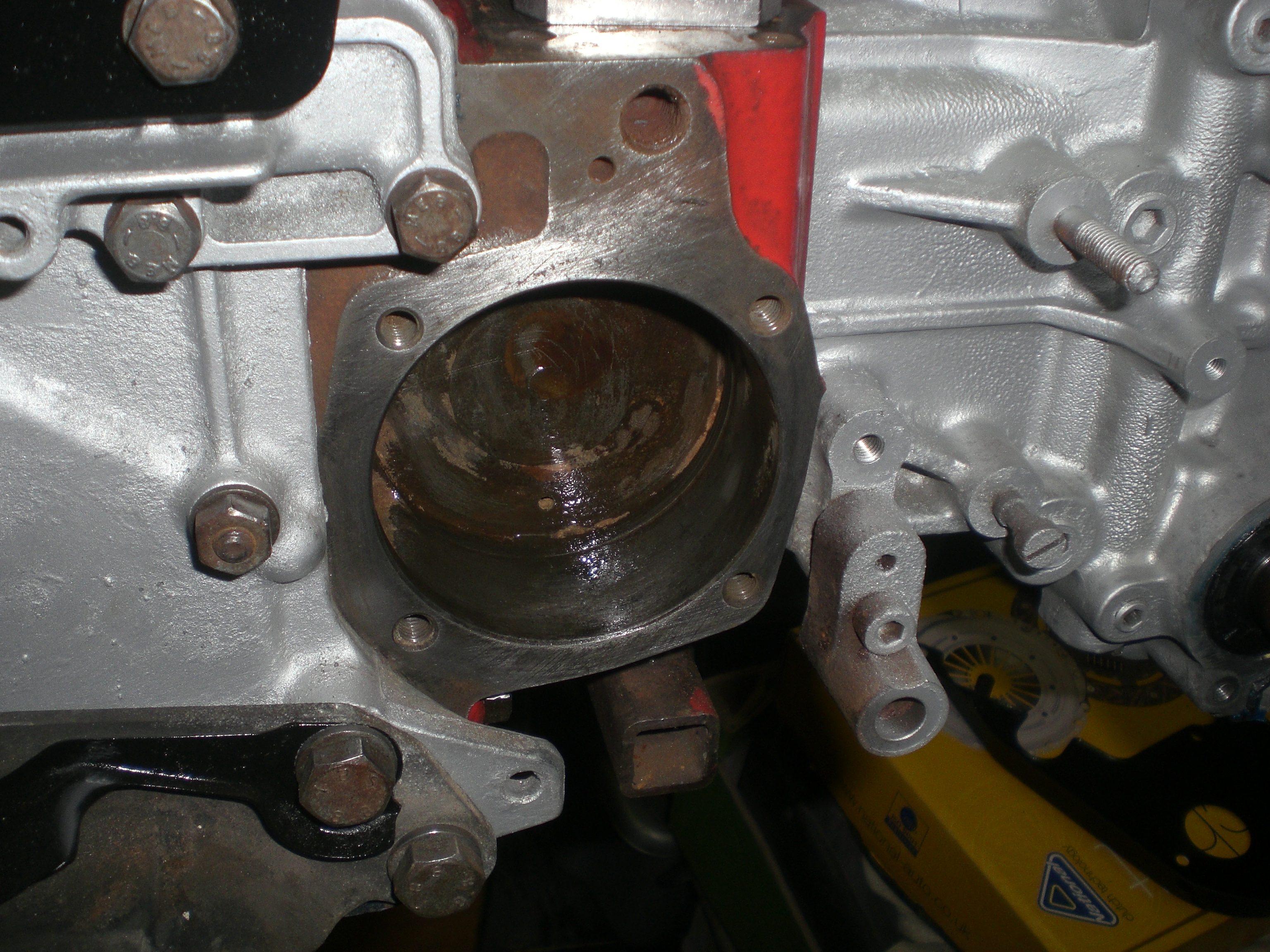

new water pump fitted. the bare metal internal part of the block where the pump fits always rusts up when the engine is in bits, cast iron tends to do that. can cause issues when the pumps are being removed, maybe. not sure if it helps but i smeared some anti-freeze on the bare surfaces to try and prevent corrosion forming. anti-freeze is also a corrosion inhibitor, whether it will help or not i don't know, but if anyone tries to remove the pump in 10 years time then please let me know how you got on

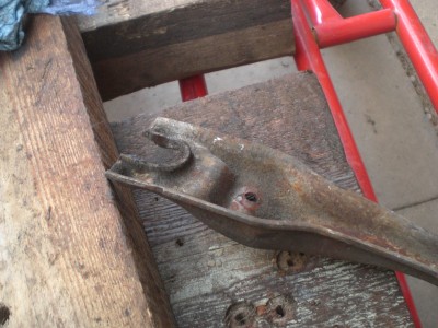

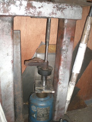

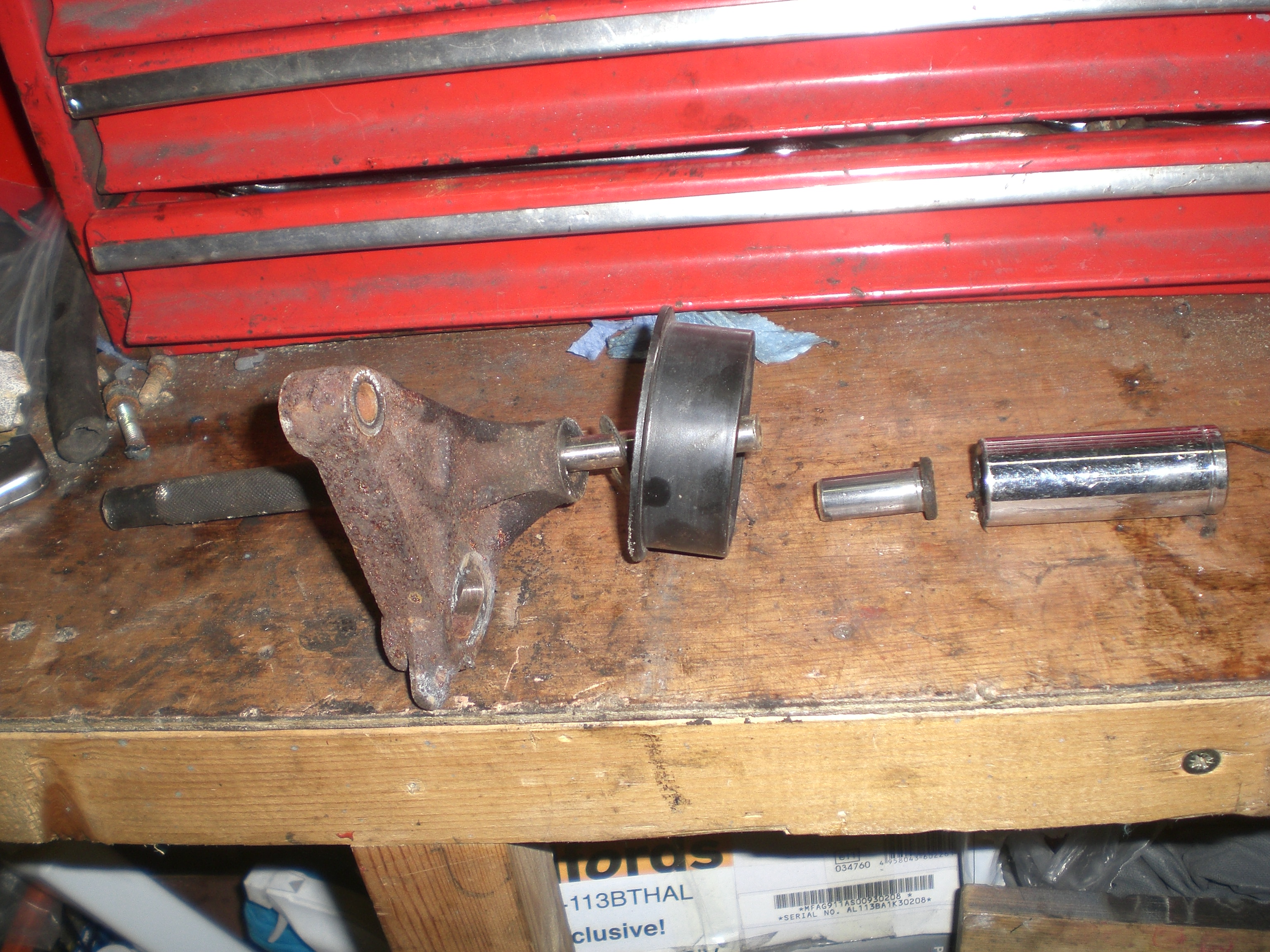

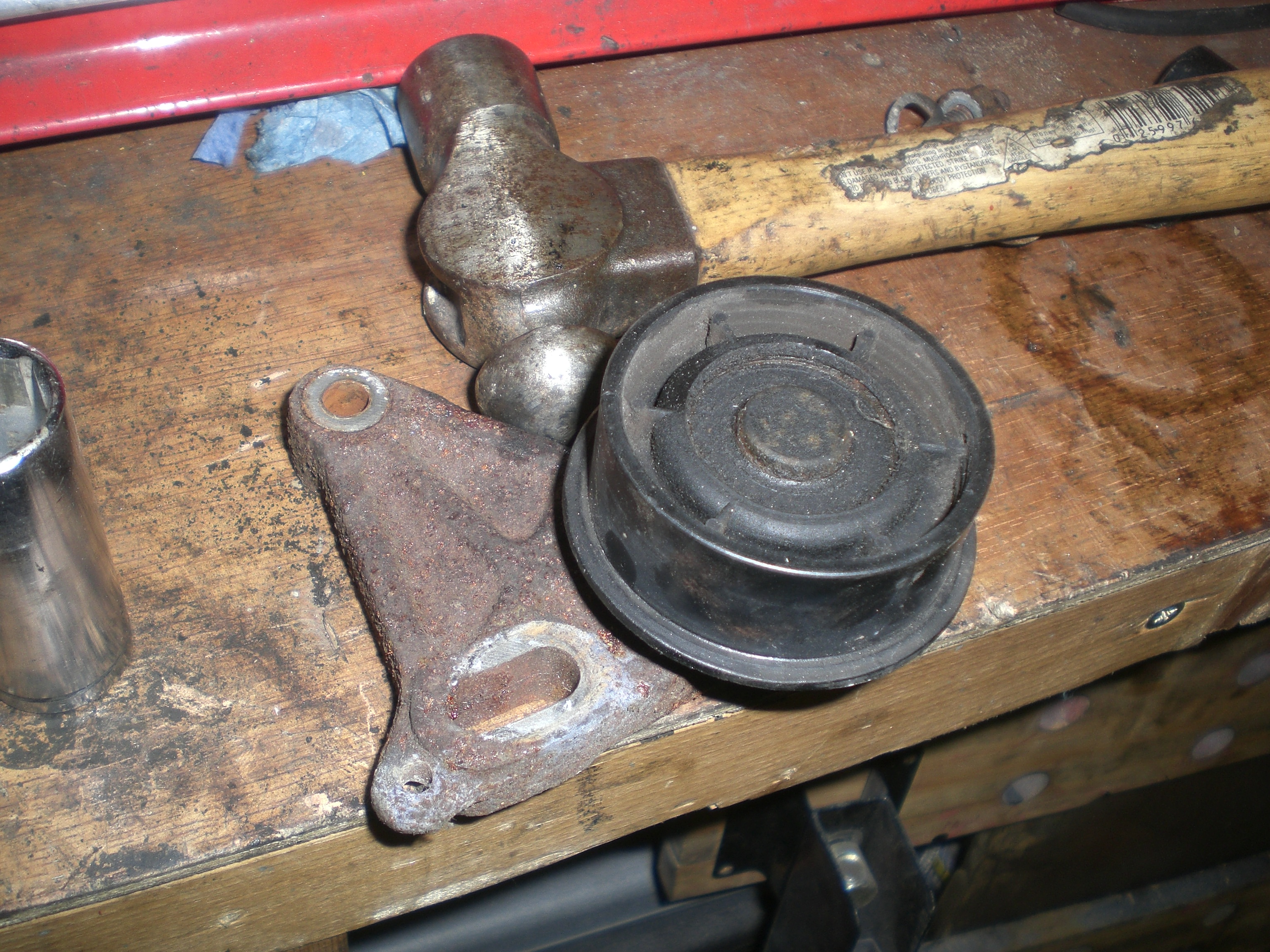

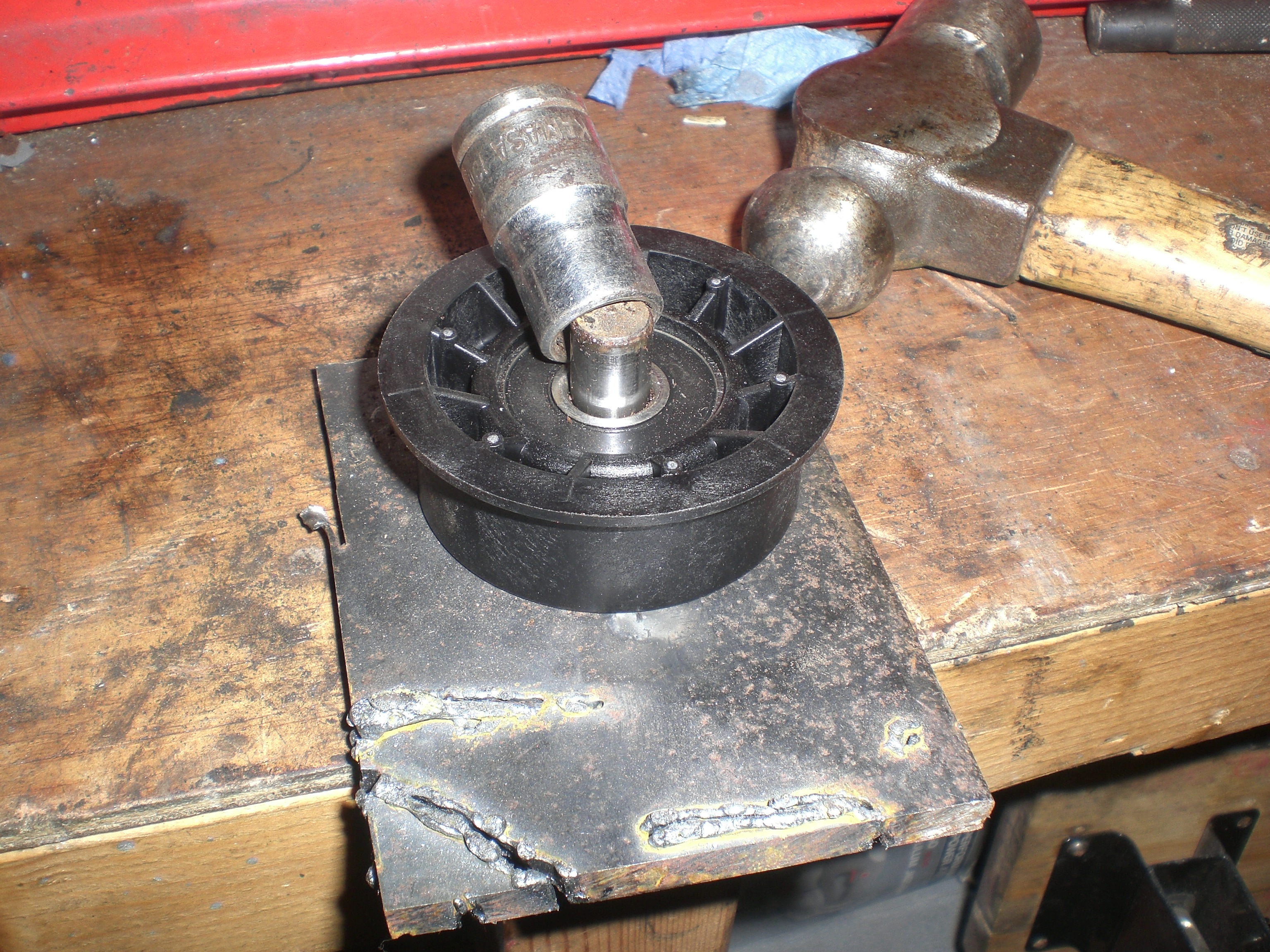

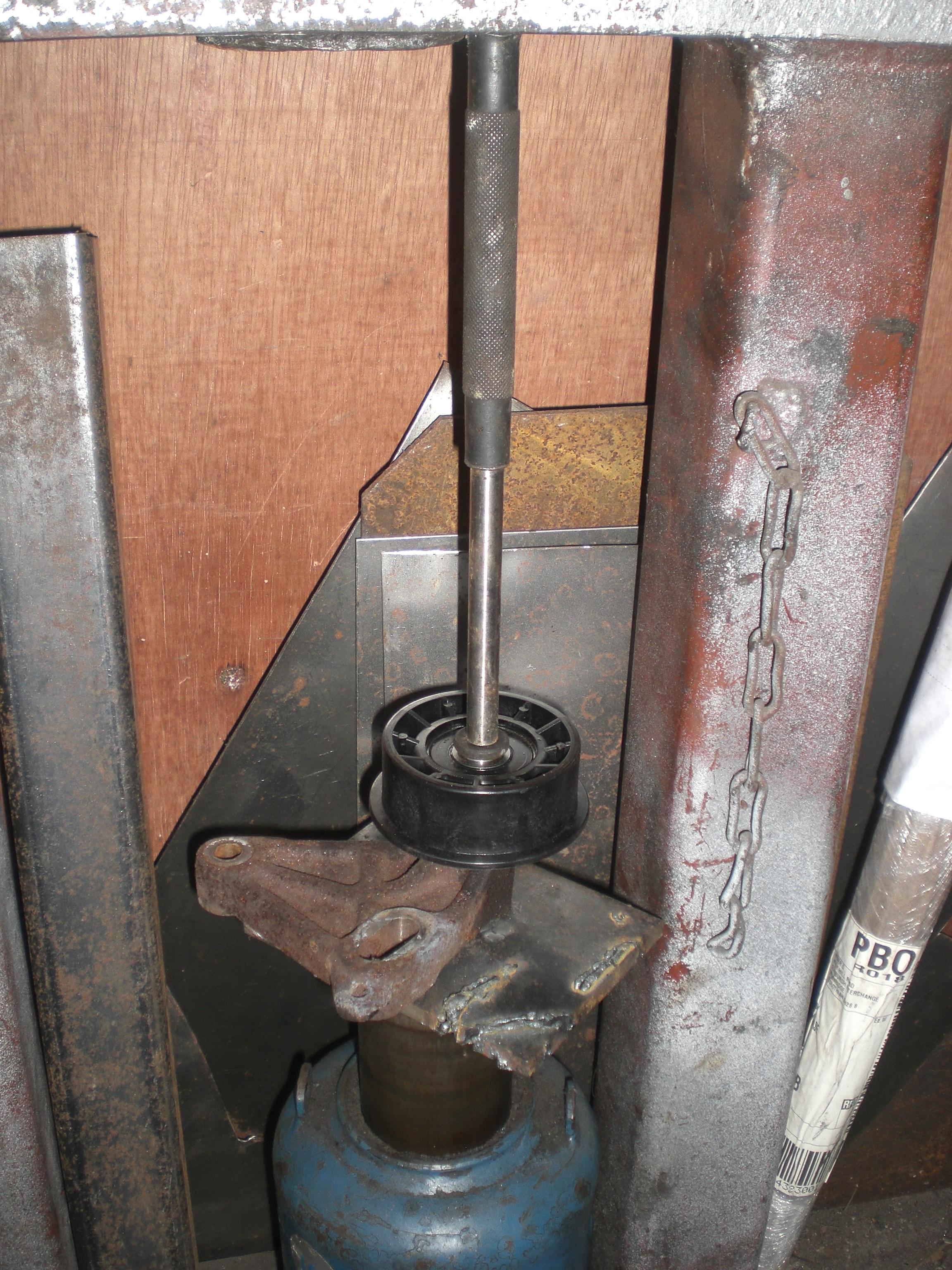

next job was to press on the new cam-belt pulleys.
quick guide below as to how to do them, if you've not done them before.
i use my homebuilt press but a sturdy vice will do the job, they aren't in overly tight.
first pic is what you get, the bracket that holds the pulley and holding pin visible through the centre of the bearing.
you need to push the pin out from the back of the mounting bracket whilst "catching" it in a suitable sized socket.
it's all pictured stood up in my press, which is really little more than some heavy duty steels and a bottle jack. as the socket is pushed up (which rests aginst the bearing on the old pulley) the punch above pushes the pin out, and into the socket.
what you end up with is laid out on the bench. note the slim washer that sits between the bracket and the pulley bearing.
to fit the new one back in i knock the new pulley onto the pin first of all, one less thing to wobble around, making sure to find a socket that sits over the pin but rests against the bearing surfcae, not the seal part.
you don't need to knock the pin fully through, in fact you can't how it's laid out due to the offset plastic wheel, but just enough to get the pin through the bearing.
then back into the press to push the pin fully home.

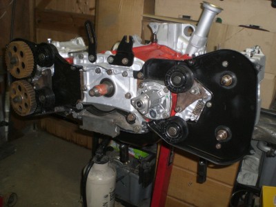

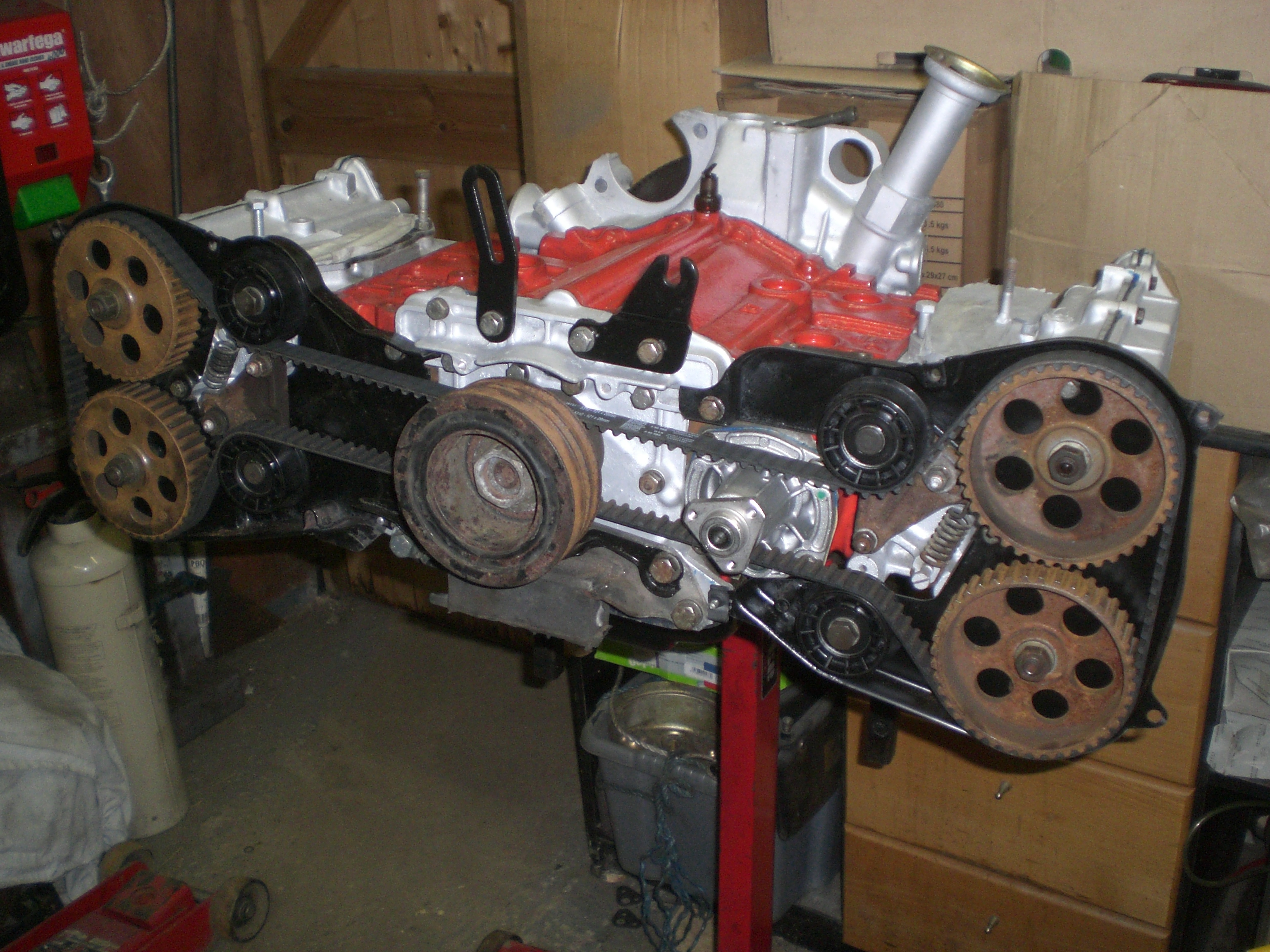

pulleys and other cover fitted, belts will go on tomorrow night.
nearly ready for the install.....
Re: My first ever 33
Getting there Kev ! Love the homemade press
Johnboy wrote:Getting there Kev ! Love the homemade press
i love the price of the homemade stuff mate
a little more done tonight, time split between getting this engine done for install this weekend and solving issues on the 147..
timing belts now on so almost ready to drop in

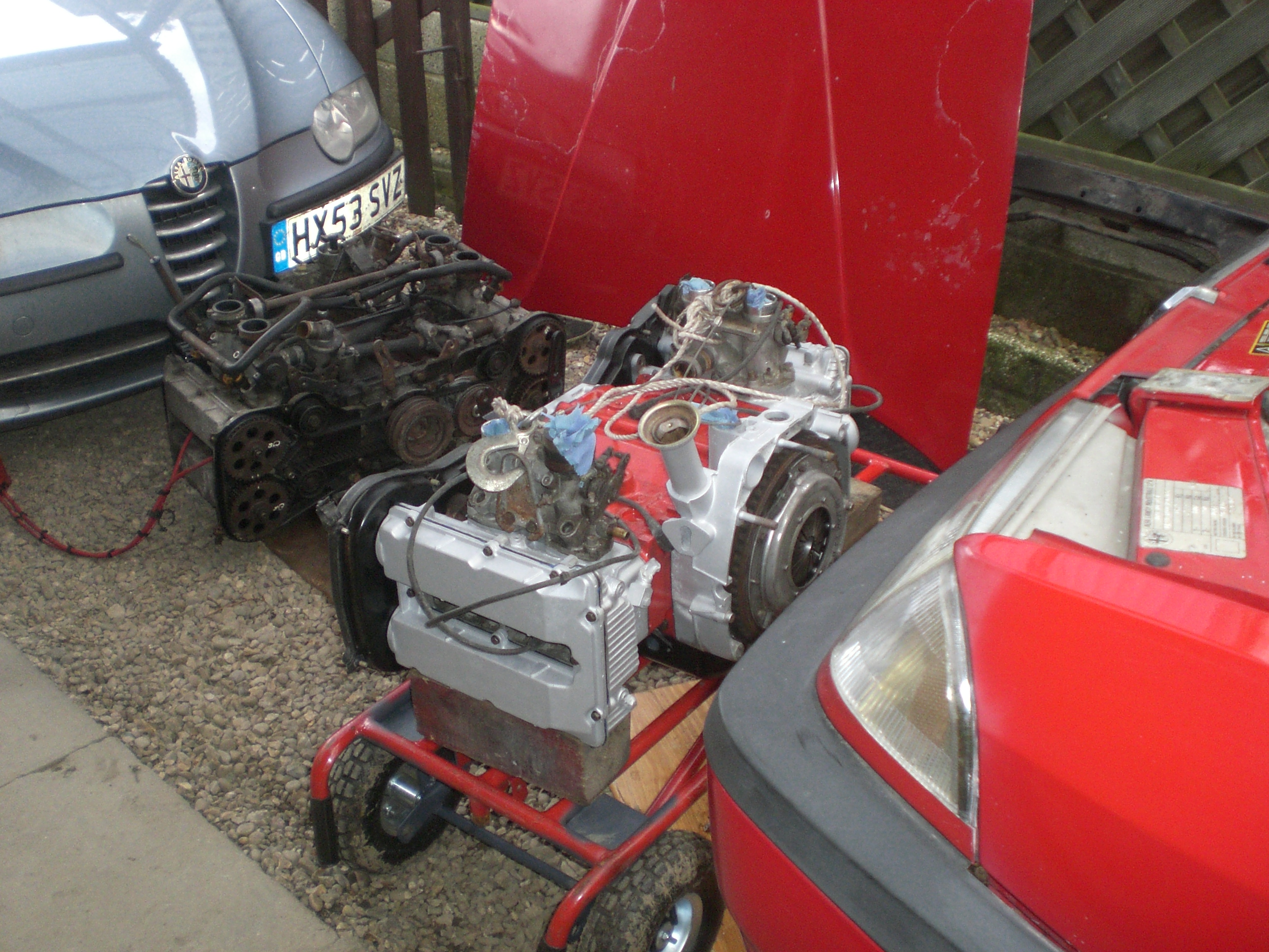

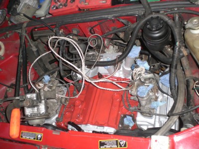

had a day on the 33.
got the old donor engine out, new one installed, eventually.
just needs everything putting back on now
out with the old, in with the new

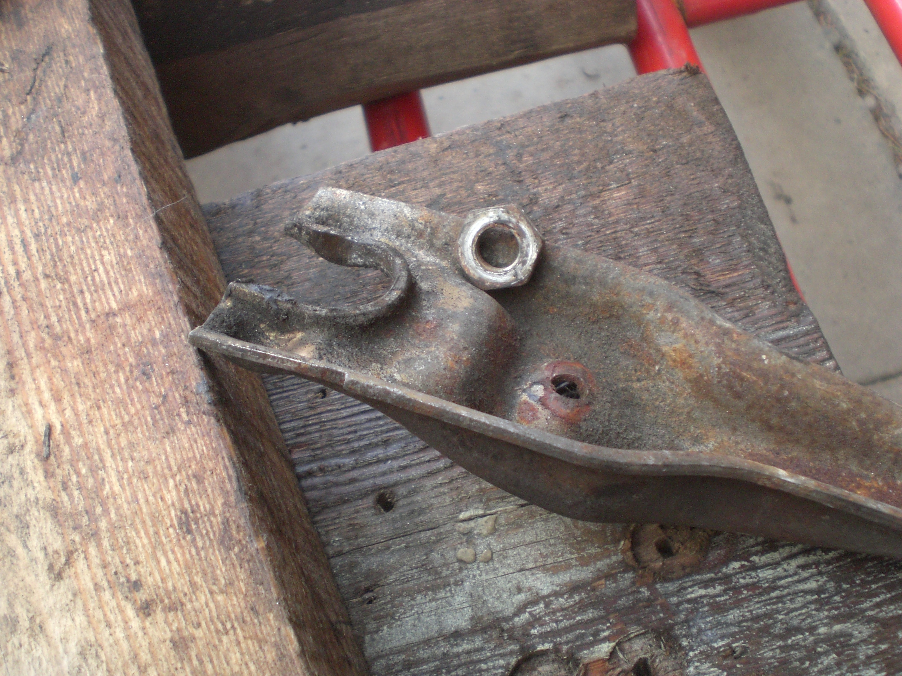

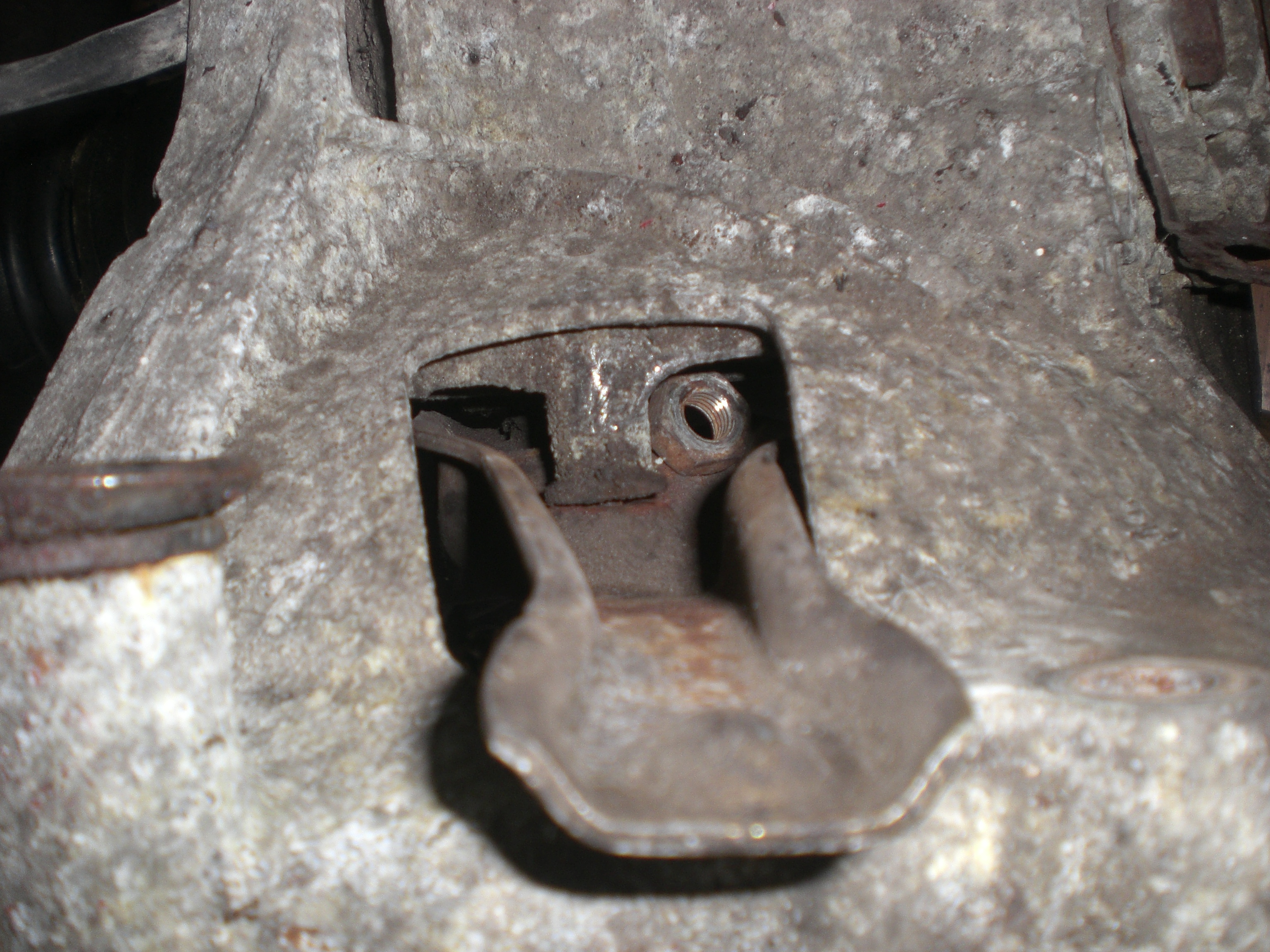

now, for a confession.
when i fitted the donor engine it had a very good clutch on it, yet when i drove the car it slipped!
wasn't leaking any oil onto it, clutch slave was new, pedal returning fine, etc etc.
a mystery.
could only sumise that the flywheel must have issues, so left it at that to have a look when the engine was swapped over.
on taking the old engine out the clutch was a bit oily/greasy, but not massively so...
flywheel at first looked a bit iffy but after another look and clean up it was declared ok, even rang shrew to see if he had a spare...but not needed.
looked at the rear crank seal, no oil leaks.
gearbox end dry too......very odd.
i then pulled on the release fork to see if there was anything to see...and a nut promptly fell out from behind it!
it had been trapped between the back of the fork and the gearbox casing thus preventing it returning fully away from the clutch, the poor release bearing must have been having a terrible time!
luckily i'd already ordered a new 3 piece clutch so that was fitted, along with another clutch fork just to be sure it hadn't been twisted in any way.
you can make out in the pics where the nut had been sat, amazing how it had stayed there for probably 100+ miles of driving!
a mystery.
