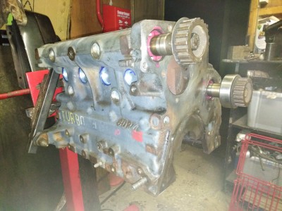

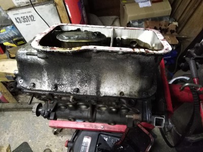

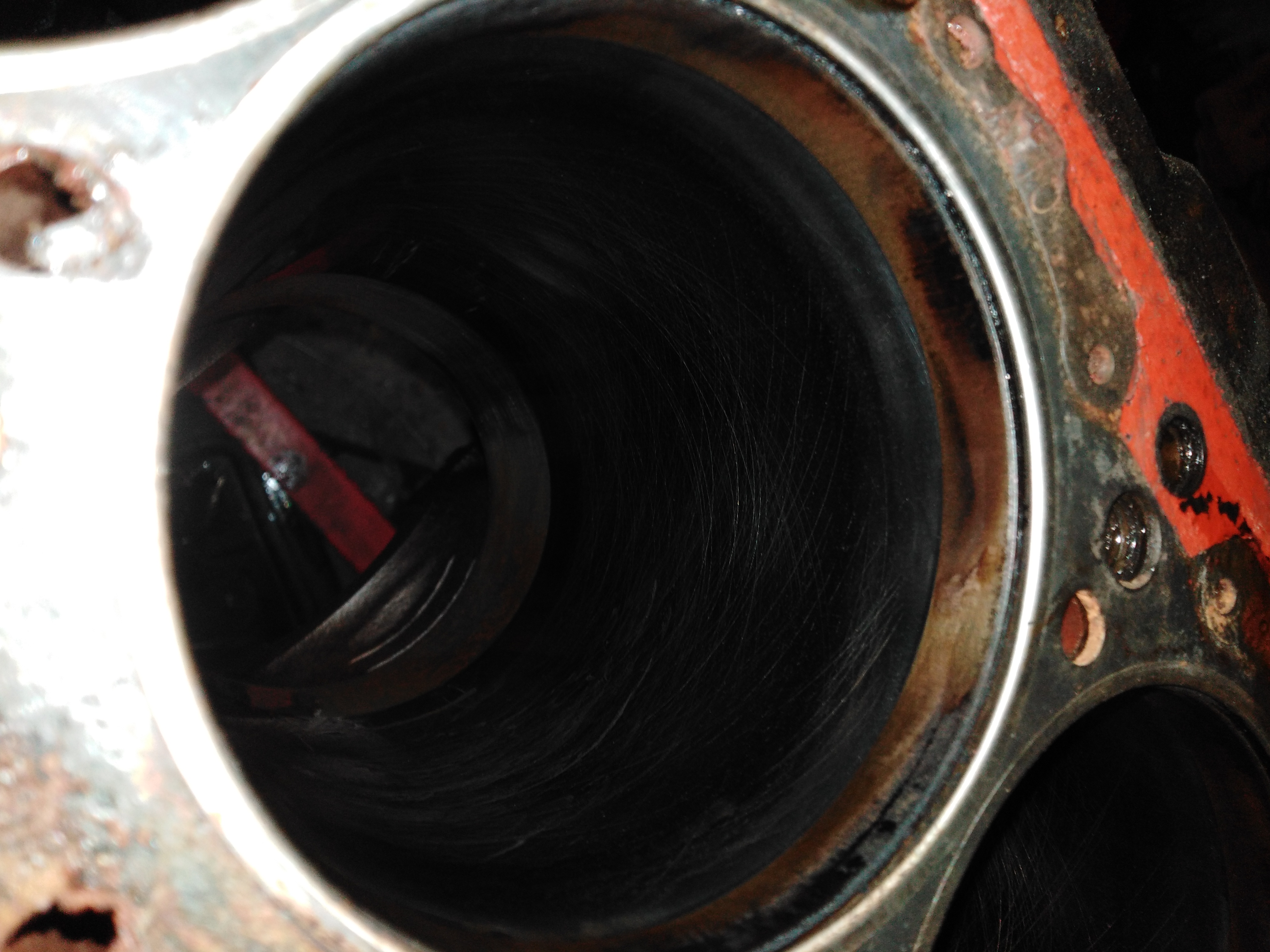

Tonight I thought I'd have an hour or so to start the block stripdown. I want to get it stripped down to all it's component parts then get stuffed checked before a rebuild.
All a bit grotty after nearly 30 years use.

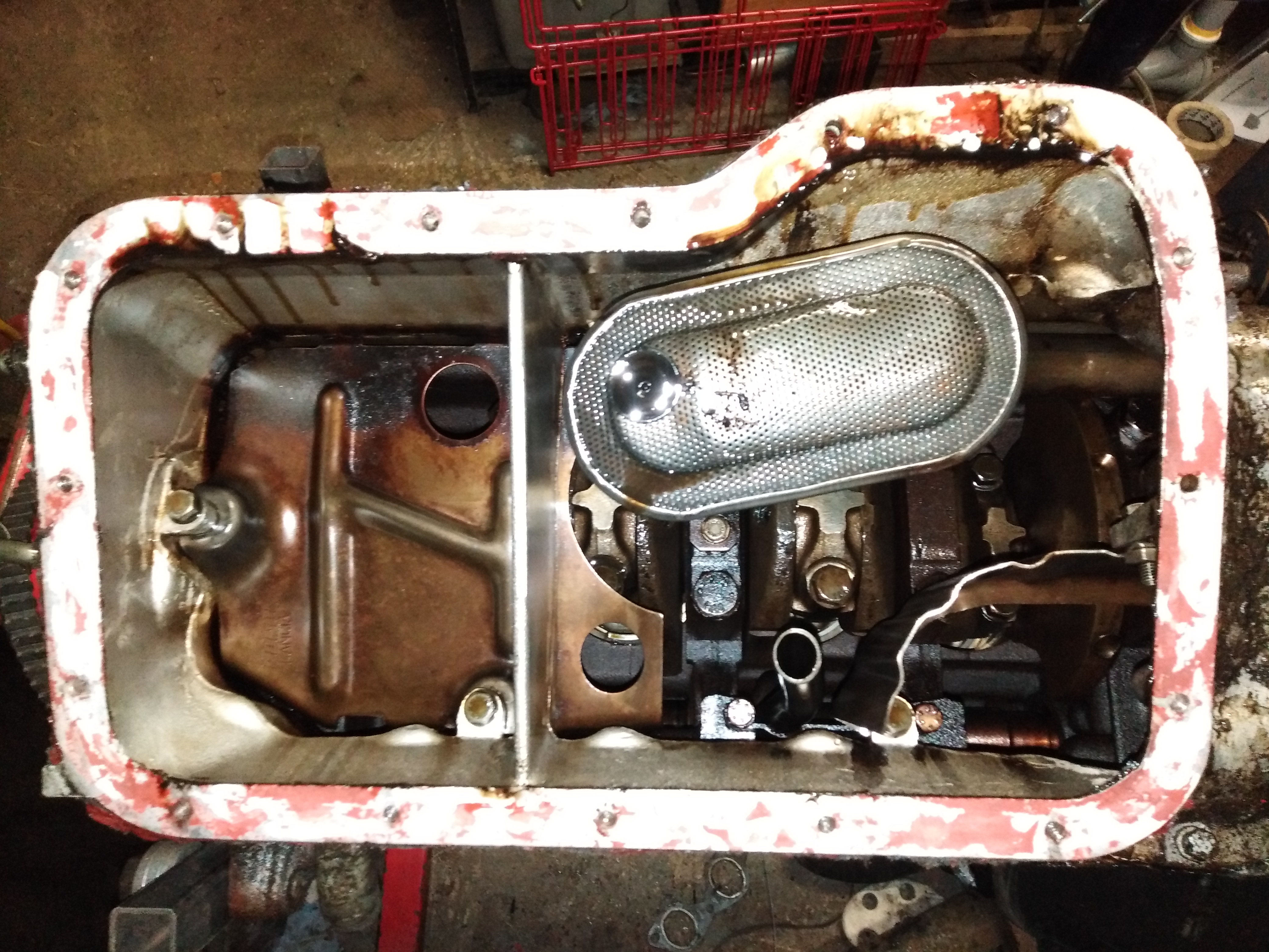

The engine has a cast iron block with a double section sump, this is an alloy deep section that has a steel bottom portion where the sump plug is.

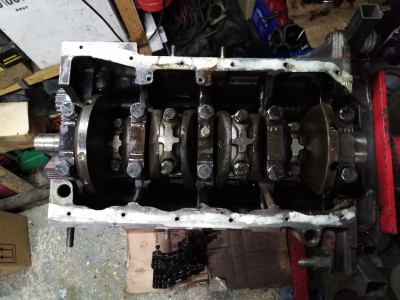

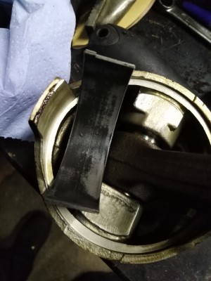

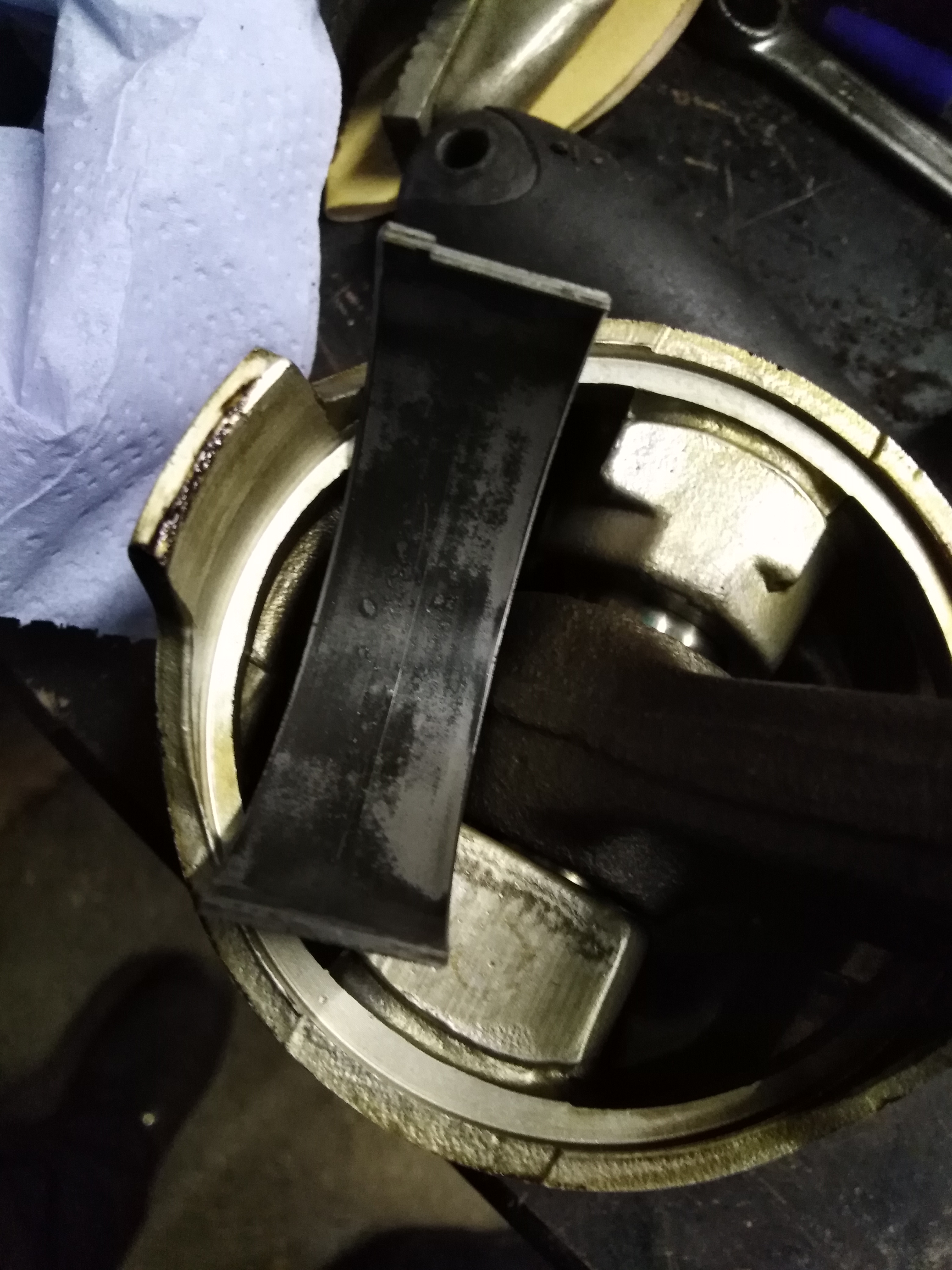

Big end shells look about ready to be changed! Luckily though the crank appears in good health but it'll all get checked out soon at the machine shop.

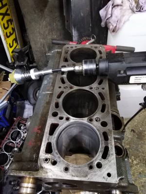

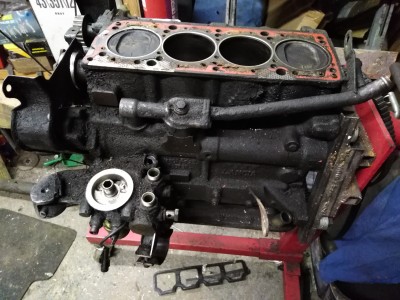

Bores look in great shape, minimal wear with no discernible wear lip should see them just need a hone once checked, new rings and shells is my hope.....
An hour starting the stripdown turned into a couple of hours and all done, saves me a job for Sunday I guess!

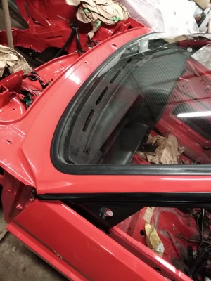

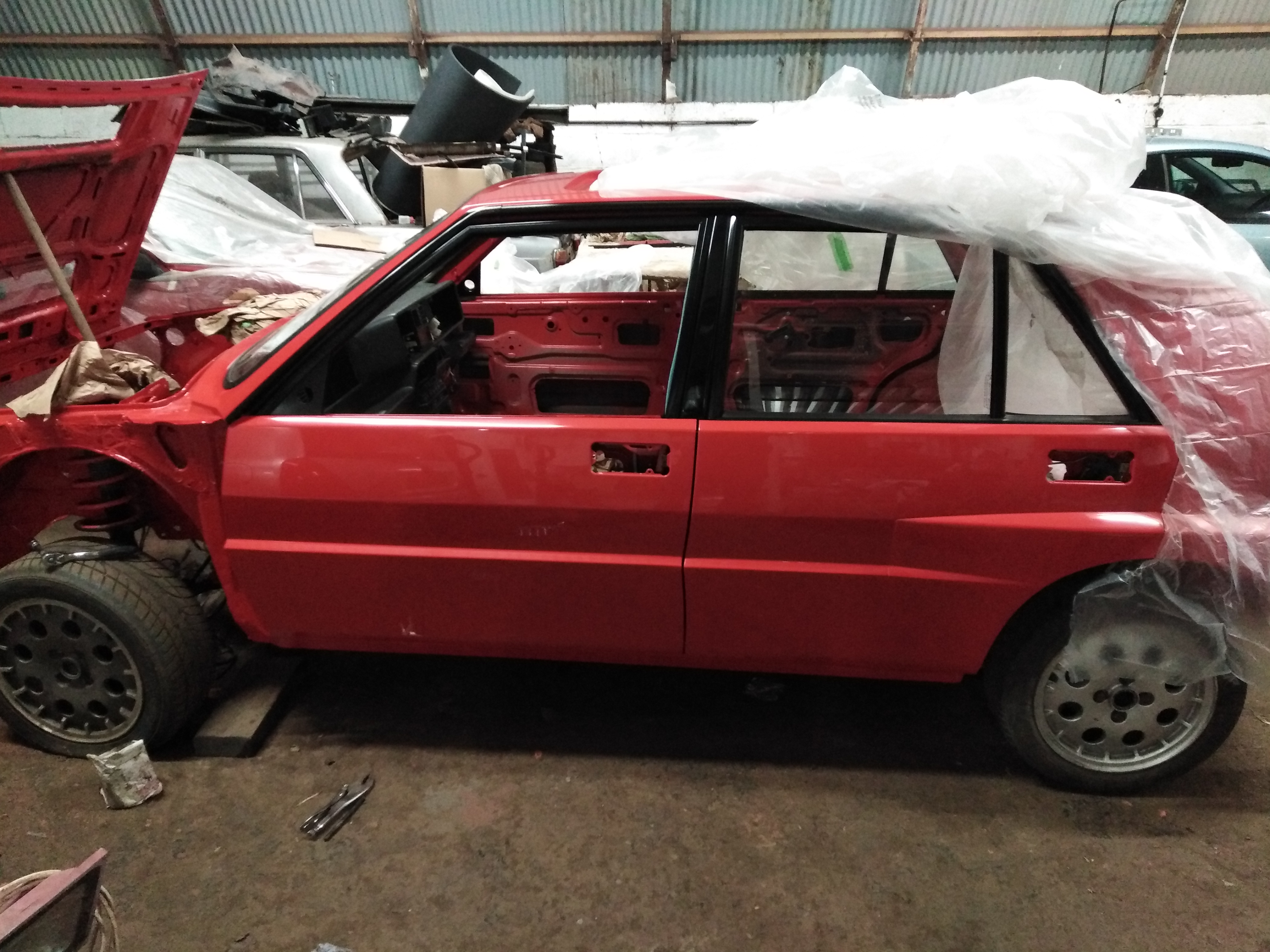

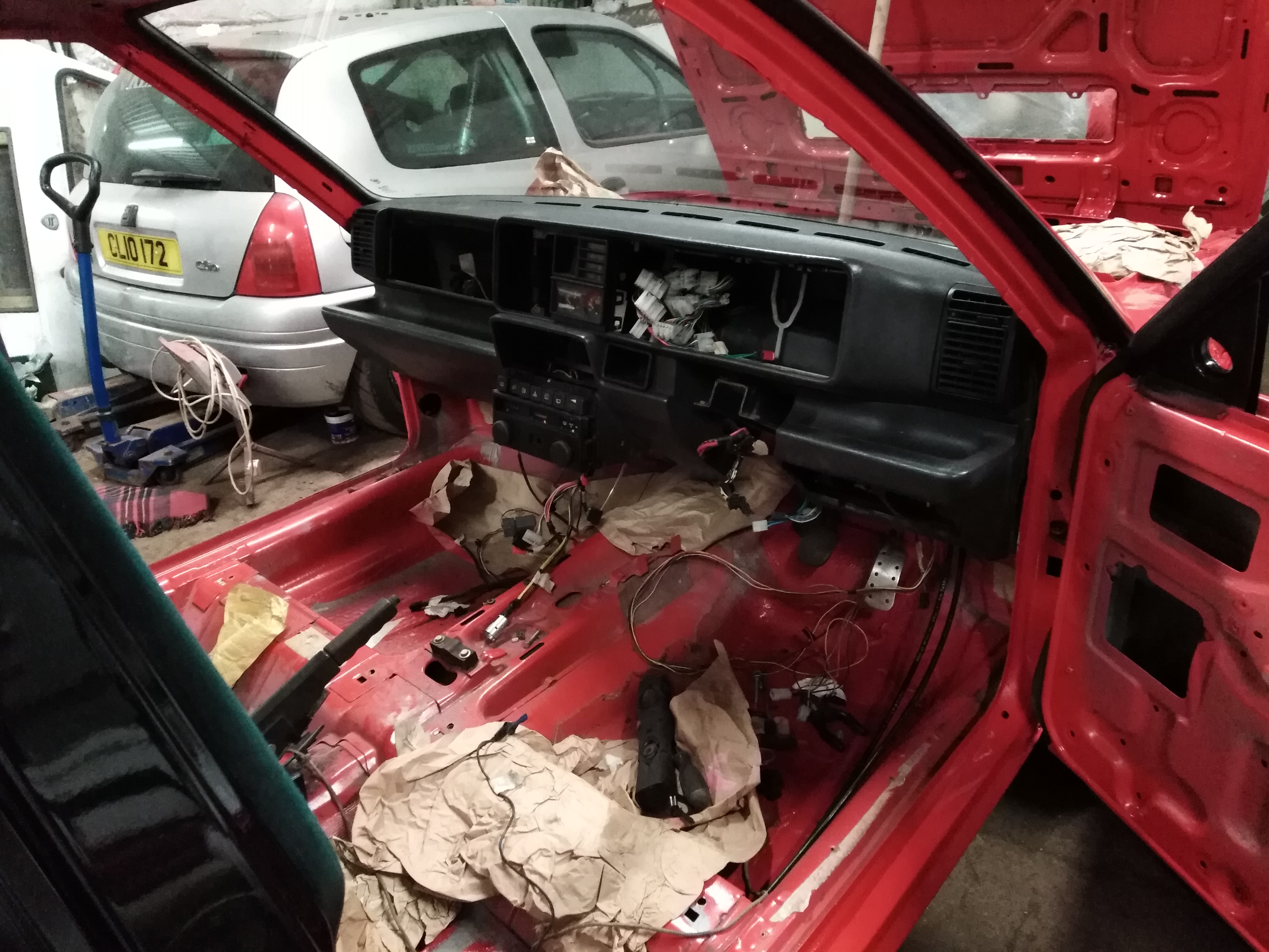

Started off my day by building up the last remaining door, passenger front. The fitting of the seal took its usual lengthy pain in both fingers and time taken.

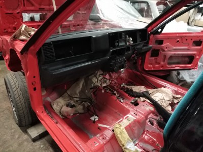

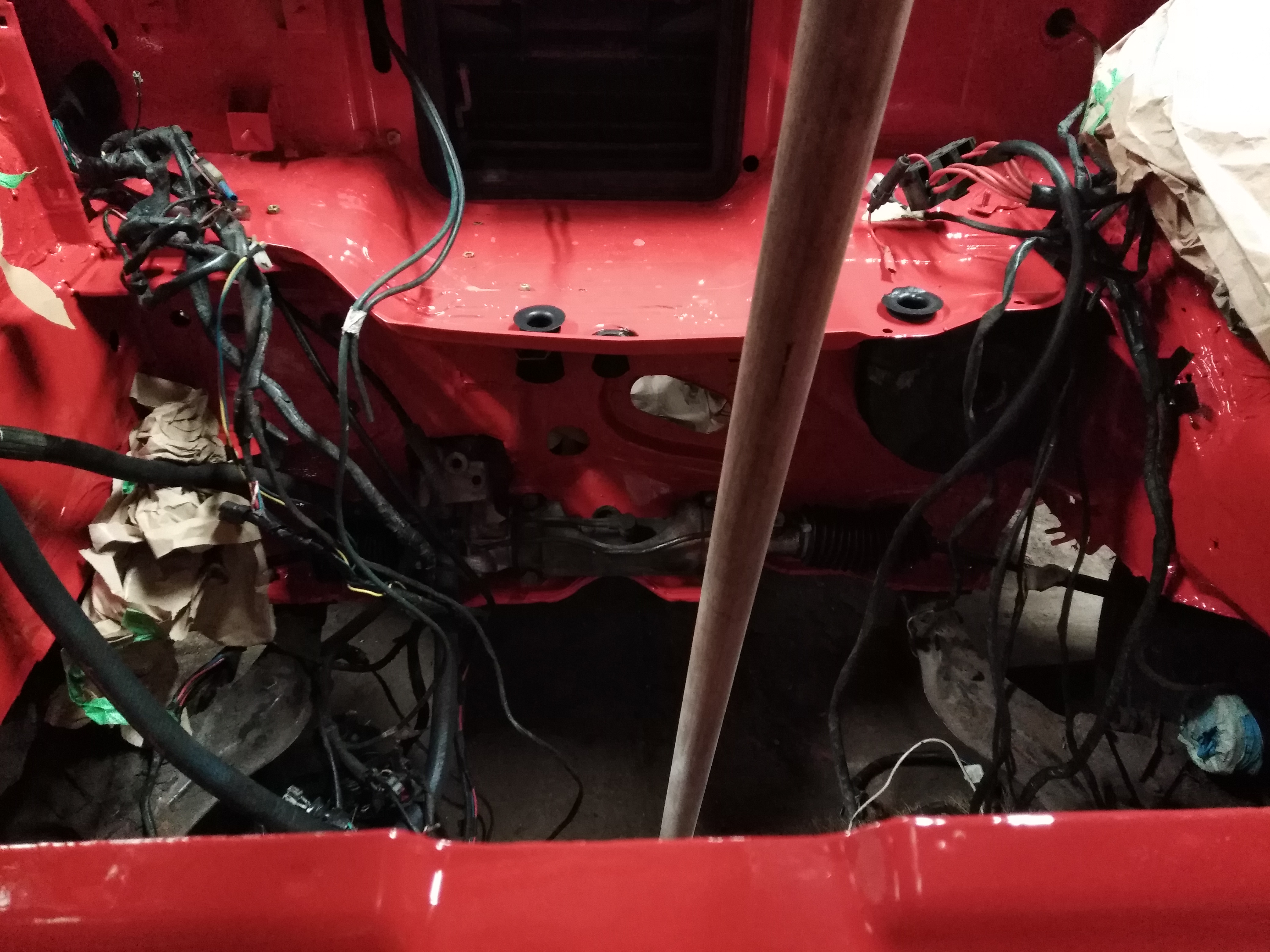

I'd made the decision that the dash ought to go in before the doors went on to aid access, trouble is the fitting of the dash is no small task and I really don't want to have to take it out again.
Whilst access was still good the pedal box, brake servo and linkages were all buttoned up.
Time for the brave pills then.

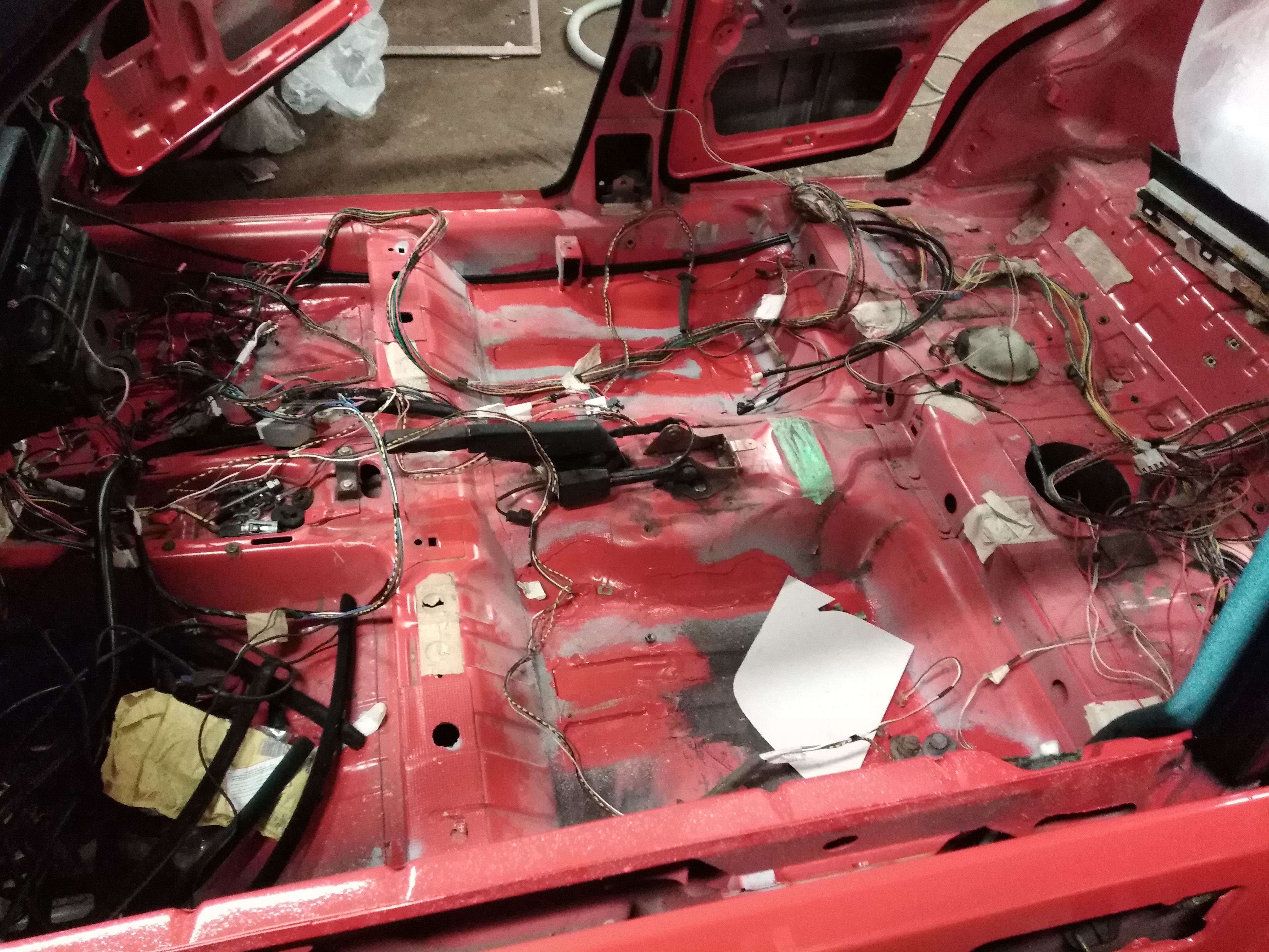

When I took the dash out two or three years ago I removed all the wiring from it then pulled the dash, this was very awkward as the heater channels amongst other parts also needed to be removed to aid the dash removal.
When I stripped the Delta HF last year that I broke to get the useful parts I left the wiring attached and dragged everything engine wise back through the bulkhead still attached to the dash, more bulky to handle but far easier in the long term. A while back I dragged the dash and wiring up to the unit and used the HF dash a s reminder of what went where attaching it all back together.
With a big dash and a mountain of wiring to feed through each side it wasn't a job I was looking forward to but it needed doing.
First off though I cut out some 20mm soundproofing and stuck that to the bulkhead, the original stuff just disintegrated when it came out.
Some huffing and tucgging but in reality it went in well, especially considering the amount of alterations the bulkhead has had where it mounts.
Quite a bit of wiring that had to be dragged through!
As the door was ready for fitting it seemed rude not to fit it!
Snug fit for the dash and 'screen

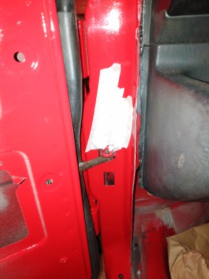

A tip for when tapping the roll pin in for the check strap, put a few strips of masking tape above it so your hammer doesn't mark the paint! :)
Heater box is about ready to go in, new wiper linkage from the scuttle conversion lines up nice, I'll test it before fitting though to make sure it actually works! May strip and grease it all anyway just so it can be on and stay on.
Then laid out the rest of the wiring for inside the car, labels I added are just about still readable so hopefully stuff will go back where it needs to...
Chuffed with my days work, getting the dash in was weighing heavily on my mind, never an easy task...fingers crossed it won't have to be repeated...

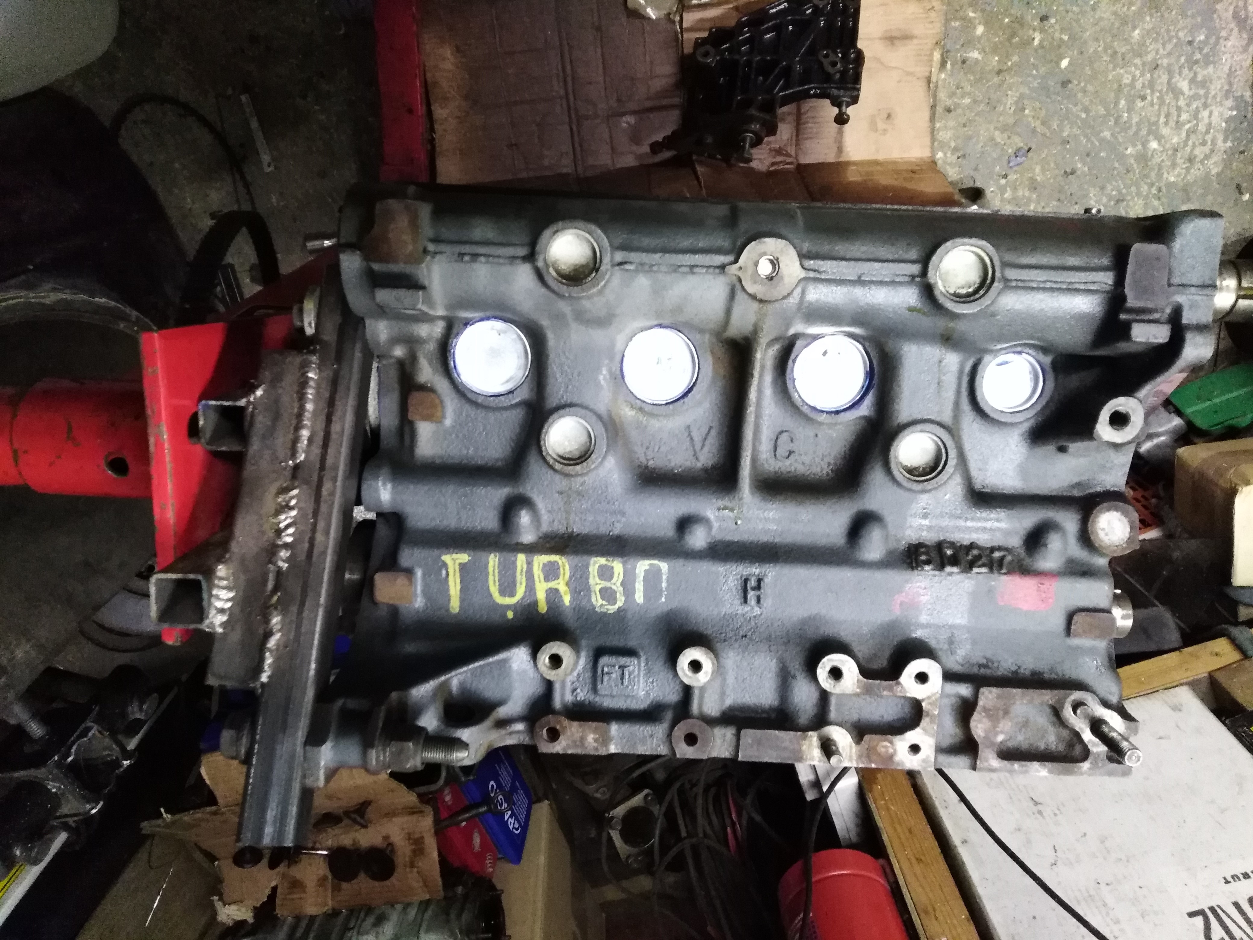

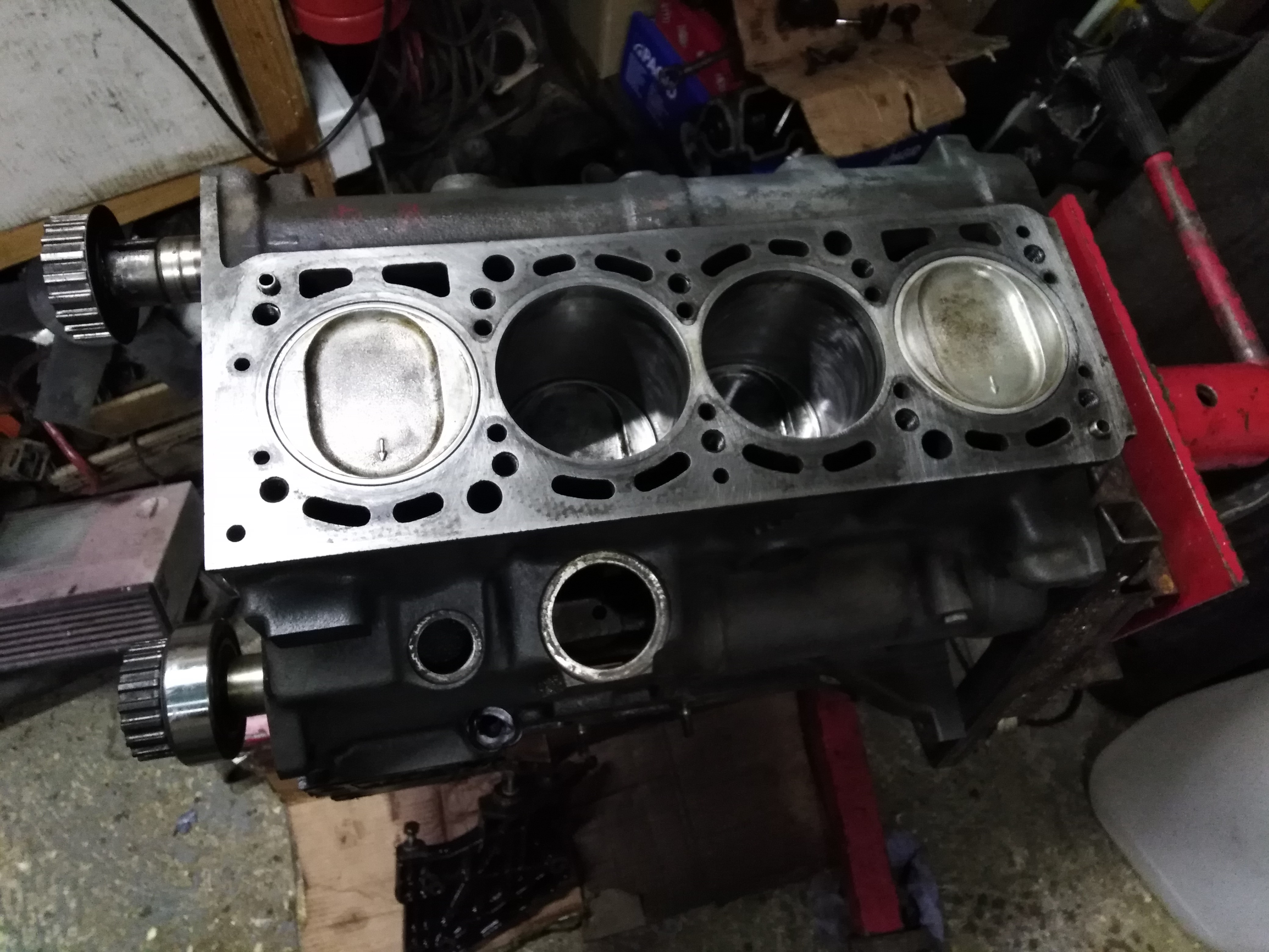

Engine all stripped down now, got the balance shafts and their bearings out tonight.

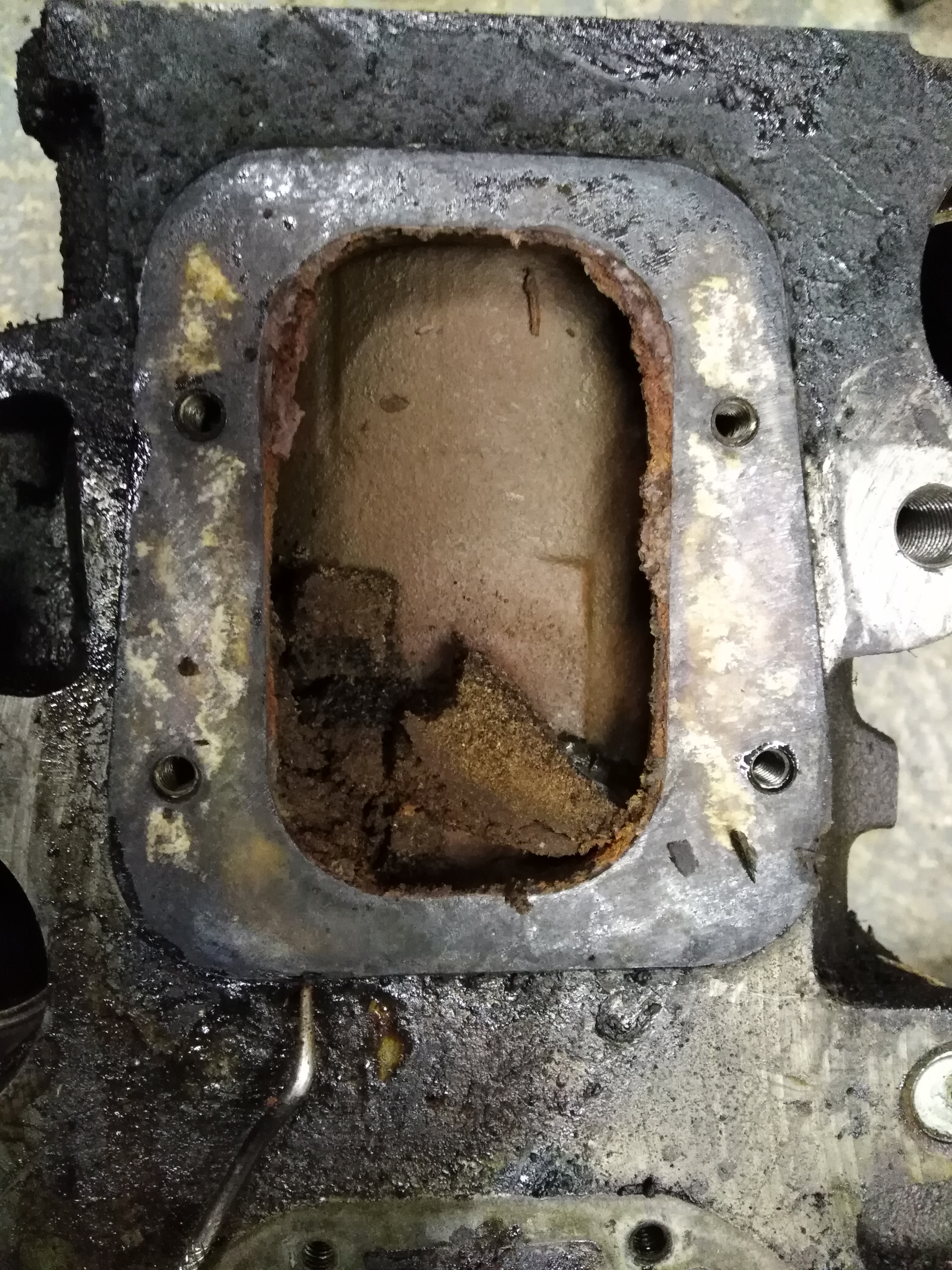

Decided that although the waterway core plugs looked in fine fettle on the outside the fact that they are now 30 years old they ought to be changed, so popped them out. They were in great condition underneath! Oh well, at least when the block gets flushed it'll flow nicely.
An end plate at the gearbox end also came off, look behind it! Hotspot city!!
Quite a build up of crud and sand..
Boot of the Brera loaded up with bits now to drop off tomorrow afternoon, every car has to earn it's keep :D
Hoping they'll be able to have a good look at least if not get things done before Xmas, at least then I'll be able to plan on rebuilding it in the new Year.
Loads of parts to clean up yet though, but thankfully nothing broken to repair...

how on earth does that much crud and sand end up inside the gearbox???
rsfruitbat wrote:how on earth does that much crud and sand end up inside the gearbox???
That's the engine block mate, inside the waterway at the back of the block. Head face at top of picture, rear crank seal mounting plate at bottom of picture. There's a blanking plate that bolts over that hole where the crud has settled in the waterway. With all that muck sat there (was a good inch high) then the cooling would be compromised on that cylinder, OK near the bottom but still would affect the cooling abilities.

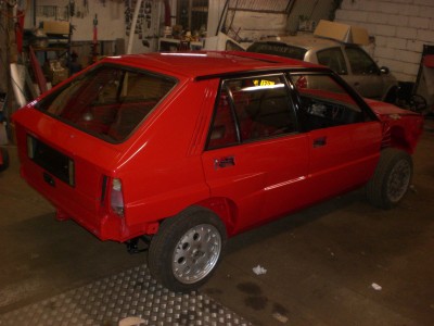

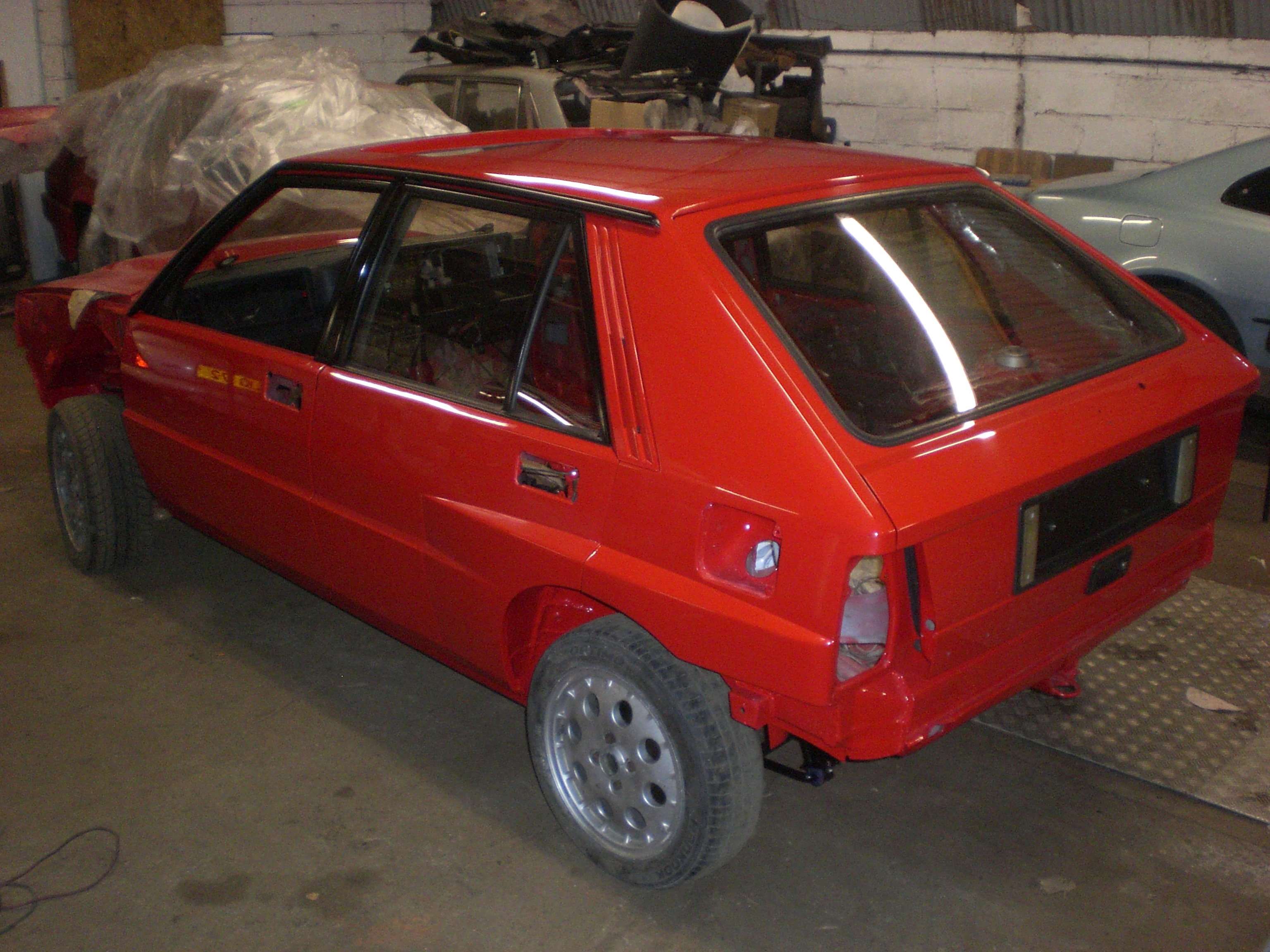

So after all those delays it was about 3PM before I got to the unit..

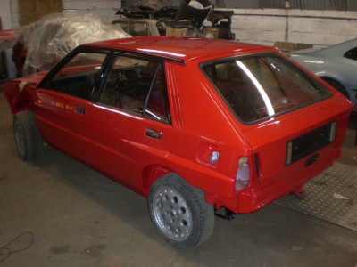

Task for the afternoon was to fit the hatchback.
Before it could go on though there was some prep to do.
The wires for the reverse lights, wiper motor and number plate lights needed feeding back through the side pillars. I wrapped them in loom tape for some extra protection.
With that done and the grommets all in place the hatch got lifted up and bolted into place, a little adjusting and a decent fit was easily found.
Rear window got a clean down then the seal refitted which I'd cleaned last Sunday, all slipped back into the hatch without issue.
Number plate surround got stripped down last week and had the bulbs changed, wiring checked and everything given a good clean up.
Struts got cleaned and fitted with grease in the ball sockets, just the little details that make them last but take time sorting.
Latches fitted and adjusted, repaired handle went on then that was about done for the hatch fitting.

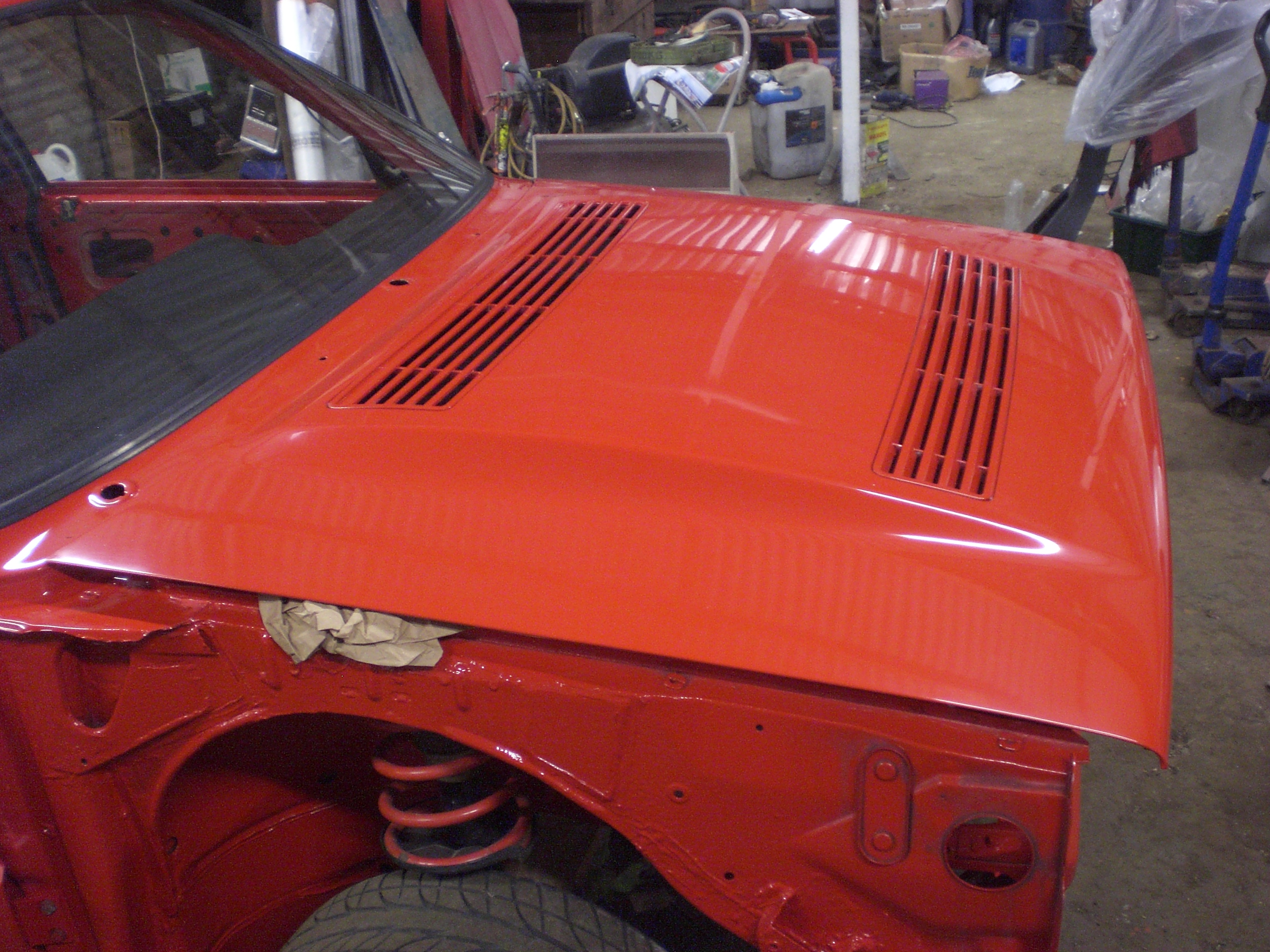

With renewed enthusiasm I set about one last job before packing up, the bonnet grilles.
They've been sat in the car for a while now and would be much safer attached to the car!
A long day, didn't leave the unit until gone 10PM but very happy with another big task done.
Just the front door windows then that's all the glass done.
In all likelihood it will be the New Year before I get back up there so nice to leave it on a decent visit.

Bores honed which were in great shape anyway, cleaned up nicely.
Crank and pistons back in, everything checked for tolerances and all within spec. New big end shells, main shells, thrust washers and piston rings. All still standard sizes, original pistons etc still in fine fettle.
Original paint on the block will be staying, core plugs replaced in waterways.

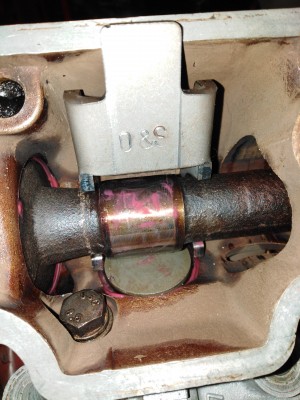

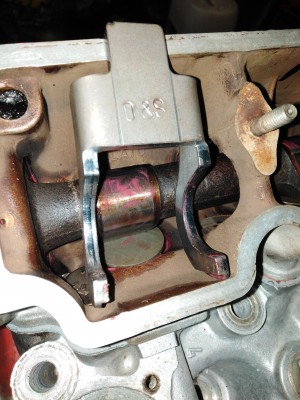

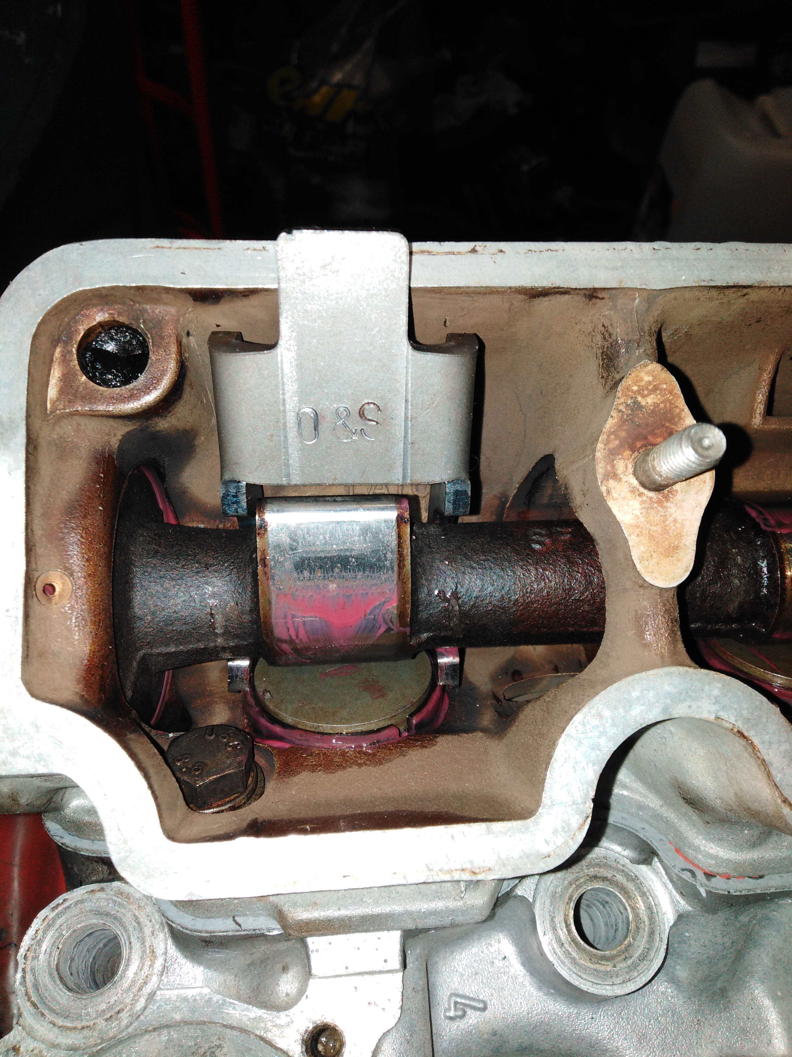

To set up the tappet shims requires a special tool. I'd done the Dedra turbo valves at Guy Crofts' place last time I did one as tools were impossible to find, I did manage to find a tool though out in Germany, another £50 or so spent!
Handy tool though.
First you wind the cam to open the valve fully then insert the tool which sits on the edges of the cam bucket,
You then turn the cam releasing the valve but the tool hooks under the camshaft and holds the valve open enough so that there is a gap o allow the shim to be removed and the correct size fitted.
This is the tool, expensive for what it is but the alternative would be to remove the whole cambox and hope that when clamped down again the new gasket would seal and the caps remain the same....
