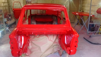

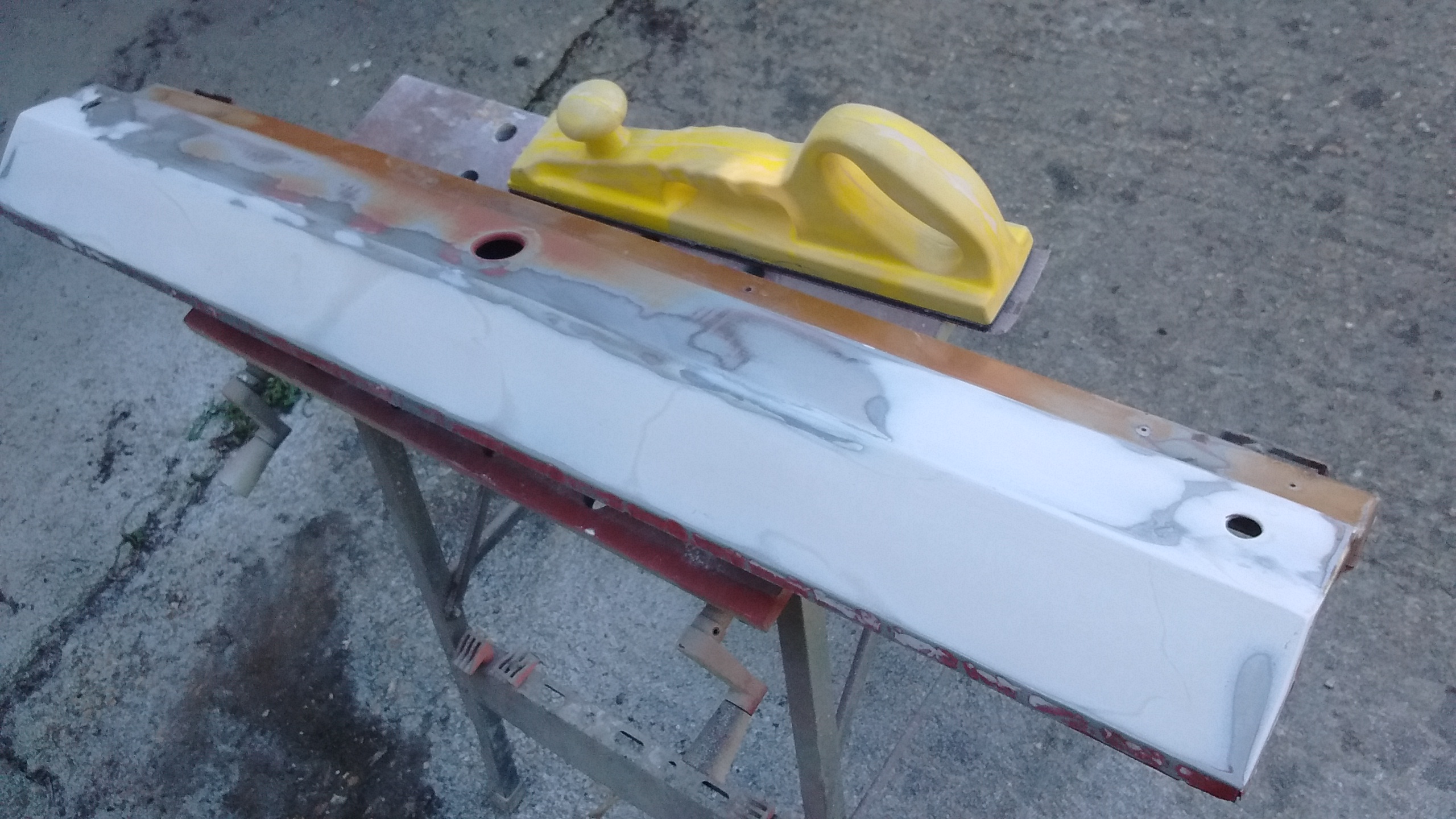

rear panel all repaired now, holes at ends all boxed in
all straight enough now
did a few other jobs in preparation for finally starting to get some primer on very soon...

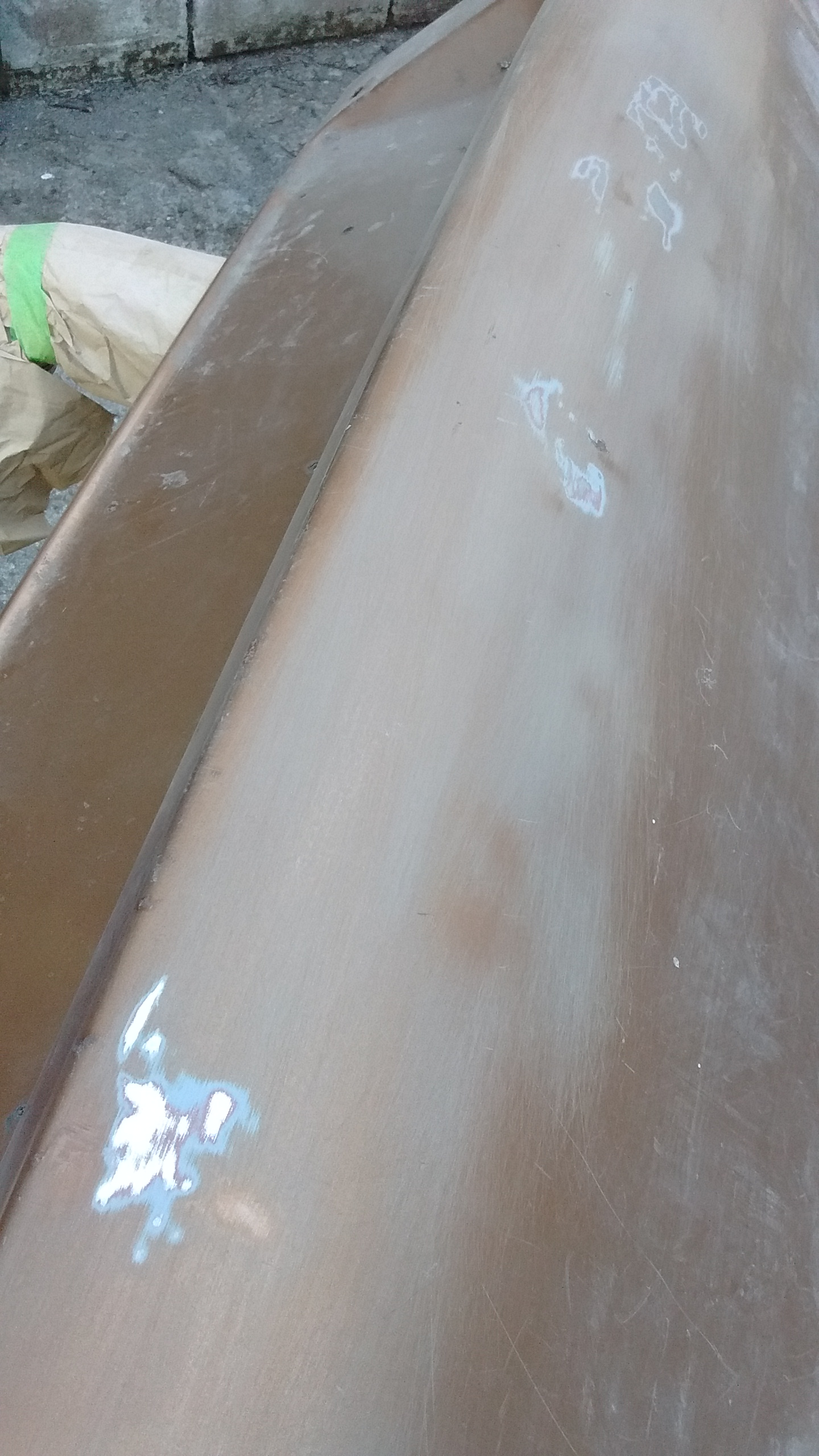

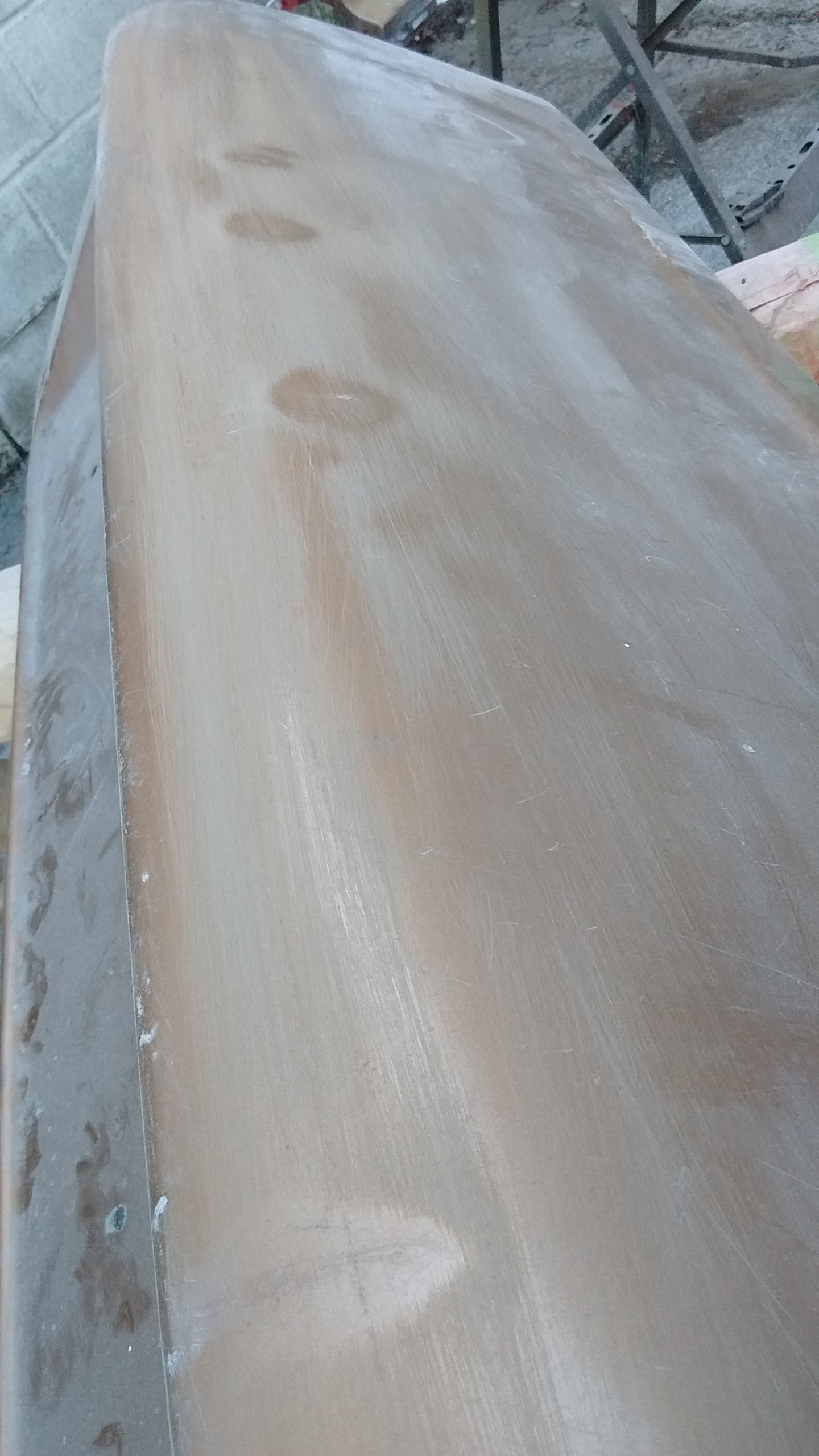

bootlid had a few dents in it to sort out so with that being the last panel (besides the grille, keep forgetting the grille) which with a quick glide over with the long sander showed them up well
bit of hammer & dolly work and the dents are pretty much gone
a quick thin skim of filler and it's all straight, could have straightened it out with the filler primer as the marks were shallow enough but quicker and easier to skim it over

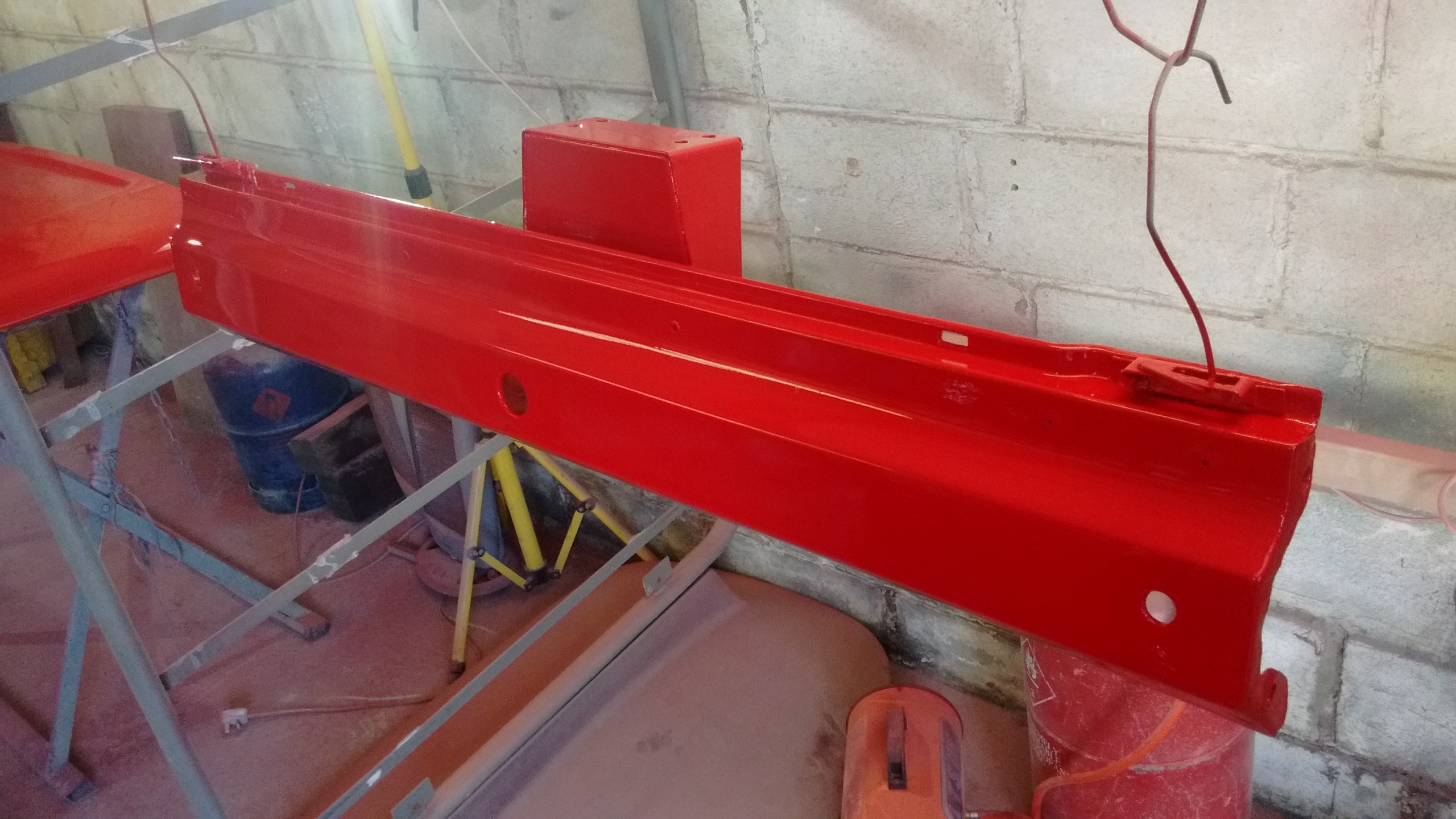

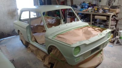

bit of a long weekend on the little Imp just gone, arrived at this stage this morning
that's a long story cut short!

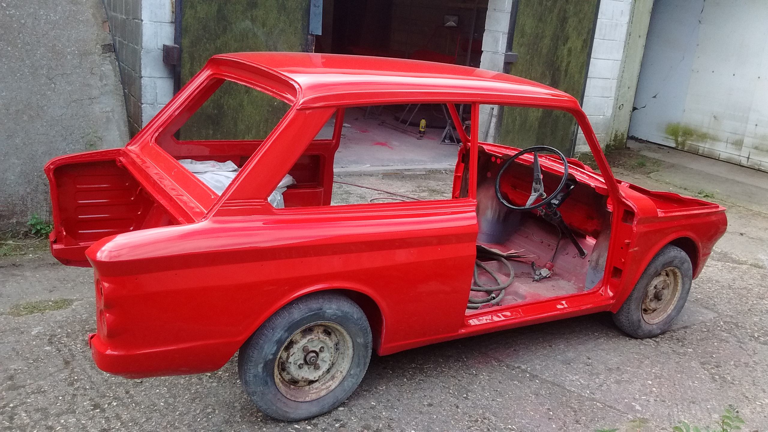

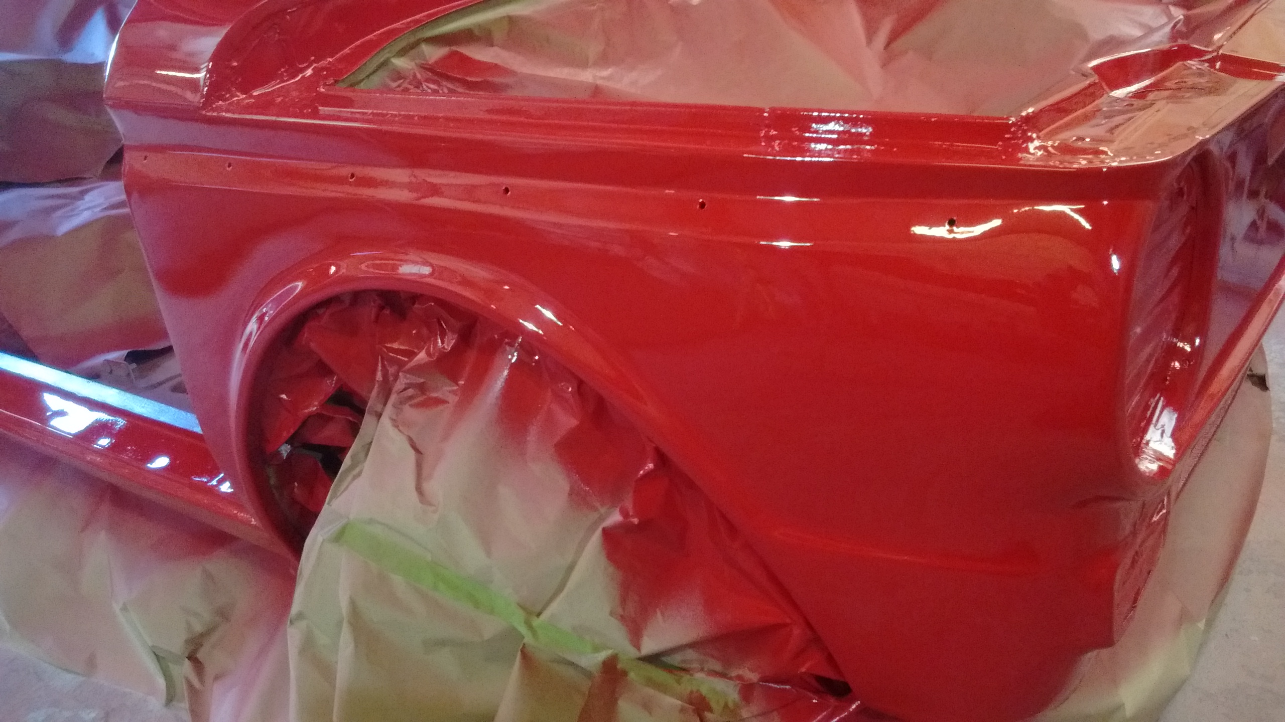

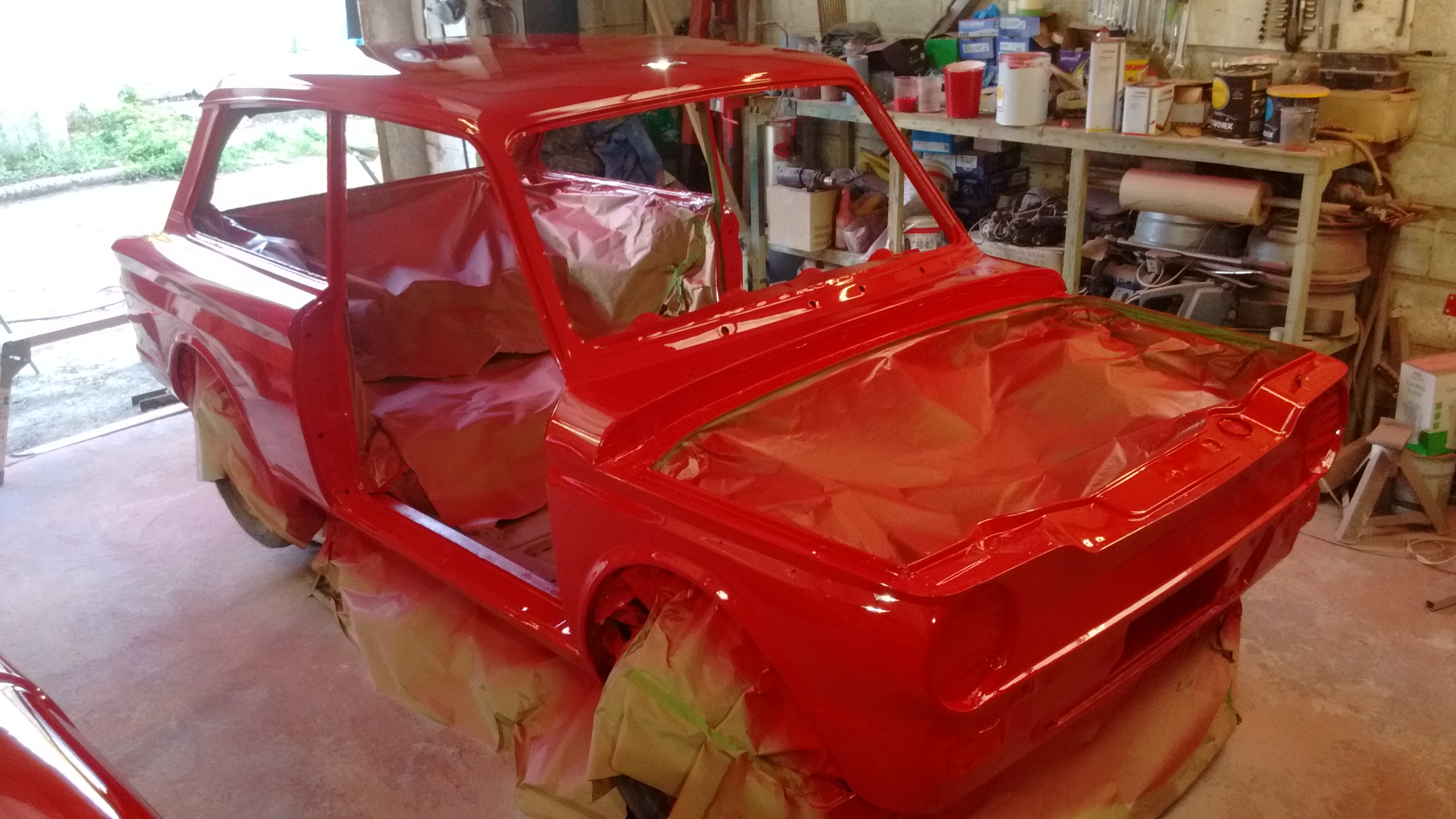

this afternoon it finally got some red paint on it, seems like ages ago that it got started......
Re: Kev's workshop projects
Good days work buddy,
Looks nice, and a bit "redder" than i was expecting from robs colour choice, and in a good way!

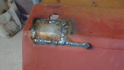

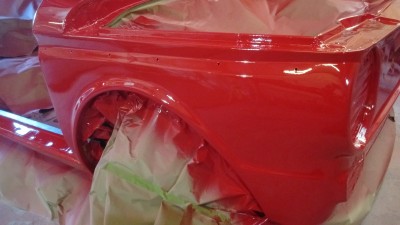

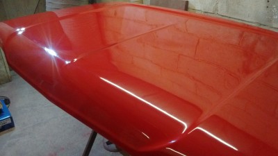

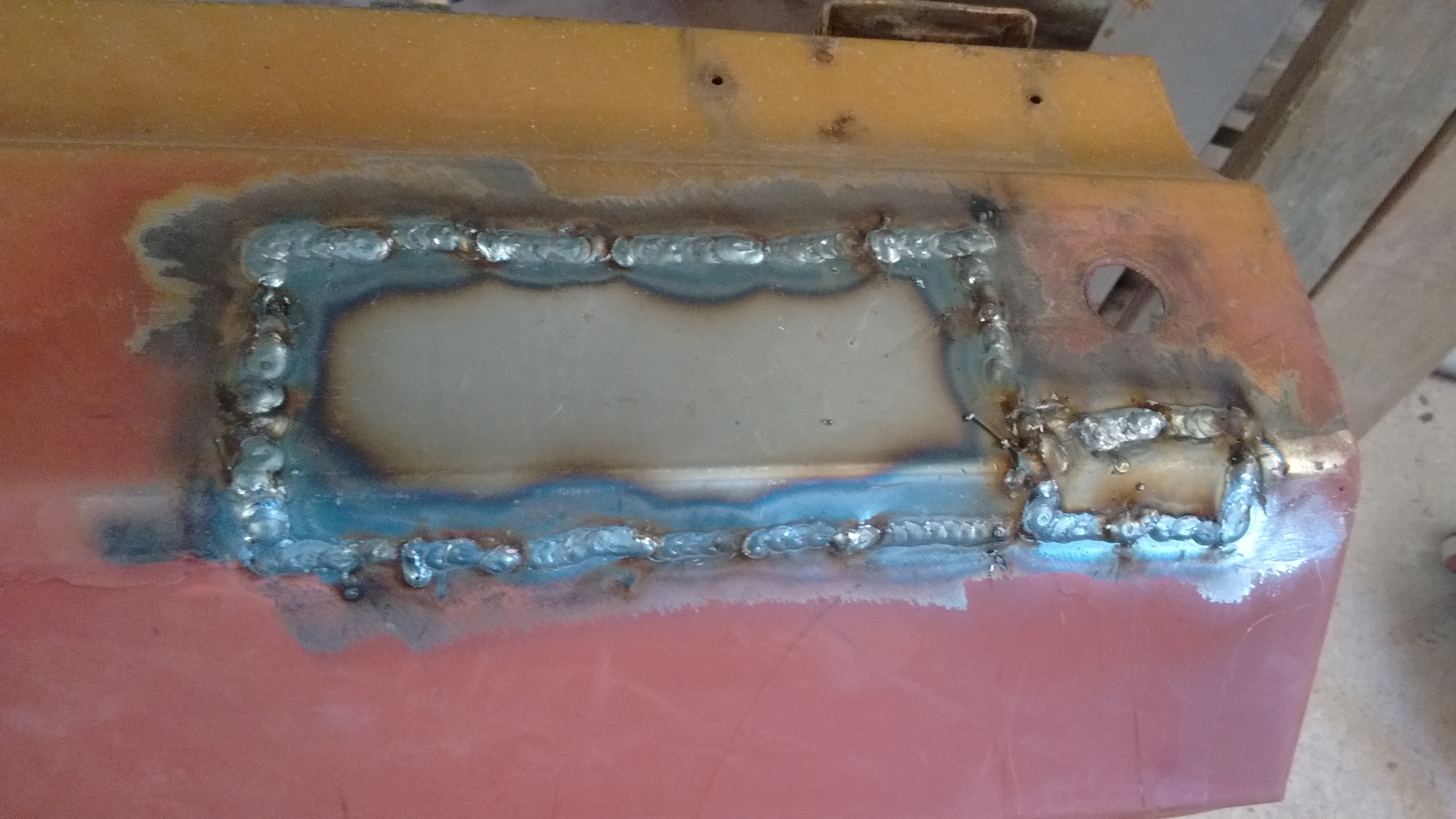

back edge of the roof had a 4" wide repair section across the full width, happy with the result

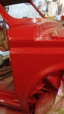

drivers front wing got probably the most repairs. again, it's come out ok.
it'll all get flatted & polished in a bit, next job is to pack everything away from the unit as I'm moving out this weekend into the new bigger one....

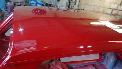

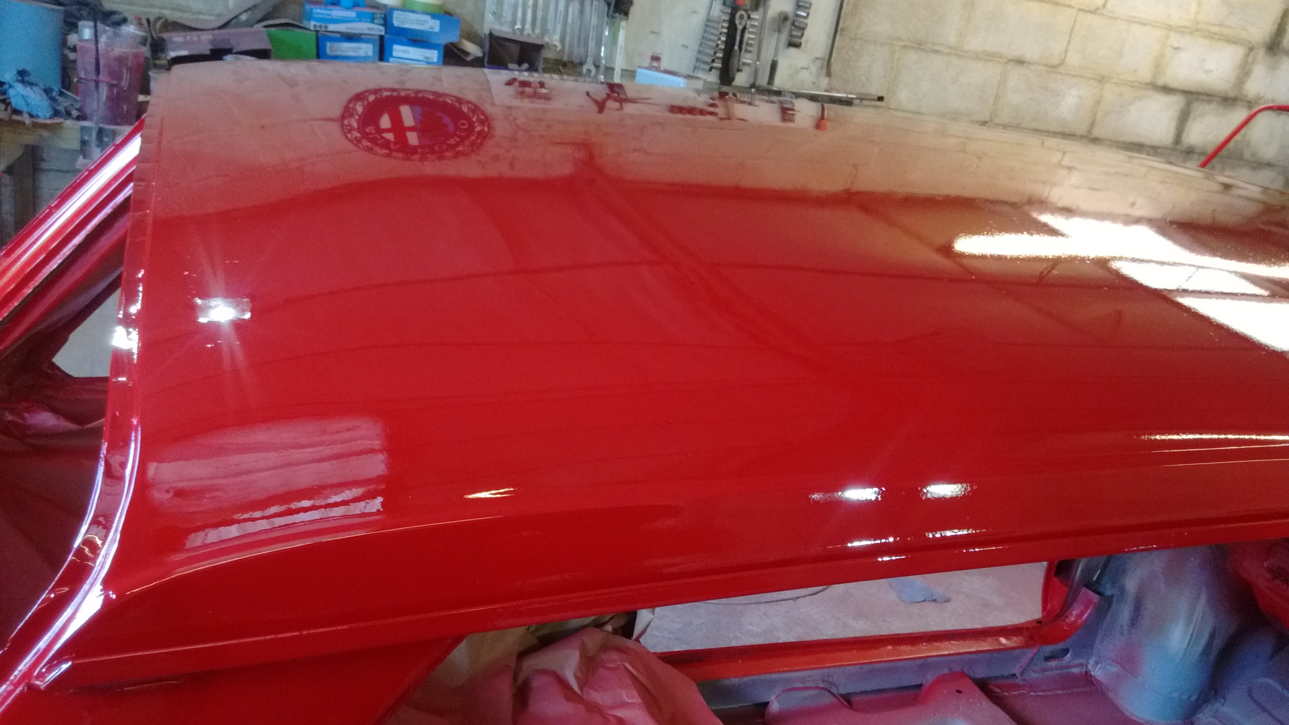

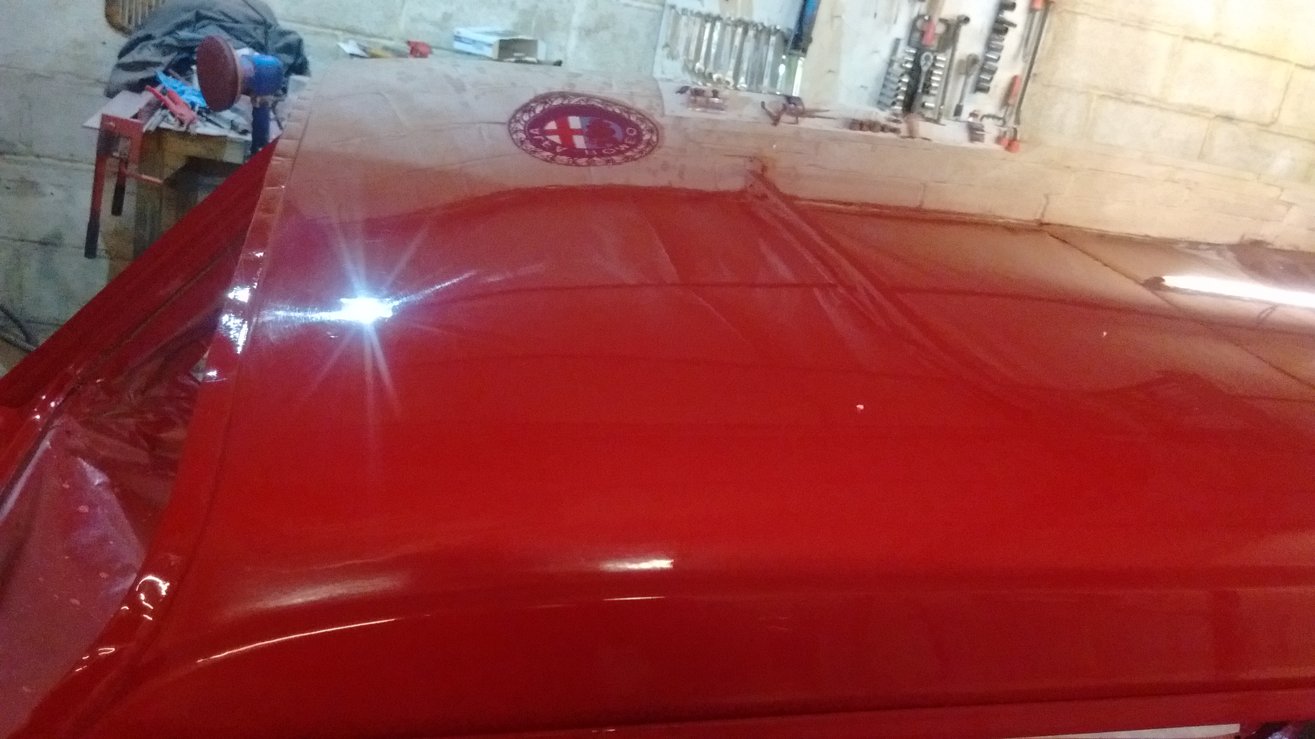

I liked the reflection of the Alfa Romeo logo in the roof shot.

Yes, try and get the Alfa shield into any shots just to keep some kind of connection! It will be taken down off the wall tomorrow with the move that's for sure

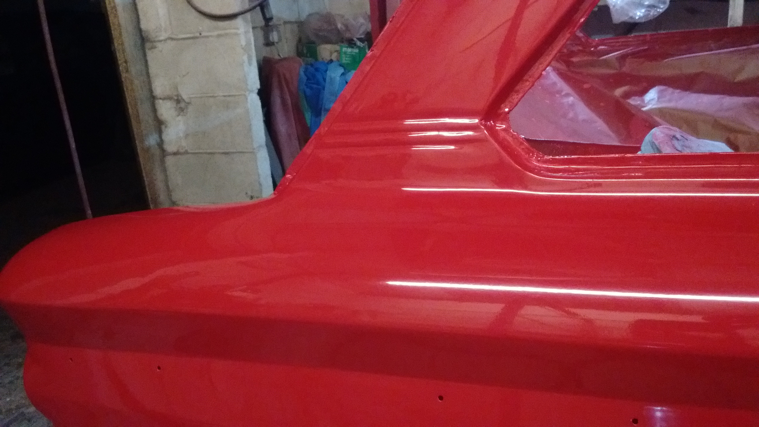

In fact I tackled another task this week, getting the large dust extractor down from the roof as I'm taking it with me too, a block and tackle rigged up from the roof beams lowered it in relative safety...

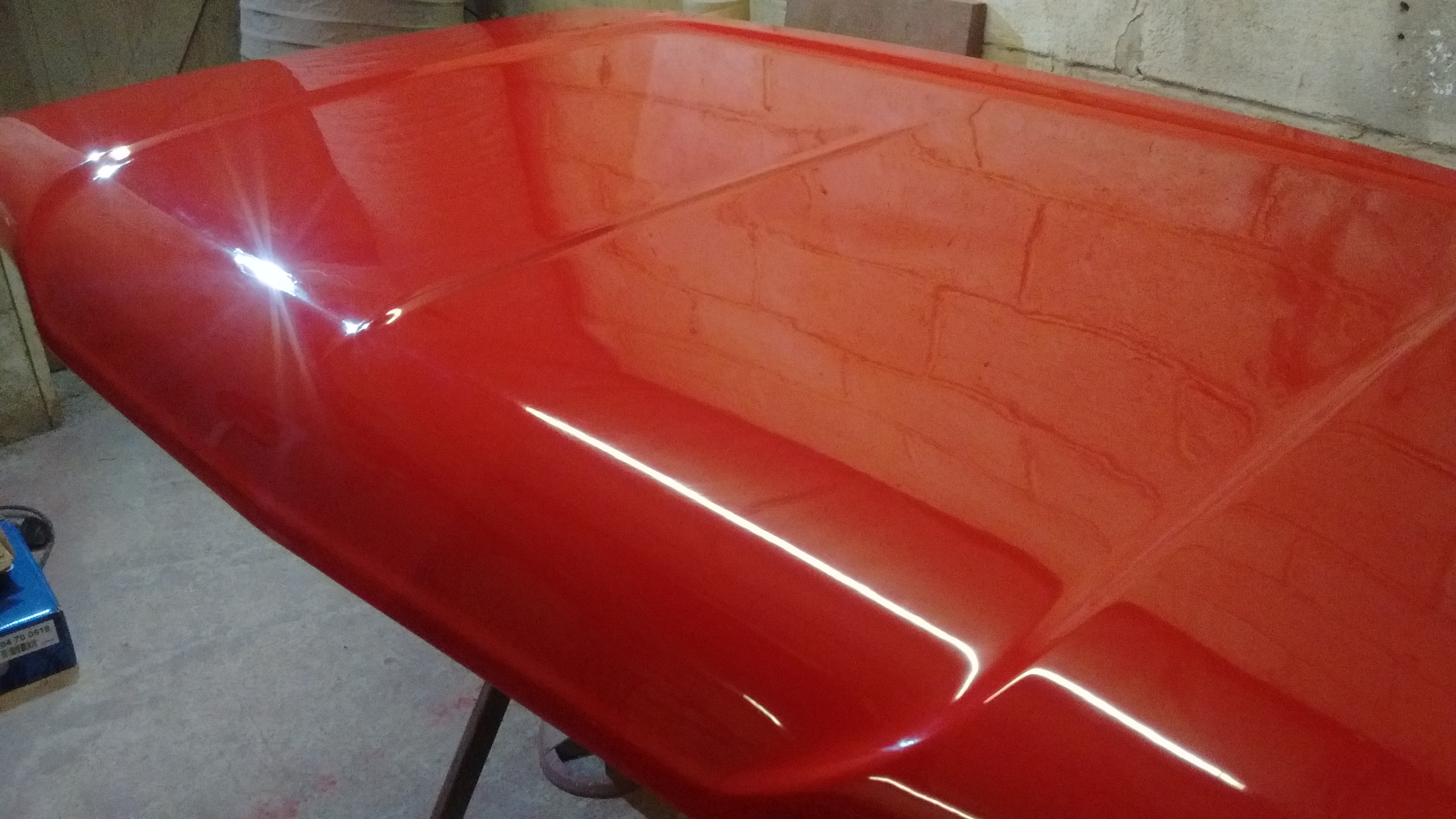

This afternoon the task was to flat down all the fresh paintwork then complete all the stages of getting a shine back, didn't know if I'd complete it today but staying at it until after 10PM finally got the little car done.

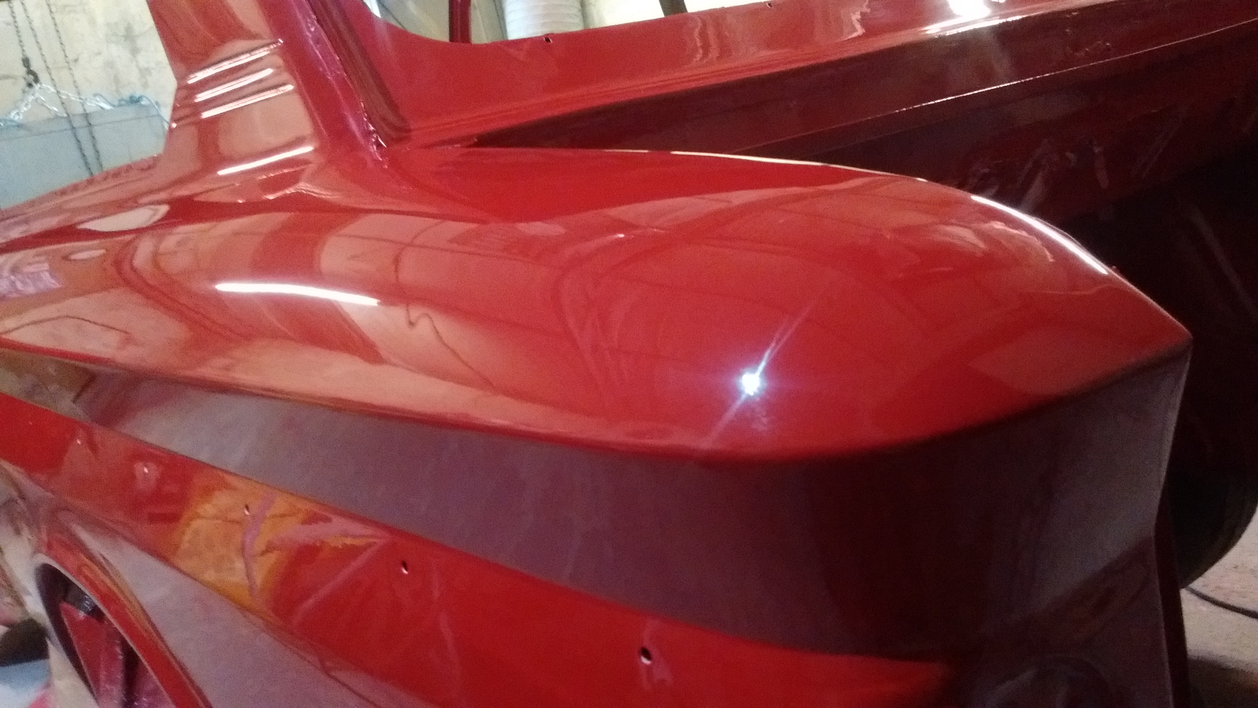

The section of rear 1/4 pillar that I had to make up with the 3 grooves gave me trouble in trying to make it but I'm happy with the results..
Front wing was also a bugger, but came out pretty decent.
Lots of hard work, no real short cuts, but it has again come up pretty decent.

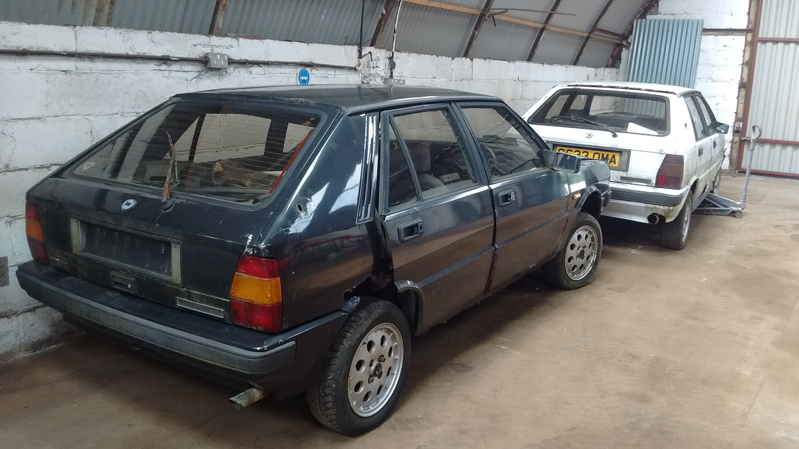

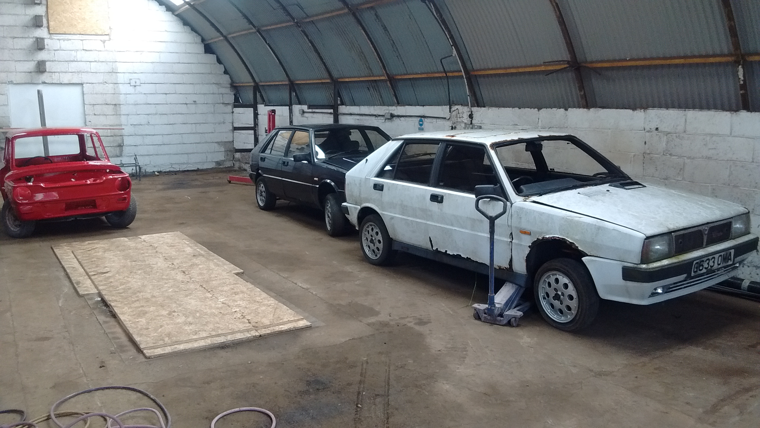

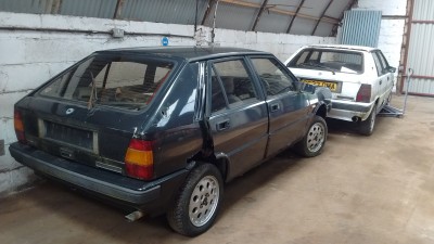

Finally, around 6 months after buying them I got my 2 Delta HF Turbo's this morning.
White one is a scrapper once I chop some bits off it, grey one will be restored to it's former glory in due time.

Plenty of room there Kev.
Good luck with the new place, is it close to home?

Had a good chat with John this afternoon who is renting it with me, we've mapped out where we are going to have stuff, plenty of room as you say but if not careful it could soon get filled with all sorts of kelter.
Enough room for prep/welding which will be properly cordoned off from the rest to keep the dust and mess from the rest of the workshop.
