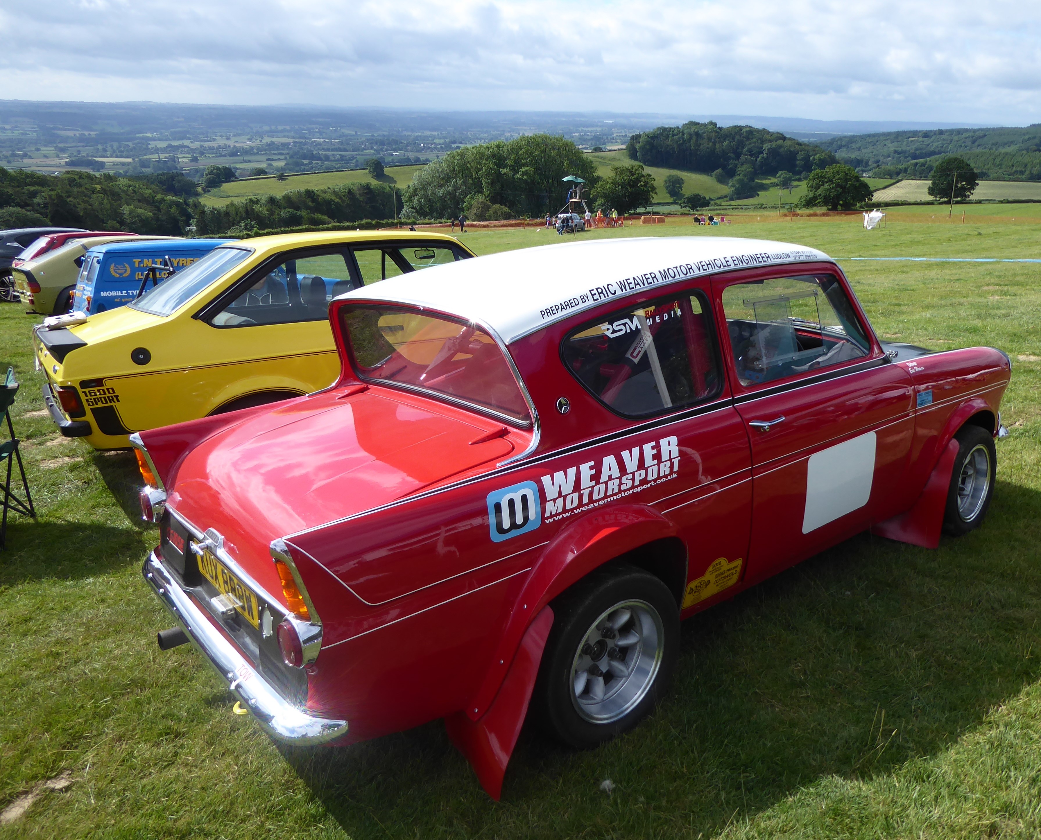

Great day out at Richards Castle soap box. They rundown all day and we run up at lunch time and for some reason we got 3 runs today so a good blast in the car and its running spot on. :D
Sitting nice now as well after a little bit more adjustment.
Eric Weaver who has helped me a lot has this Anglia and drives it well. Got all out of shape on his second run and just gave it more stick to get it back, so big black rubber marks up the track. :o I was quite impressed.
Also one of the good things about this place is the views.
Posts: 2894
Looks like you had a great day out, and you're right, views are fantastic.
Anglia looks a tough bit of kit :D
Yep there is not got a bit of it that has not been worked on at one point or another to improve it. Its won a lot and Eric has been west midlands champion in it.
Quite impressive. Esp to some one who knew nothing about Anglia's. :lol:

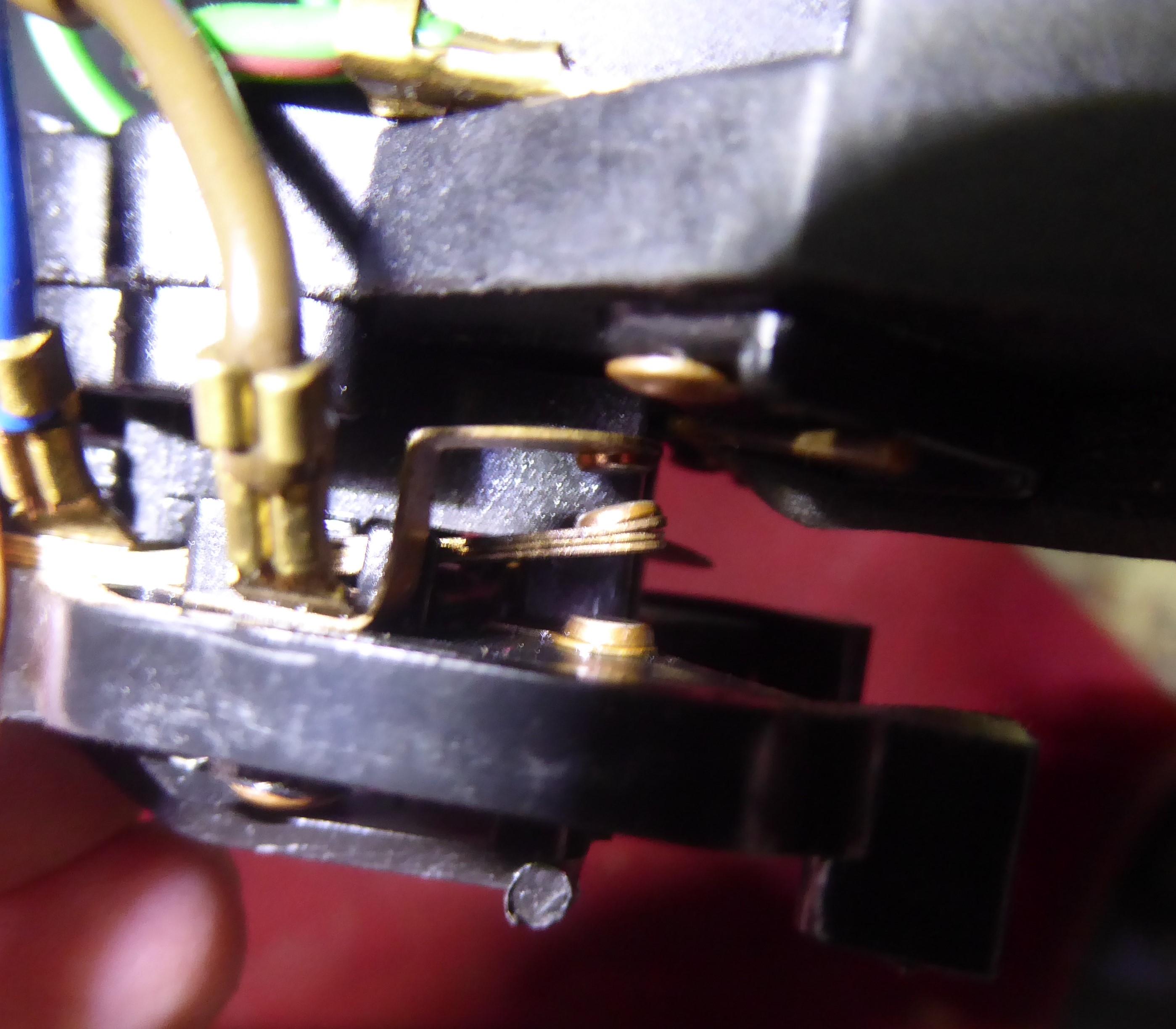

My Citroen has had its dual mass flywheel come apart :roll: and so got the Sud out as everyday transport.
What fun. Until the main beam stopped working !

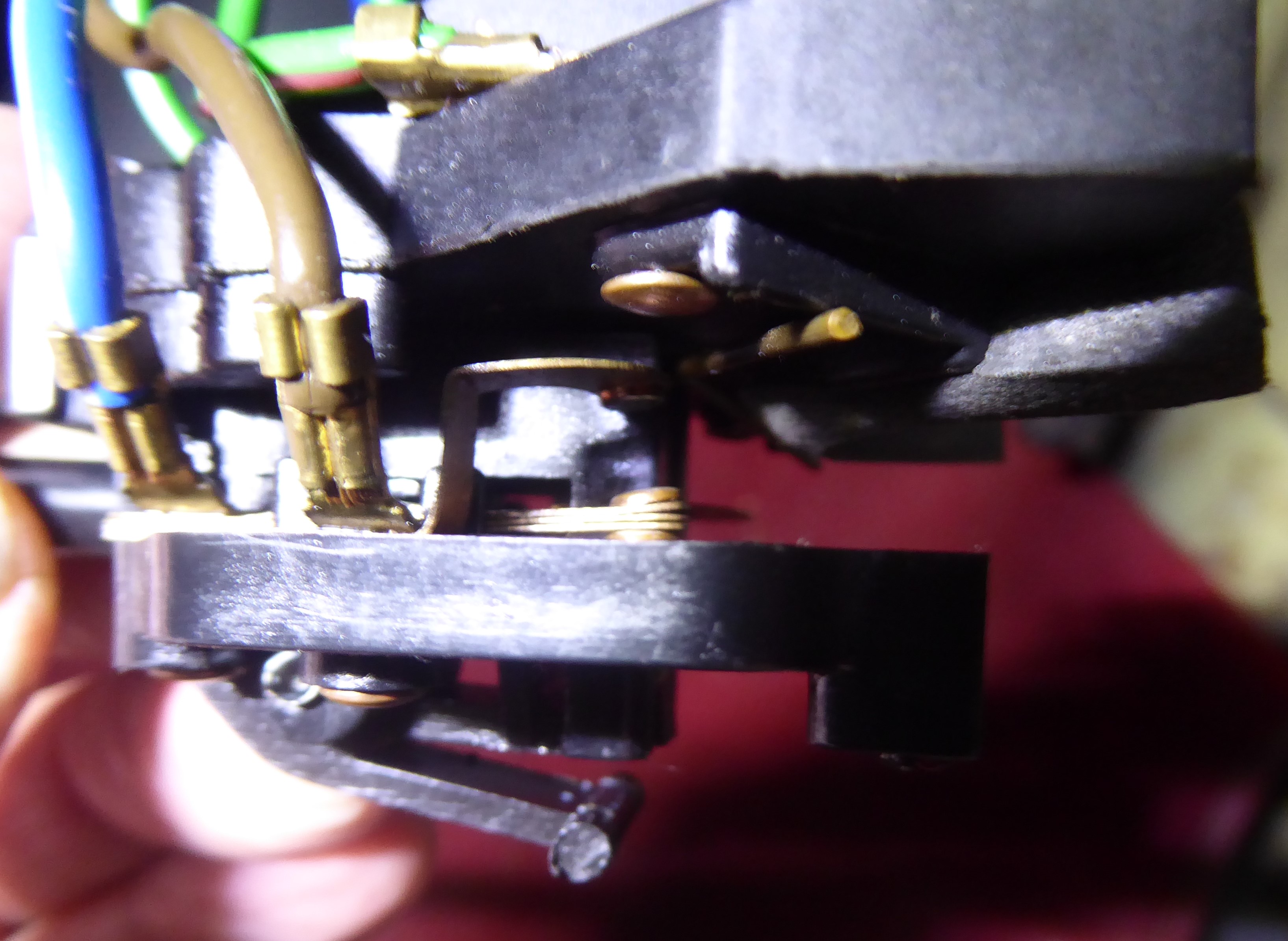

Traced the problem to this contact not coming down hard enough on the bottom pillar to make a good contact.
I would rather build the bottom pillar up than bend the tab down as if it does not bend well I have ruined a £45 switch. An it does feel resistant to change (like many of us)
where as if the pillar can be built up I an always file it down again.
Anyone solved the same problem. Blob of solder or would it melt the plastic ? Liquid metal ? Conductivity. Thank for your thoughts. :D
Posts: 1518
Are your switches early or late type?
Its a lucas one. SQB114. Chosen so I could get a lot of functions easily on one stalk.
Ta :D
Posts: 1518
Was it used on Range Rovers?
Maybe ask on their Forums?
It was used on mini's, but their forum seems to be having a big argument about fuses and so it mentions the problem, but no solution.
Been suggested to araldite a small strip of brass on to the contact whilst ensuring there is still continuity. Not sure about that one.
Waiting for a reply off Lauren as the electrics man on this site !

Had the same problem on the wife's Marina.
Ended up changing the stall to solve the problem reliably.
Tried various things but wouldn't solve it permanently.
rsfruitbat wrote:Had the same problem on the wife's Marina.
Ah yes, drilling it out would be quite easy I think. Will take a good look at it at the weekend. Thank you. :D

Sorry, bit late chipping in here. I am using a very similar set of stalks, albeit modified a bit :D
(pre-'77 Rover SD1 stalks, that's indicators on the RH side of the column and wiper on the LH side)
I too have had problems with my main beam contacts, made worse by the low current passing through the contacts due to the use of relays (SD1 originally routed the full headlamp current through the contacts). As RH indicator stalks are getting hard to find I have (1) cleaned the contacts with emery cloth, (2) carefully bent the contacts so that they have similar travel between dip and main beam, and (3) fabricated a small aluminium clamp plate that fixes over the contact leaf with a self tapper. In my case it increases the travel, without it the contacts don't seem to close. Maybe due to wear in the plastic cam attached to the stalk.
I don't suppose any of that helps as I suspect each set of stalks is different. That said, there is quite a lot of read across between BL parts, so you might find a replacement that fits from an SD1, Mini, Marina, TR7... Also, I have noticed that the LP5000 Countach uses the same stalks as me, as well as Alfasud S3 face vents, so you are in good company :D
Good luck with the fix and sorting out the rest of your fleet!
Thank you lauren. Get the Citroen c3 back tomorrow and will be very glad. 32 mile cycle to Ludlow has left me a bit tired.
The idea of it being wear in the plastic cam is interesting as I was trying to fathom what had changed for it suddenly not to work.
Will have to have a good look in the daylight. Thanks to all for advice. :D
Took the indicator stalk off cleaned it all carefully, but no different.
Ran out of time and left it.
Took it out in the pouring rain and muck as had to move it and it was quite interesting as the light weight and wide tyres seemed to be making it aquaplane.
Best of it was that the lights now work ! :o
So carefully put it away and see what happens in the spring. :lol:
