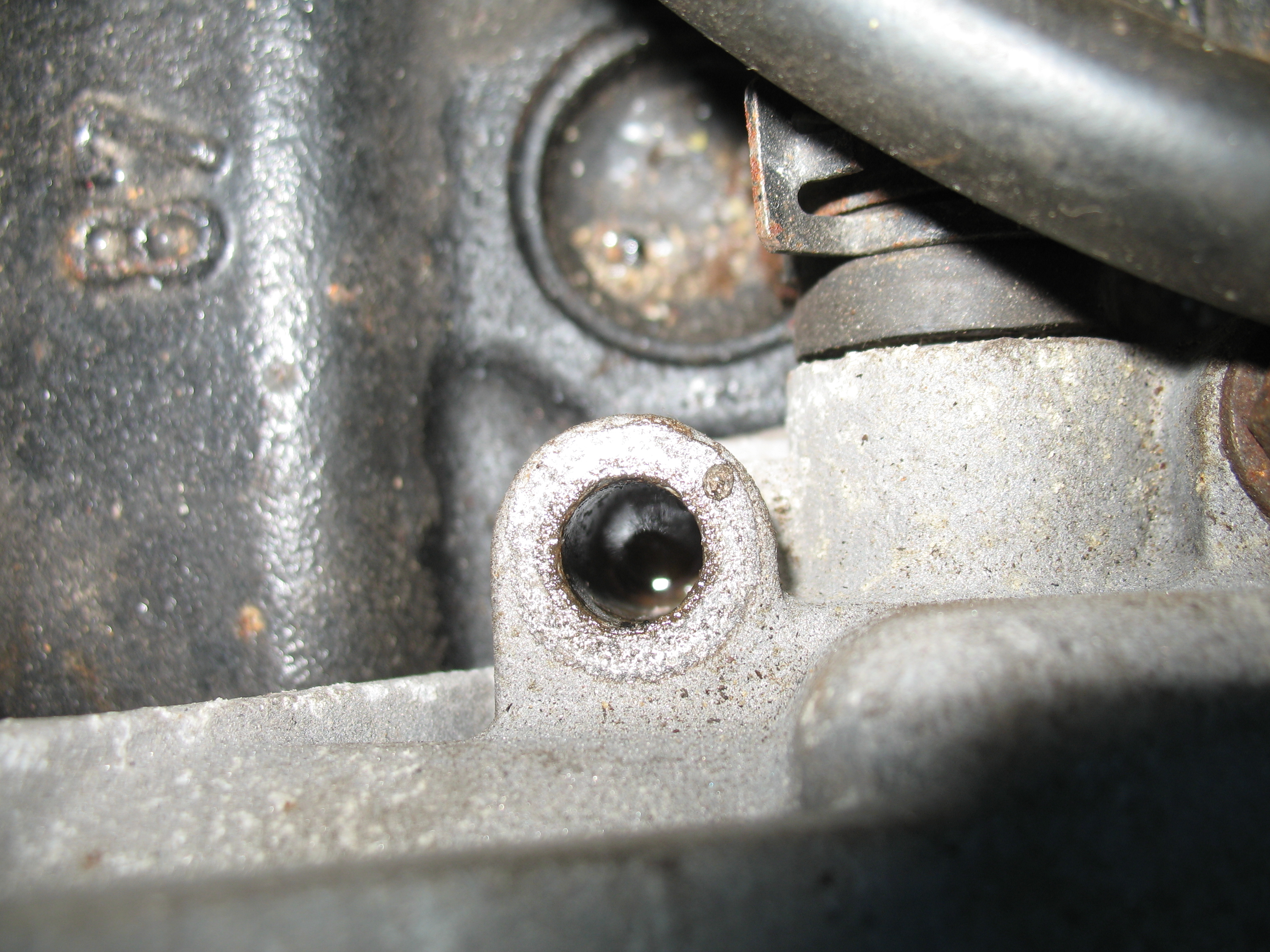

Looked over the engine in case of anything loose and spotted a bit of weeping around a bolt and undid it.
It was full of water. Is this a big problem ? Any ideas. I suspect its coming up from the bottom of the hole.
Or basically . Have I screwed up big time or small..... :roll:

Probably the gasket has failed under the water housing.
New ones come as part of a full head gasket set.....not normally available singly, unless someone has a spare one.....just checked, I don't have one.
The alternative is to buy some gasket paper, take the housing off, smear it with oil from the dipstick,trap the paper between the housing and the block.
You will then have a stencil which you can cut out carefully with a craft knife.
Good luck!

Thanks for your response but I stuck that housing down with very good sealant so its actually rather likely it will not be that.
I may well pop that bolt out and one of the others and measure the depth of the two holes. If the water filled one is much deeper then i can worry.
Whilst typing this I have had a thought that if I fire the car up with the bolt out and water flows out steadily that will also be clear cut.

That bolt goes into the coolant jacket
Just put it back in with RTV sealer around the threads and it will be fine
Oh wow. That easy. Thanks a lot. Will do that. :D

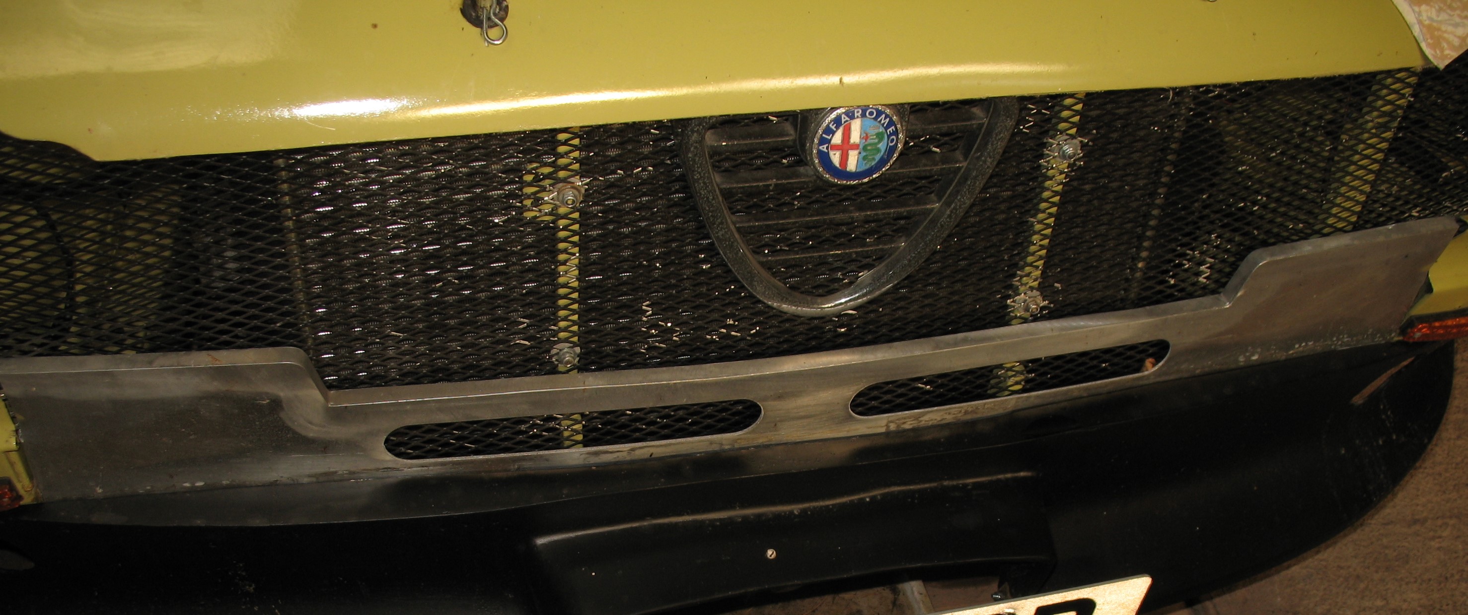

Have put the number plate in a better spot and extended the front skirt back at the top to the ali panel so as to lose the gap between. Quite pleased, it looks much better.

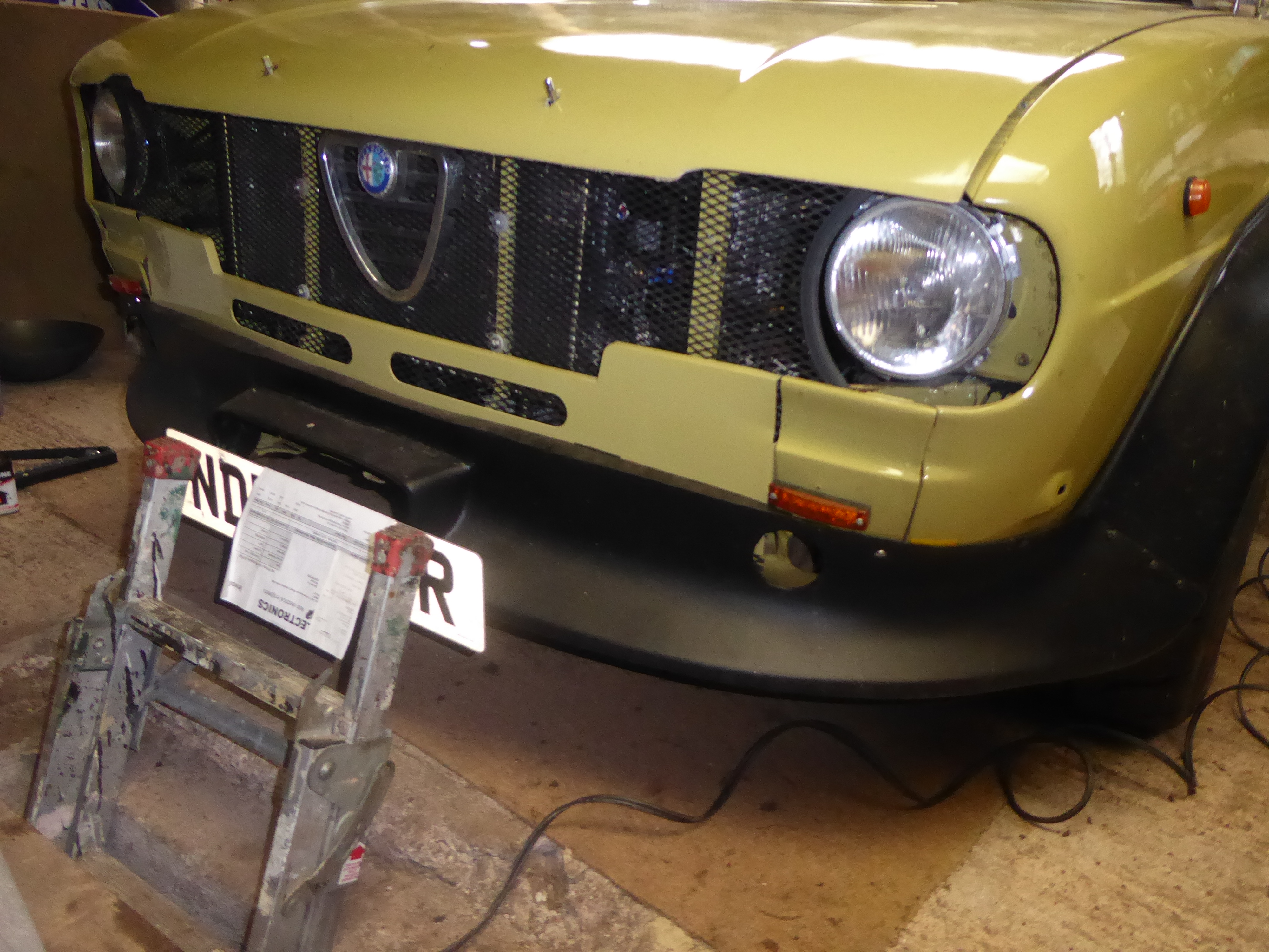

Then the painter finally painted my front panel. Time travels slower in rural Herefordshire.
Not quite the same colour, :roll: but looking much better.

Only one question, why have you got what looks like the worlds shortest step ladder infront of the car? :-)
Mufasa
Posts: 184
Post by Mufasa »
Sprint88qv wrote:Looks a top Sud to me.
Or is it protruding out of a pit?
