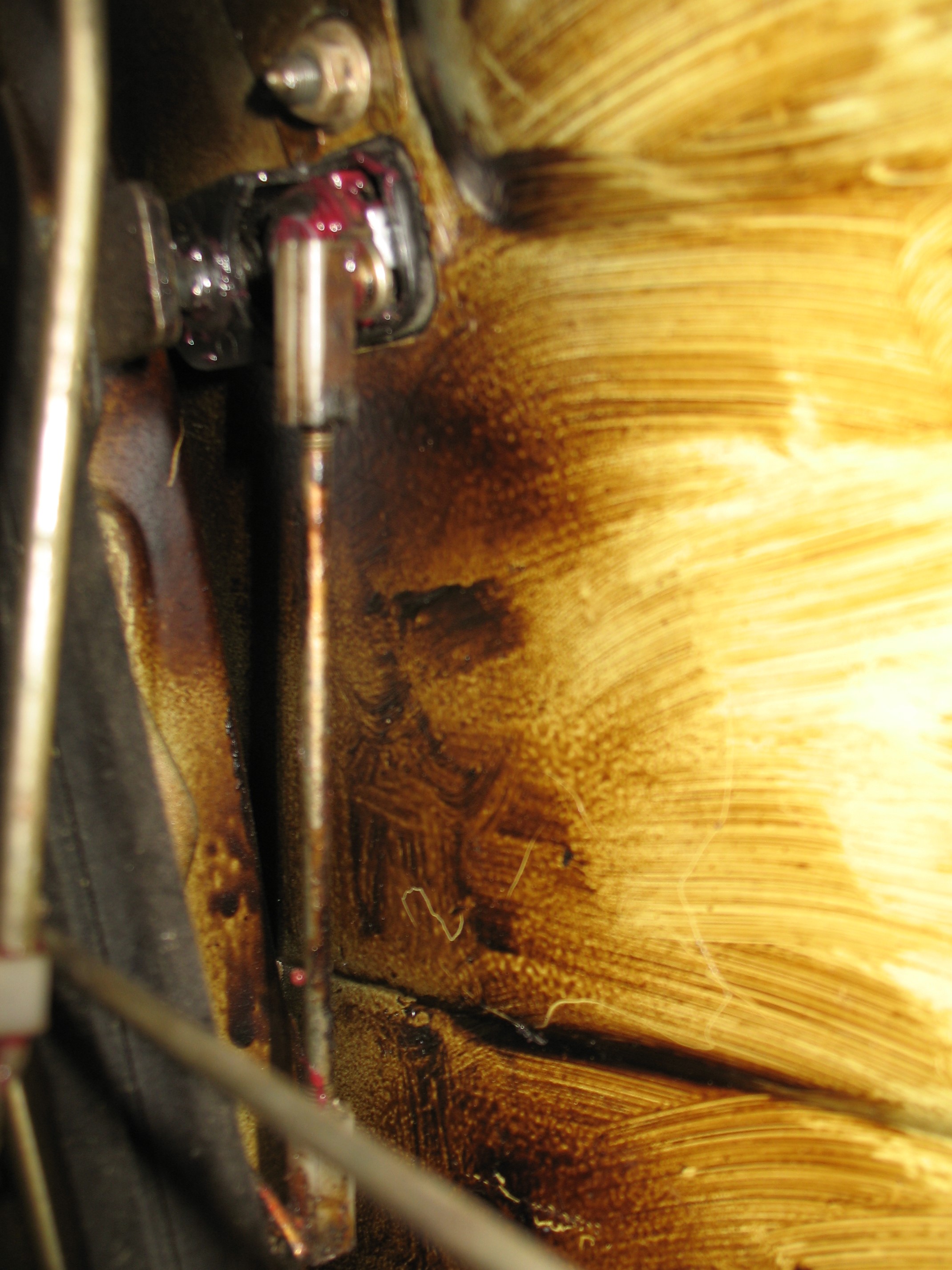

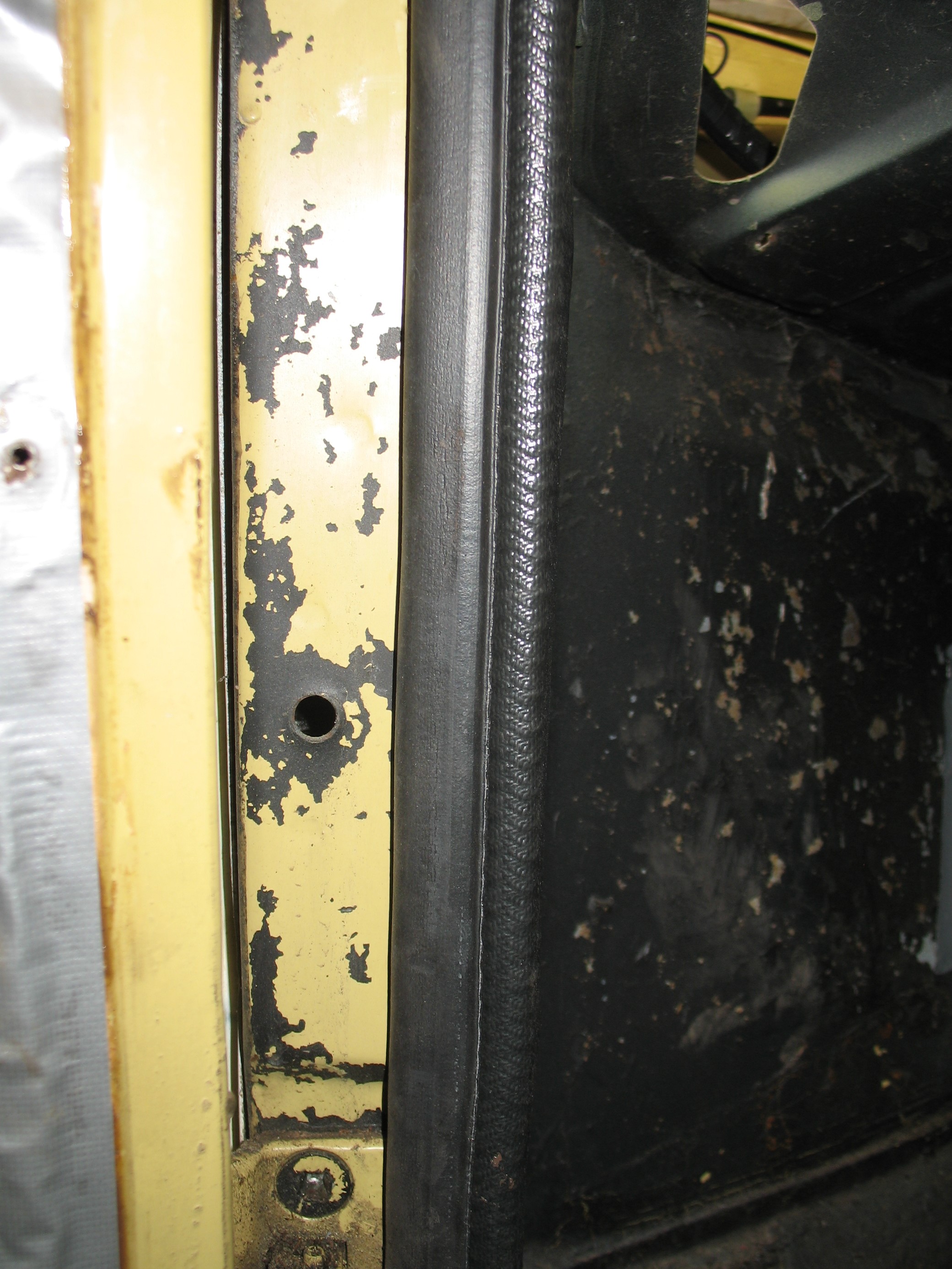

The passenger door refusing to lock has been making me a little crazy and as there is no work and its hot I decided a morning in the shed would sort it.
Took the door skin off carefully :roll: again and checked it all. Just appears the lock not responding to the turn of the key. Then saw that the rod down to it was at its least extent and so extended it to up its range.
Result, it worked. Double checked as been here before(door open door closed etc) and it worked. Fab
Put it all back together and it did not work. :oops:

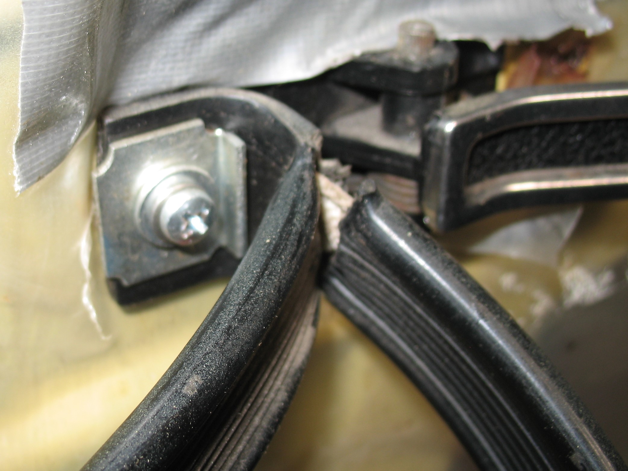

Took it apart again and looked very hard at all the parts, then noticed the new door rubber was bunching at the front and pushing the door back against the stop.
So very carefully cut the back out of the rubber so it looks fine but has less mass and the door fitted better. And the lock worked so double checked and all was well. So put it back together and it did NOT!. :x
Then did all that again and filled the lock with oily grease and it all worked smoothly.................but did not work.
Then had lunch and decided to take it apart and add one part at a time till the lock stopped working.
It turned out to be the rod going across from the internal door handle.
The screw that held it had sheared or rusted before I had it and I had drilled it out and popped a nut and bolt through to hold it in place. This allowed a bit of movement and when I had tightened it up, it had been a bit forward. This then put tension on the lock mechanism which stopped it locking via the key.
So I have decided its best NOT to mend things. :lol: Mind you the door works perfectly now.

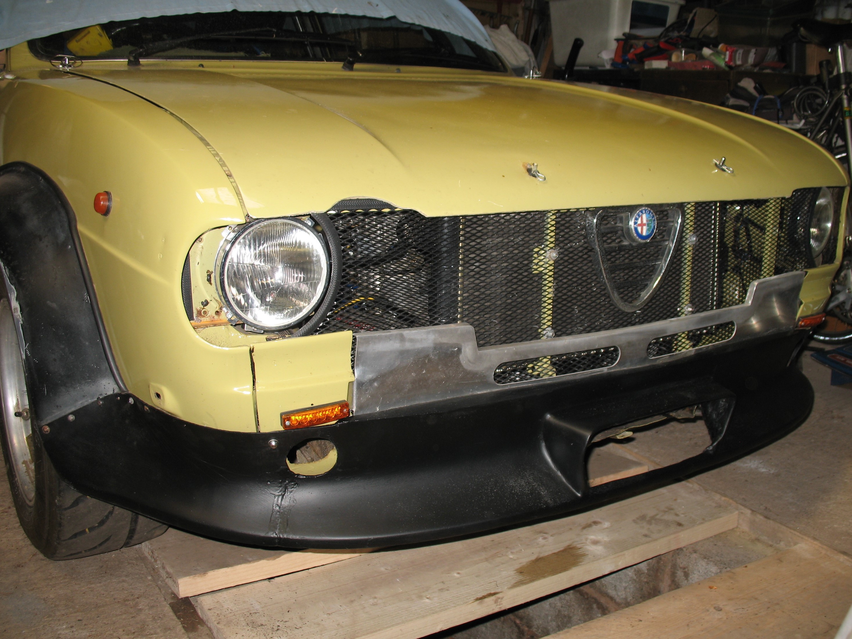

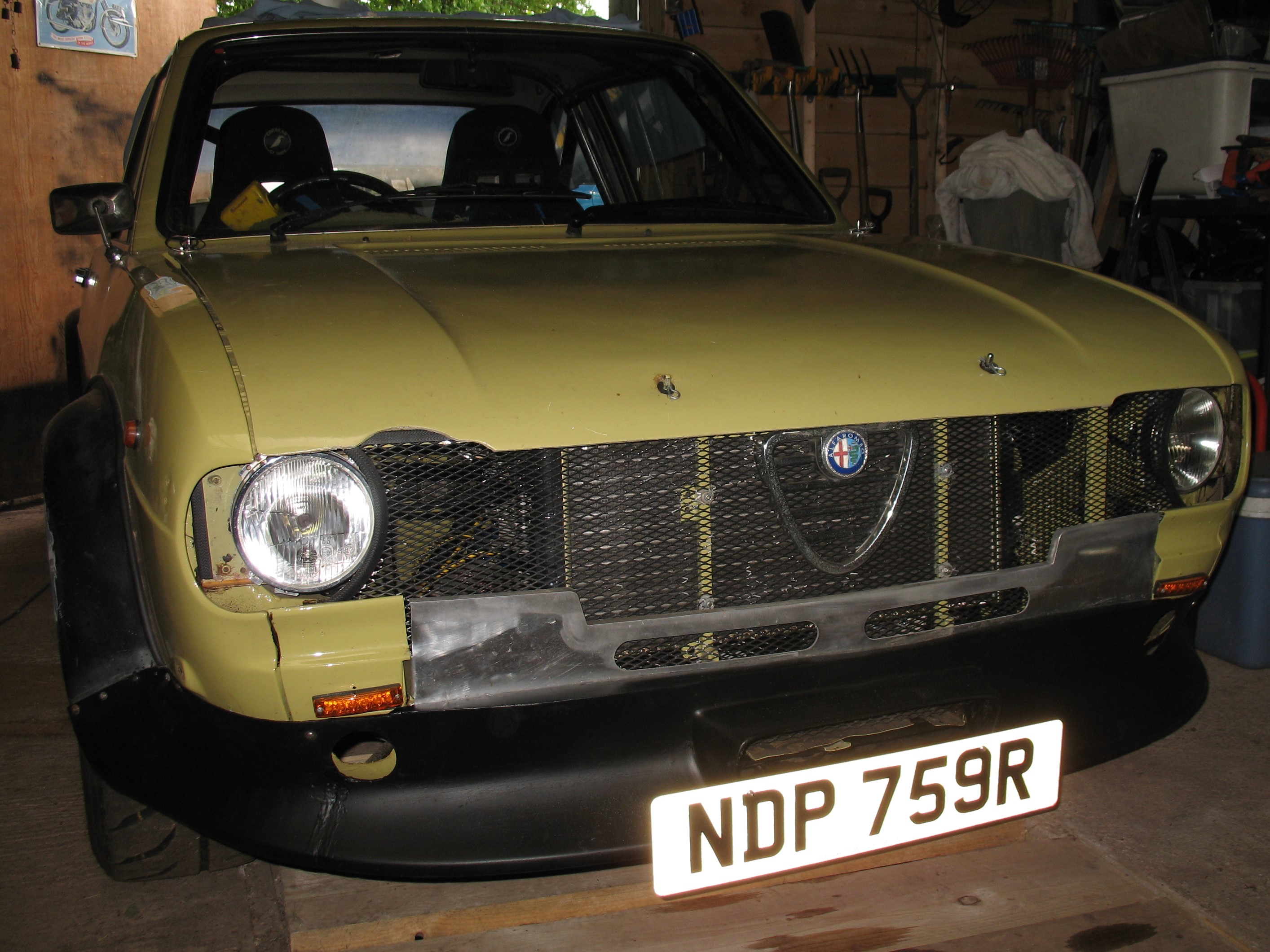

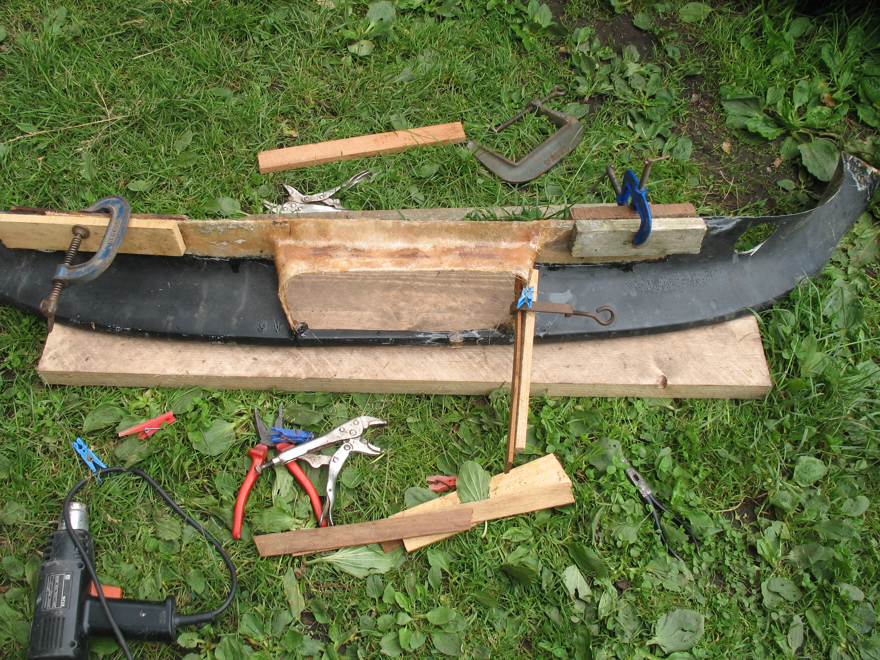

Started on the front skirt which is a bit of a learning curve again.

Interested to see how you get on with the spoiler, big fibre-glass sections I've never tried to make like that.

Ah, the Black and Decker heat gun - many's the time that has saved me!
Yep its a very helpful tool, though not quite done the trick as I am trying to get the skirt to fit closer to the front of the car and its resisting.
I think the bottom of it where the material is thicker is just not heating up enough. Took an inch out of it so its much better, but if I try to pull it in further it just pulls the wheel arches out at the front so a bit annoying.
Still could be worse , I could have taken too much out ! :lol:

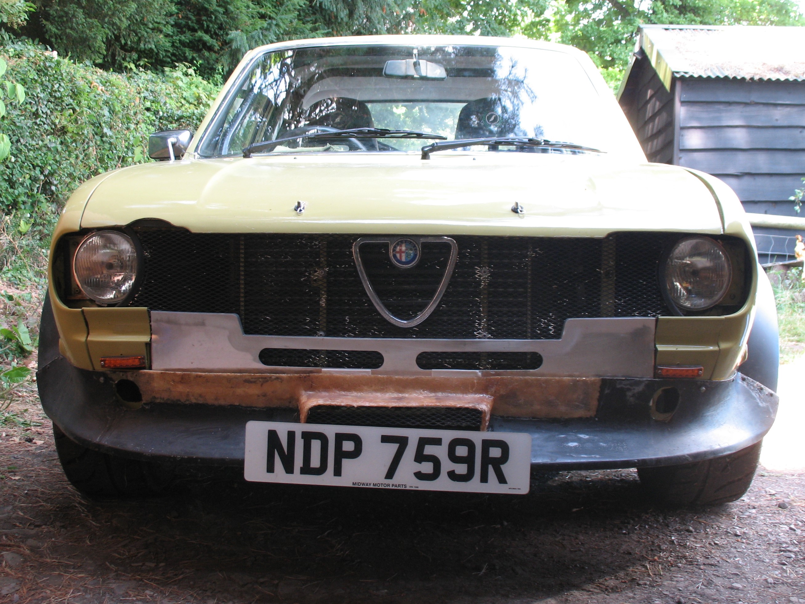

With it in place I now wonder about colour and if I should do the whole of the grill, alloy panel and skirt black, or the alloy in Beige, or a mix and take the beige down into the skirt to the top of the scoop. Or......
Very undecided, so chaps your thoughts on a postcard please :D Don't let the wonky number plate confuse you, but it will probably stay in that area.
Posts: 2894
Personally James, I think keep the spoiler all black like the arches and grille, but your infill panel I would do body colour so it looks more original.
Ah yes, when you compare like with like I see your point. Thanks for putting the photo up.
Posts: 1235
Kegsti66 wrote:Personally James, I think keep the spoiler all black like the arches and grille, but your infill panel I would do body colour so it looks more original.
Definitely gets my vote!

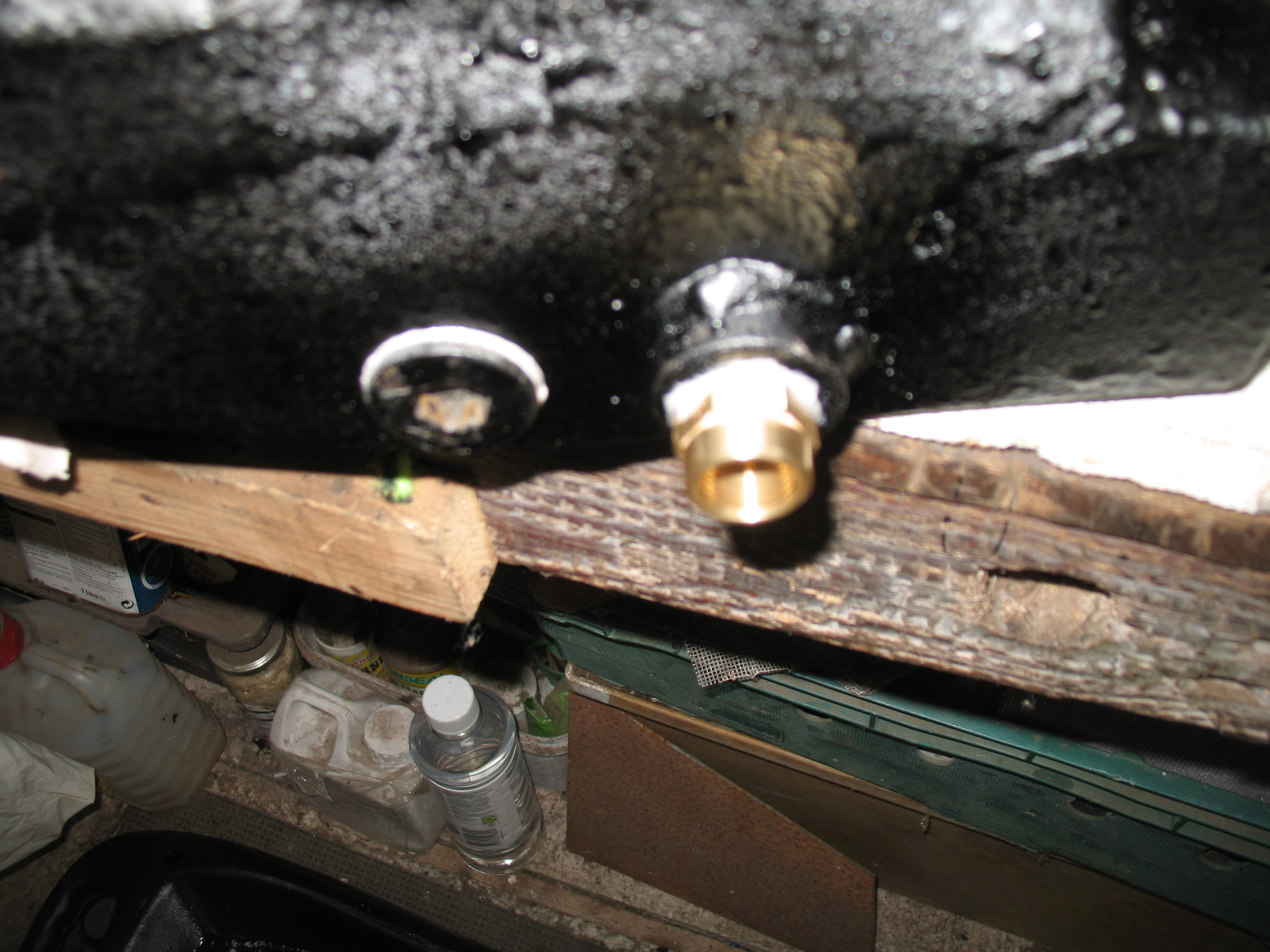

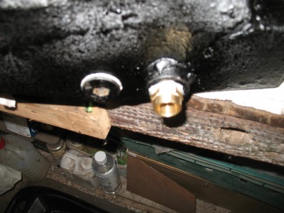

Just took my son out for a run, went down one of the narrow lanes near me and a large tractor suddenly filled the whole lane,
so pulled to one side and gave the brakes a big push.
The pedal went to the floor after scrubbing a bit of speed . :shock:
More grass verge and a bit of handbrake, round the tractor and trailer and onwards. Applied the brakes gently at the last hill before home and it just worked them enough
to not have to use the handbrake. Once home, bonnet off and the Tilson brake bias valve if that's the right term was letting lots of brake fluid out of the top.
One of the few modern bits on the car and it let me down. Glad to have got away with it though. :D
Glad of the big tyres as they went well off road ! Never thought I would say that when I built it. :lol:

Presuming you have split circuit brake pipes, the fronts should have operated?
Or maybe you had lost too much fluid?
In which case, have you got a low brake fluid switch on your master cyl, and a warning light.
I've got the switch on the master cyl, but doesn't seem to be provision for it in the S2 loom
Just lost way too much fluid as it spurted out of the top of the brake bias valve.
No, no warning light, but I think I have had a clear warning now and will be acting upon it. Hopefully end of the week.

Cannot see why the tilton brake bias valve was leaking. Seems odd as all looks perfect. Will buy new seals and then if I desire it later put it back on.
Just put a female joiner in the line and after a bit of fun really testing it I dont not think it is needed. Brakes worked perfectly.
