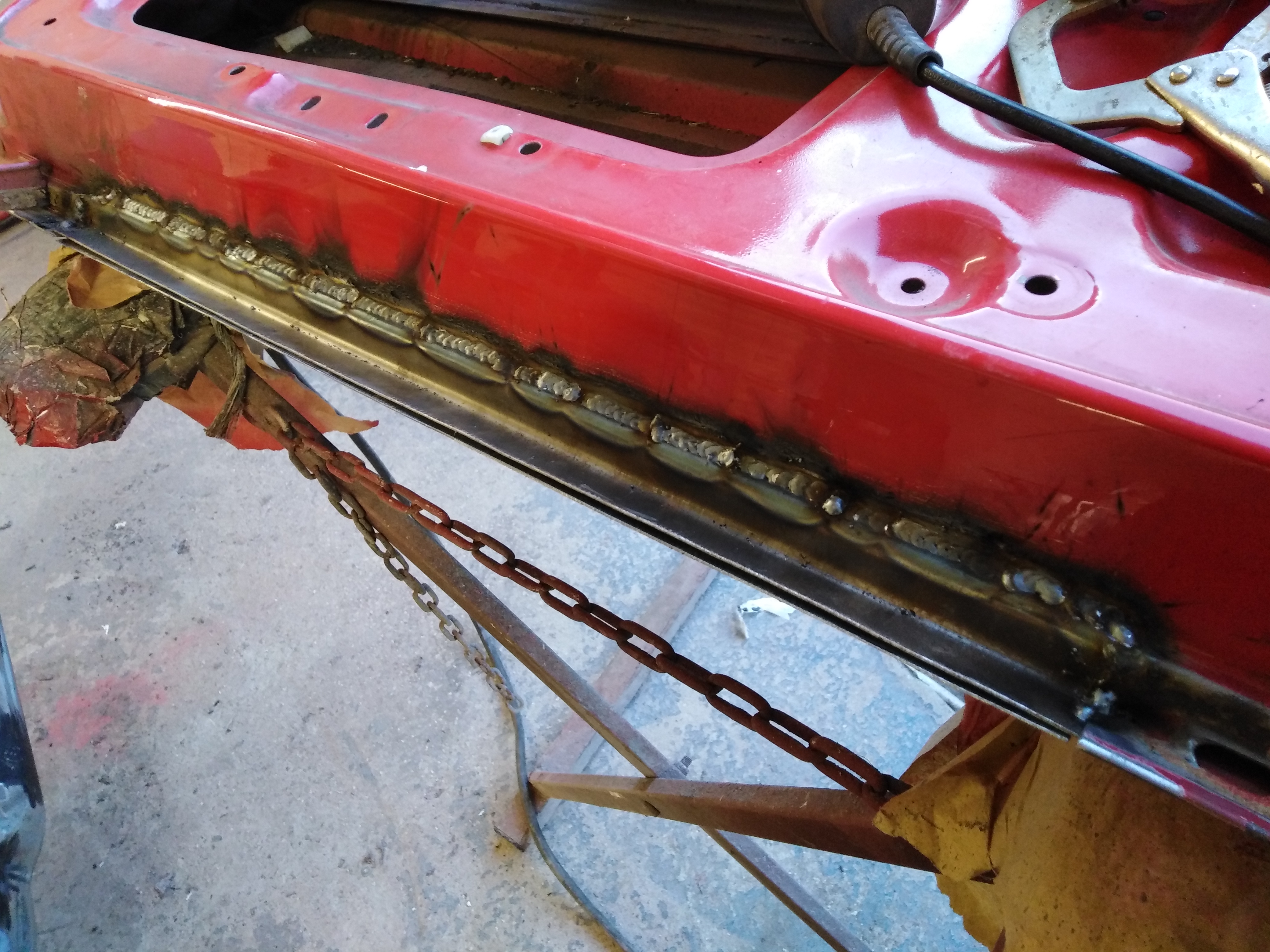

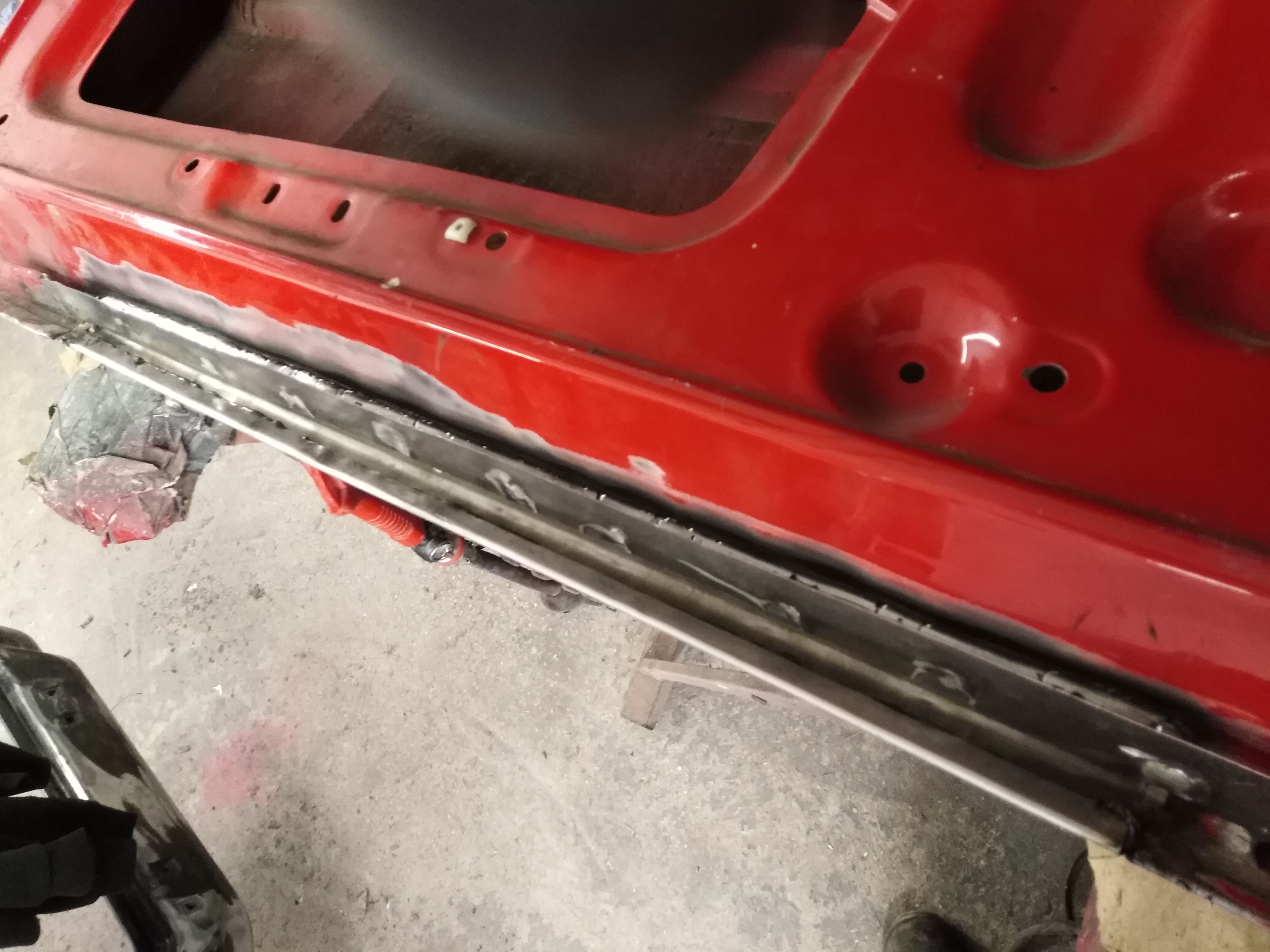

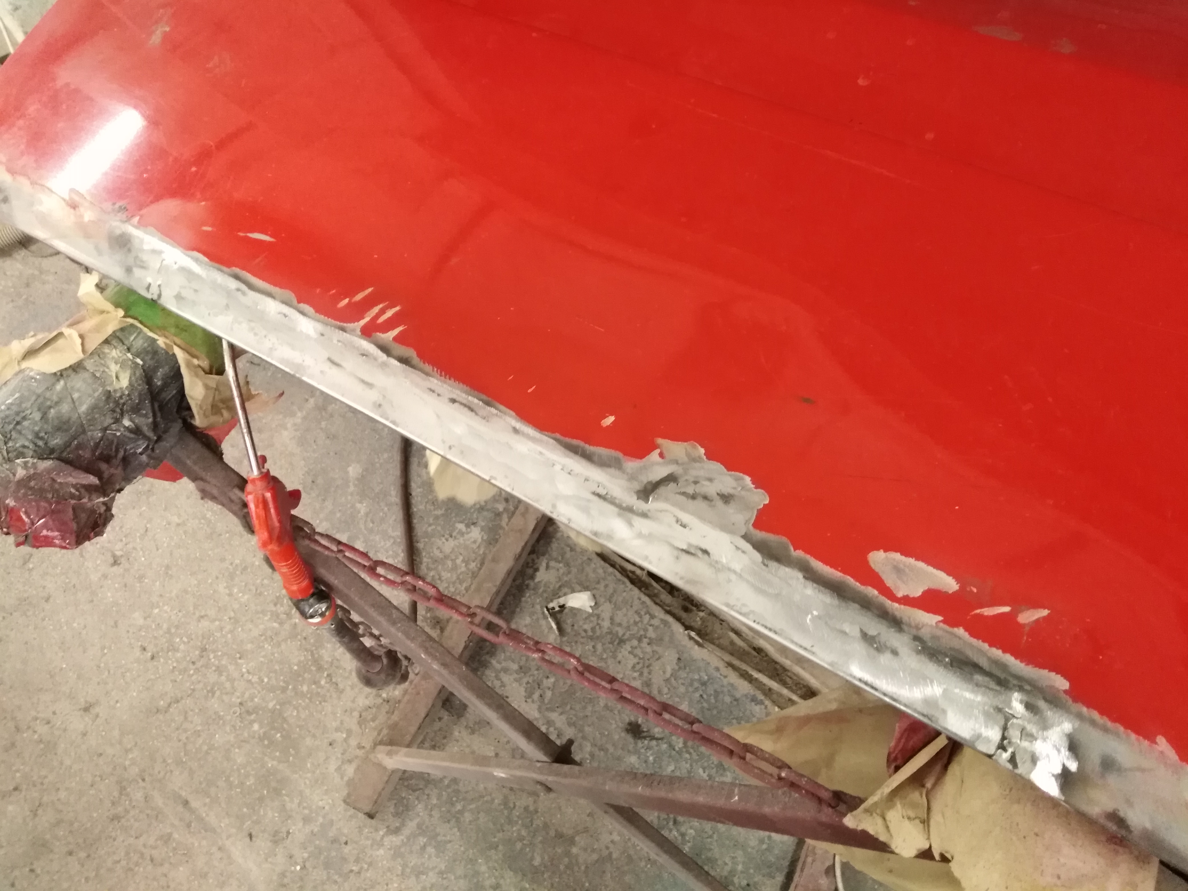

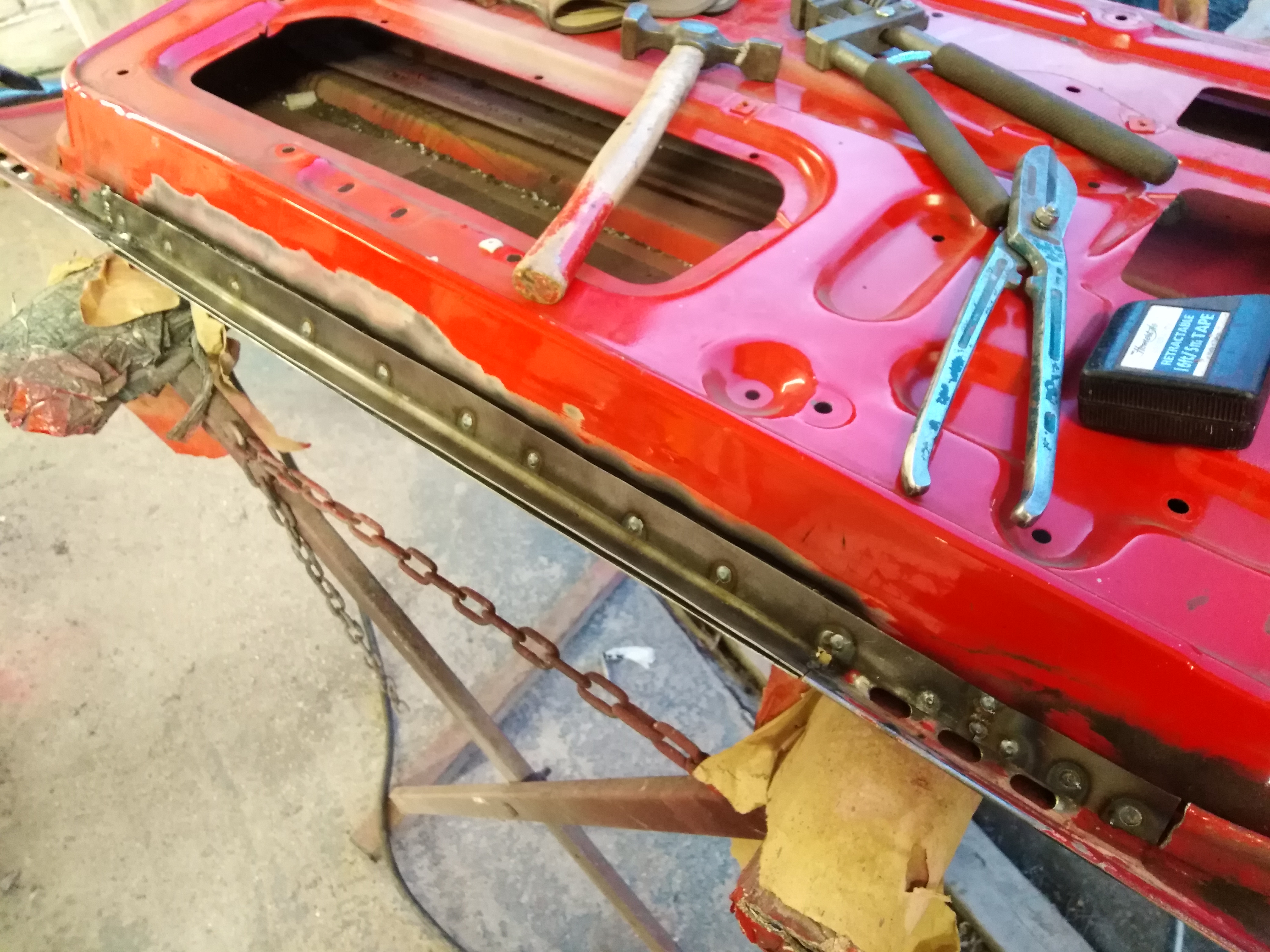

Door bottom all solid again
Then a new seal retaining plate needed making up and welding on

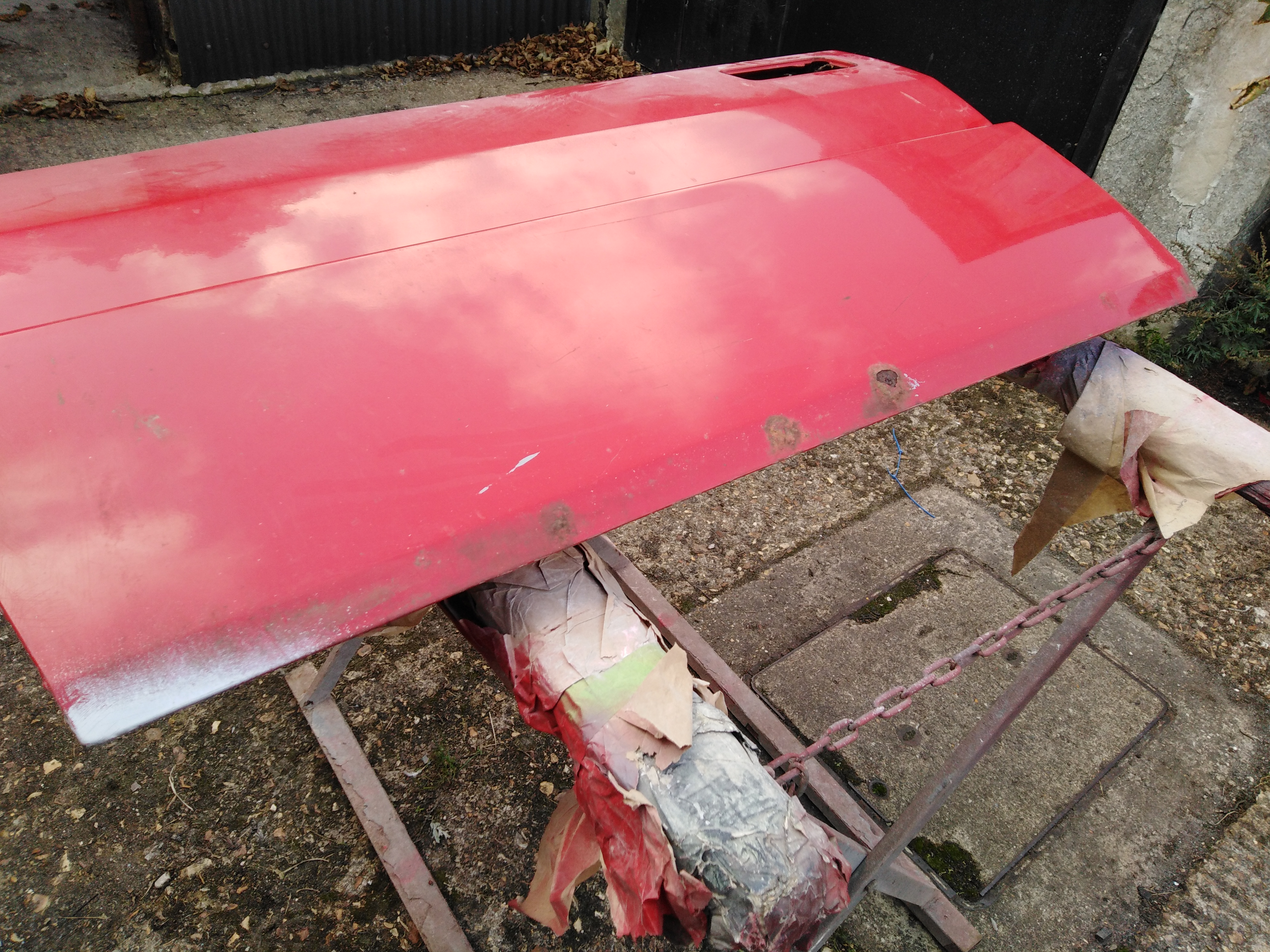

The outer skin had these few scabs...
All chopped out and a new door bottom let in..
Bottom edge fitted with sealant where it's lipped over

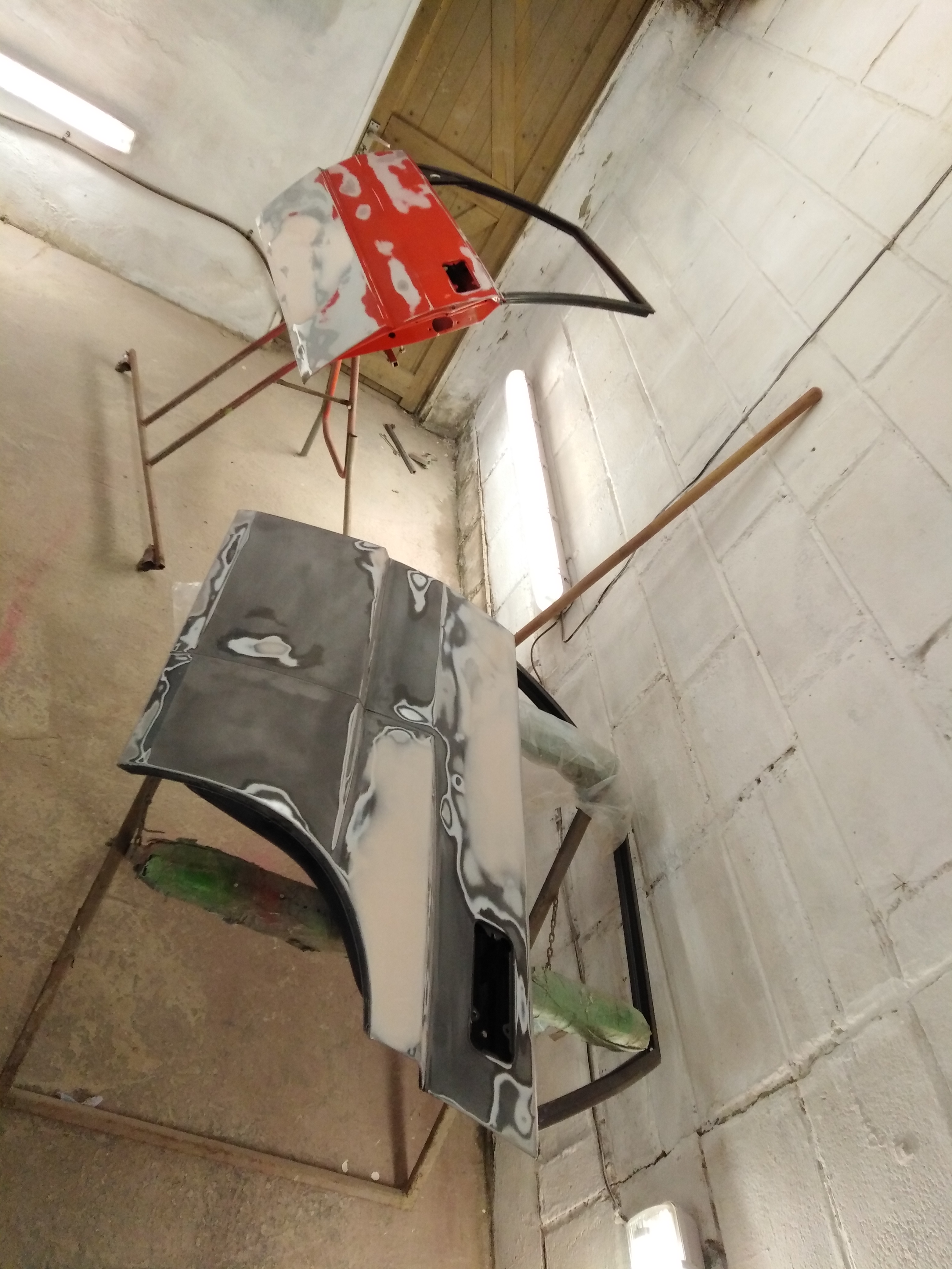

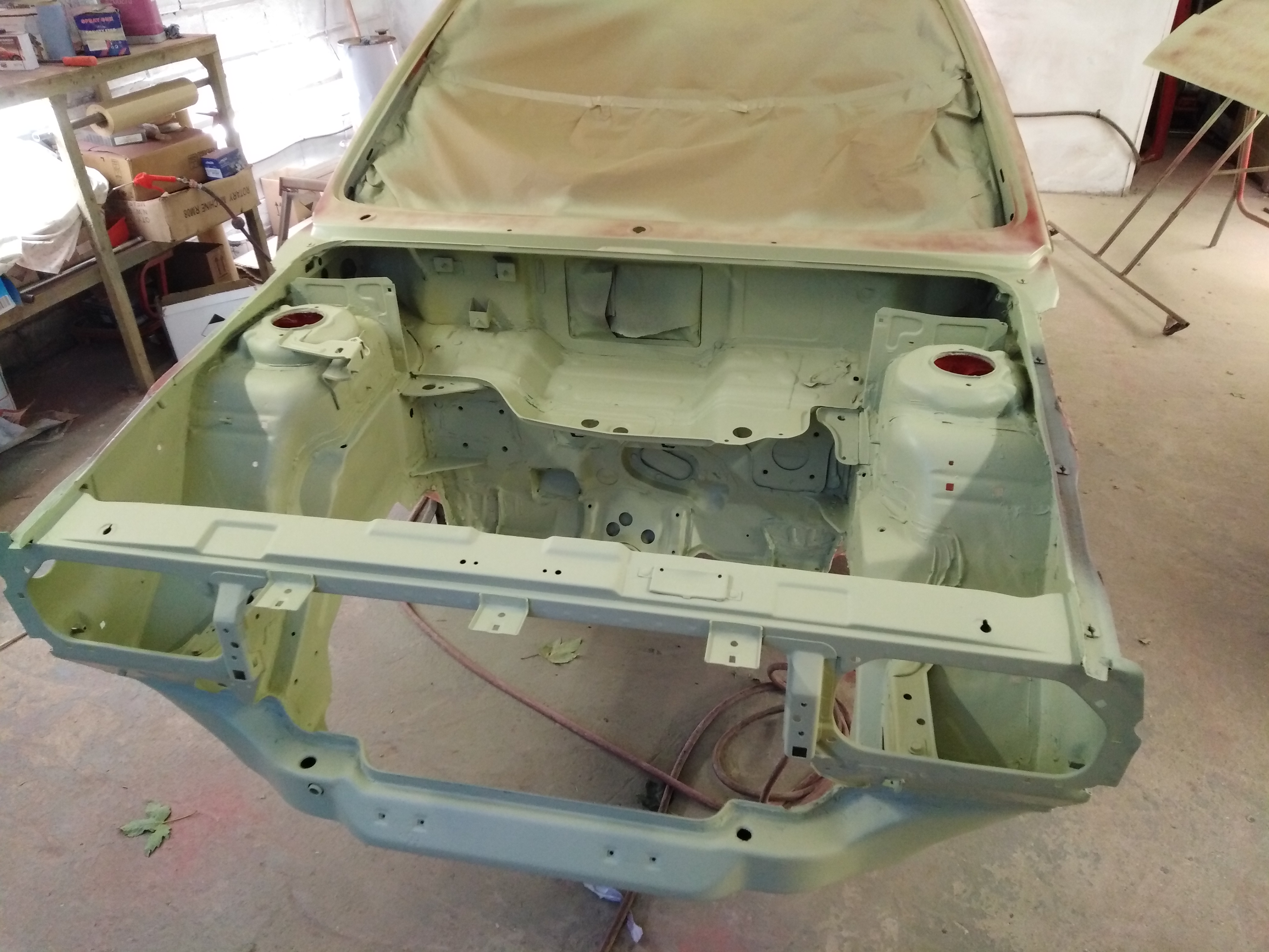

Today I finally just about got everything prepped, the big pieces like the roof are plain sailing, all the little PITA bits like door shuts, hatch shut, under bonnet etc are the time consuming bits.
Still, a bit more cleaning tomorrow morning then mask up time and get some etch then filler prime on it.
Only doing two doors at this stage as I am limited on space and only have two hanging frames! Could hang them off a wooden beam like we did for Pauls' 33 but space is tight.
Next stage once these parts are out of the way then the bonnet, rear hatch, other doors, front wings etc will be done.
Last set of parts will be the plastics like bonnet vents, bumpers etc.

Yes, the priming stage is always a big boost, must admit to getting a bit tired of it all now but I need to at least keep pressing on with the paint whilst we've still got some weather..

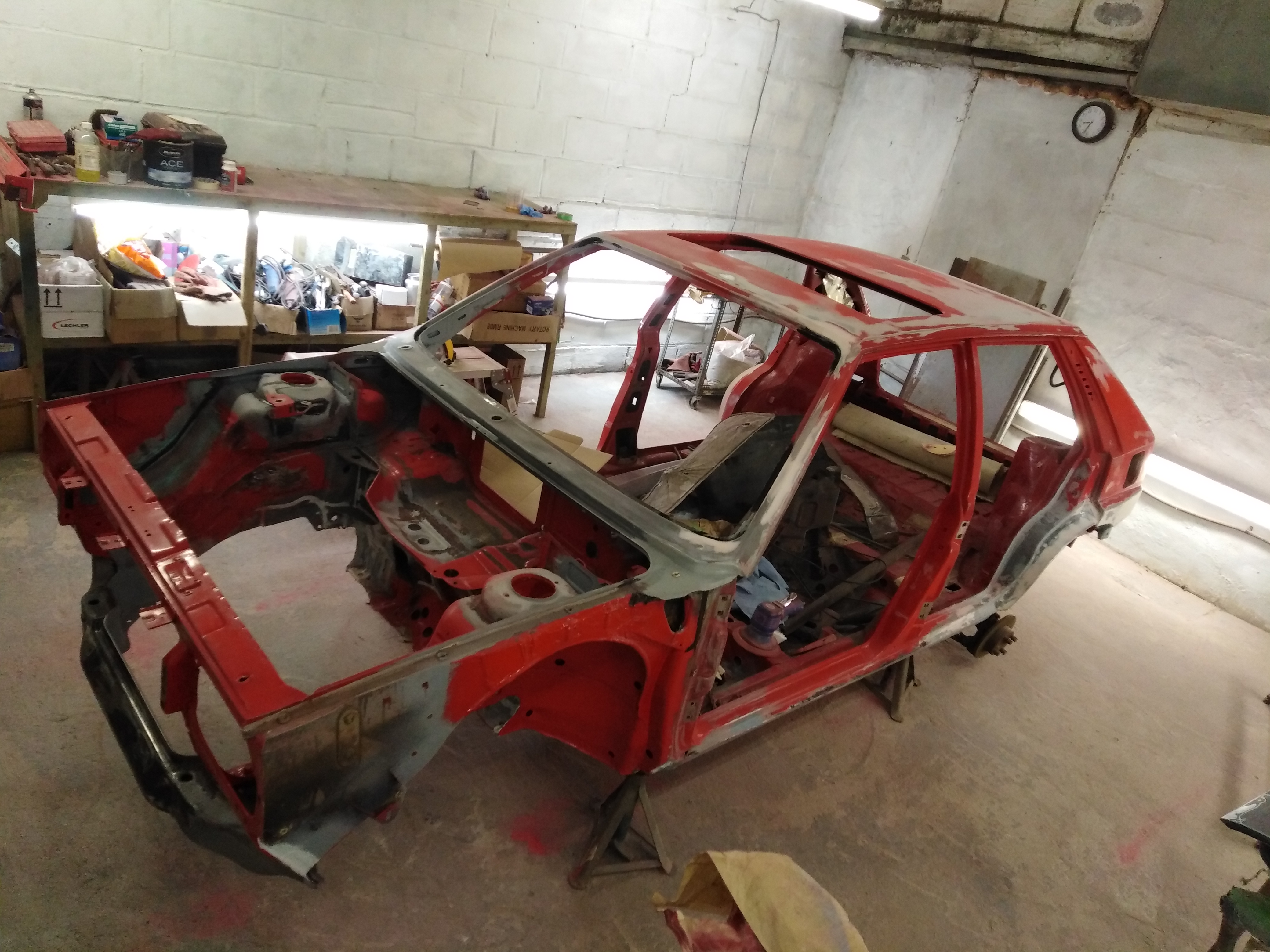

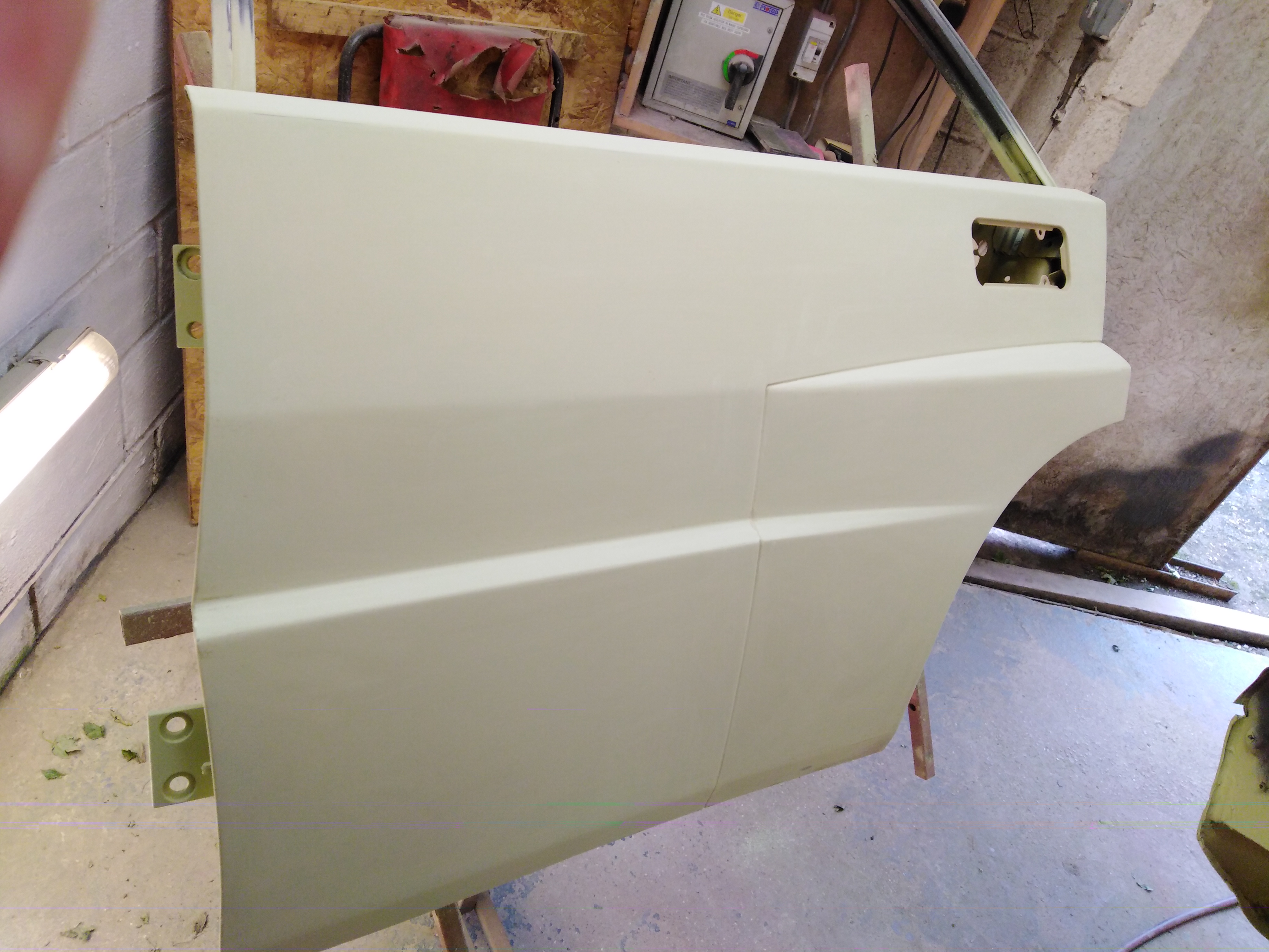

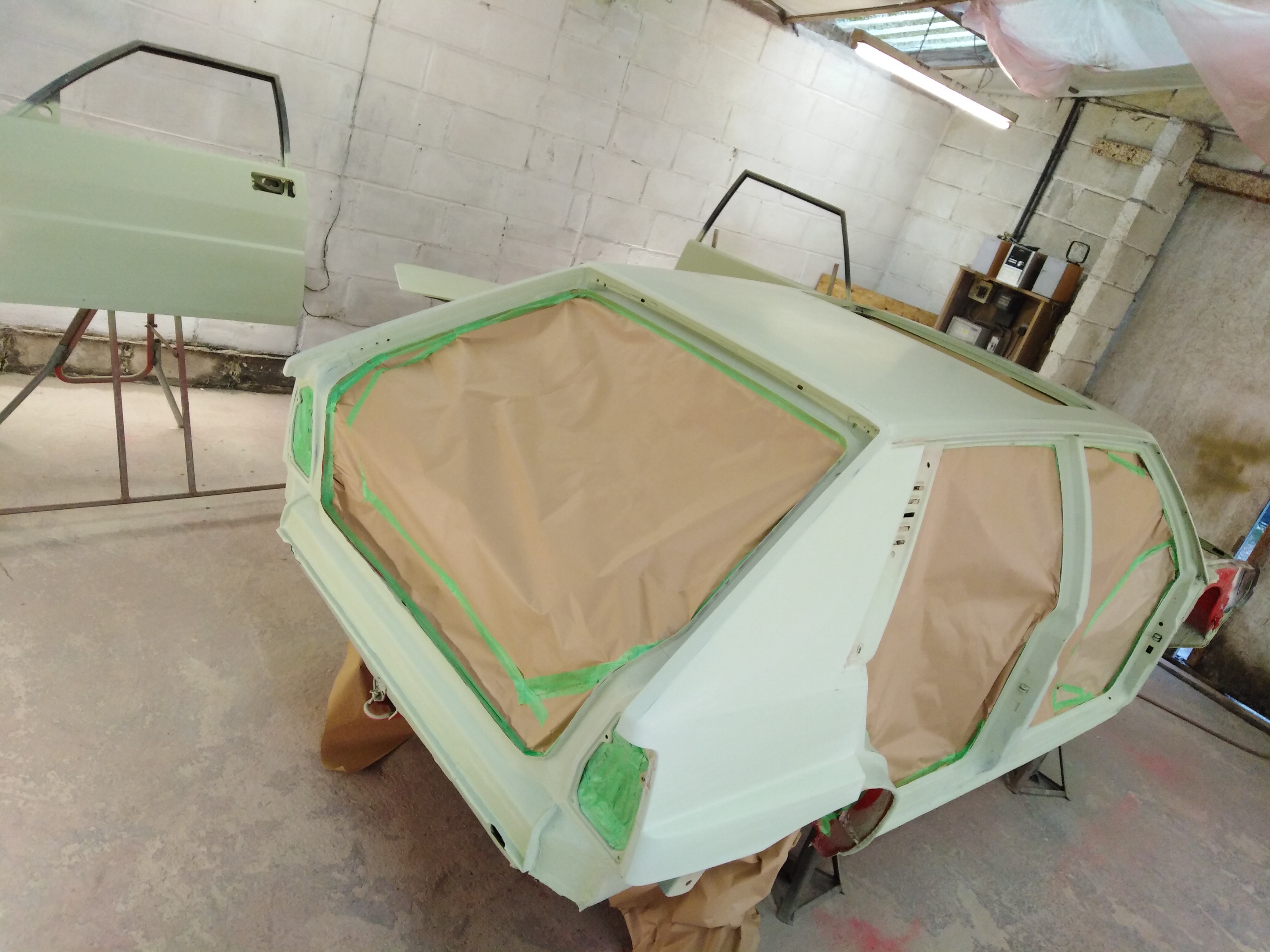

Today the last few bits got finished off then the laborious task of masking out, another job that I really don't enjoy.

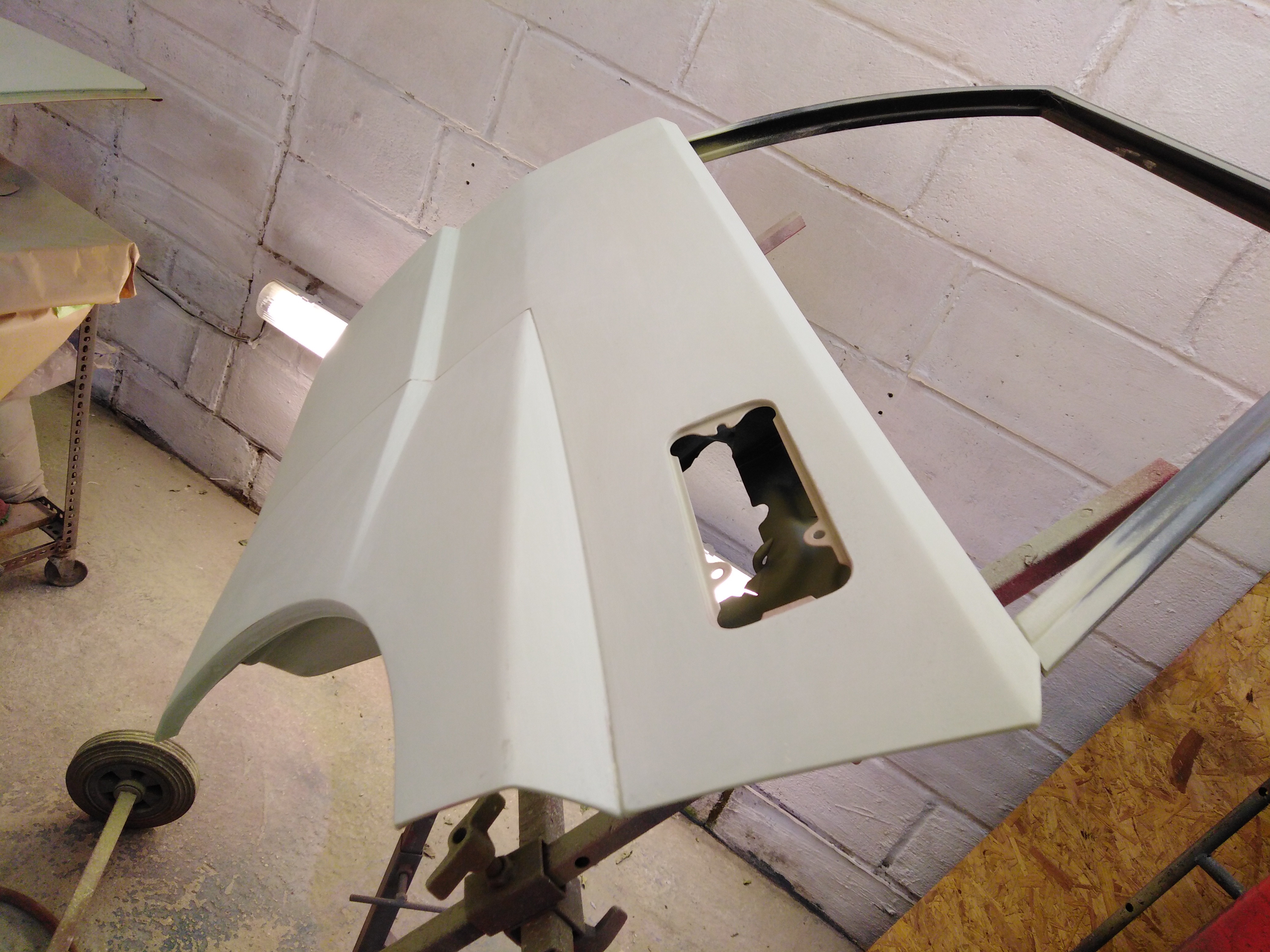

Etch primed..
Then full filler primer
8-)

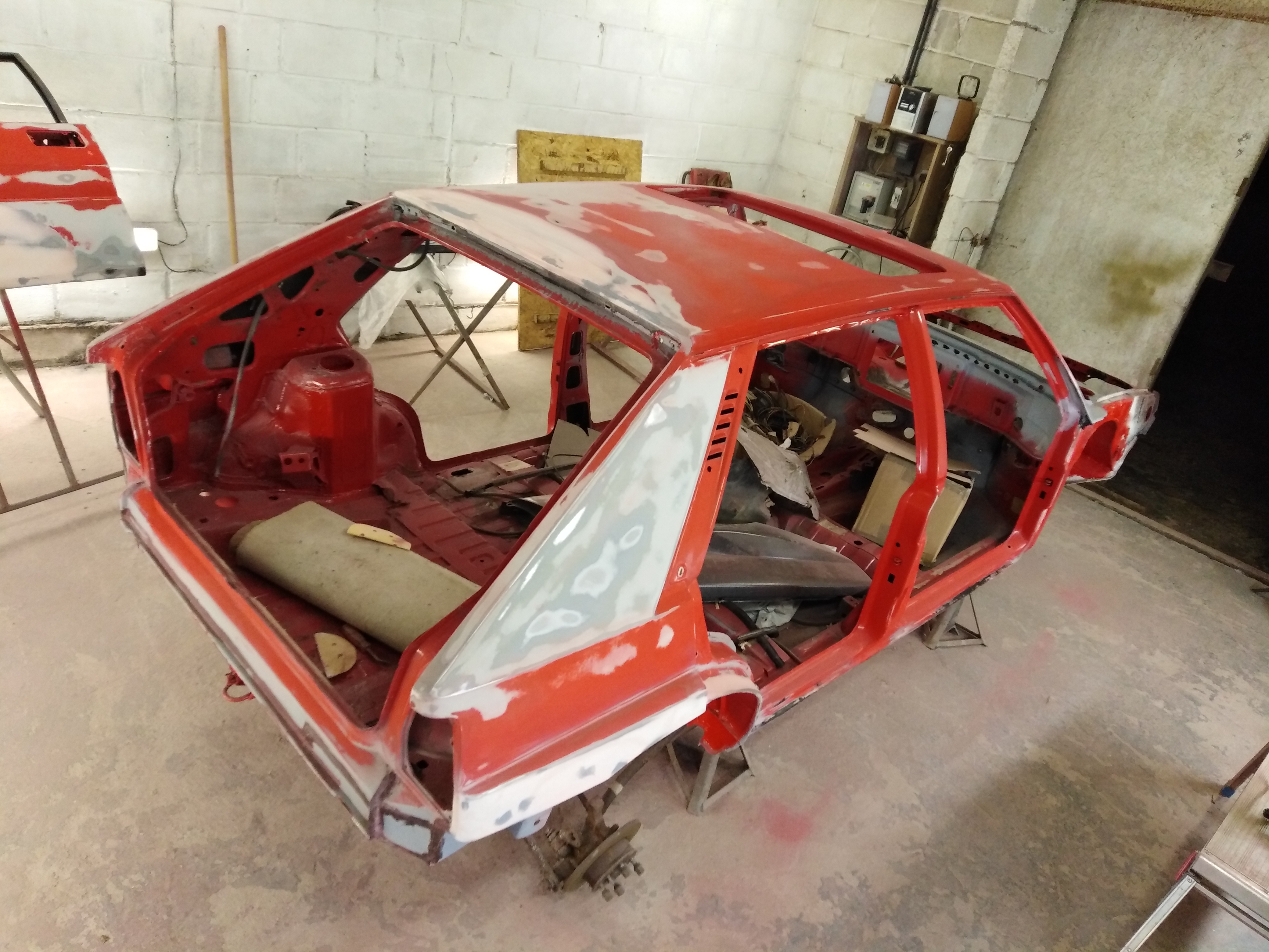

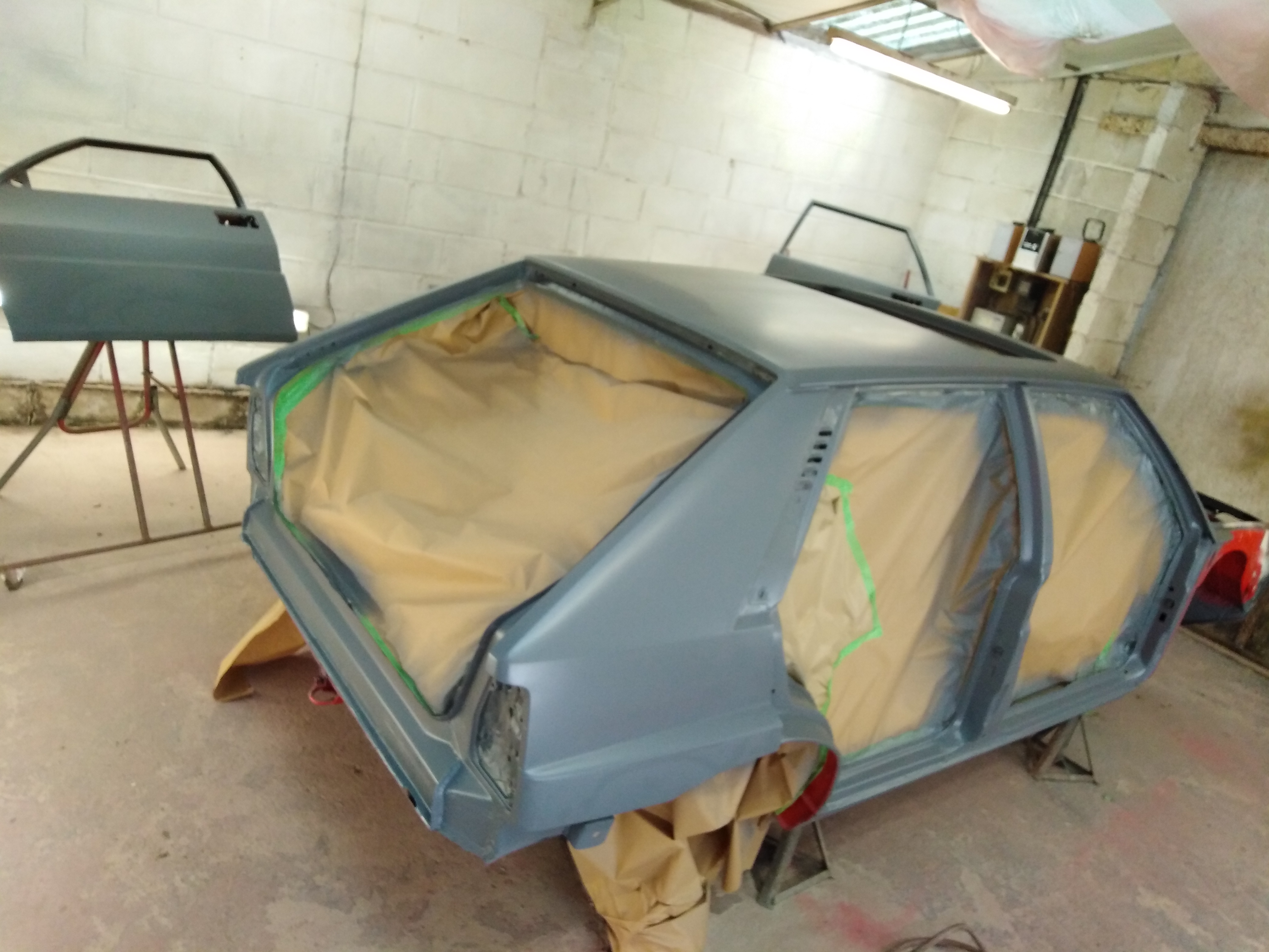

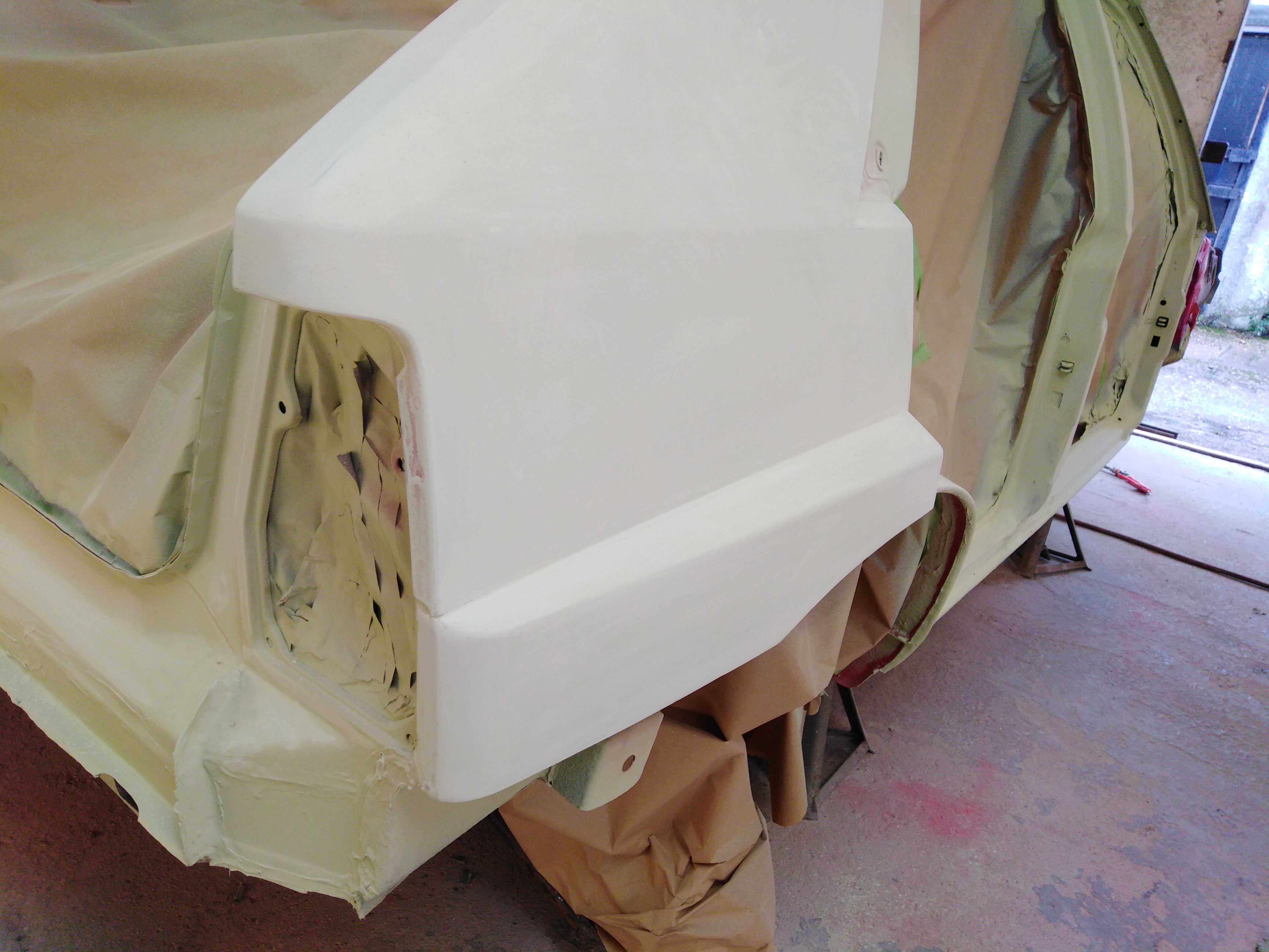

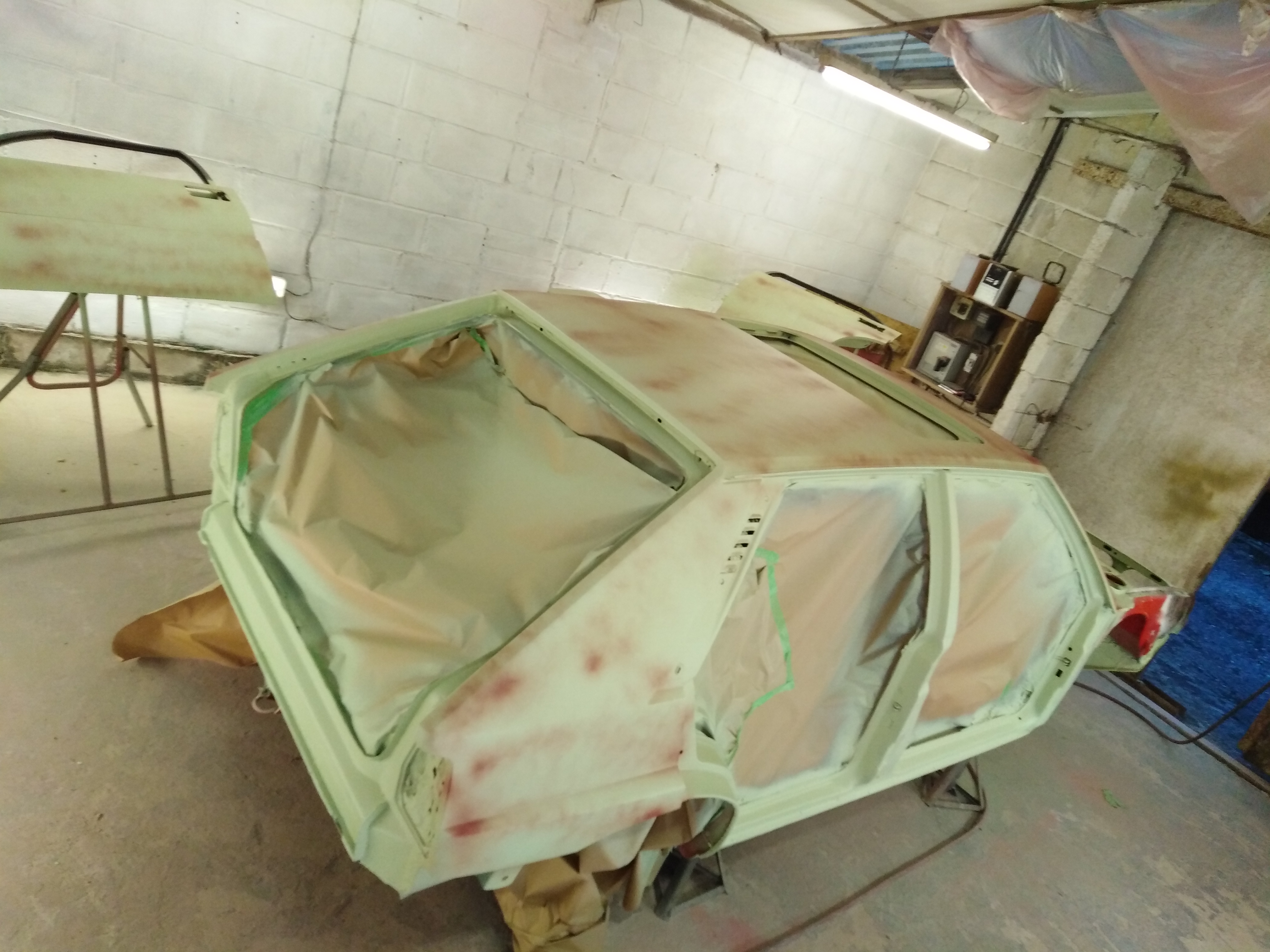

Today it all got flatted off which went well, all seems pretty straight, well the amount of filler primer I sprayed on allowed it to be! :)
Happy with the new arches how they've come out, handy they are so boxy in shape!

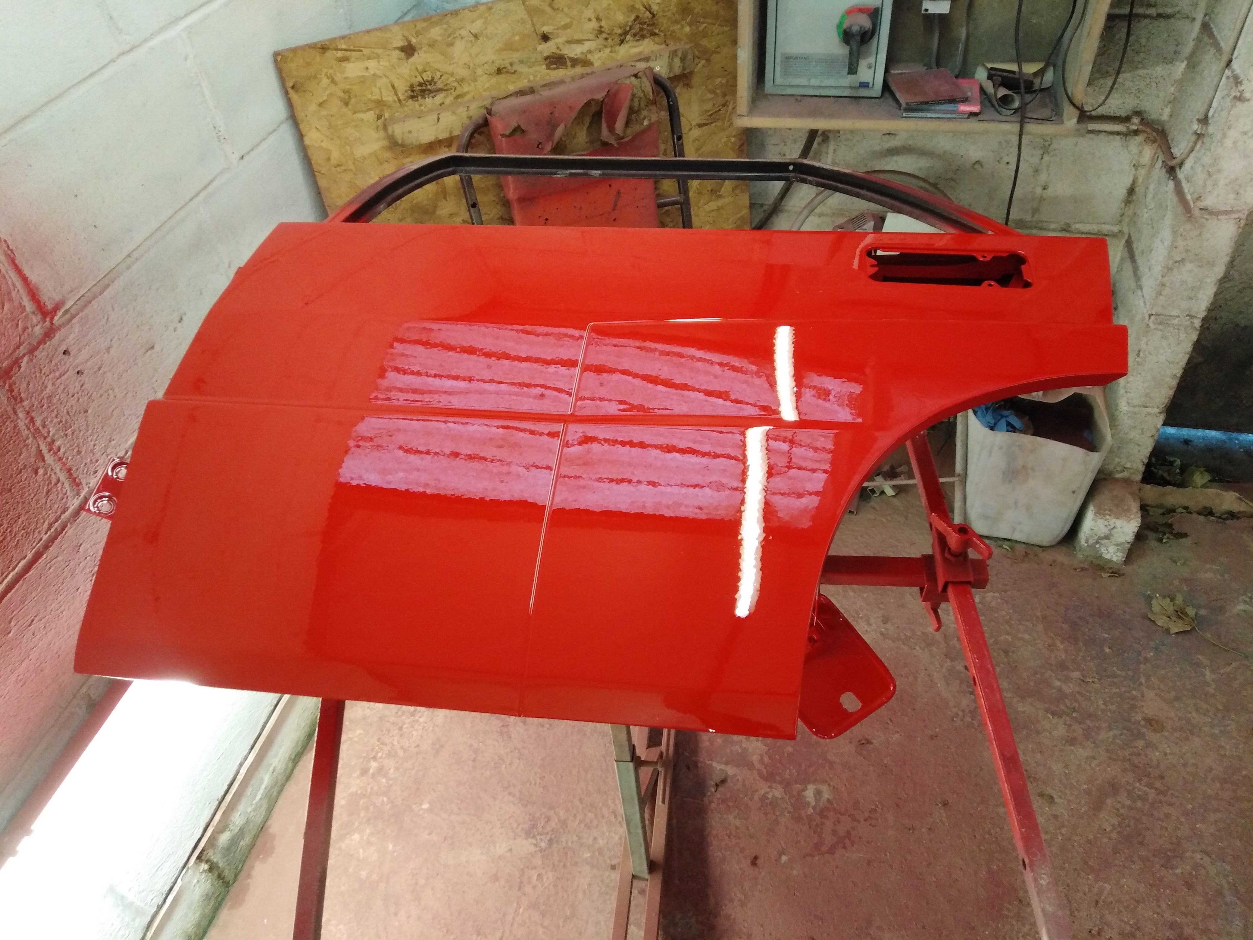

The rear doors on the integrale are not actually made from full new doors, they make them from regular doors then the extended section is flanged and spot welded in, hence the seams that run up and across. Amazing how they don't creep moisture in the gap, guess they must have used very good sealant.

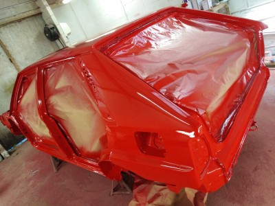

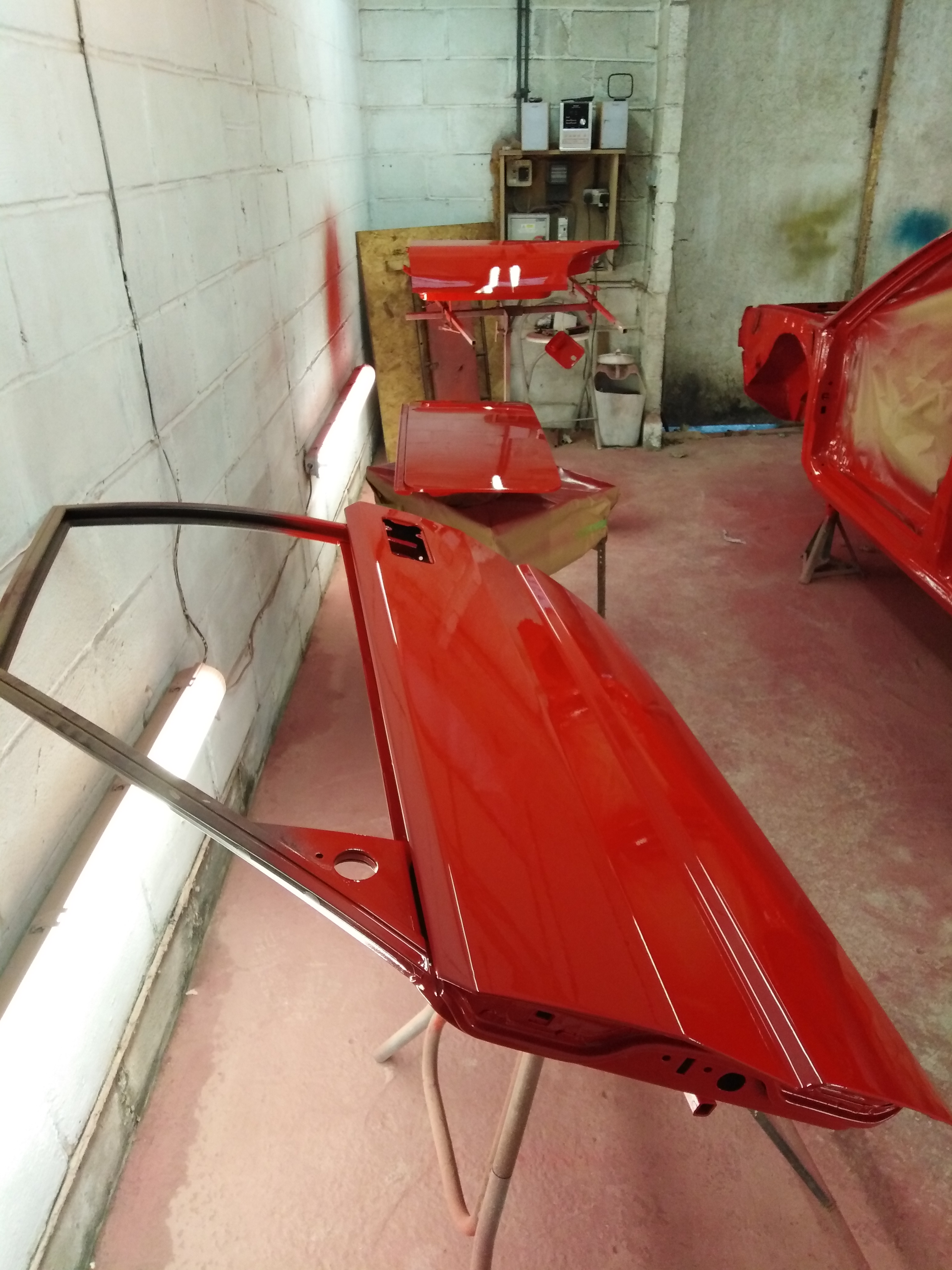

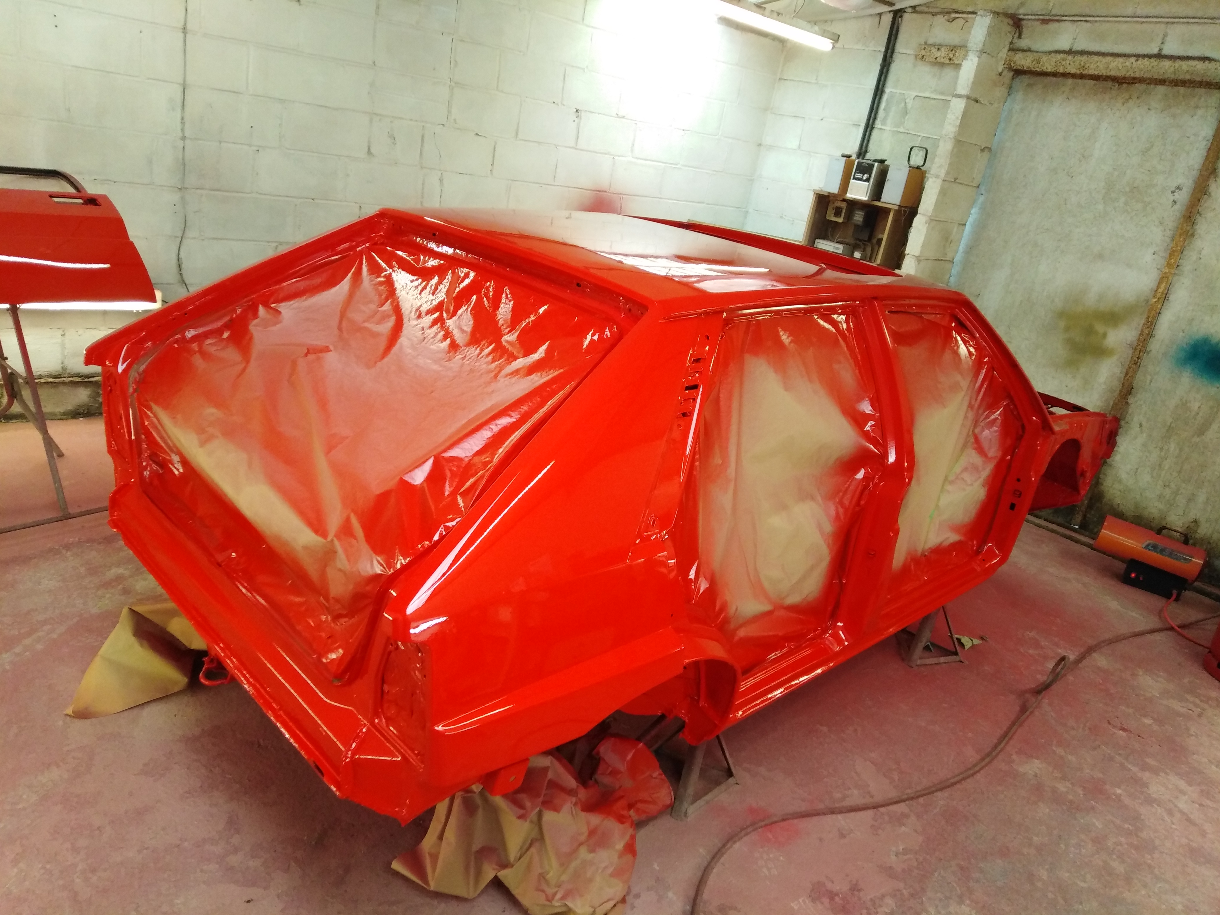

Now all cleaned down. floors swept, degreased again then remasked ready for the red tomorrow. ;)

Yes, spray day is the best :D
Happy that all the prep is done besides a clean down again in the morning.
Weather is supposed to be windy and showers tomorrow, like tonight, so I'll get the heat going.
Beans on toast before I set off, should see me through, no time to stop once I get going :)
Nice red pix tomorrow night I hope ;)
Cars looking great.good luck with the red .are you going base and clear or just solid red .looking forward to seeing the legend in red 8-)
Just solid red JB, I haven't done much base & lacquer jobs so I stick to the stuff I know more :)

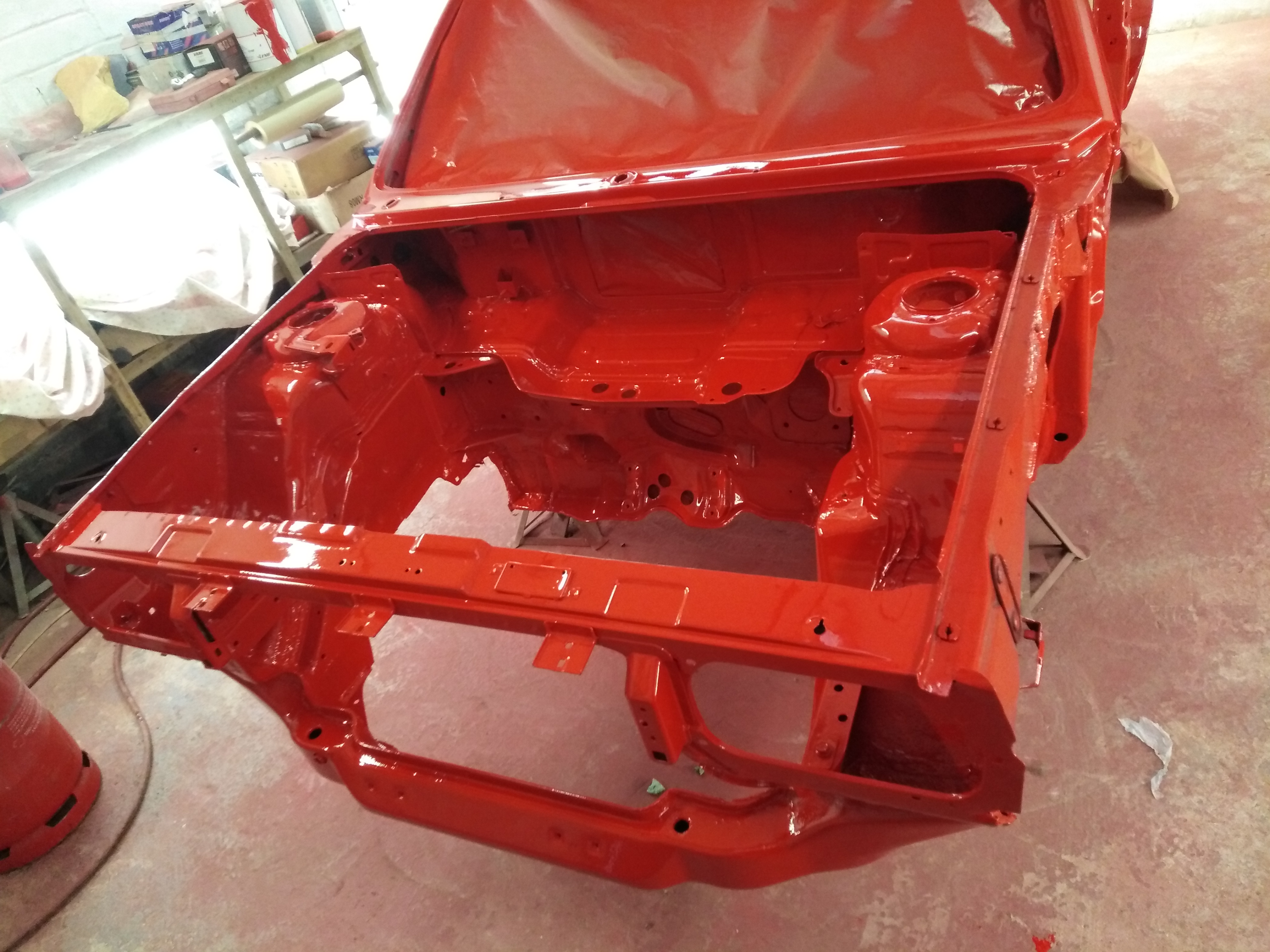

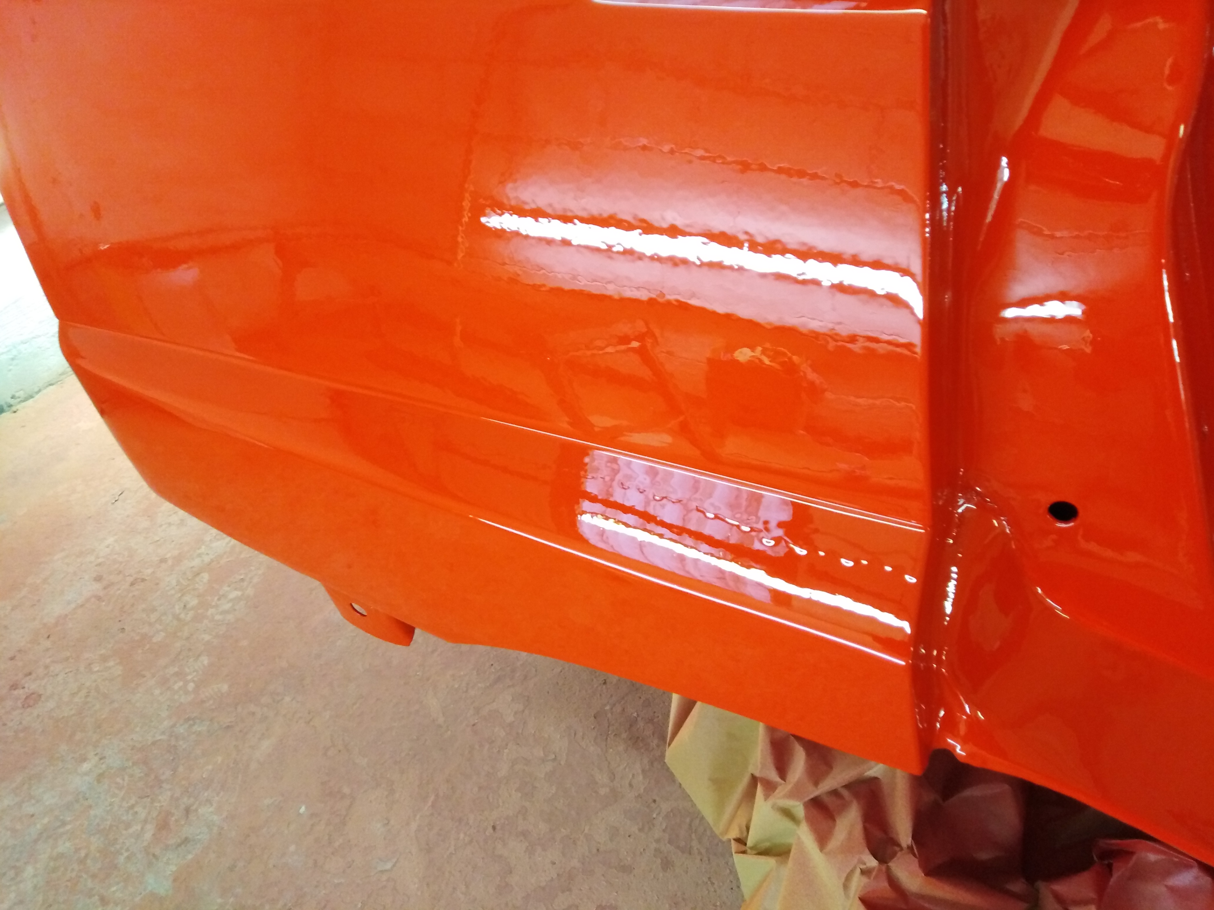

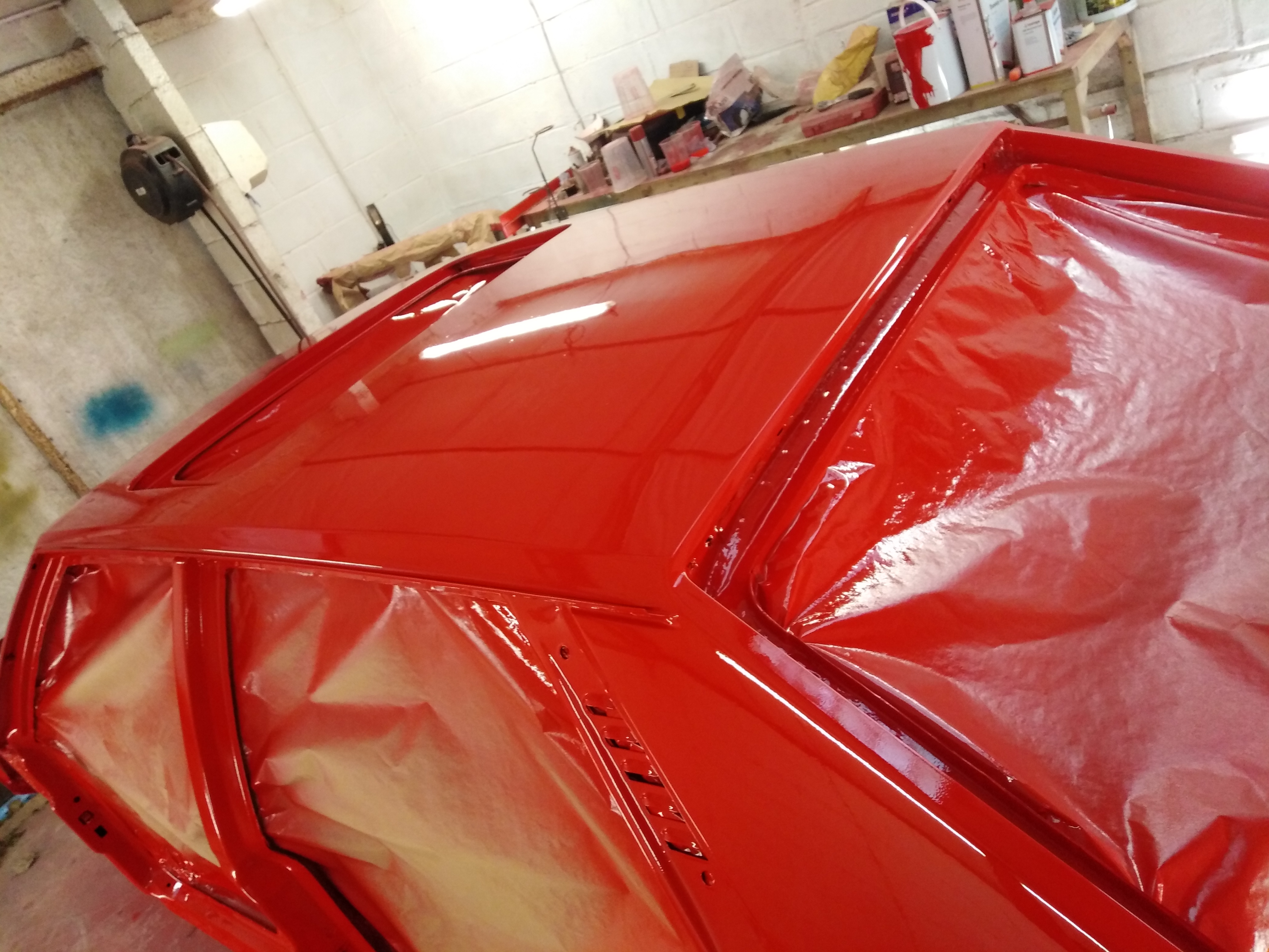

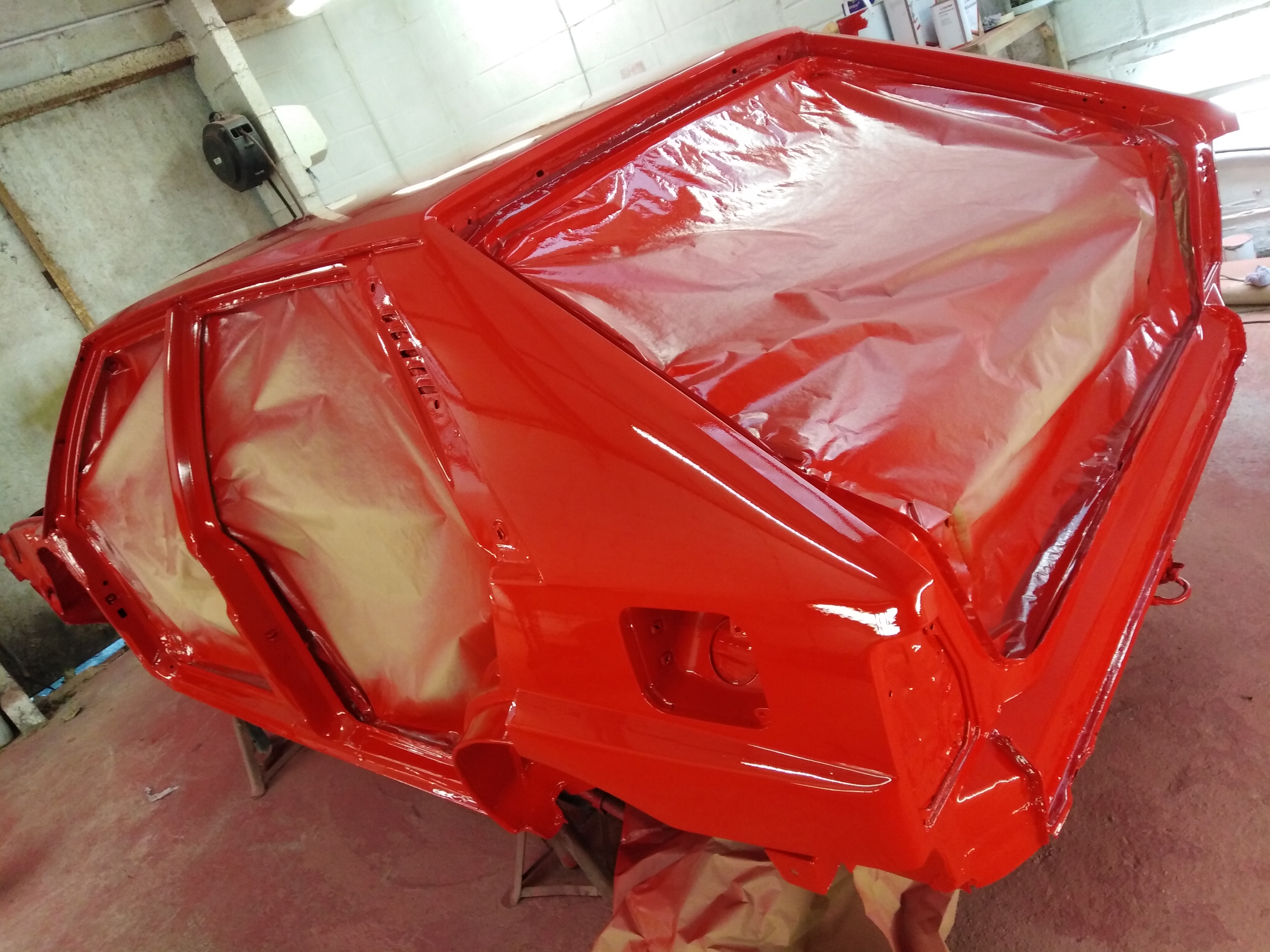

Very happy with the 'screen scuttle change, repairs up the pillar have blended in lovely.

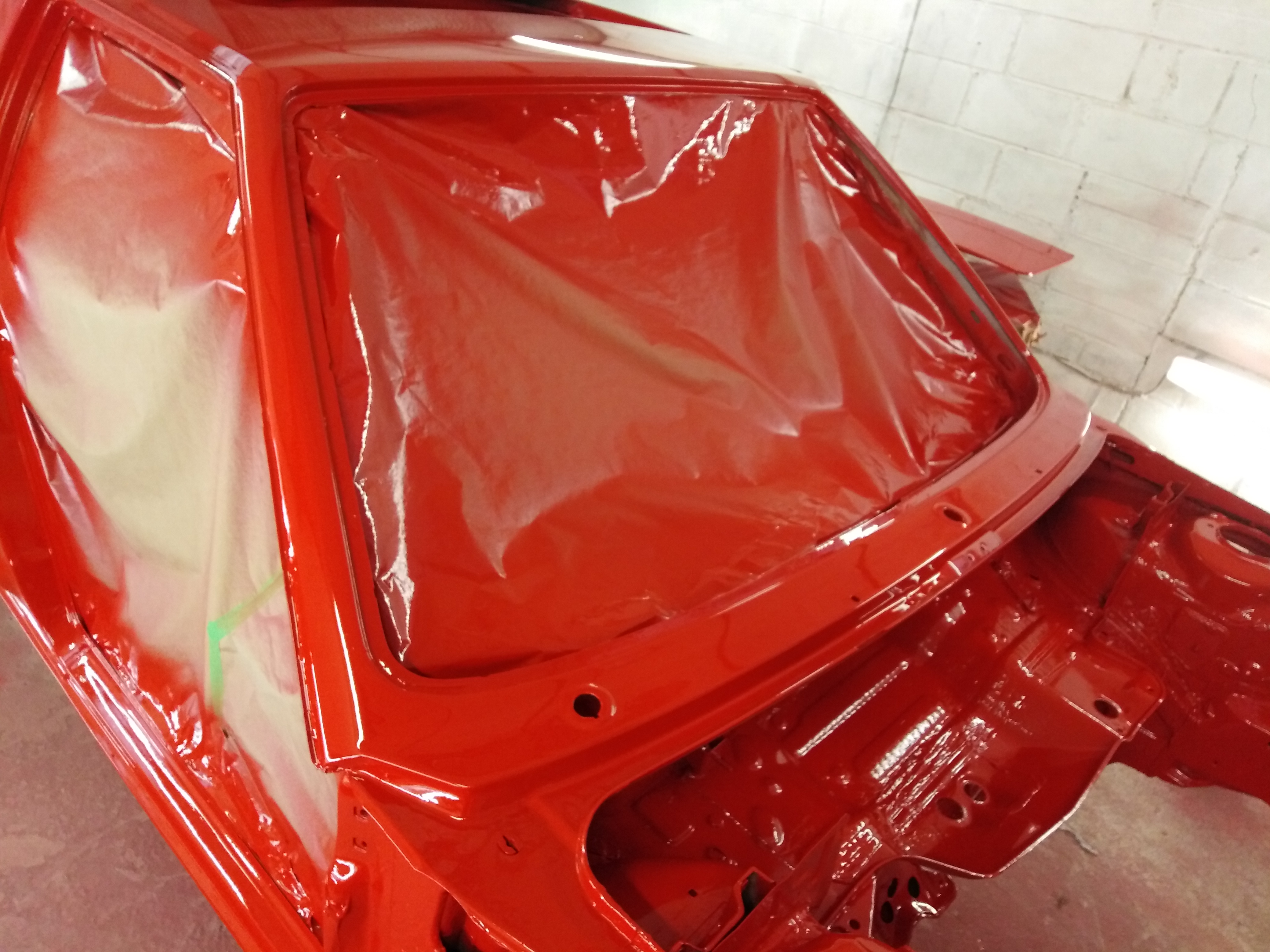

Finish has come out pretty decent, some dust and overspray drop on it but that's my circumstances with the building I'm in.
What's not the buildings fault though is my giddy moment where I reinacted Niagara Falls :roll: :o

If that is the only run you got, top bloke. Trust me, that hasn't even broken into a trot.!! :lol:

One question you may be able to answer mate, either from your vast experience or through data at work? The door frames are black, would that just be a satin black or is there a code available?

And yes, that run was the only one.. well besides the matching one on the other side arch!
Brain fade following the contours of the rear arches too much and double dosing where I shouldn't have!
That isn't the red I imagined Kev. Maybe the pics don't reveal the true colour accurately.
I think digital pictures sometimes don't show the true colour mate, it looks more orange in the pics than in real life.
Rosso Monza 155....
KevJTD wrote:I think digital pictures sometimes don't show the true colour mate, it looks more orange in the pics than in real life.
Rosso Monza 155....
I think you're probably right Kev, from the pics it looks like my Mito in Giulietta Red.

I would think just a satin black would be fine on the door frames Kev. Aerosol or gun applied. Not aware of a specific code.
Satin can be a pain to match . It's around 30-40 % gloss if I remember right . Aerosol cans mite be be an option.but not as much control as a gun .
I'm gonna do all 4 doors at the same time plus the weather strips so I'll probably get half a litre of mixed satin for the spray gun, might even use that little gun I got JB ;)
