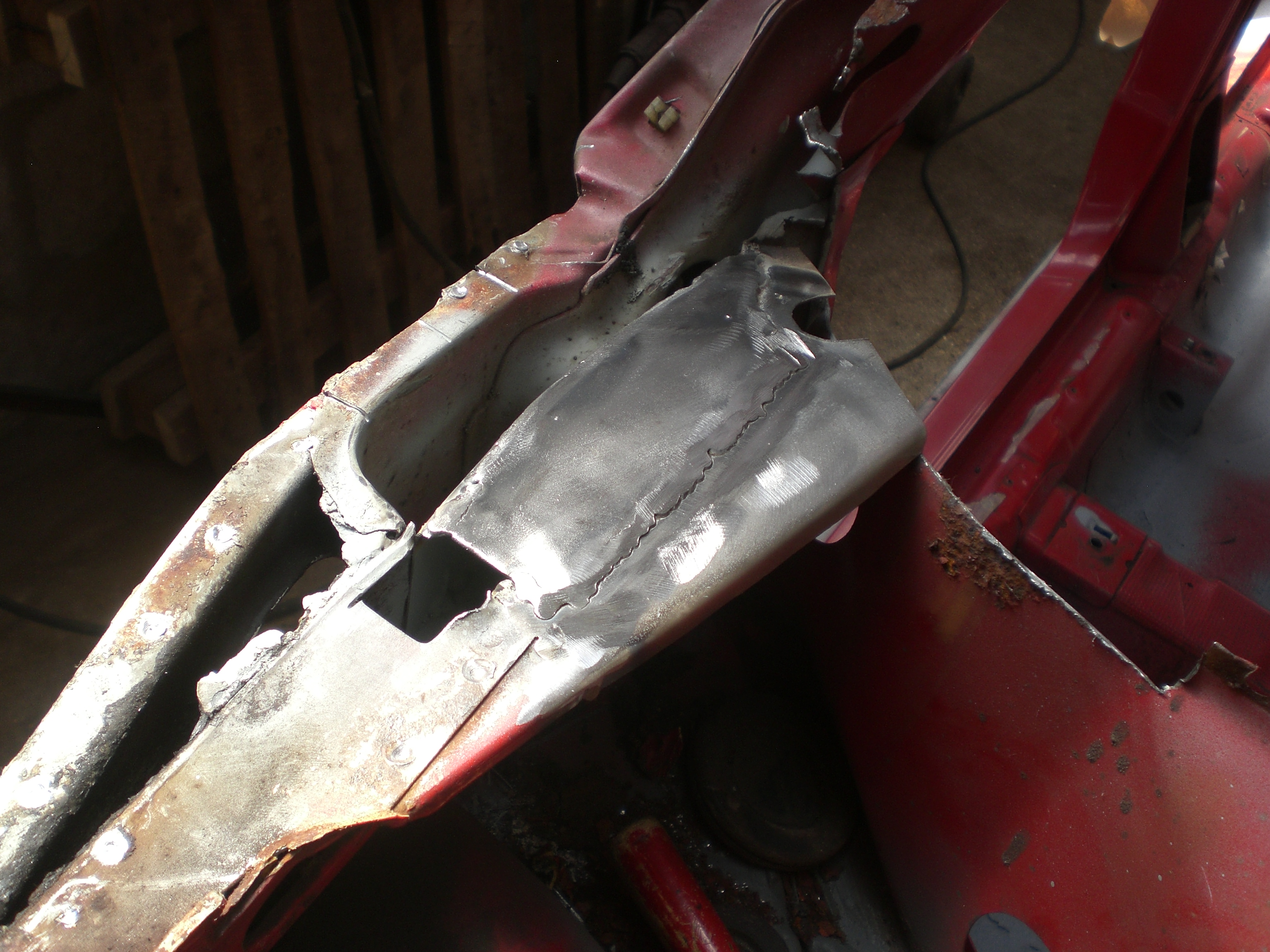

First job was to repair the top of the A pillar on the drivers side. How to repair it wasn't quite as straightforward, a simple enough box section but access wasn't that easy unless I started chopping big holes in stuff.
A bit of thought and some differing ways of removing the rusted sections (not a hope of getting an angle grinder in there, not even my plasma cutter) and a couple of plates made up and welded in made a good start.
Just then to box the top in.
Not quite as simple as it sounds as it needed to be in the right place height wise as the scuttle panel welds down onto it.

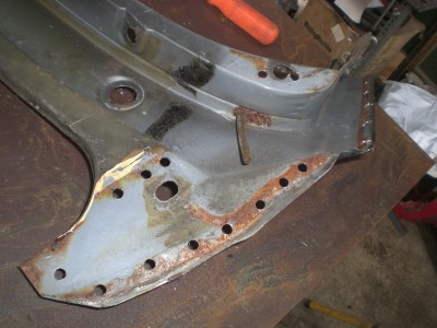

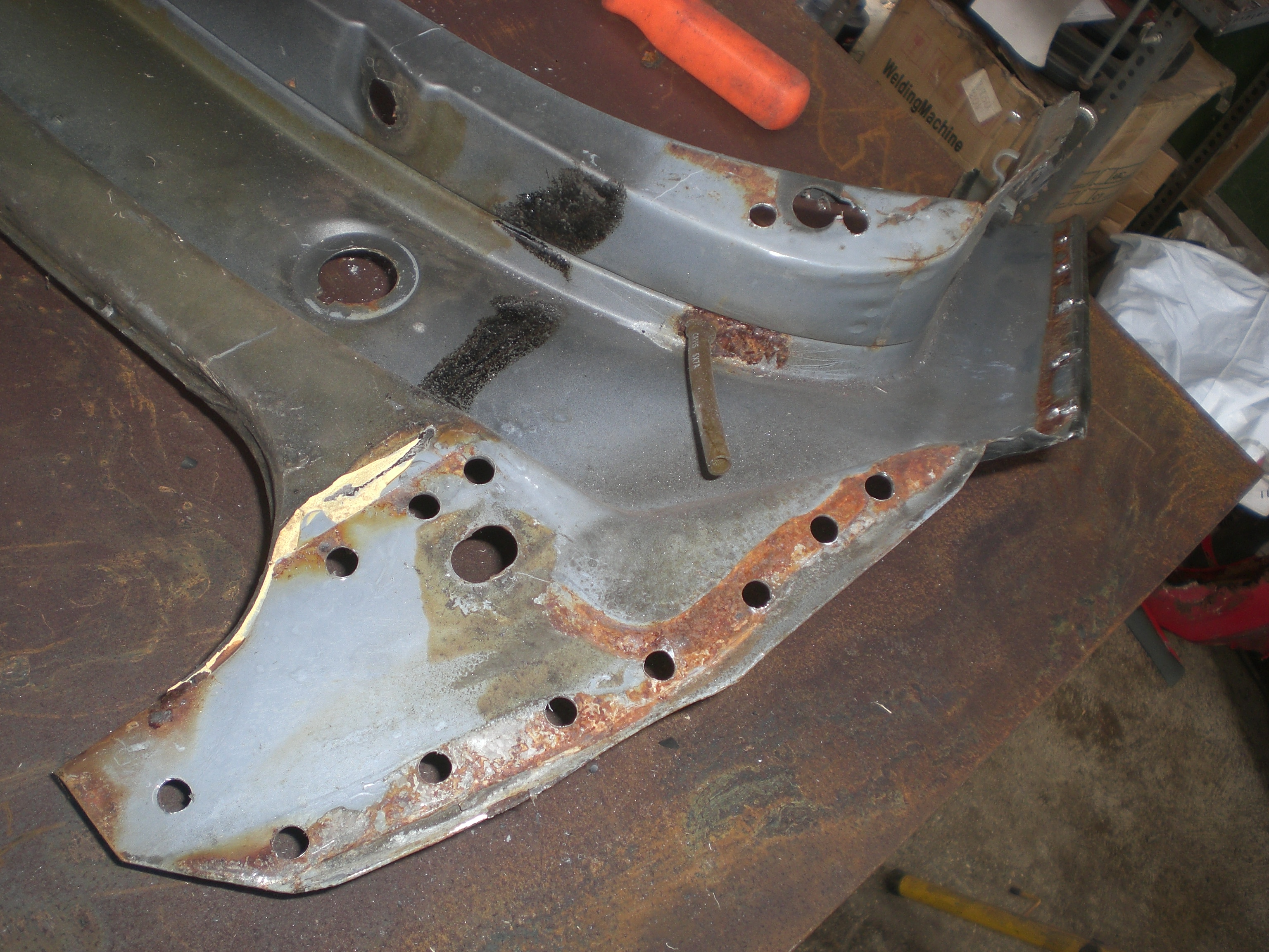

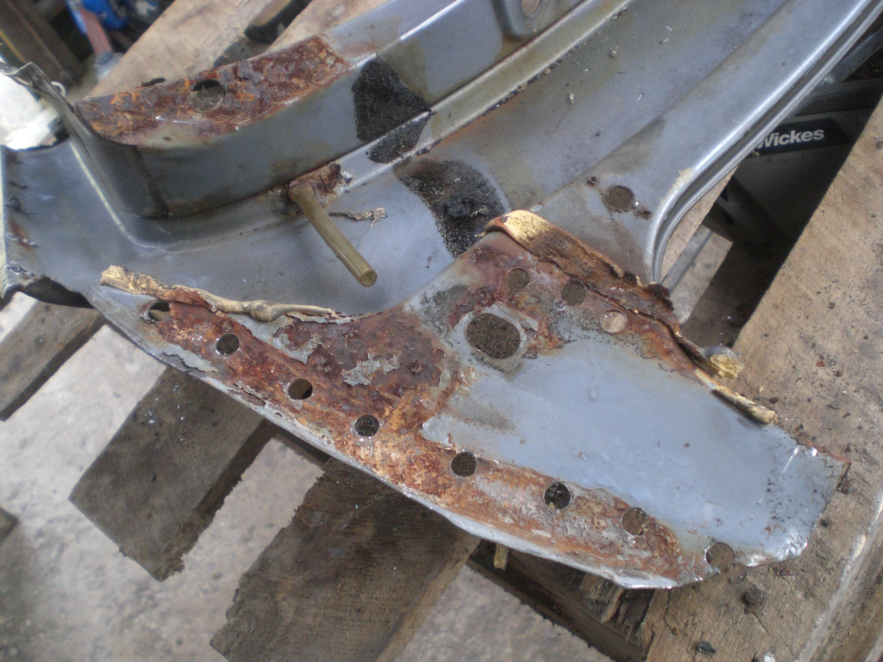

This afternoon the laborious task started off removing the unwanted metal from the replacement scuttle. Trying to remove just enough without causing any damage or distortion to the part I do need was time consuming.
Eventually though the "new" section was ready for trial fitting.
There are a few bits of surface rust plus the 2 drain holes in the corners will need repairing but overall I'm happy with the panel.
Passenger side is a bit pitted...
For once though luck was on my side, the original section is in great condition and I'd even managed to chop it off the car yet leave just enough material to be able to replace on the new one!

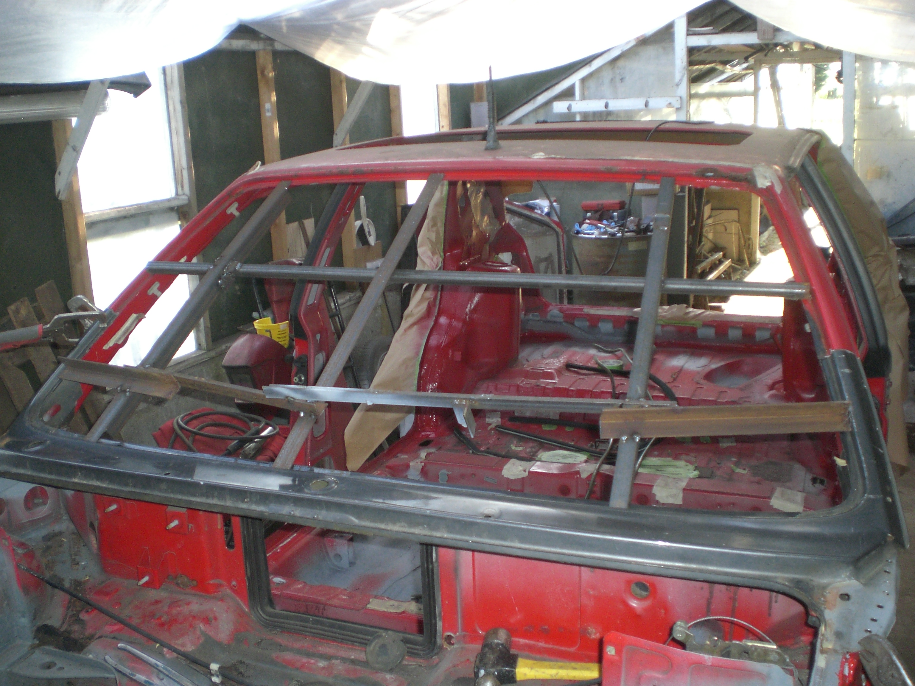

With things tidied up alignment is just about there....my stock car roll cage still fits!
All the rusted sections I will repair before fitting it to the car as it will be way more easier to weld on the bench than on the car. Thankfully there really isn't a huge amount to repair.
There will be quite a few welds to do though!

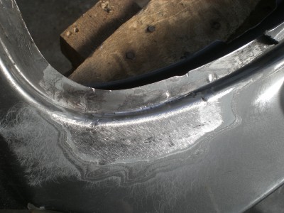

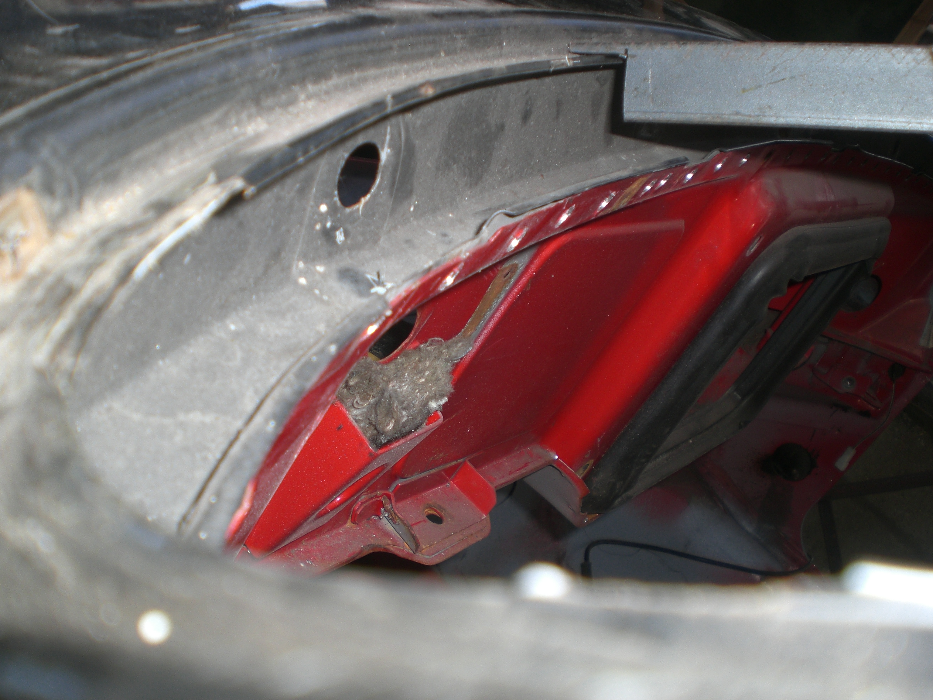

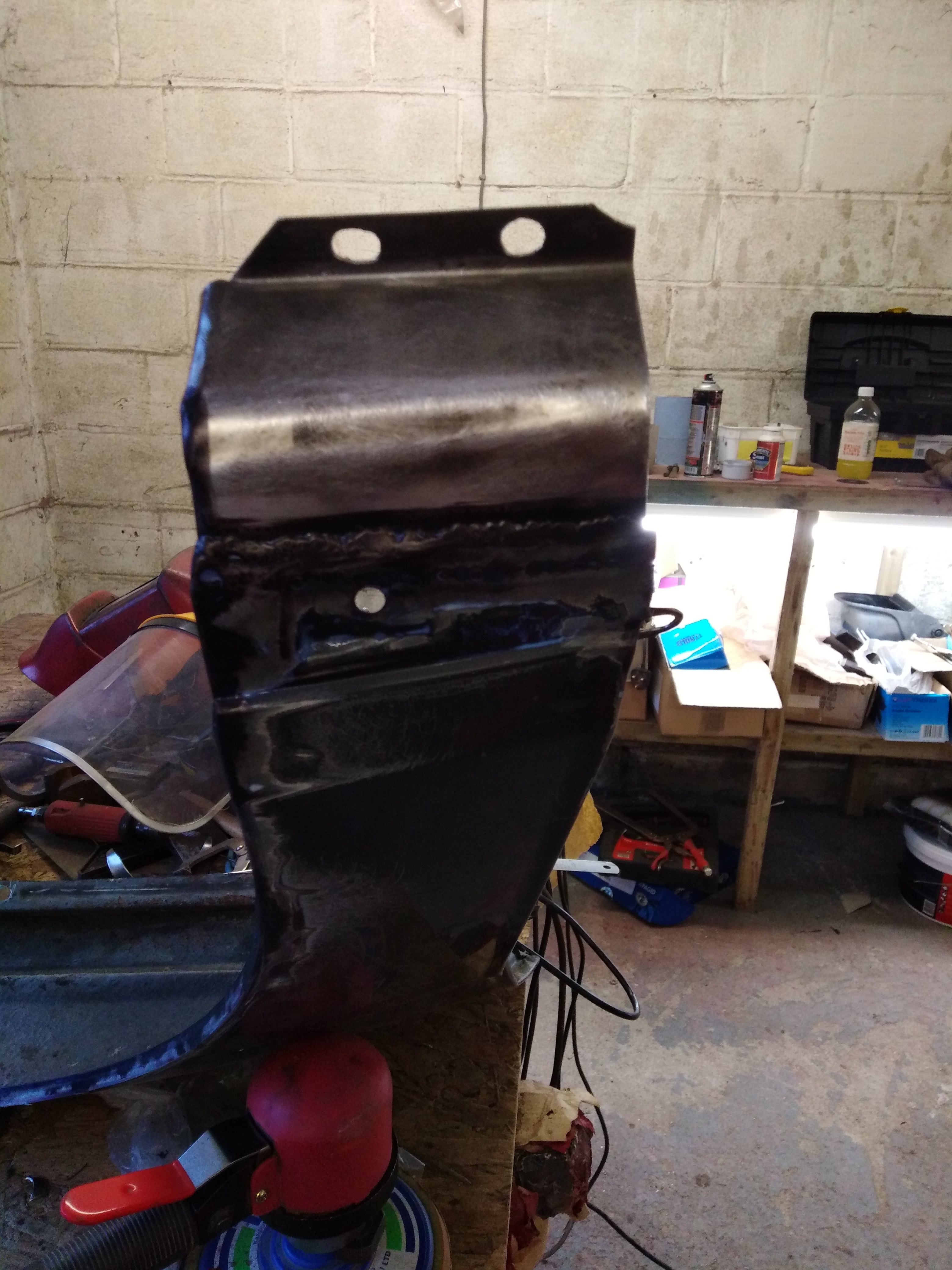

This afternoon I set about making the repairs to the replacement scuttle, the little drain holes in each corner were crusty. Could have maybe been saved but I don't particularly like them so rather than just clean them up I chopped the holes out a bit bigger than the rusty portion, as I keep saying, a patch is a patch to weld in whatever its' size. Being bigger than a finger nail makes it easier to work with too.
Drivers side butt welded in flush to keep filling to a bare minimum.
Beauty of having the panel off the car to repair it is you can weld the underside without being a contortionist! And with the inner part being in fresh air away from everything the weld can be left on to keep maximum strength, I'll seam seal it before it goes on too, it's at the moment laid upside down having hat rust treatment then etch primer drizzled into the seams..
Passenger side the same process.

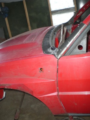

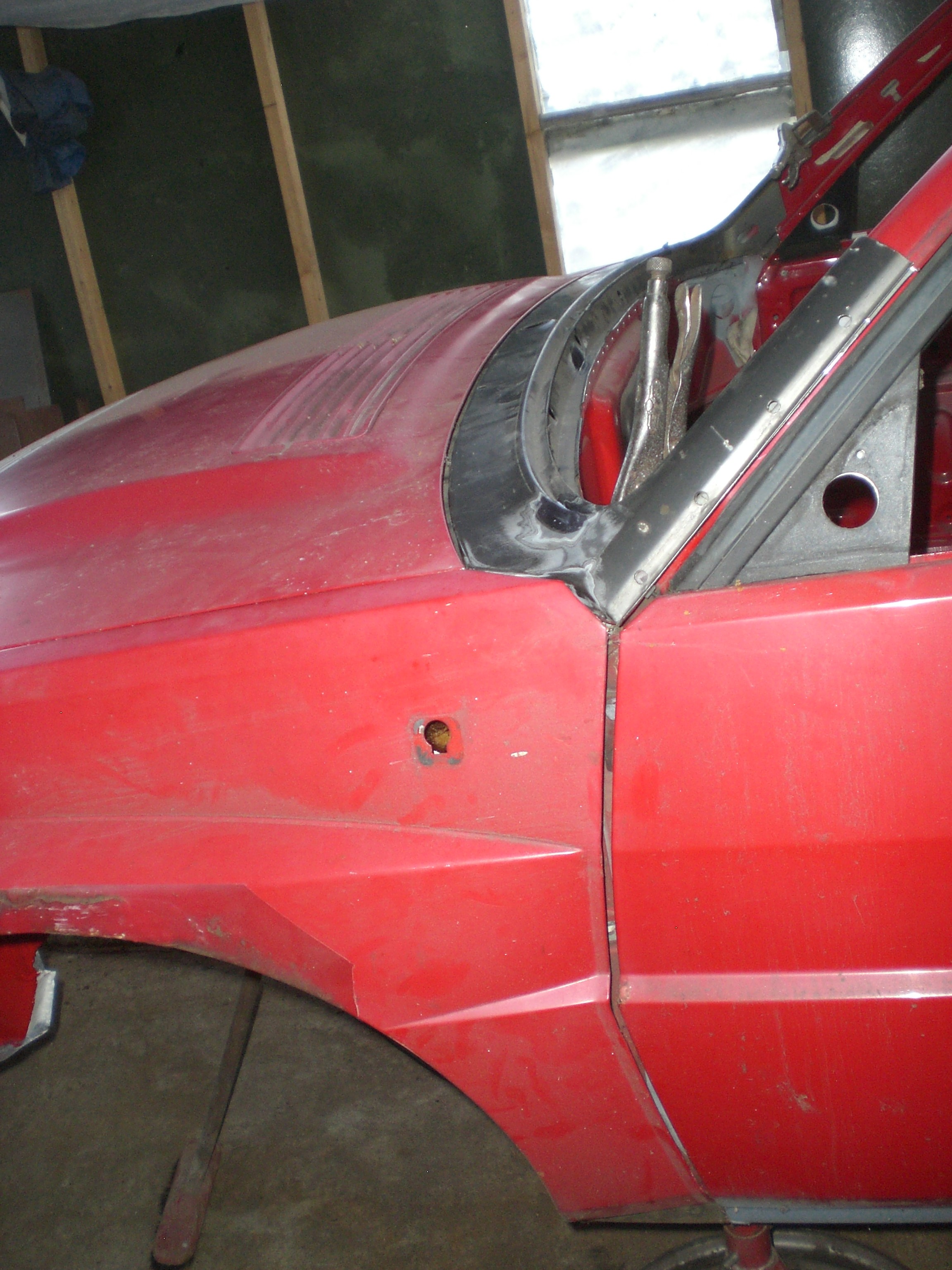

With the panel ready to go on (before I did the treatments) I dug the doors, bonnet and wings out to check we were still in the ballpark regards alignment.

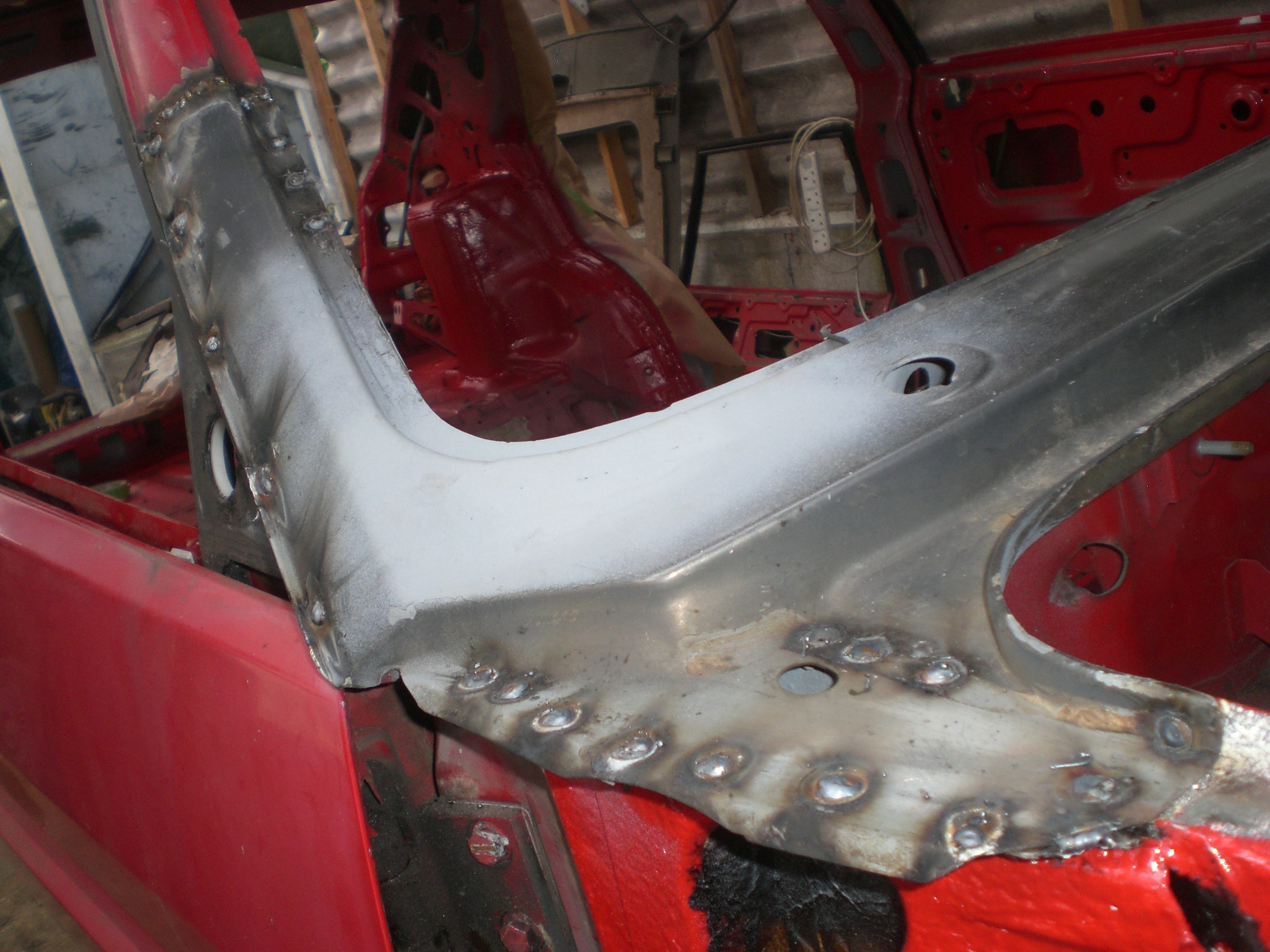

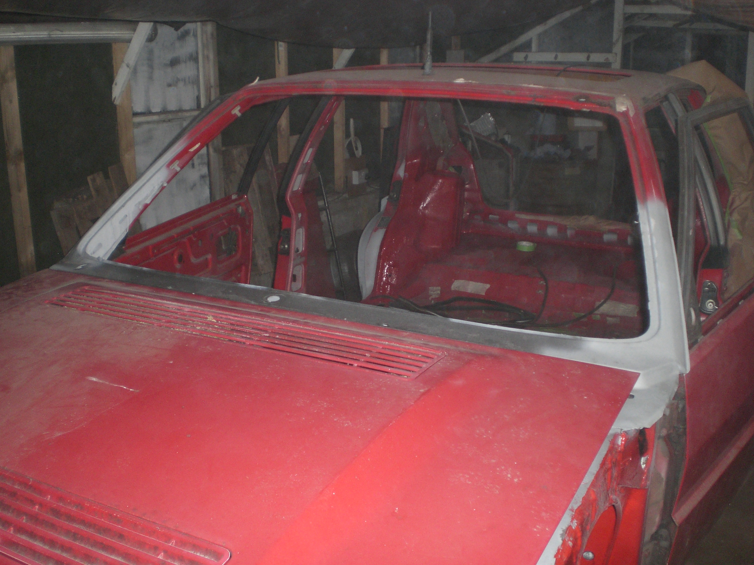

Got the afternoon off as planned so up to Jims' to do some welding, the 'screen/scuttle top was pretty much ready to go in.
Alignment checked and double check then the plug welds could begin.

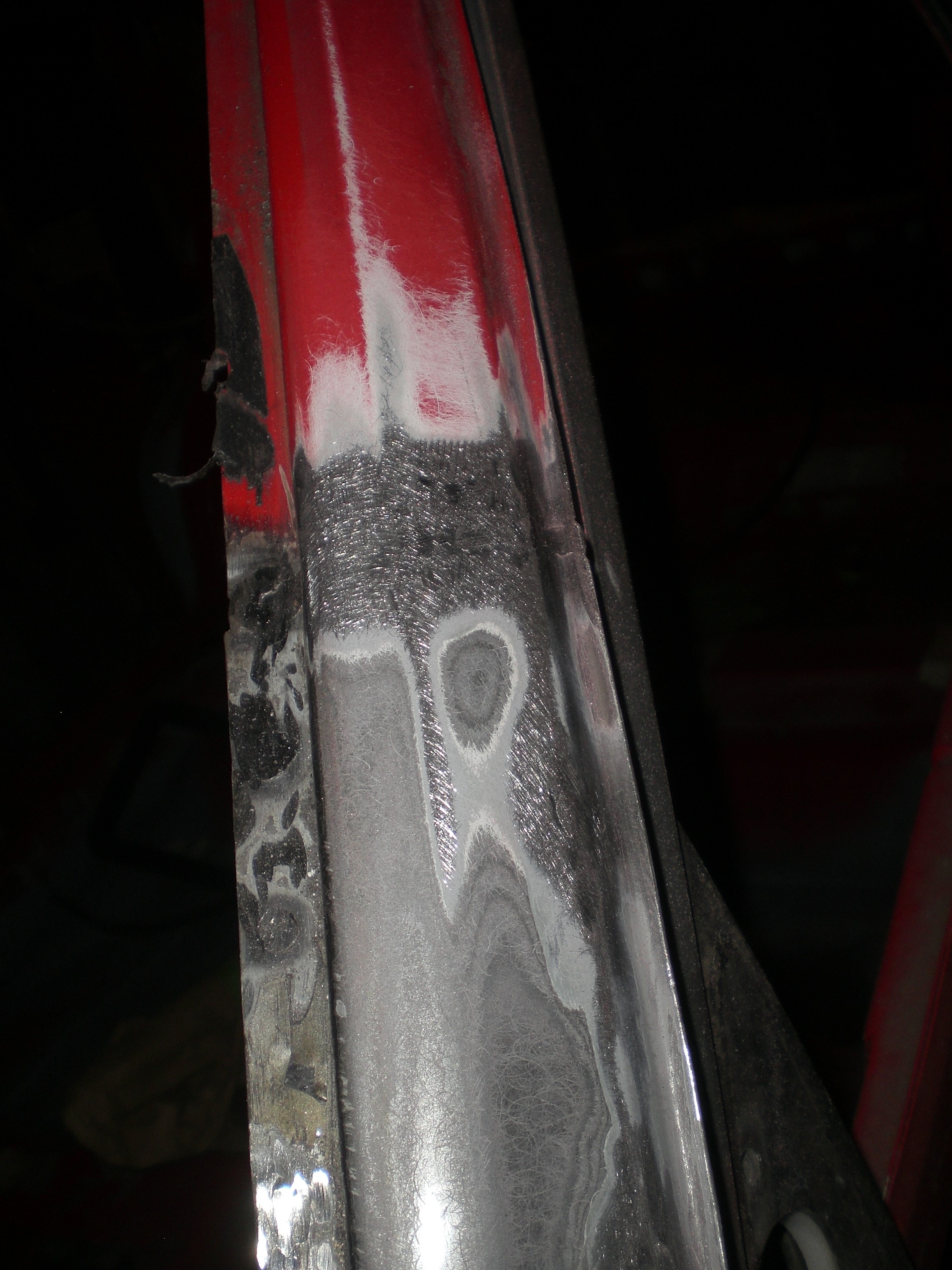

Up the pillars it needed to be butt welded to ensure a flush finish.

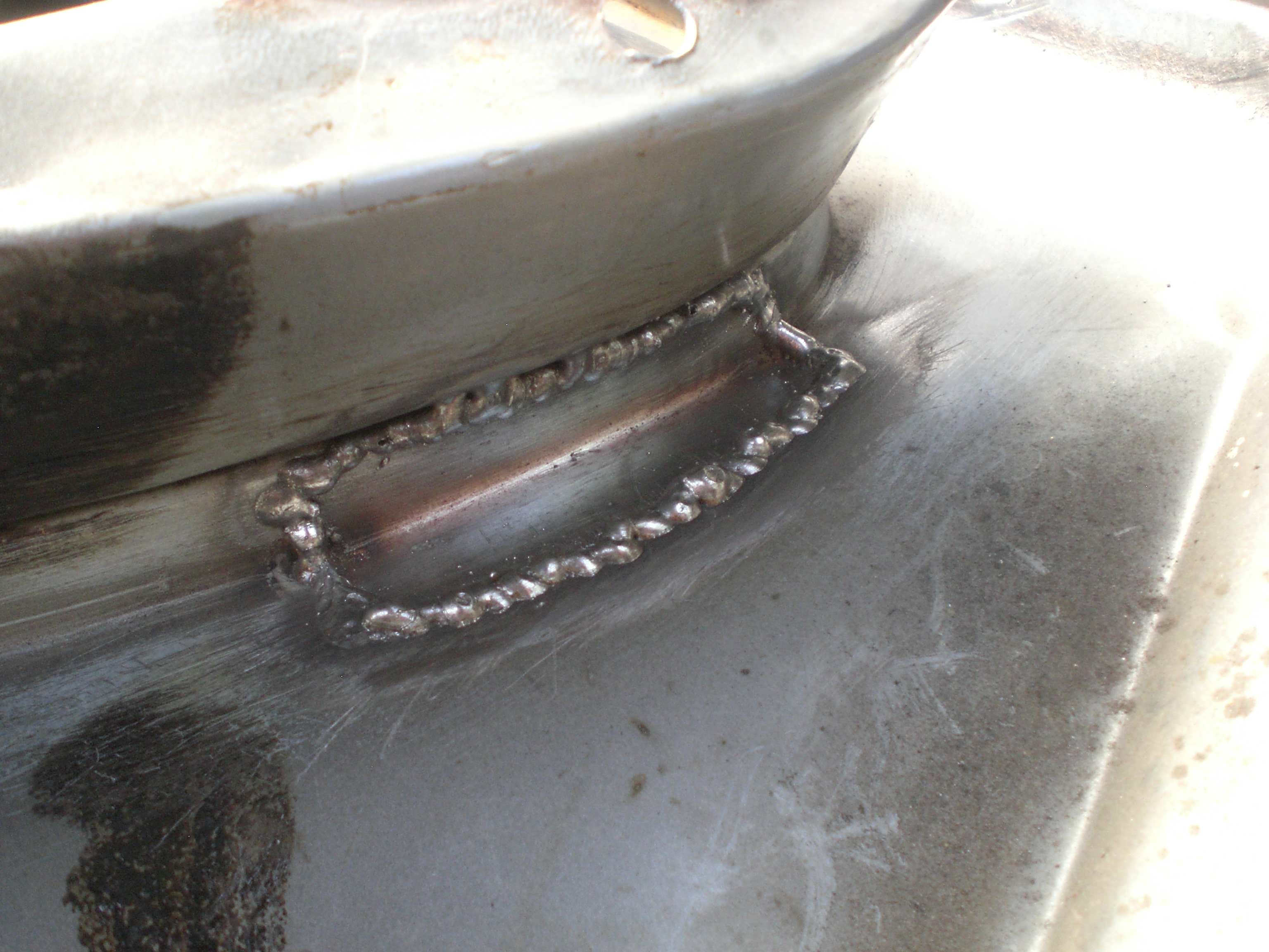

Inside the pillars the joint was staggered half way down using an overlapped joggled joint not only for strength but because the sunroof drain tube runs behind this joint so I didn't want the risk of a stray weld wire poking inside.

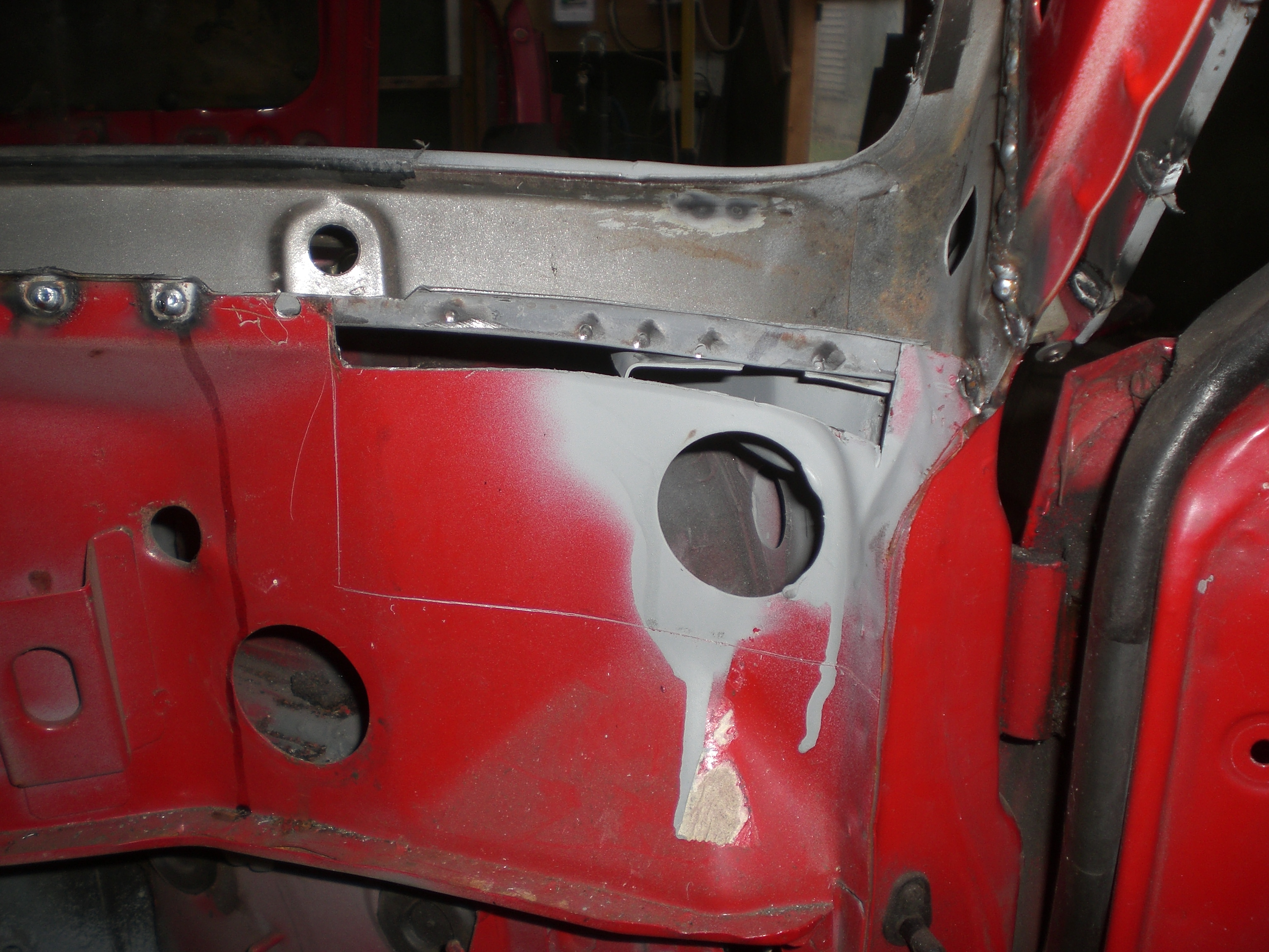

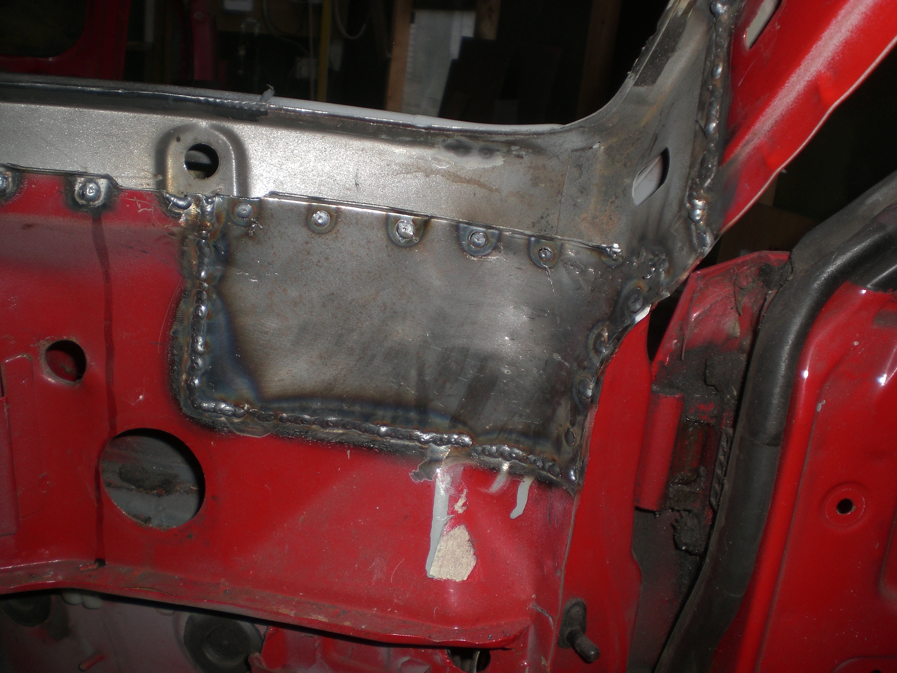

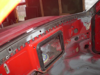

The long row of plug welds on the bulkhead will be inside the car rather than having a load of fresh welds on the 'screen lip I used more of the replacement panel which turned out pretty good in the end.
The drivers side bulkhead corner had some rust around the large grommet hole, which is just blanked off so of no use! The marks show where to cut...
With the grommet not being used and of no real use to me it makes sense to not bother with it, it's my car so I'll do as I like! lol
You can also spot the slot where the sunroof drain comes back out showing that care of the weld there was needed, again using the section of the new panel helped here as the old was crusty and would have been harder to weld down in the gulley.

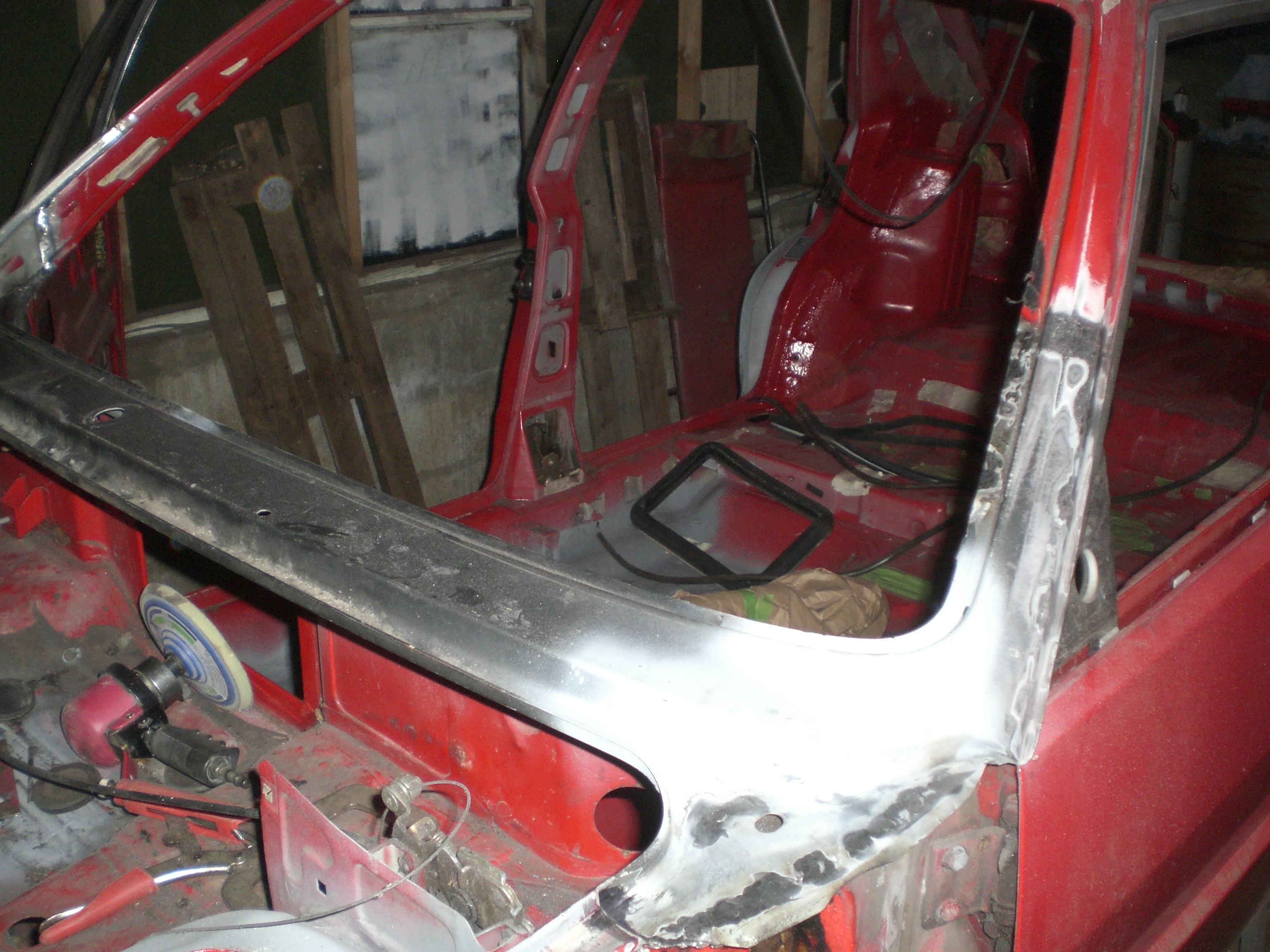

After many hours of clamping, checking and plugging the welding was done.
So that just meant the worse task of grinding clean the many welds!

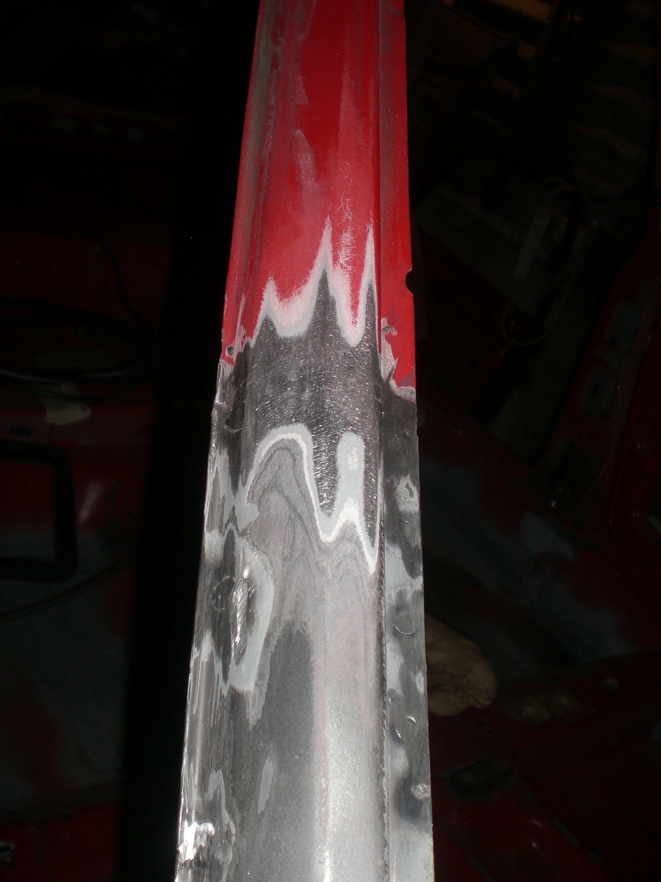

With some careful welding and even more careful grinding the butt welds up the pillars came out pretty good, takes so much more time to do them like this but the results can be worth effort, the joints won't even need any filler.
Drivers side...
Passenger...
Cleaned up and aerosol etch to preserve it then done, pleased with the nights work, yes it was almost dark by the time I'd finished!

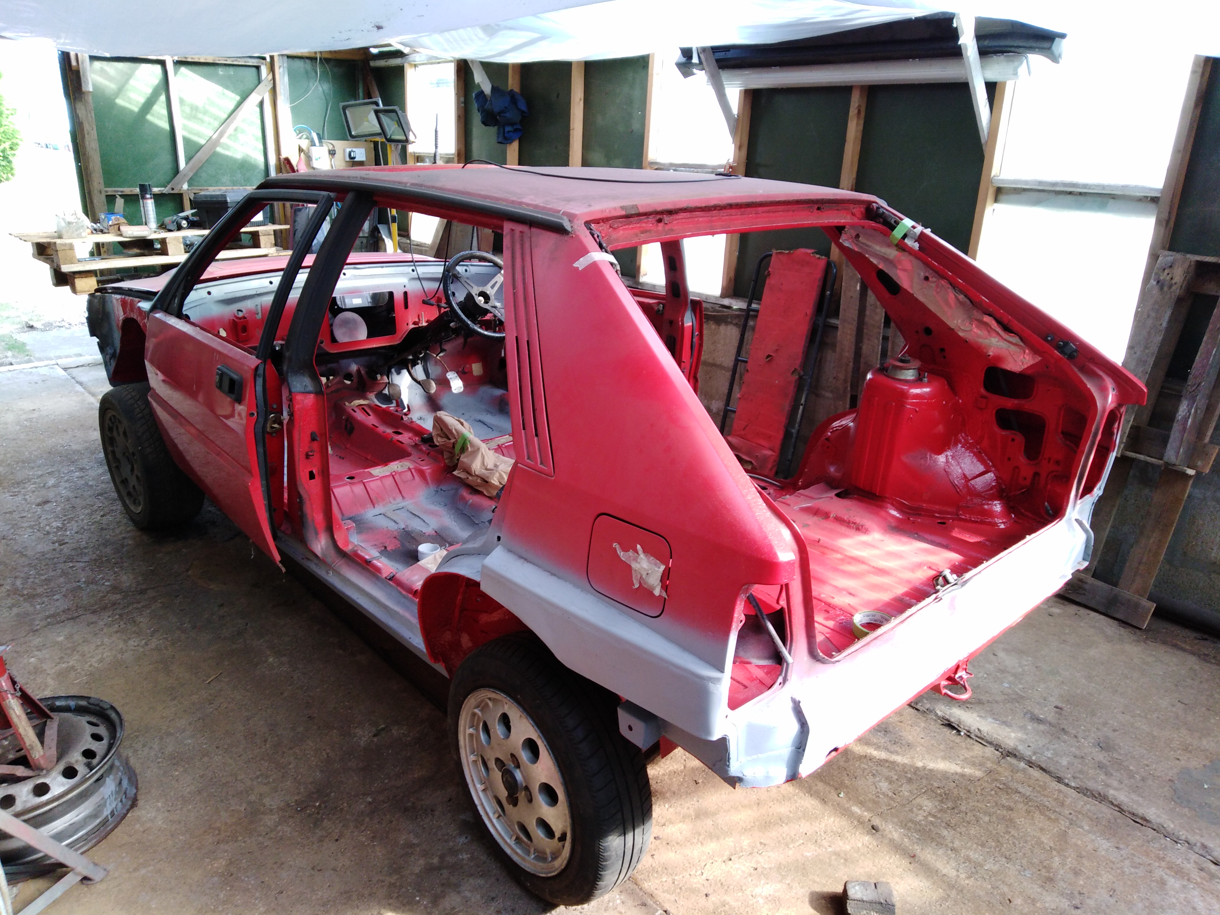

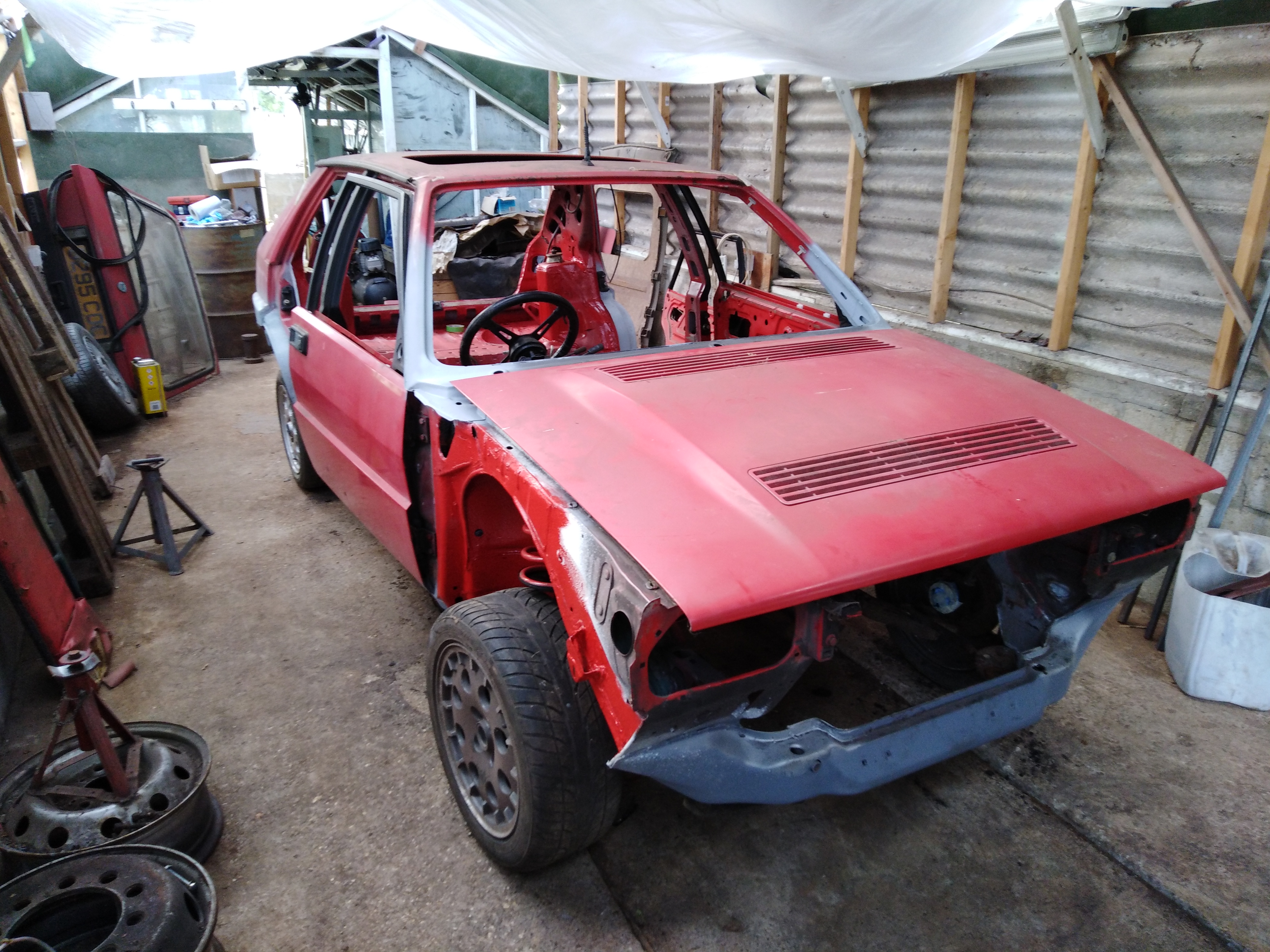

Today though I got the car fitted up with suspension all round ready for it to go up to the unit soon, when a slot becomes available at the unit I hope to at least get the shell painted before the year is out.

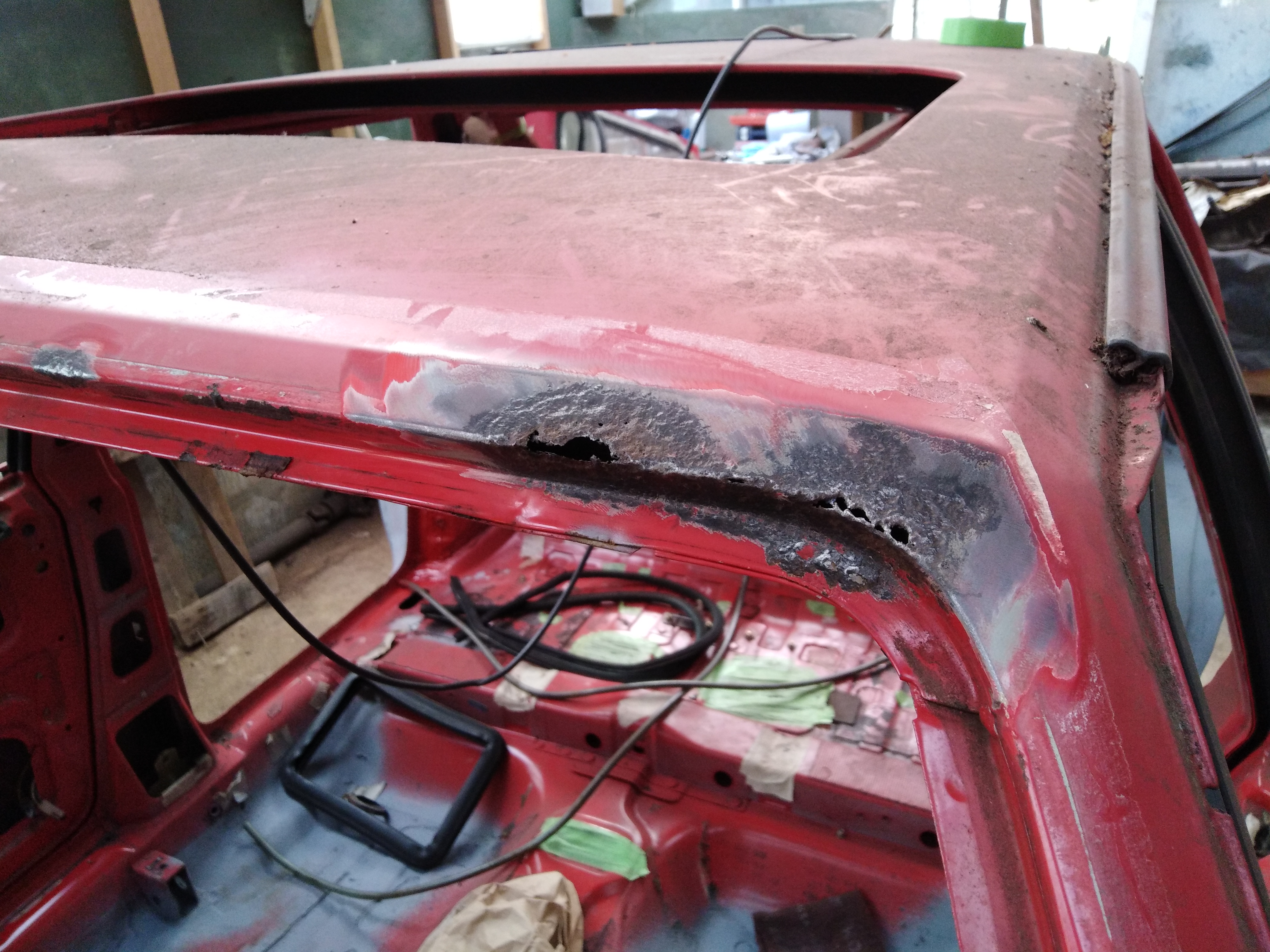

Now it is back on the ground I can reach the top edge of the roof where the rusty scabs inevitably turned into a rusty hole....
A couple of patches made up and solid again.
Hoping next week the move will happen....it's been far too long sat in Jims' shed that we knocked up to do the "quick" welding!

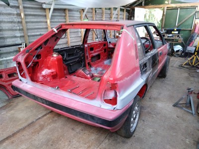

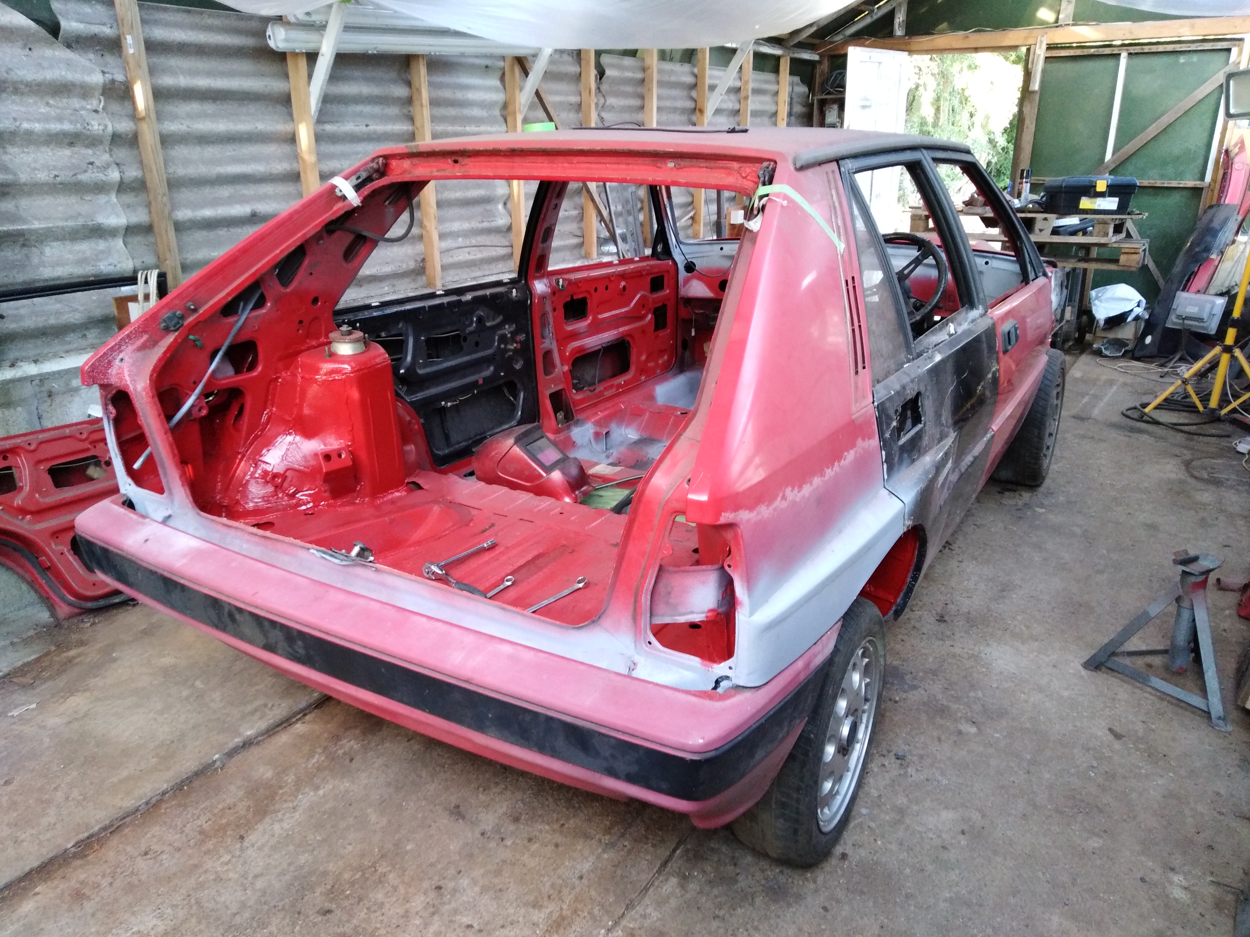

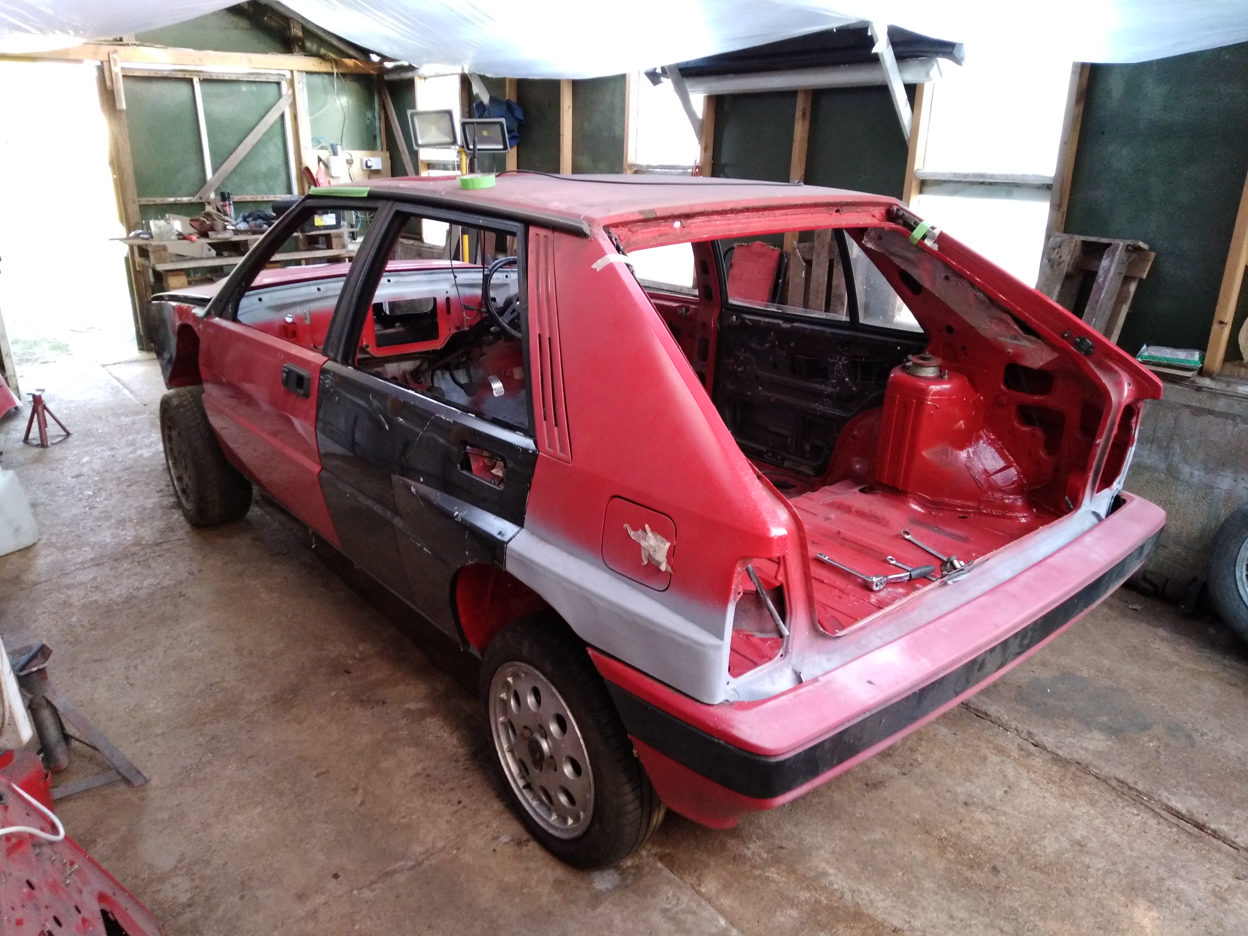

Not anything new to photograph, but I did anyway! :)
A long way off being complete again but the illusion is there :P
Pshycological step forward can be as important as a real one......once it’s painted even more so.

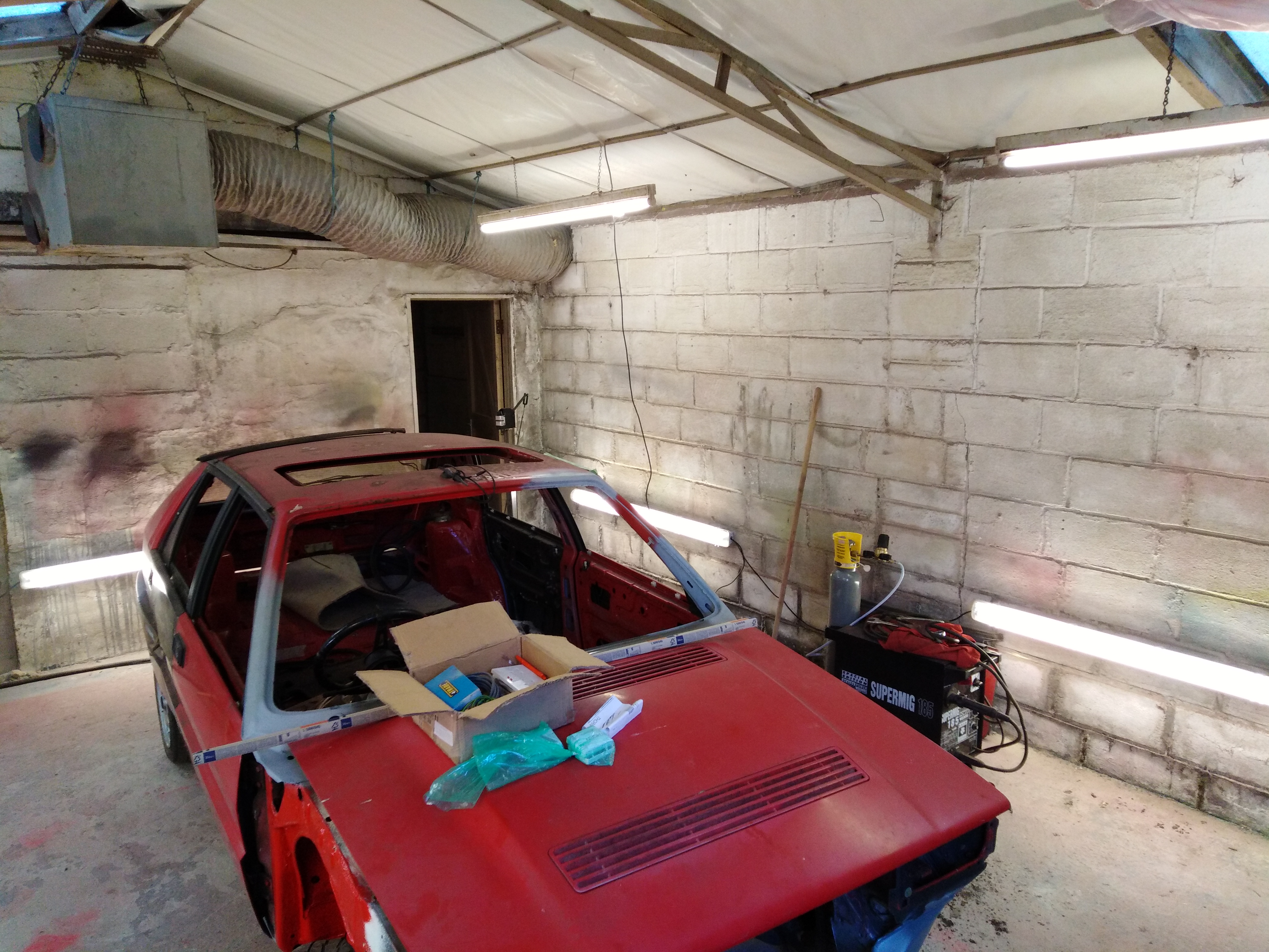

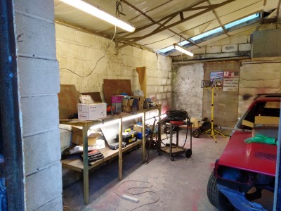

The last few days have been spent moving stuff around, the integrale into my old unit that we will now use for welding/painting despite having a much bigger unit to hand.
This is because to segregate a useable size in the big unit would compromise our space and flexibility of use for the big one, both John and myself sharing the unit have different cars in and out, John more so than me. To separate an area for painting etc would lose us space and potentially create problems with contamination especially as John's cars are in good order and not waiting for stuff to be done!
If it was just my unit then I'd keep it all together but it's not, so we won't :D
It is nice to get back into the small unit again though, a few cars have been done in there in the past.

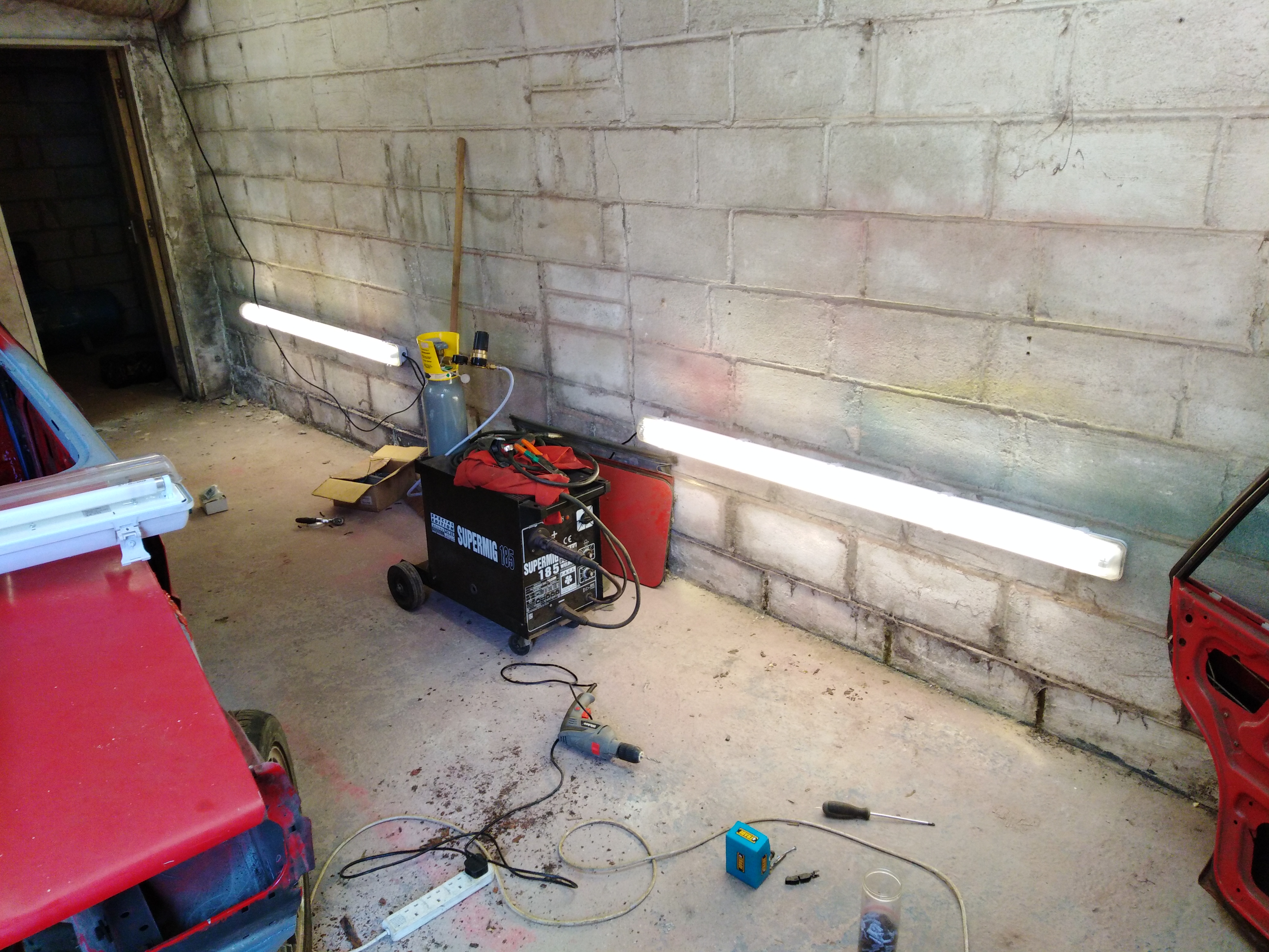

I always wanted to get better lights in there though, it just had 3 hanging from the roof, not ideal for painting!
Some previously donated new units by Richard and Shrew have been fitted up and wired in by yours trly….so far so good!
Extractor hung back up and hole knocked back in wall for it, I am going to try and get some more suction pipe so it draws from differing areas to hopefully cut out a little more of the overspray fallout. The fan has terrific suction but at the back of the unit it struggles to pull the spray from the front, a couple of pipes mounted high up down each side should help.
I'll probably get some white paint of some sort to do the walls, should help it brighten up some more.
The compressor I've put in the little store room this time, gains a little more space and also helps it breathe clean air when spraying.
Nice to get the integrale in there....

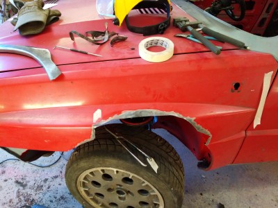

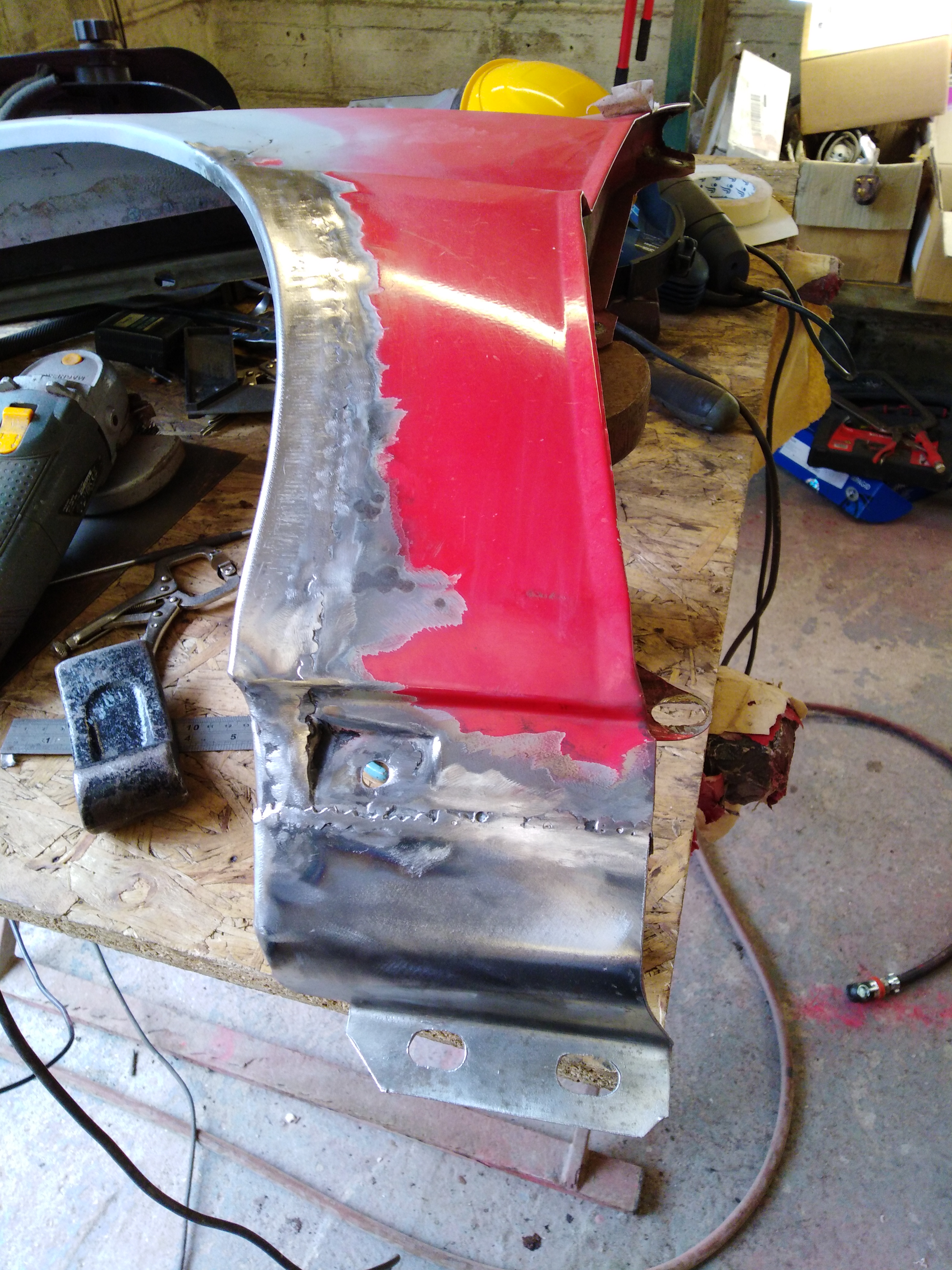

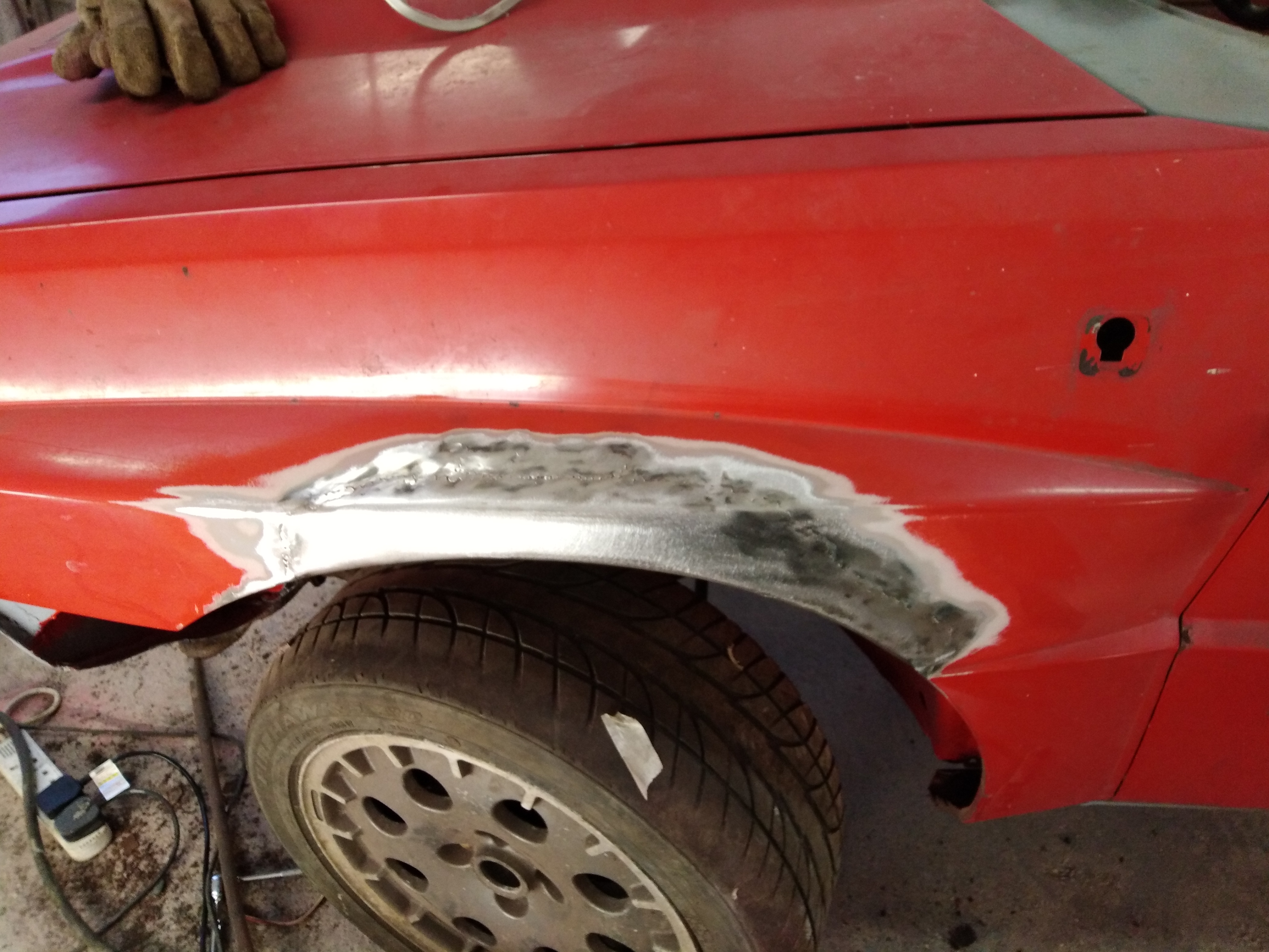

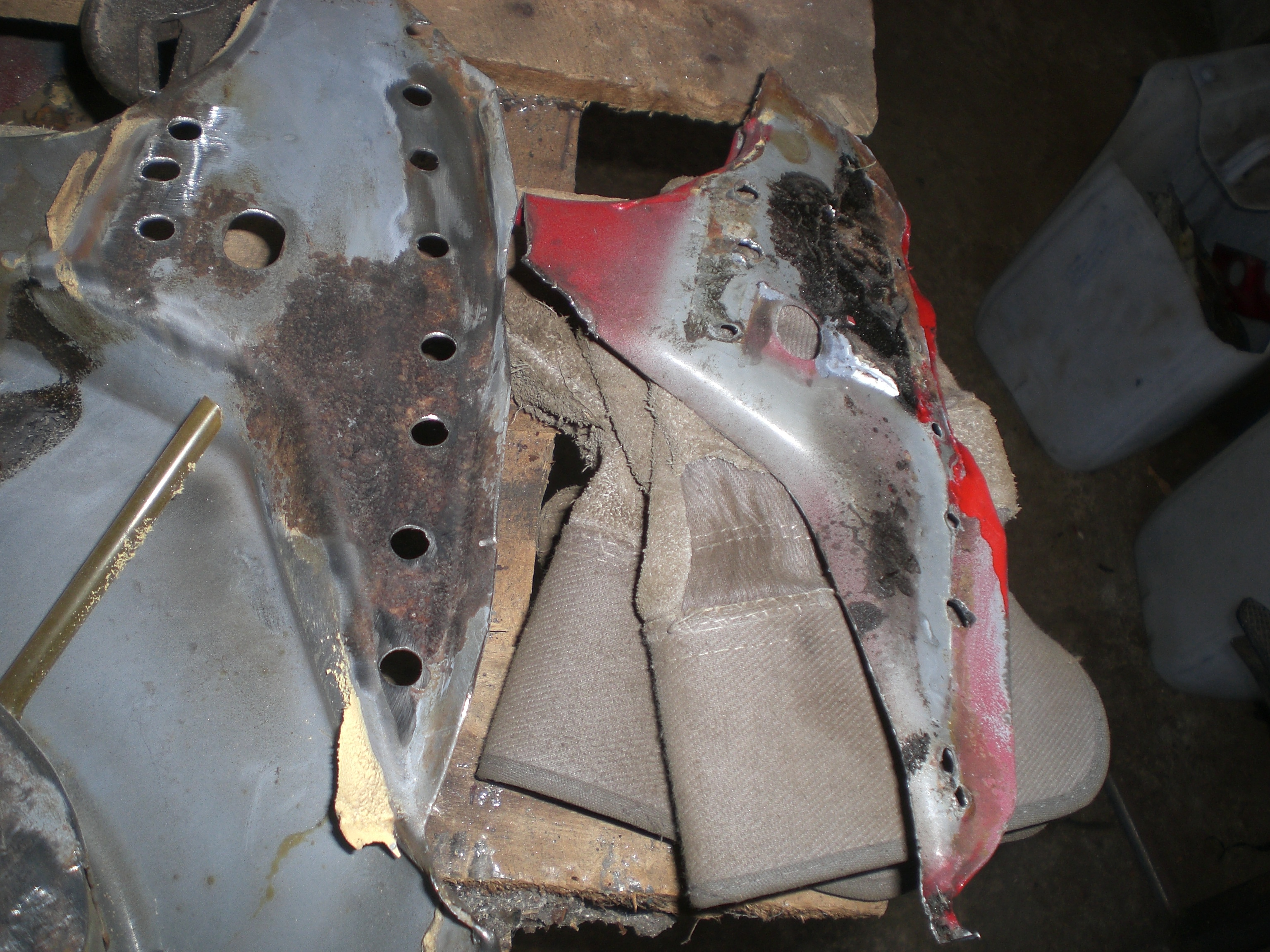

A good while back I'd bought a pair of good used wings cheap, well I thought they were a good pair...

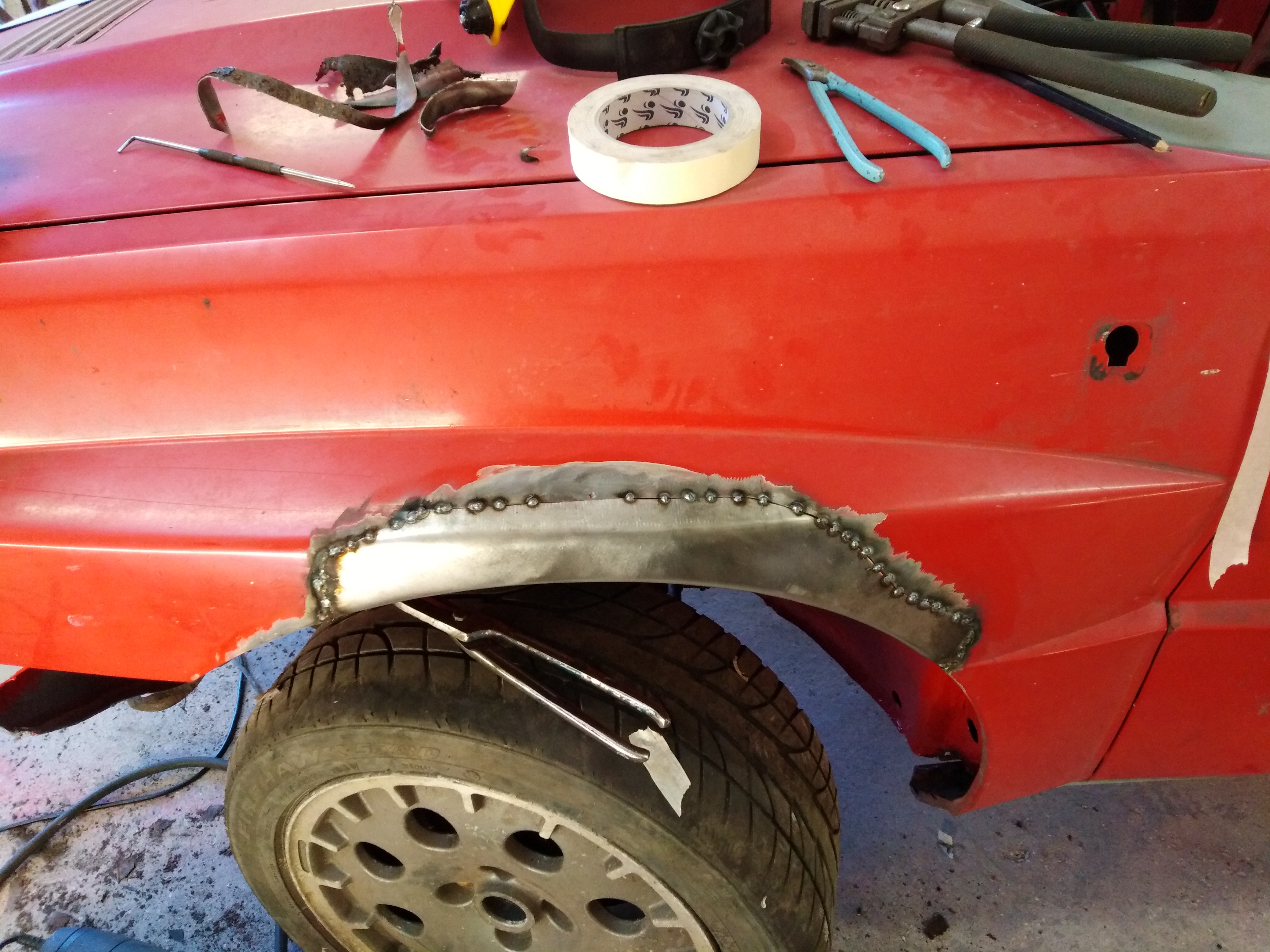

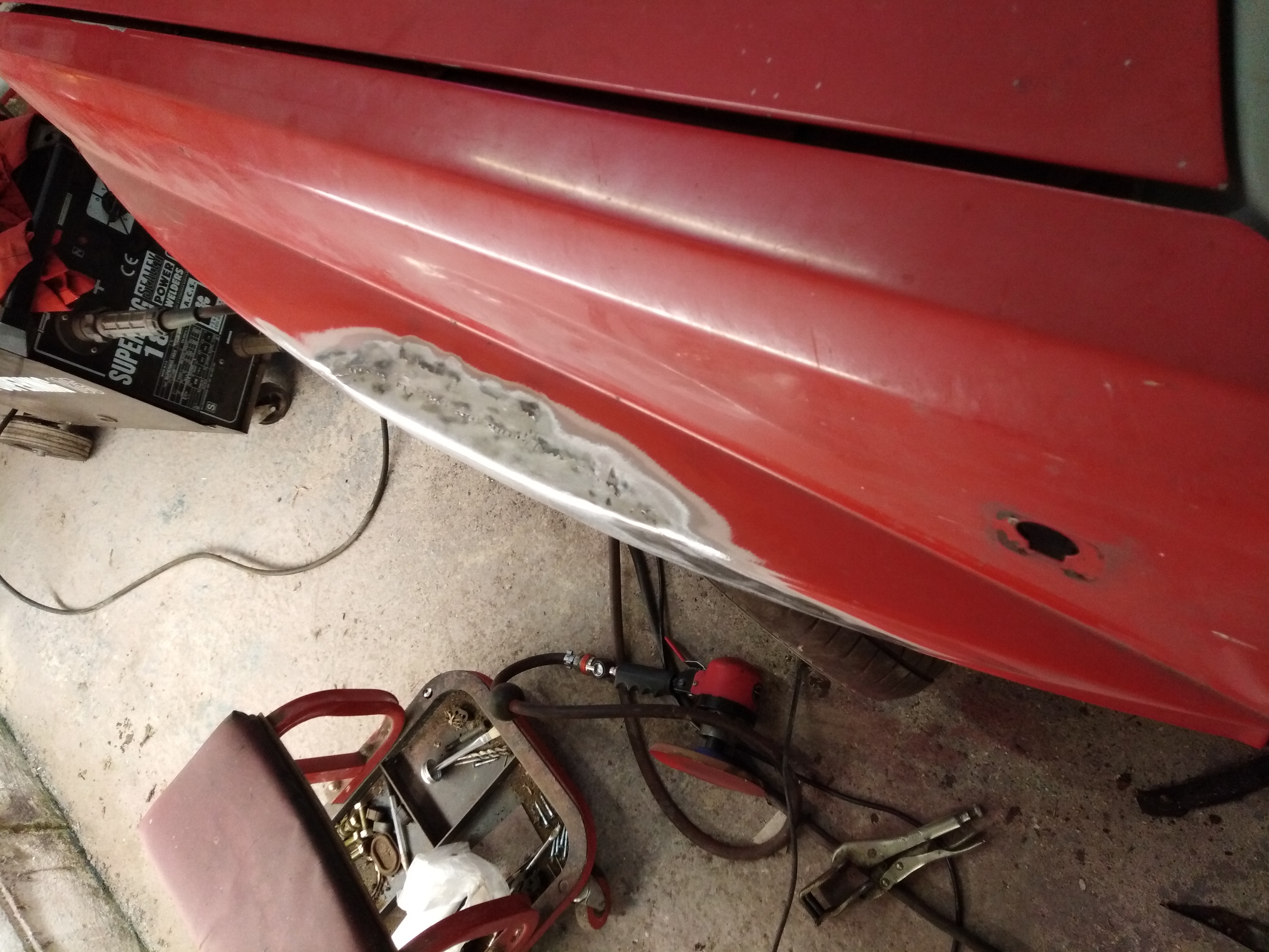

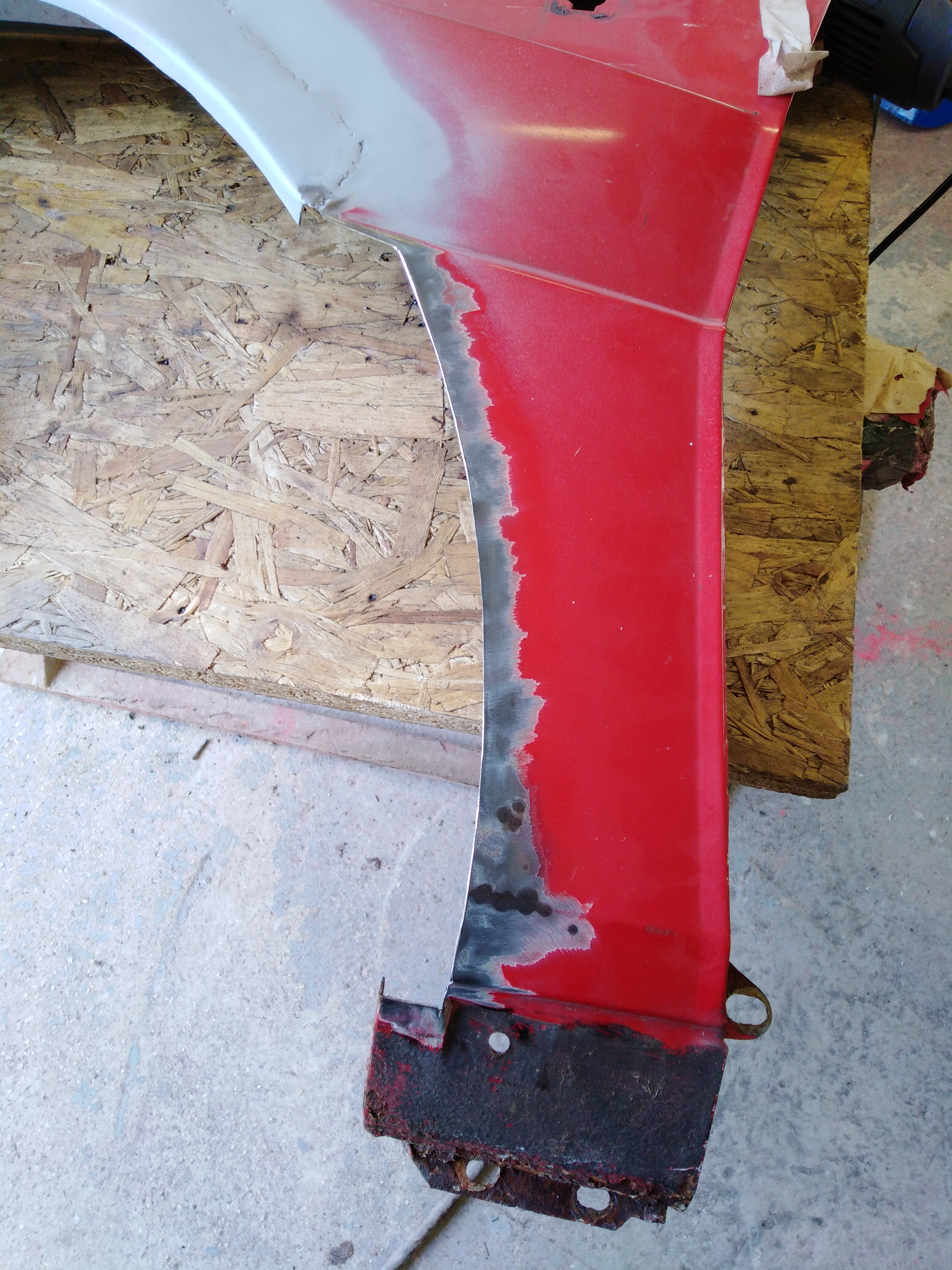

Passenger side was quite creased along the back edge where it meets the door, I managed to get it fairly straight but the fit was still a bit off and it needed the arch repairing anyway. Decided I may as well use the original passenger one which fitted nicely and only really needed slightly more rust repairs..
Wing had had a previous repair using rivets, aluminium foil and fibre-glass....
Chopped out ready for a new plate to be welded in, this I'd already mostly made at this point.
Tacked into place

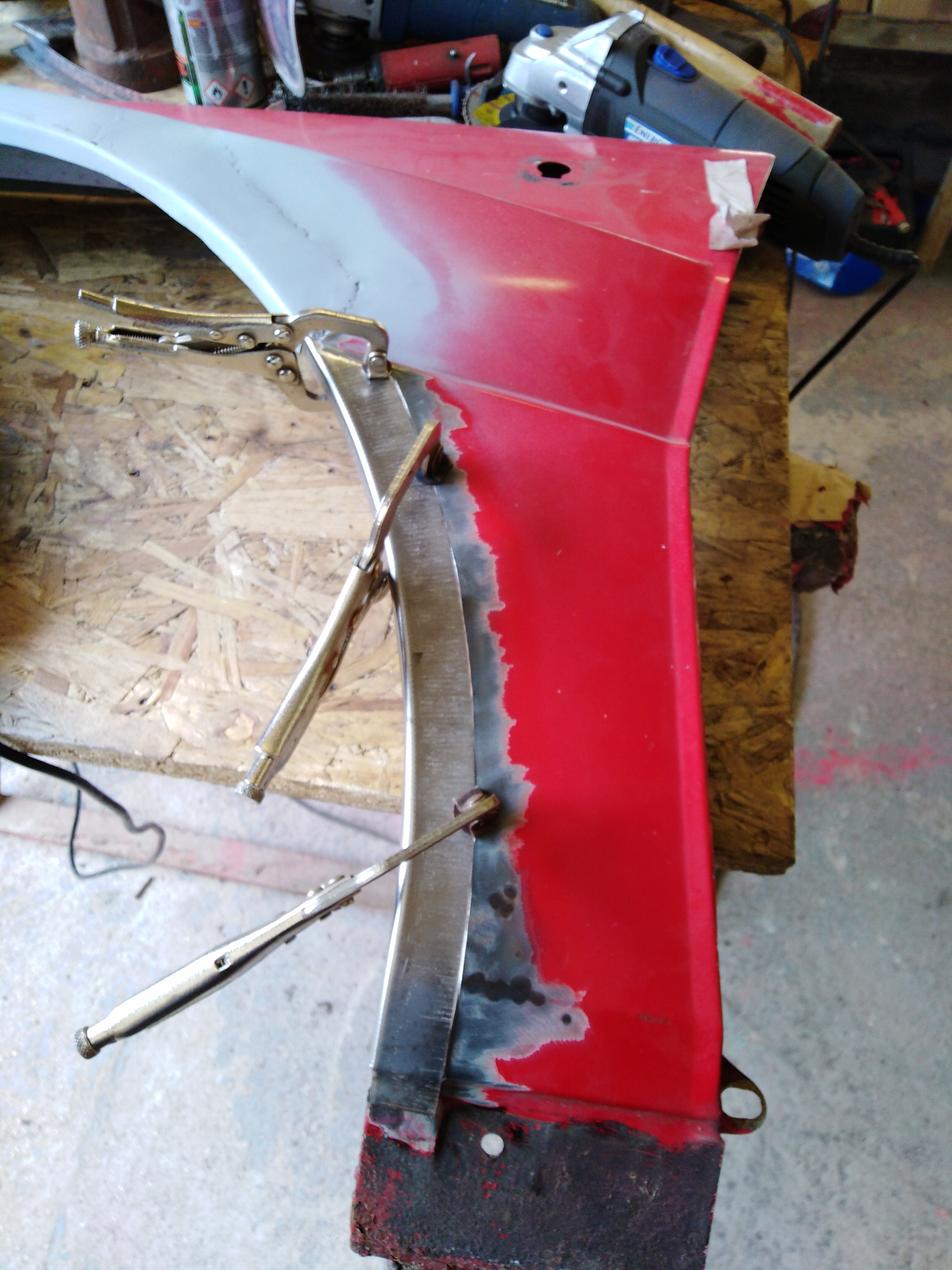

This patch had curves in all directions and folds that needed to be anything but straight, wasn't perfect but close enough.

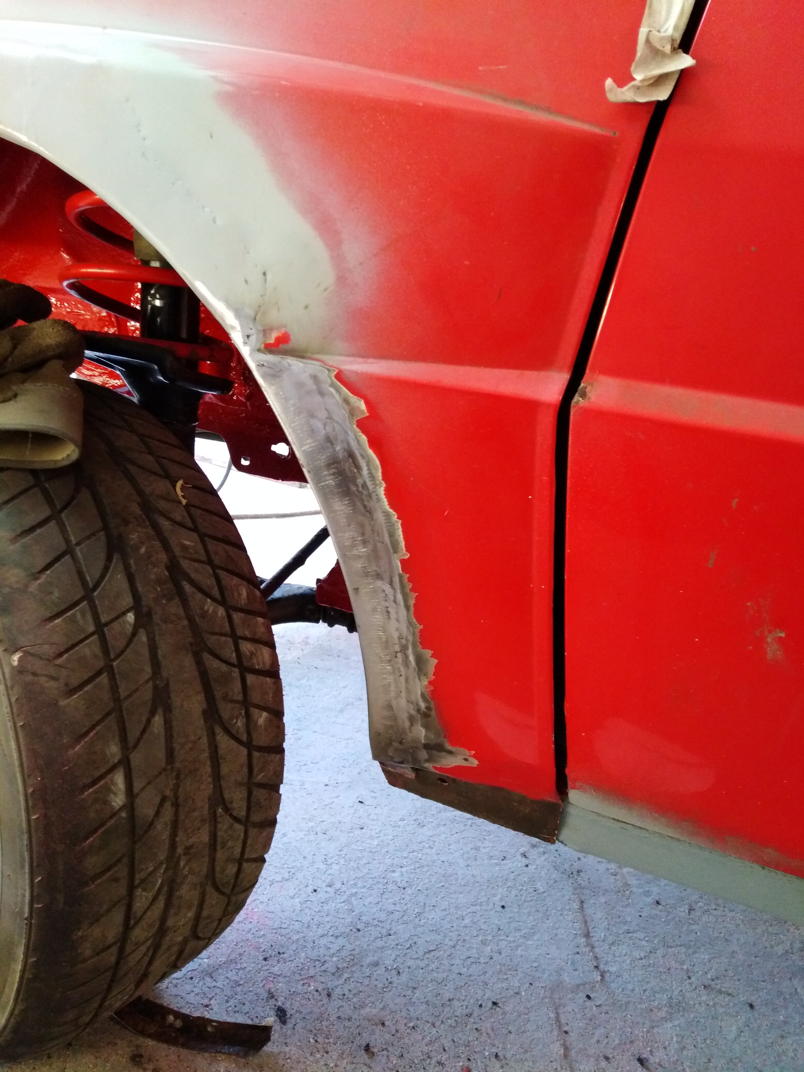

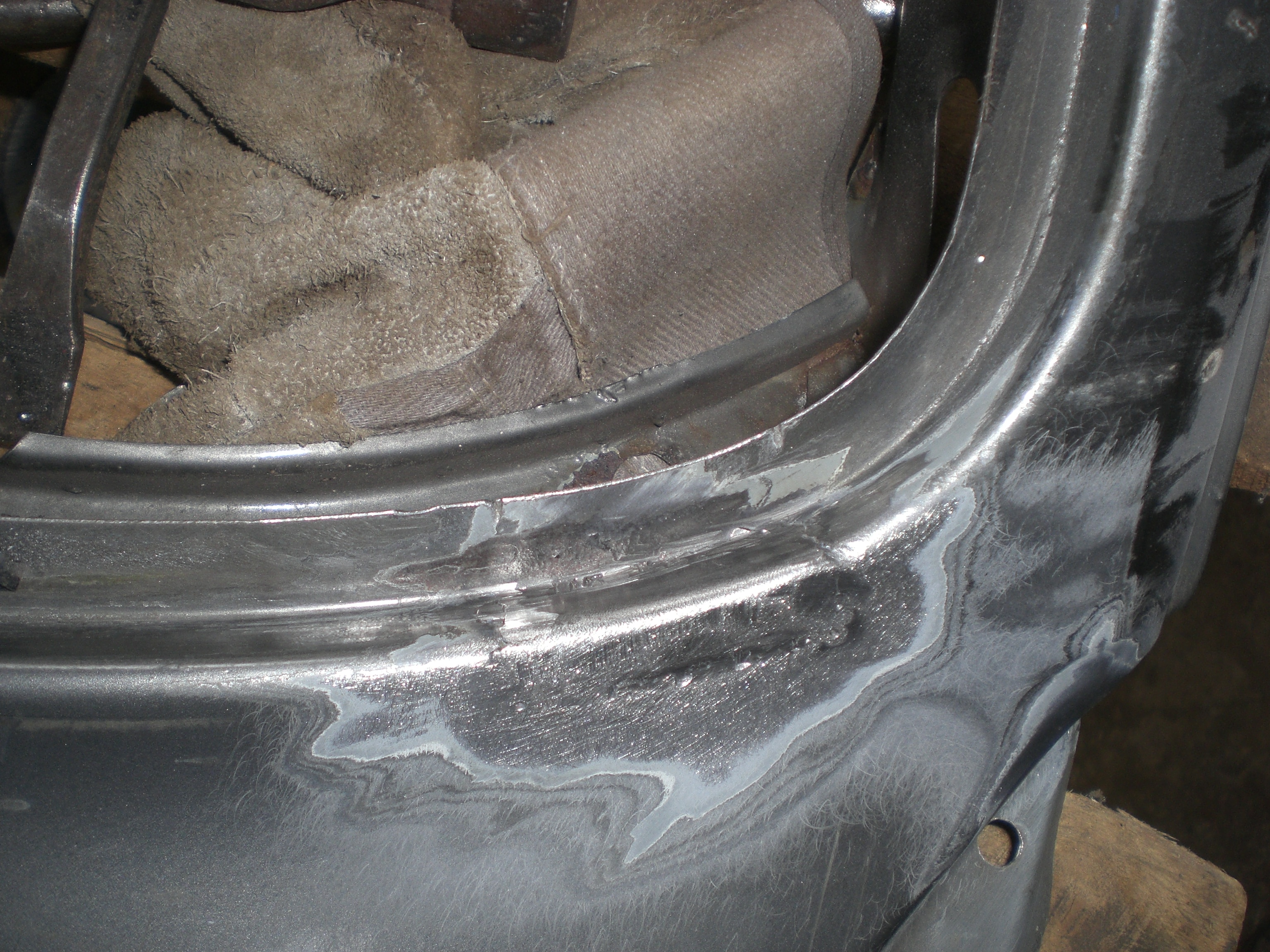

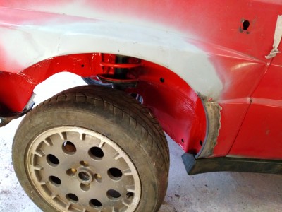

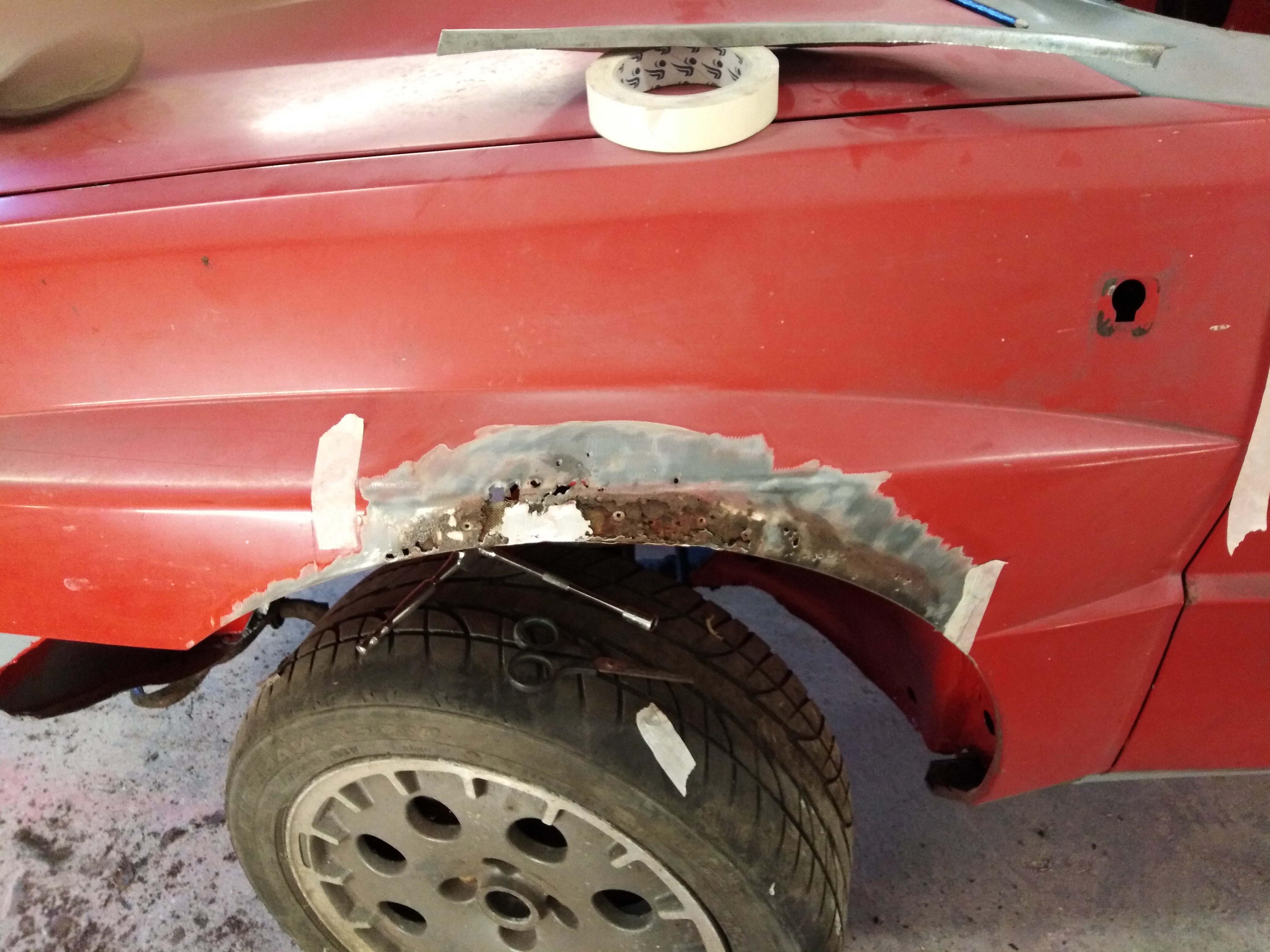

The lower section of the arch had some heavy rust pitting on the inside, nothing breaking through on the outside but worth the effort to chop out at this stage...
Butt welded repair again so small wide clamps to hold in place. You have to take greater care cutting and shaping the repairs this way but it pays off in the end.
Welded in and smoothed off, this one went in well so will need minimal filler.
The bottom edge where it will sit behind the sill cover was too rough to save so a new one made up and welded on
This part though it sits behind the sill cover you do have to make sure it sits at the right angle to follow the sill cover...

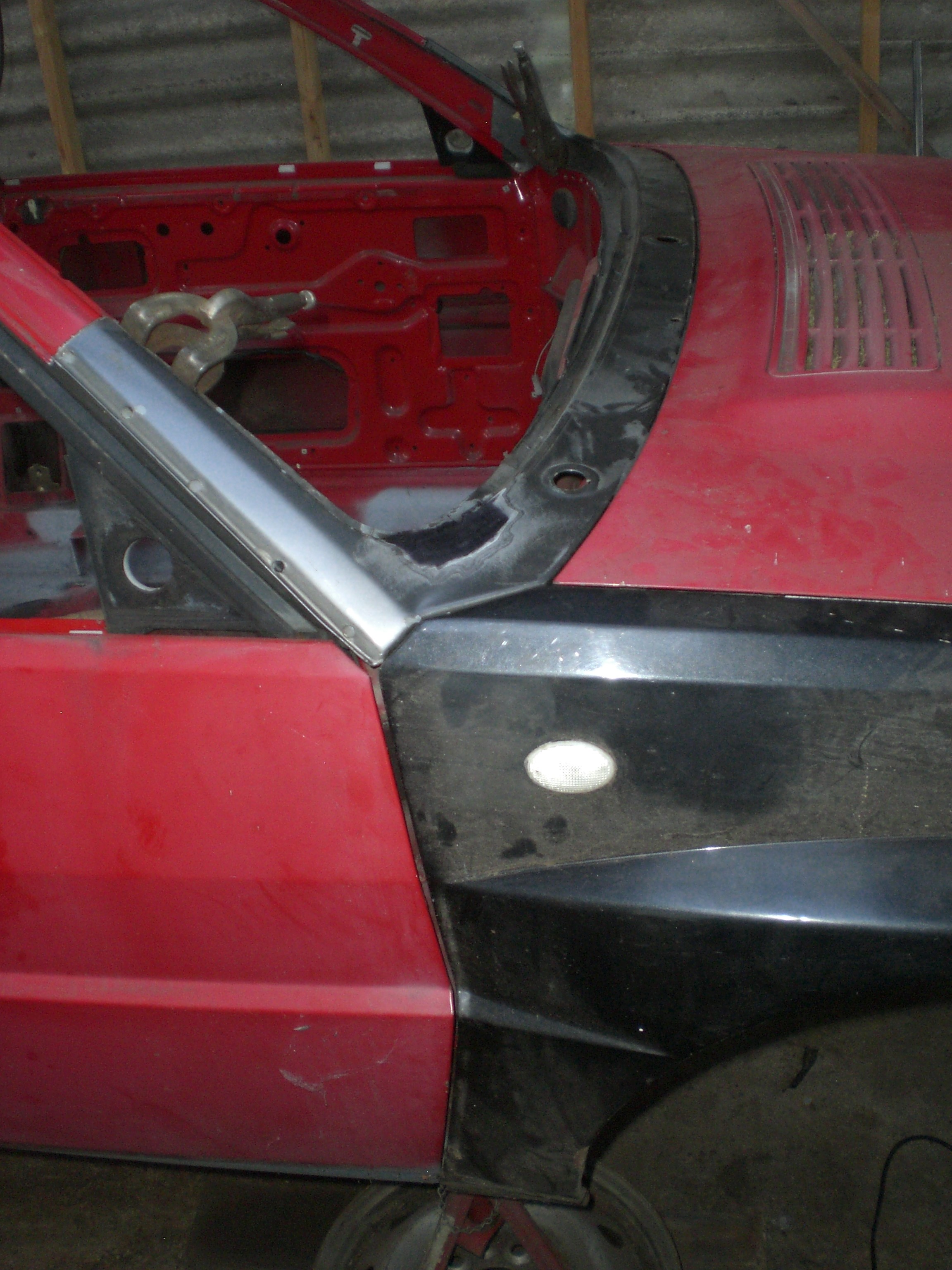

The "new" drivers side wing wasn't half as bad, apart from a few dents it just needed the same repairs to the bottom edge that sits behind the sill cover..

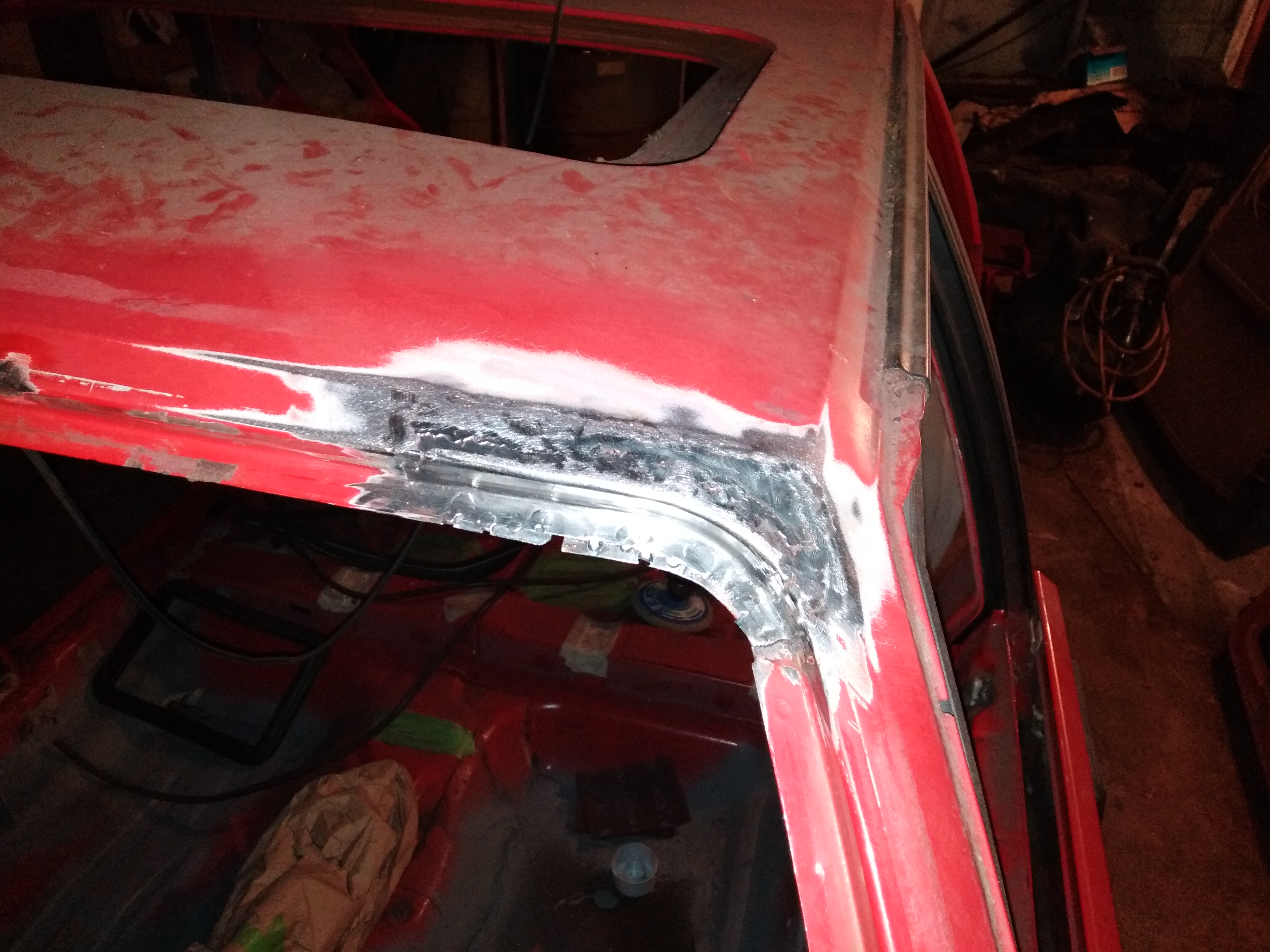

The rear edge of the roof plus a bit on the front edge of the roof just need repairs now then the repairs with the welder are hopefully done.....saying that though, I did spot a bit on one front door tonight....haven't looked too hard at the front doors yet either...or the hatch! Oh yes, I remember now, that needs repairs!!!!

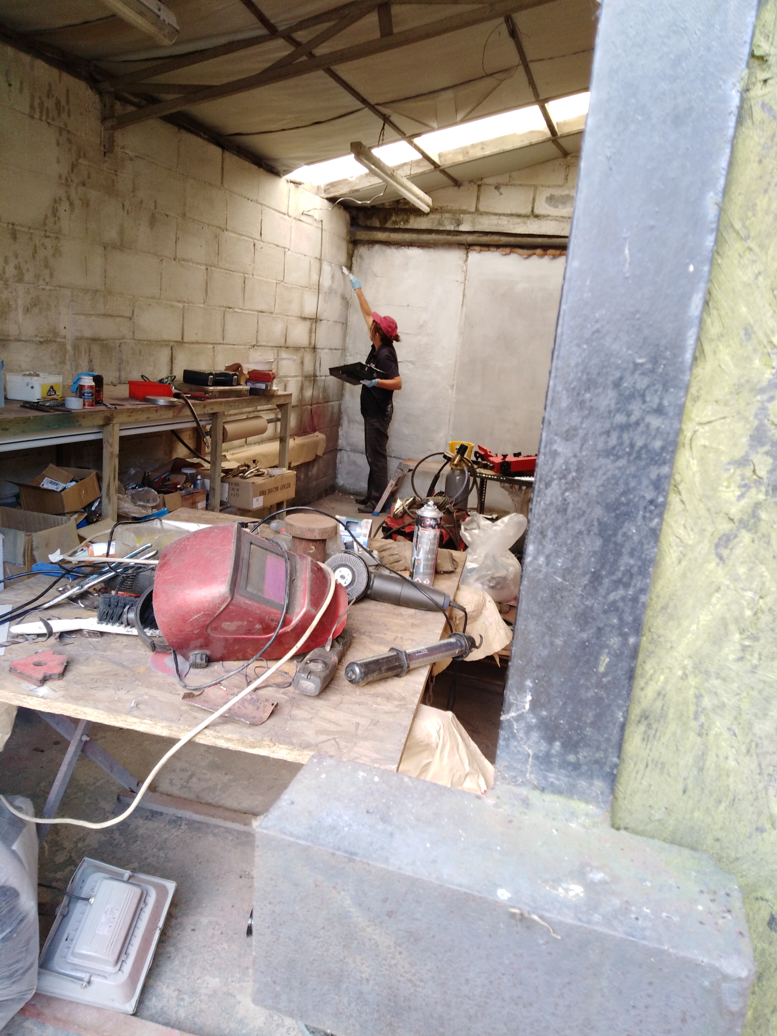

Had the day set aside to paint the workshop walls to make the most of the new lights so didn't think making a load of dust was a good diea!
Got the staff in for the job :)
Mrs much better at this sort of painting than me ;)
