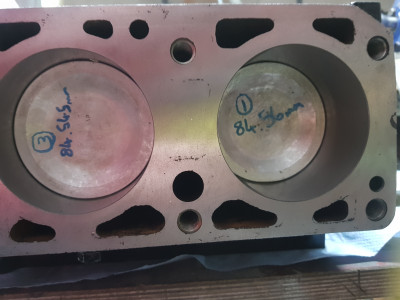

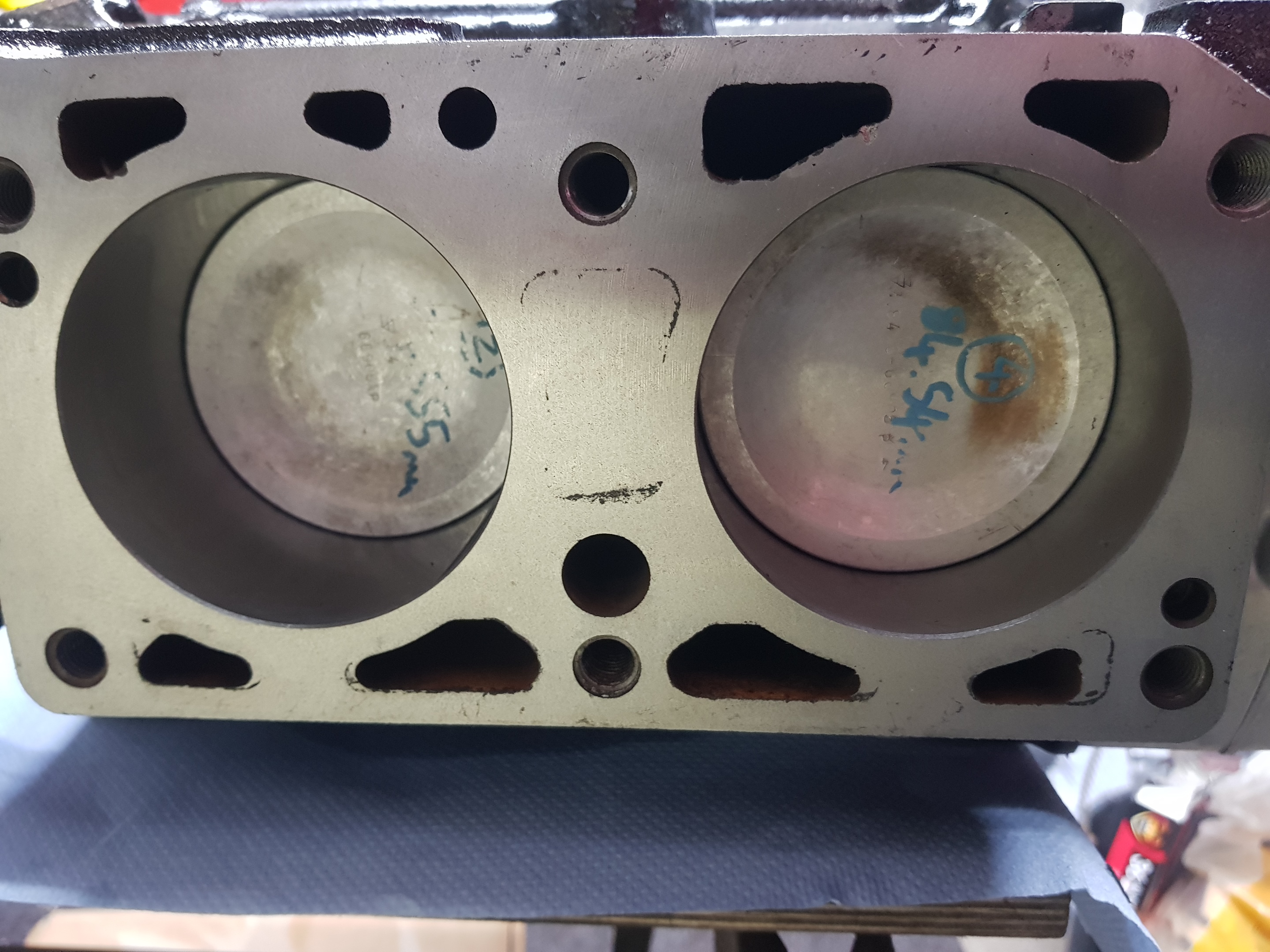

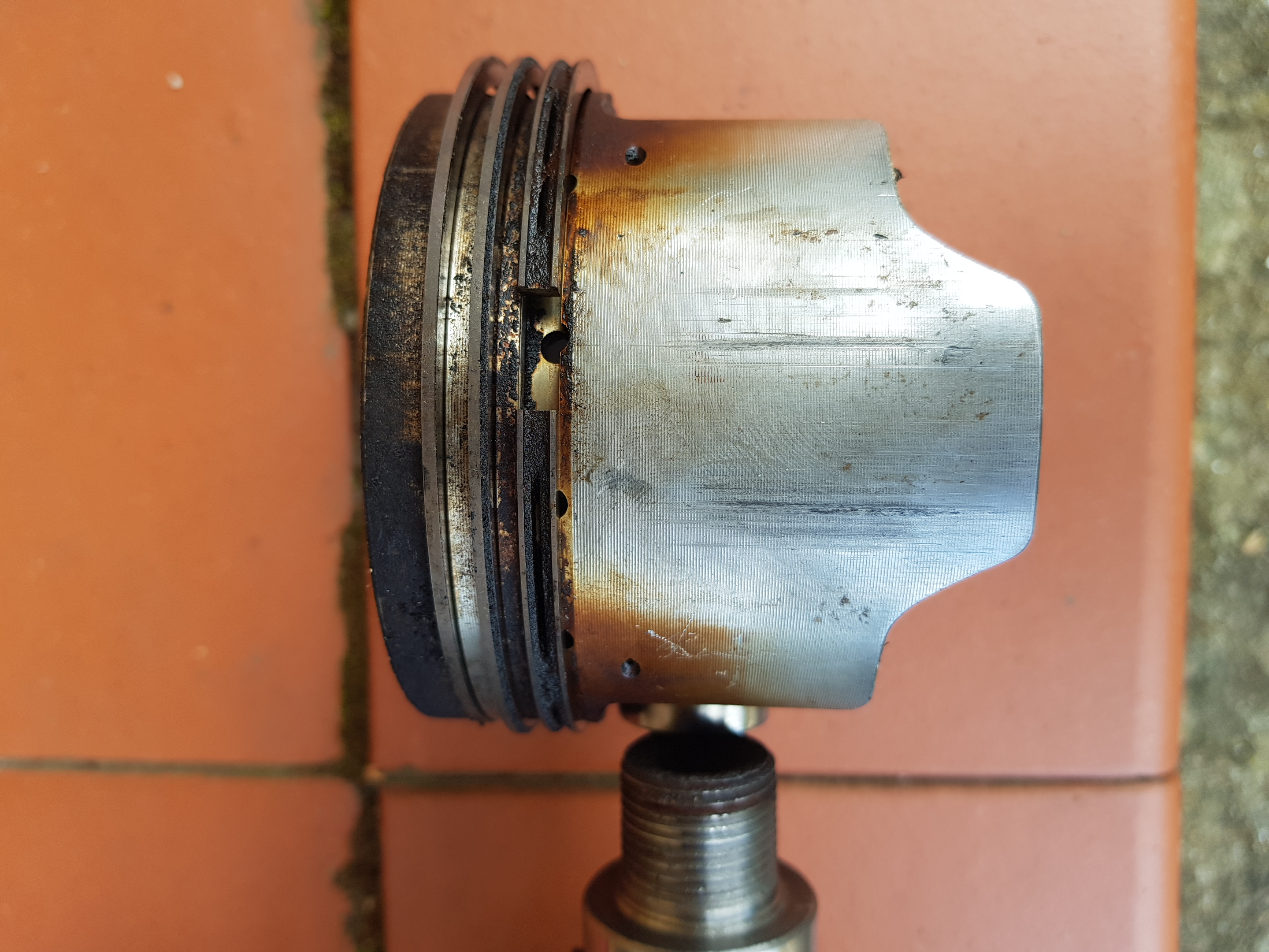

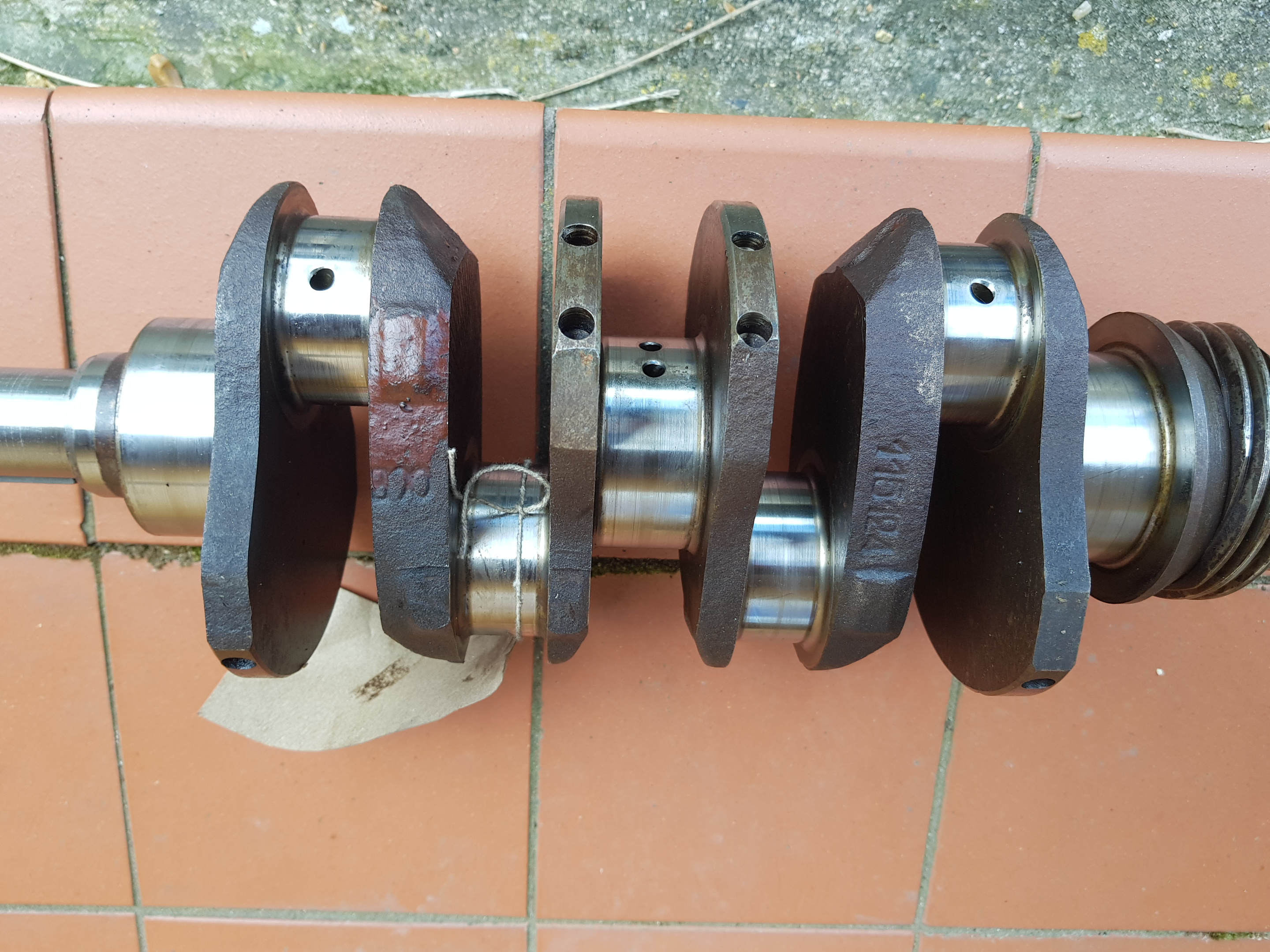

In other news, here is a picture of the crankshaft & the rear main journal. Two of the pistons are scored on one side as per picture, might be useable with new rings. The Gudgeon pins are an interference fit in the pistons & I can't see any wear.
The conrod little ends are allegedly slightly worn, but I don't know what that means. Before I scrap these items, they are free to a good home. Collection preferred esp the crank due weight. I'll also list in the parts for sale section.

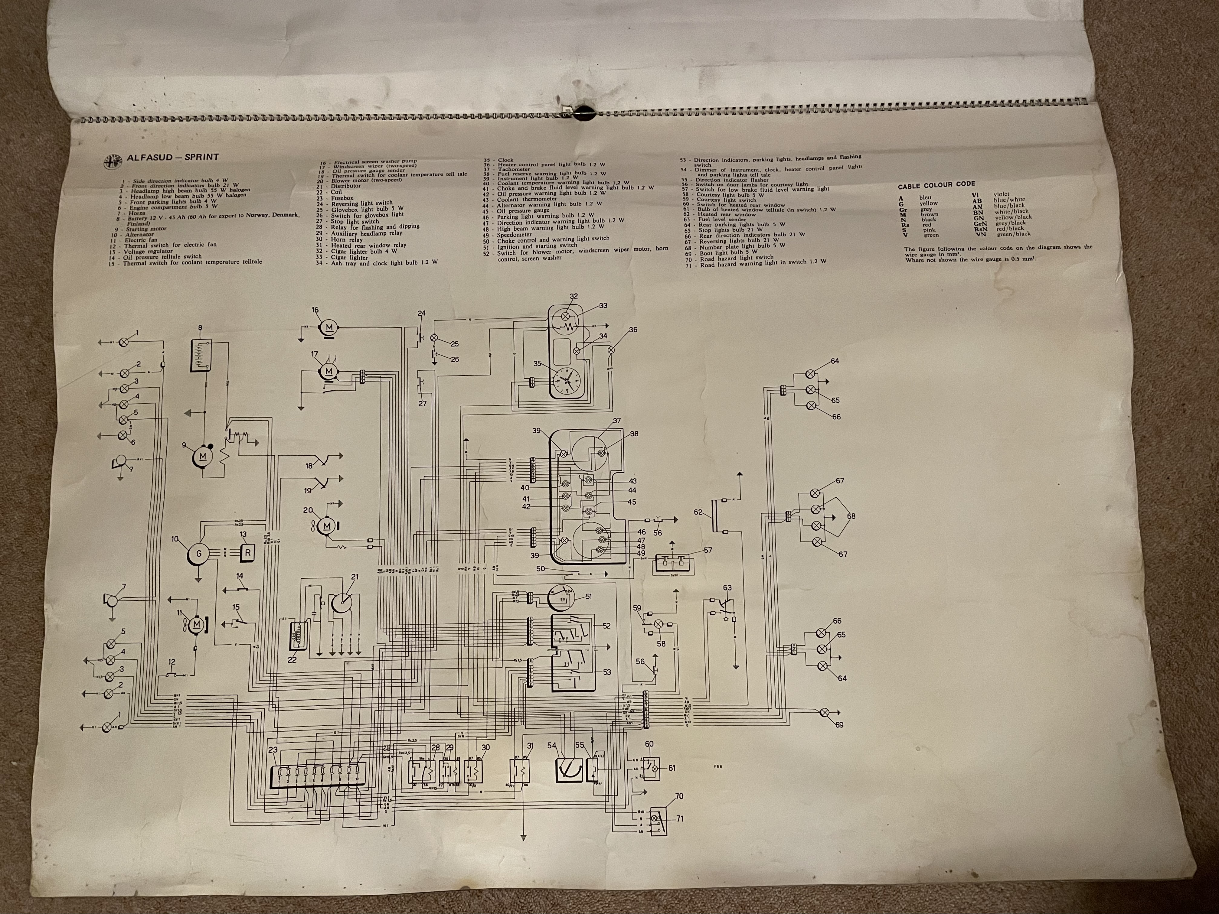

If anyone is watching, I'm hoping to restart this project after Christmas. Seats have gone away for refurb & I've nearly finished sorting out the wiring which previous owners have modified & for which obviously I have no info.
looloosud1984
Posts: 75
Re: SPRINT RESURRECTION
Post by looloosud1984 »
I have original dealer wiring diagrams but will have to check for sprint variant but Tbh I don’t remember the sprint loom being too different from TI’s
looloosud1984
Posts: 75
These may help
Alfaoldgit
Posts: 197
Location: Lewes, East Sussex
Post by Alfaoldgit »
Thanks for that. I haven't identified relay 28 yet. Doesn't help that the relay cases are corroded, so the only thing to do is pop the back off the fuse box & find it by wire colours. There are two "bonus" relays, one installed at import for the rear fog lamps, the other a lash up by someone, function unclear as the switching supply is off another relay in the fusebox. No extra switch on the dash for driving lights etc. They earthed it on the washer pump :lol: with 2mm red cable!

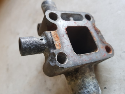

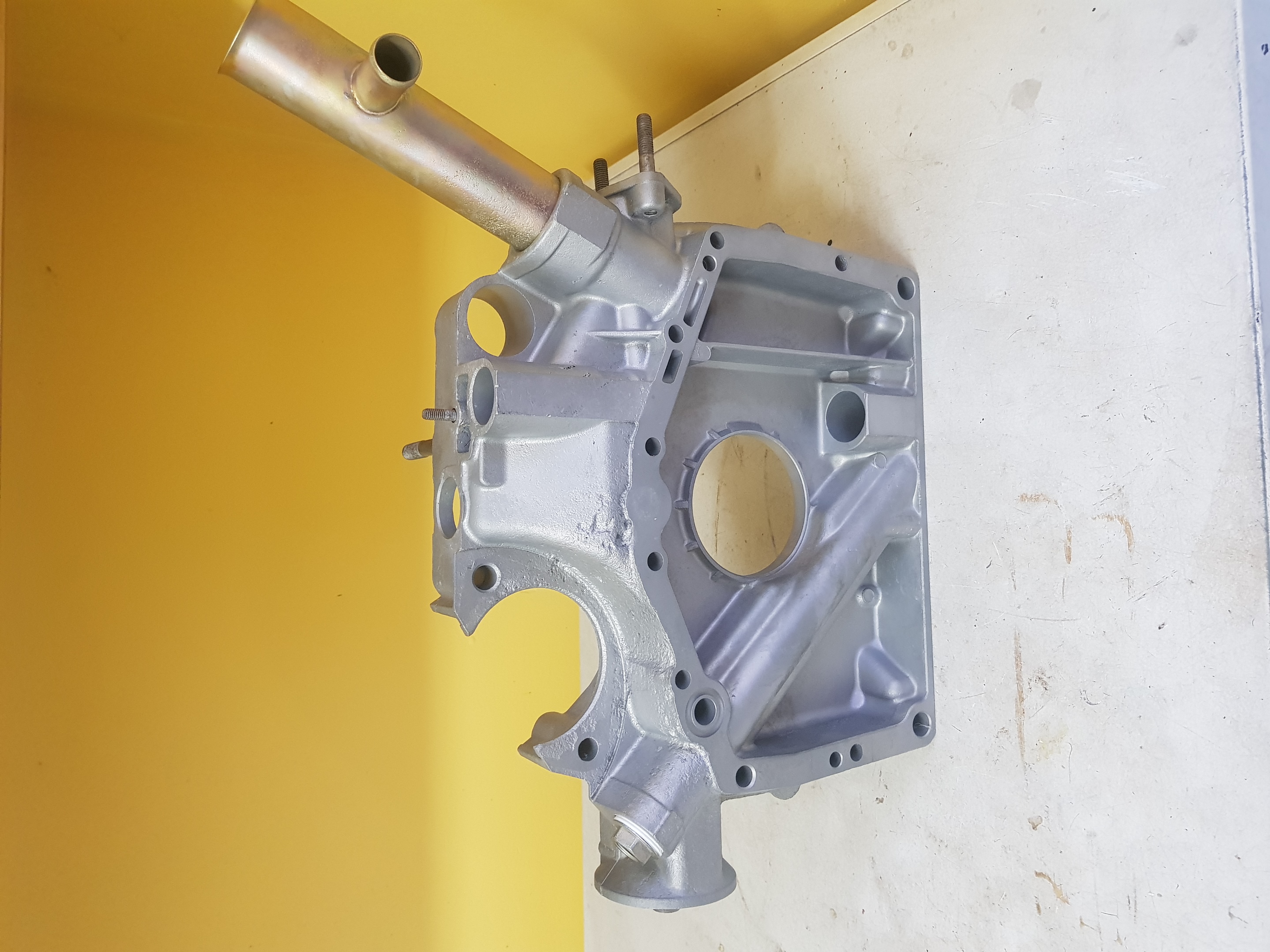

In the meantime, the very first part of the engine rebuild - installation of the oil fill pipe in the rear cover. Used the oven while domestic management was out. 200C and a few light taps with a hammer. Oil px switch adapter fitted too. Hate RTV, used thread tape to seal it. Pictures rotated for some reason :evil:

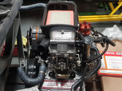

Pics of engine as received from AMS for those interested in such things :lol:

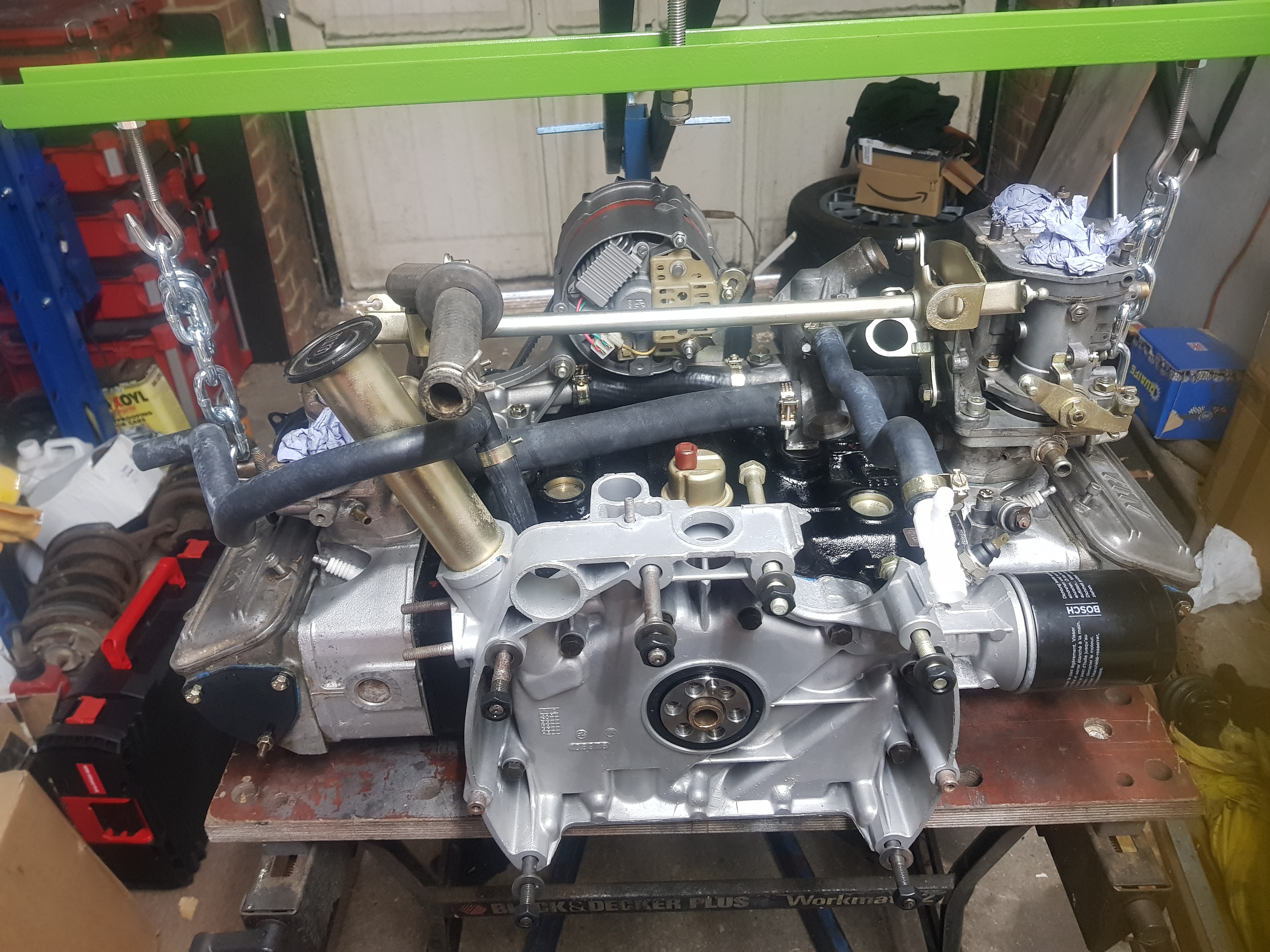

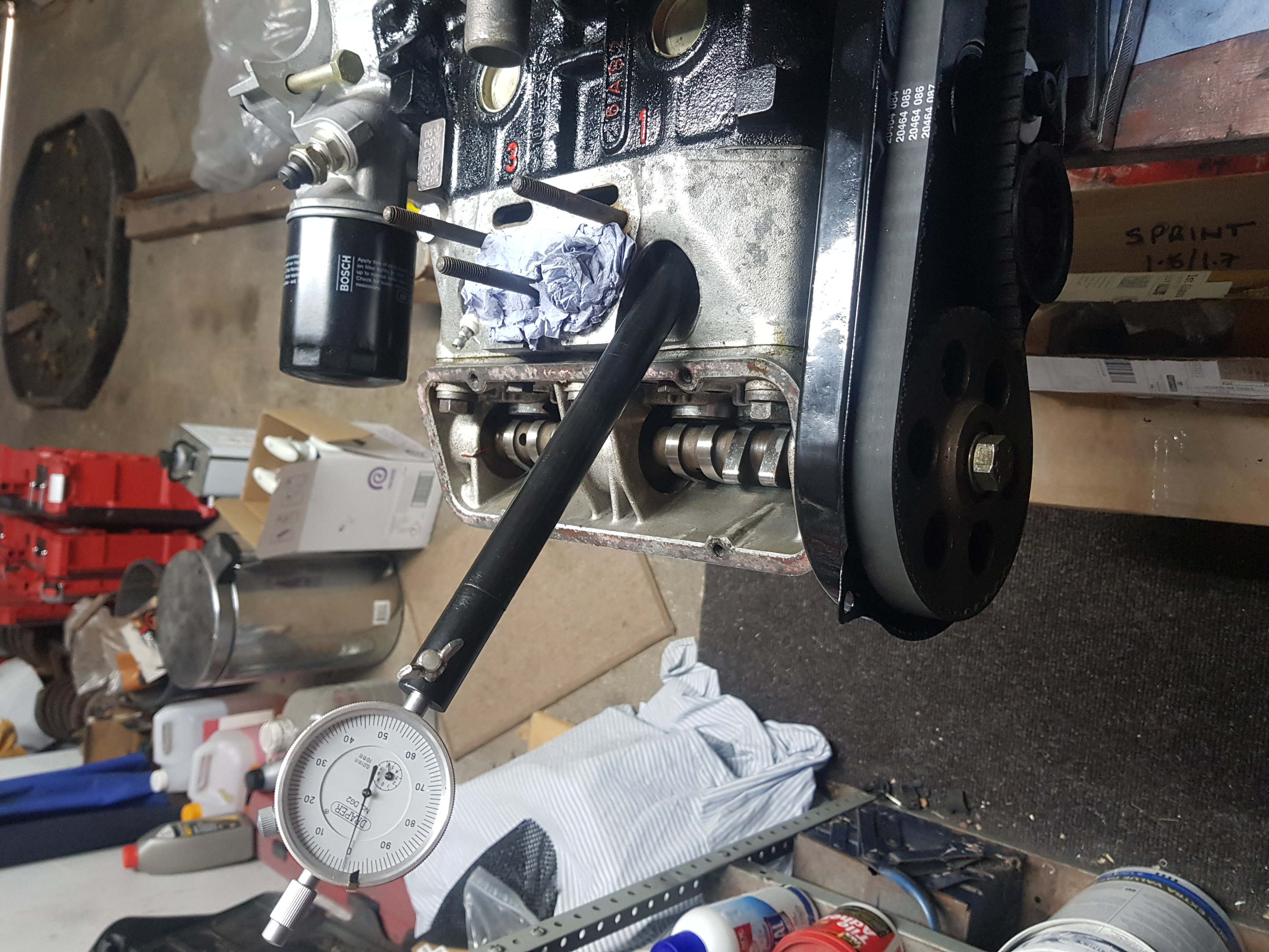

Engine progressing. Timing is spot on, belts tensioned. Couldn't find my valve adjustment tool (well I last used it 41 years ago & moved house since) so I bought a mini set of keys from Halfords for a fiver and "modified" the 5mm one. In the meantime here's yet another picture turned on its side :evil:

Engine & gearbox awaiting installation, after wiring has been installed.
