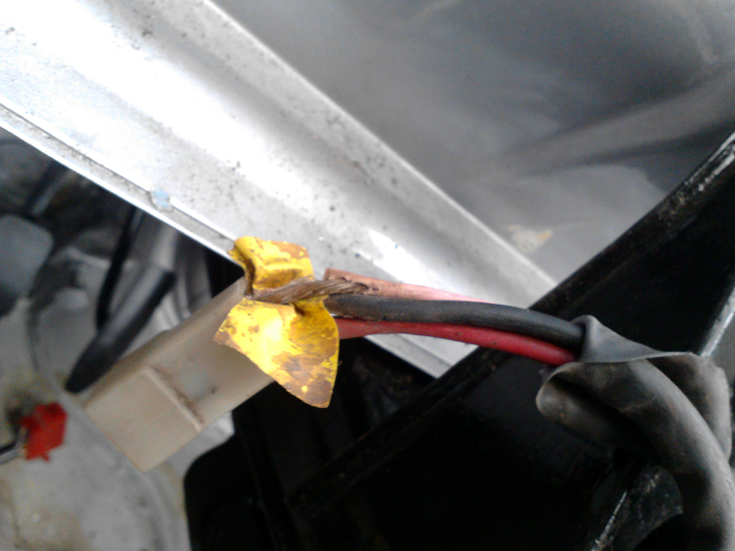

tested the rad fan by earthing the fan switch....nothing :?
surely something hadn't gone wrong? i'd tested all this while the loom was in the shed..
checked the connections at the relay and had no continuity between the relay and motor, or switch :roll:
bloody odd that, bugger. loom will have to be dragged out..
bit of head scratching before i realsied i was looiking at the wrong relay!
when i tested the correct relay, things looked better. once i'd turned the ignition on.....numpty! :D
fitted the new igntion coil and a choke cable, time to try it
glad to say that the car started a treat. doesn't sound bad at all, settling in nicely 8-)
