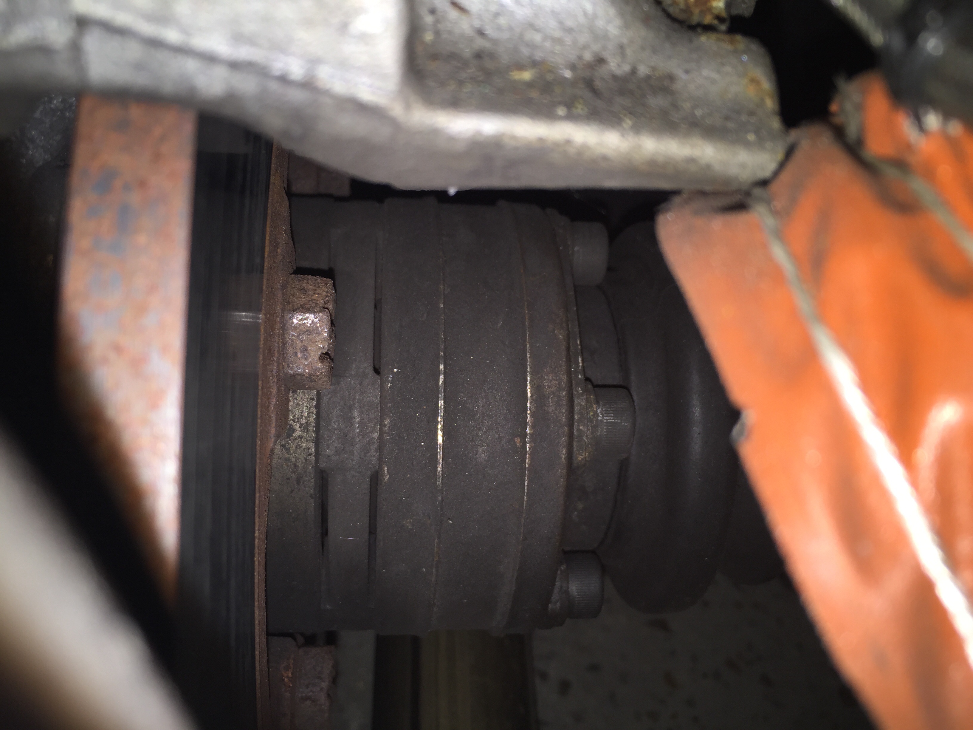

Just one more example which is different.
S3, 1.2ti gearbox, early discs. It has a spacer ring and a thin spidery spacer instead of the wide spidery spacer.
[attachment=0]image.jpg[/attachment

Pretty much everything has been said, but to add to the confirmation, I used :
Big spacer with early 4 lug / stud disc
Smaller spacer with later 6 hole solid disc
The gearbox made no difference to the above, it's the disc - solid or not solid.
And finally I used a small spacer when converting to outboard discs and using a 33 driveshaft.

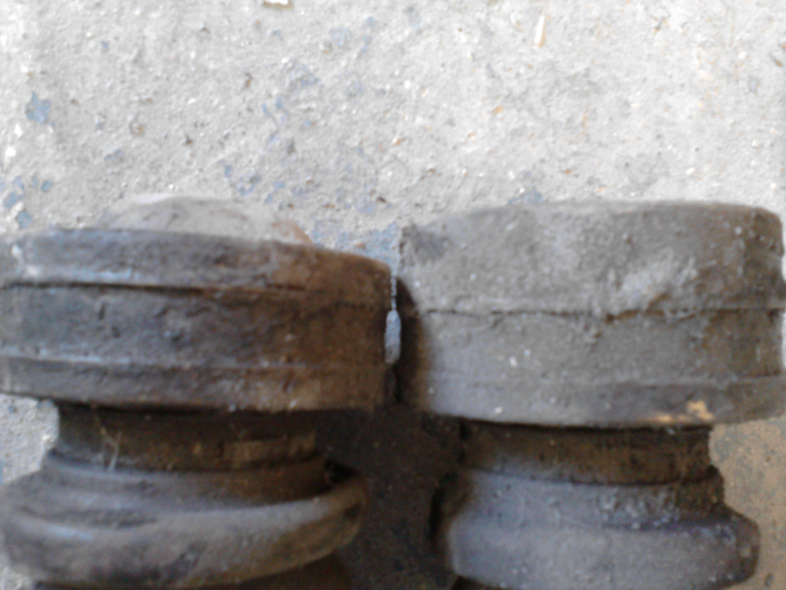

KevJTD wrote:all good info guys.
i have also seen inner CV joints with a spacer inside the end cap.....just to throw a spanner in the works :D
i have a dozen or so used shafts in my unit, one day i'll get around to inspecting them to find out the differences.
said i'd have a look when i got a minute....finally remembered tonight whilst sorting one for junior ;)
rest of what's left will be going shrews way so if anyone needs one then he's your man
