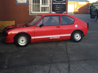

Good Evening All,
Dropped the Sud at John clarksons yesterday, he,s tasked
with tuning the engine and setting up the suspension
including corner weighting the car, fingers crossed regards
power to weight ratio, some pic below,
Liam
Liam

Finally got the sud out for testing at Oulton Park Saturday,
A bit slippy on track, car performed generally well, gear linkage snapped
late in the afternoon, back to the drawing board on the quick shift, met a chap called Marvin,
ex mechanic, worked on the Peter Cates alfasud back in the day,
hes now a photographer took a few nice pics of my car.link below.
https://www.flickr.com/photos/80988790@ ... 487568683/
Liam

Hi Guys,
Thanks for the comments, really pleased with the car generally,
Yes Kev, c pillar vents to be added in time, still not sure about
the front spolier, comtemplating full trofeo arches. Brakes were
pretty rubbish, got better after bias adjustment, looking at wilwood
dynalite calipers for the front, exhaust noisy due to all the quick
release joints on the manifold, just made noise testing at 103db,
hopefully Shrew can work his magic.
Liam
