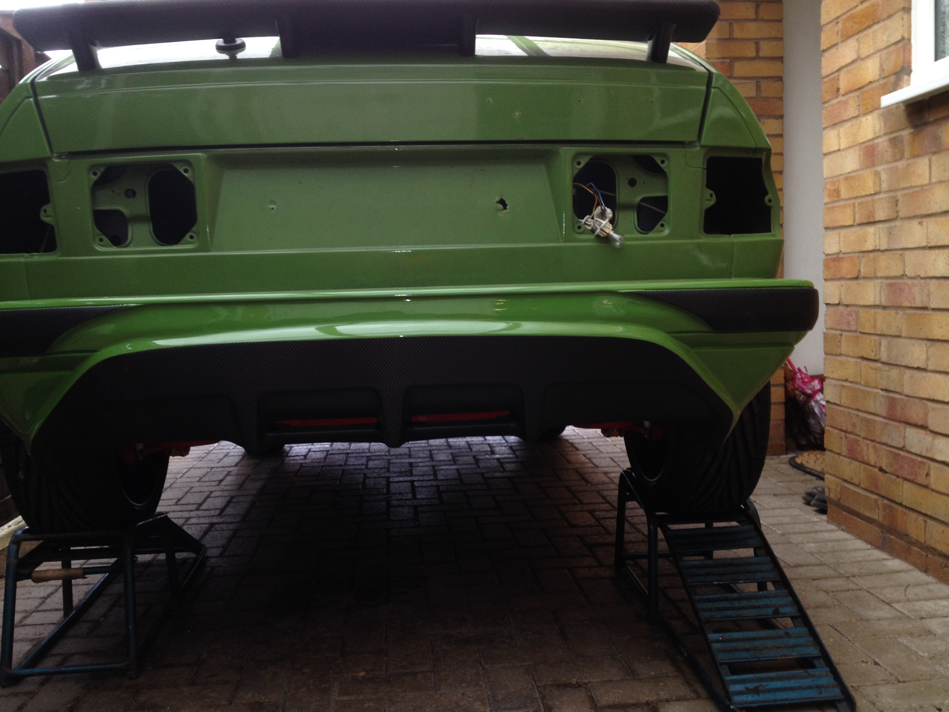

Pic of rear spoiler - sorry took so long to post it Kev

Decided to take another pic of the rear diffuser

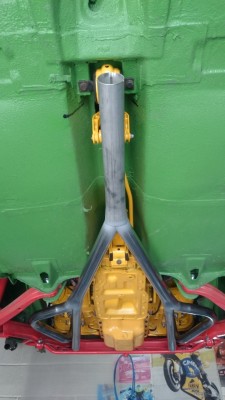

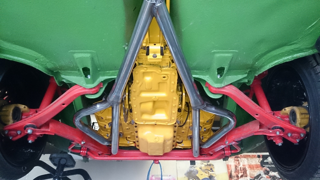

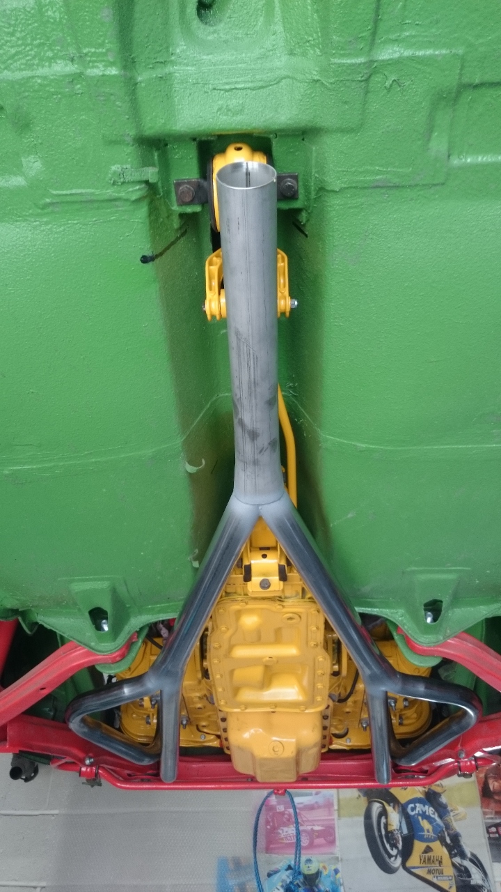

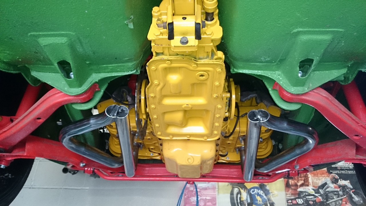

I'm sure H is gagging to report a bit on todays progress and work too, but seeing as he's likely still driving home, i'll dive in first!
So it was a "crack'o sparrers fart!" kinda day for me, trailering the Sud over to the wayne and the exhaust workshop for us to do a complete front to back custom manifold and system on FMJ.
lt needs to be an early start doing so much, or it becomes a very late finish, so the moment i arrived, it was onto the ramp with her and start making the equal length primaries up.
I tailored the lengths to suit an 8v, with fast road cams, so not as short as could be in a race revvy 16v, and decent secondaries, which should all help to free her up whilst holding onto the bottom and mid range characteristics of the 8v motors.

and then manifold closed off with the final third pipe up to the silencer joint
