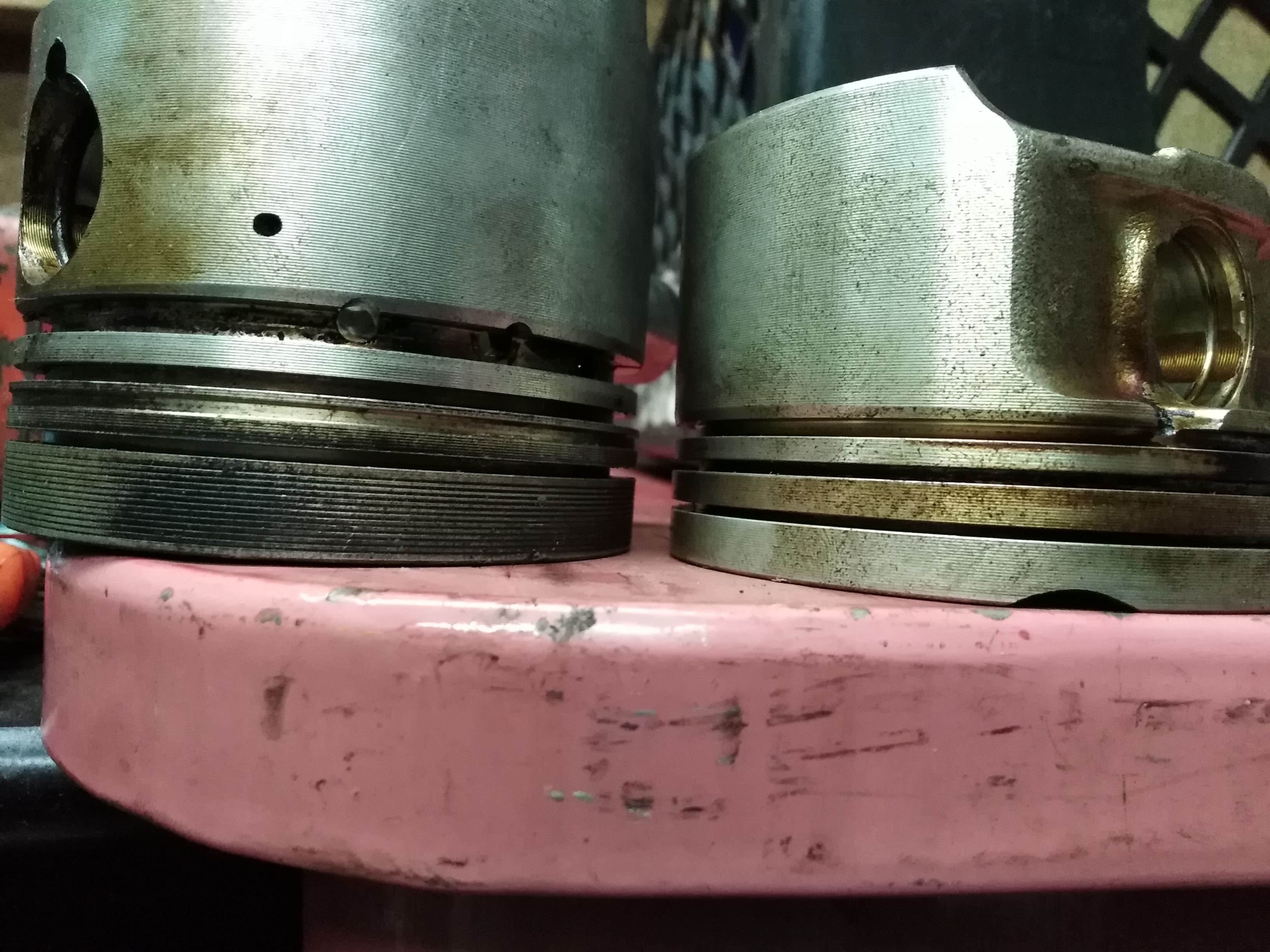

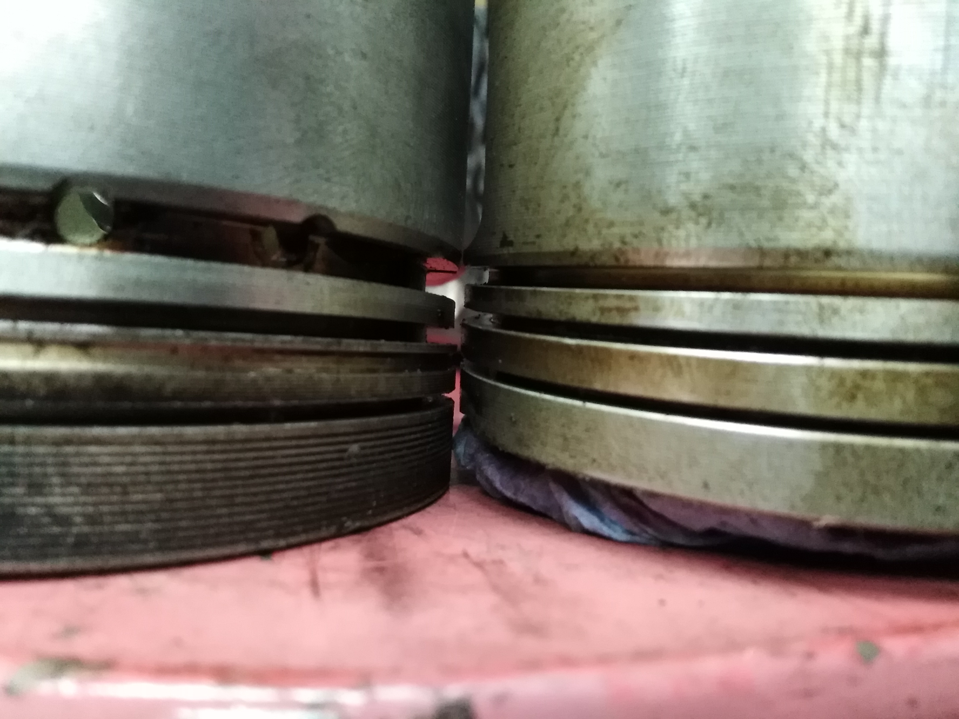

From lookinmg at the piston rings I suspect they went too far in minimising friction losses, they are incredibly small compared to anything I've seen before.
I'll take a comparison pic with an integrale piston next week to show what I mean.
I guess that with the rings, and in particular the oil scraper rings they are too thin to properly clean the bores and thus oil gets left behind.
Just my theory.
Just my theory.

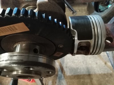

Re: GTV ts

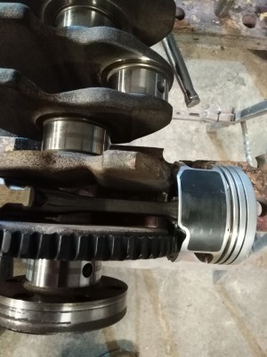

As promised, a comparison picture between an integrale piston and the GTV, as you can see the rings are much wider on the integrale in particular the oil control ring which is 4mm on the integrale and only 2mm on the GTV.
Also there are no oil holes in the piston ring groove so not only is the capacity to scrape oil half, there is nowhere for the oil to go! There is a drop off at the gudgeon pin but no substitute for a tried and trusted method.

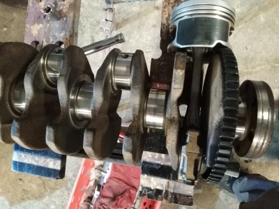

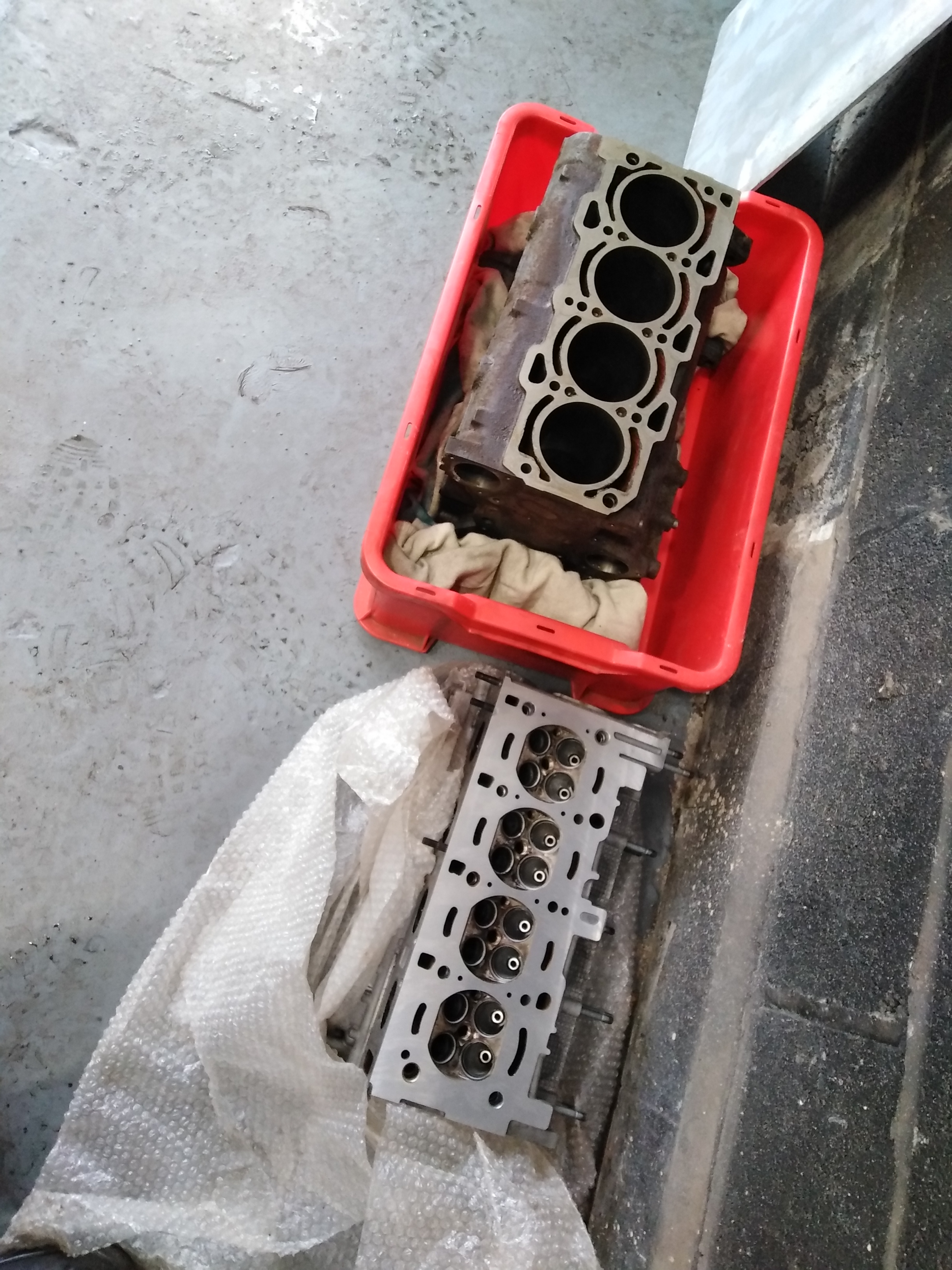

The original block is stripped and away at the local machine shop with the head having a light skim to the face to ensure a nice seal.
Replacement crankshaft cleaned and ready for fitting.
I have a set of pistons from the donor spares engine that I'll be using hopefully, they have wider rings (3mm oil control ring) and drain holes. They also have Teflon coating on the skirts. Not sure if they are from an upgraded design used to combat the oil usage issues, they are Alfa branded ones and rings are avaialbe for them, so are OE spec.
Everything to hand now to start the rebuild so once I have the block back I'll hone it and start the rebuild.

Interesting about the TS pistons.
Seems like they downgraded the spec from CF1 to CF2 by fitting different pistons?
Re: GTV ts

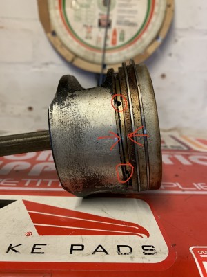

Evening Kev. As I’m having a clean up i had a look at the pistons out of the original engine from the spider. As you can see these have oil ring drain holes. I can confirm These pistons are from a 99 CF2.
Re: GTV ts
Now there's a thing.
The TS engine in the 145 was a peach and used hardly any oil, a CF1 motor.
156's I've had in the past have all liked a drop and were the newer cars, CF2 or CF3 motors I guess?
Could Alfa have cocked it up on the later engines?
My car is a CF2 indeed but a 2001 engine, a change of design between yours and mine?
Both size of rings were listed as being for mine, yet it had those smaller ring widths with no oil drain holes in the pistons.
The pistons in the picture (right side, integrale ones on the left) are the ones that came out. Also note that the skirt doesn't fully go around at the piston base. The ones I will be using are the same design as yours, but with the addition of the Teflon coating.

I did get the head and block back from the machine shop last week but have held off starting the rebuild, at least until I knew it would be needed!
The head was pretty much bang on, one pass at a thousand of an inch was enough.
The block however needed a few passes as one corner wasn't good enough, about 5 thou he said.
So shows it pays to have both done.

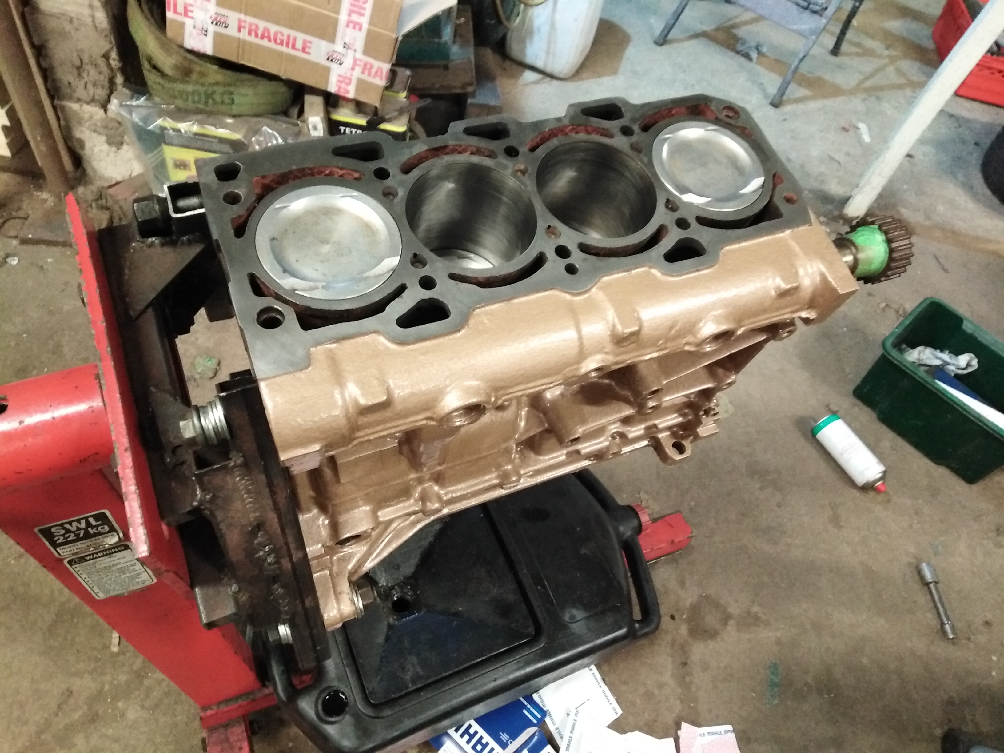

Yes, odd isn't it that the cast iron block was out of true. Guess the head could flex enough to follow the contour a bit but at least I know now I'm dealing with two flat surfaces!
Checking the bearing clearances with plastigauge it's obvious to see why the piston isn't uniformal at the base of the skirt, runs very close to the crank position sensor ring. Never realised how close the balance webs get on bdc either.
All good so crank fitted to the freshly painted block, new piston rings so starting to get on with it now I know I need it!

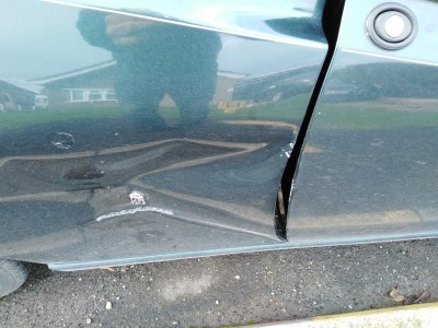

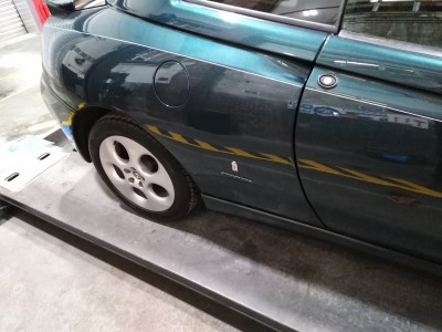

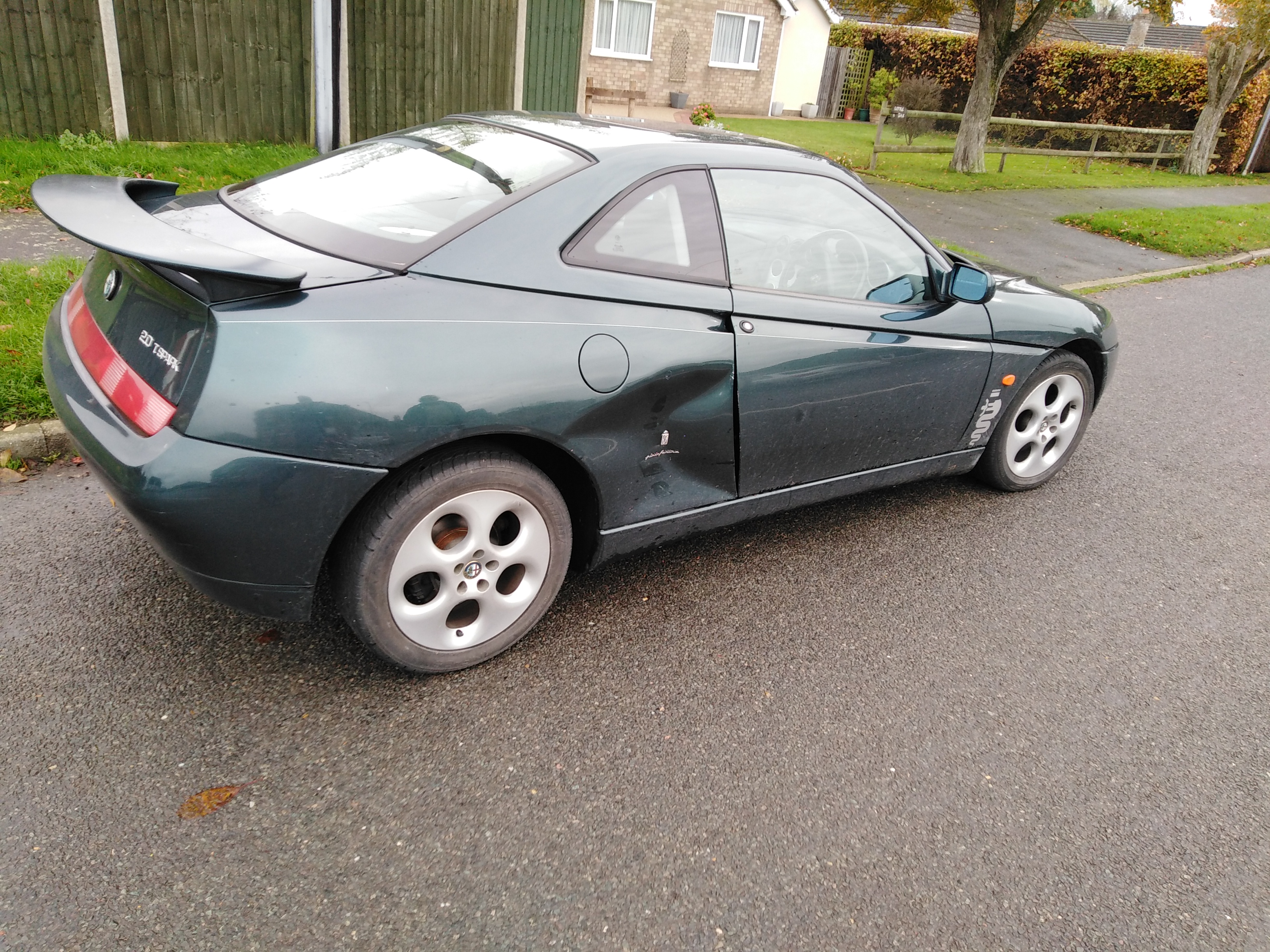

Along with the big ding in the rear quarter courtesy of the reversing kamikaze Renault of a few weeks ago I also asked the bodyshop to repaint the rear spoiler as it was all speckled with lacquer peel.

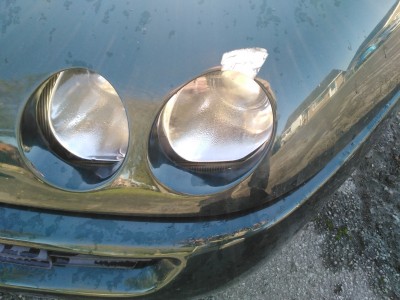

The bonnet though had a big chip out of it above the passenger headlight opening (plastic bonnet remember) and a couple of cracks at the base of the opening, probably from someone's enthusiastic closing at some point, or closing it down enthusiastically onto something that shouldn't have been there! Either way it needed repairing.

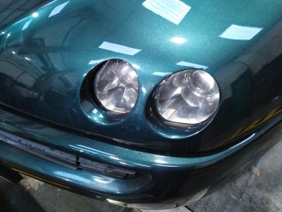

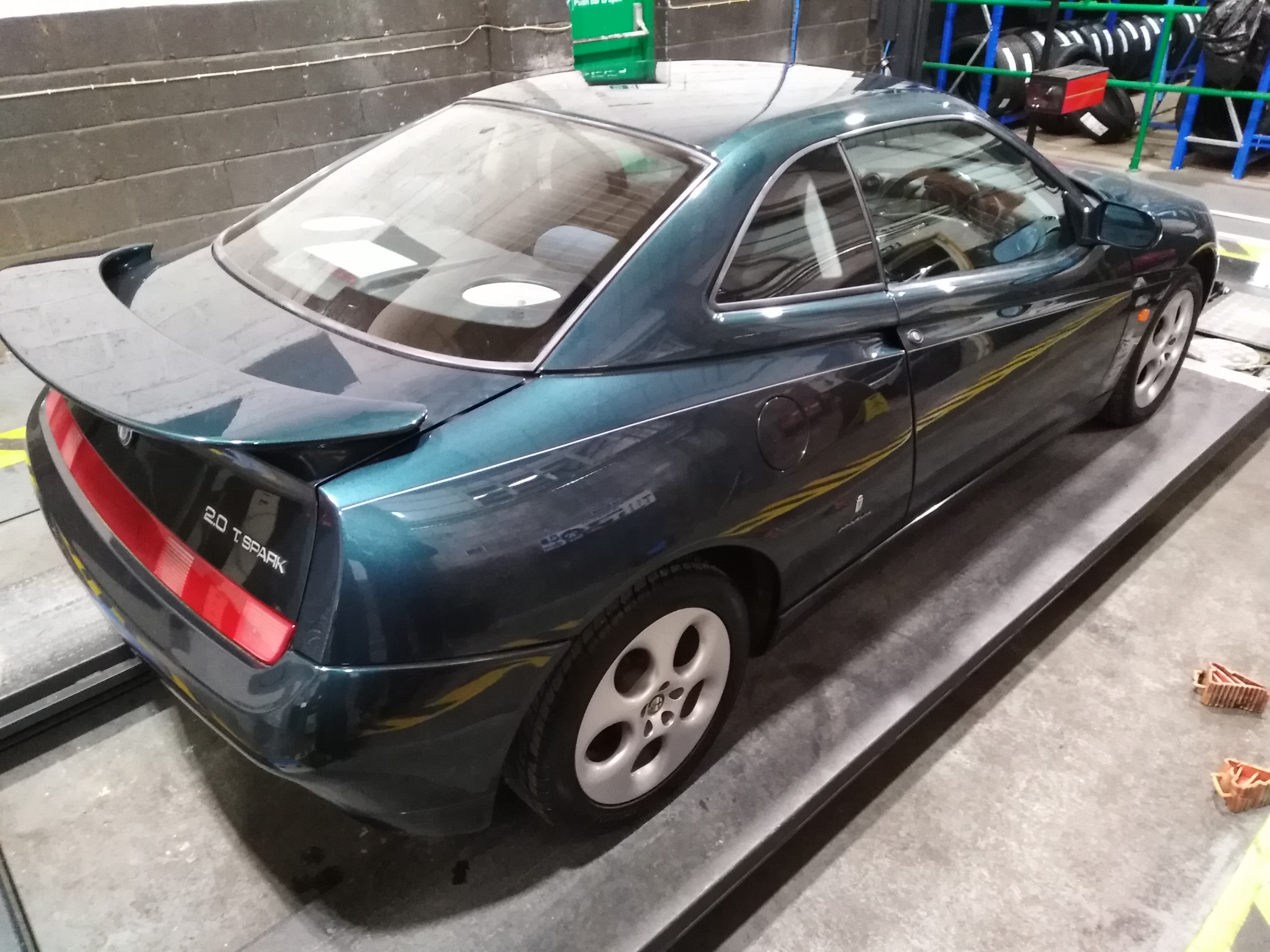

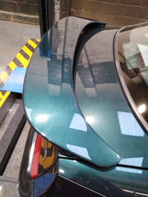

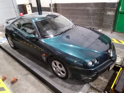

Today it came back looking of so fresh and way better than it has for years.
The bonnet repair is invisible, you just wouldn't know it had been done.

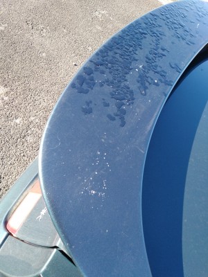

The rear spoiler too looks smashing.
Re: GTV ts

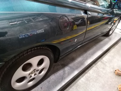

The accident damage though, again you'd be hard pressed to know anything had happened.
I've done a bit of painting but can hold my hands up that the professionals really are a step above.
Re: GTV ts
Overall I think the car looks incredibly better than it ever did, I even like the green colour now! Almost as a torquoise sheen to it, not nearly as dark a green as it looked now its all shiny.
My only regret is not instructing them to do more, the colour match on the bonnet edge to the passenger door isn't perfect in some lights, I should have asked them to blend it in even if that would bump the price up, but the shine on the bonnet now is superb as before it was fairly dull even after a good polish up in my hands.
Again, leave these specialist jobs to the specialists.
Chuffed with it now though, very presentable indeed. Also looks like they gave the wheels a tidy too, not a full paint up but they were more scuffed I'm sure, but maybe the rose tinted specs are fogging up!
