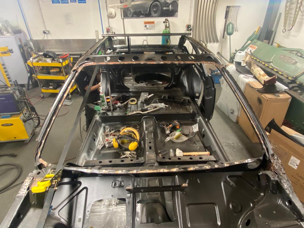

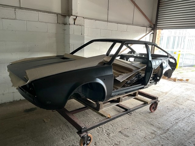

Hello folks (well, assuming anyone is reading this

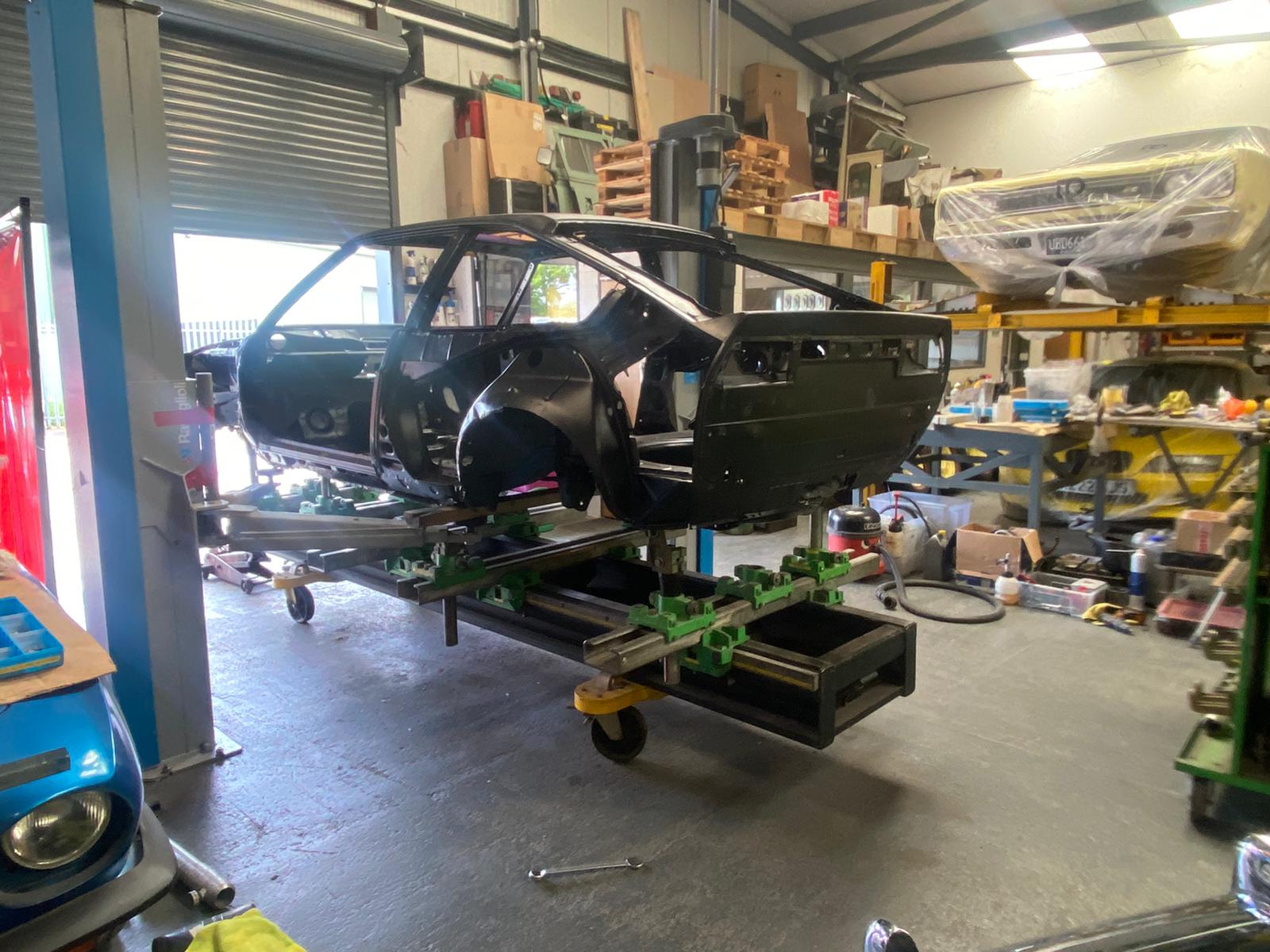

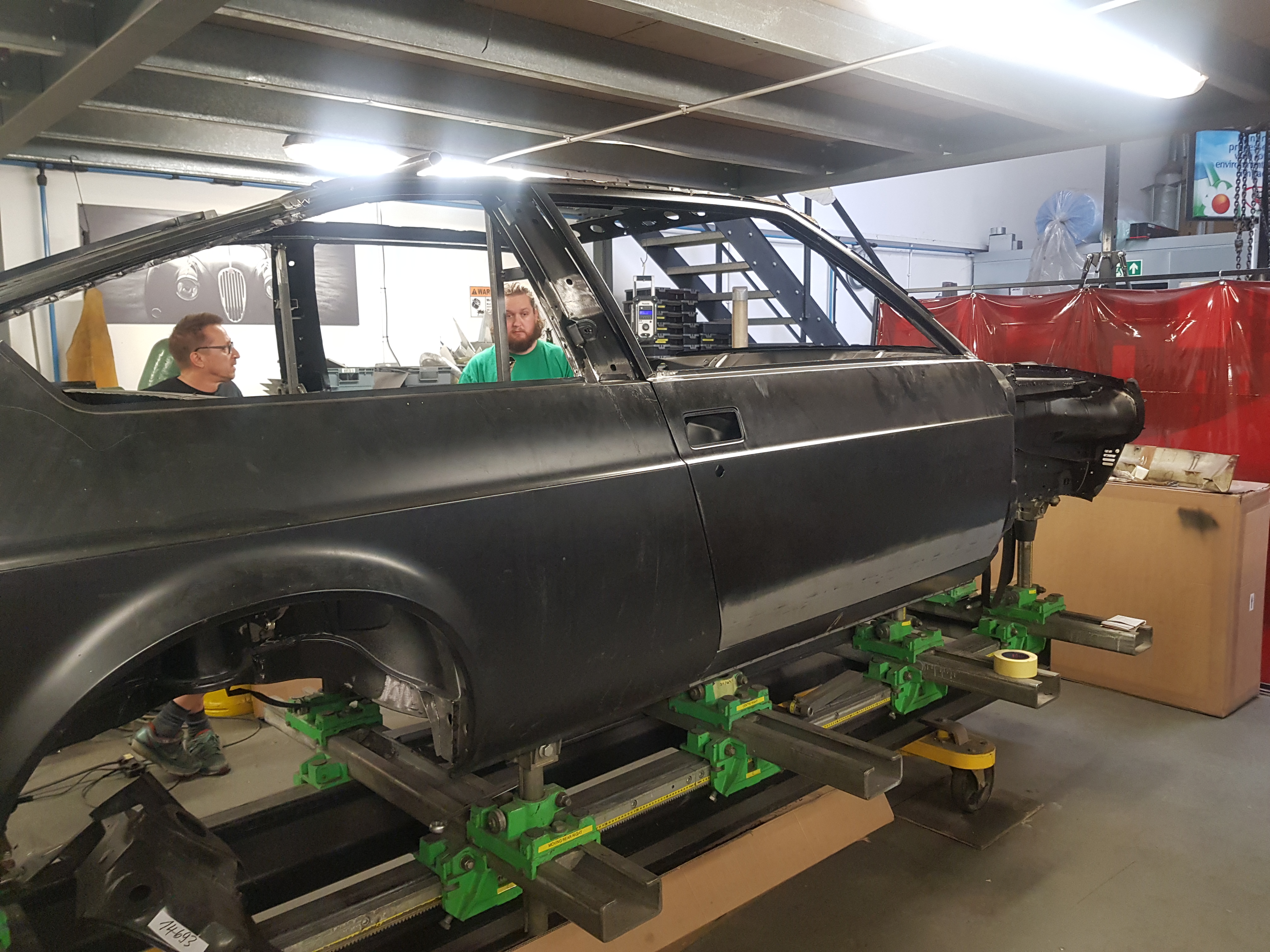

) Here is a picture of the shell after its dunking at Envirostip. You'll notice the rear 3/4 panels are gone, they were so bad that it was decided to lop them off before it went. The shell is now in an alignment jig at the body shop; I'm going over to see it tomorrow & discuss what needs doing & likely cost.
Thanks to John @ Justsuds for supplying the missing roof bars & inner rear valance which delivered today.

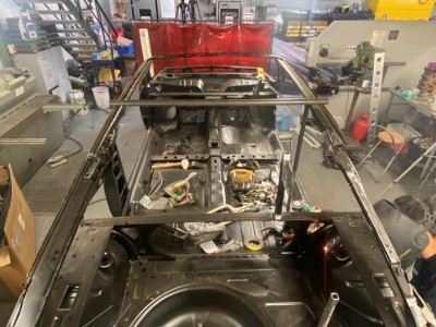

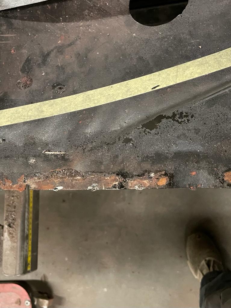

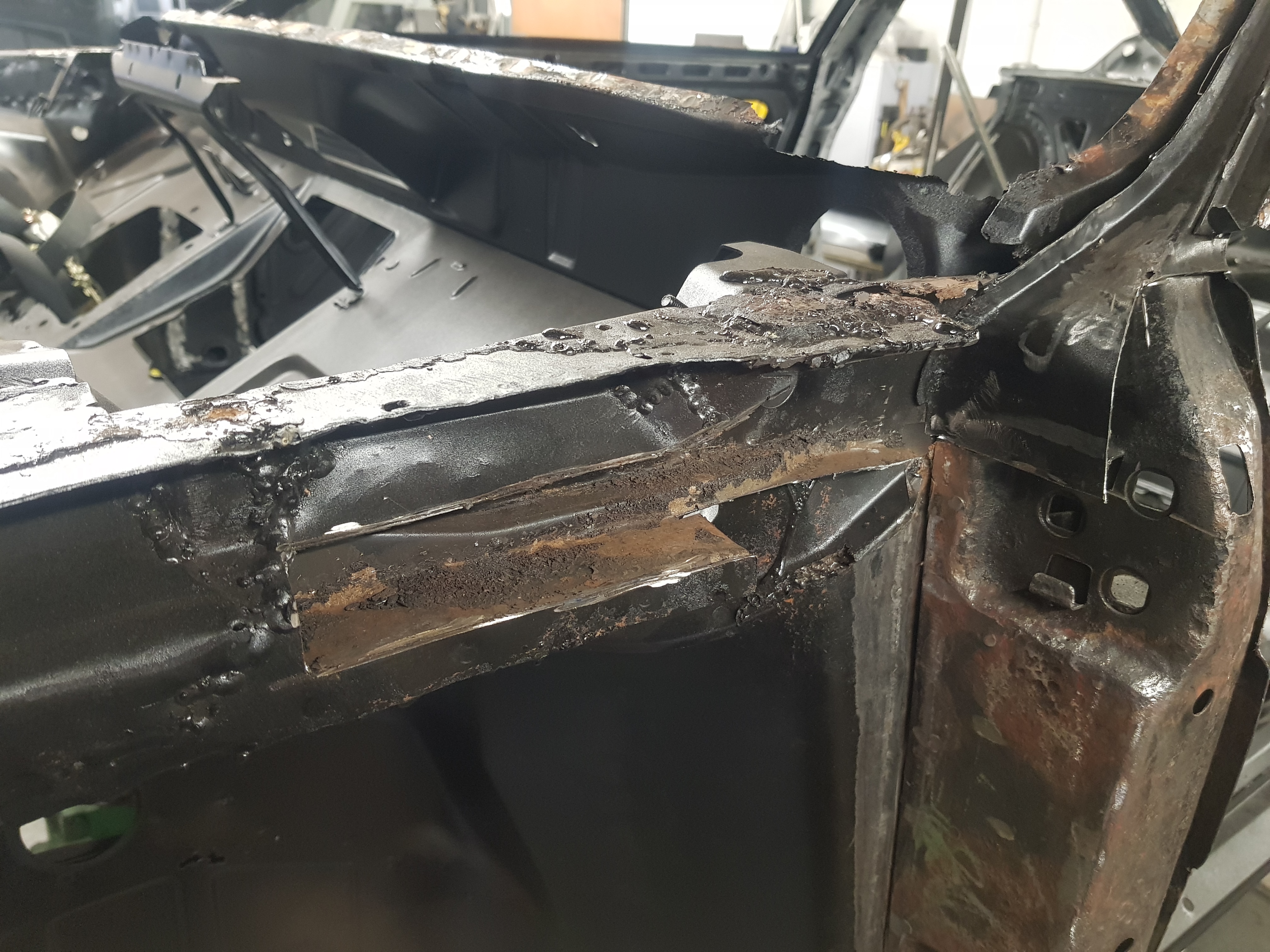

First few pics, as it arrived from Envirostrip. You can see evidence of a repair to the top of the RH inner wing. The rear 3/4 panels were removed prior to stripping as they will be be replaced by new ones.
Alfaoldgit
- Posts: 197
Re: SPRINT RESURRECTION

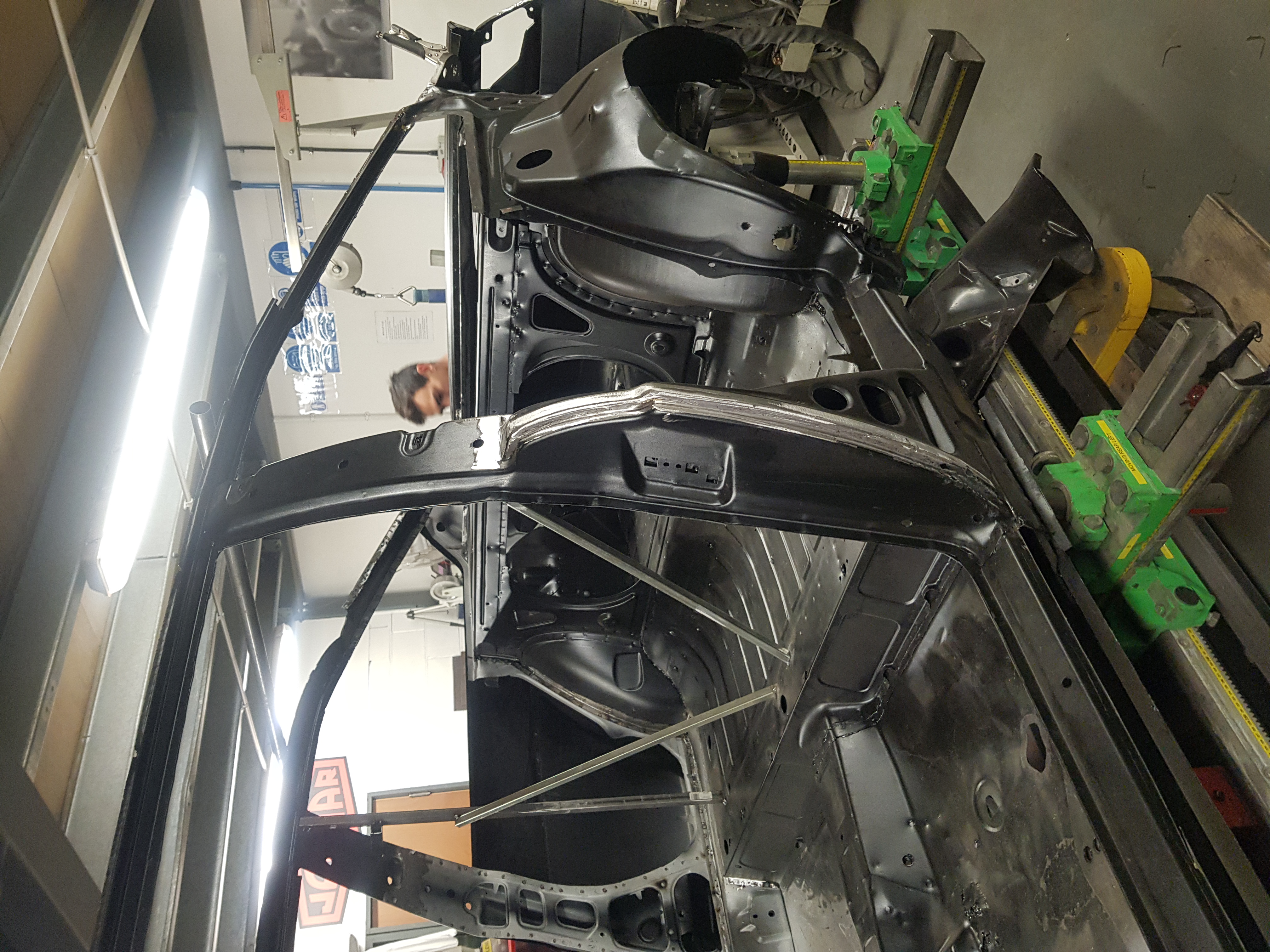

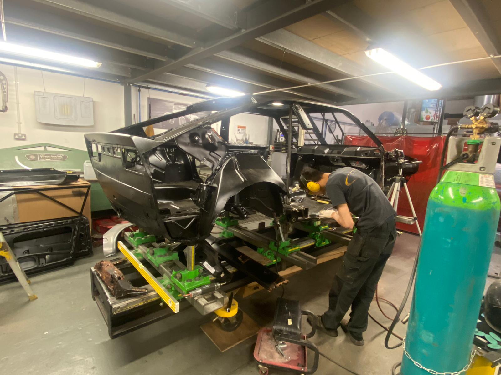

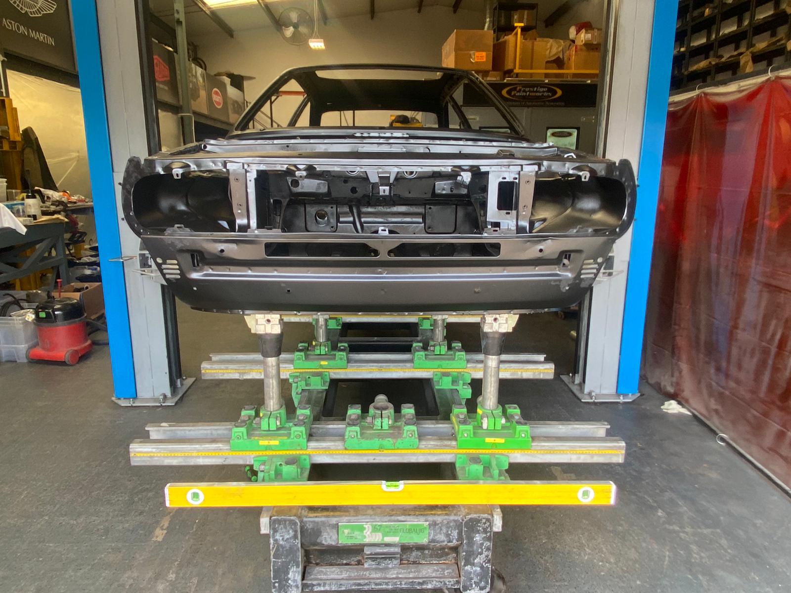

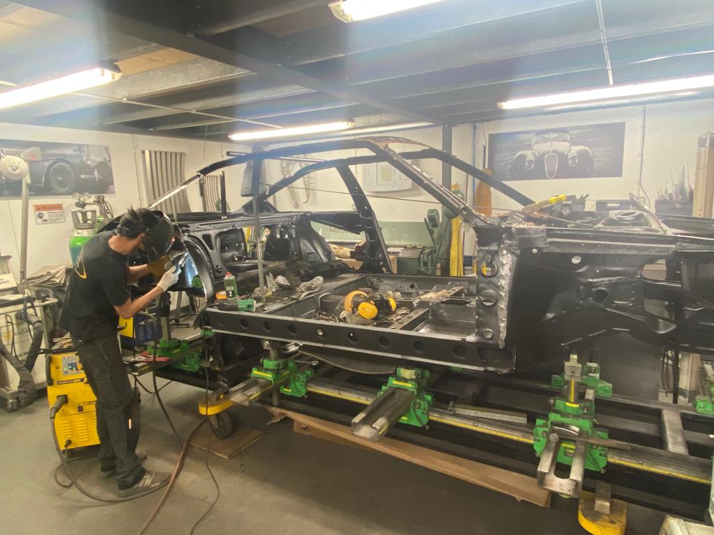

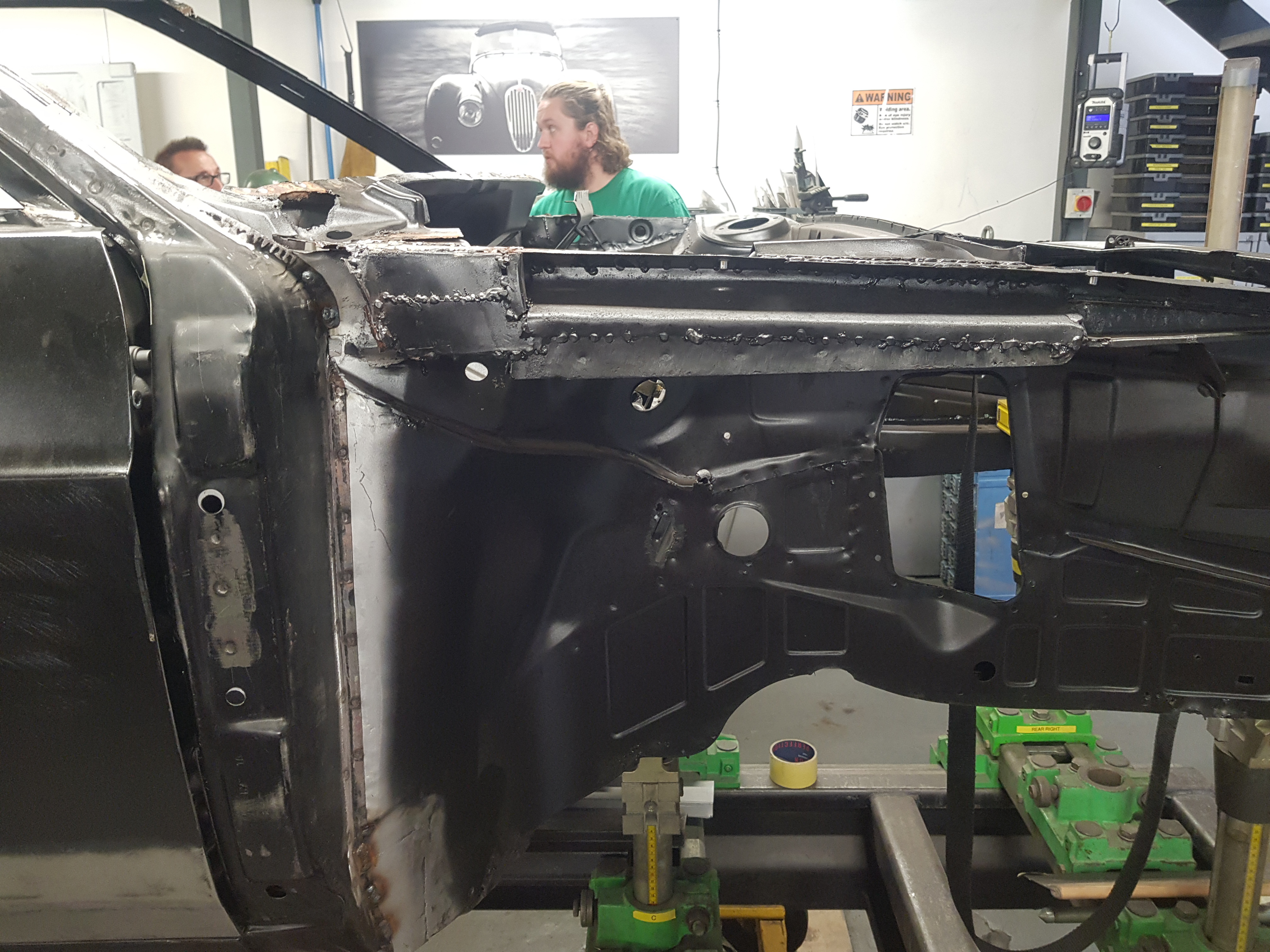

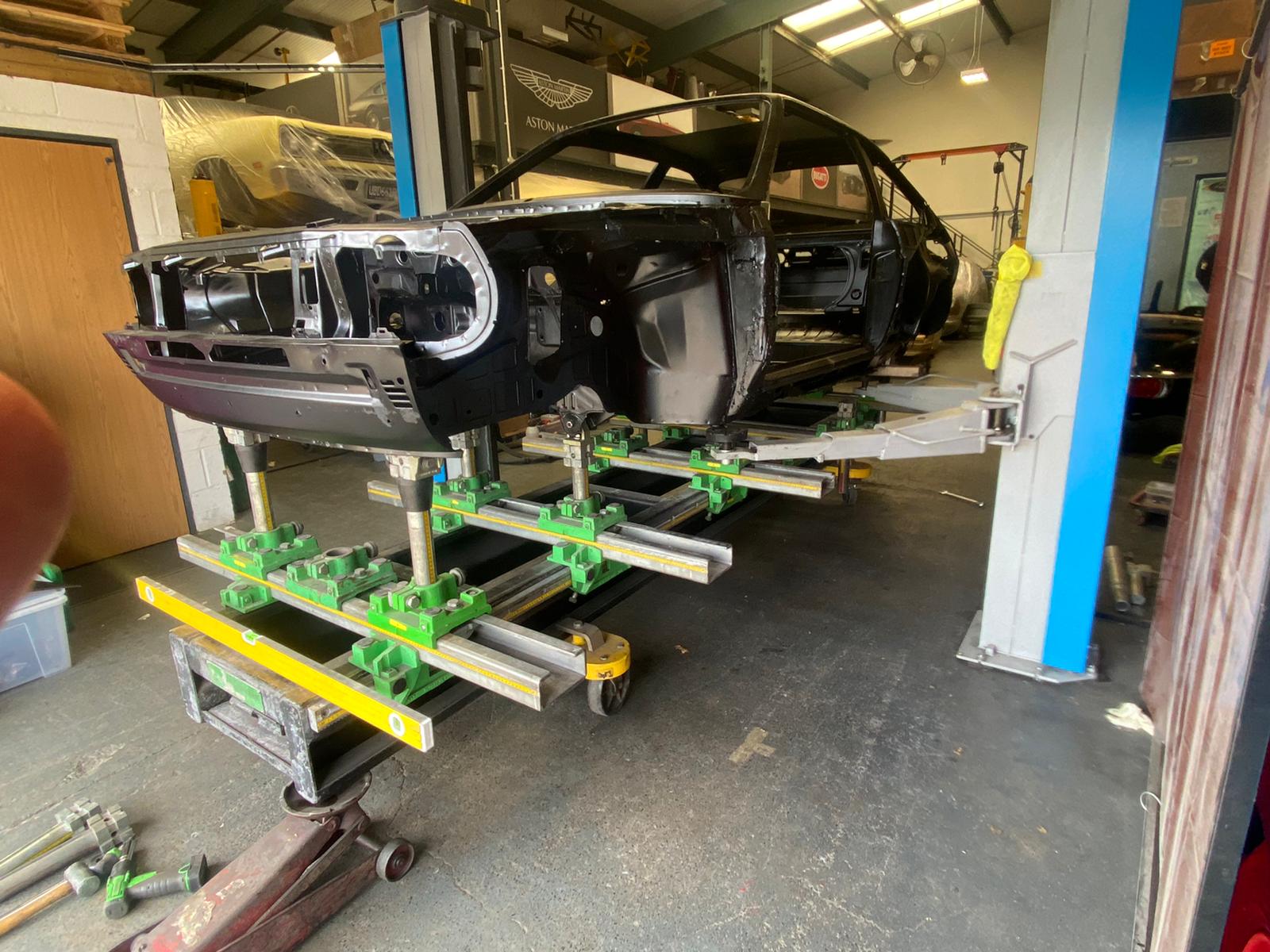

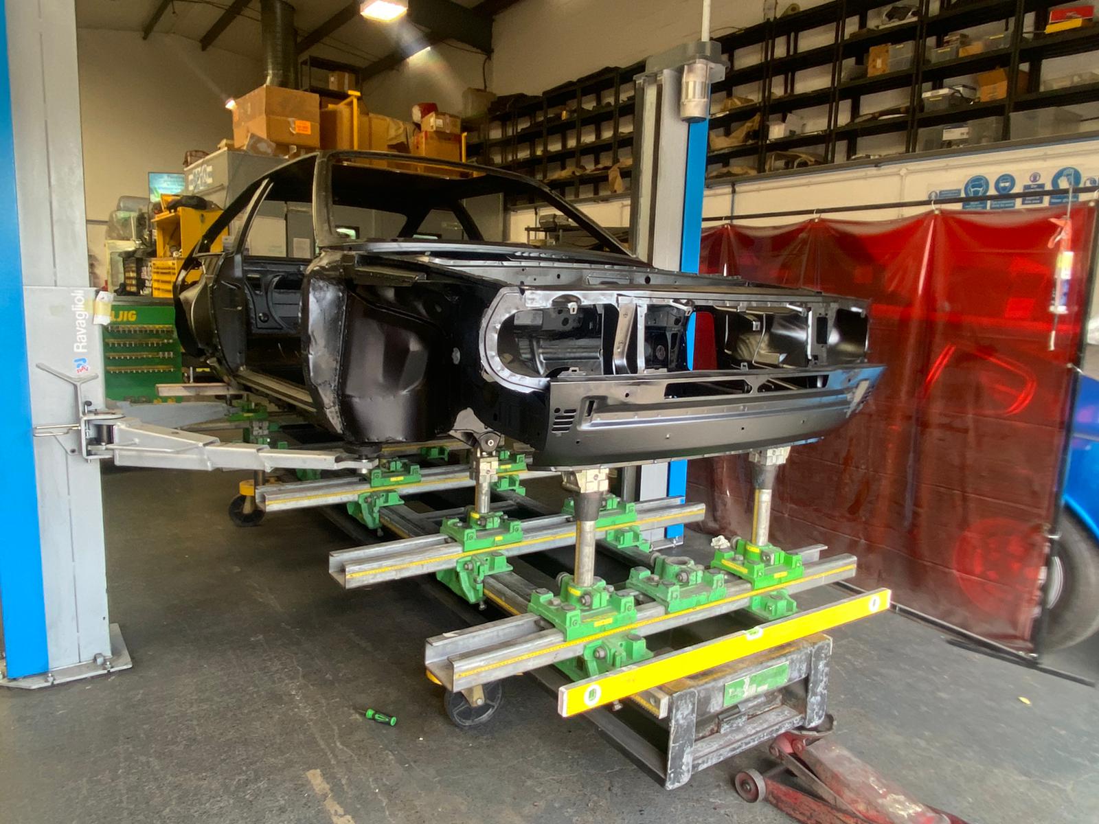

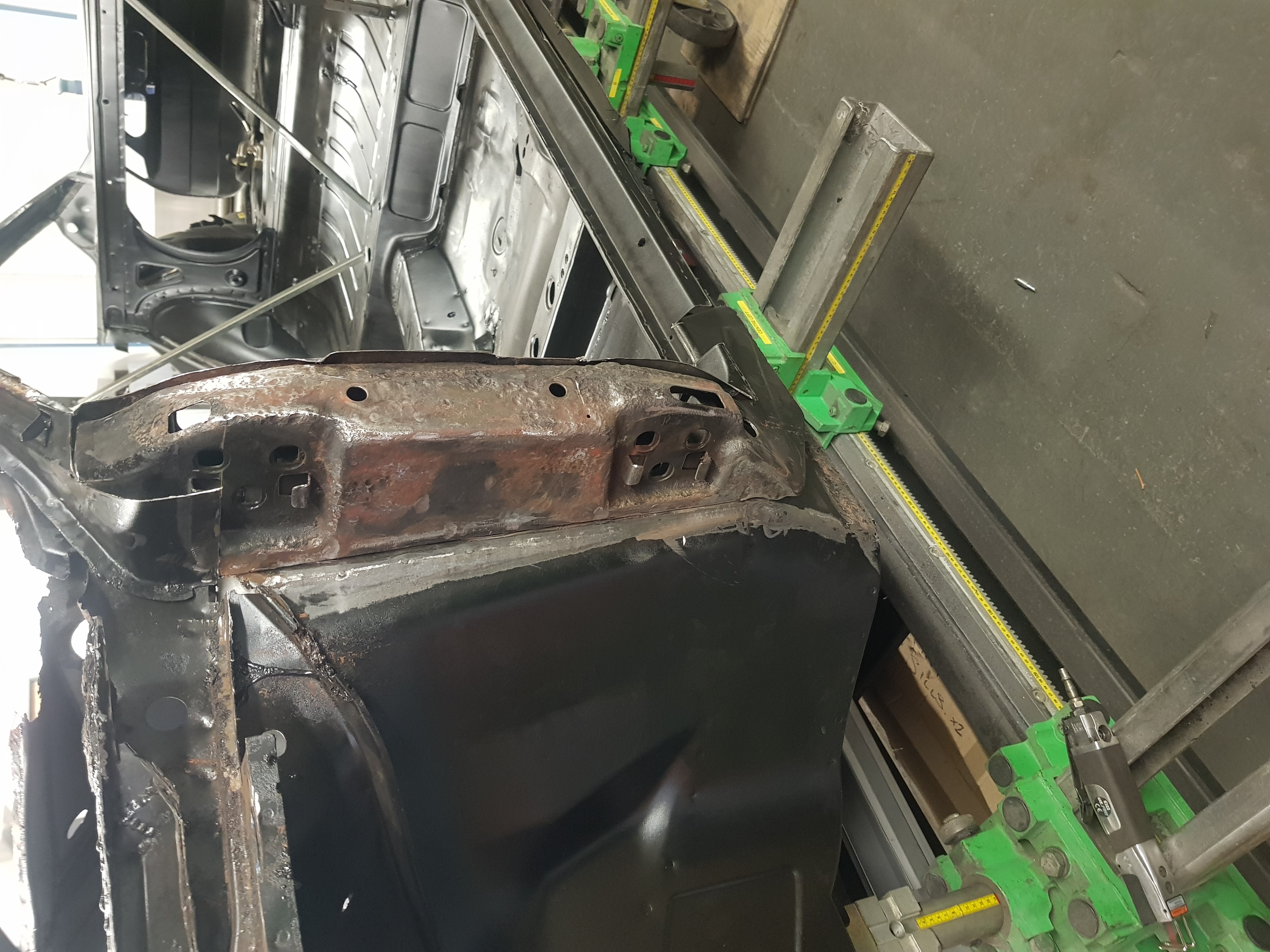

The jig showed the LH front side was 3/4 inch higher than the left with local distortion. Not accident damage, suspected to be pothole impact to weakened shell. It will be corrected.
Where's my RH B post gone....and the sill, and the outer A post? Oh, there's the inner sill laid under the rear wheel arch (what's left of it)! All work will be photo'd or videoed, hence the tripod & phone. I tip my hat to those who do their own bodywork restoration, it's beyond my abilities. Yes, it's going to cost a bomb at this level of thoroughness but it gets done properly or not at all. This project is indeed a resurrection

After some (maybe all)of you have laughed at my insanity
, I could do with the following please:

Someone asked how the redundant glass sunroof hole was going to be filled. The answer I was given "English wheel contoured infill panel welded into existing roof panel" errm, what about distortion from welding? "Distortion will be minimal and easily corrected, we have done this several times before".
At the same facility are a DB7, a DB5, a Vantage & a Skyline GT-R, the Sprint is the street urchin

Yes, the black finish is the E coating applied by Envirostrip. In an ideal world the shell would go back to them after repairs are complete and the whole process repeated. But at £4.5k a go, it's only really viable on a car that's going to be worth £100k plus. The shop are confident that they can apply suitable processes to repair panels/joints to stop corrosion forming. All the replacement panels to hand went to ES so they are all E coated too.

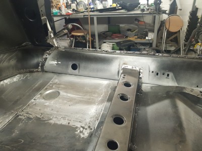

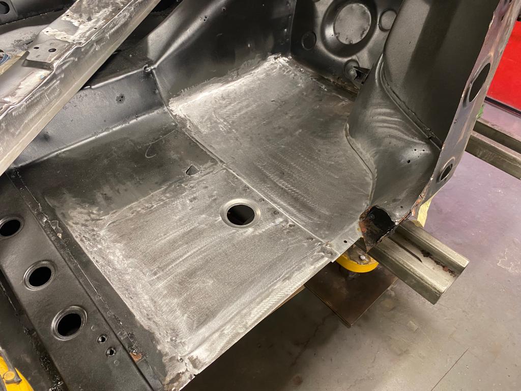

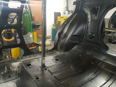

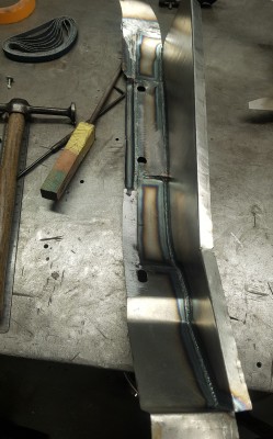

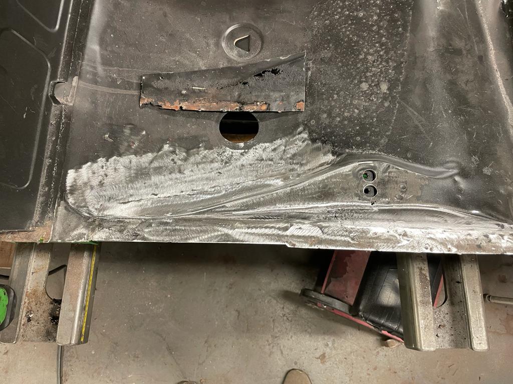

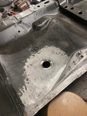

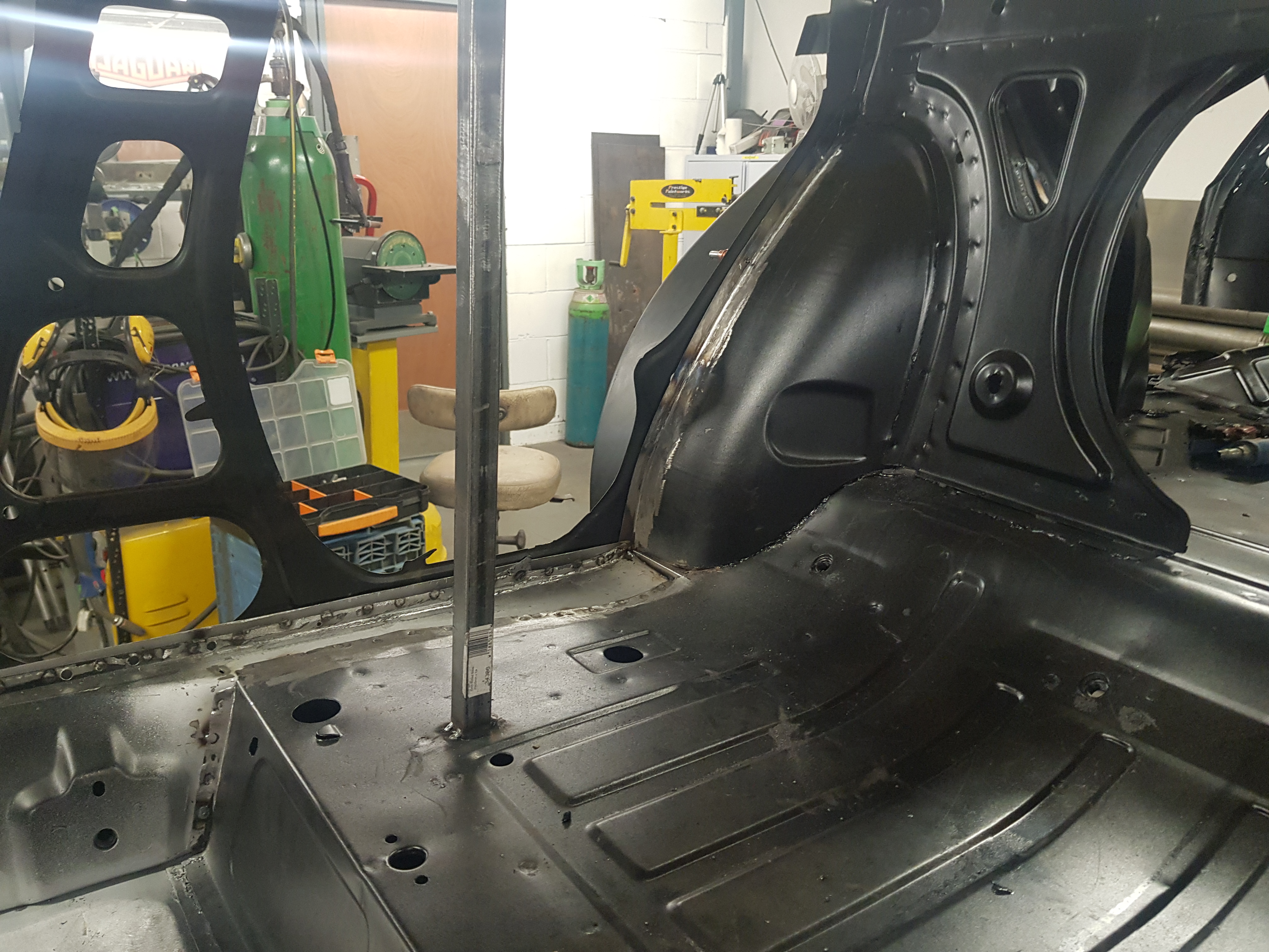

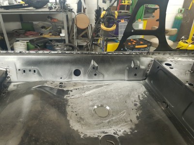

Here we see OS floor rot just fwd of the rear bulkhead adjacent to where the inner sill should be.
Repair section fabricated & welded in, the very first repair. It gets better from now on
OS rear floor repaired & cleaned up
OS front floor repaired, neat welding!
I think this is the OS inner sill, with a new bottom edge welded on. Note the shop clean floor apart from the tidy small pile of scrap on the floor. As an apprentice, everyday I saw on the hangar wall in 2ft high letters "cleanliness is essential for good maintenance" - it's stuck & is the first thing I look for.

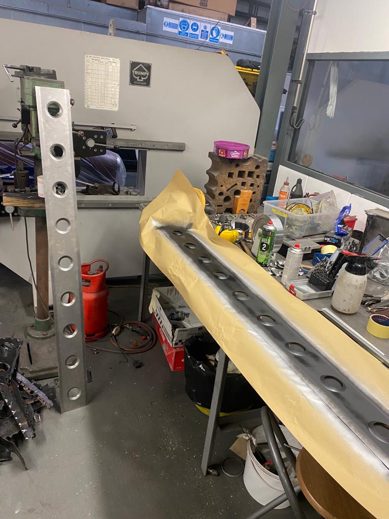

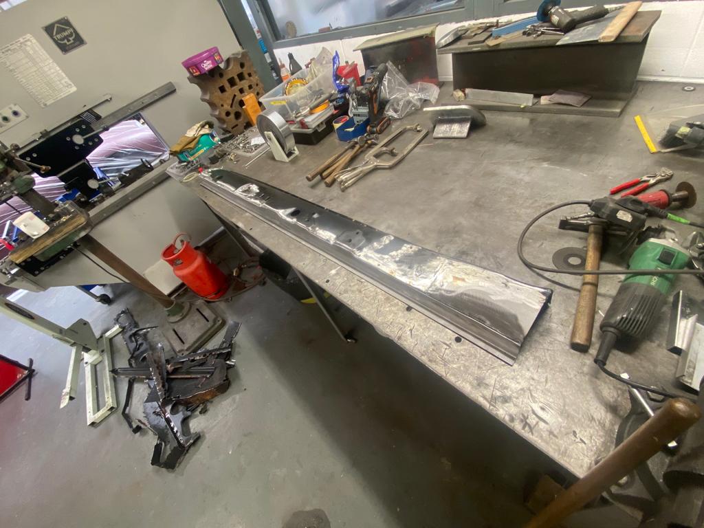

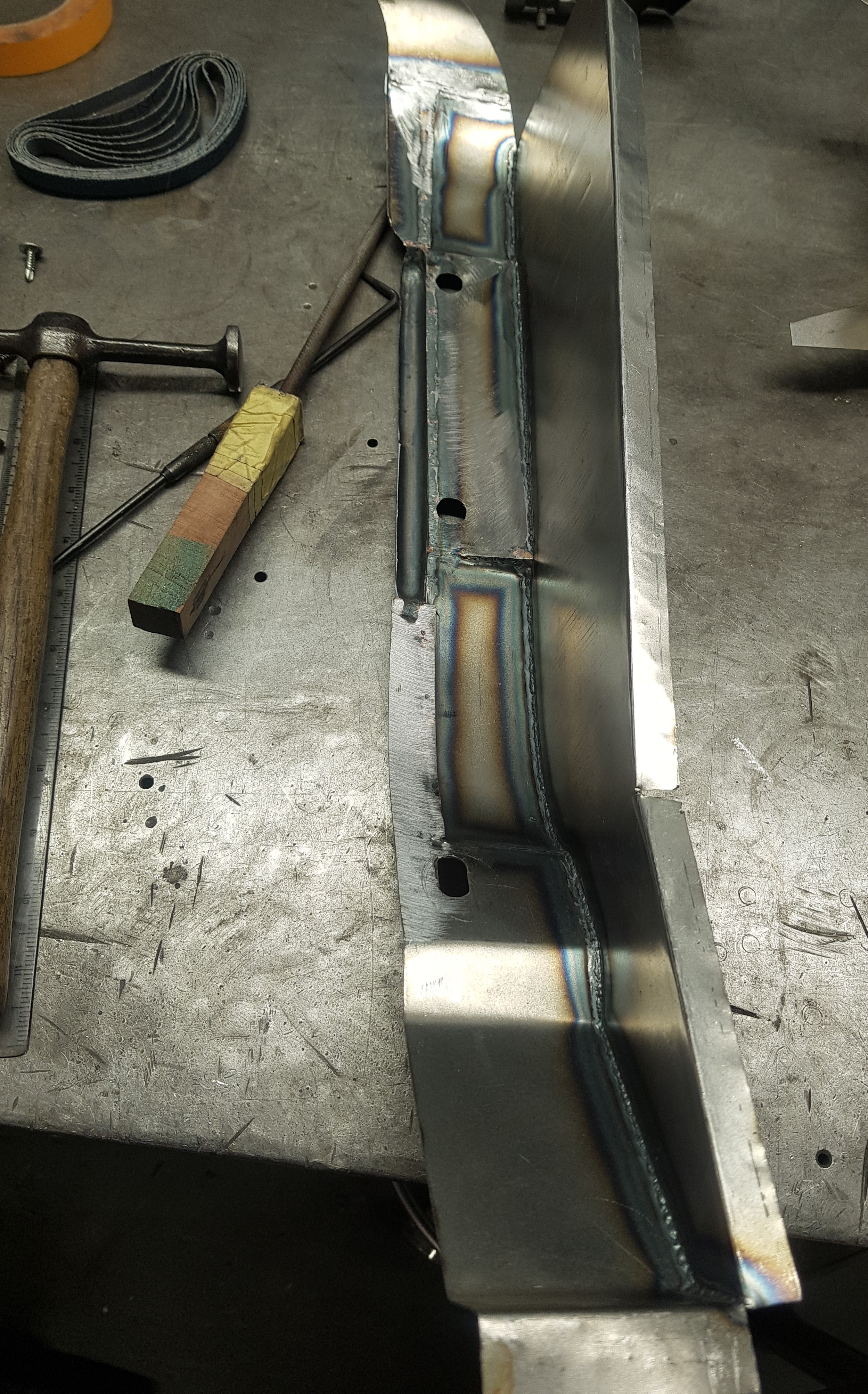

Today's update. Newly made sill inner webs.

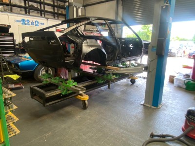

Elsewhere, the offside inner sill and web is now installed. Outer sill, outer A & B post pressing trial fit in last 3 pics. It can't go on yet as it has to be part used to produce a mirror image for the nearside. The missing arch inner edge has been rebuilt. The majority of the work has been done by the young guy in the pictures who joined as an apprentice; good to see a business training up skilled technicians.

After a break for the Jubilee last week, work is progressing. The offside rear quarter is on, the A post & outer sill installed & the door rehung. Unfortunately the door didn't survive Envirostrip as well as hoped and the bottom two inches have had to be reskinned.
The inner wing shows scars from previous repairs! Progress on the offside is now on hold awaiting a replacement rear window pocket and fabrication of a new wing attachement rail/flitch panel.

The nearside is a different story. The sills haven't been touched yet with work limited to repairing the B post, clean up and the removal of the old rear window pocket. I don't know why the pics are on their side, but if you click on them they should open the right way up.
The focus of attention is the A post which as you can see has seen better days. A new NOS one is to hand.
The top of the inner wing has been subject to investigation................

The outer A post is being fabricated from scratch, note the welding. This item is eating up man hours & it's a pain that I couldn't find a replacement anywhere (someone will say "I've got one!" now).
There's been a bit of a rethink on the roof as an unadulterated second hand roof panel has become available which is more cost effective than filling the sunroof aperture in the original roof although there is the challenge of shipping it. Also waiting on the window pockets and wing rail, but there's plenty to be getting on with in the meantime. I dragged my long suffering wife to Folkestone on Tuesday to CE Design to get the dip beam lamps resilvered & various bits yellow zinc plated then over to Bognor Regis on Wednesday to pick up two used front legs, primarily for the spring pans. May have hit gold though as the shox are the original upside down ones. Fingers crossed they are Konis; for now I'll make do with new conventional inserts in the leg casings I've had refurbed.
Finally (yes, I'm nearly done) the new rear panel and inner valance are installed and the two small holes in the boot floor patched.
