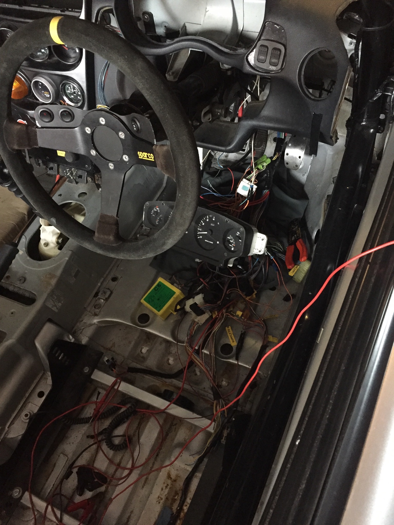

Indeed the wiring has given us a few headaches and it’s all “Jerry rigged” at the moment so I’ve now got to make a new dash. We’re making a custom loom system for the wipers and lights etc.
Re: Race Spider project.
When I did the 145 I seriously considered just binning the 145 and coupe dash pods and fitting a 'bike one, there are some reasonably priced ones out there that looks way simpler to get working than trying to get everything talking to each other.
Well we ended up ripping all the std Spider wiring and switch gear out and at the moment just connected what we’ve had to to make it run . We’ve no instrumentation yet other than a capillary oil pressure gauge . So as this is a race car we’re going to design our own fuse box system and I’ll have small switches on the wheel for wipers and lights. We’ve got the code and injector lights working so we can use the. For fault diagnosis in the future .

Sounds good, you probably wouldn't want all the original dash / loom anyway if it's going to be used purely on the track - it'd be wasted weight
As I said it runs despite this !!!

LooLooSud33Spider wrote:As I said it runs despite this !!!
Hmm, floor mounted instrument cluster, it could catch on :)
Interestingly (or maybe not) I had exactly the same steering wheel on my original roadgoing Legacy twinturbo - they seem to last very well for a racing wheel, even with everyday use.

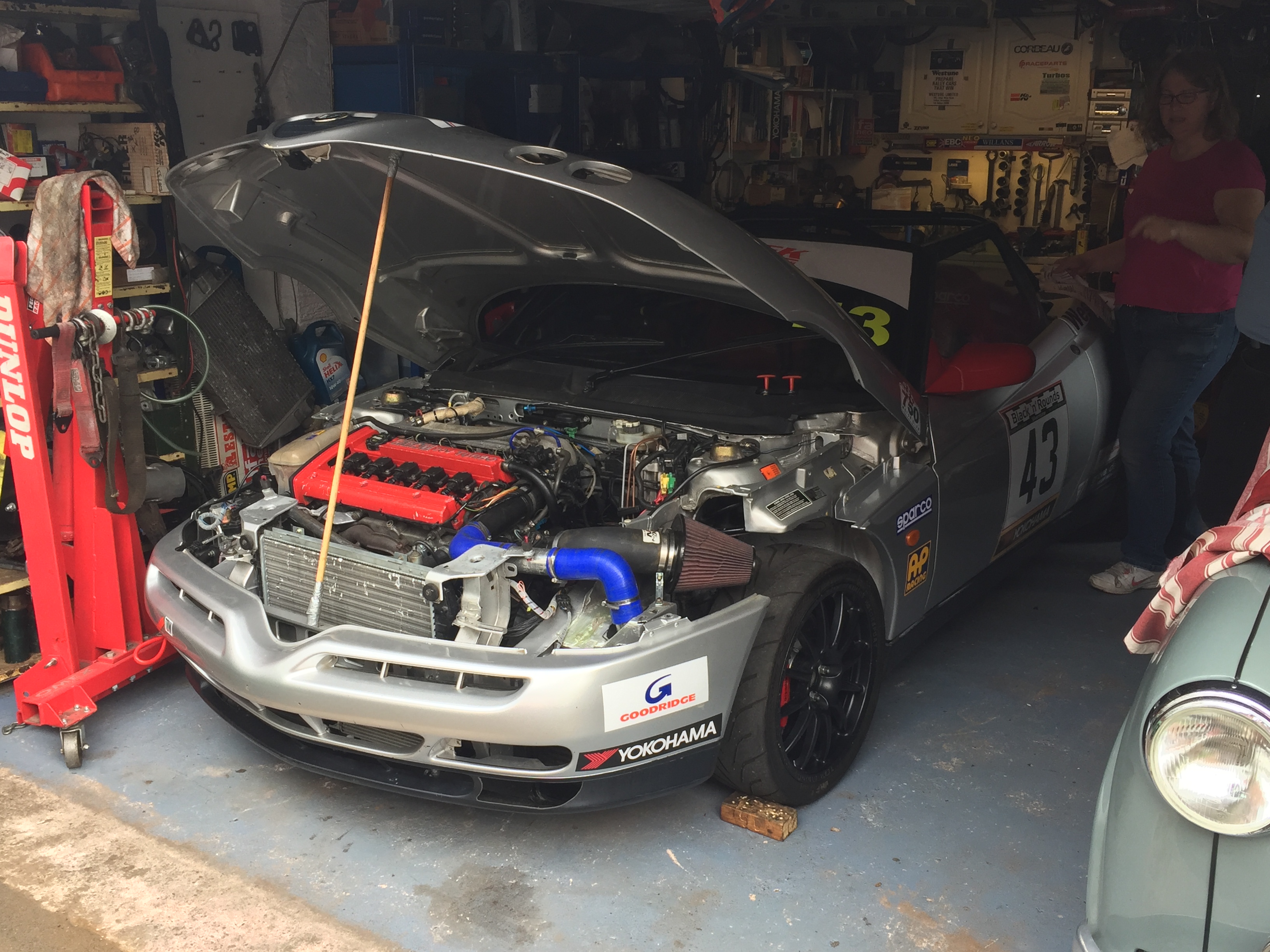

Latest update on the spider . As mentioned we made it run. A few problems have shown themselves . The main one is the “it’s a good one” Turbo we acquired turns out to be good at one thing . That is pumping oil straight into the exh system the thing smoked Worse than a whore on crack.
So I removed the turbo again and is currently being rebuilt with a few reliability related mods at the TurboCentreUk in Wakefield. So Whilst that’s away I’ve been getting stuck into the electrics. New fuse box system installed and just the essentials for racing of rain light, wipers, stop and tail lights all working. Still got to rewire the fuel and temp gauges then hopefully we’ll be almost done. We’ve ordered some exh parts In order to make a new system. I’m scheduled to collect the Turbo on Wednesday so hopefully have it running again by next weekend. Watch this space .

So I Fitted the New turbo and made the exhaust system yesterday. And the smoking has largely disappeared. I think The small amount we did see was probably from all the oil in the front pipe from the knackered unit.
One last push on finishing the dash wiring later today and tomorrow. just a few small finishing jobs then we can look at going testing.
Sounds quite horny now in a weird 5cyl turbo whooshy kinda way.

Thanks for all the words of encouragement. We’ve Had a few good days slicing the Fiat loom into the Alfa clocks . The rev counter does now work but reads approx 500rpm high so the plan is to try to rotate the face through the relevant degrees. Alternatively I’ll re Mark the face every 1000 rpm.

So it never rain but it pours . almost got the spider finished. And it runs superb BUT and it’s a big but. It still smoking rather more than I would like
Even with a nice fresh Turbo. I’ve run it long enough now that all the accumulated oil and gunk in the front pipe should be gone . But as it warms up and you pick the revs up I’m still seeing enough blue smoke to be a concern. So I’m thinking valve guides and seals or possibly rings. As most of you will know with the 5cyl any kind of major overhaul normally means pulling the engine out. However I’m determined to at least have a go at doing it in situ. I may just have to modify a few things . Wish me luck !

So We’ve spent today warming the spider up to temp several times we still had a noticeable amount of smoke so we added a can of Wynn’s Oil treatment. This is not a flush it’s an additive . (I’ve used it before and still use it as an engine build lubricant).
And I have to say since adding it the oil smoke has almost completely stopped. I’ll spend this week giving the car a full nut and bolt safety check and tie up a few loose ends and continue to warm the car up and as long as it behaves itself well look at booking a track/test day.

So the Spider drove under its own power today . Only up and down the close and our driveway. Sadly whilst the smoking had disappeared under idle and free revving conditions as I put the engine under load it started to puff the blue stuff out again.
So it’s going to have to come out again so I can rebuild it. I’m a bit fed up but I’ll just have to deal with it life sucks at times .
