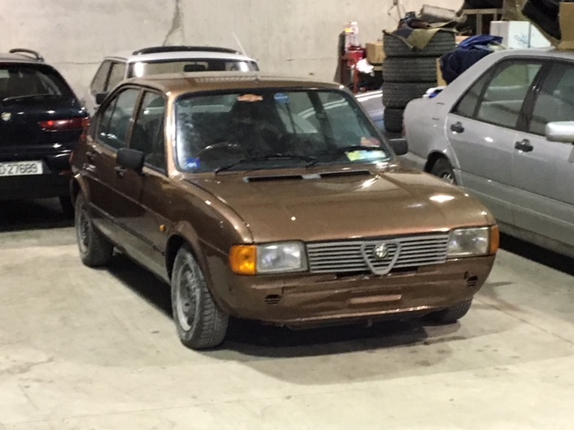

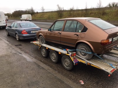

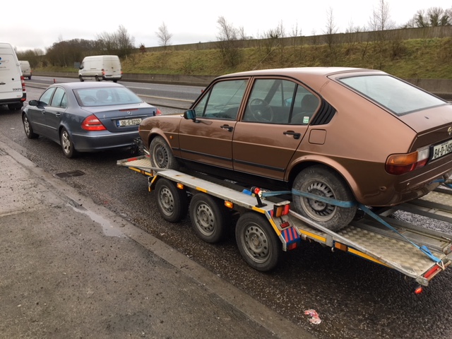

Road trip day to pick up Sud

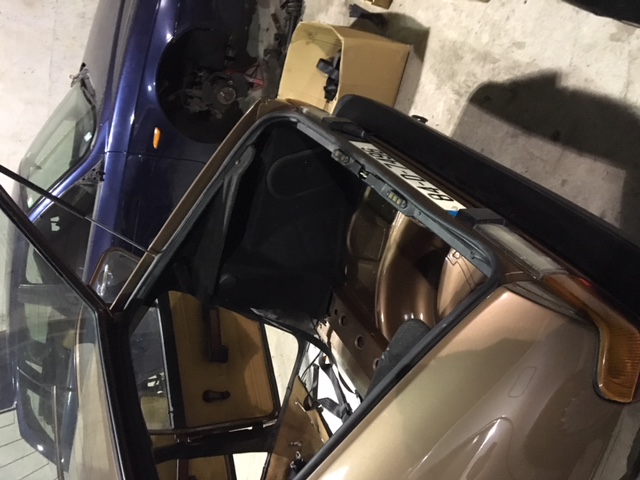

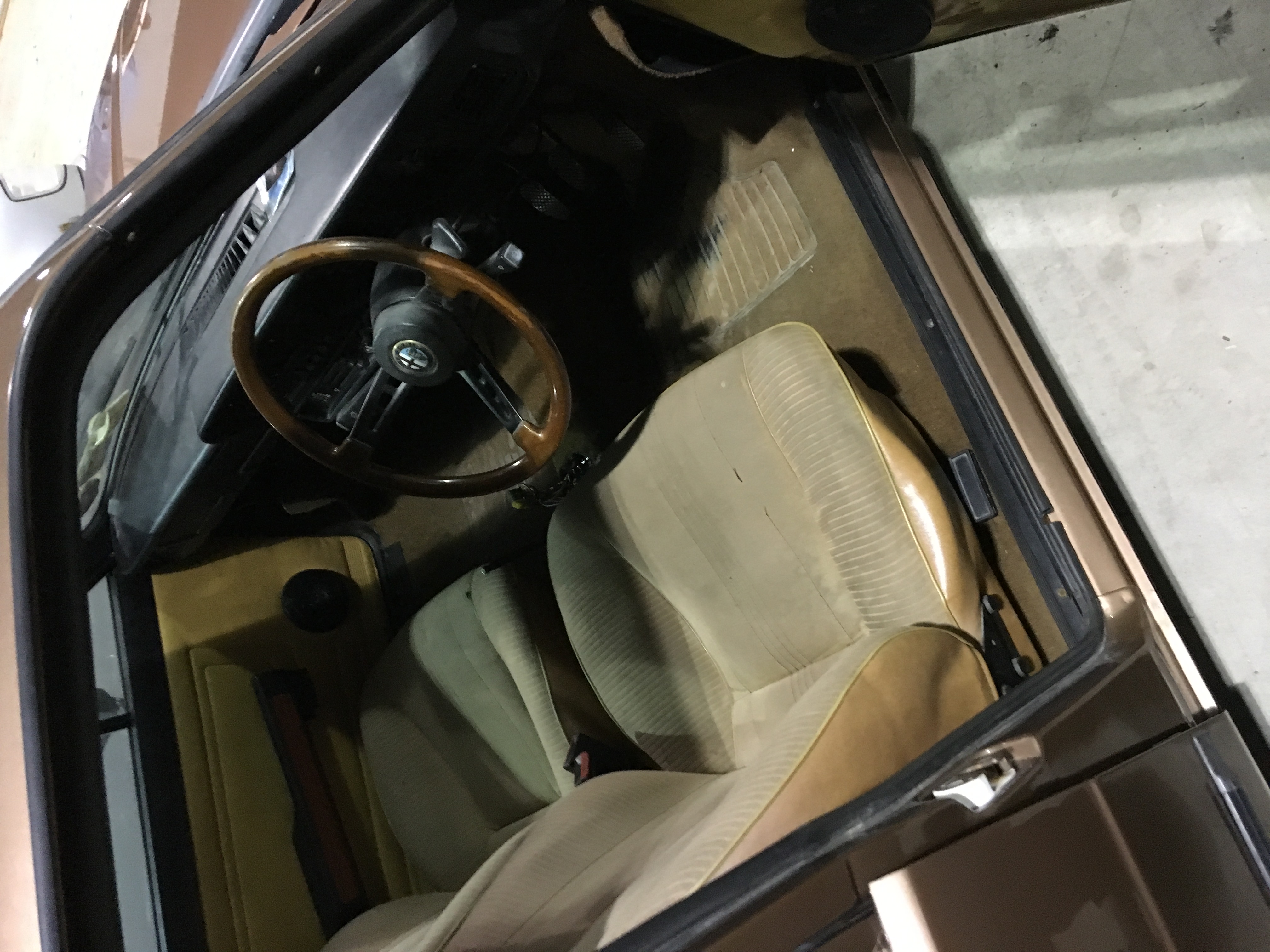

Back in the garage now

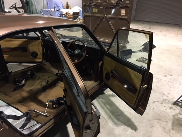

Update: today I refitted the headlining, visors, rear view mirror, interior light, grab handles above the doors and the bumpers. Although I have to finish fitting the bolts for the front bumper.

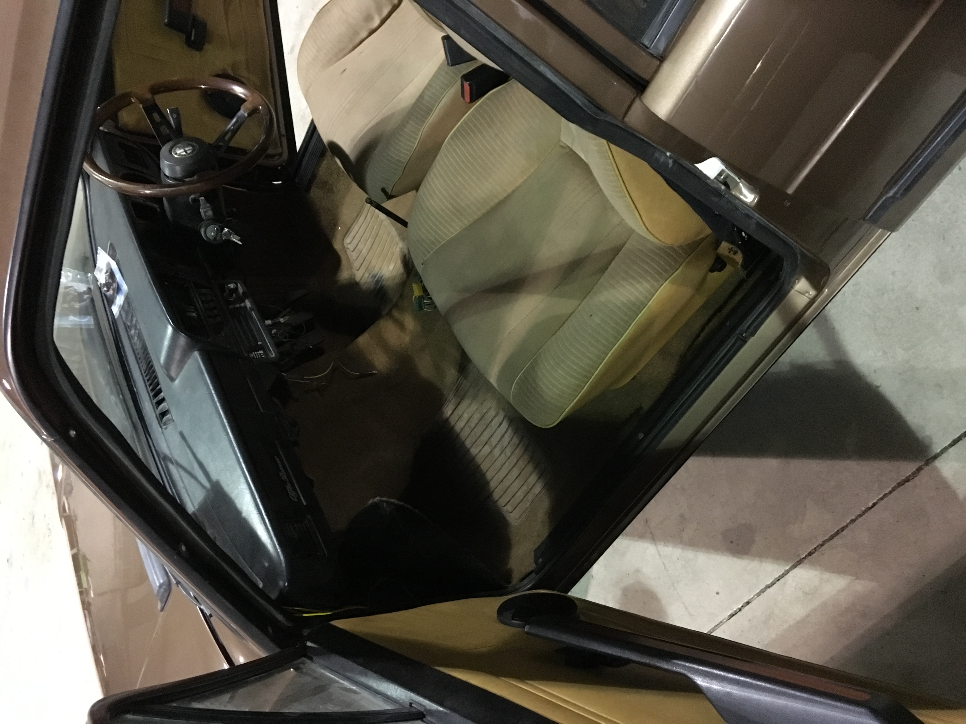

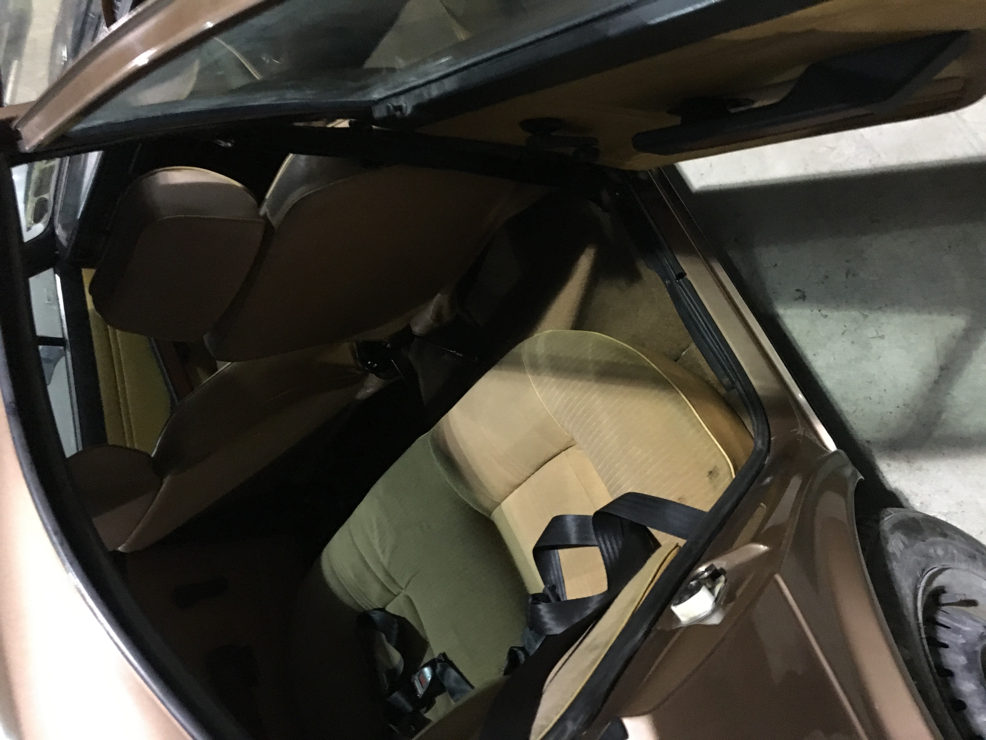

Latest update:
Bumpers back on but will need to be revisited as I used a black restorer
but someone has previously sprayed them so they're patchy.
I did dinitrol the cavities thanks to Frank but of course forgot to do the sills via the holes for the side trim! :roll:
Boot, tailgate trim and door cards back in place.
Put the original carpet back in - look fine to me.
Now for the 'challenges:'
Similar to Stesco I removed the seatbelts and for some reason forget to knot the driver's side one!
So I'll be trying the angle trick as per his thread.
Also like the plank I am I removed the handbrake and can't get enough purchase on the cable to get it back into the lever.
might leave this for the mechanic. (Any pearls of wisdom greatly appreciated here!)
I also found that the proposed rear seat from a 33 has the opposite locking mechanism to the Sud.
What I might do is refit the original seats and get the mechanicals sorted, NCT passed (ROI version of MOT),
then revisit the seats....
If you click on this one is displays correctly

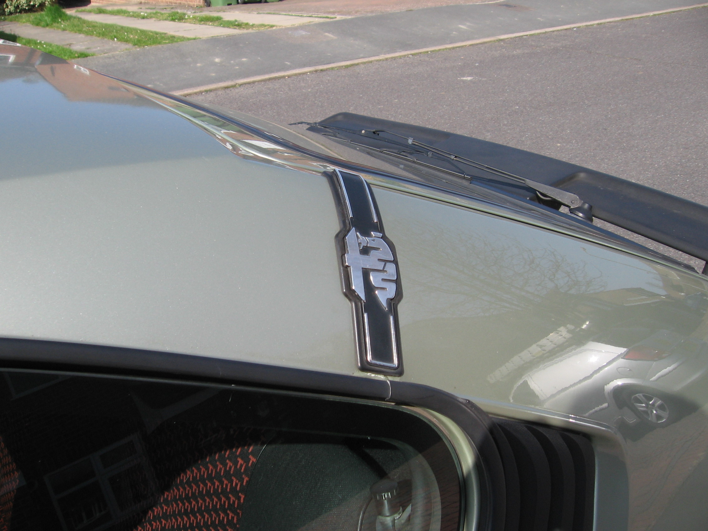

I was really lucky to find mine Rory, actually did a "swapsie" for them. If you do locate any remember they come in long and short versions. These are the long ones.

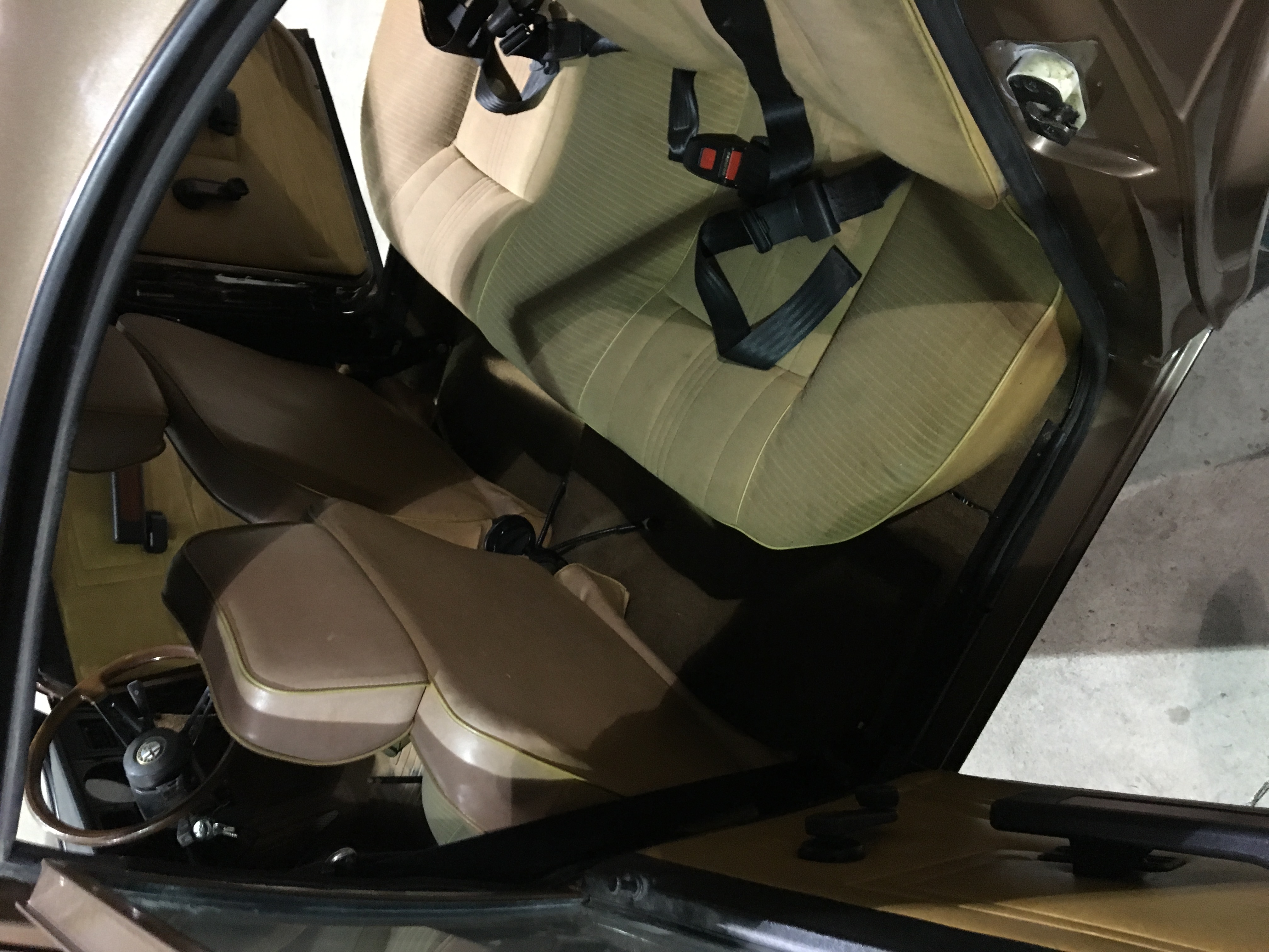

Quick update:
I've got the rear seats, rear seatbelts and the rear parcel shelf in so the back half of the car is almost finished!
I did manage to unreel the DS front seatbelt so it's in place now.
I tried to faff with the handbrake cable reattachment and gave up - I'm going to leave that to the mechanic to refit.
I have a favour to ask any Sud owners, could you please take a photo of the handbrake in place (need to see how it looks with the carpet)
and some up close photos of the front seatbelt anchor points on the floor.
Thanks in advance!

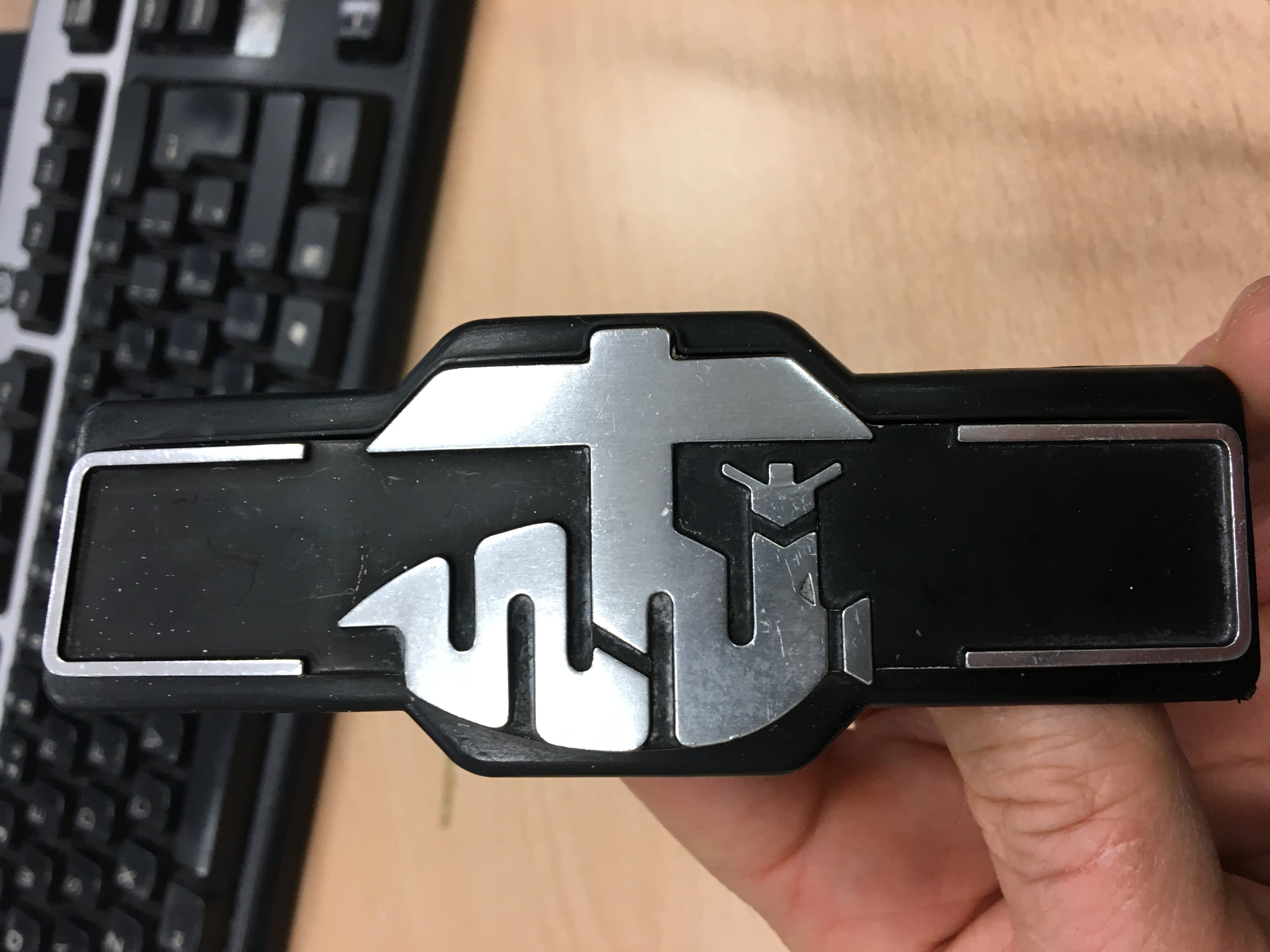

eBay purchase - just the one though! Very good nick. I do have the badge bit already so I just need one backing rubber....
After I confirm for definite which side it actually is! :lol:

Clearly UK passenger side / left side. You can distinguish by the direction if the slant, it needs to follow the rear window frame.

Alfa_Japan wrote:Clearly UK passenger side / left side. You can distinguish by the direction if the slant, it needs to follow the rear window frame.
That's what I thought too, but was going to see next time I get out to the car.
