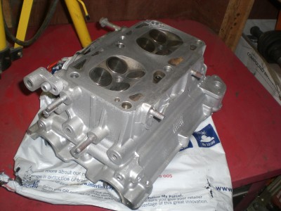

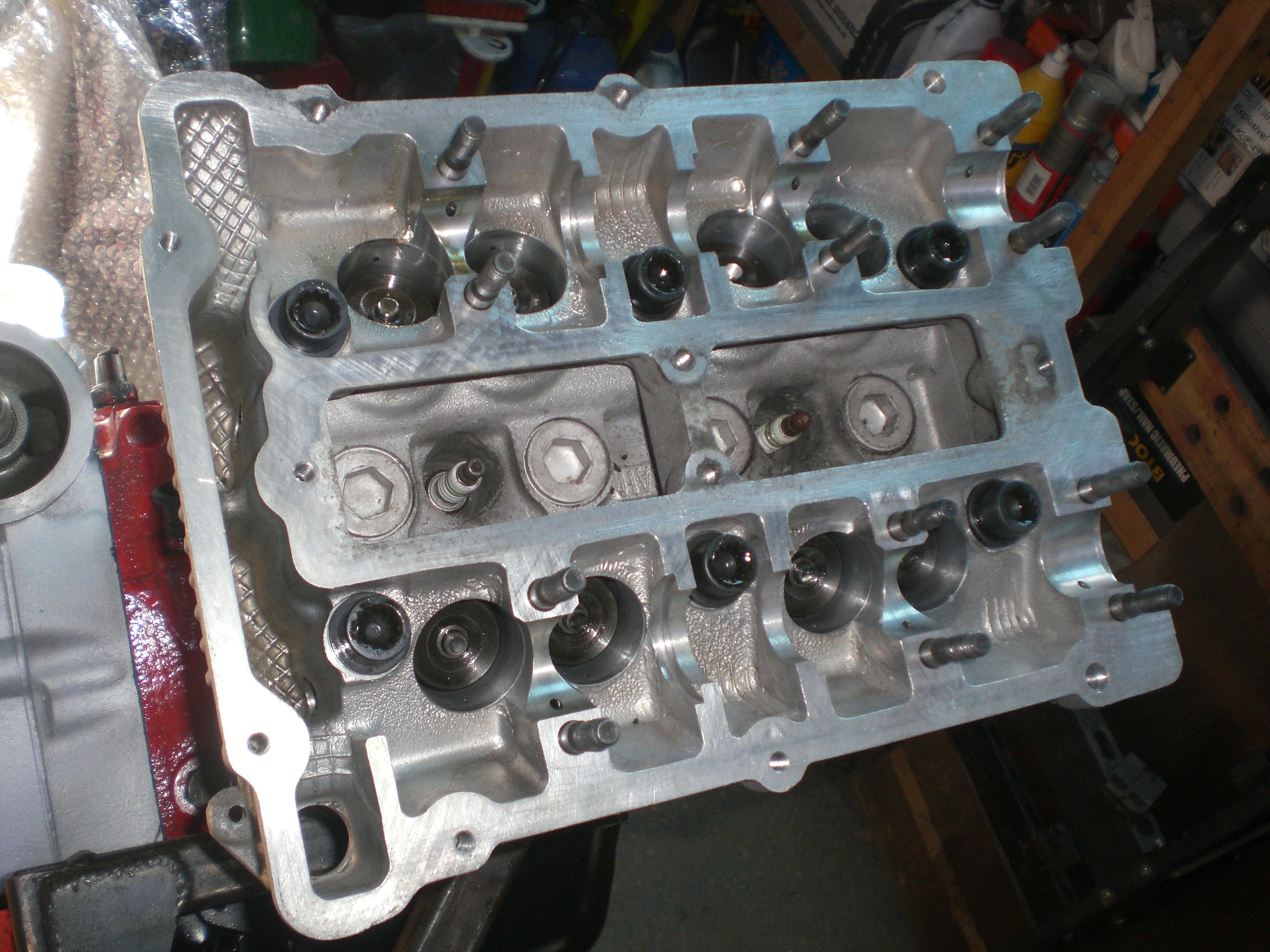

started on one of the heads now, the replacement for the one that had the bent valves and broken valve guides.
these 8 valves have been lapped in, not a task i relish but has to be done.
all stripped down and ready for a good clean in the parts washer, once done it was cleaned and dried as usual.
new valve seals in place, spring plates cleaned and oiled ready for the valves to go back in.

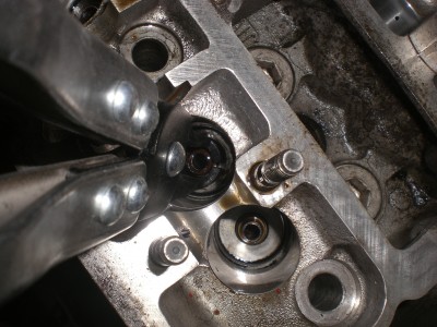

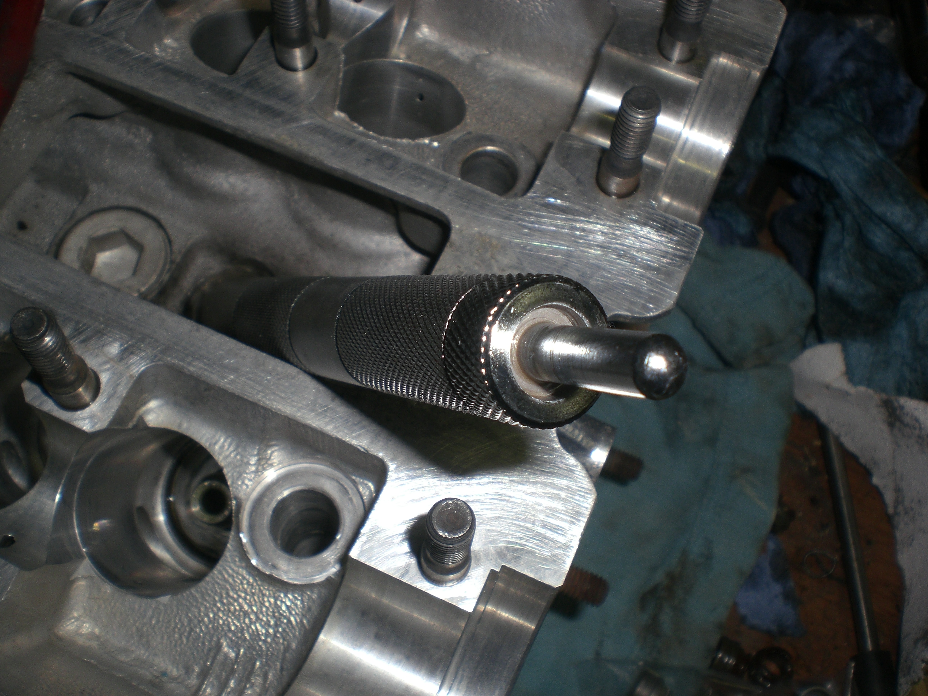

johnboy, you asked a while back about the ease, or not, of removing/installing the valve seals.
with them being sunken down the old traditional way of prising them off with a screwdriver is impossible and hammering back on with a socket is tricky but a bit fiddly
the tool you need is pictured below.
you get a set of long nose pliers with serated teeth that are designed specifically to fit the seals, makes removing them unbelievably easy. a little twist & pull and off they come.

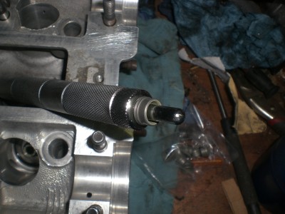

to insert the new seal you select the tool that fits into the valve guide, screw it onto the handle and slide the new seal up the tool. you will notice there is a reccess in the tool where the seal slides up to so the important sealing part isn't damaged when fitting the new seal to the guide, it means when you press the new seal home it's being pressed on the shoulder section.
so just align the tool up into the valve guide and gently tap the tool, you feel when it's driven the seal home, doesn't need a huge force to fit them. gentler is better actually as you can feel it hit home.
tool kits are available on ebay for under £15, well worth the money
