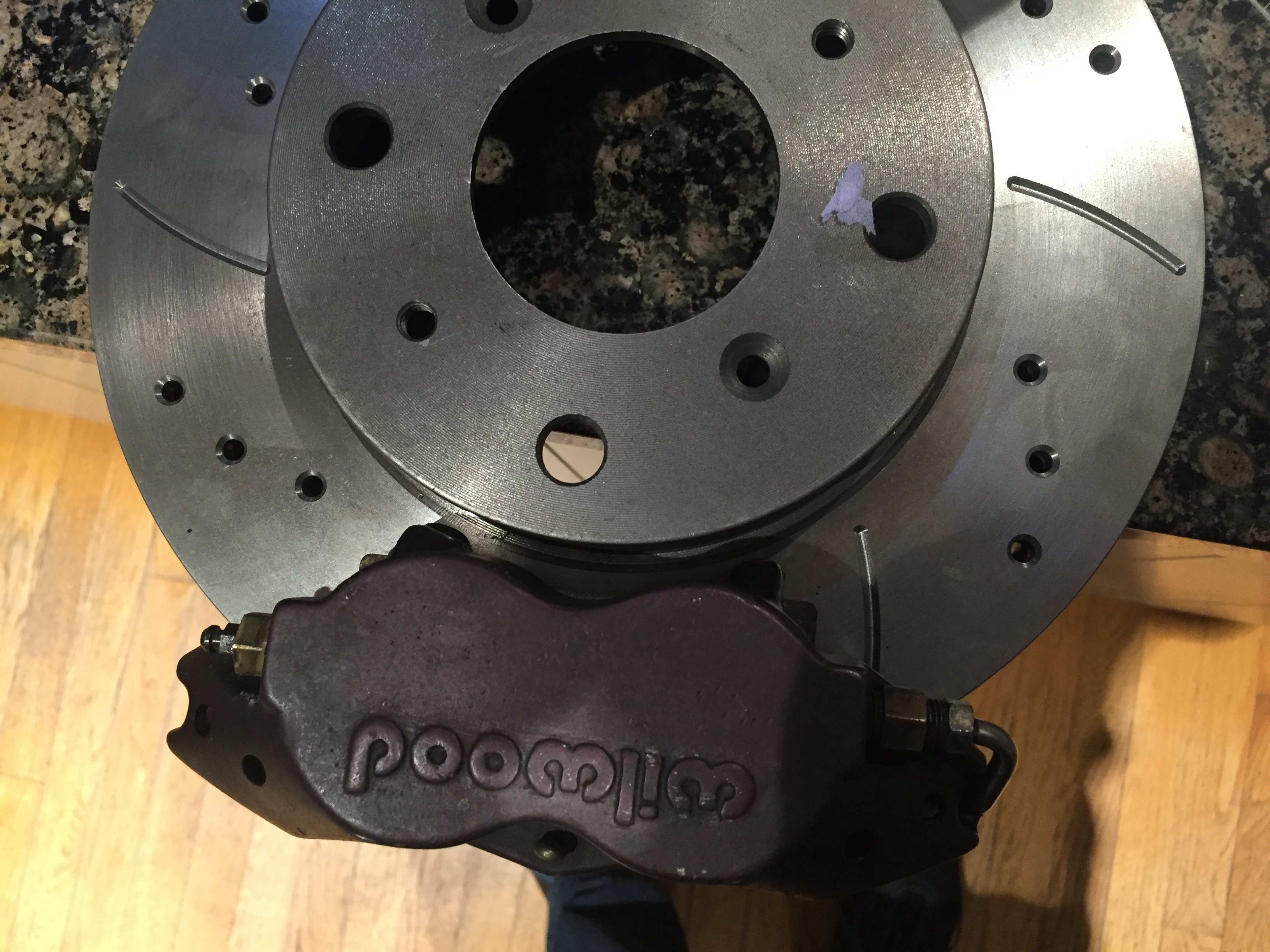

Hi Guys,
I came across a new problem today:

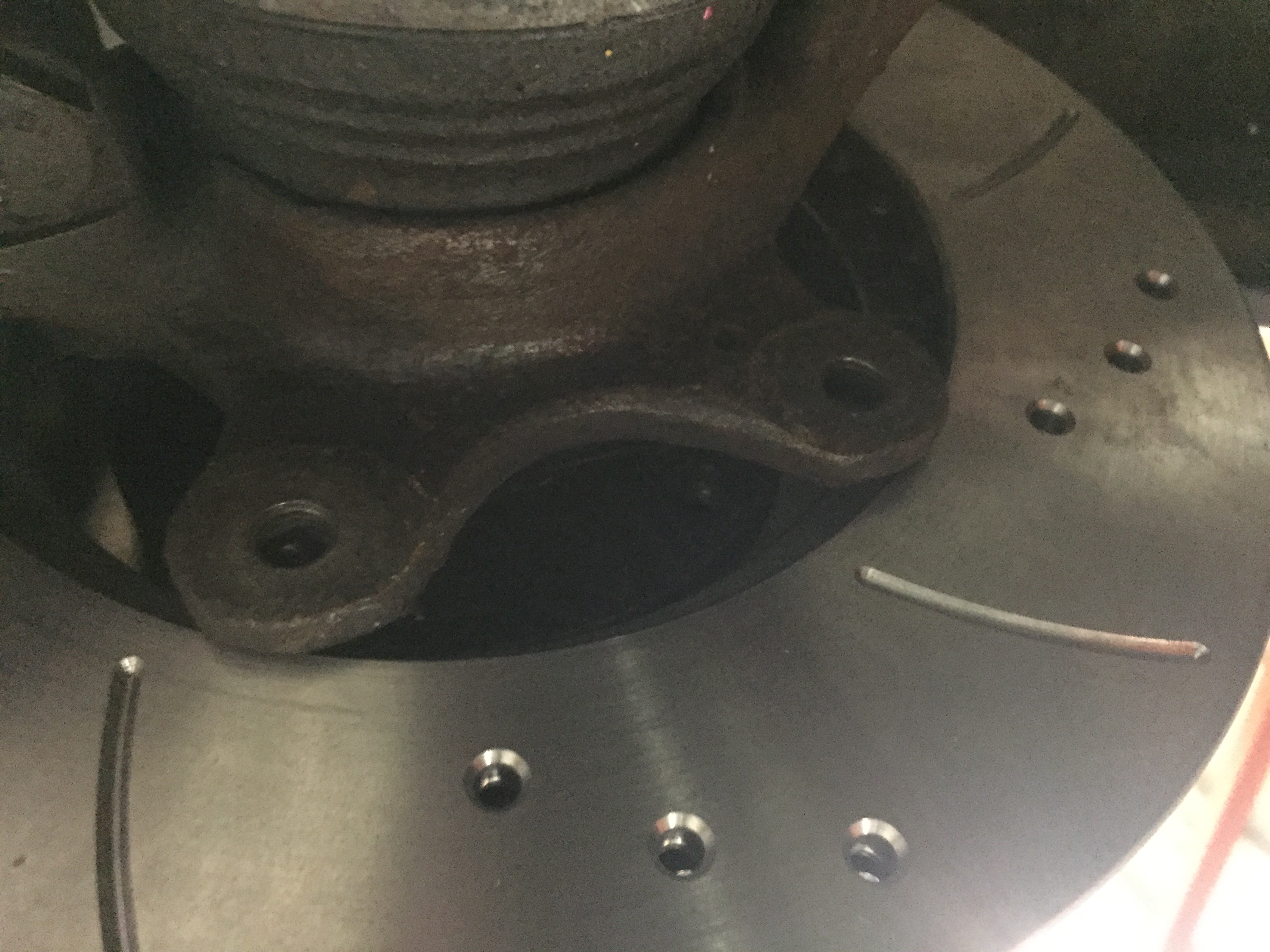

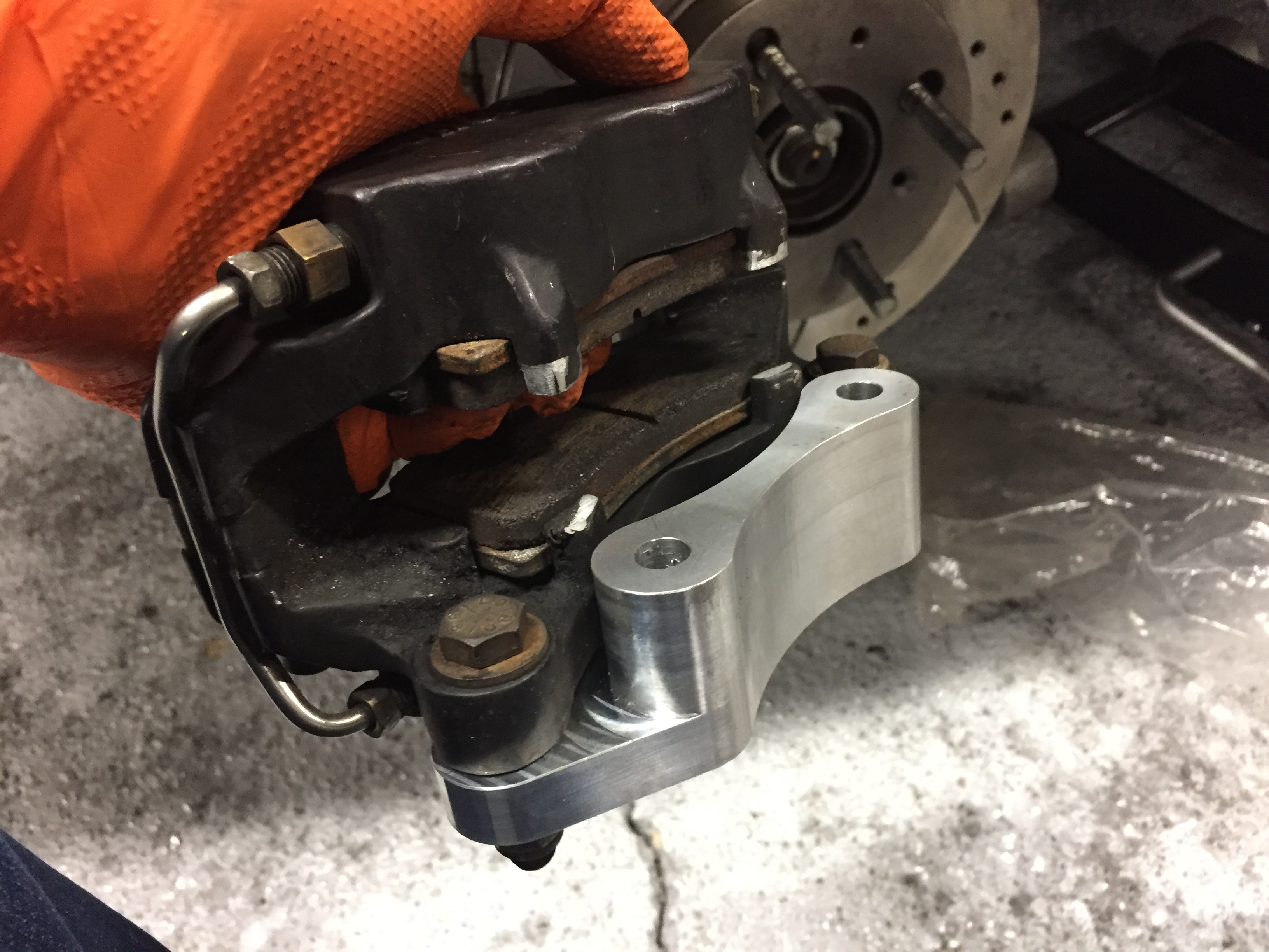

This will require 3.5mm to be machined to allow the calliper mounts to fit inside the disc. This is in addition to reducing the disc diameter from 262mm to 256mm, increasing the centre bore from 64mm to 65mm, machining 4x100 new hub stud holes.
Just getting a dwg file produced of my calliper mount so I can hand it to a machinist to get two produced.
Then I will be good to go!
Using the current Dynalites for now.

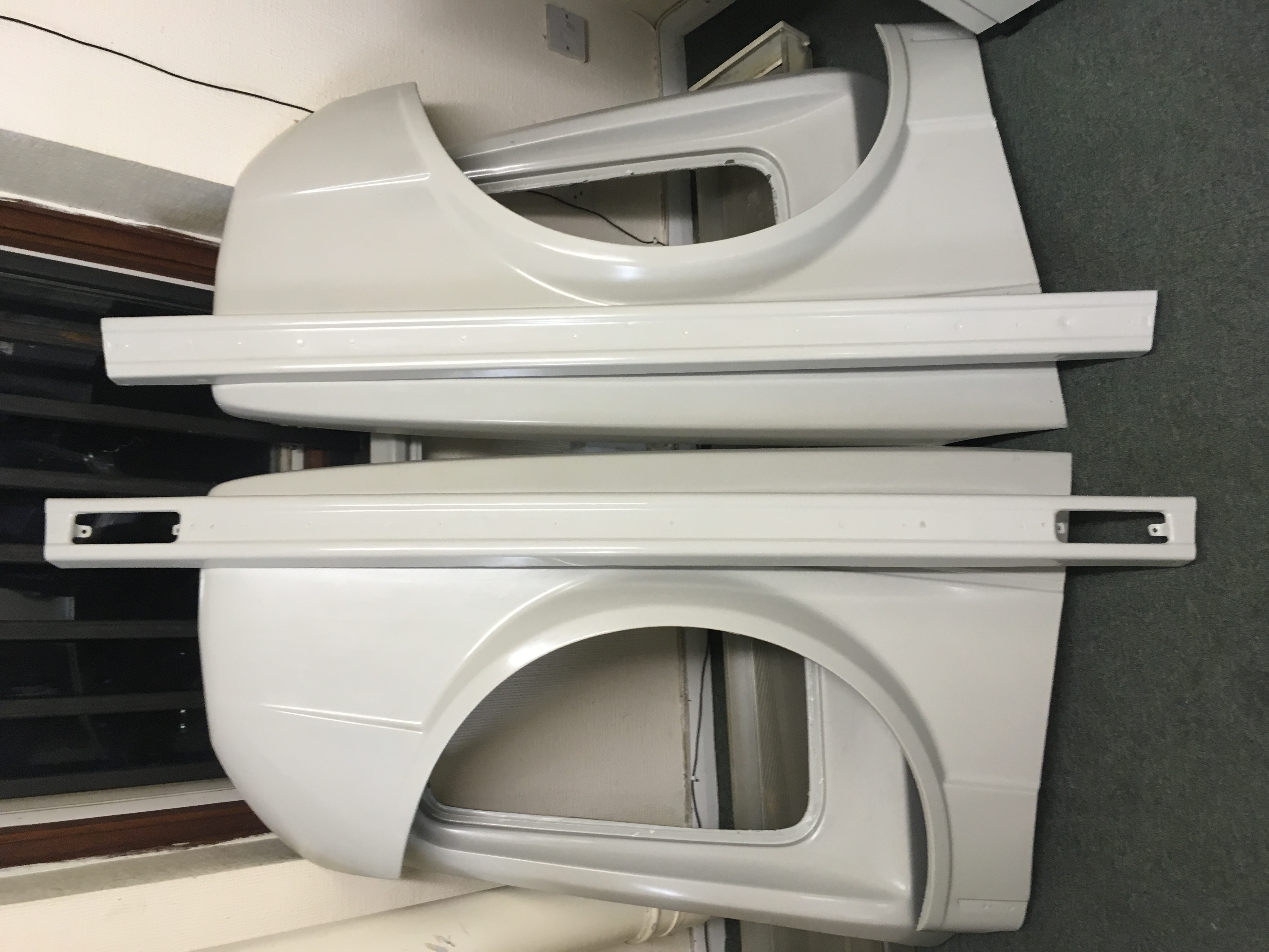

Picked up the carbon Kevlar panels!

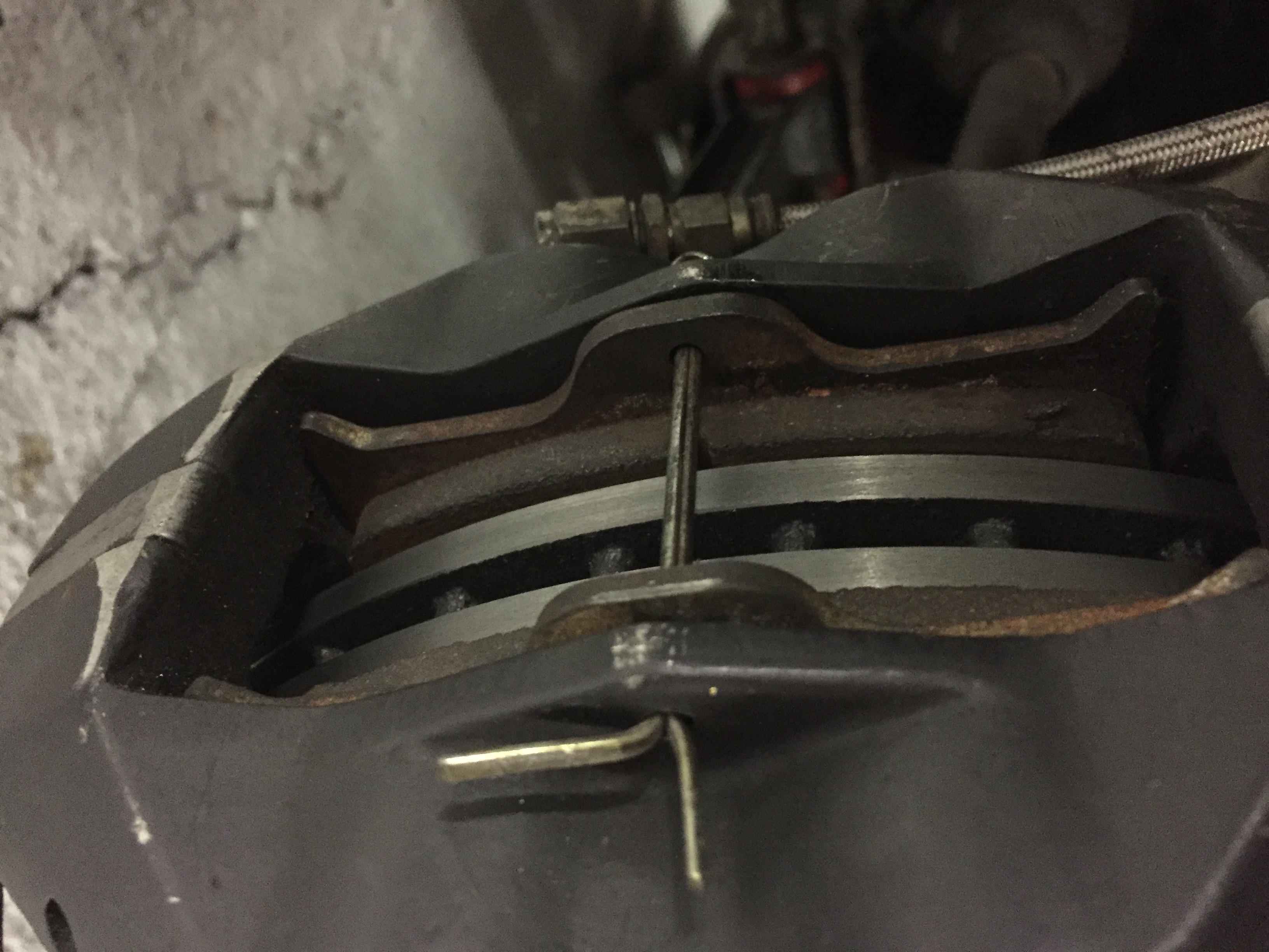

Hi Guys,

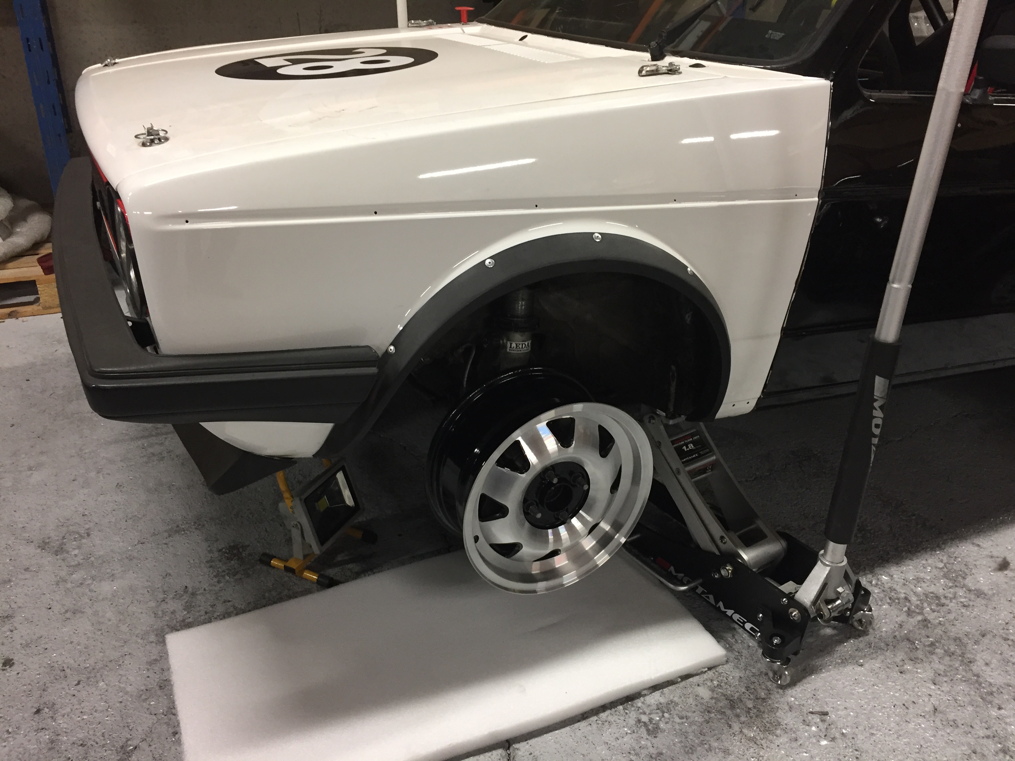

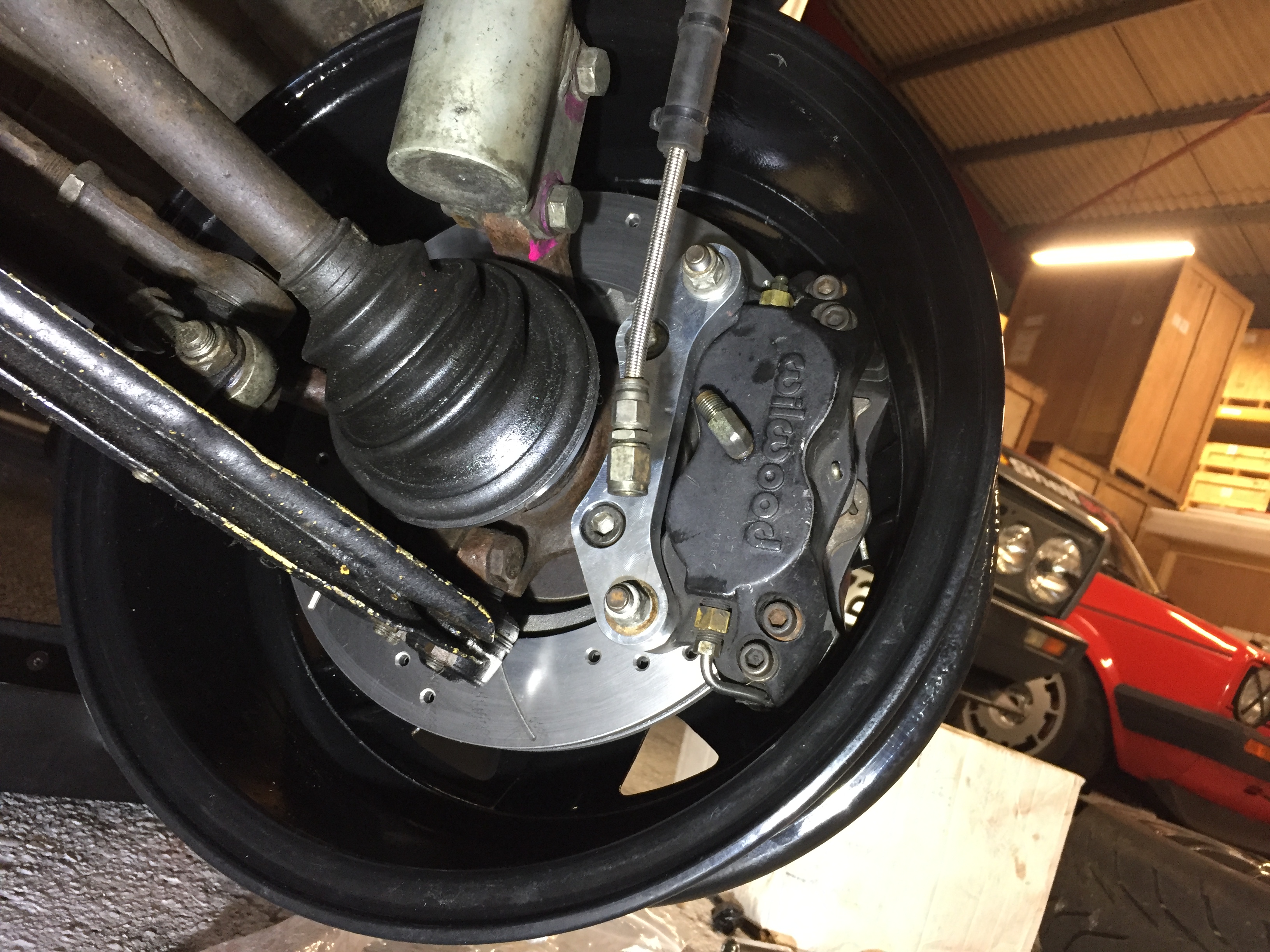

I think I am getting close to getting a four pot caliper in a 14in Golf ATS Cup wheel.
The original Mk1 Golf front discs are 239mm with a one pot steel caliper.
The Rover discs are machined and the new caliper brackets are finished. At first fit the caliper brackets needed 1mm machining off the mount face.

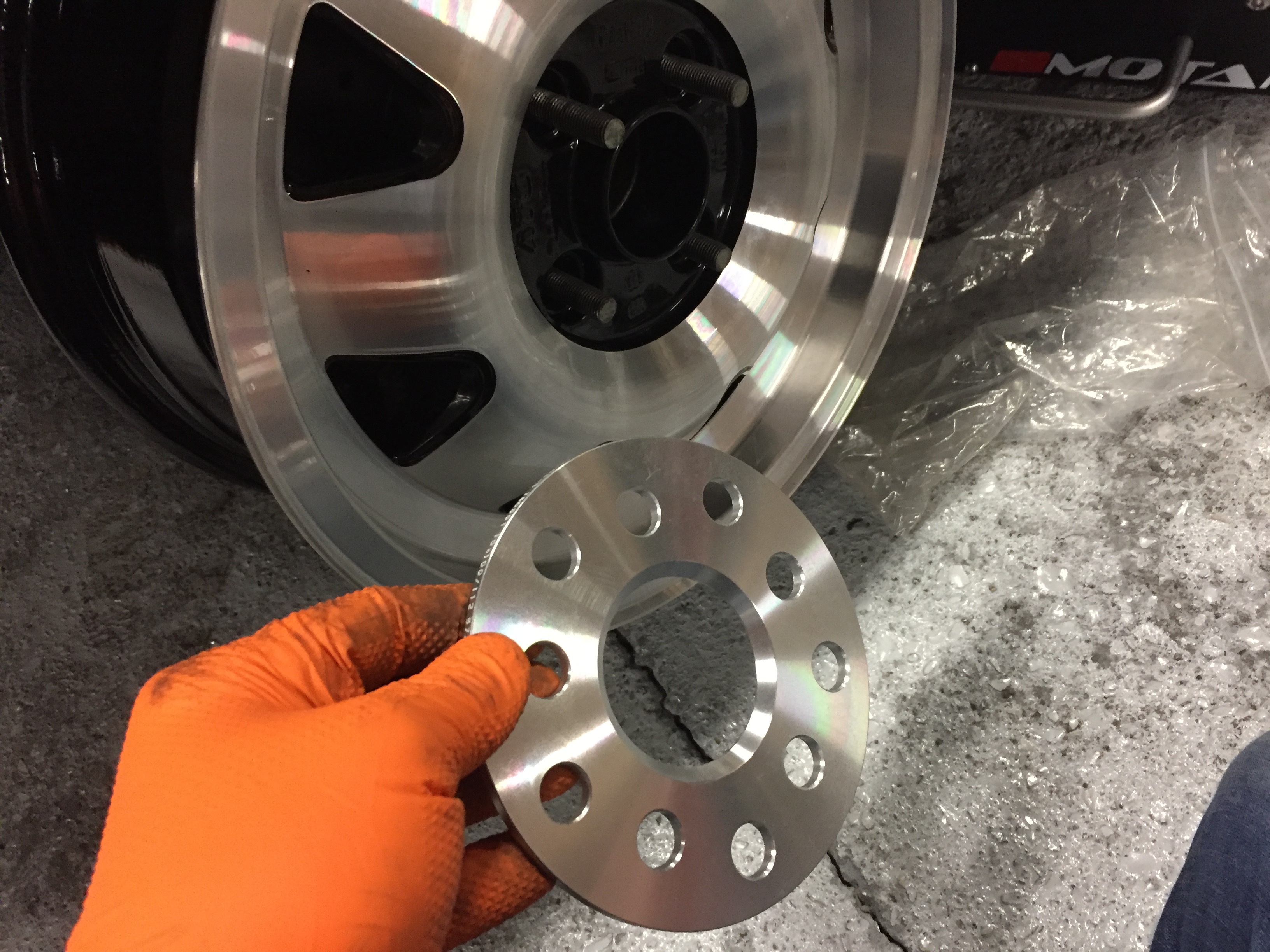

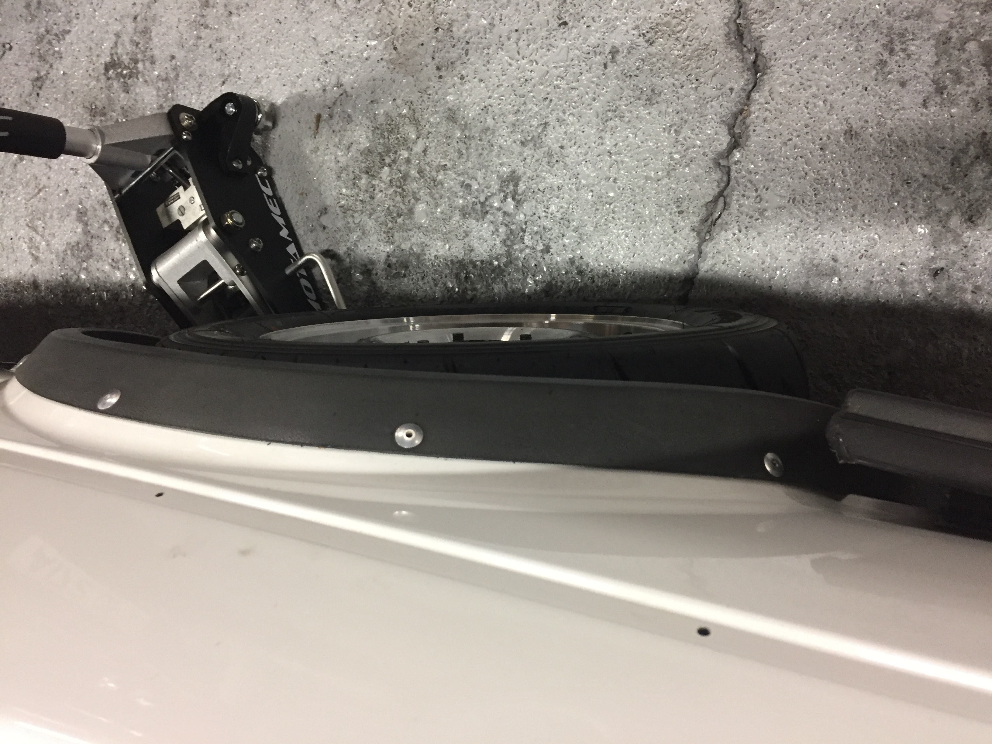

I was planning on no wheel spacers but I do need a 5mm spacer:
The disc is currently 256mm but can be 264mm. I have another pair of Tarox on the way.

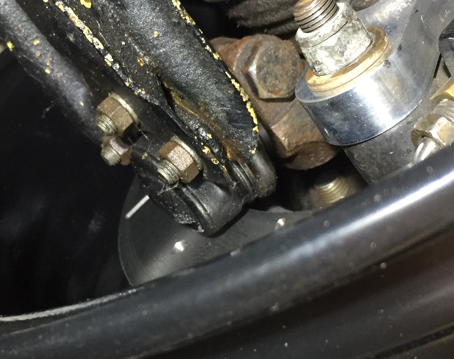

The lower ball joint clearance is not much. Here is the clearance with the wheel supporting the car weight.

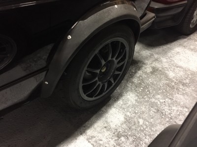

From these 15in wheels
To these:

Re: Escort Hunter Killer
Ball joint does look close to the disc as you say, only to get closer as the suspension arm pivots up and alters the angle between them.
Will be well worth making a heat shield for the ball joint rubber.
A lot of fords have a simple shield held in place by the ball joint pin, this then protects the rubber boot, with your bigger brakes it'll get fried and dry the grease out in no time!
Amazing work on the set up, really well thought out and engineered 8-)

Great advice thanks Kev. I will have a look at those Ford heat shields.

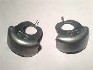

Could well be I meant Peugeot :roll:
No good having a memory so useless as mine!
Not at all sure what they usually come on now!
But simple enough to make something, if nothing shows up from anywhere..
They are like this, hole through the ball pin with a locktag to keep it from turning right round

Brilliant. Thanks Kev.

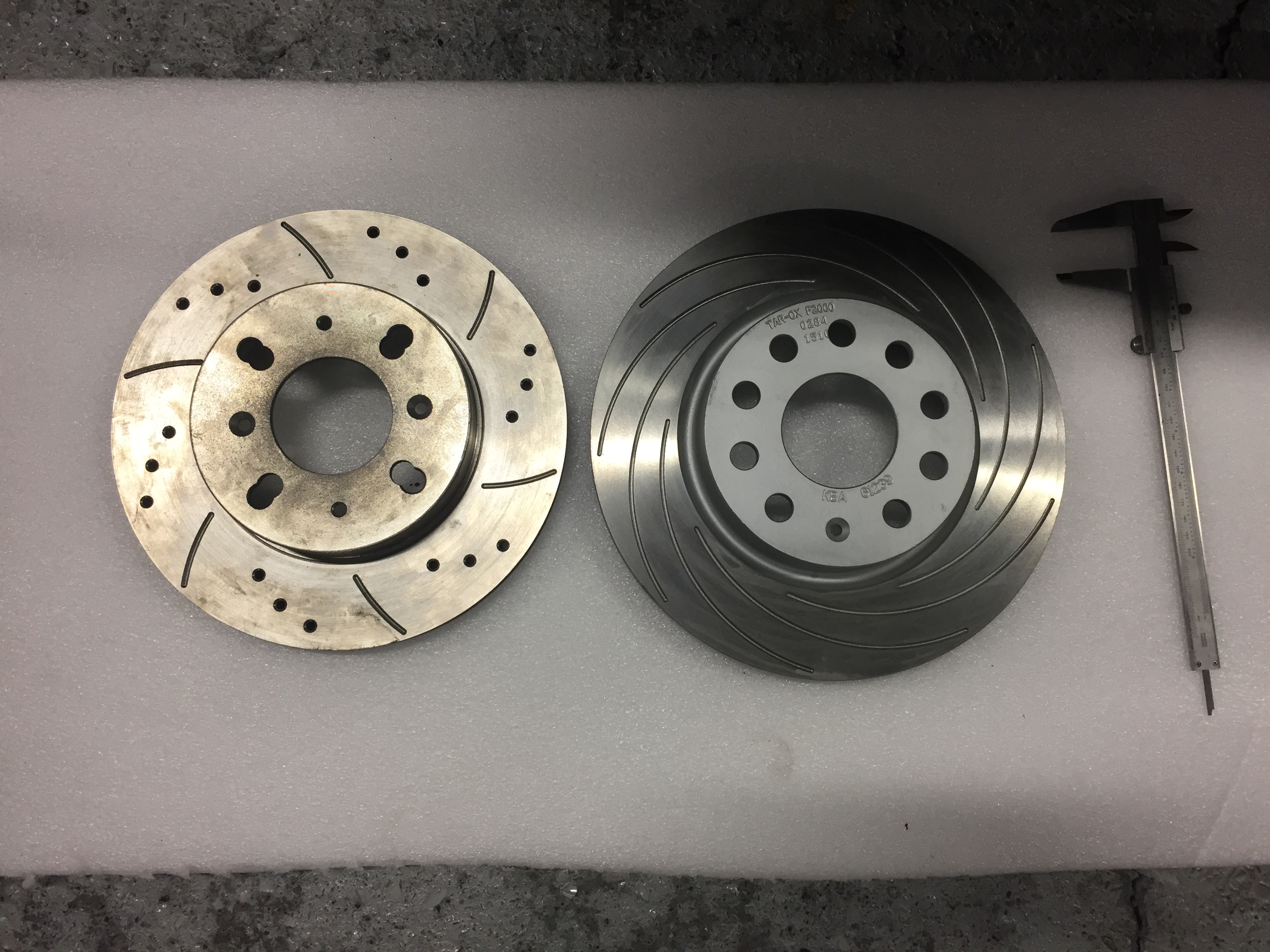

Hi Guys,

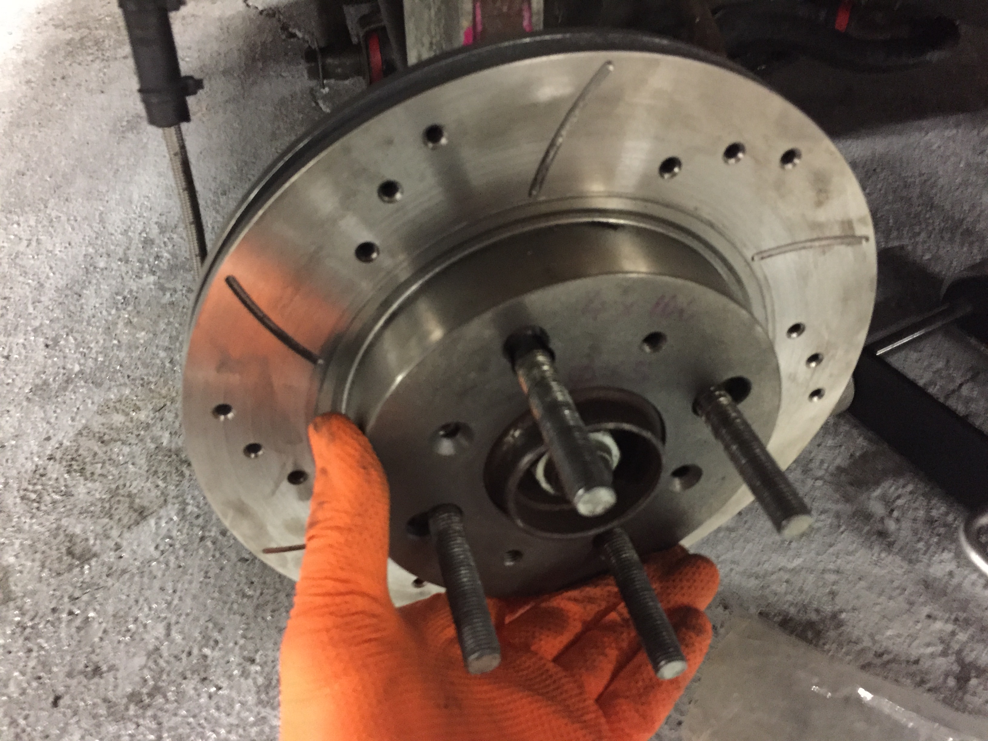

The Tarox discs arrived today. Much better quality than the MTEC ones but more than twice the price.
The disc diameter will be slight larger now to cover all of the pad area. 262mm instead of 256mm.

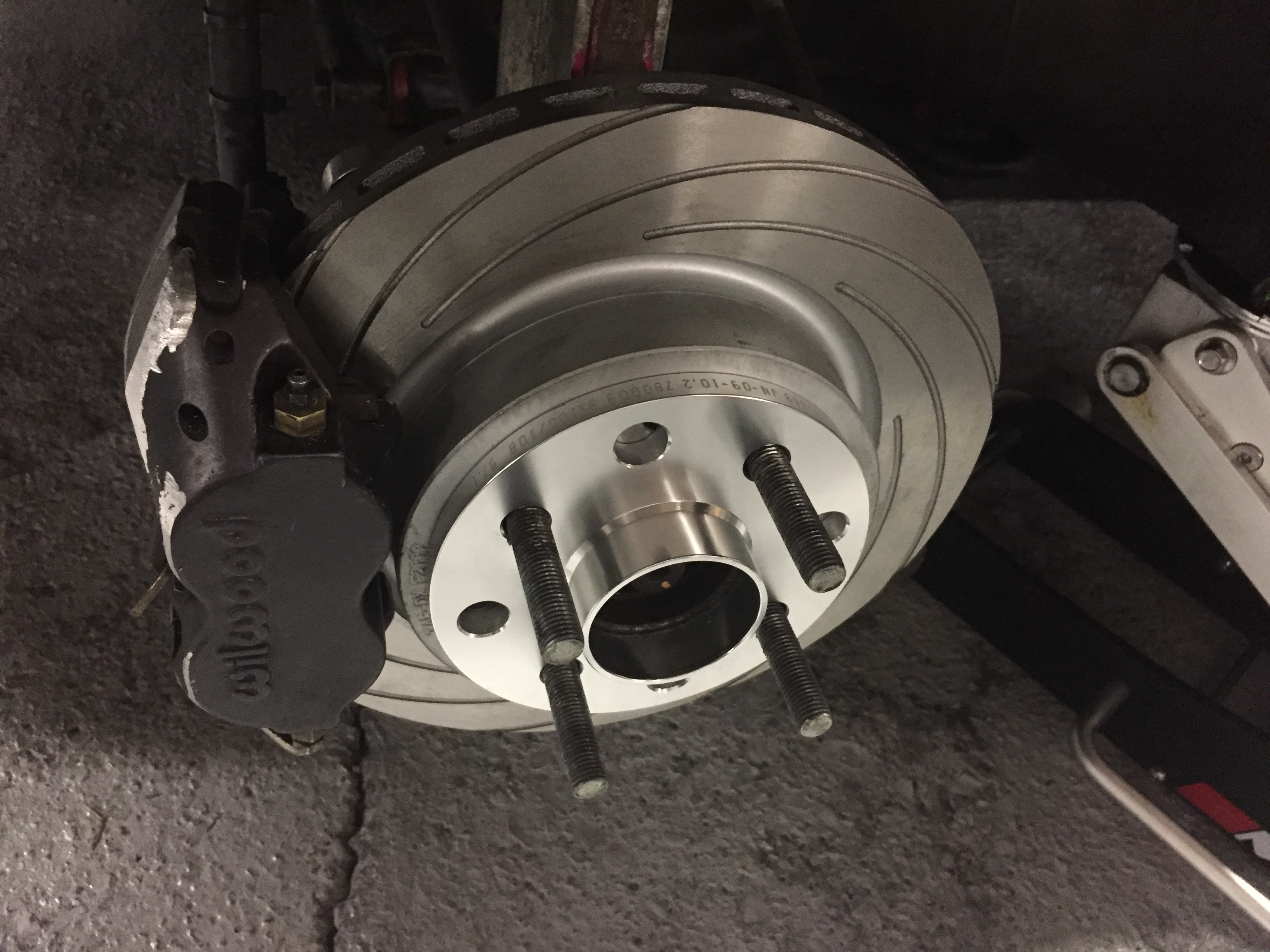

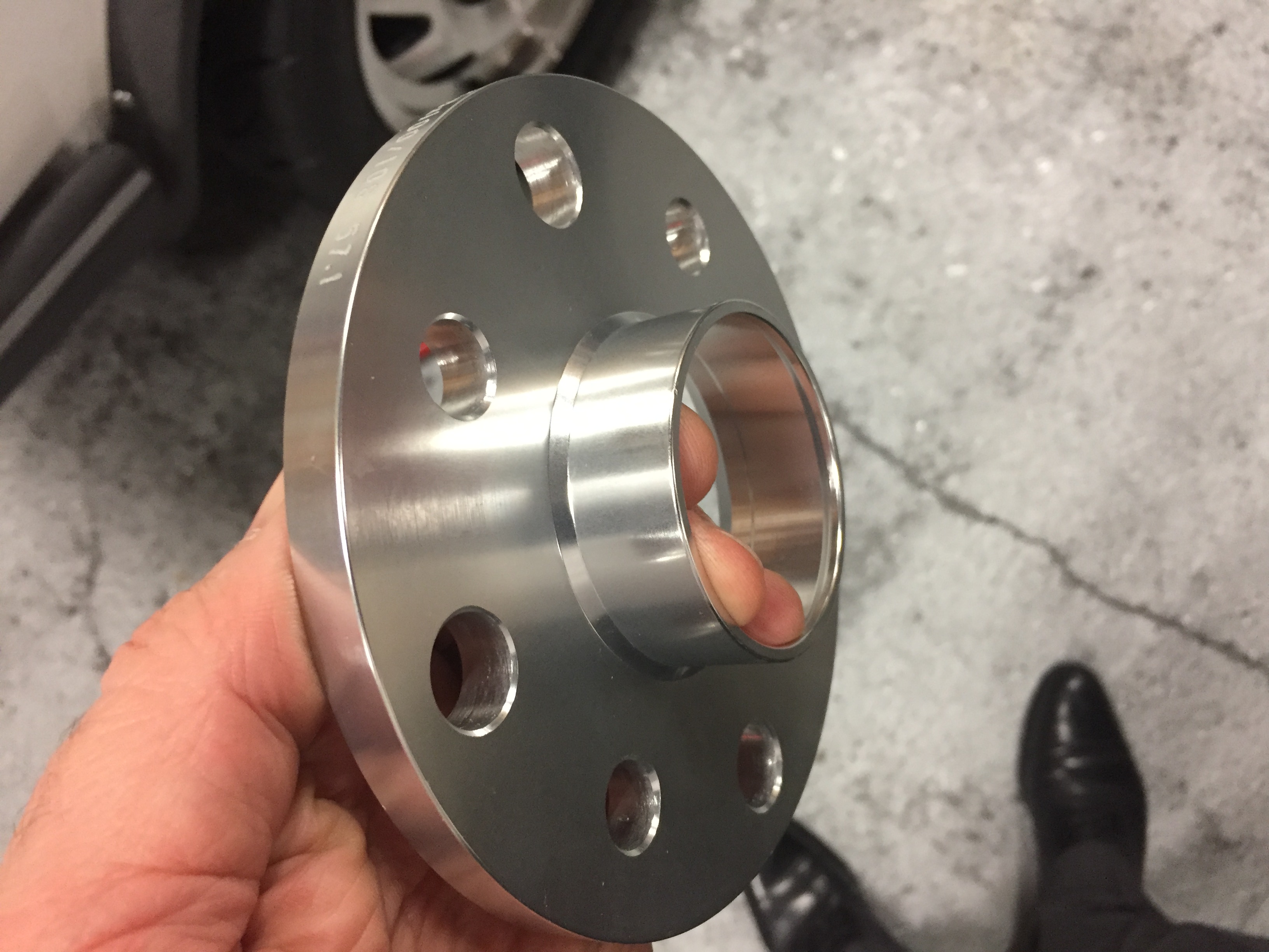

I ran in to a problem I want to share. This is the 5mm spacer:
The wheel was rubbing in one small area as if it was buckled. What I discovered by laying the wheel face down, adding the spacer, then the disc and then dropping in a spare hub - was that the hub was not locating the wheel concentrically.
The fix is to use a bigger spacer that has a concentric shoulder as follows:
I think the tyre will run within the arch ok but if not I will machine the back face of the spacer to take it down to 6mm.
Disc setup is pretty much finalised now:

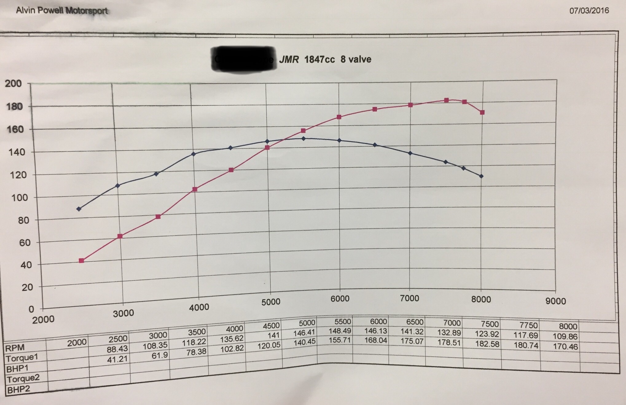

The Golf has carbs on it already - twin 45s I think. I have checked - and they are allowed. Should weigh in at 906Kg with empty fuel.
Here is a typical set of curves for the engine going in it:
Looks like a strong motor there Simon.

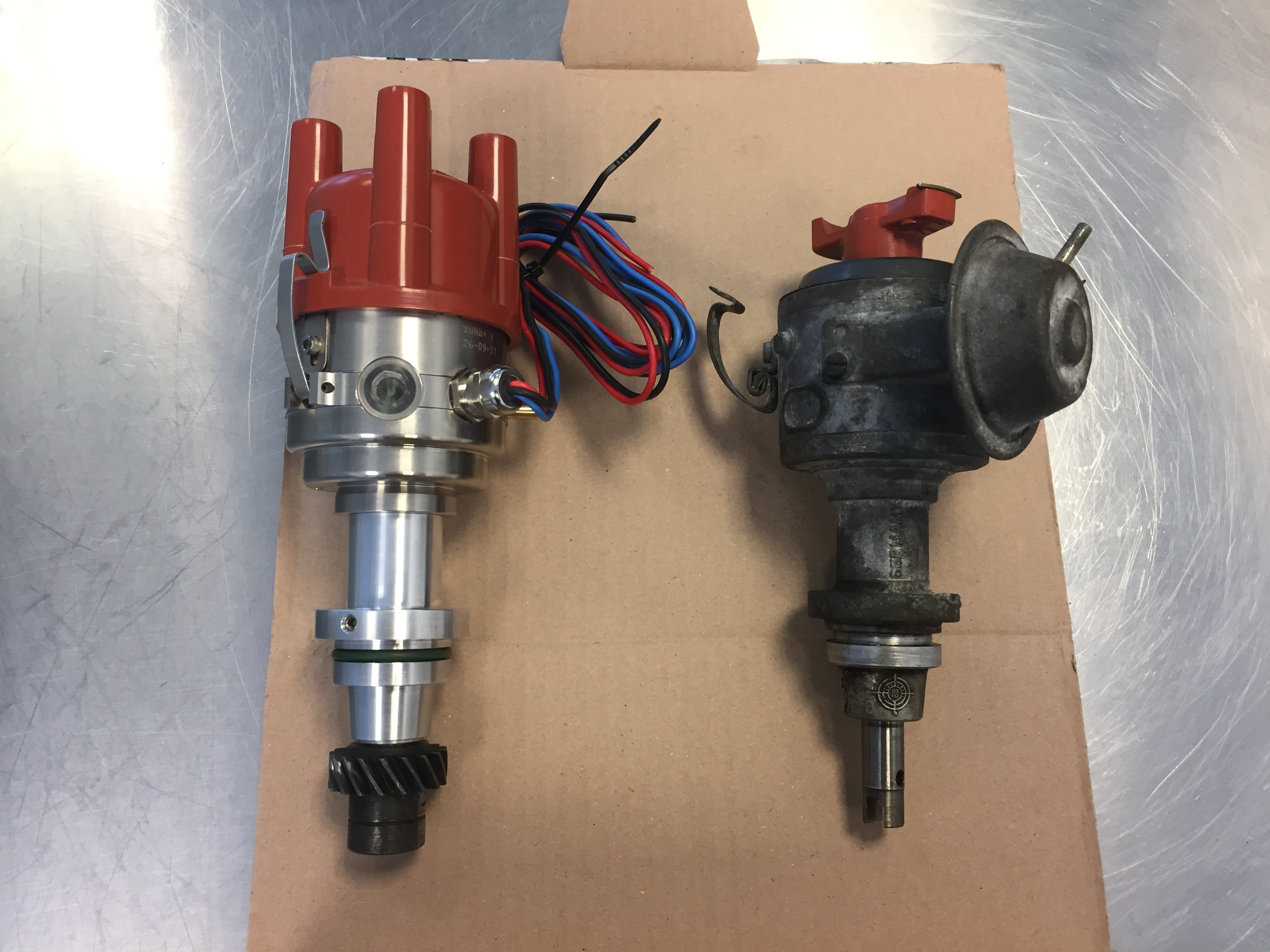

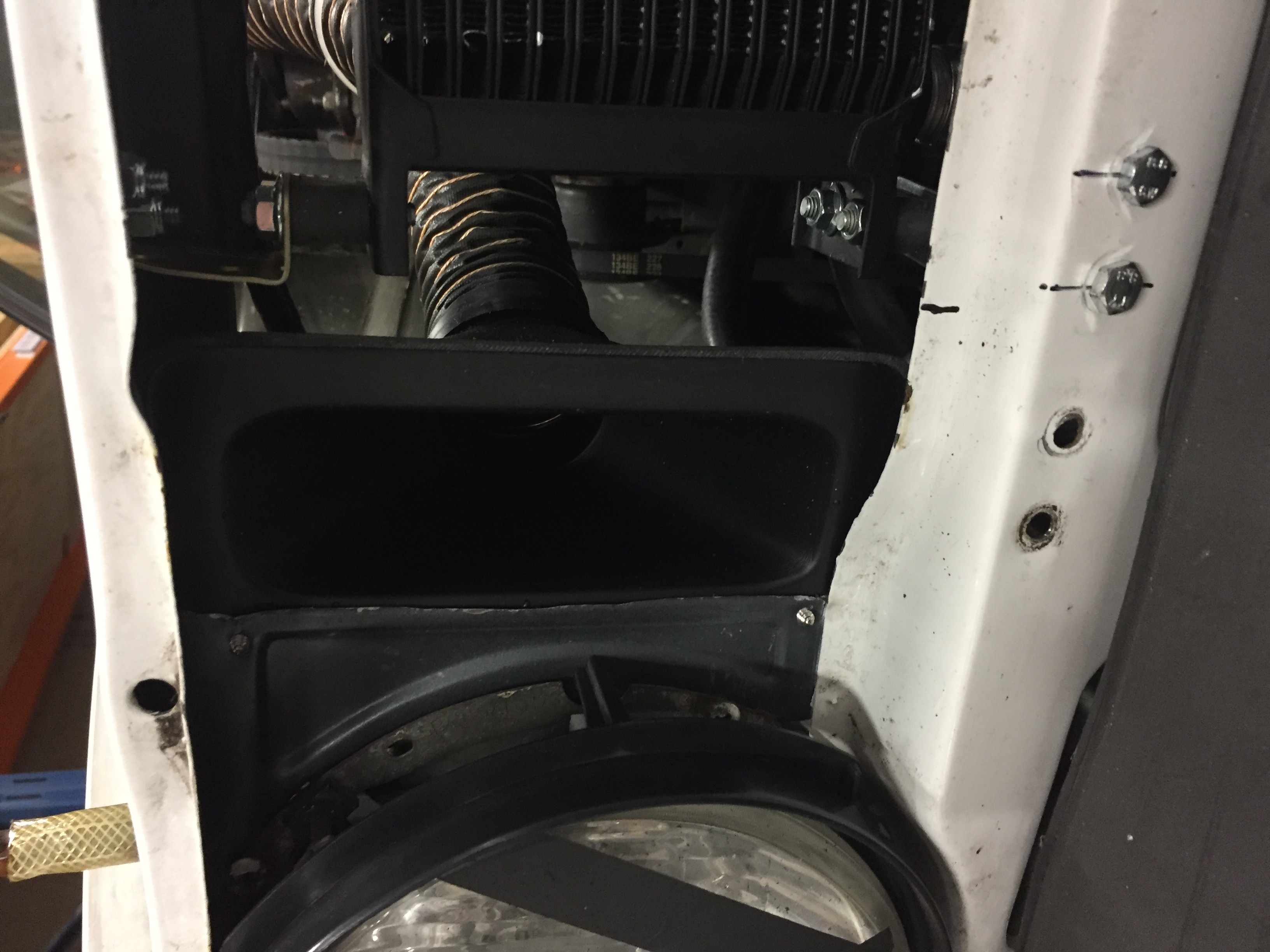

Hi Guys,
Getting a few jobs done so I can race at the end of this month at Silverstone.

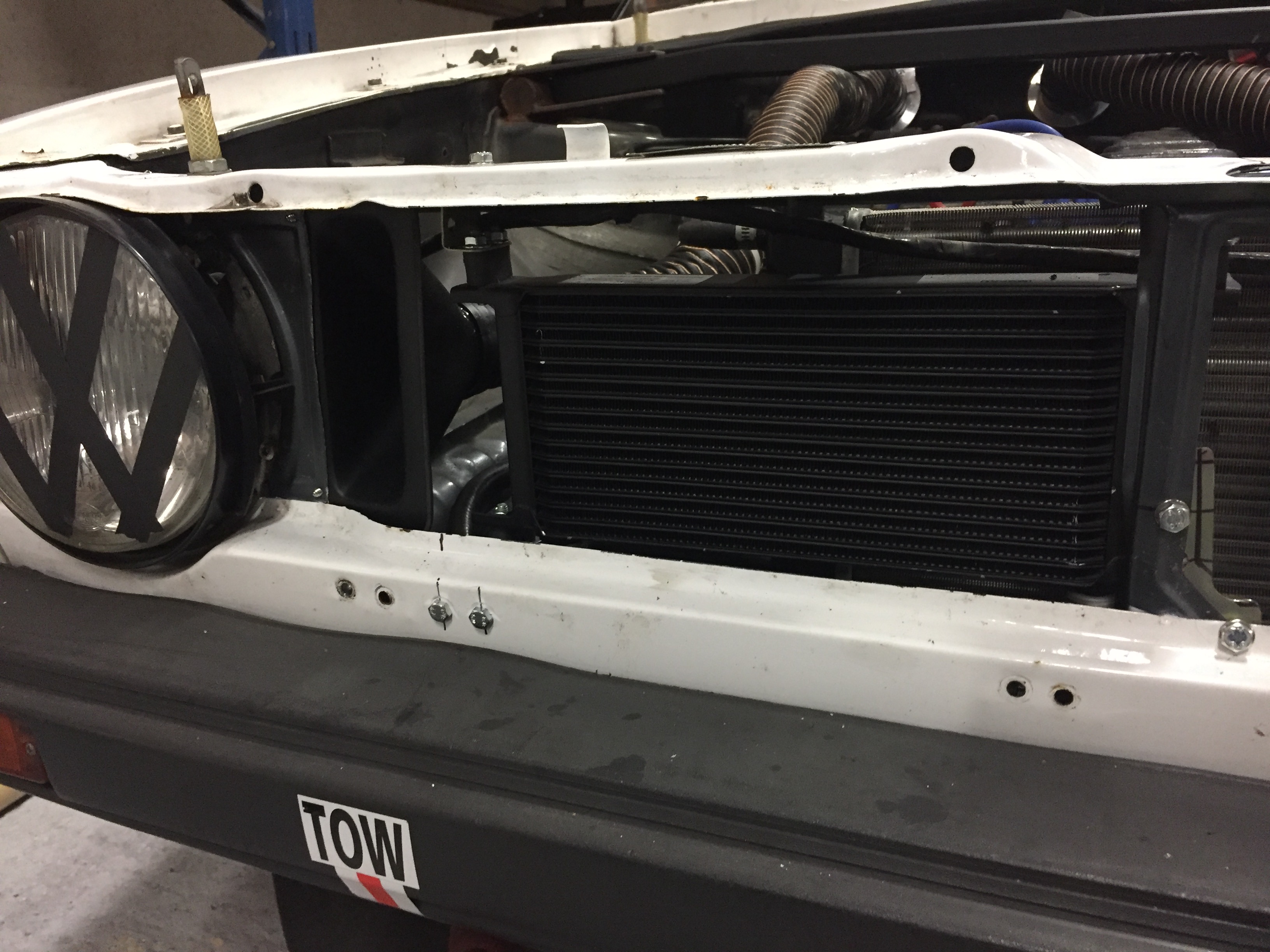

New oil cooler with 16 rows instead of 13.

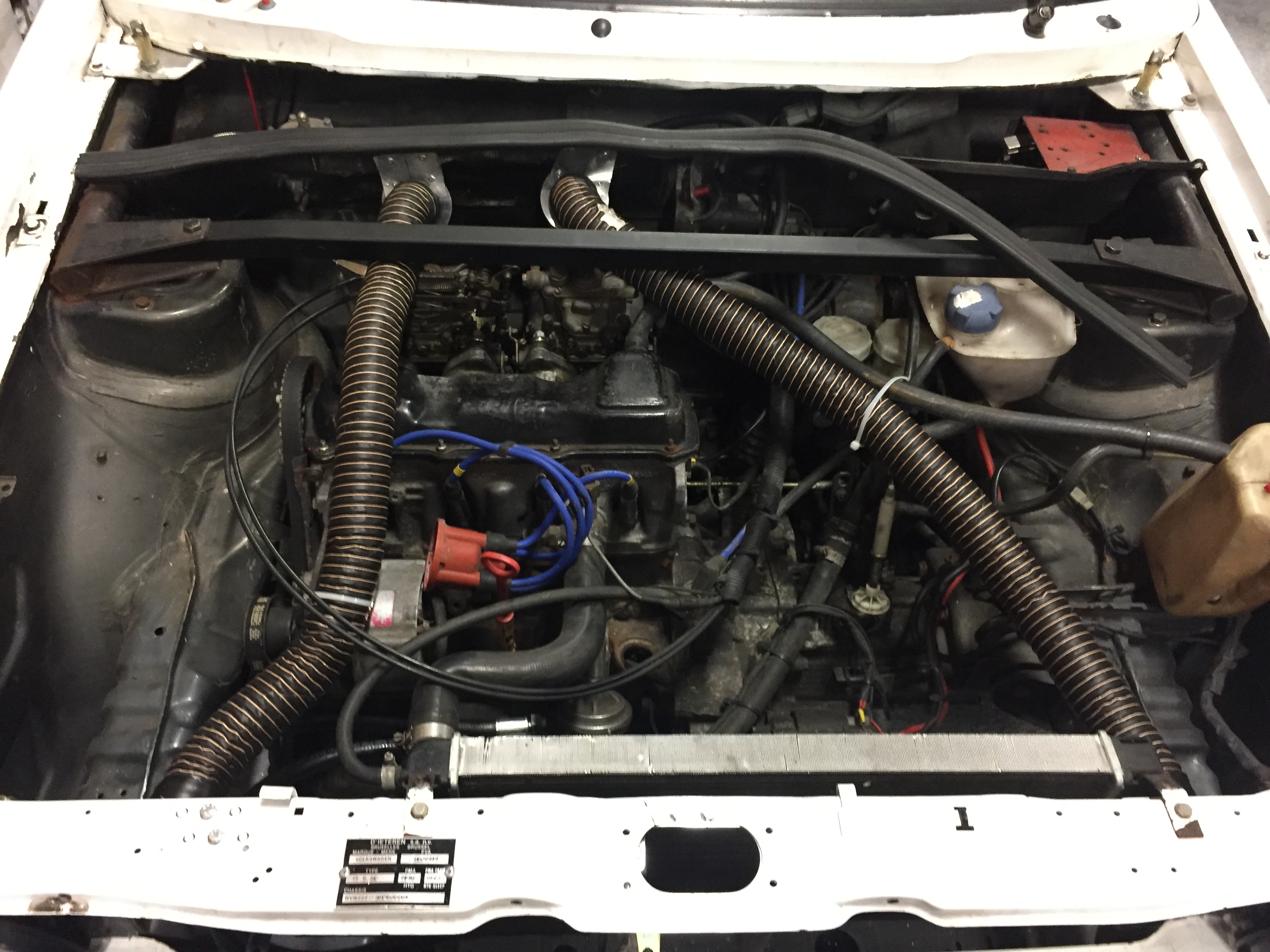

New fresh air vents and plumbing to wash fresh air over the carbs and take the exhaust heat downwards and under the car.
New Bluetooth distributor arrived today. They don’t make them so they produced a drawing from my old distributor.

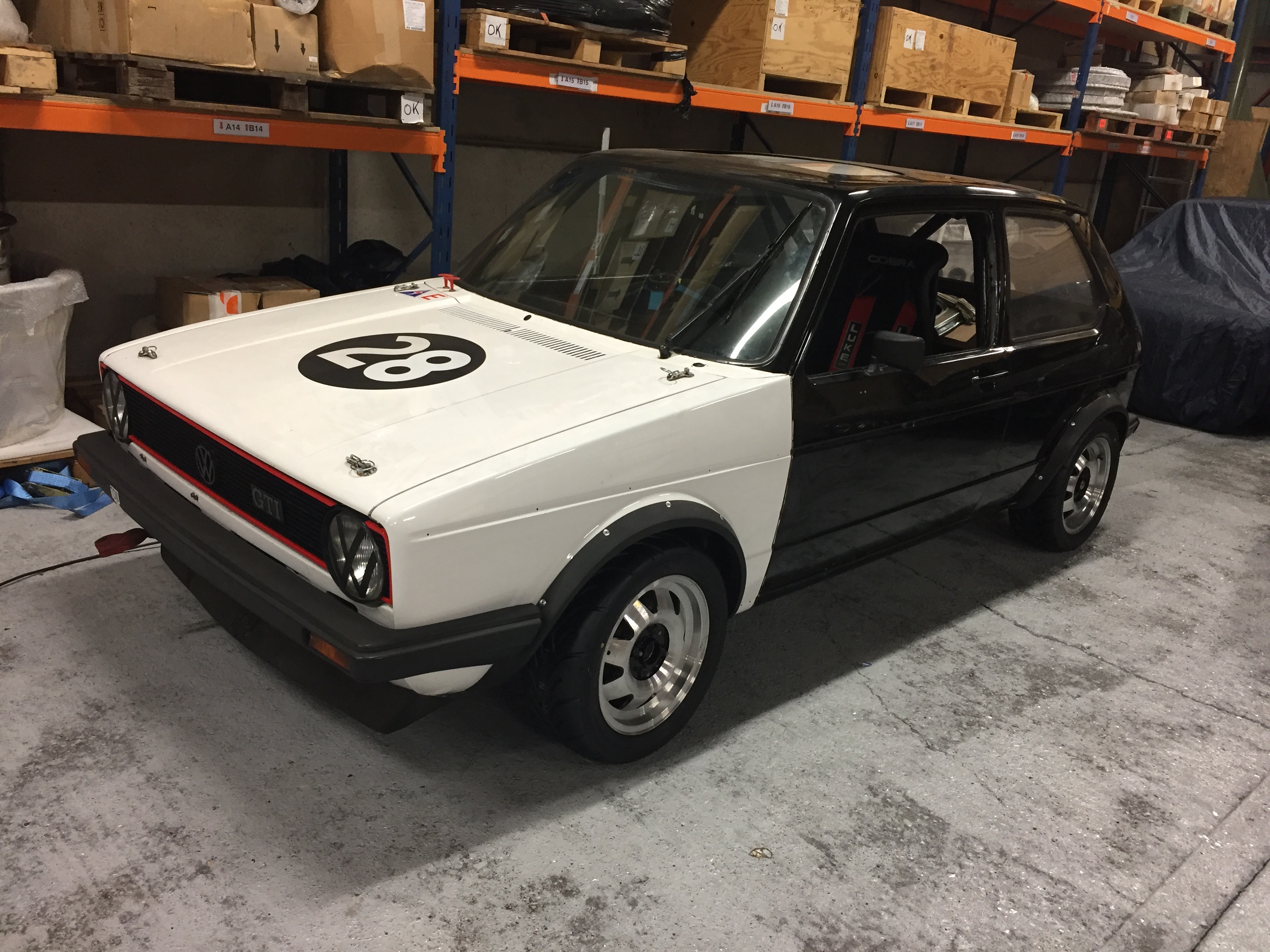

Hi Guys,
It’s a bit of a mad rush to get the car ready for Saturday. I have to add 30kg to be 5kg over min weight of 905kg.
It still needs to be painted some time this year and get the 190bhp JMR engine dropped in.
