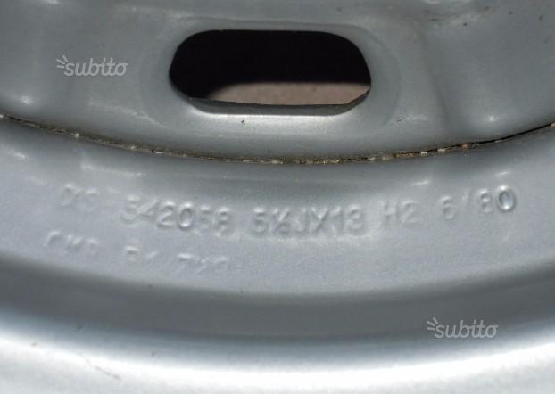

A gentleman in Italy is selling his 5 never used steel wheels from his Sprint Veloce. According to his advertisement he immediately replaced the steel wheels with alloys and therefore these are described as never used. The date stamp in the wheels state 1980 and the width is 5.5J which corresponds to some of the comments previously stated within this thread that the early vehicles had 4.5J and 5J wheels and the later ones the 5.5J. The advertised wheels from 1980 show a silverish colour, most probably the factory original colour.

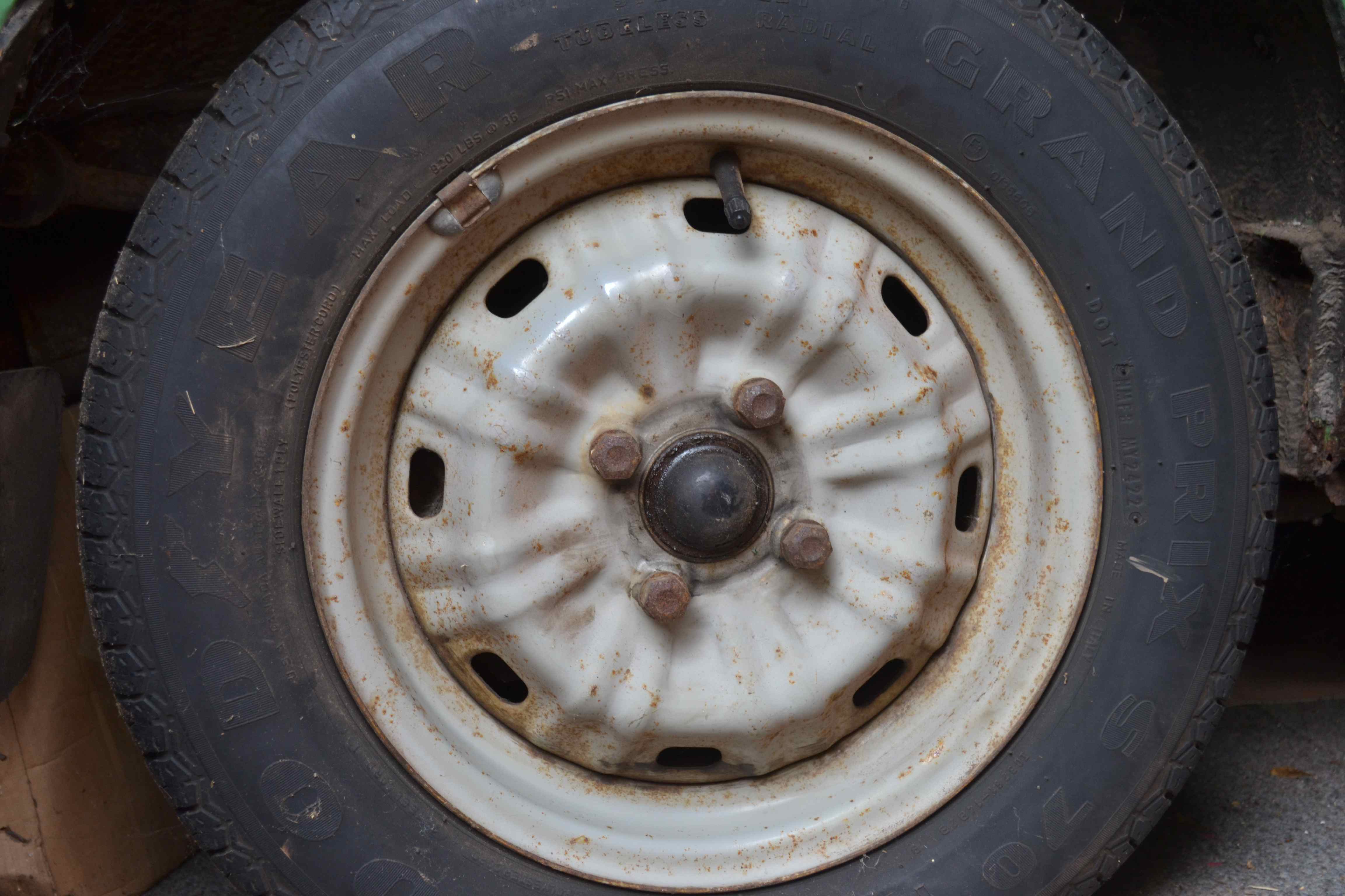

I need to correct my earlier post. I did not realise the wheel size was stamped on the rim. My S1 cars ( Yes I have two awaiting restoration ) have 5j wheels not 5.5j as I said in my first post. I remembered that a friend of the family had one of the first four speed saloons and that it had narrower tyres than my Ti and therefore made an assumption about wheel sizes. My apologies. I presume the first cars had 4.5j wheels ? My 1976 car had inner tubes on all four wheels when I bought it in 1978 and I am 90% sure that was how it left the factory the wheels not having a lip to hold the tyre in place. Not that that stopped local tyre fitters throwing away the inner tubes.
If someone has a handbook for a series one car this should confirm wheel sizes. As for colour I tried T cutting a small area as I think the blue colour has faded over the years but it did not make any difference? I shall try and attach a photo.
