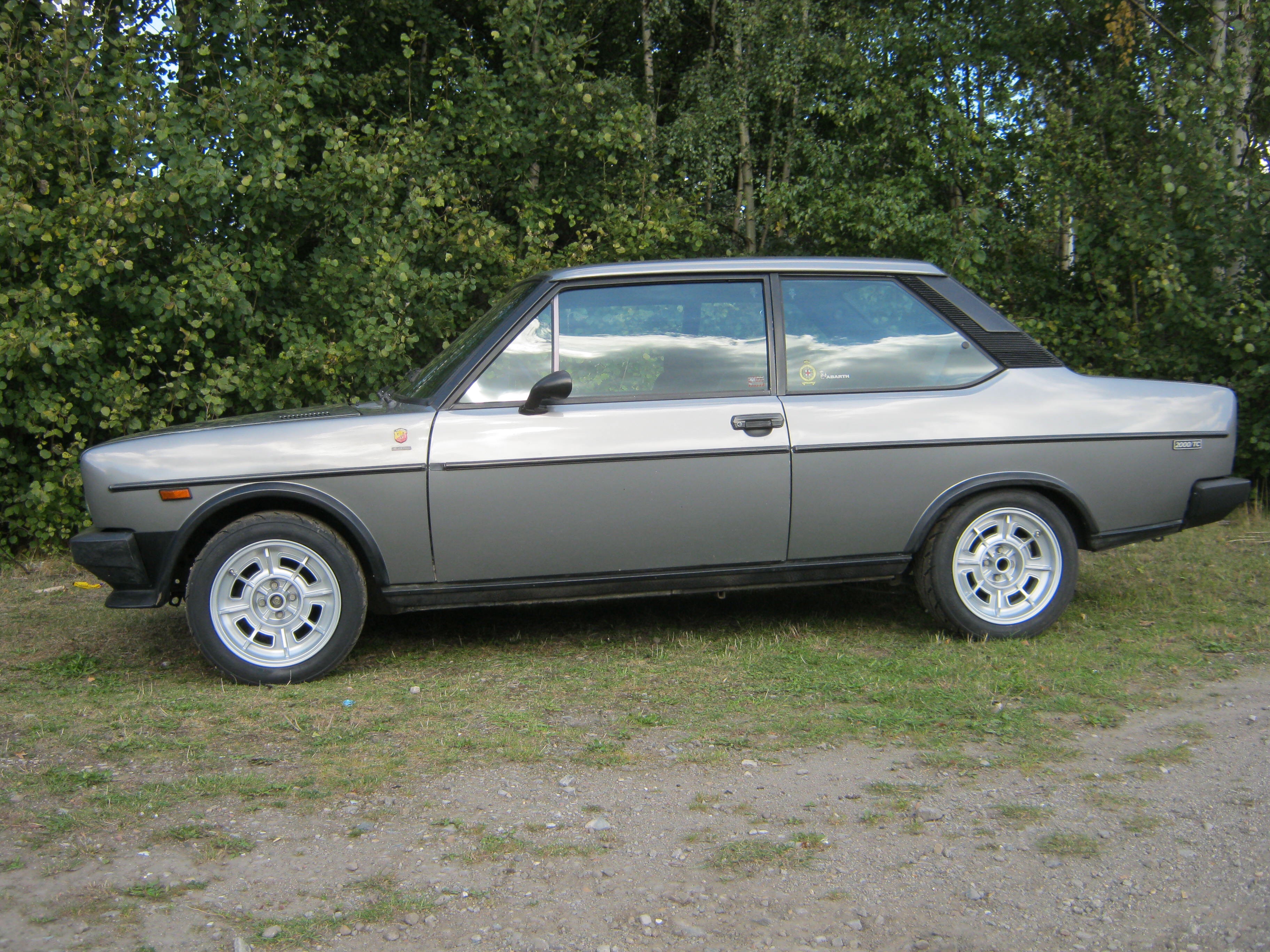

The new wheels are on. Transforms the look of the car:
Re: Racing Saloon
Very nice Simon.
Re: Racing Saloon
It's like winding the clock back a decade - very nice
Re: Racing Saloon
thought those wheels would suit it, very nice too

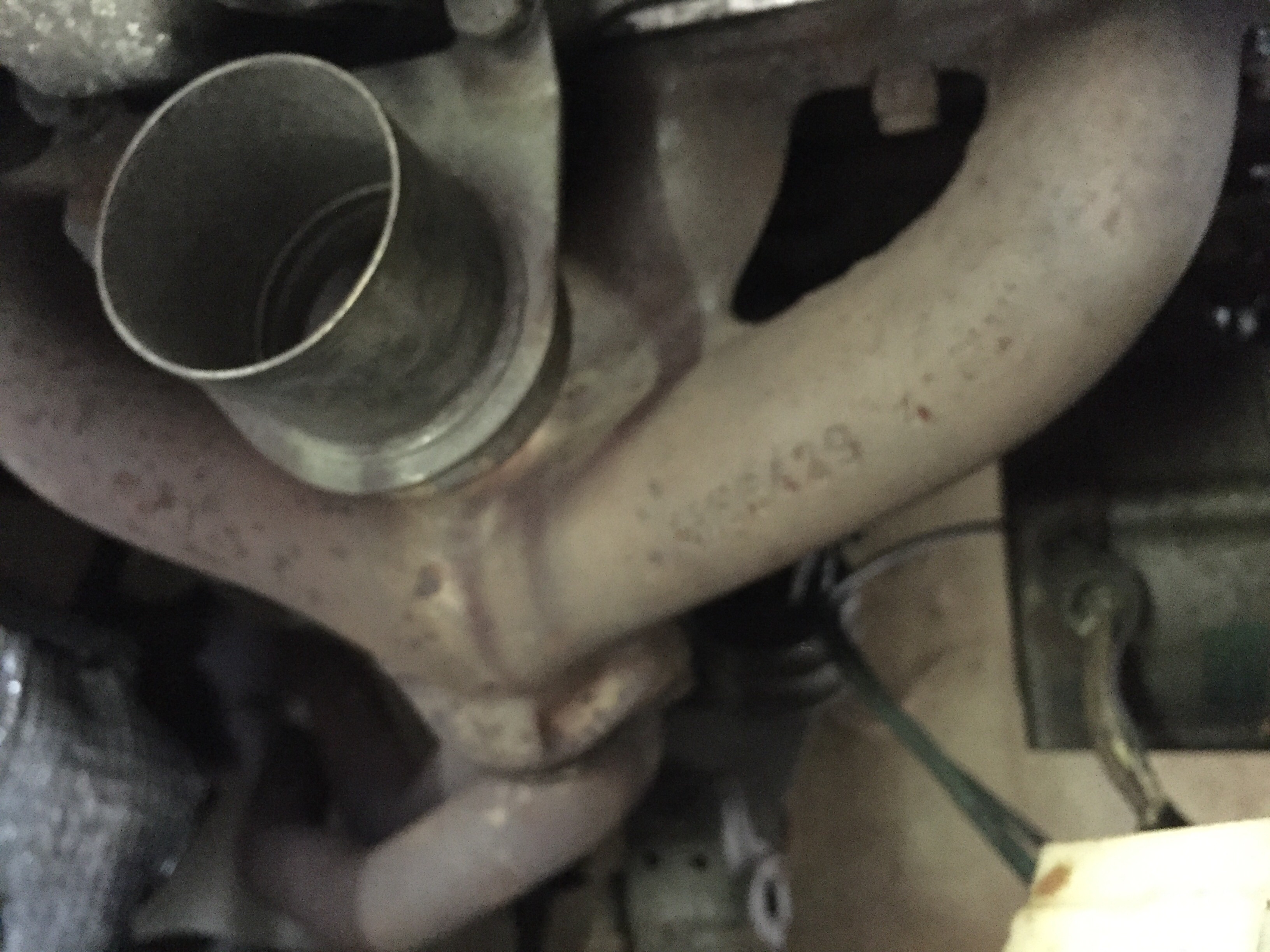

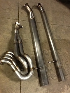

Original exhaust manifold:

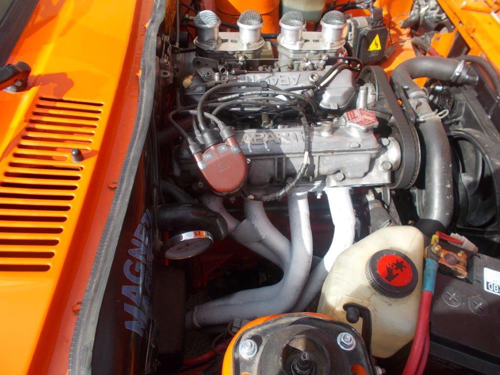

I am advised that the new manifold should have equal length primary tubes like this:
But supercharged engines need to be able to breathe so bigger diameter primary's like this:
And a large diameter exhaust pipe like this:
This shows a 3in oval and a 2.5in round.

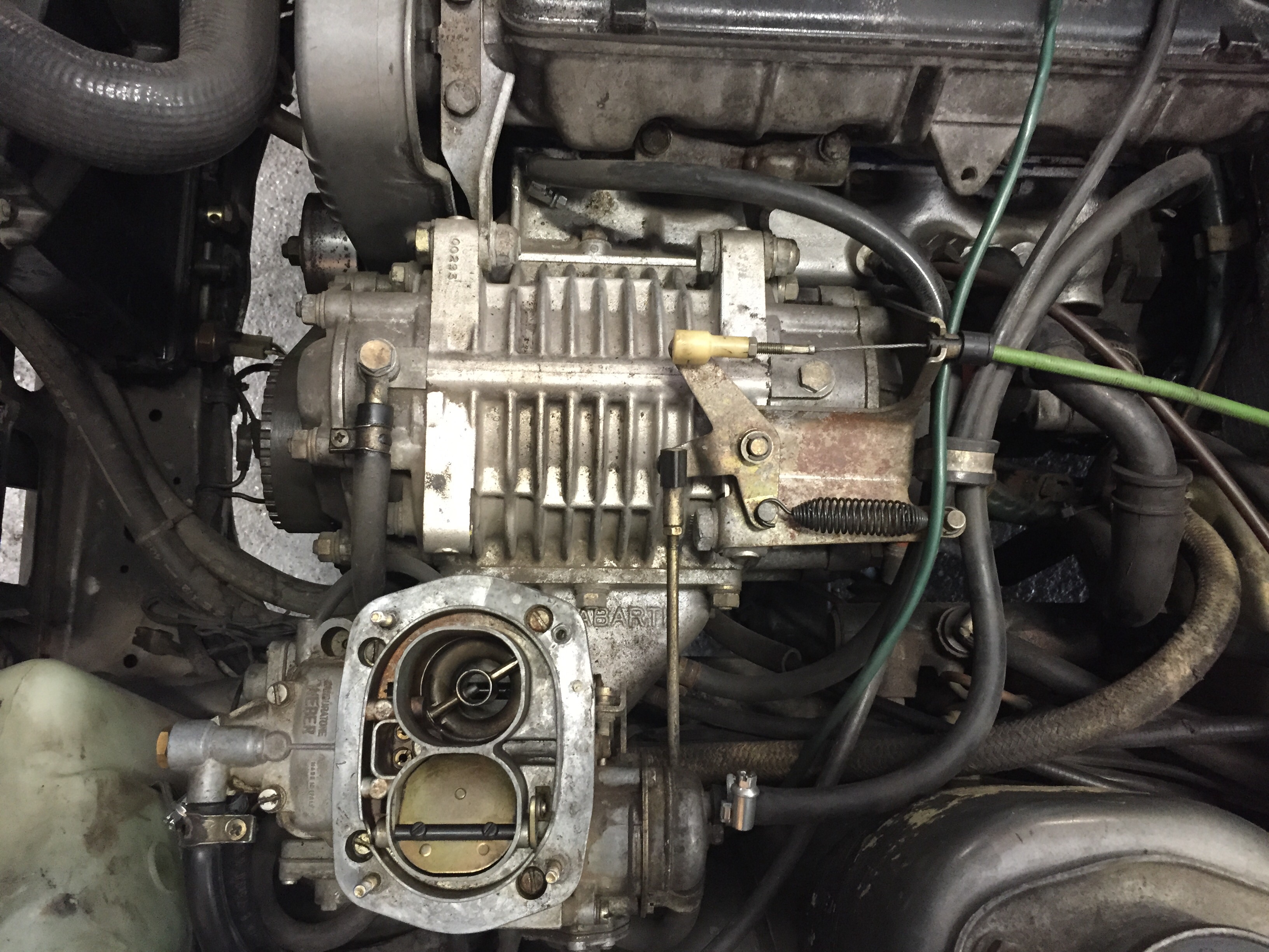

Re: Racing Saloon
Impressive manifold and exhaust......What would the big carb be, 48 ?

- Posts: 976
Re: Racing Saloon
Hi Tim,
The engine is for a racing Fiat 124. The Carb is a twin choke 45 DCOE.
I am advised that the original carb will easily do the job if you fit bigger chokes.
