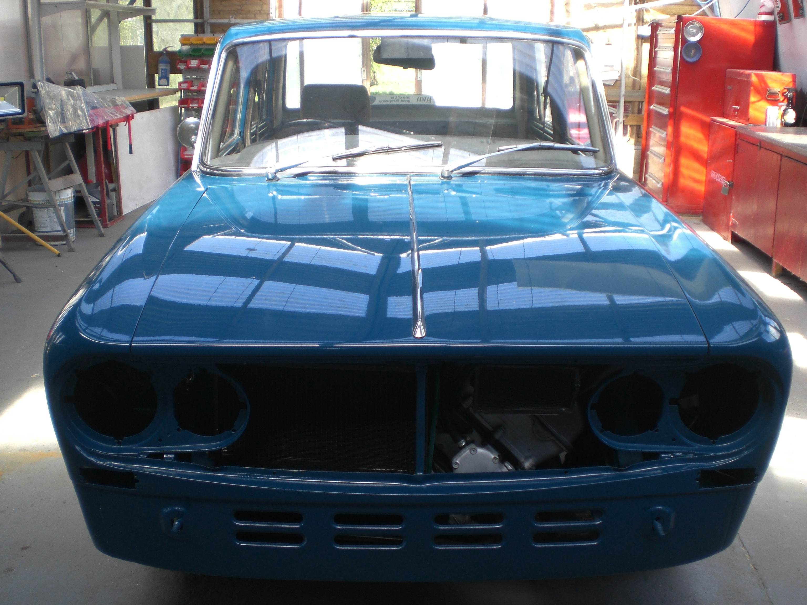

met rich for some refurbished parts last night so this afternoon the plan was to make some decent progress....a later than planned start didn't bode well.
radiator was my first task, how hard could it be to fit it and plumb in? turns out harder than I thought!
there was hardly any room to fit it in let alone get at the mounting bolts
alternator had to be removed which allowed just enough space, a few more tweaks and it is now where it needs to be.
once I'd sorted out the hoses, and which ones I still need to find it was time to move onto something else.

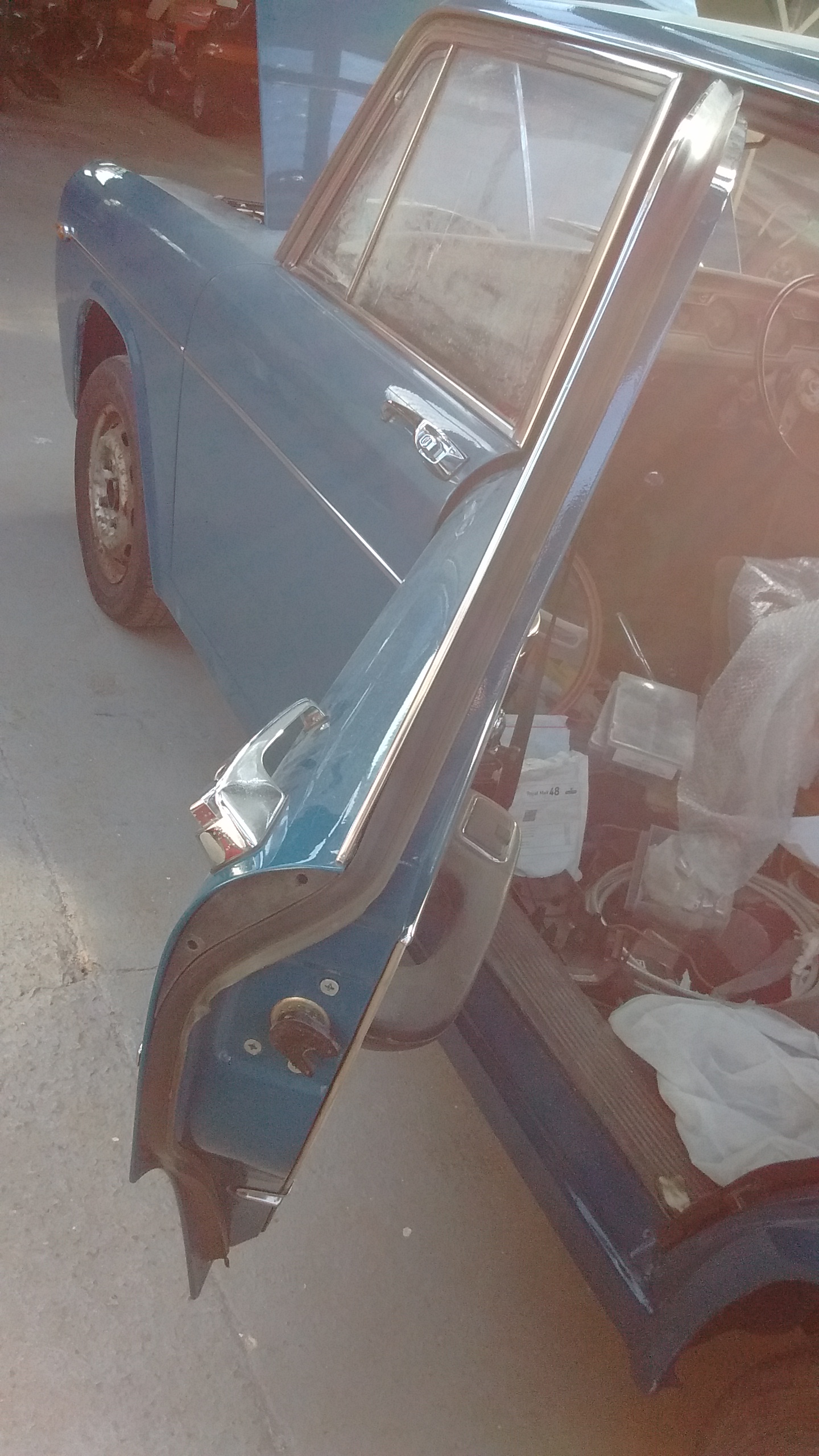

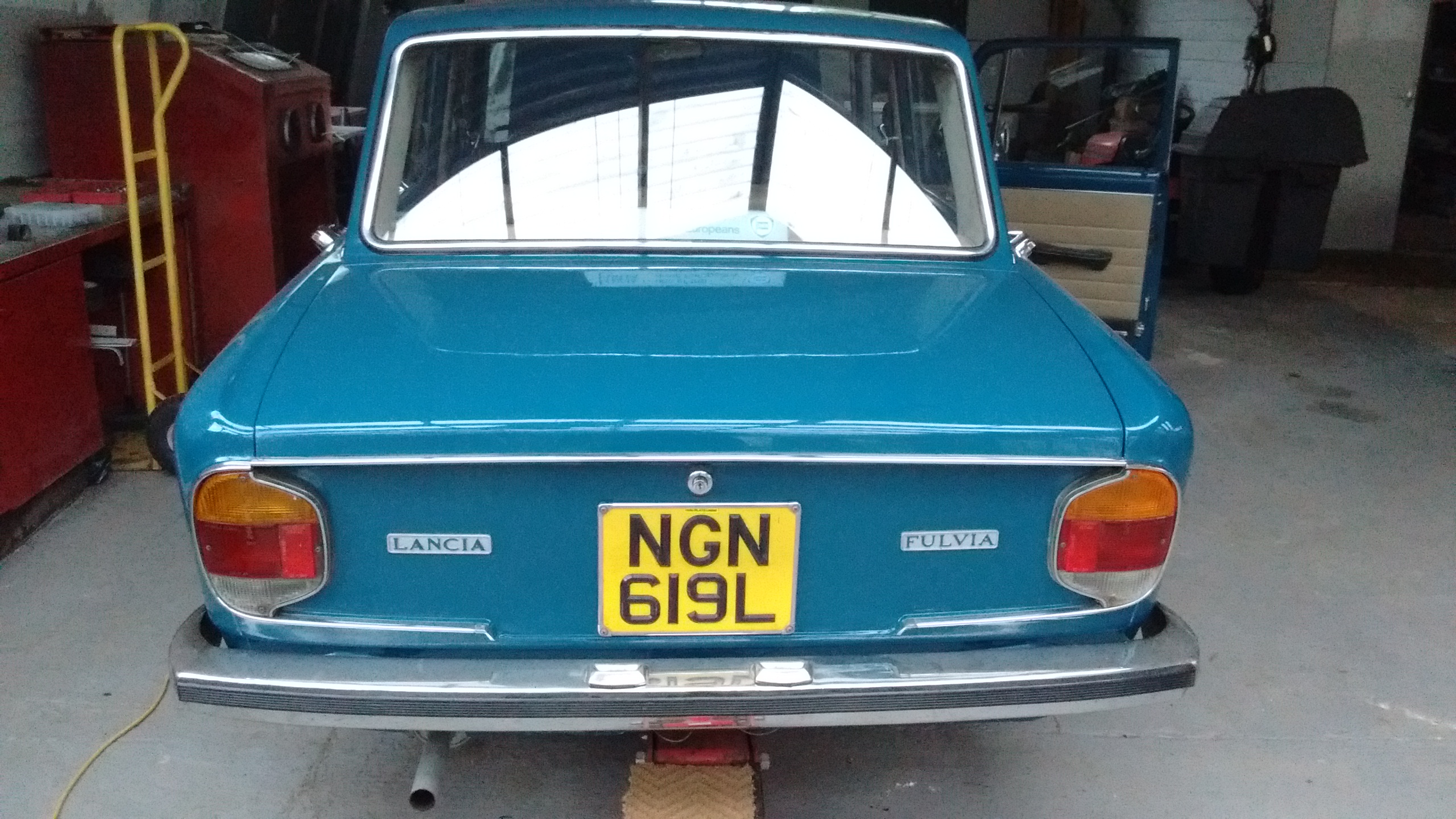

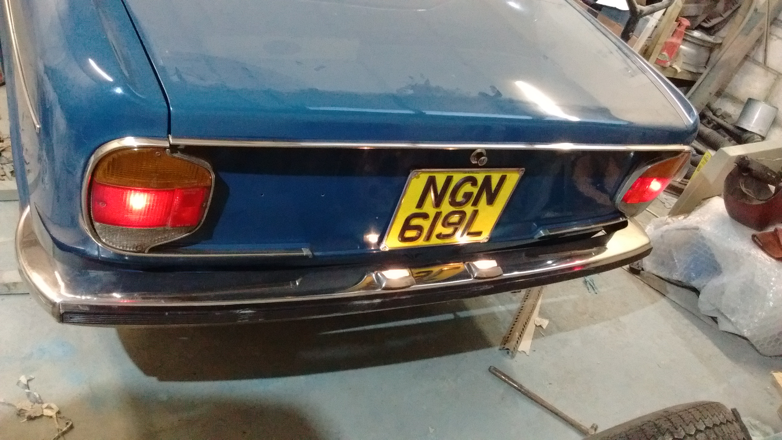

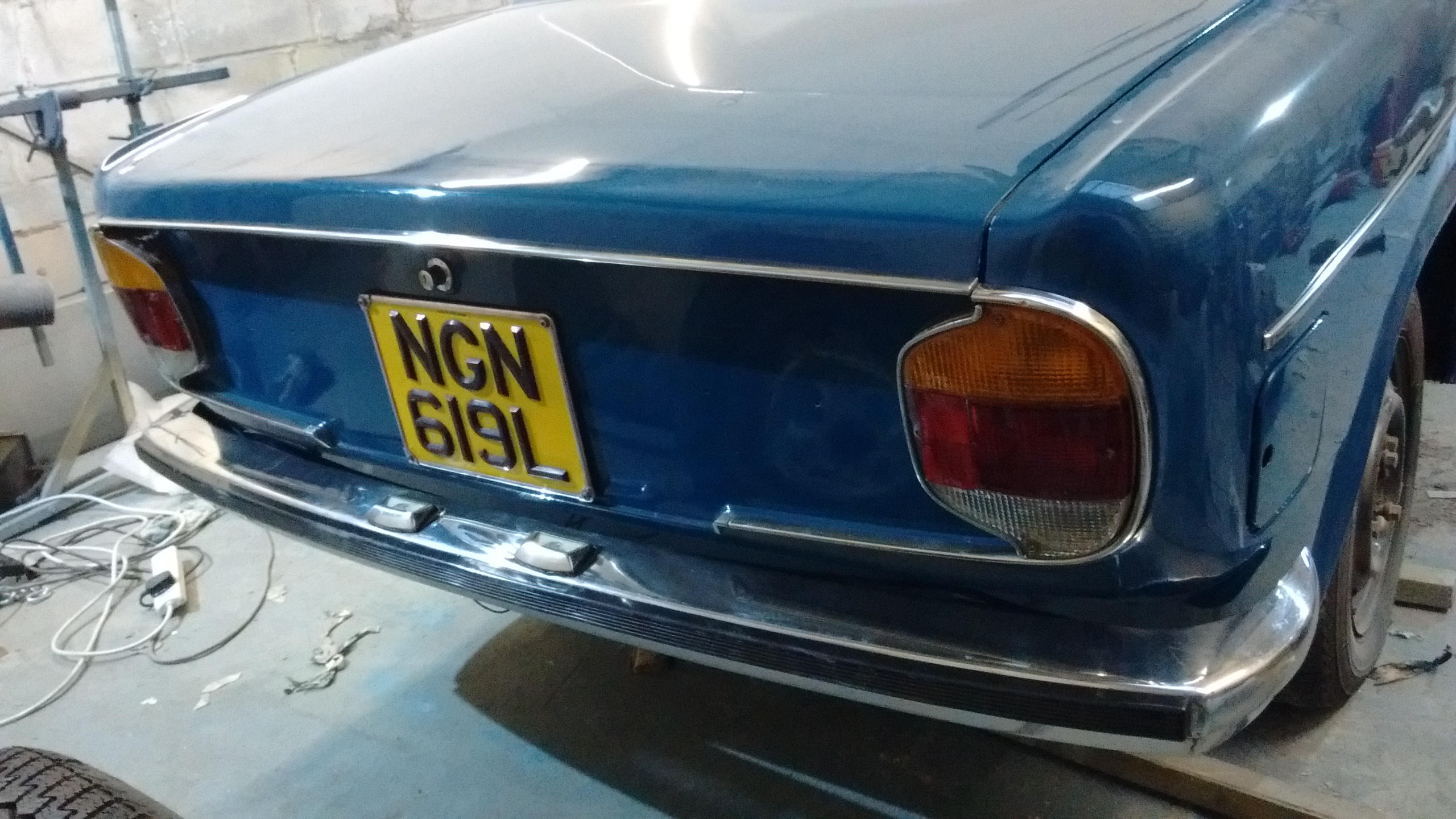

as the rear bumper has been nicely cleaned up and brought back I fitted it to the car along with the nicely cleaned number plate lights
original spec rear number plate is a great touch, no web address or anything, looks perfect on the car

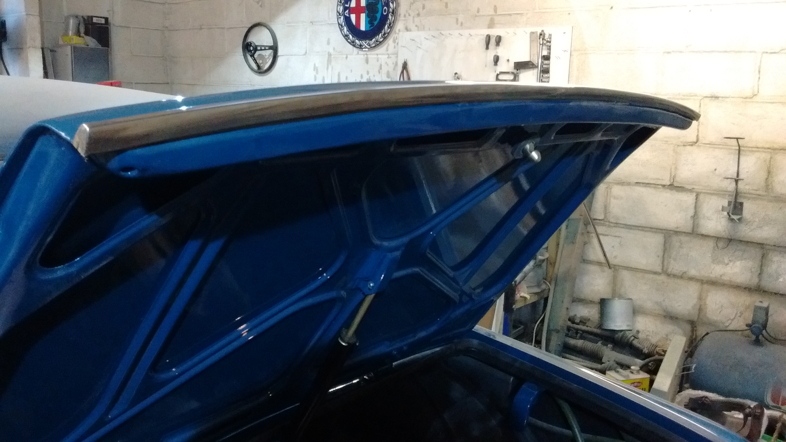

the edge trim on the bootlid was then cleaned up and fitted back on with loads of waxoyl behind the metal fittings, most likely to ooze out a bit in the summer but better than having none in the and causing corrosion..
the last boot seal I'd ordered was too thin so I got a bigger one, seems a tad too big at the moment but it may well ease up a little and allow the latch to be tightened back down to pull the edge back into line
whilst in the mood for making the outside look pretty I sorted the final front wing stainless trims out

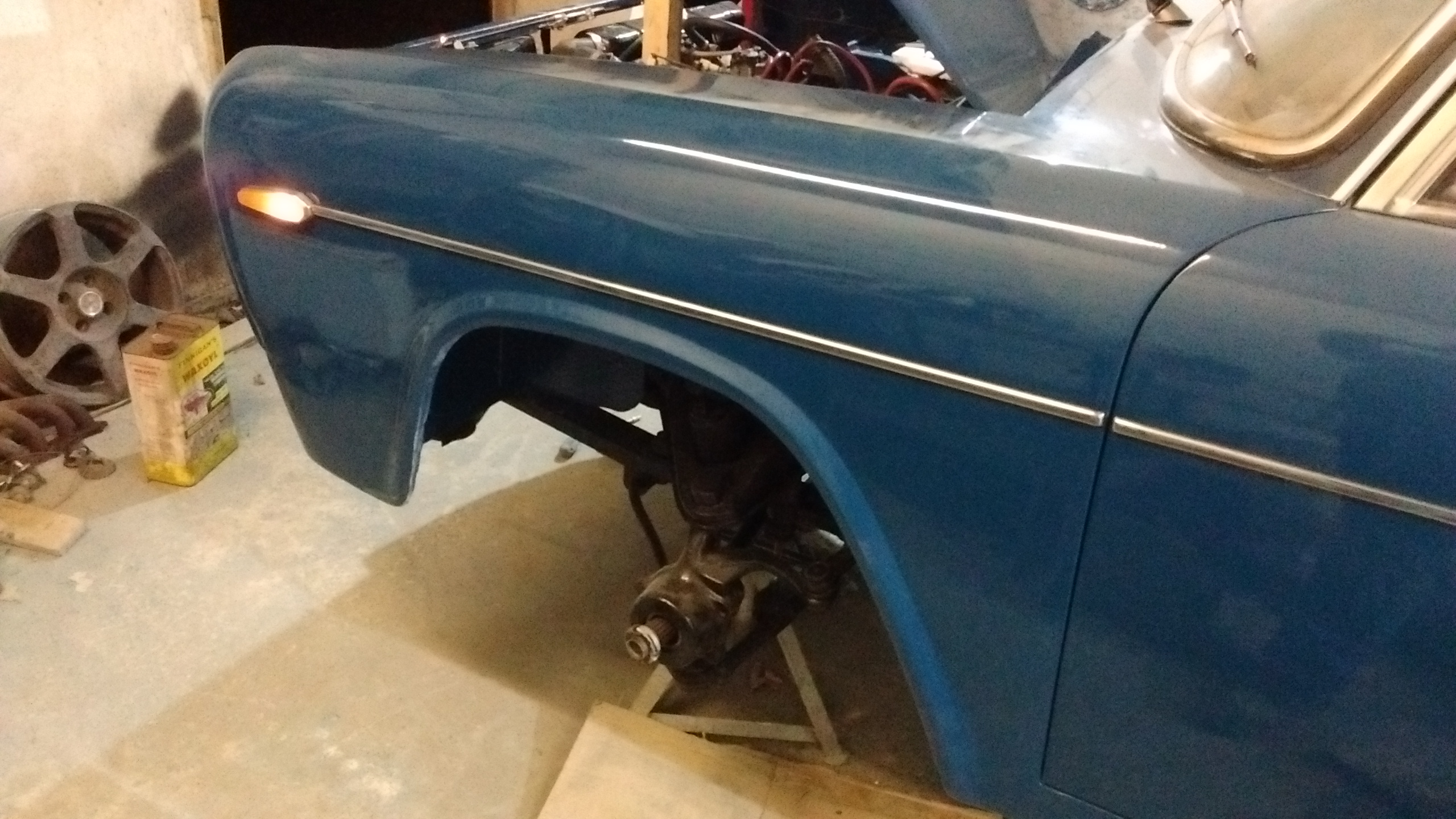

I'd been waiting to be able to fit the side repeater indicators as this has some bearing on where the trims go, issue being that the mounting lugs for the indicators had broken off. did consider using double sided 3M tape to hold them on but they are usually held in place by lugs on the orange lens, which then traps the seal and bulb holder section so wouldn't have worked.
with a bit of fettling they are now on using self tapping screws into the lens from behind the wings, nice and firm location and can be removed if needed
new bulb holders and bulbs completed the job

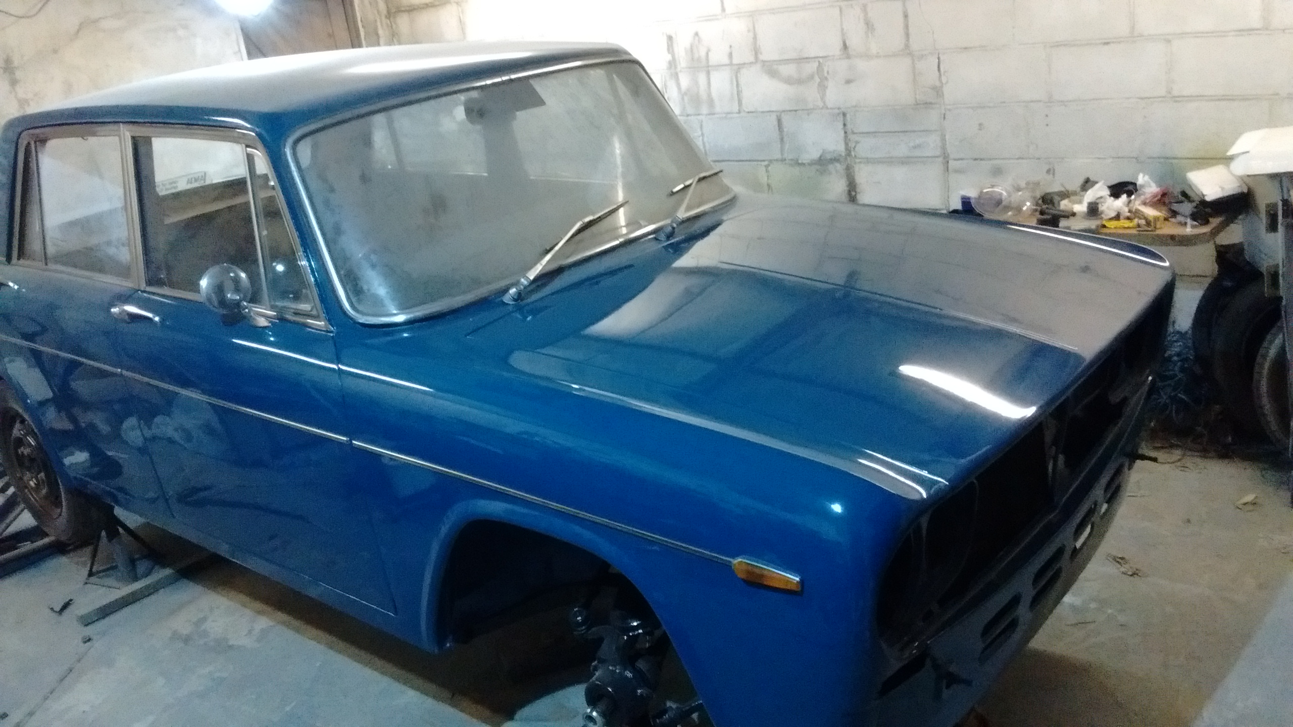

the observant will notice now that the bonnet is on, rich and myself fitted it last night as it's not really a one person job to lift on. needs a little bit more fettling but is very near a decent fit now
the rear is also now jacked up ready to fit the exhaust system......until I found the front pipe wasn't anywhere near as good as I thought. there is a new middle & rear box to fit but without the front pipe there's bno point starting to put parts on. I'll repair the section for now, if a new one becomes available then a simple swap out can be done

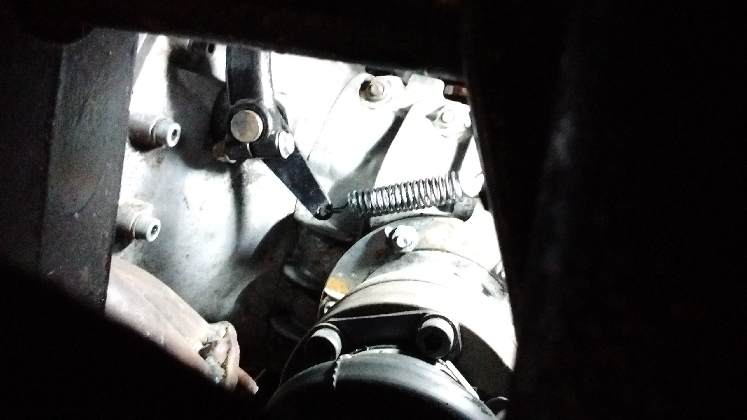

a return spring for the clutch fork was another little job I'd missed out, bit tight for space to get at it now everything is getting back in but it's done.
a few more little tasks done then that's it for another afternoon.
the end is in sight, list of jobs is actually getting trimmed down now so every chance that the fulvia will be out sooner rather than later

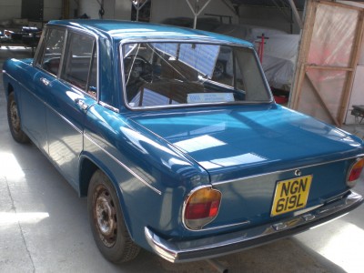

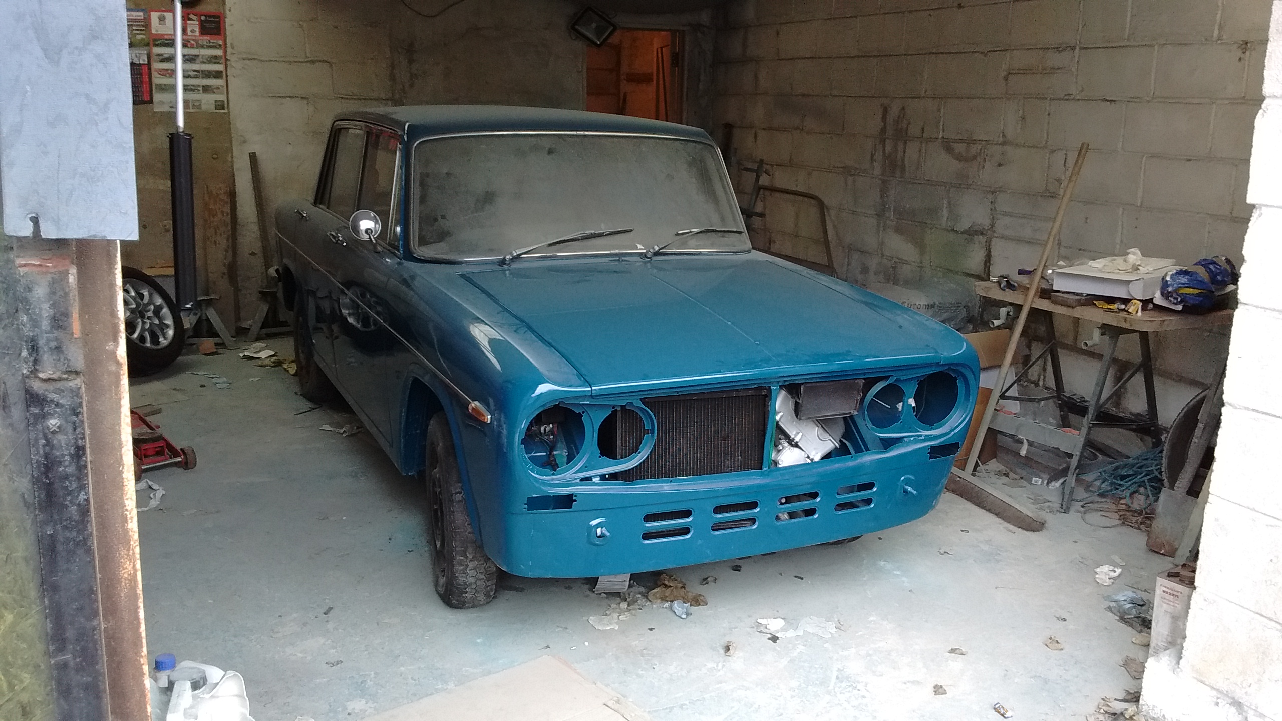

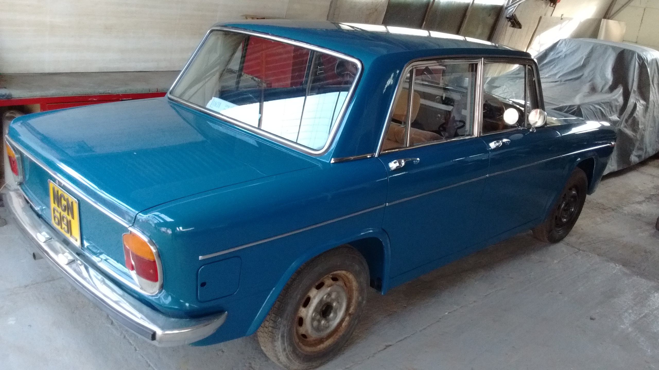

dusty, but ready to face the outside world
awaiting shrew for a ride on his trailer, my 2000 berlina wondering when it's its' turn
it's now safely tucked away at my mate jims' place, where I have my integrale, where i'll finish it off over the next few weeks

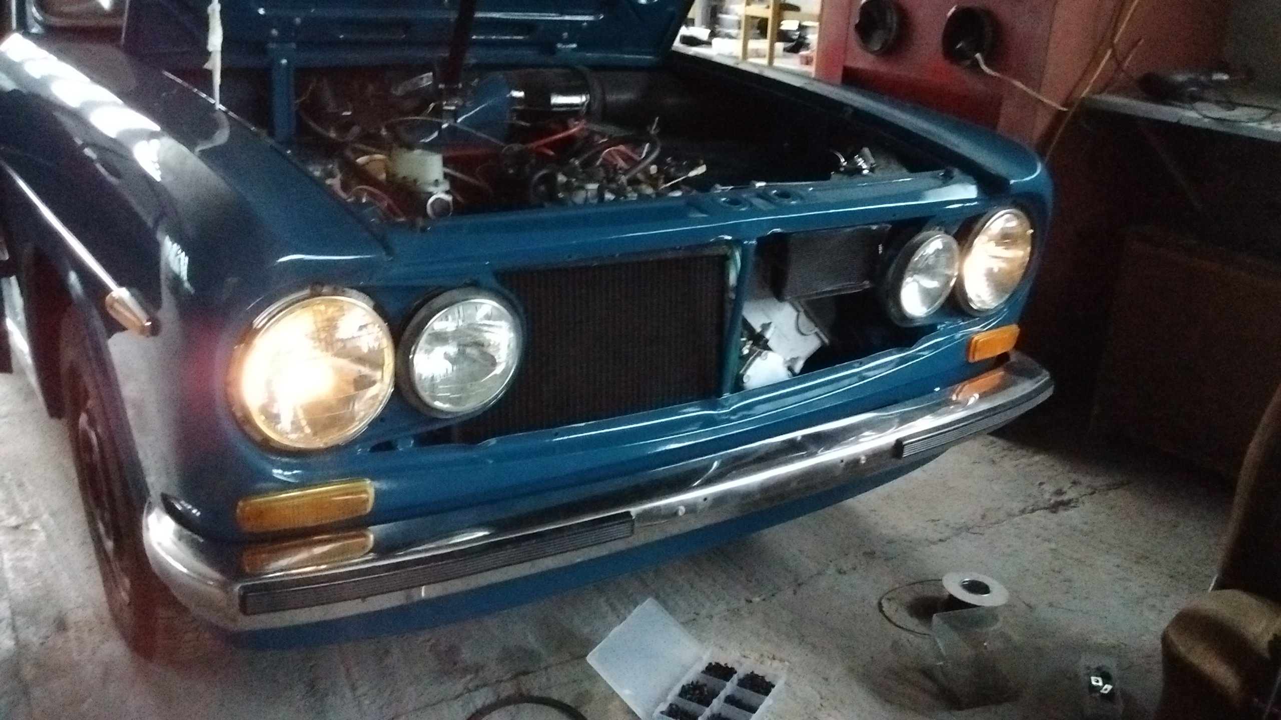

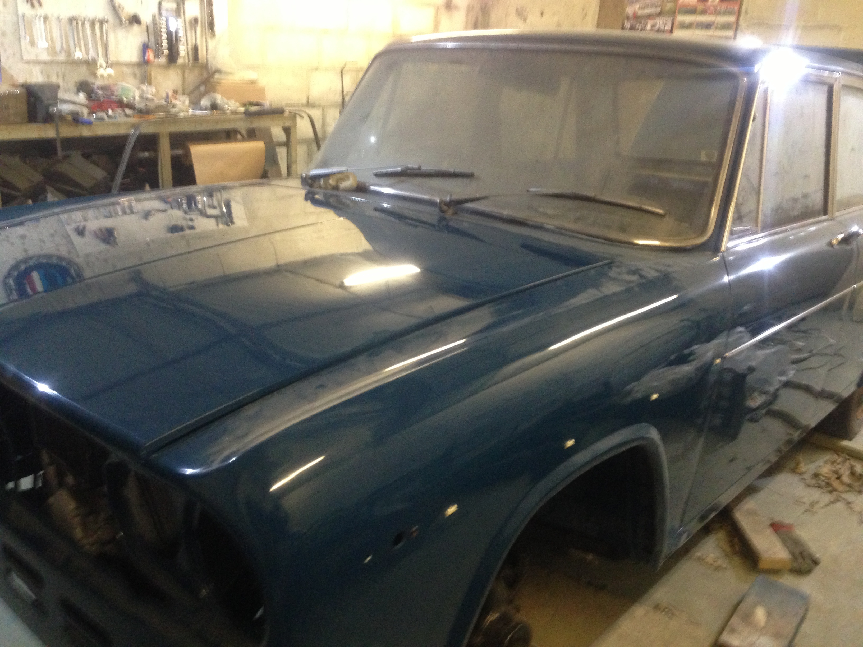

managed to get down to jims place yesterday afternoon for a few hours, and again this afternoon.

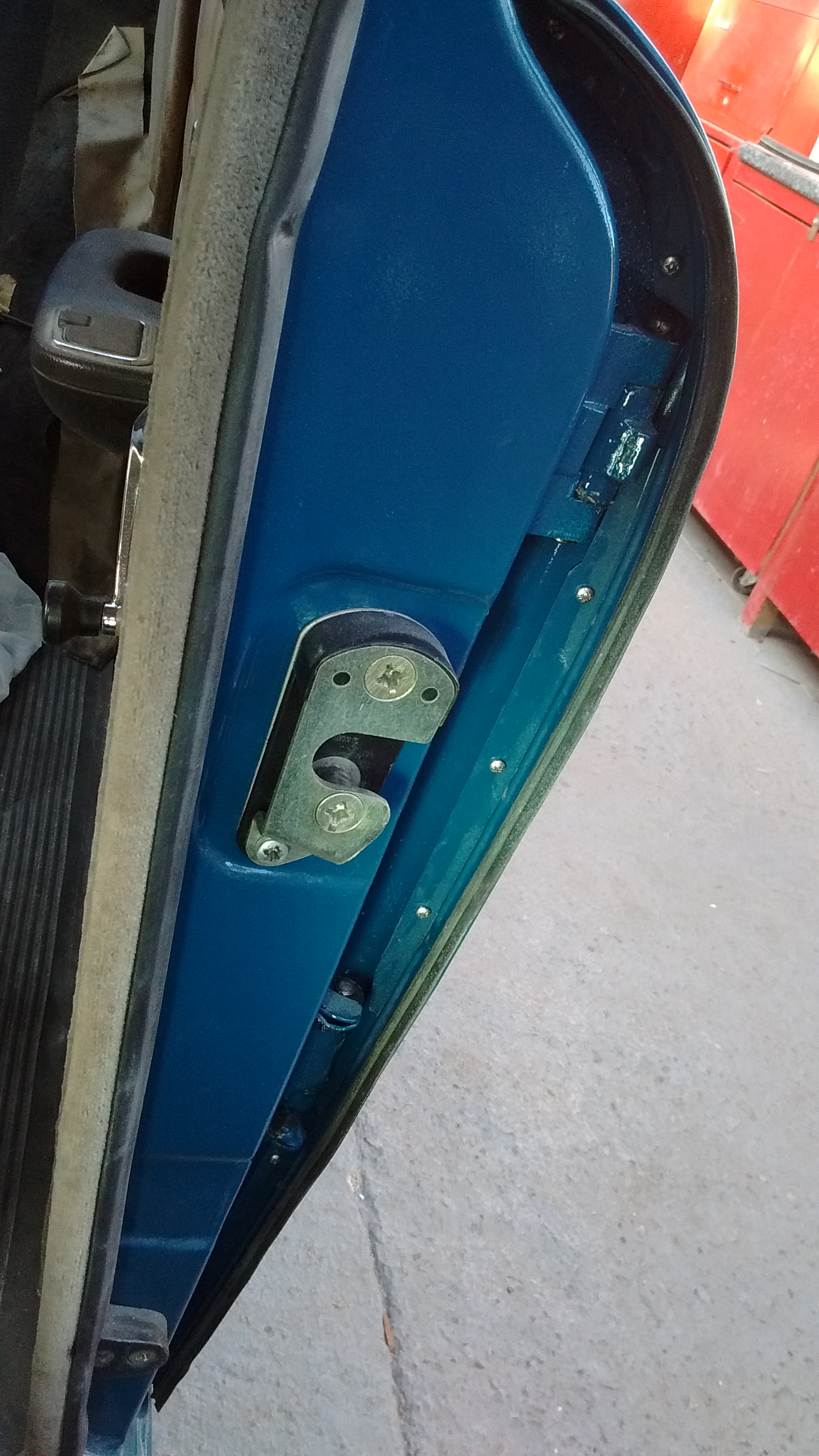

at long last all the door seals are fitted up, never seen so many on car doors before, I took some time remembering where they all went!

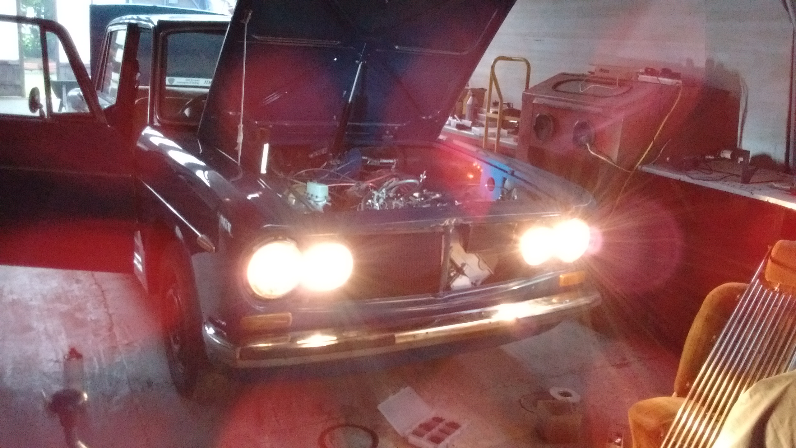

sorted a few more trivial parts out, engine mounting stabiliser, finally getting the rad fan wiring sorted which still needs a new relay as the cars one is duff.
the alternator wasn't charging despite it being reconditioned, turned out that the separate voltage regulator wasn't playing ball. I had one in the shed which with a little alteration to the terminals works just fine, relieved to say that as a duff reconditioned item isn't any good to anyone
the bonnet stainless trim got a thorough clean. it also needed 3 new brackets making as they had sheared off months ago when it got taken off.
whilst under the bonnet the damper got fitted, bonnet raises as light as a feather now.
also fitted a pair of bonnet stops to align the corners up nicely

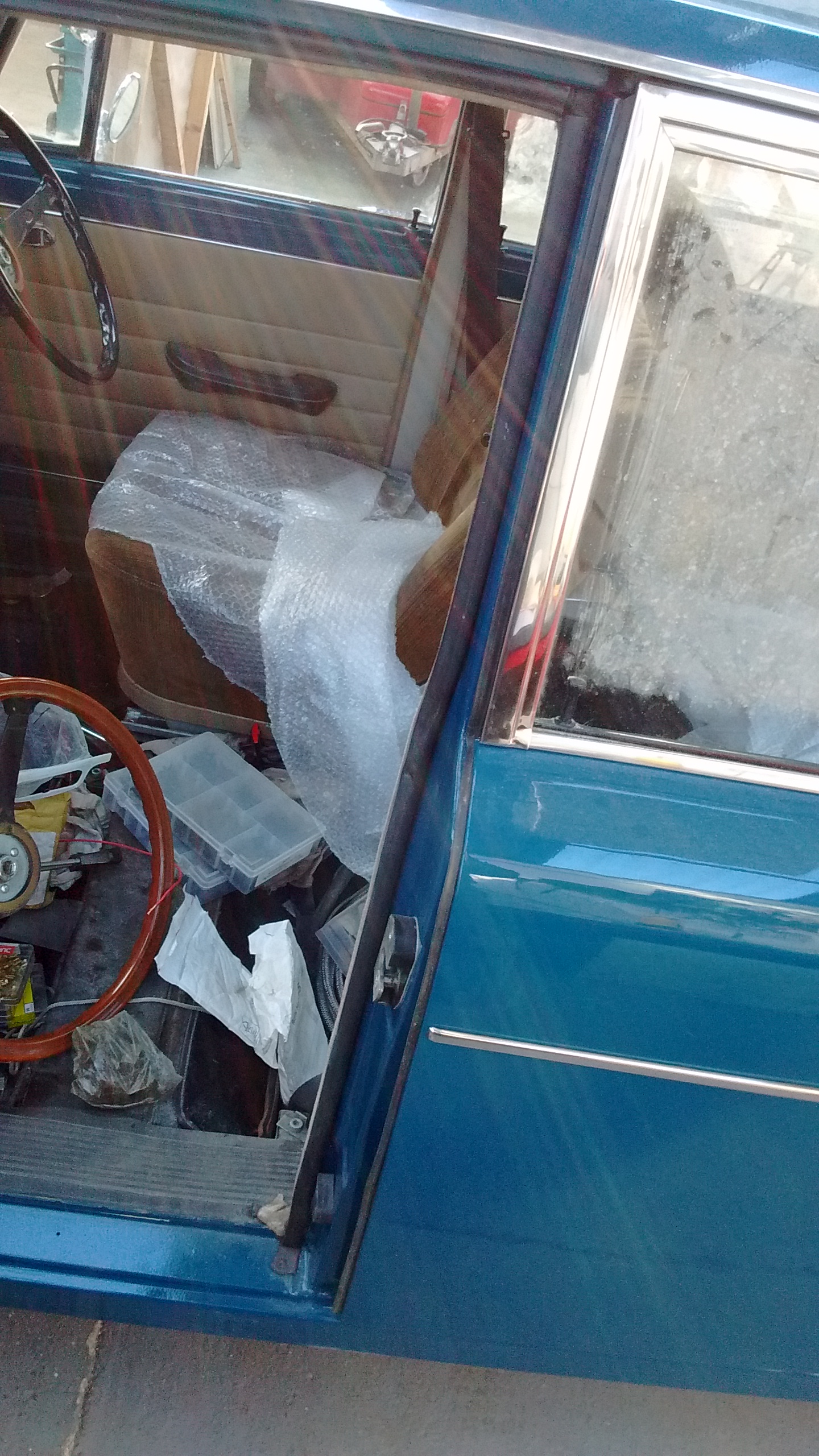

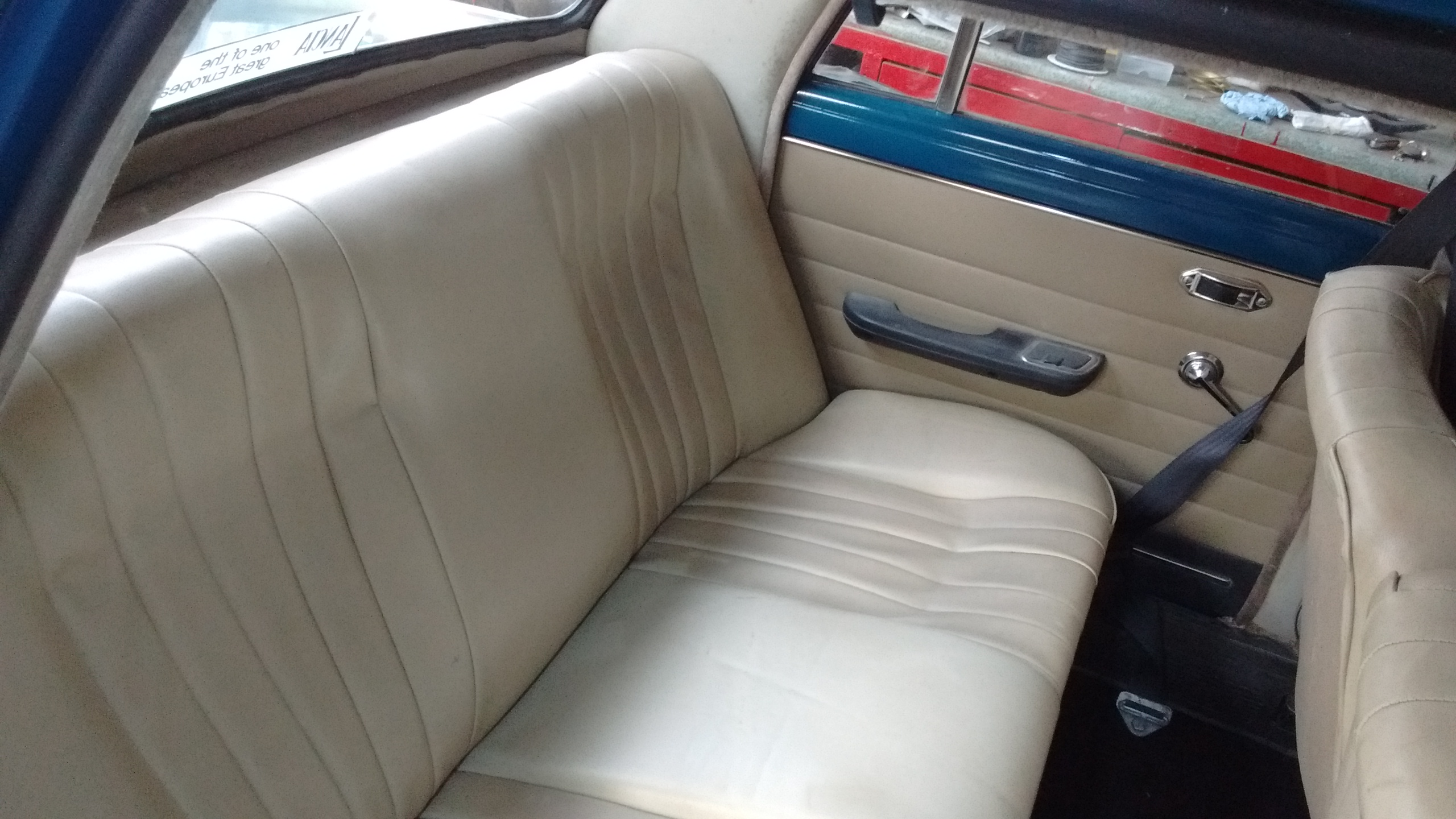

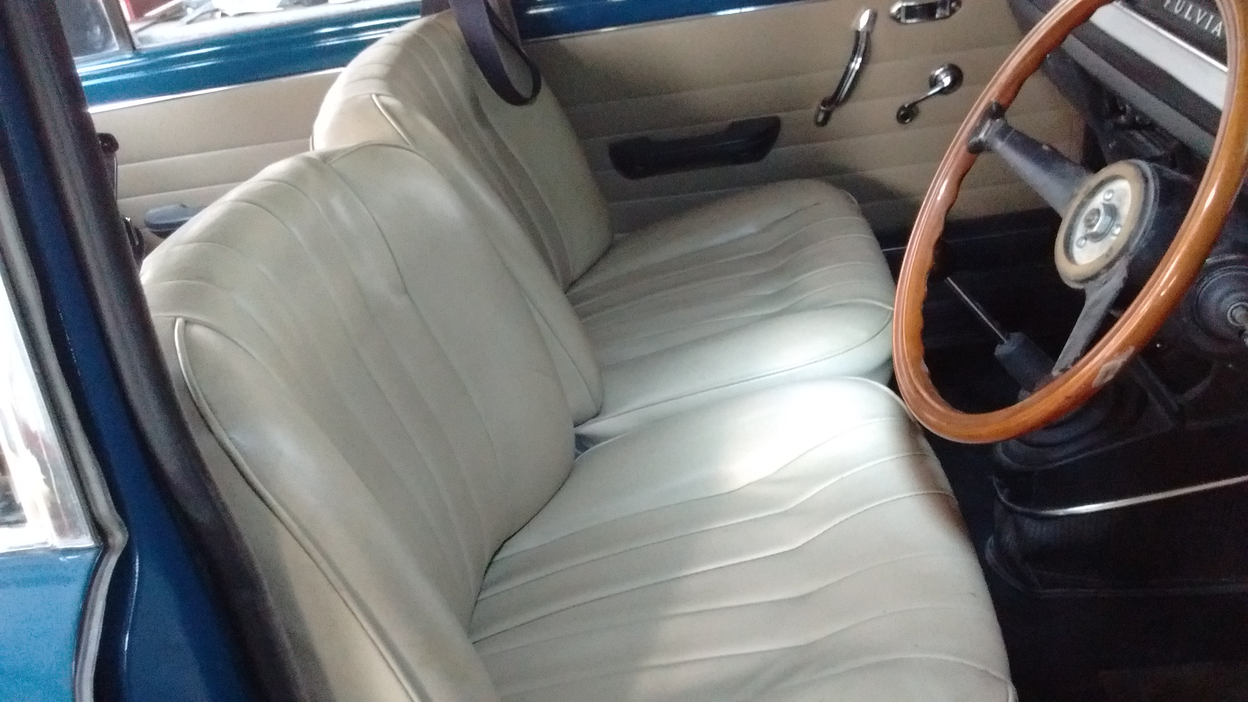

I gave the inside a bit of a clean out today too, long overdue. the dust and grime from the welding and spraying had gotten everywhere
came up ok though

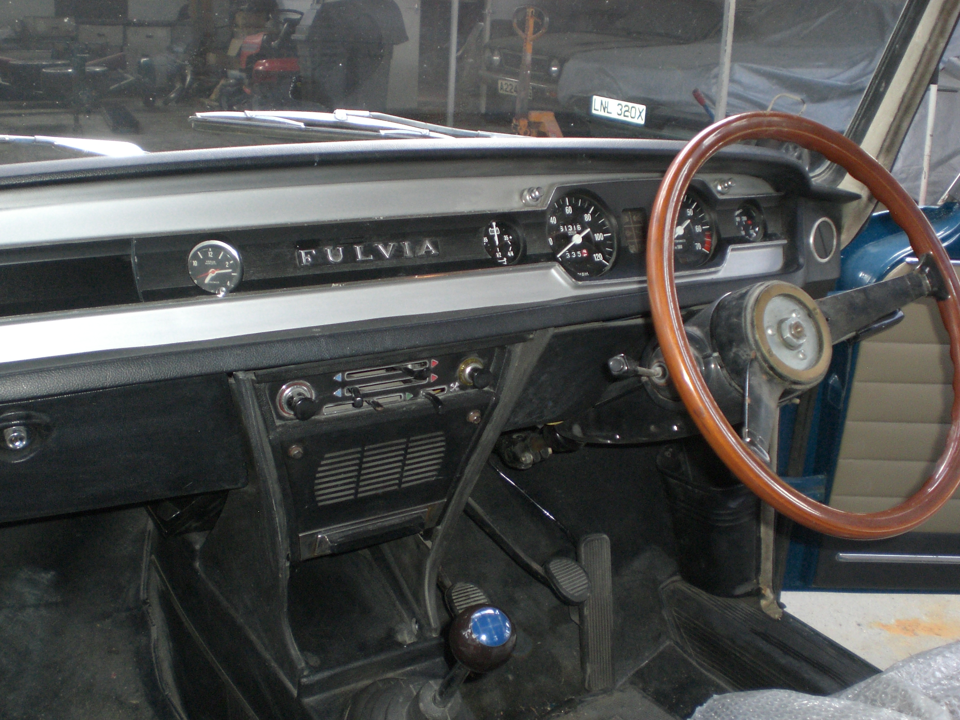

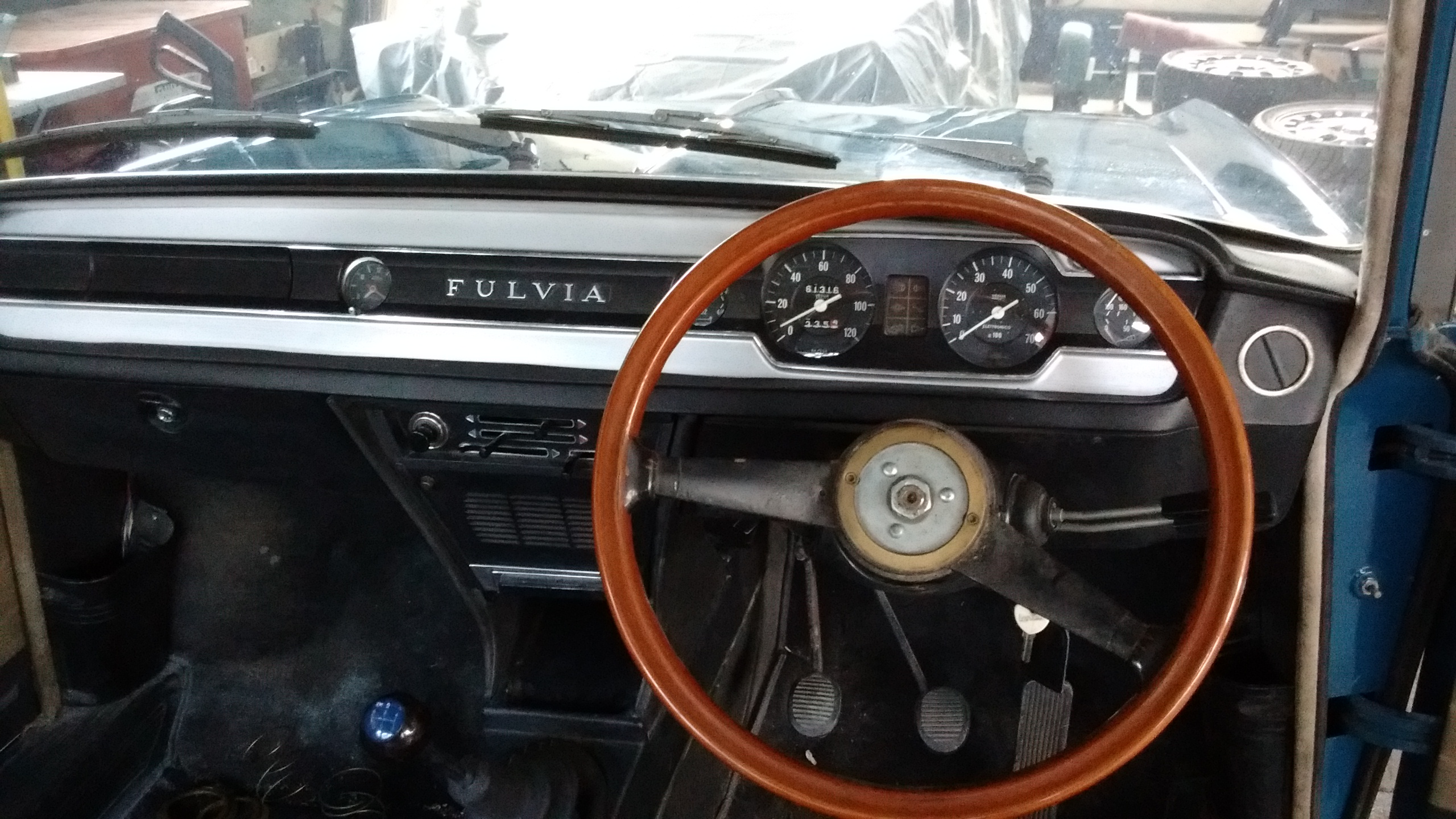

steering column has also now been changed for the right one after the key saga, long story!
the wood rimmed one suits the era better than the black one, if I'd have remembered to take a suitable socket I'd have been able to fit the lovely centre horn push and Lancia shield

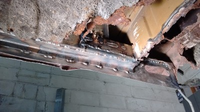

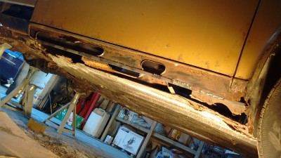

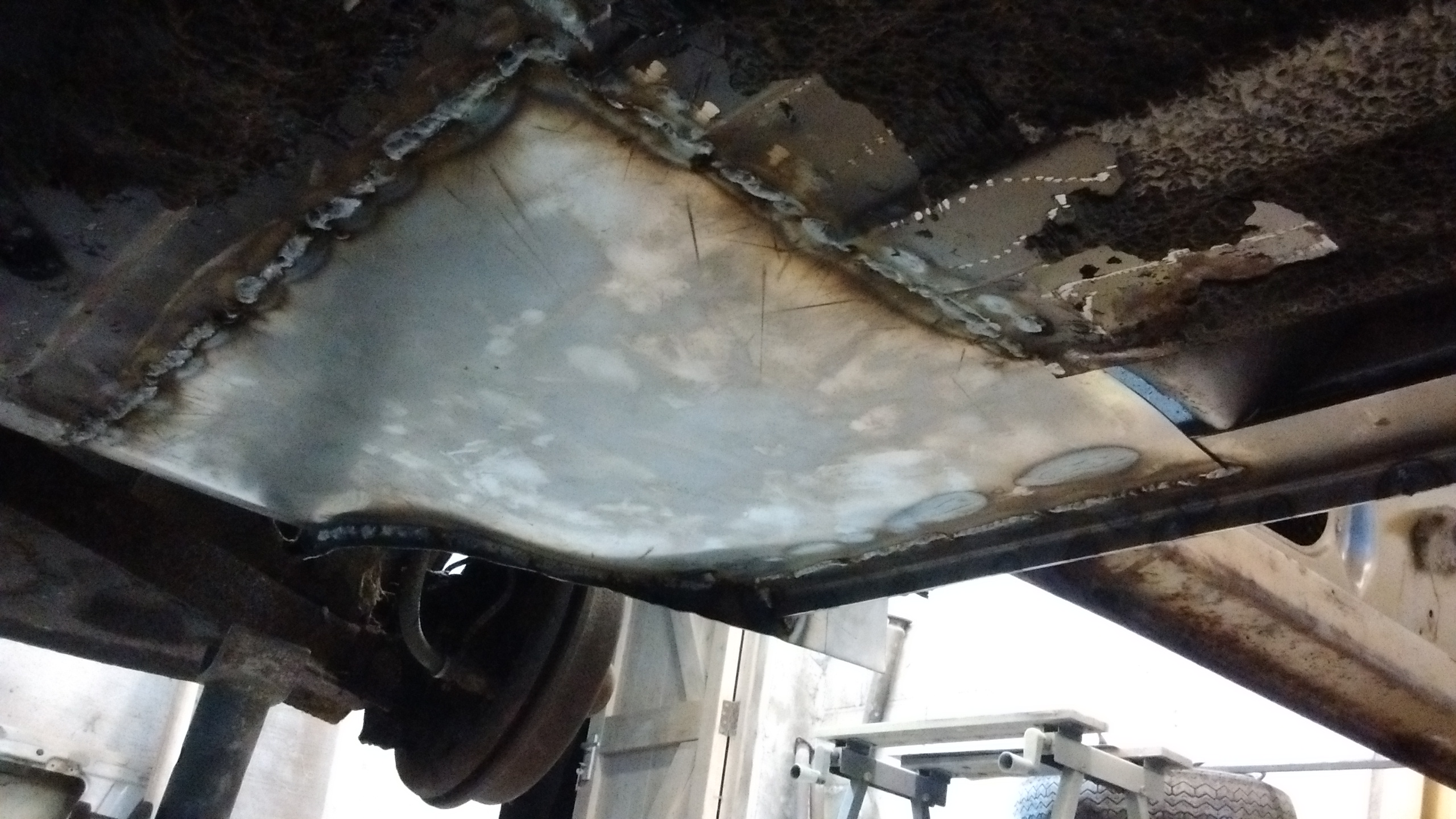

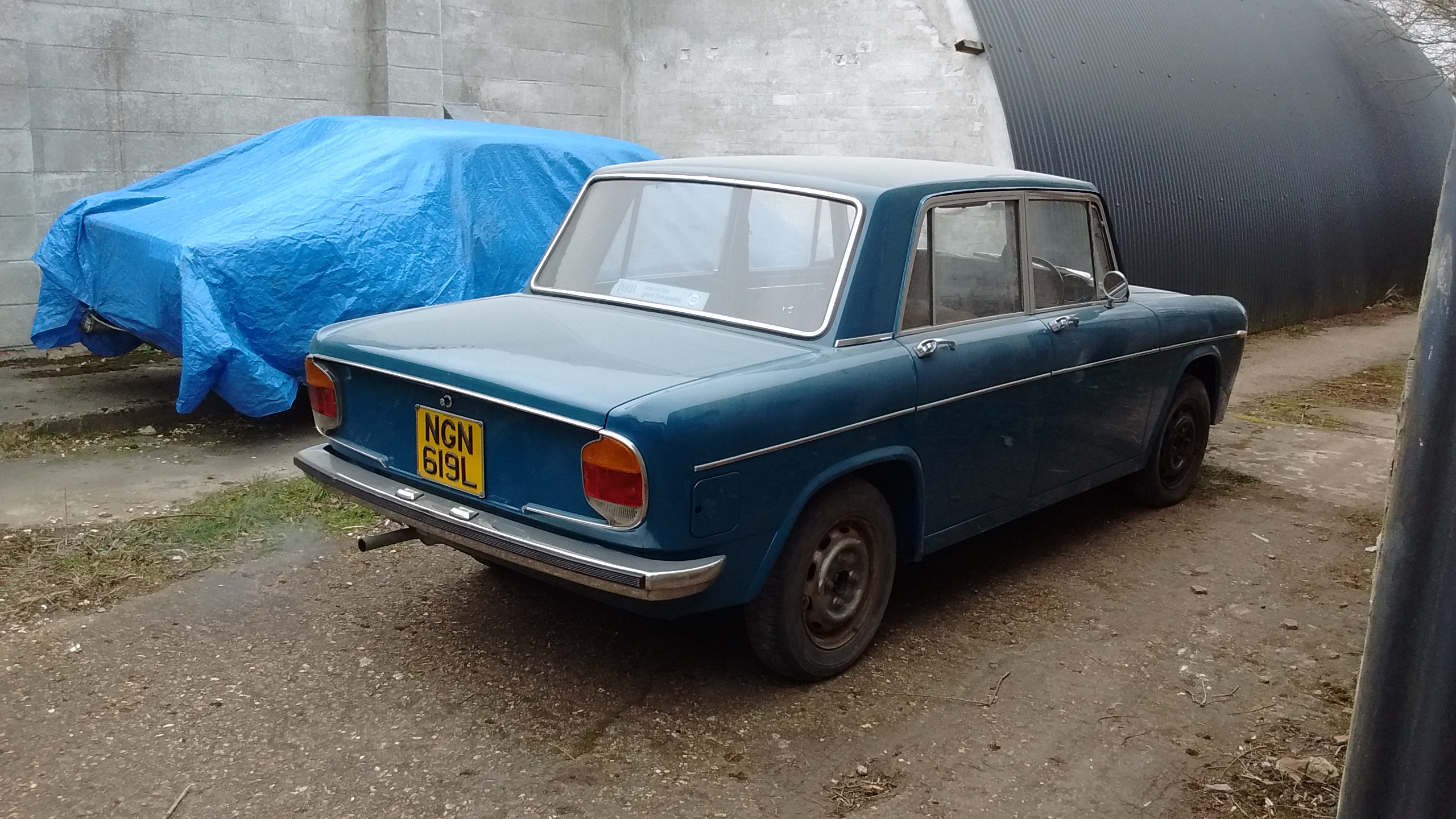

we'd taken the car up to the unit last weekend and as my time is now split between the Imp and integrale progress will be a little slower
Rob will be helping when he can, he works Saturdays so will come up when he gets finished, I will be up there a bit earlier to get on with things

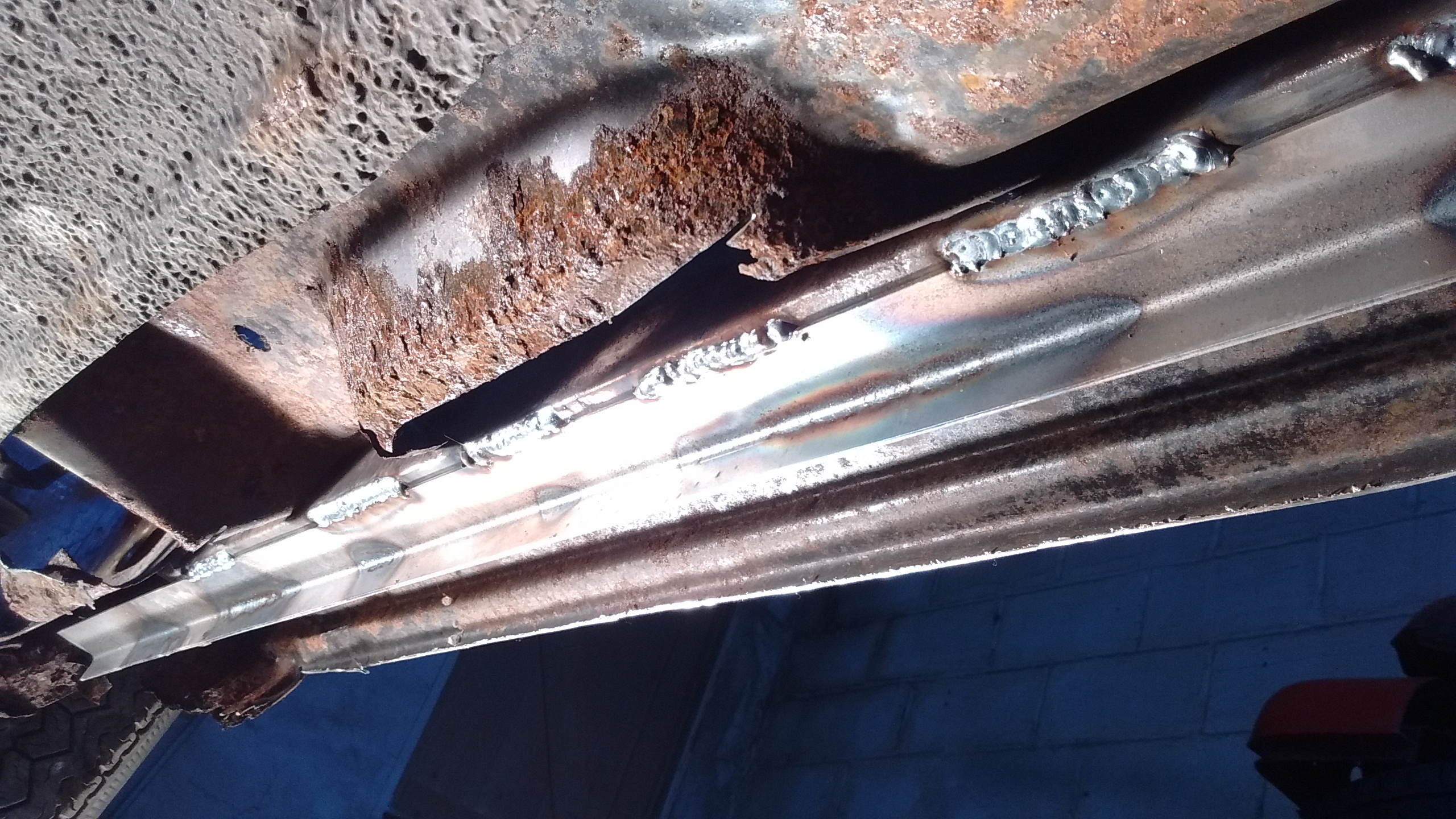

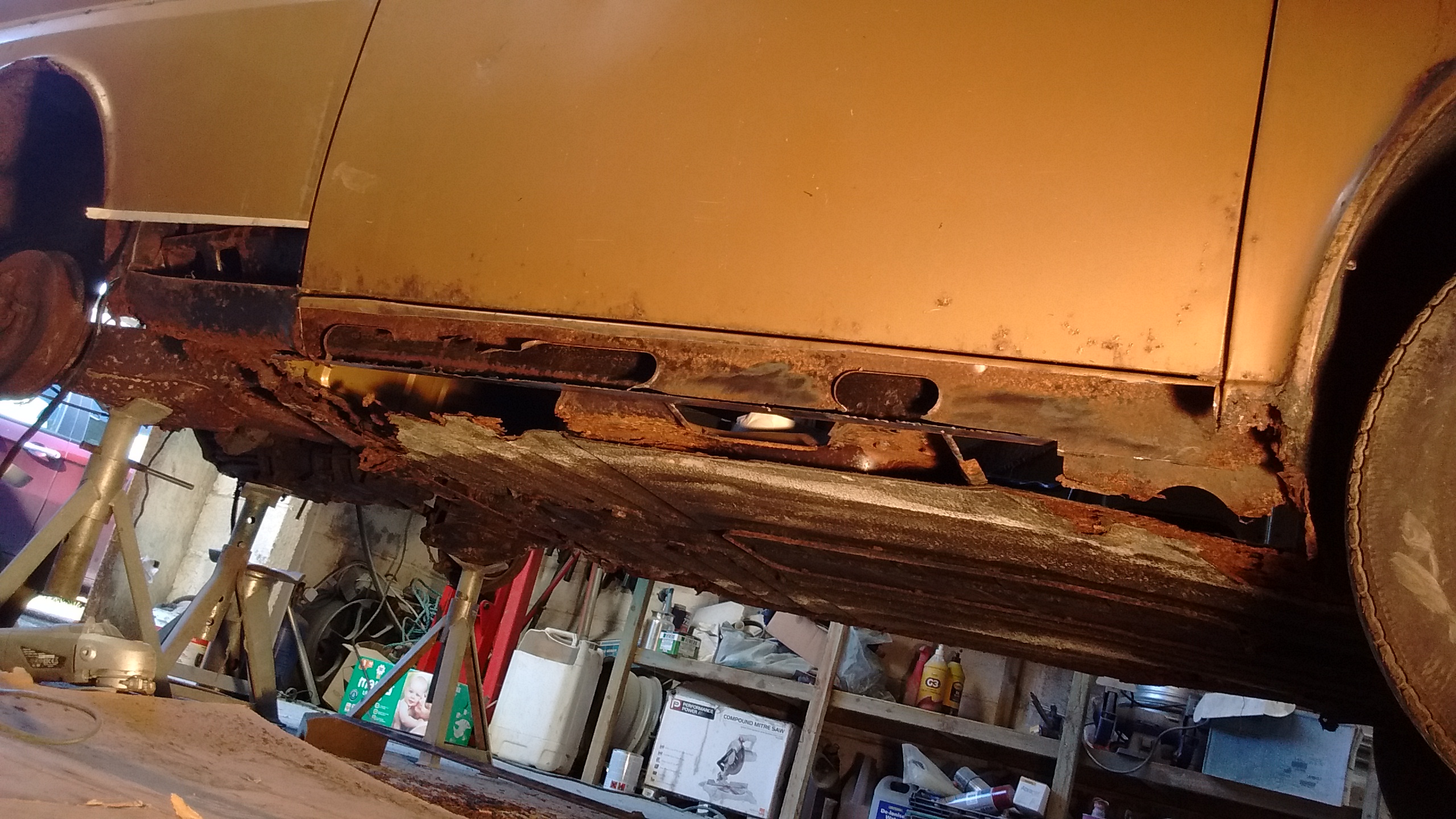

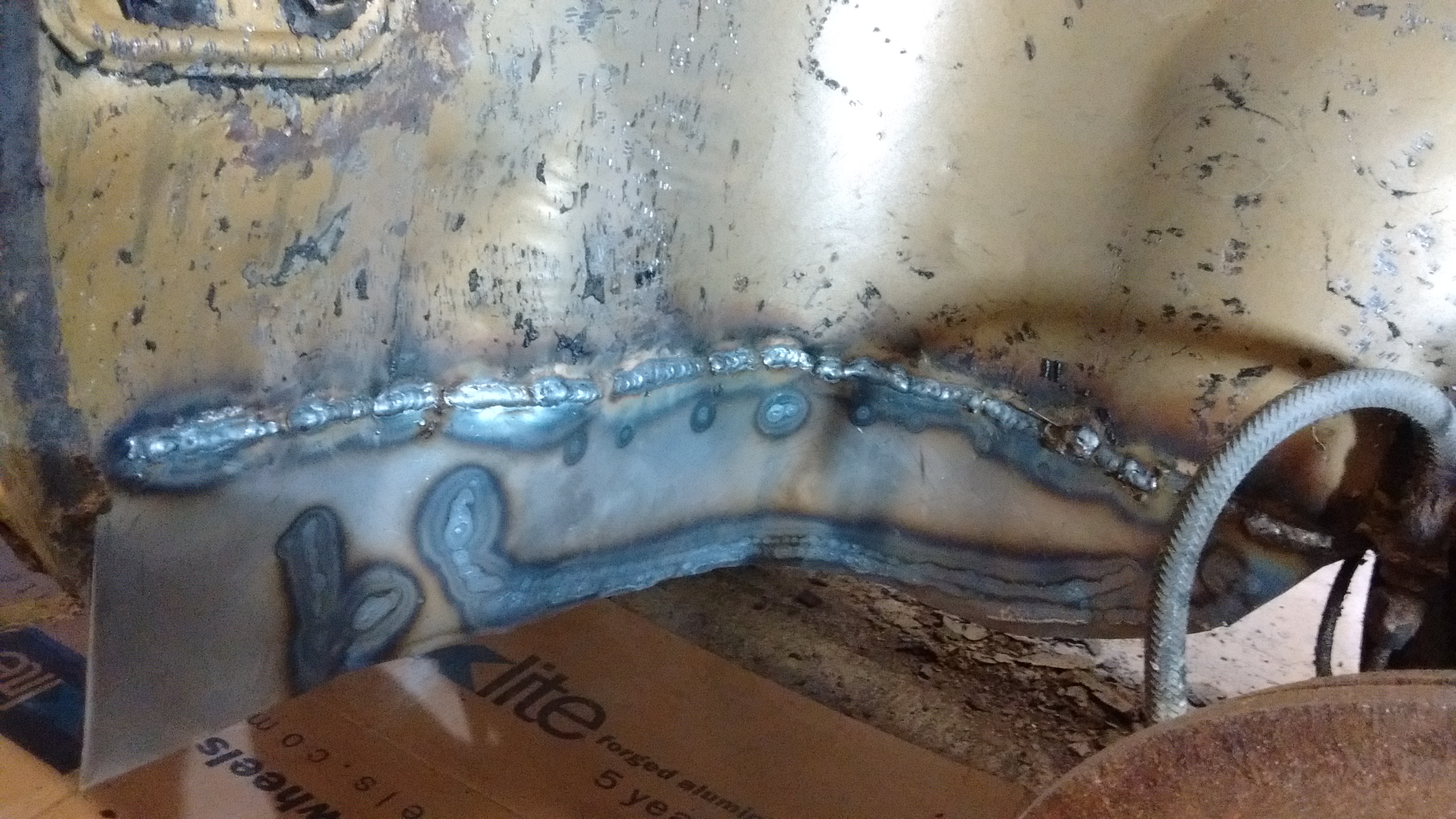

as the car is perched up on the stands and the floors/sills are pretty poor I decided that getting those sorted first off would be best to try and get some strength back into it
drivers side first, is a bit worse than the passenger side by the looks of it but once the rot is chopped out I guess they will be similar amounts of repairs needed

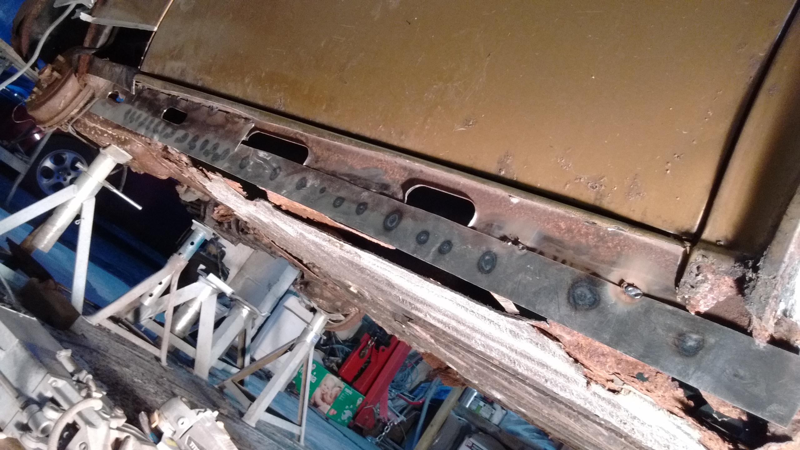

anyway, with most of the outer sill removed along with the useless bottom lip it wasn't long before solid metal was reached

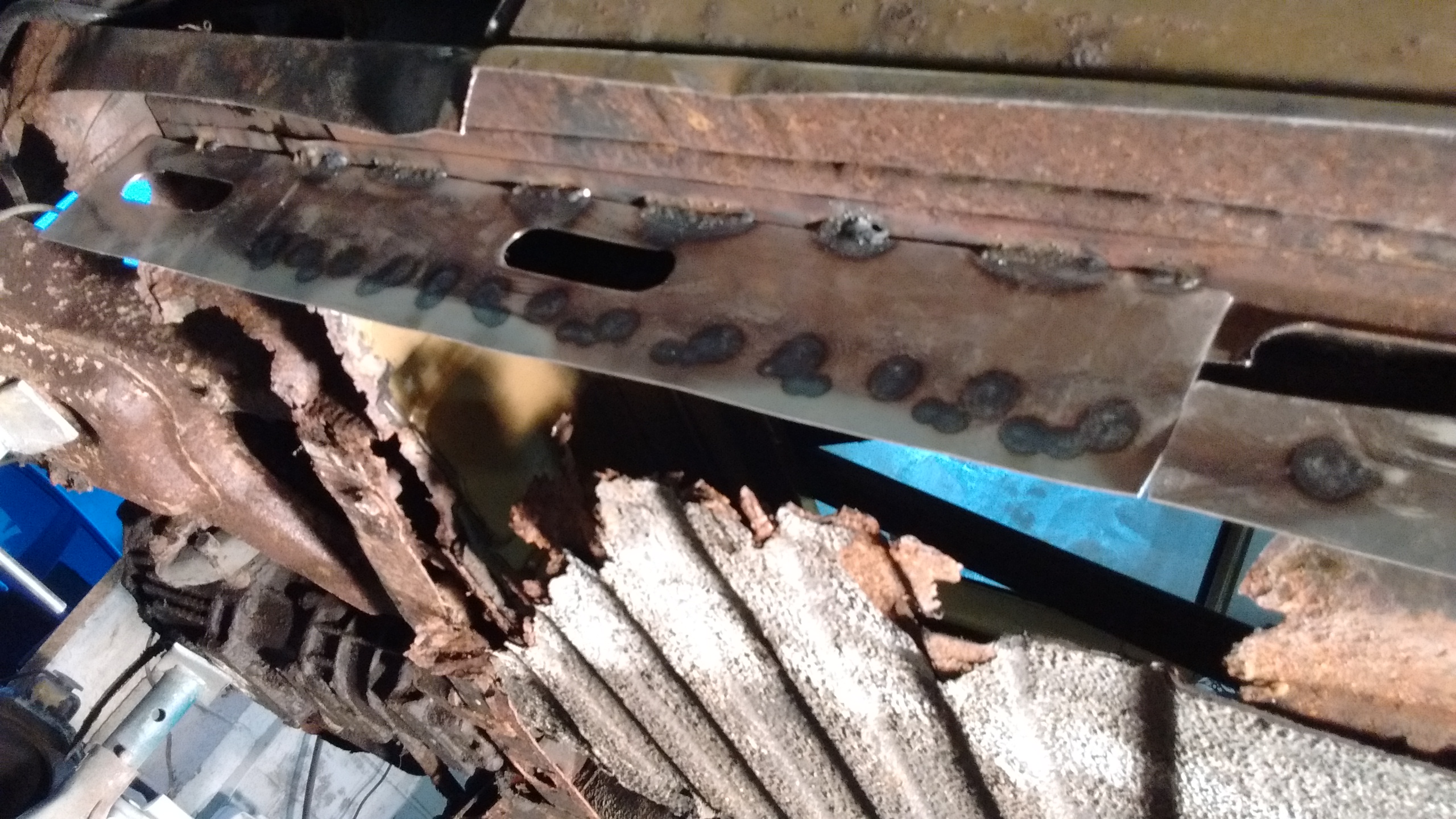

it is a slightly strange arrangement at the sill to floor join, quite a deep flange which leaves a gap between the inner sill and floor section
first task was to weld into place a new length of steel which would make up the basis of the sill flange
with a guide edge to now work off a repair section for the rear half was made up complete with oval cut outs to allow the sections to breathe and the paint/waxoyl to be reached into all the sections
this was spot welded to the previously fitted new flange then mig welded to the top inside the sill cavity, plus a few extra mig tacks behind the bottom edge for good measure
the rear box section will be made up at a later date once the subframe is removed so we can see what goes where, fresh air isn't a good guide!
the forward half didn't need such a deep plate making up, the original centre sill is still strong at the forward end and was already migged to the new flange. a further repair patch was only really needed to create the lower down bottom edge
as before it was spot welded in place before attempting to mig the rest....I say attempting as my welder woes continued when I ran out of gas! I blame Keith
fate tempter that you are mate
not too bad really though, I've done the fulvia and Tims' sprint on the one bottle so much more better value than the disposable ones. i'll collect a refill when I go to the integrale on Wednesday
Rob managed to get a good few parts off the car too, he's brought home a boot full of goodies to clean up and paint or polish.
all in all not too bad a first afternoon on the little Imp. just hope I've bought enough steel....

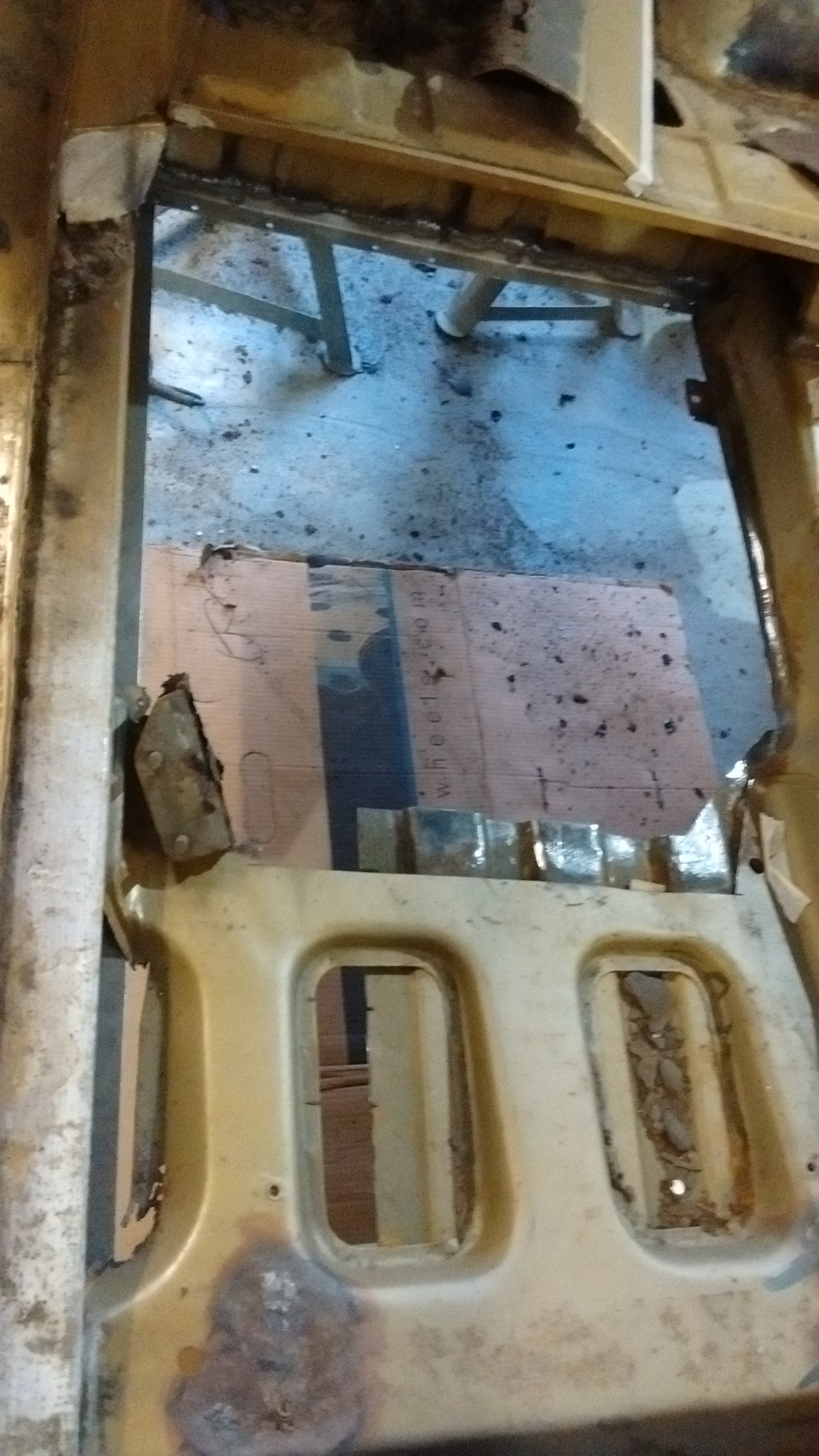

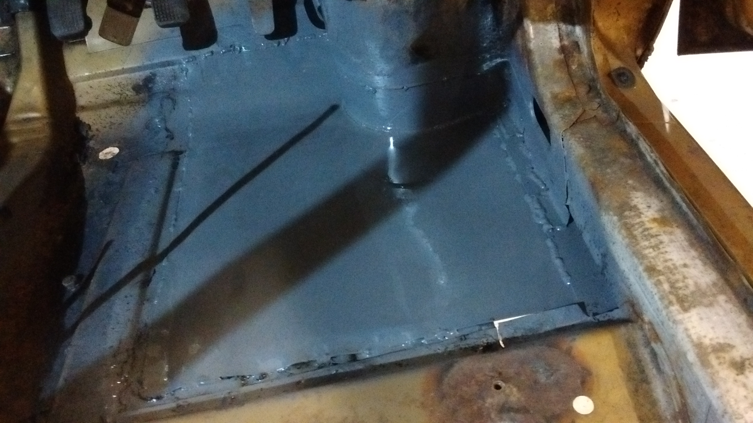

had an afternoon up at the unit again today tackling the rusty spots on the Imp, and the fresh air parts!
with a fresh bottle of welding gas the central sill section got welded up fully.
time then to figure out the best way to attach the new floor sections.

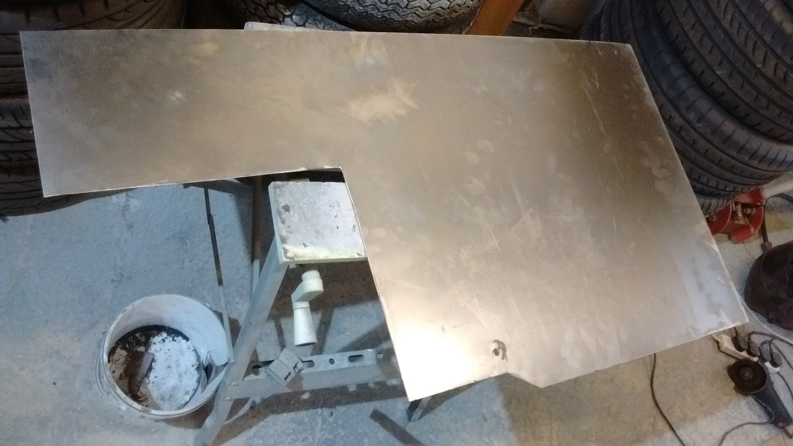

as a lot of them would be made up in longer sections than would go in my metal folder and wanting to keep a straight edge for when the outer sill goes on I decided to use an already folded edge of the thick steel that I bought for this such a job. that will allow for the floor sections to be made up to overlap this piece instead of having to have a fold made
I then made up a drivers floor section up once I'd cut it back to solid metal, which thankfully is pretty decent once away from what's already gone
next step was to make up another plate for the wheel arch bottom portion where the new floor section could be attached to
then button up the rest of the inner sill section and that corner is almost done. just a bit of lower wing to make up when the outer sill goes on plus a jacking point of some sort to make and fit

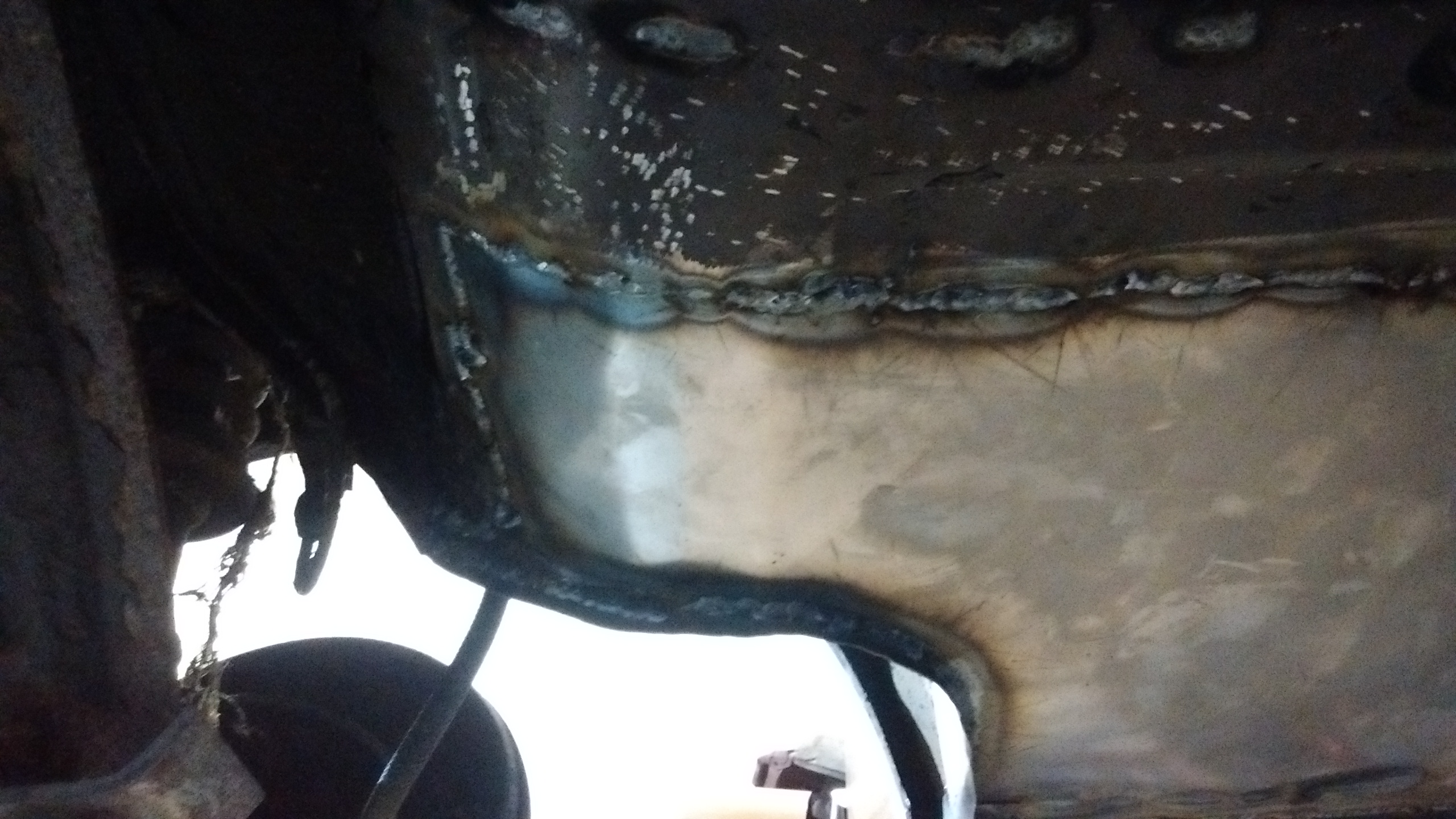

underside seam welded, inside the car just done in smaller sections so I can blow some primer under the overlapped sections
under the pedals, still making sure full throttle can be achieved, as checked by Rob

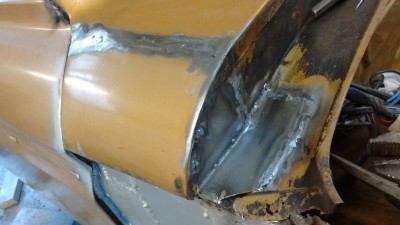

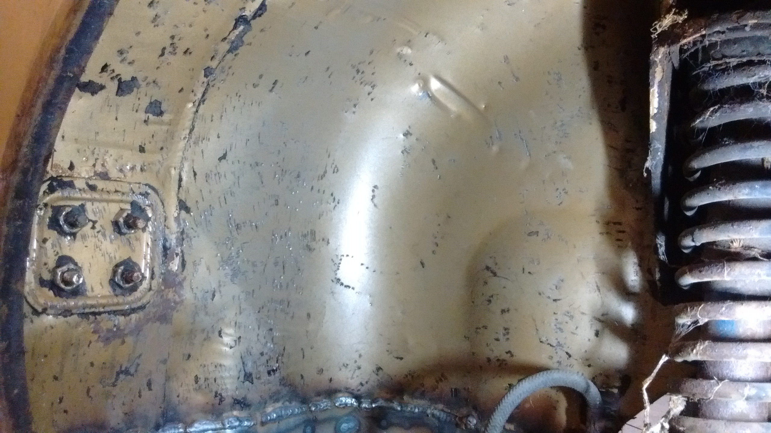

lower wheel arch repair
I chiselled off some of the thick underseal that's been plastered inside the wheel arches, ugly stuff but appears to have done a great job in preserving the parts that had at least not let the damp in, this will hopefully be repeated in the other arches so that we can make it look decent and in paint colour
got some etch primer on the new metal after a grind over, it'll get seam sealed once I have enough done to go at.
next time should just about see the drivers side floor finished off all the way to the rear subframe area....

Rob is busy taking everything else off the car whilst I'm grinding away, although with him working Saturdays he doesn't arrive until after 5PM but does turn up with some chips
He's got the passenger side door glass and rear side glass out, stripped all the wiring and cables from the engine bay, hoping he remembers where stuff goes....

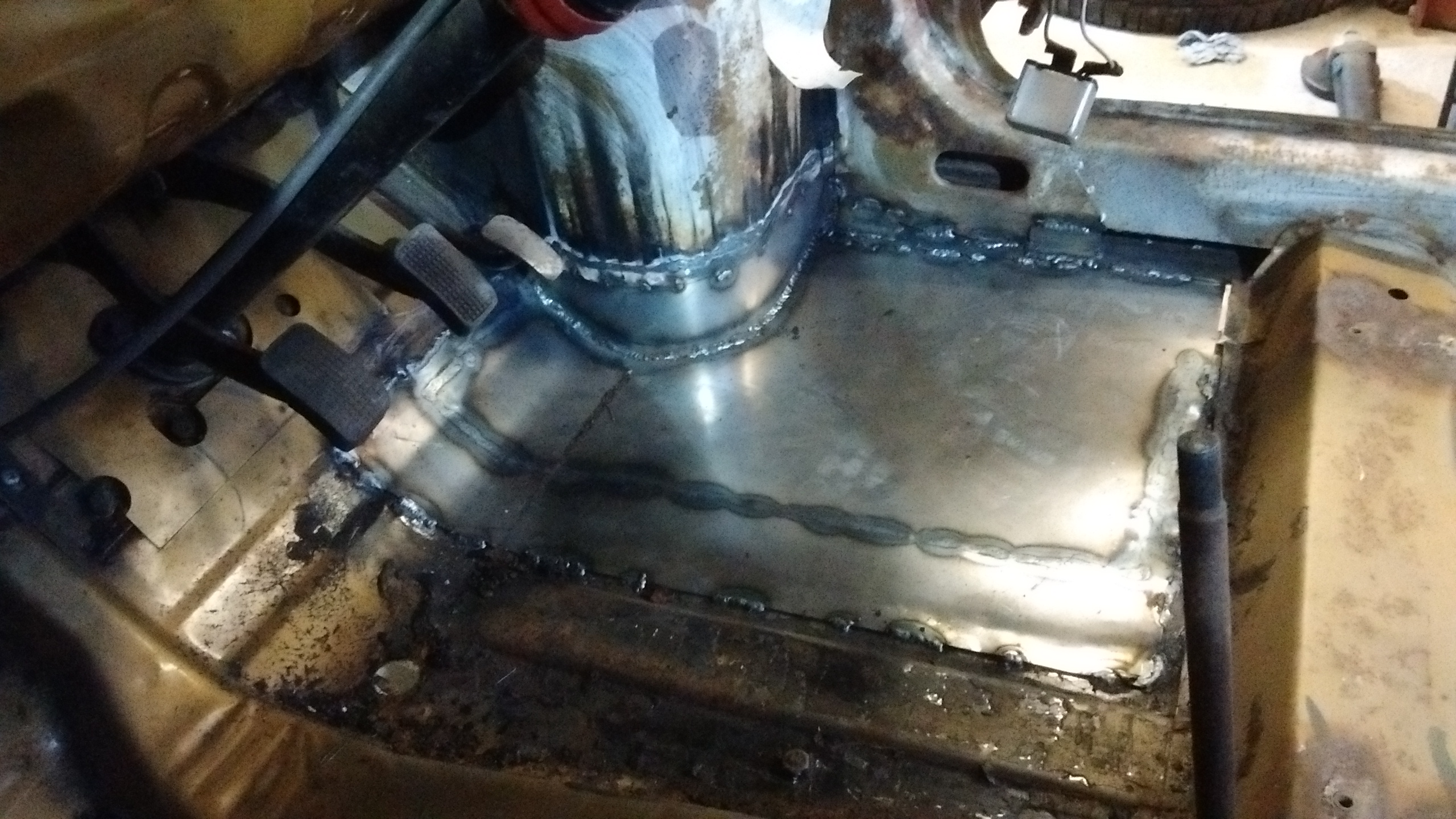

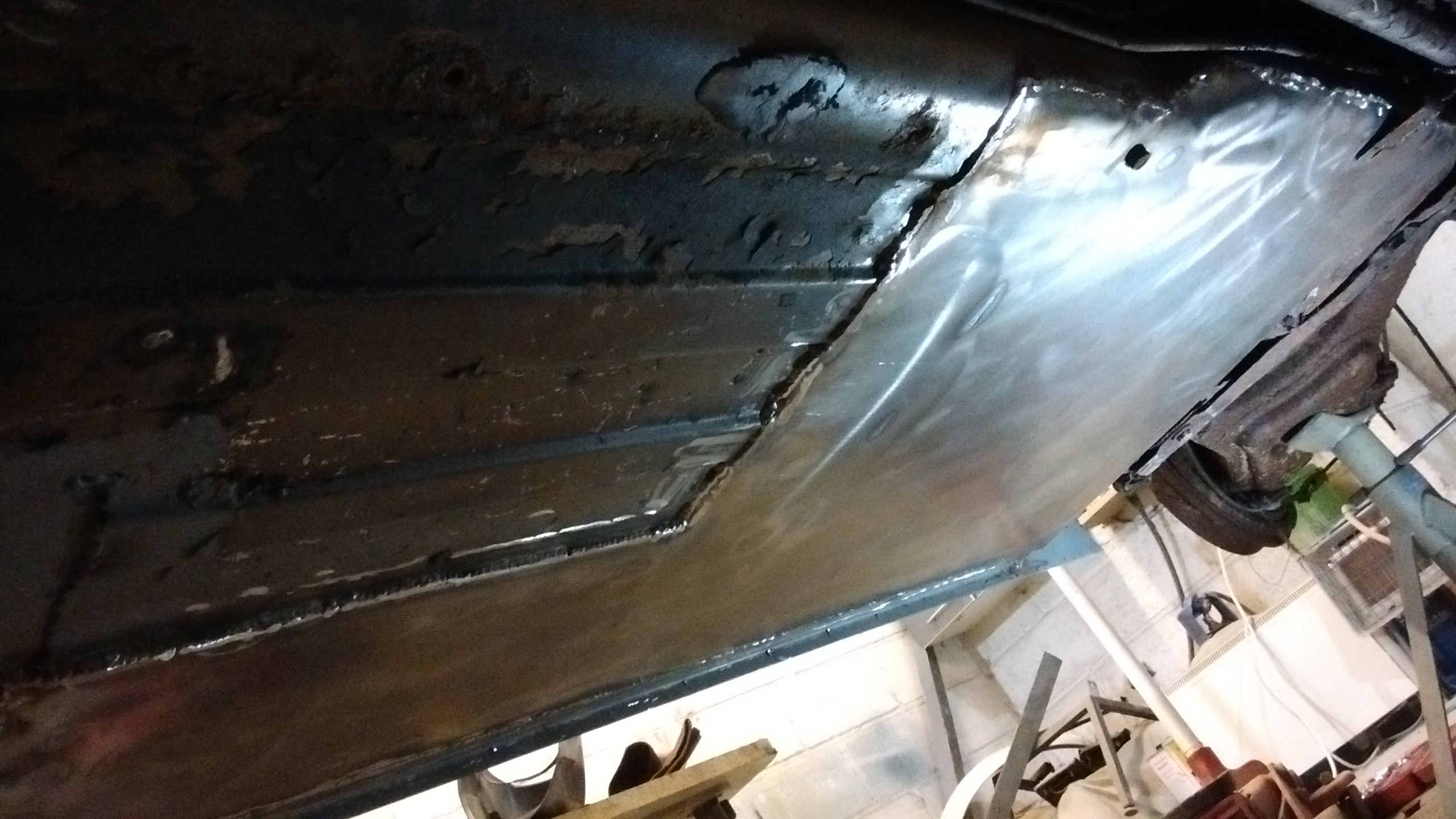

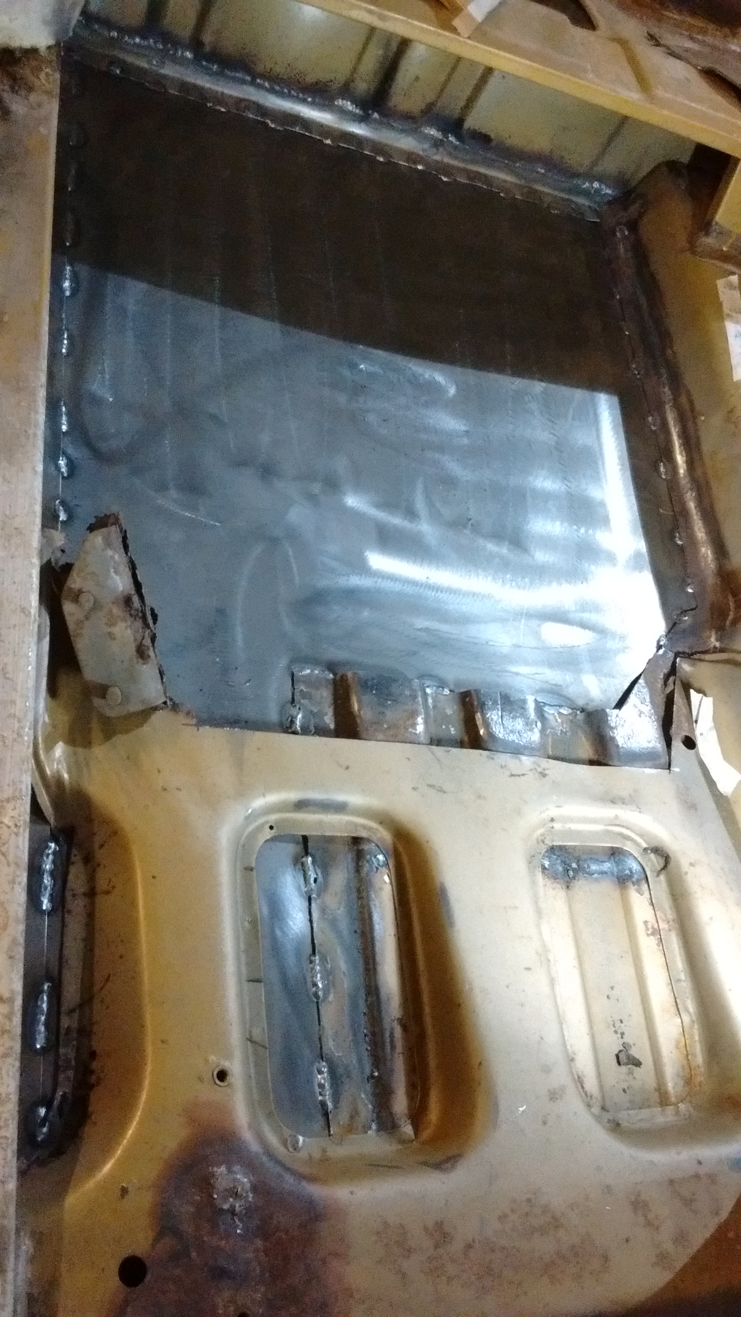

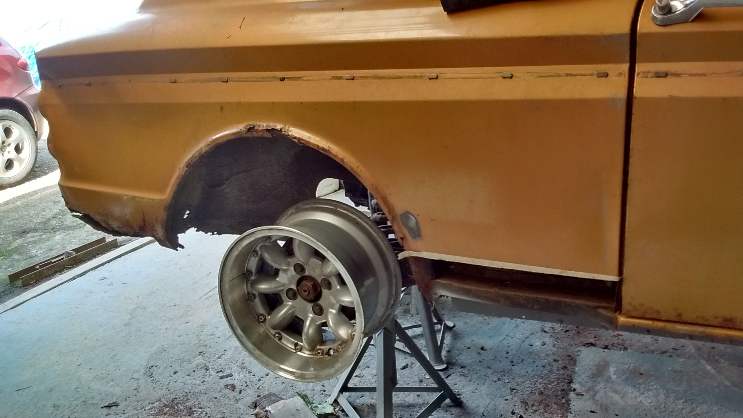

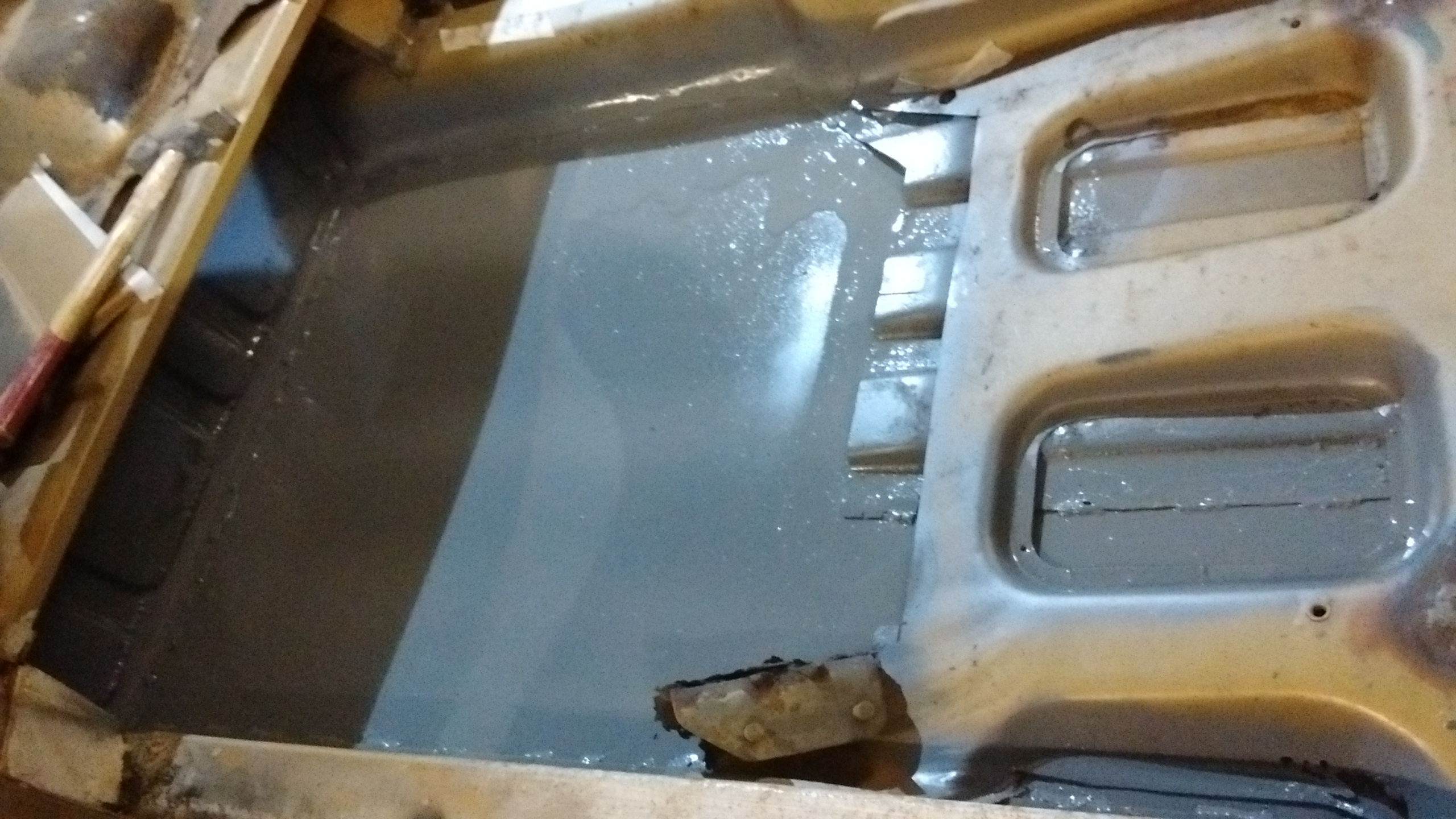

on my lonesome today, rob was off doing something else, don't know what.....suspect some distractions are afoot
anyway, chopped out the rear floor on the drivers side and made up a little flange return for under the rear seat to link up with the floor, it had long since split away with rust
was going to fill in the rest of the floor from the back of the rear to under the drivers seat then another plate for in between but decided one large one would do.
had to take off the inspection plate that covers the gear linkage and brake cables as the rot had gone under it, one mounting hole being overlapped
as before, seam welded all along the underside and stitched in above so I could get some paint between the overlapped sections
bit of a late finish but mixed up some etch primer to protect it until next time, still got the drivers seat reinforcements and mountings to redo
the little imp has always had a bit of a droopy drivers door which tonight I found out why, the top of the A pillar has rotted away
nothing for it but to remove the wing and chop out the 'screen scuttle and make some repairs. that's for next time...

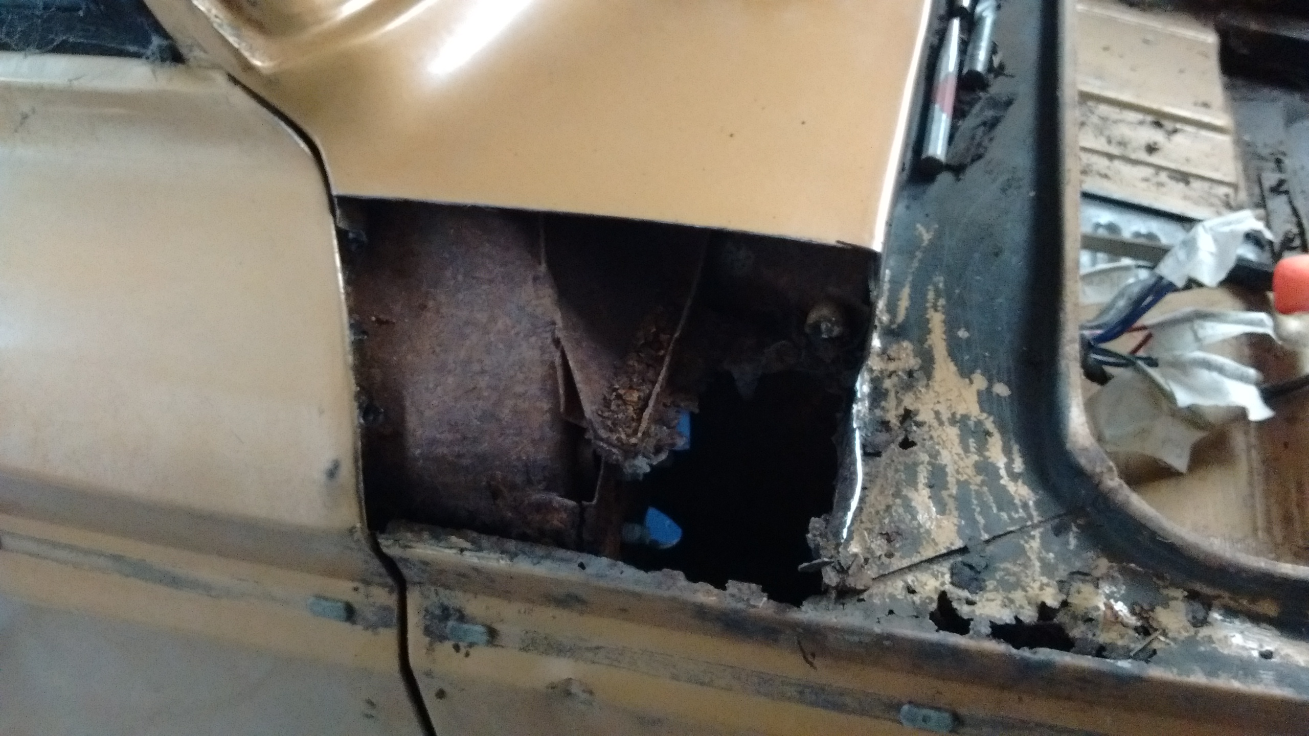

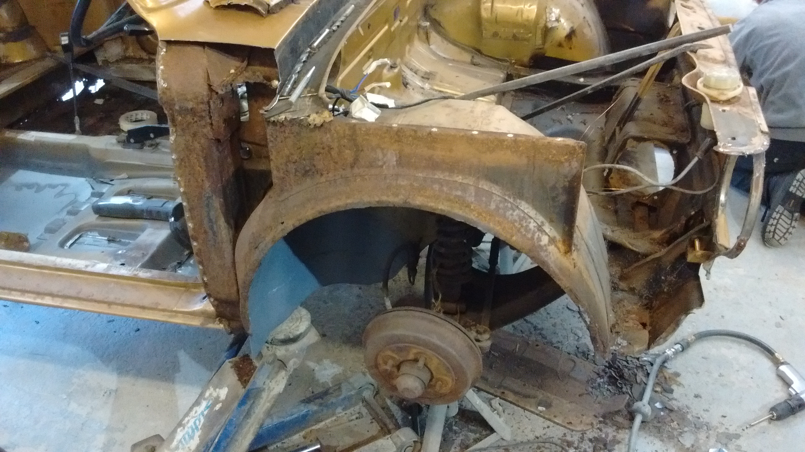

been extra busy elsewhere of late so hadn't got anything much done on the little imp.
did get up there yesterday evening for an hour or two.

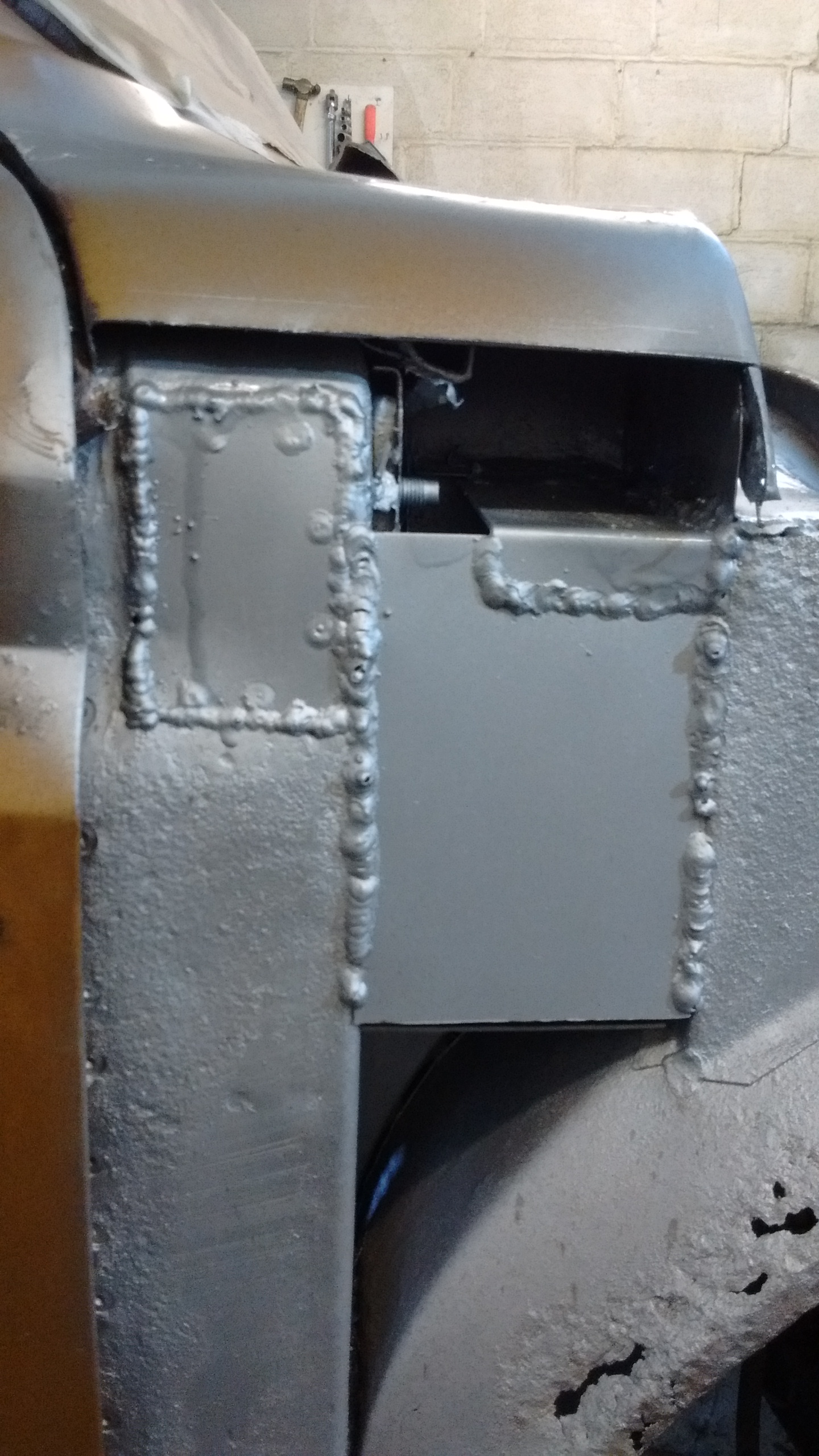

as I eluded to last time, the drivers A pillar had suspected to be rusted inside, the wing was being forced back onto the door leading edge and corrosion could be spotted from inside the car up in the depths of the pillar
whilst rob wasn't around to stop me I chopped a big hole in the windscreen scuttle panel to have a look inside,..
the top part of the box section above the door hinge mounting bolts had completely disintegrated and looking further down the depths it didn't look any more promising so nothing for it but to take the wing off.
now on suds it's a simple matter of undoing a selection of bolts, the imp unfortunately has a spot welded on wing plus brazed sections around the light openings.
also the door needs to come off but with 8 cross head screws holding the hinges on it didn't look good, 40+ years without moving and no purchase gave me little hope. of course with the hole i'd made I was at least able to get some release spray oil onto the threads, so with the aid of an impact driver they all came out nicely! thought i'd have to drill out more than one of them
with the wing off we plan to fill in the void with some thick new steel, that should keep the body line between the door and wing at least a constant gap
it's not nearly as bad as it looks. after a brush up and a poke around most of the remaining metal is solid enough to keep, just a bit of repair work to the wheel arch lip where the wing will need to go back on to.
the wing itself will need quite a bit of repair work if we can't find a new or at least a better one....rob's starting to find the backwards steps a bit trying I think, but I keep telling him - there's no point in not doing this work while we're at it.

as the A pillar was giving some grief and rob I think was worried about the droopy door I thought i'd better get it sorted.
so with a few reinforcing plates cut and welded in the door finally hangs nice.
the screen scuttle section i'd cut out to gain access went back on with a few little repair plates
the door gap is nice now whereas before it fouled the wing and scuttle when opening and closing.
I have cut the bottom inch or so off the scuttle as it had some corrosion, i'll make a new section to suit once the wing is going back on to make sure the lines are decent

Rich has been busy beavering away cleaning up parts and getting the remaining bits ready for fitting back to the Fulvia, this week I've taken a few hours out to get things near to the finish line.
First job was to fit the servo and brake master cylinder as access to the pedals is needed to connect it all back in, then the new set of seats went in.
These are some really nice soft and comfy ones, really in keeping with the car. Match the door cards pretty decent too despite them not being the original set to the car.
The rear badges had been nicely cleaned up and colour coded so they went on to complete the rear view
The wiring to the rad fan and a few other pieces needed tidying up so whilst I had access through the front panel that got done.
Front bumper went on next, followed by figuring out how to attach the front indicators back in place as the mounts had sheared when they were removed, plus new earth wires needed making up as they were originally on the seized mounts.
Headlights next in line which Rich had taken the trouble to strip down and fit new bulbs etc. As this was another item I'd not removed it took a moment or two to figure things out. The drivers side main beam light actually has a cut-out in the back to clear the radiator, very tight for space. Things followed on smoothly until coming to the passenger main beam light which looks to have been a drivers one at some point, or a combination of both. Certain features fitted the handed alignment holes but the adjusters and mounting holes didn't. A bit of stripping and fettling and they were all on.
All 4 lit up nicely, I'll leave the covers off until the MoT is done so they can be fine tuned for alignment.
