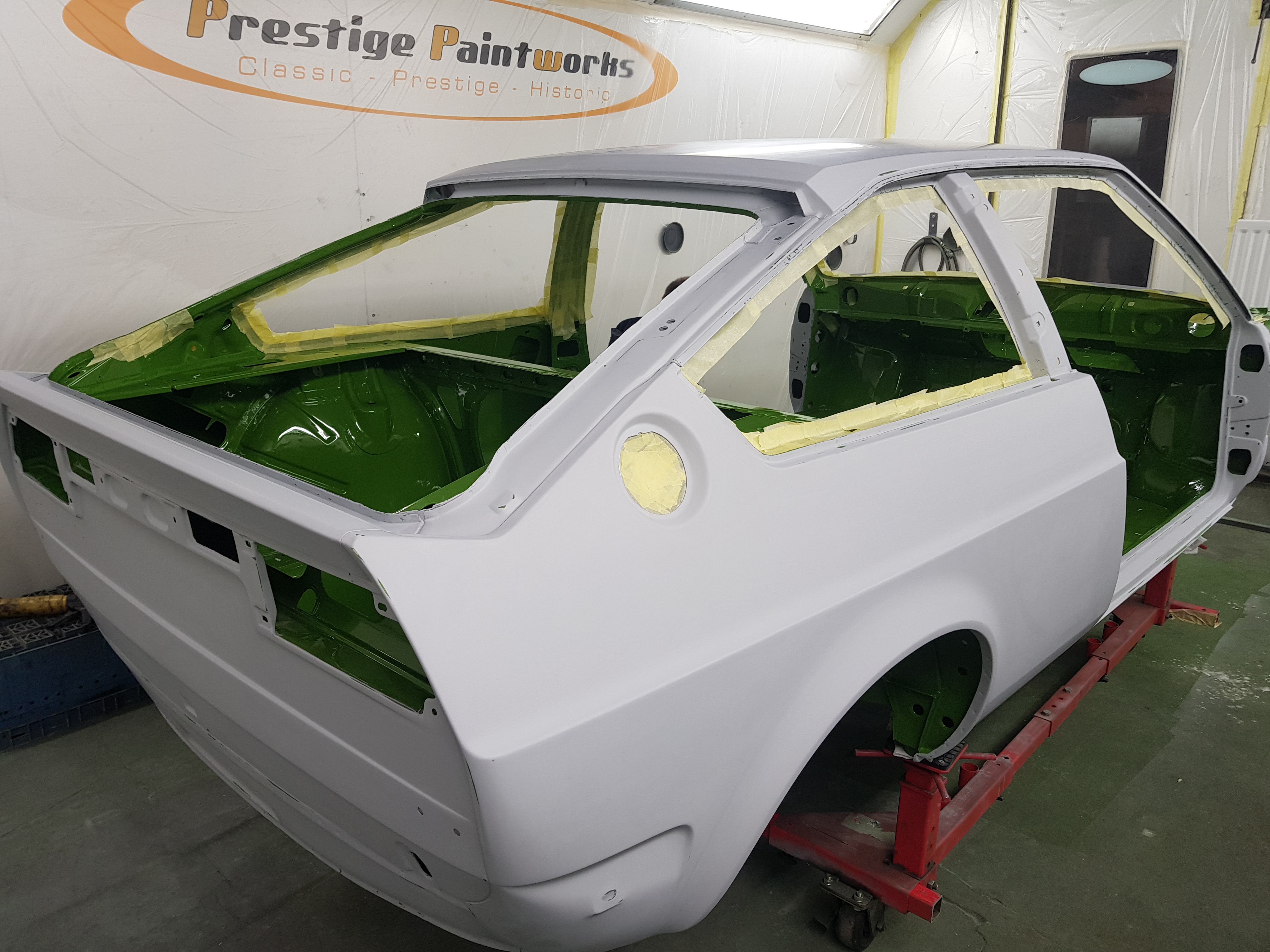

Meanwhile, the outside of the shell is nearly ready for paint. The agenda is to have it fully painted before Christmas so that there is plenty of time for the paint to cure over the Christmas break.

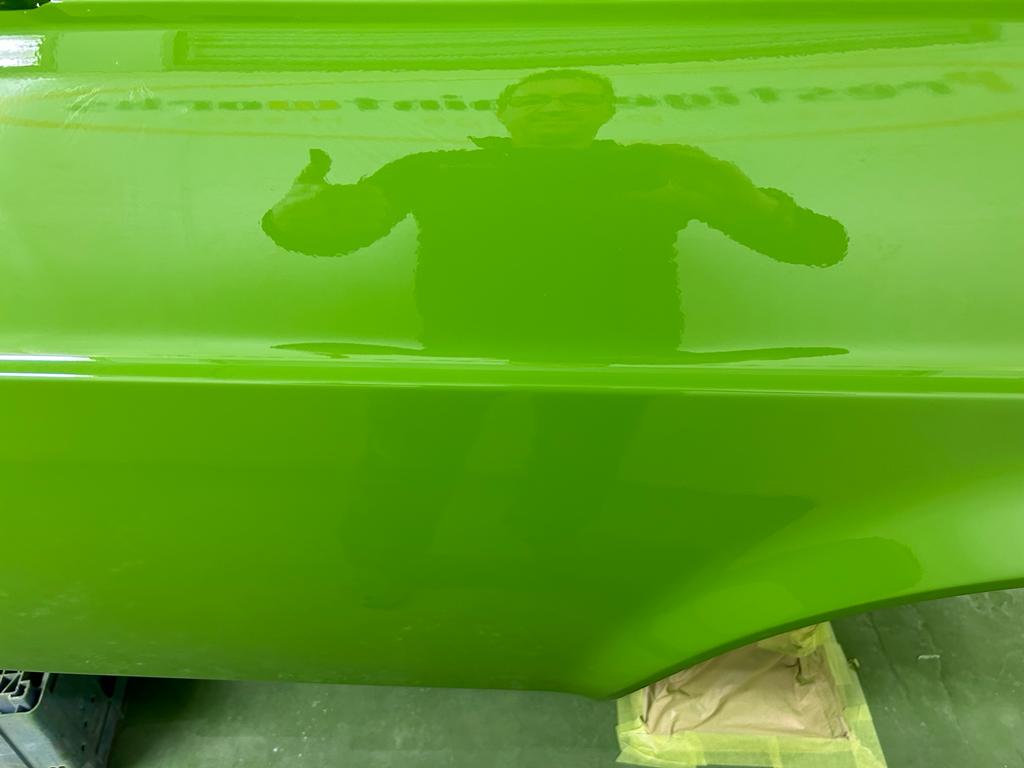

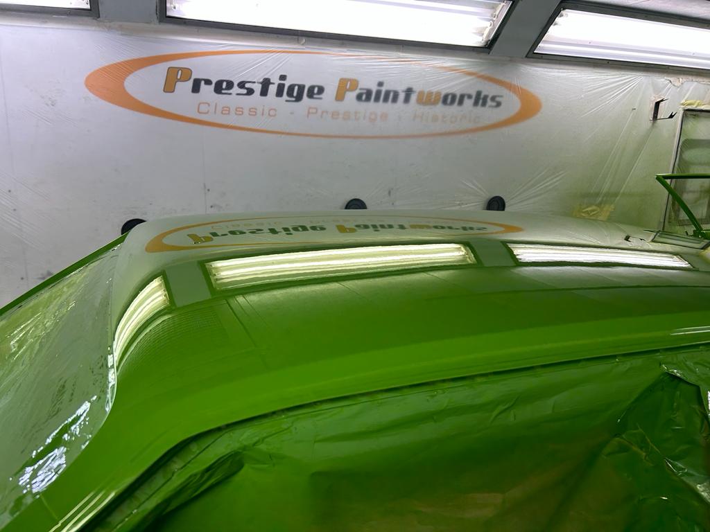

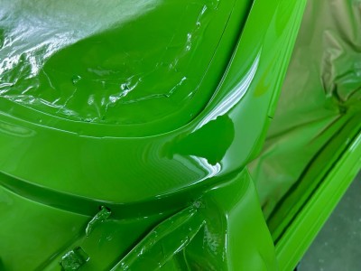

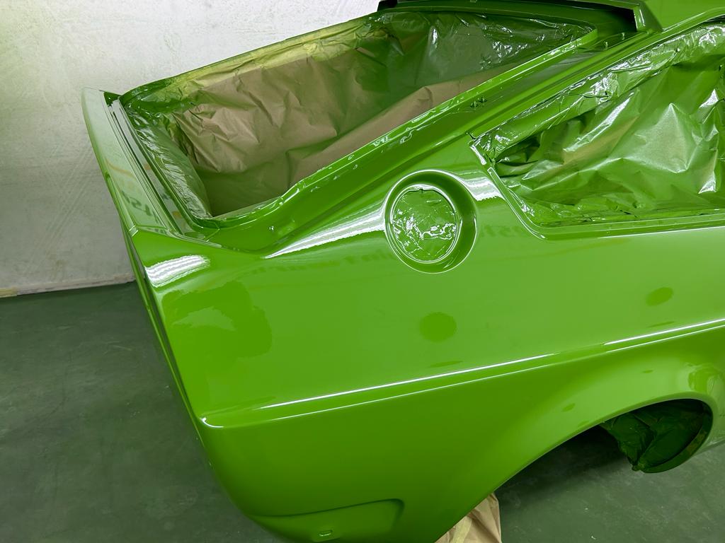

And now the topcoat, these pics show the paint straight from the gun taken by Chris, who sprayed it. He’s reflected on the rear quarter. :D
It will be left to harden over the Christmas break then fine sanded and buffed. The B post covers will be green, Chris has decided. I might tell him to strip & polish all the matt black stainless trim strips as revenge :lol:

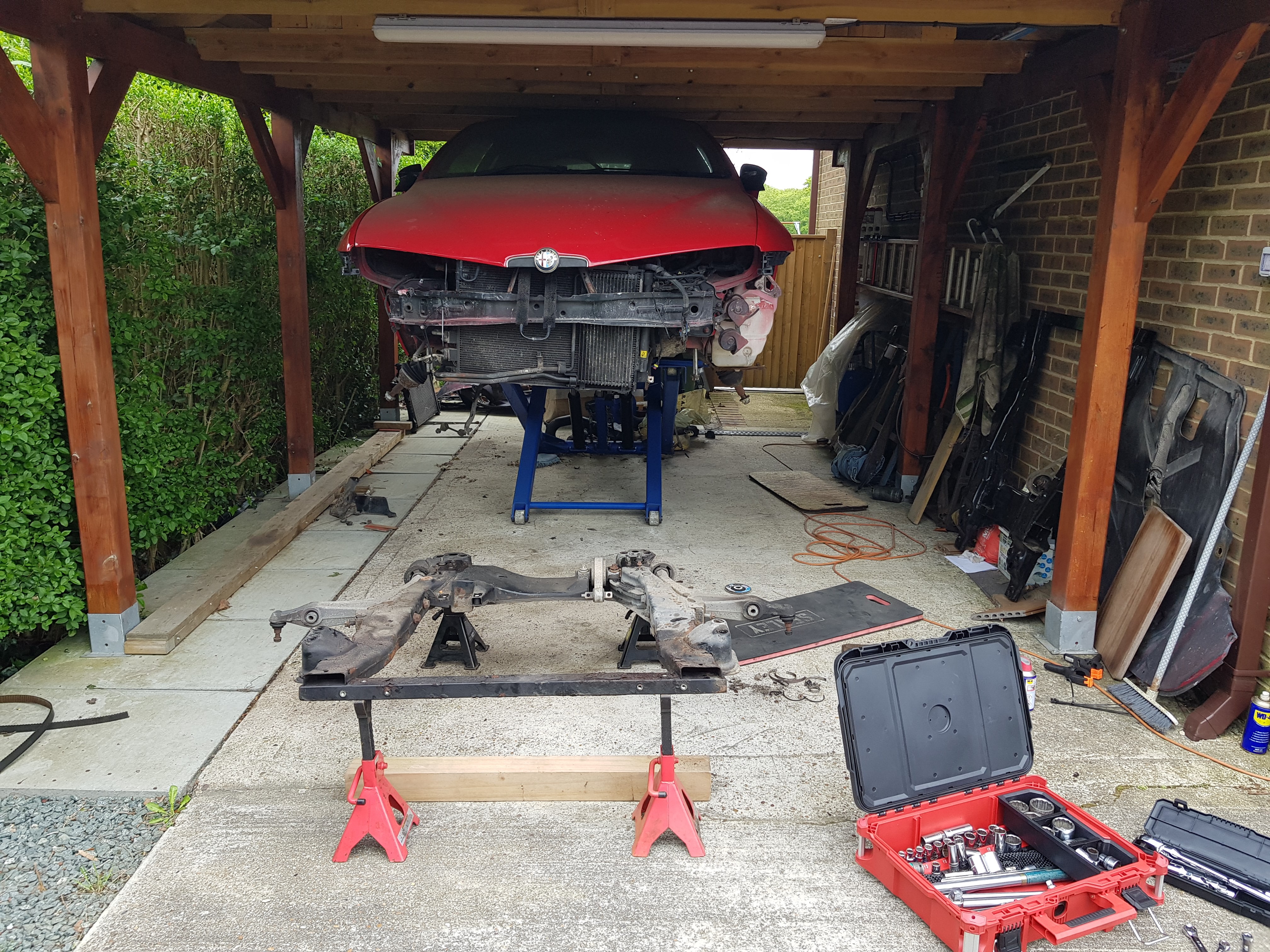

Sorry for going off topic. I have repainted both front hubs, cleaned out the bearings, repacked with new grease and replaced the seals. I posted what I learnt doing this on the bearings replacement thread. I have also repaired and repainted the steering column. Repaired........? Yes the plastic sliding block behind the up/down adjuster had shattered. I made a new one out of a piece of 'er indoors' nylon chopping board. She didn't need it, but can't understand where its gone :lol: .
I could post pictures of shiny hubs and the column if you want me to, but it seems a bit 'look at me'.
Work should restart mid May and to alleviate the shop workload I will be putting the suspension & steering gear back on. The plan then is to reinstall the doors and front wings with weight on wheels to ensure a perfect fit. Then there will be the external trim to fit. We are still waiting for the new windscreen from Pilkingtons, I'm going to have to get it delivered as my 159 is dying.
