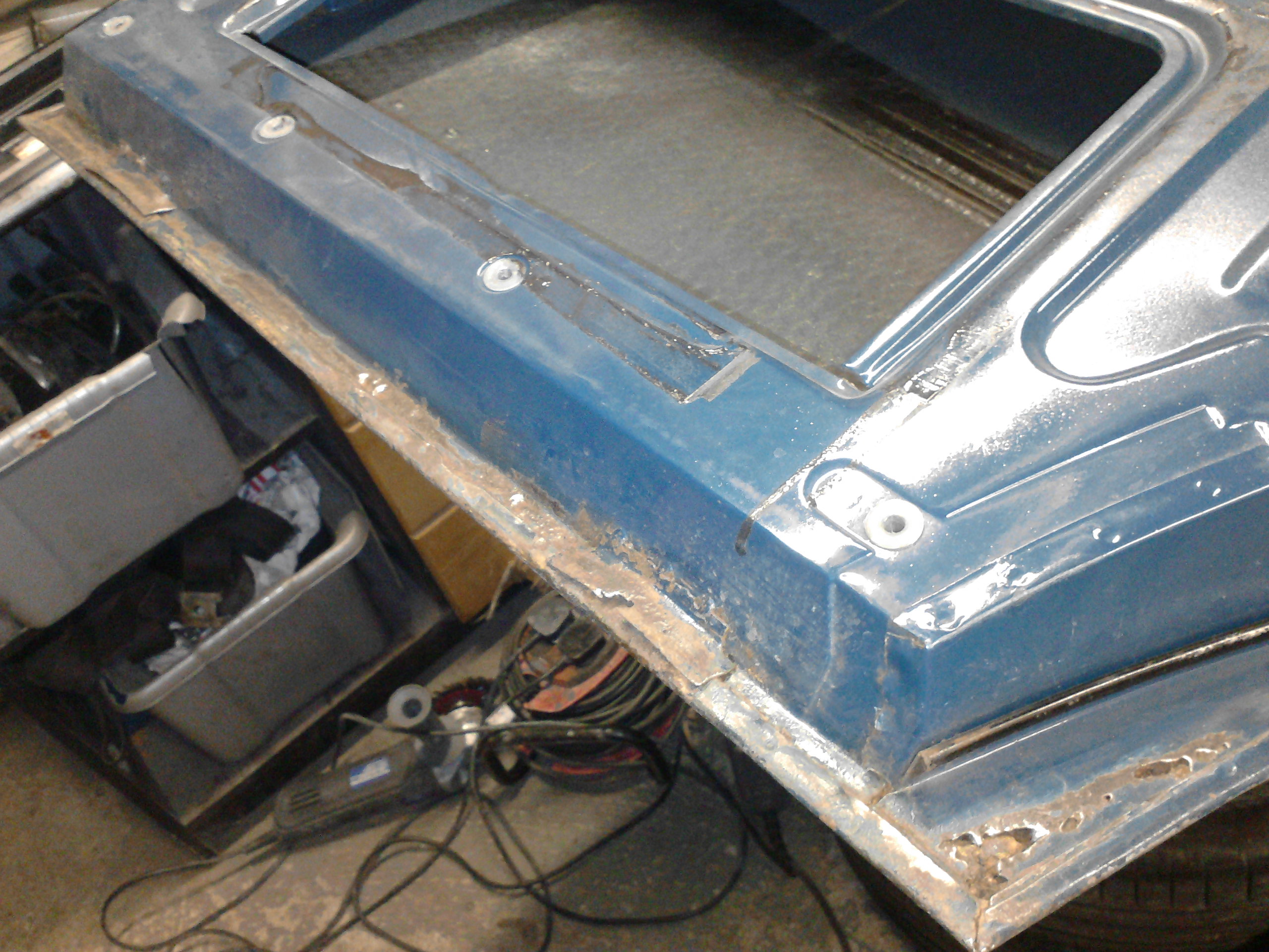

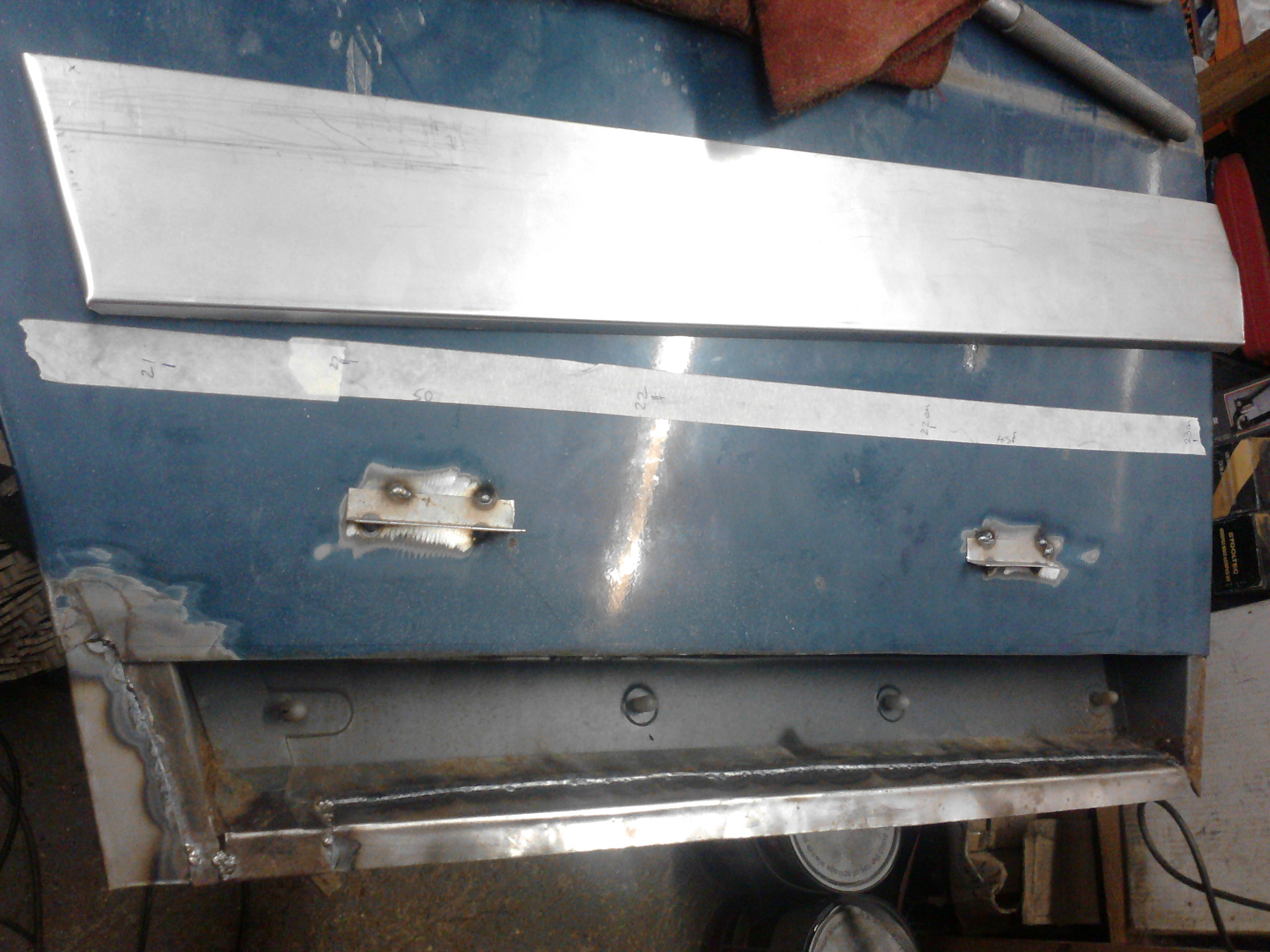

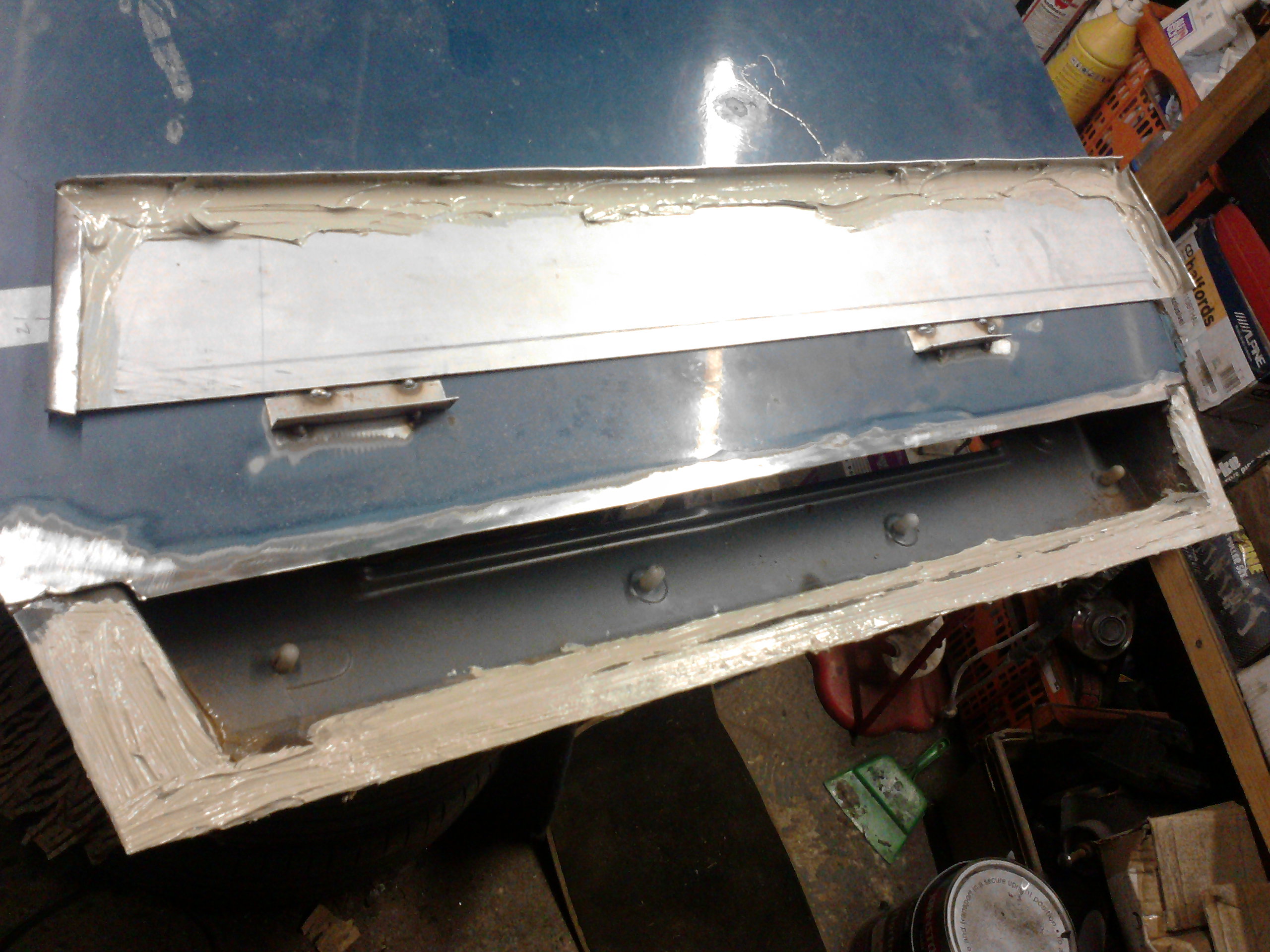

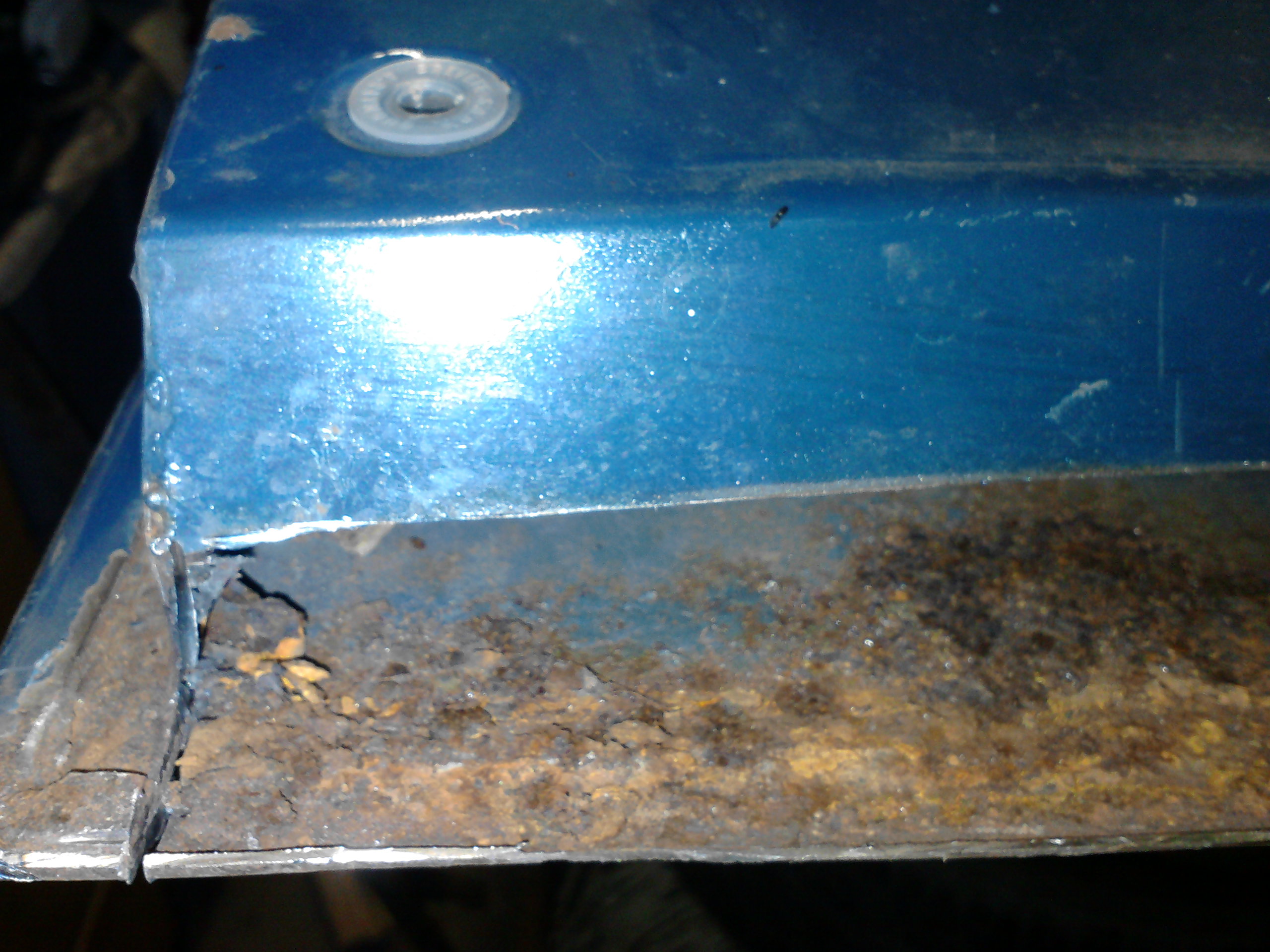

managed to sneak an hour down the shed tonight to start on the door bottom repairs
the inside of the skin and bottom plate have a little more corrosion than i'd like to see in there. a clean up and treat might see it last a few more years but why bother when replacing the metal should see it last another 20 years?

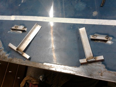

making and replacing the door bottom without the car is a concern as alignment is crucial to keep things in line, ok to measure it up with a tape but a mm or two out and it'll look awful.

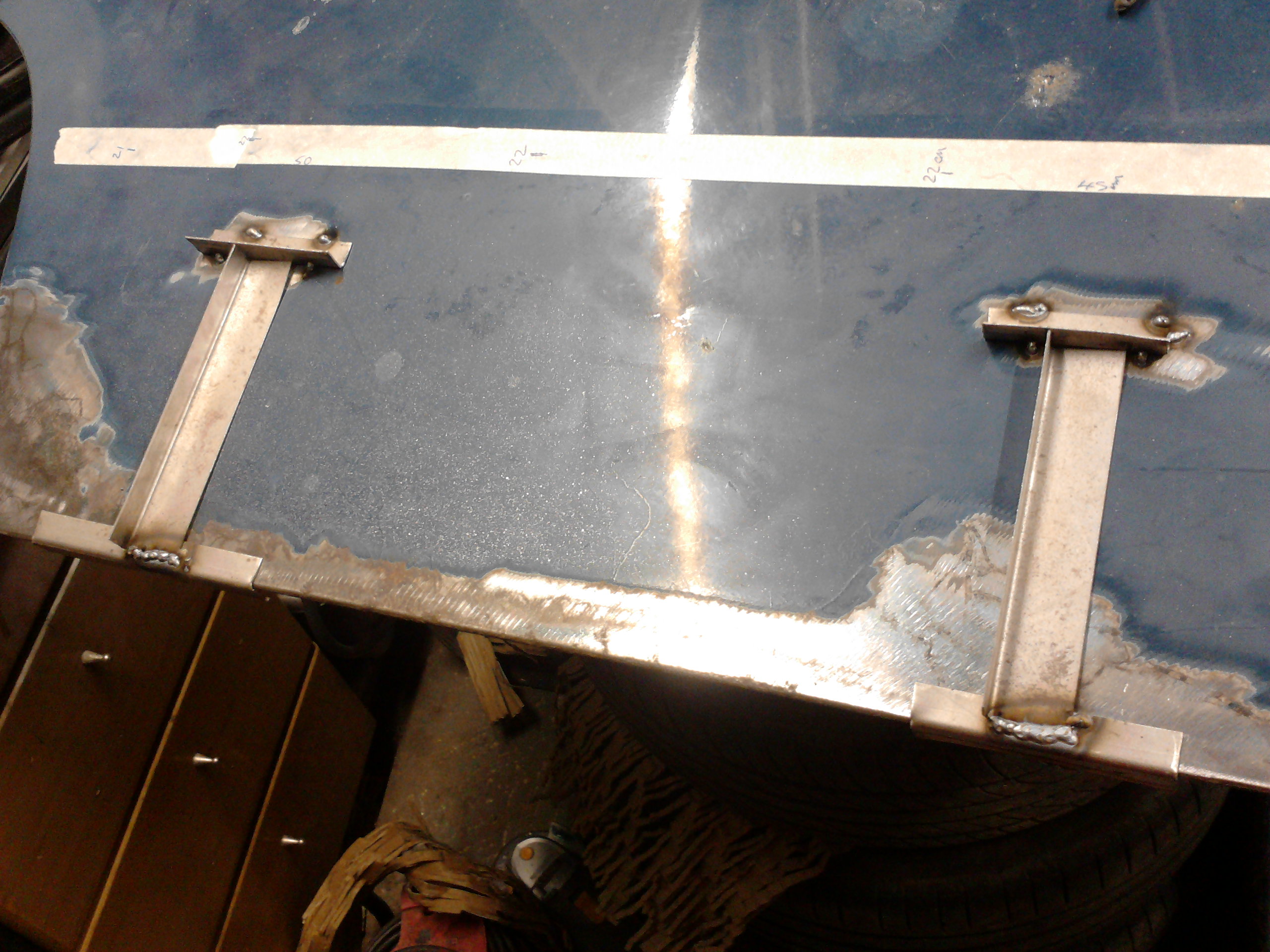

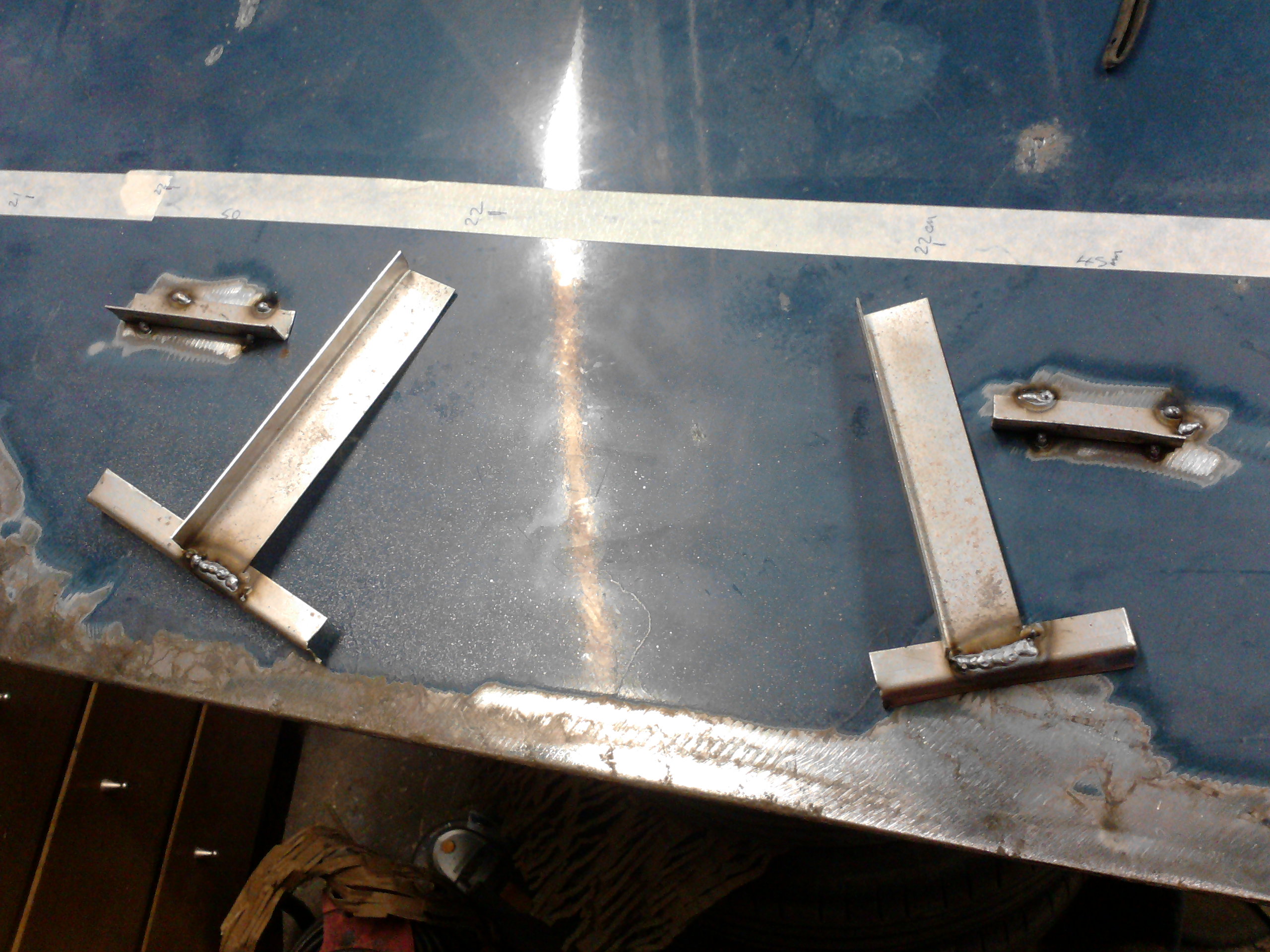

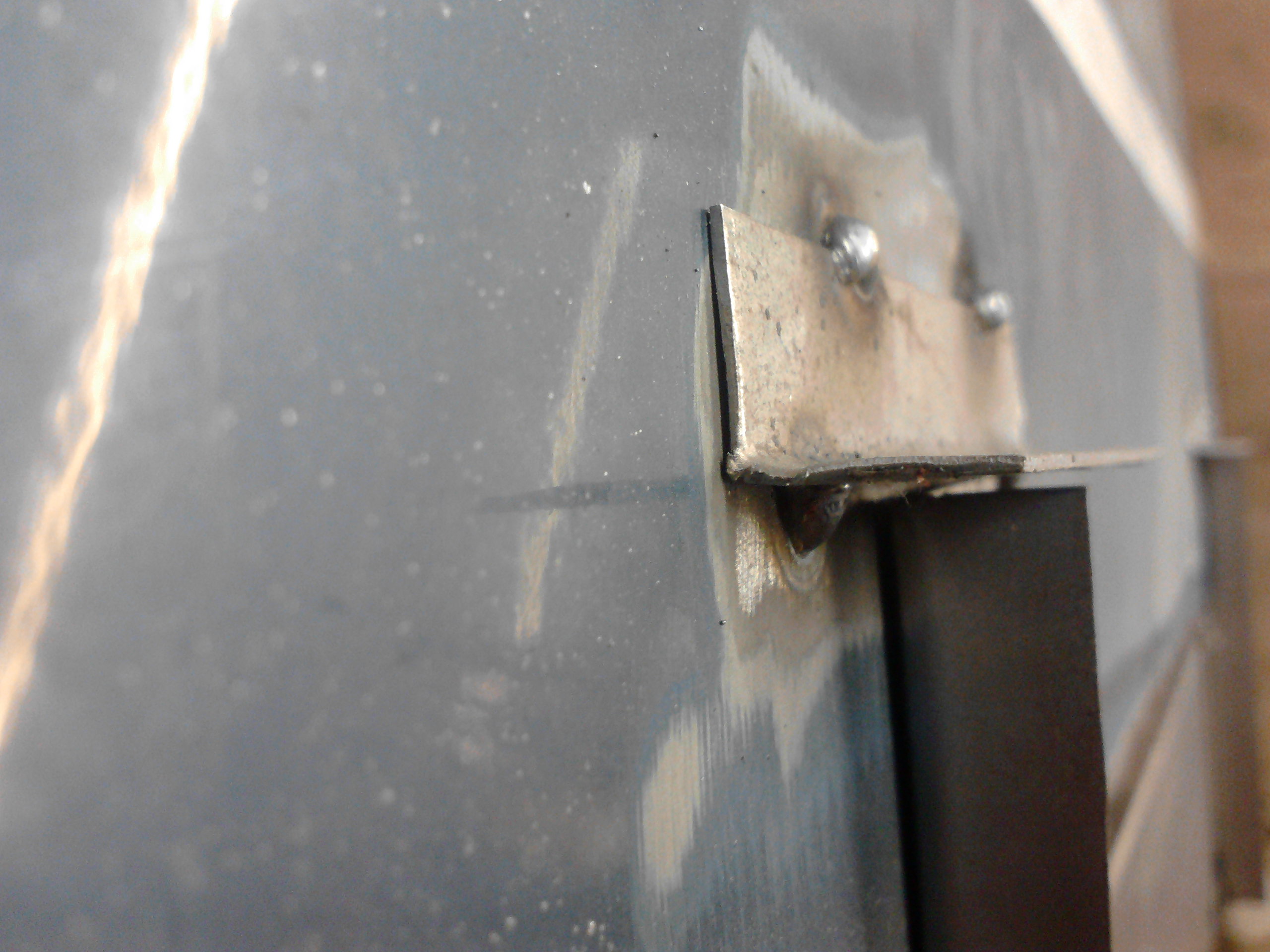

I came up with the plan of making some alignment brackets for the original skin bottom edge which will then be easy enough to reuse when the new skin is offered up
so the steps were to weld a couple of brackets parallel to the bottom edge on the skin higher up than will be cut off then weld a pair of brackets that align with the bottom edge, differing lengths to each other to prevent a mix up
now when the old skin is cut off I can ensure the new one will go back in exactly the same place......fingers crossed!
started to make and shape the bottom skin which luckily the back edge isn't too curved at the point where it will be cut off so that will make life easier
little steps over the evenings this week should see it all welded up

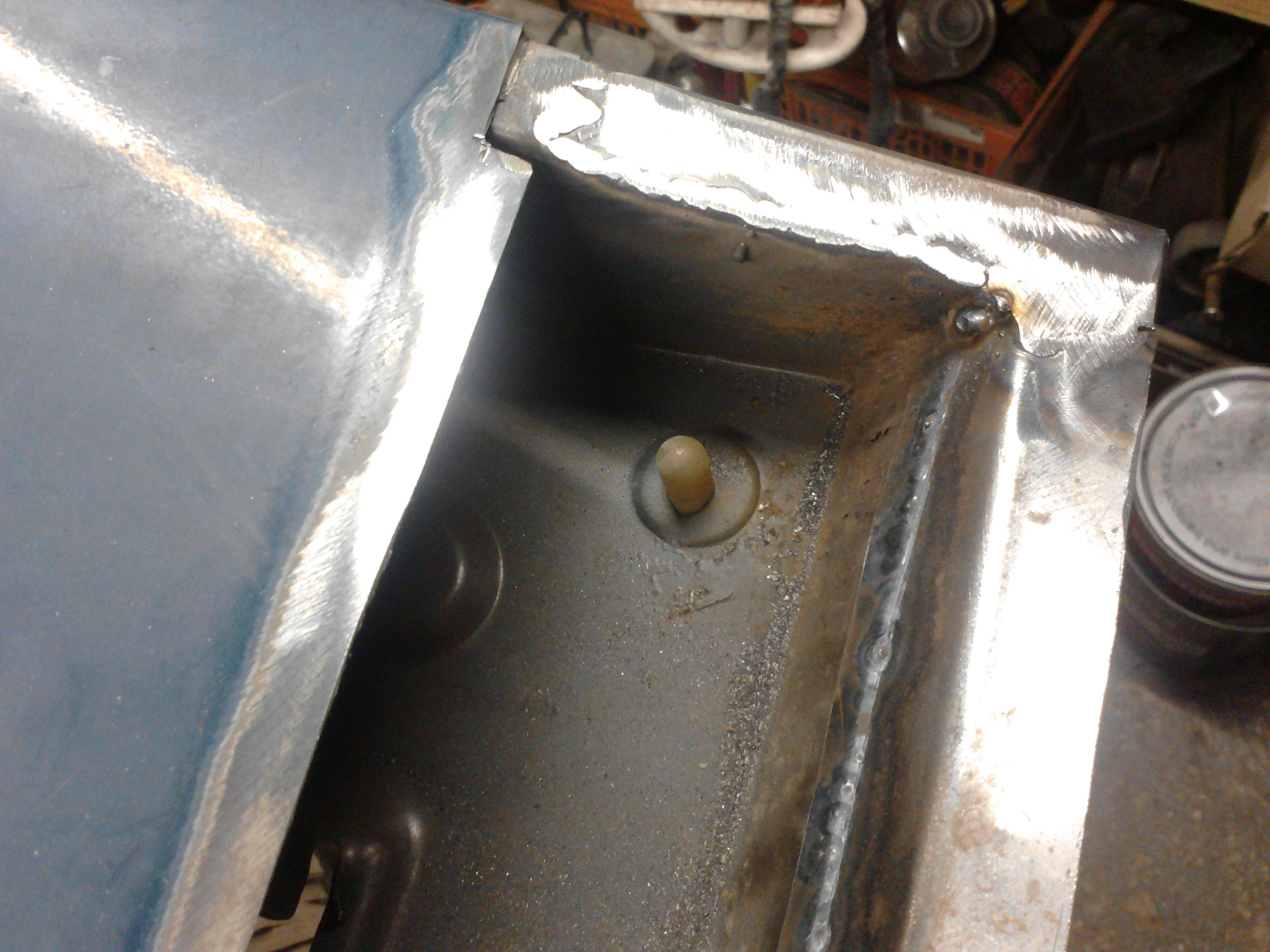

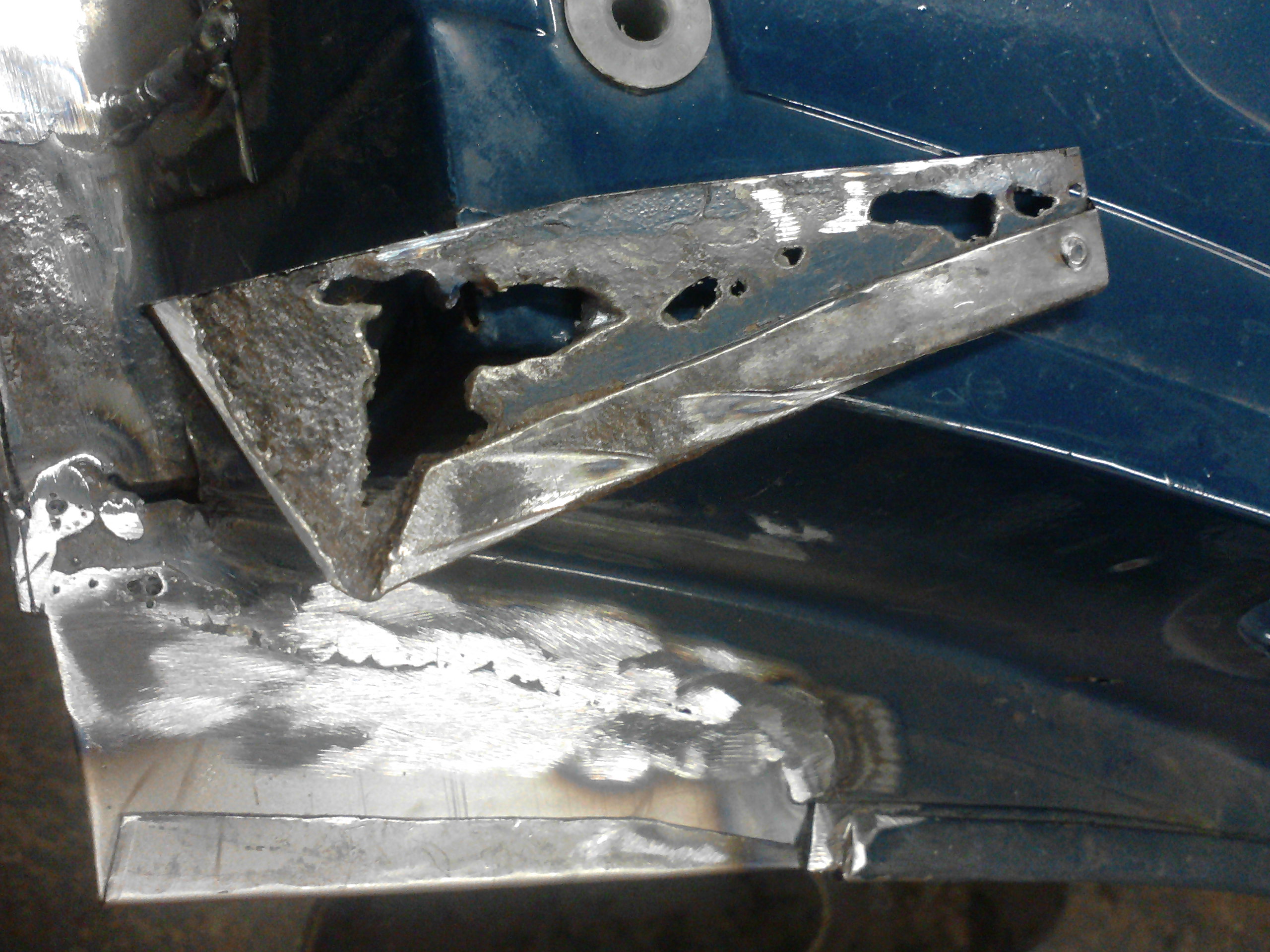

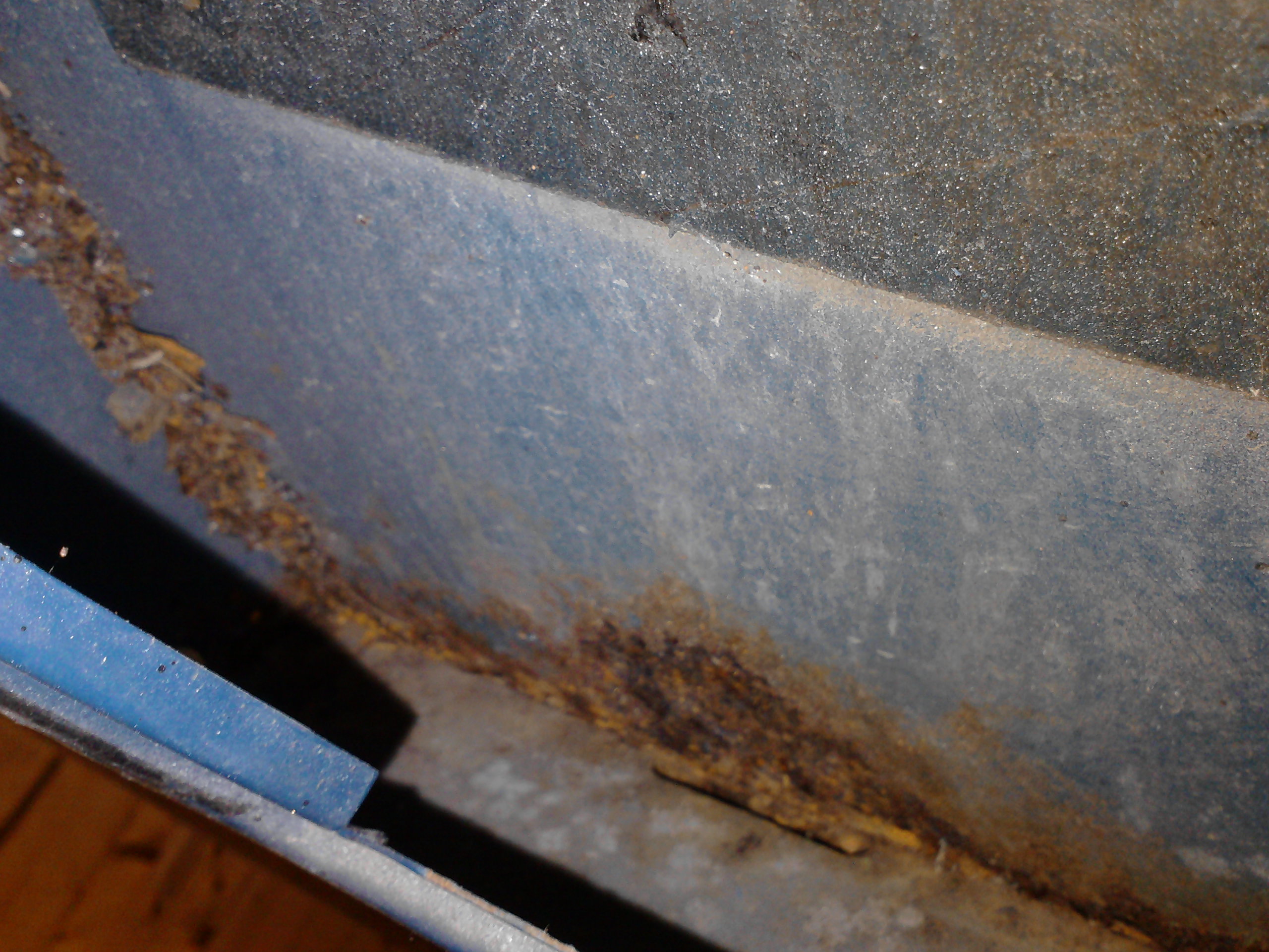

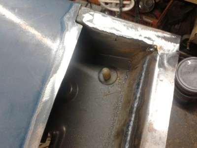

grabbed a bit more time on the door tonight.
once the bottom plate was cut away the hidden rust became evident, well worth the extra effort at this stage to chop it all out.
patch made up and welded into place.
thought better of getting the grinder out seeing as it'd gone past 10pm....can't annoy the neighbours too much! easier to keep working late down the unit without anyone to annoy

fixed the inside face at the rear corner
then cut off the outer skin ready to accept the new bottom section
I've made up a few plywood templates before cutting things off to make sure it's all aligned.....fingers crossed

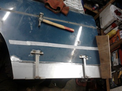

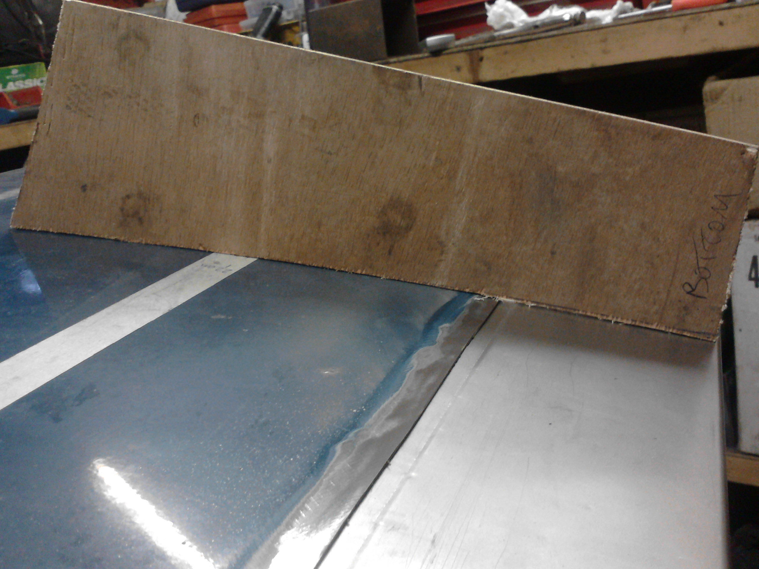

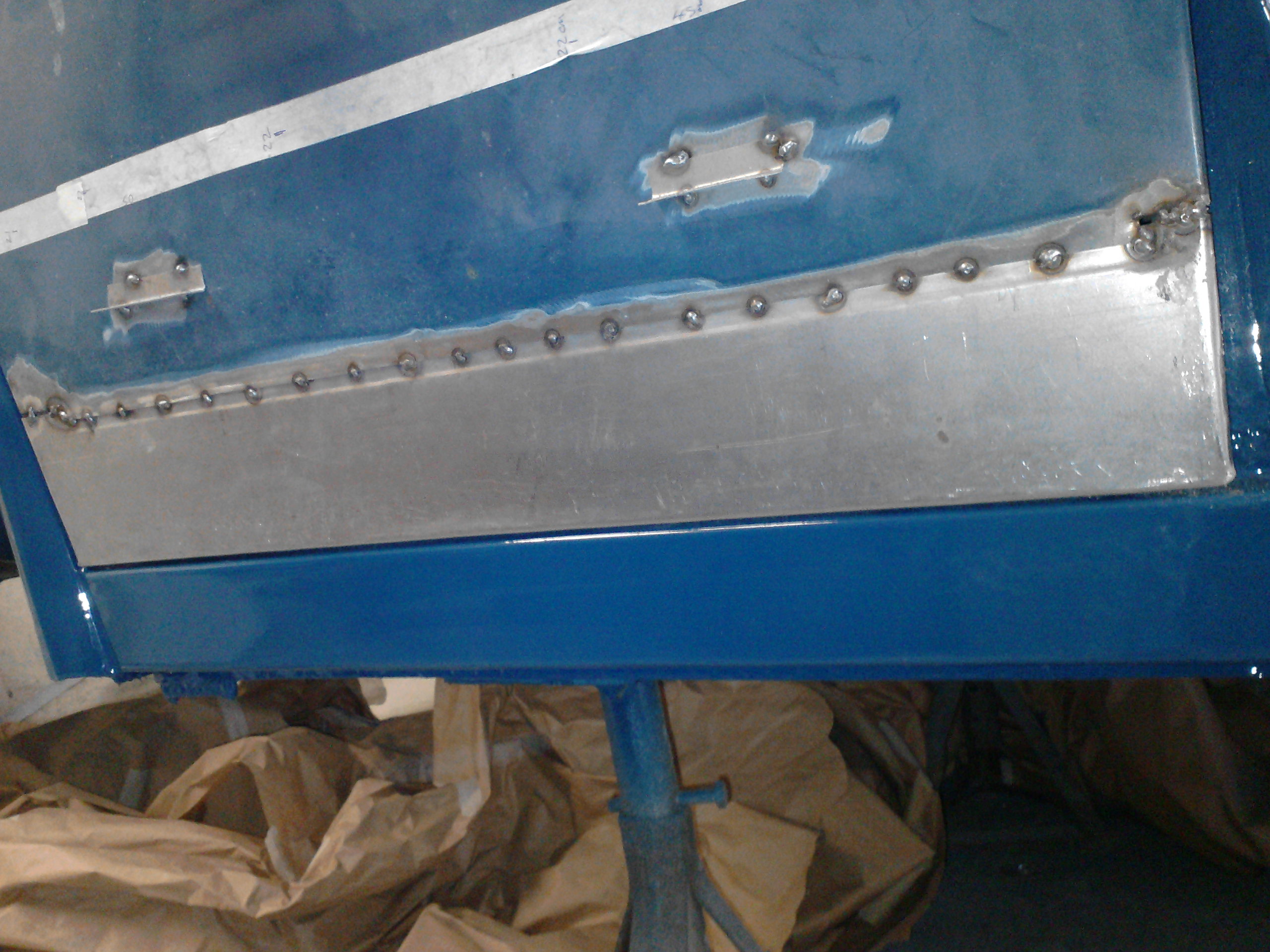

repaired the other corner as it looked a bit crusty
the curvature of the skin I tried to keep in check with a template I made from some plywood
the depth was kept in check via the little brackets I made up earlier
Re: Kev's workshop projects

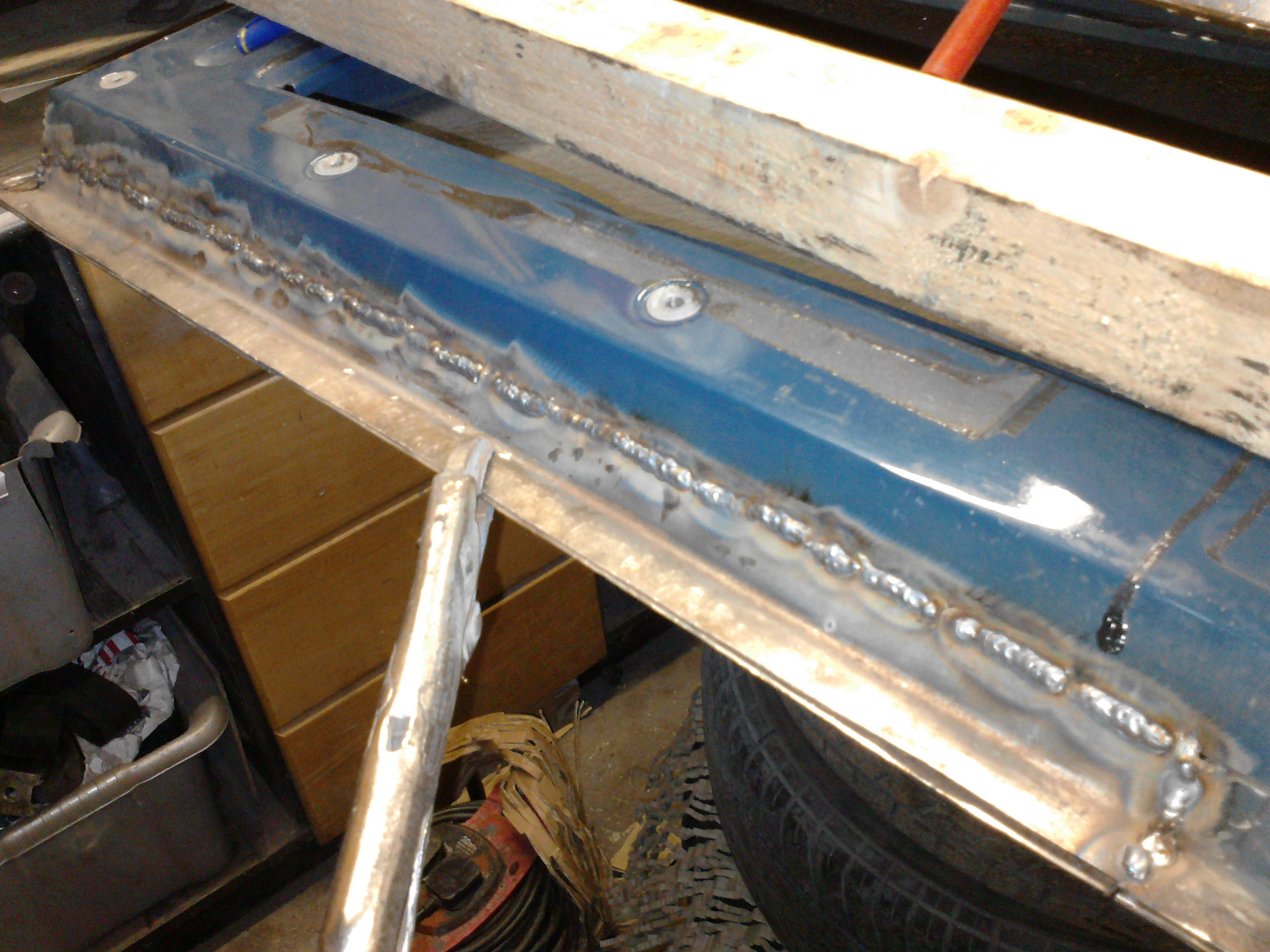

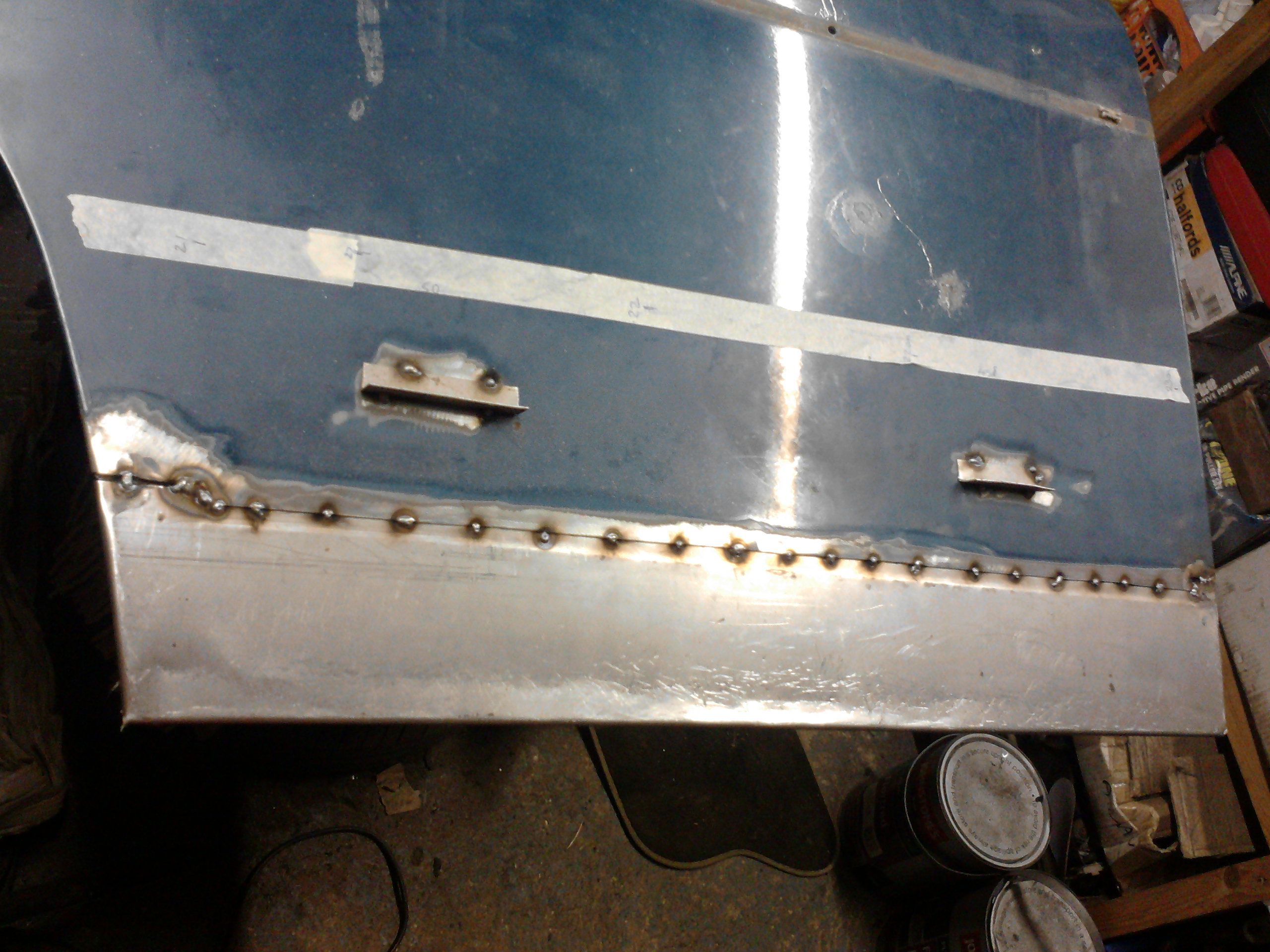

once happy that decent alignment was achievable a tack weld was done at each end then the folds peened over to clamp the skin to the frame, with a good dose of sealant to help with the bonding and to keep water out
when it was all folded over the alignment was checked again, and noted that it was about a mm shy of where it needed to be, clearly shown up by the little brackets I made. was simply then a case of tapping it up to where it wanted to be then welding to the original skin and door frame.

alignment test fit done, happy days.
the theory on the measurements was sound, just a relief to see it actually worked!

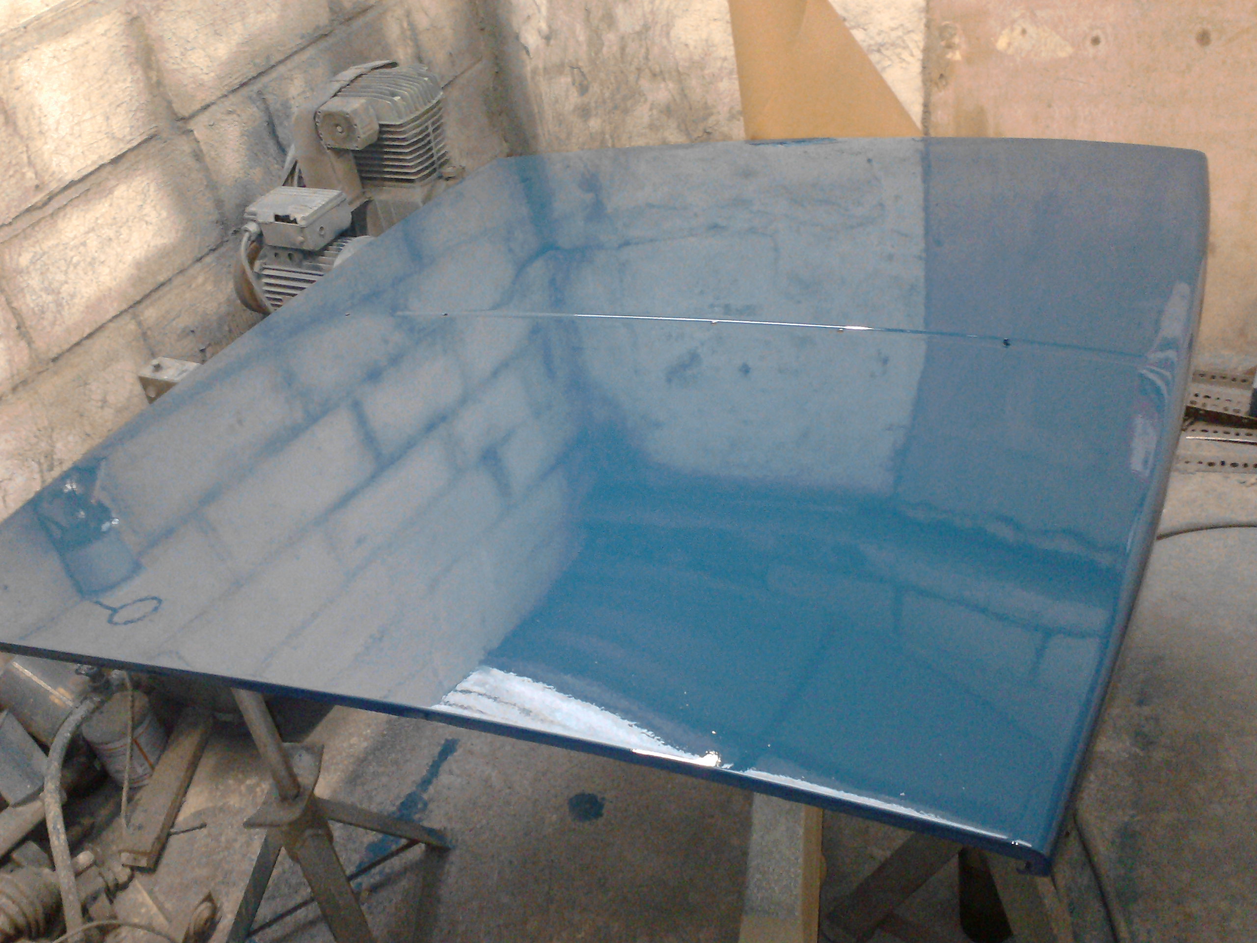

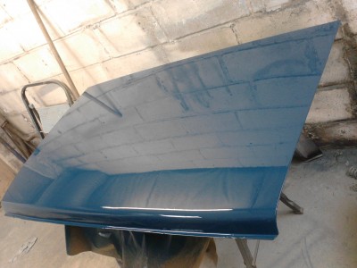

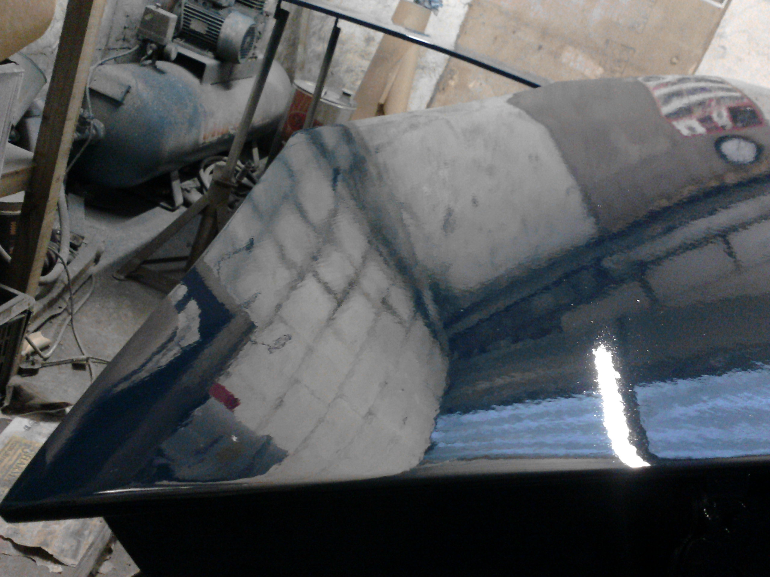

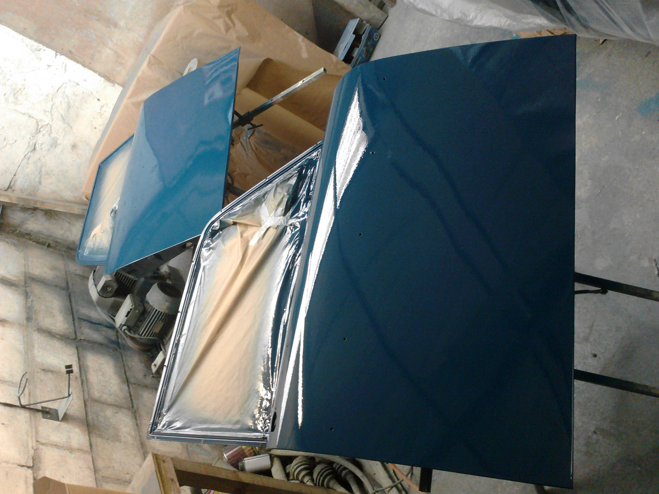

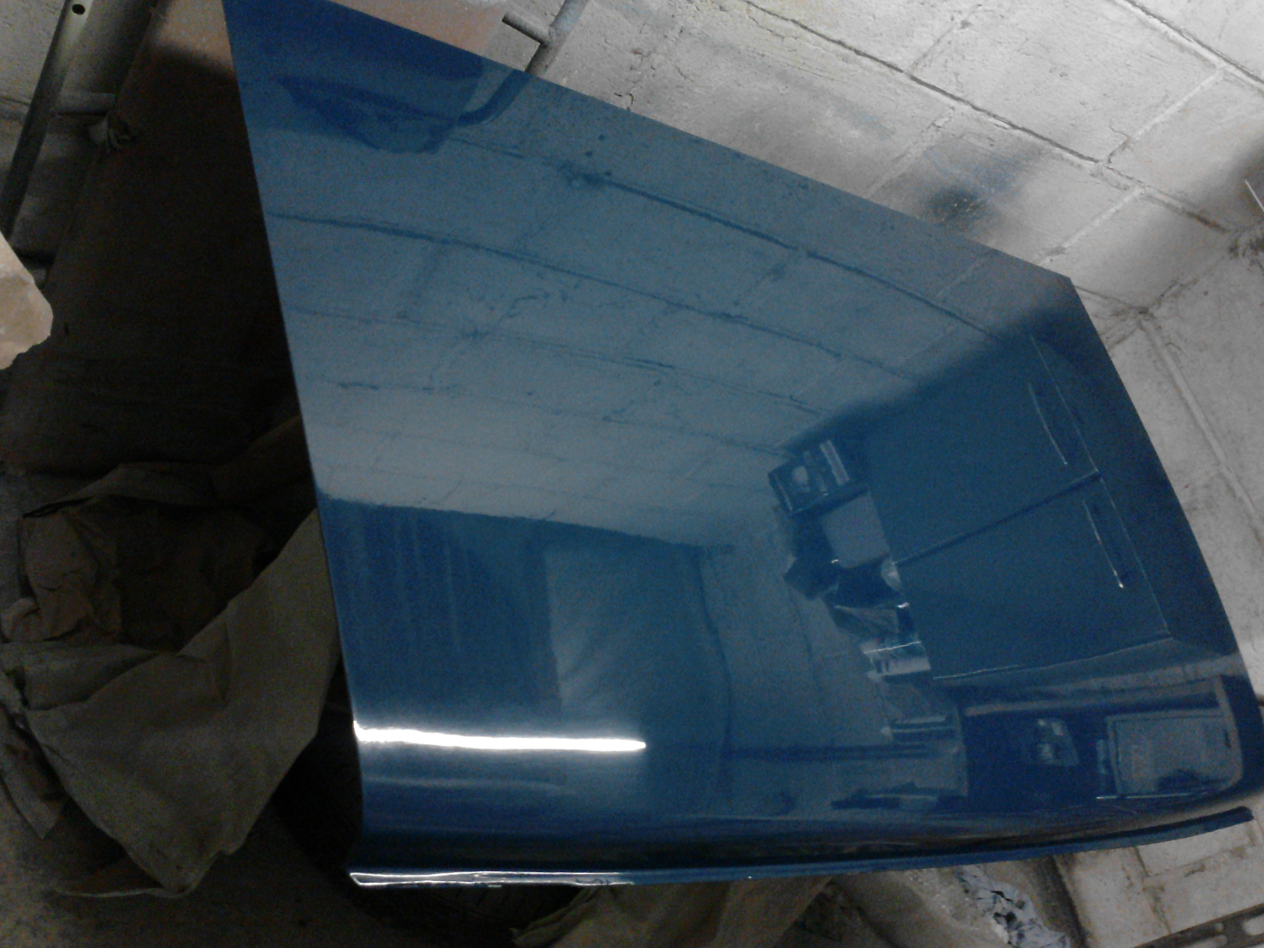

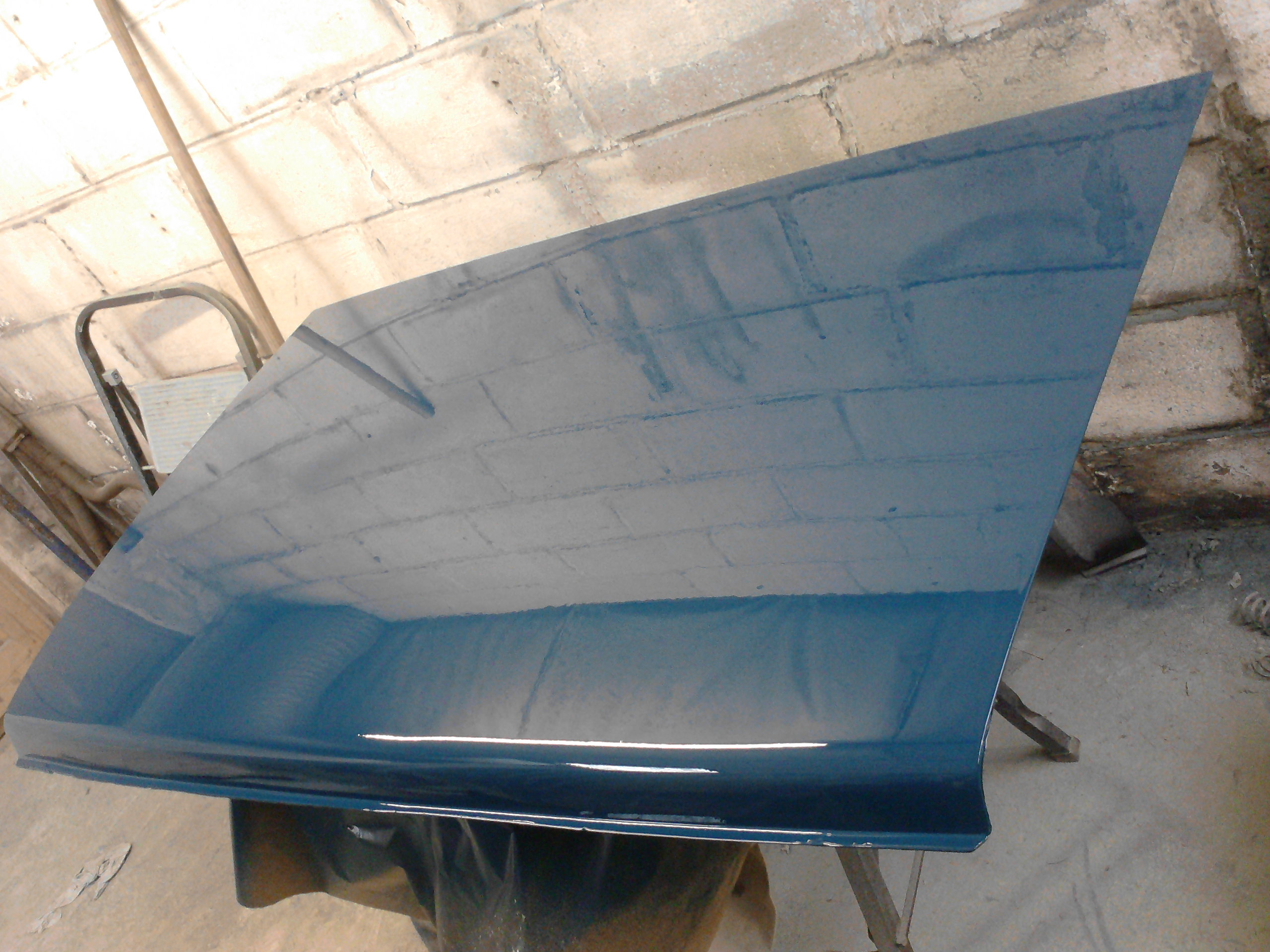

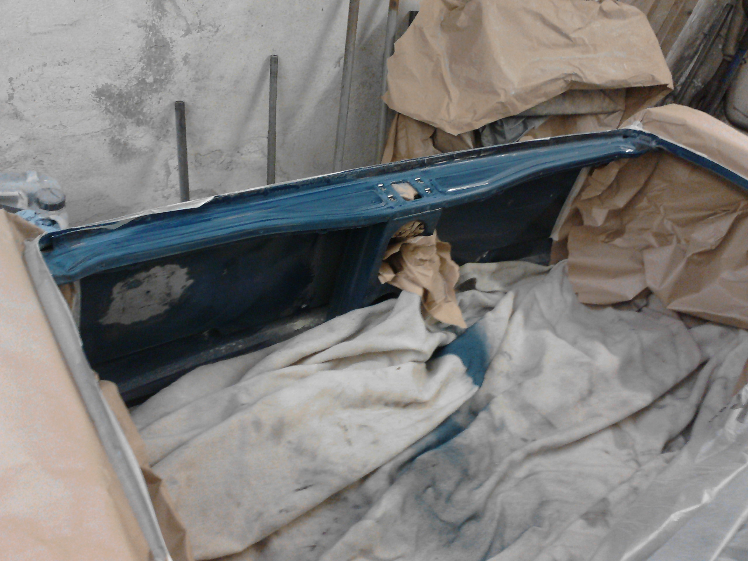

far too damp last Saturday down at the unit to do any painting, not having a pro oven to bake the paint in means I have to be mindful of the weather conditions.
with today off work though and it being very mild for the time of year I got stuck in first off and got the heaters going whilst masking up the doors
usual process of cleaning and going over the panels with a tack rag then on with the painting.
dust coat followed by 3 further coats, the last one being as wet as I dared!
finish on the bootlid has come out really well, doors will need a going over with the wet & dry to rid the slight peel. being on a less flat plane I was worried about runs so it was hard to get it on thick enough without going overboard..

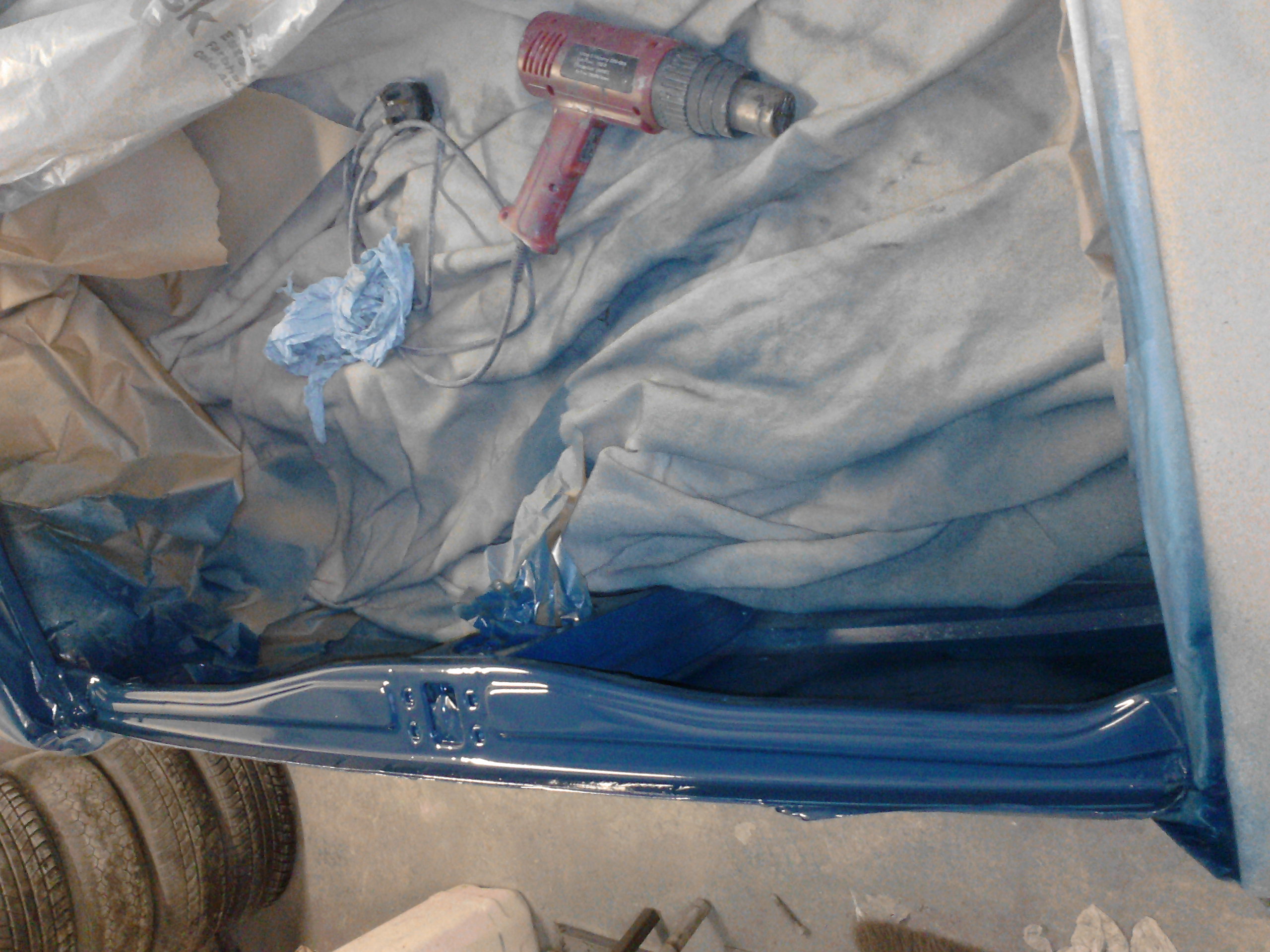

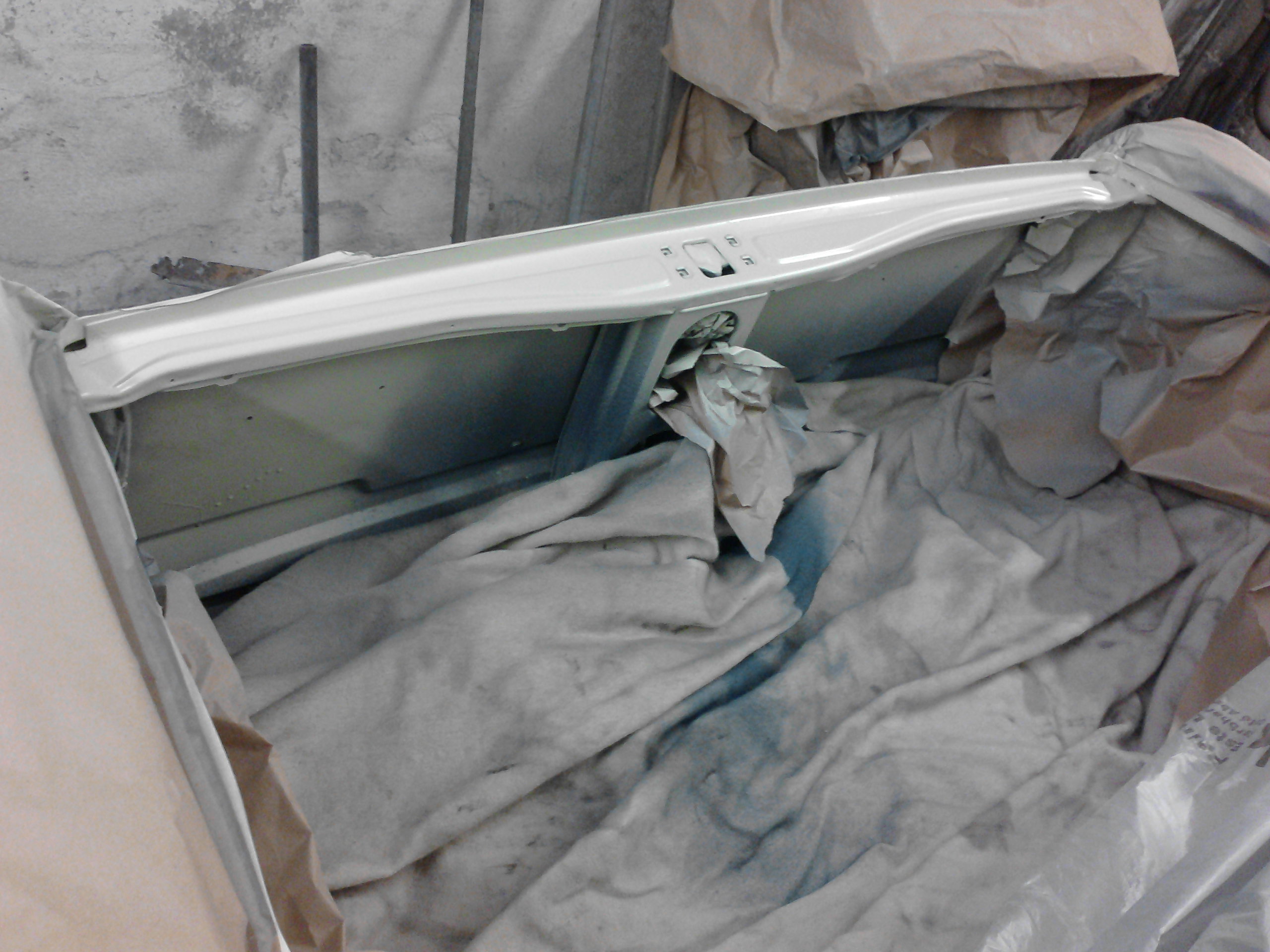

the rear doors and underside of the bonnet were prepped for etch primer next, the repaired door having been filled to get things nice and straight

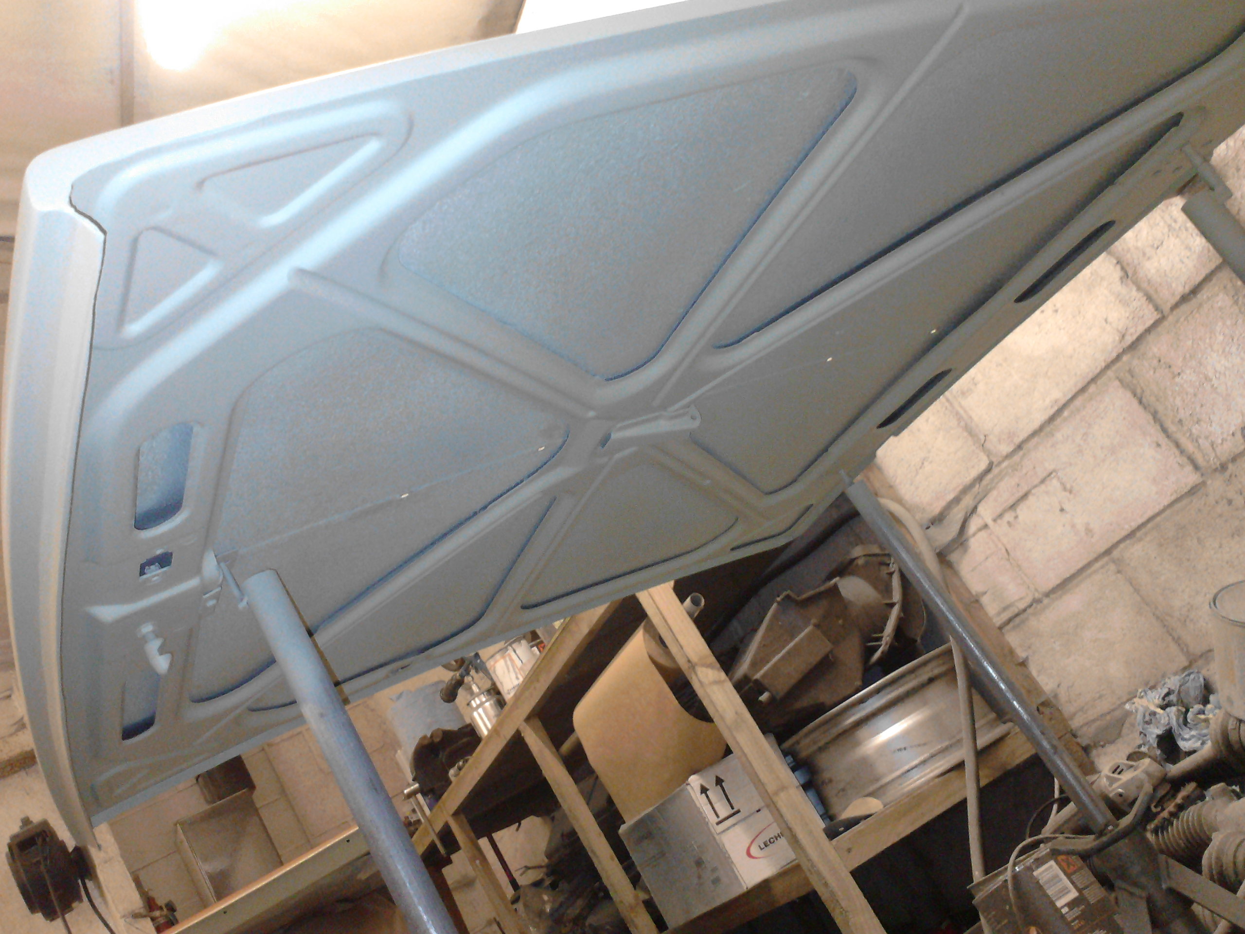

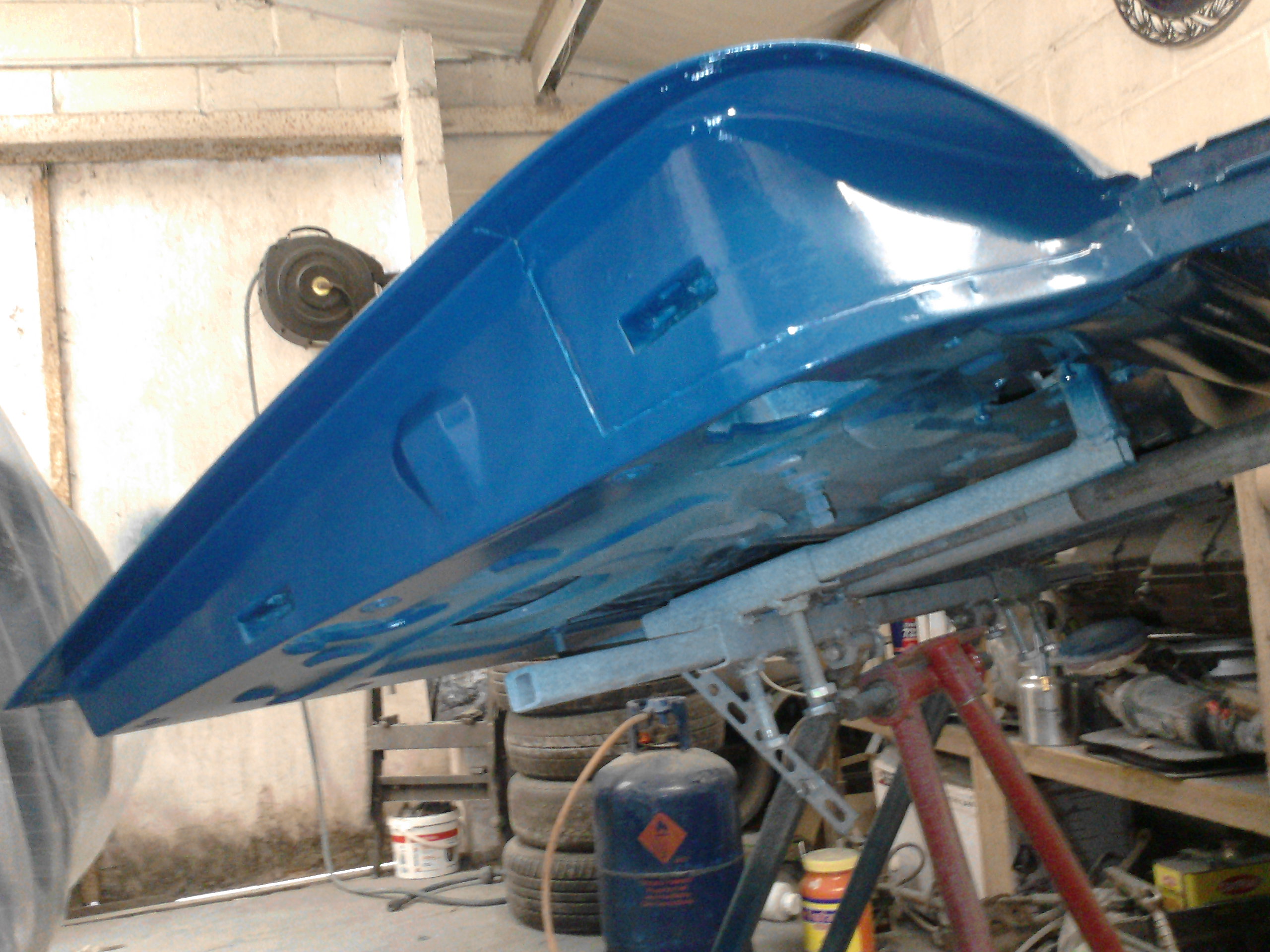

once we had some stable electricity again I set about making 3 legs to stand the bonnet on. it'd been bugging me about how to paint both sides of the bonnet in one go without hanging it from the roof, that prevents you from going full on with the paint as it's so easy to get runs in it...
so I came up with the idea of balancing it on 3 legs high enough so I could get underneath to paint the underside but still comfortably paint the top.
a few odd bits and bobs welded to 3 axle stand legs sorted the job out nicely.
even with 3 strands it showed signs of reaching it's limit just using the compressor...

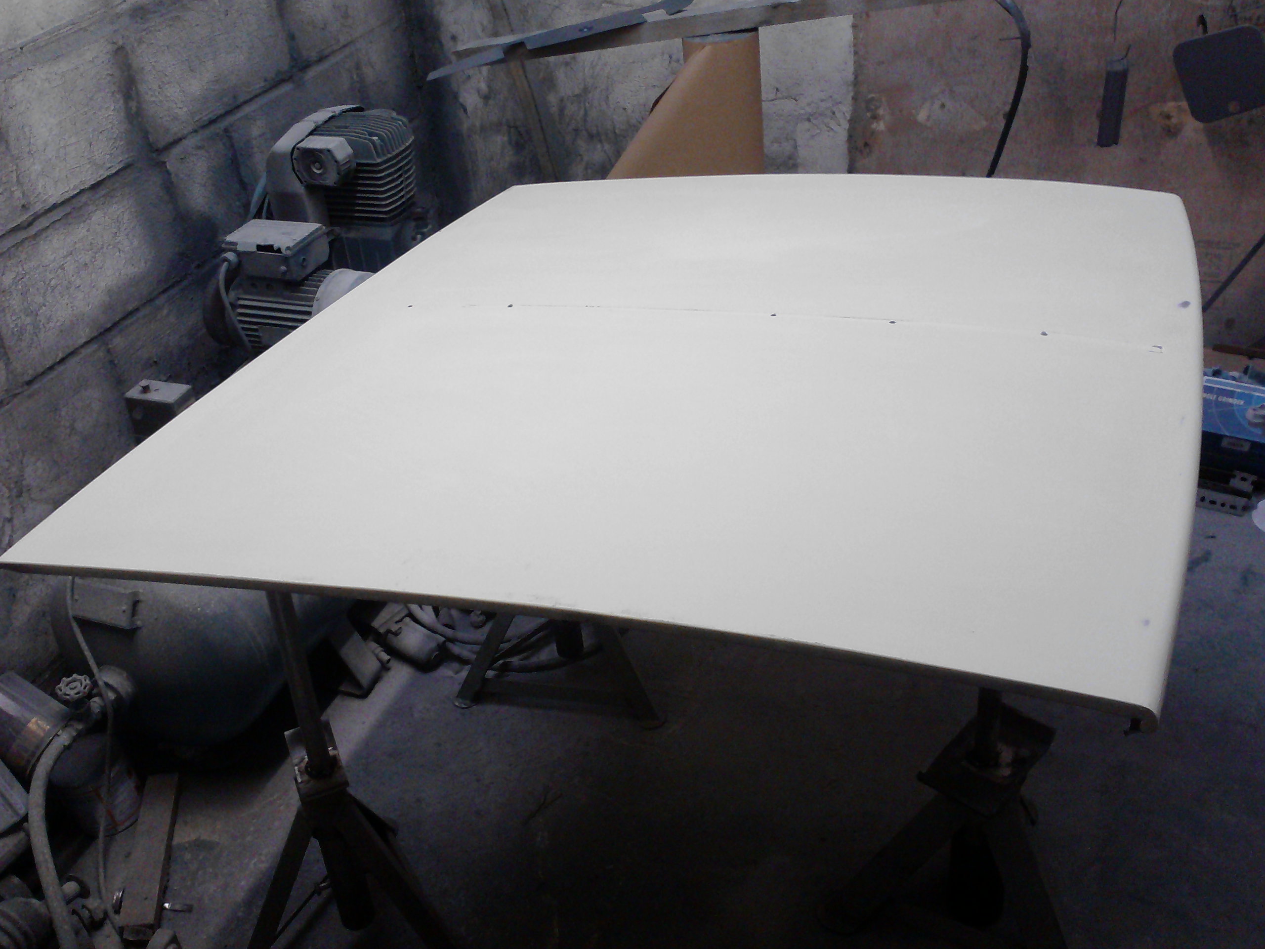

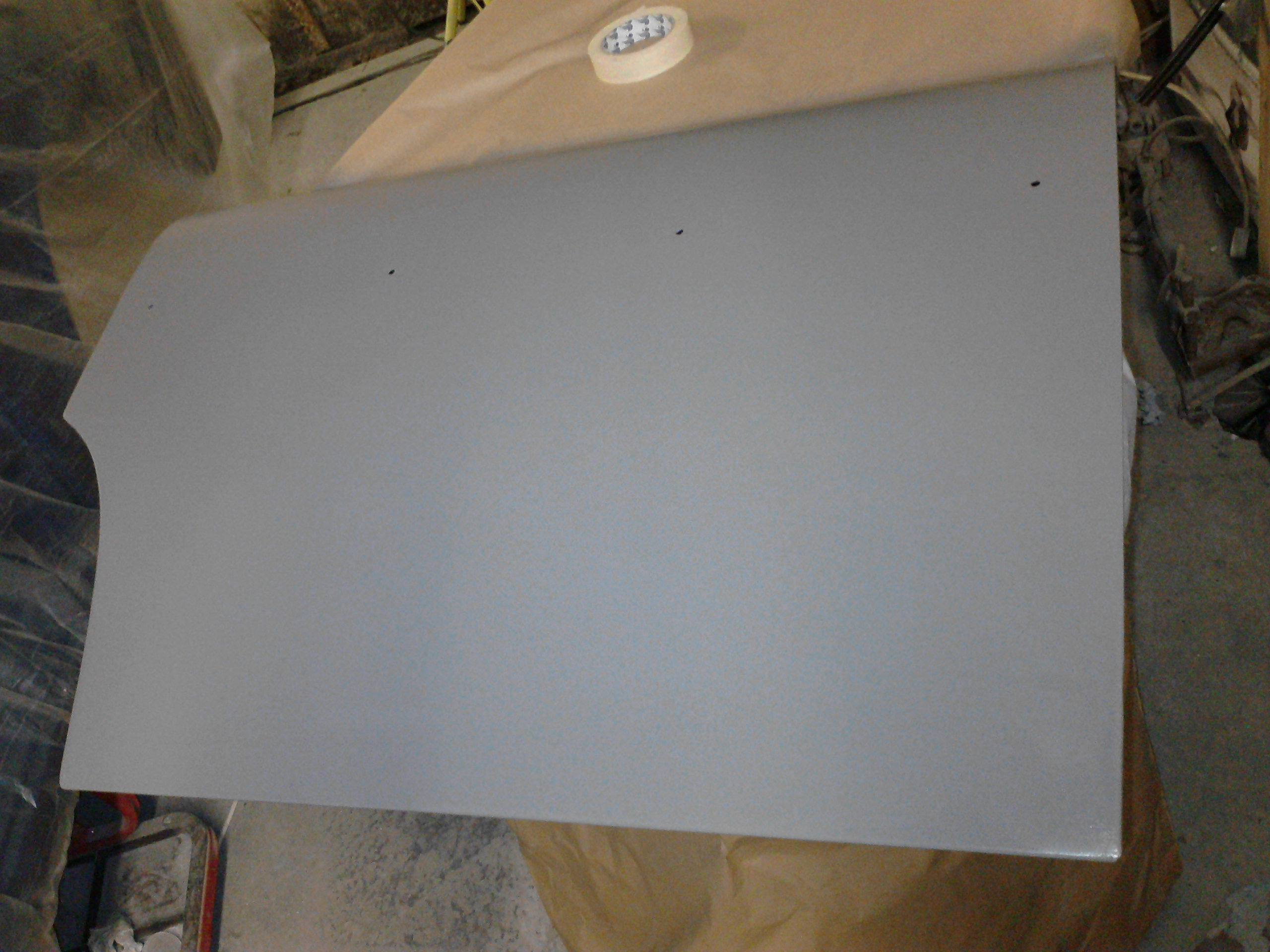

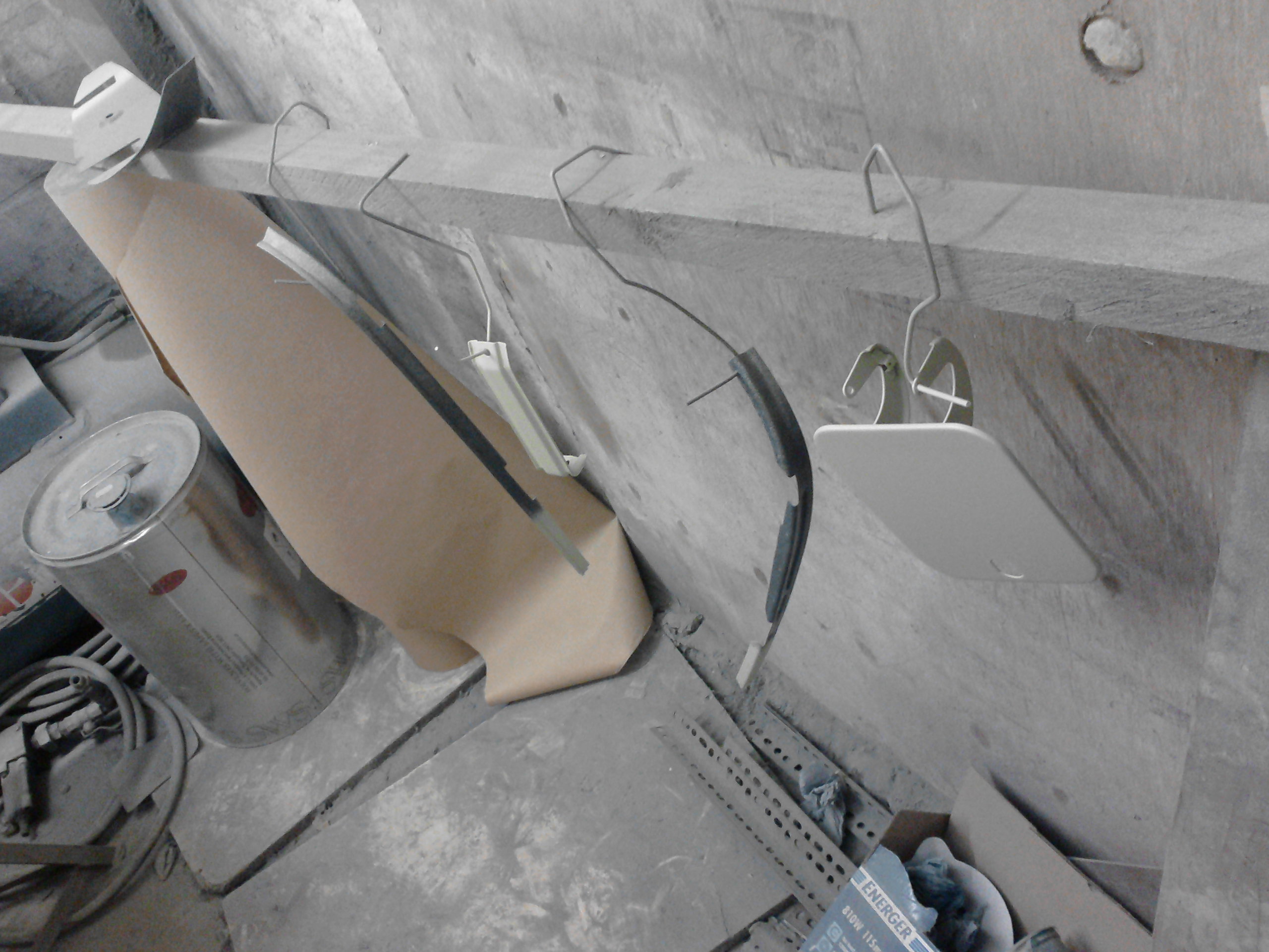

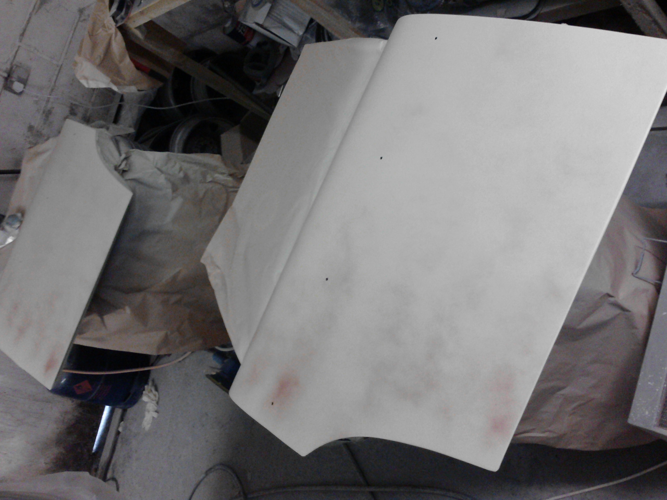

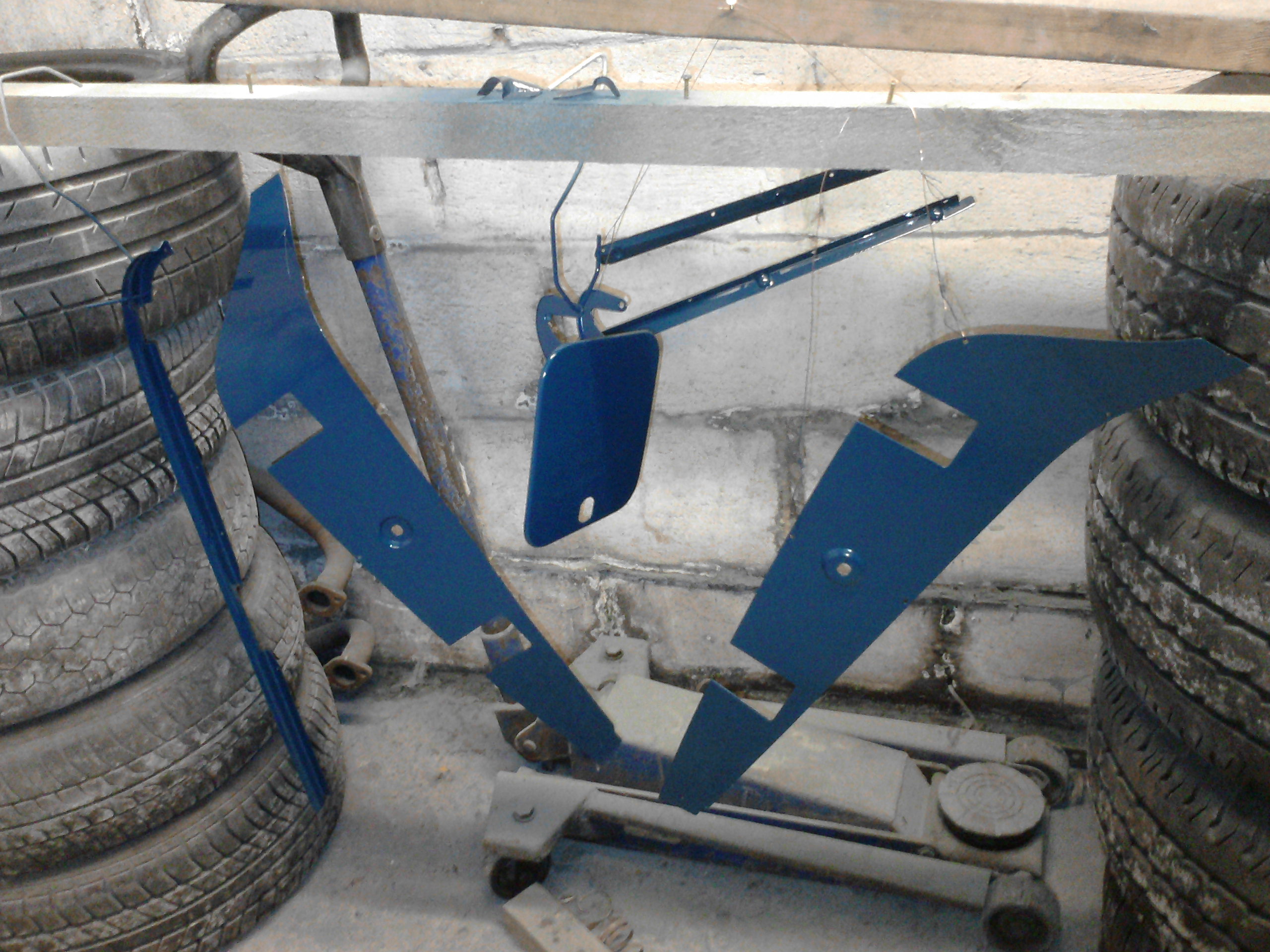

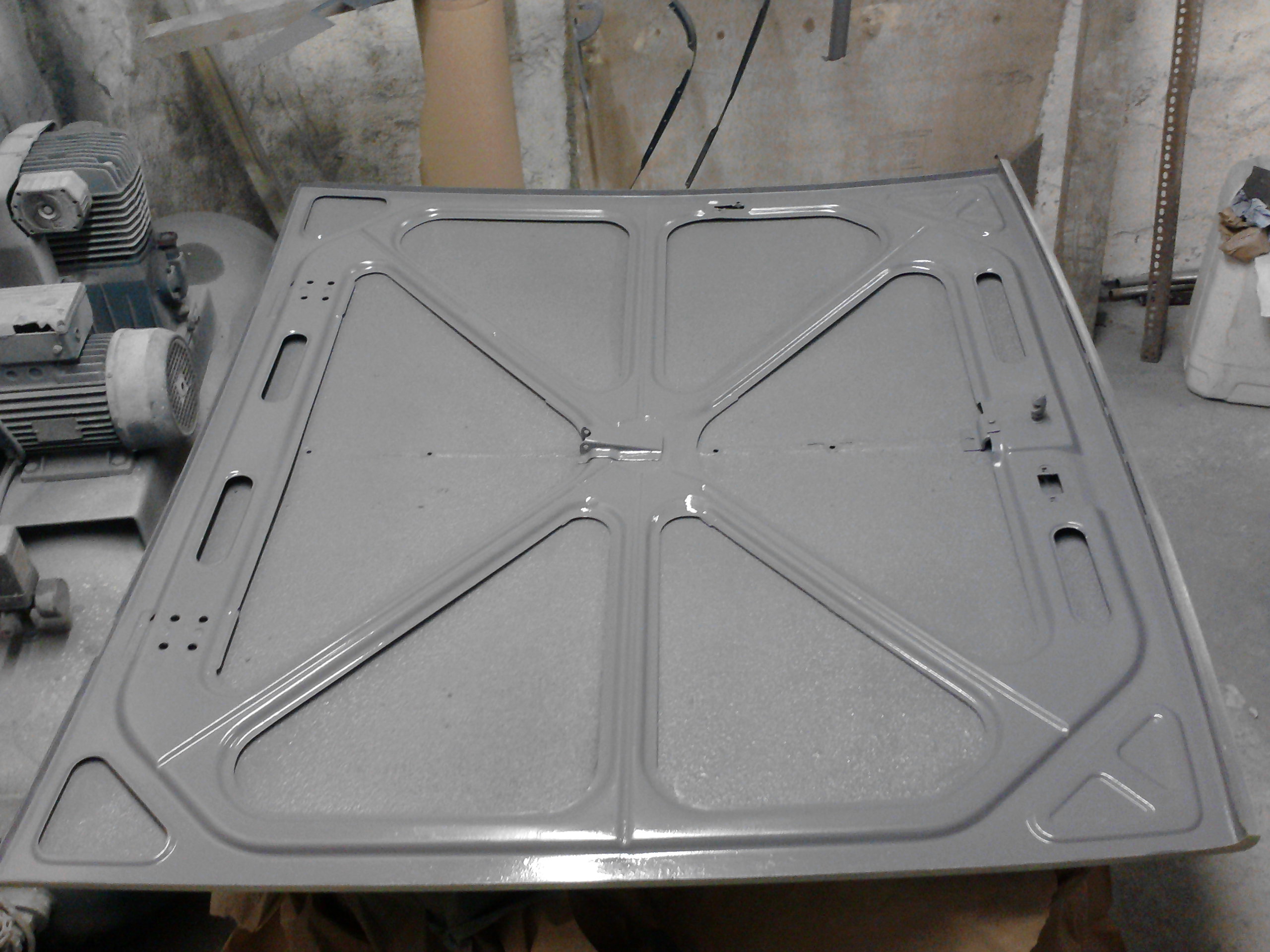

had myself a little washing line of small items that needed priming too
rear doors and bonnet got a good few coats of the high build primer so once that is flatted off on Thursday i'll paint it all, fingers crossed that will be all the paintwork done...

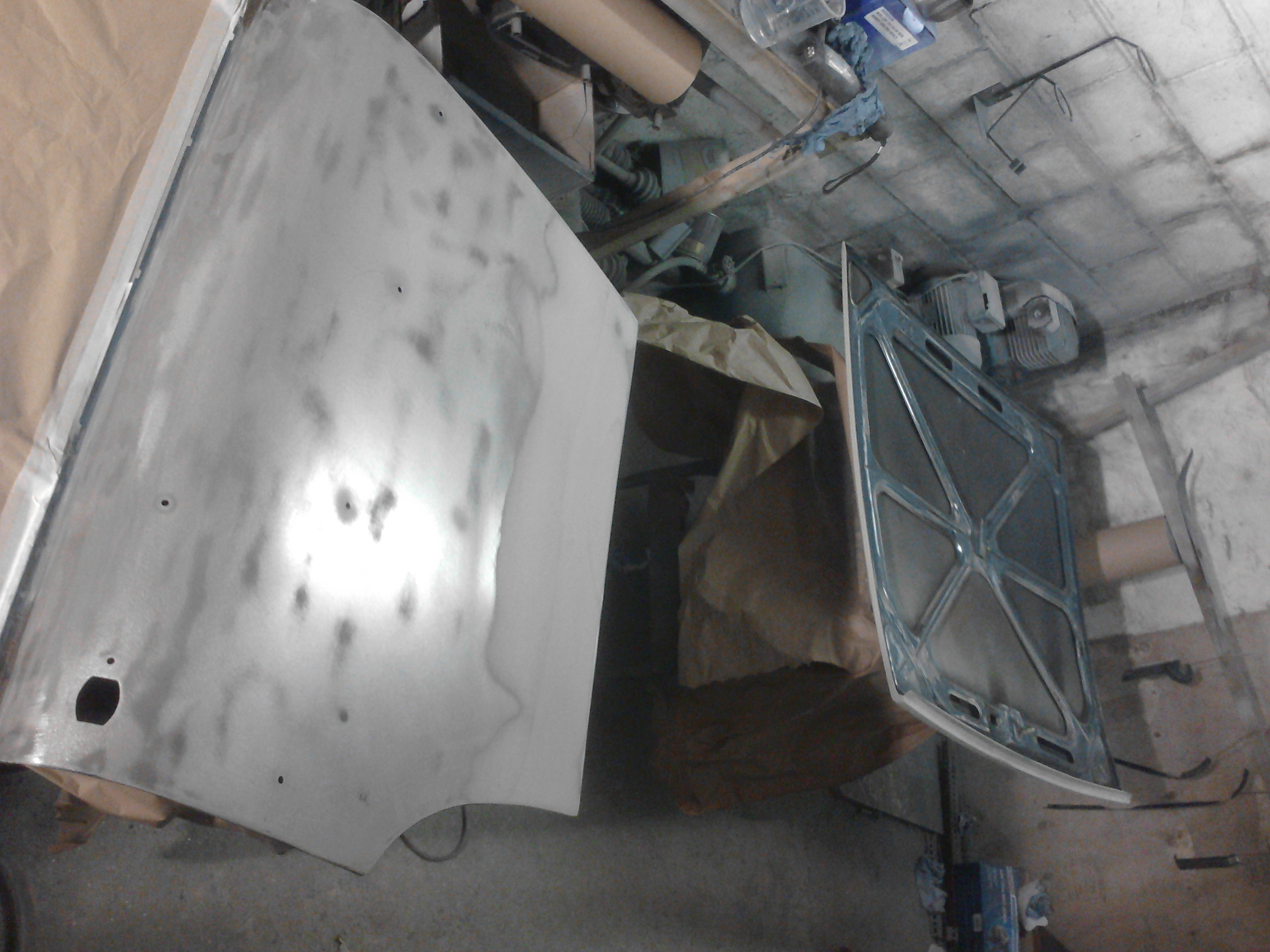

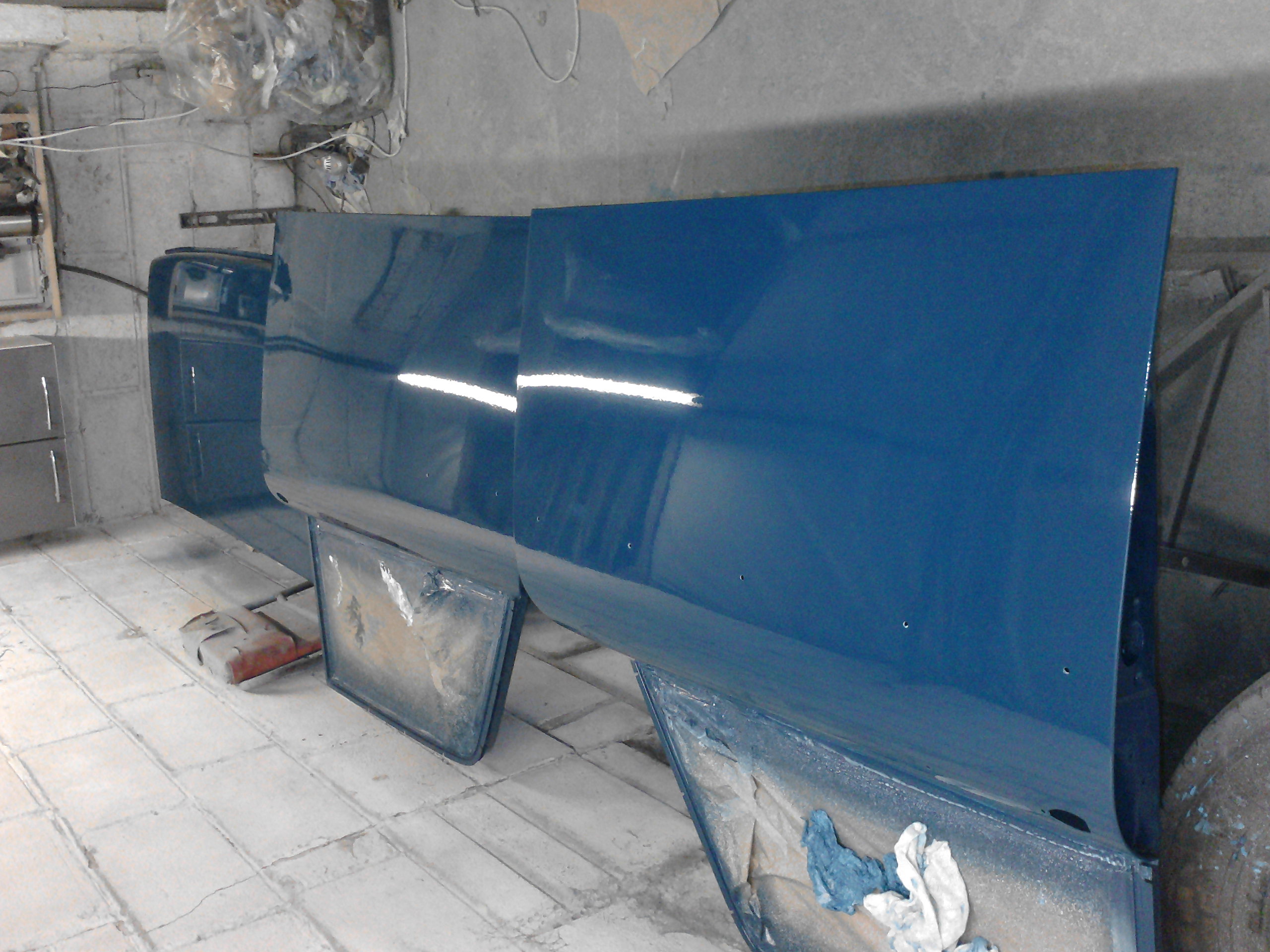

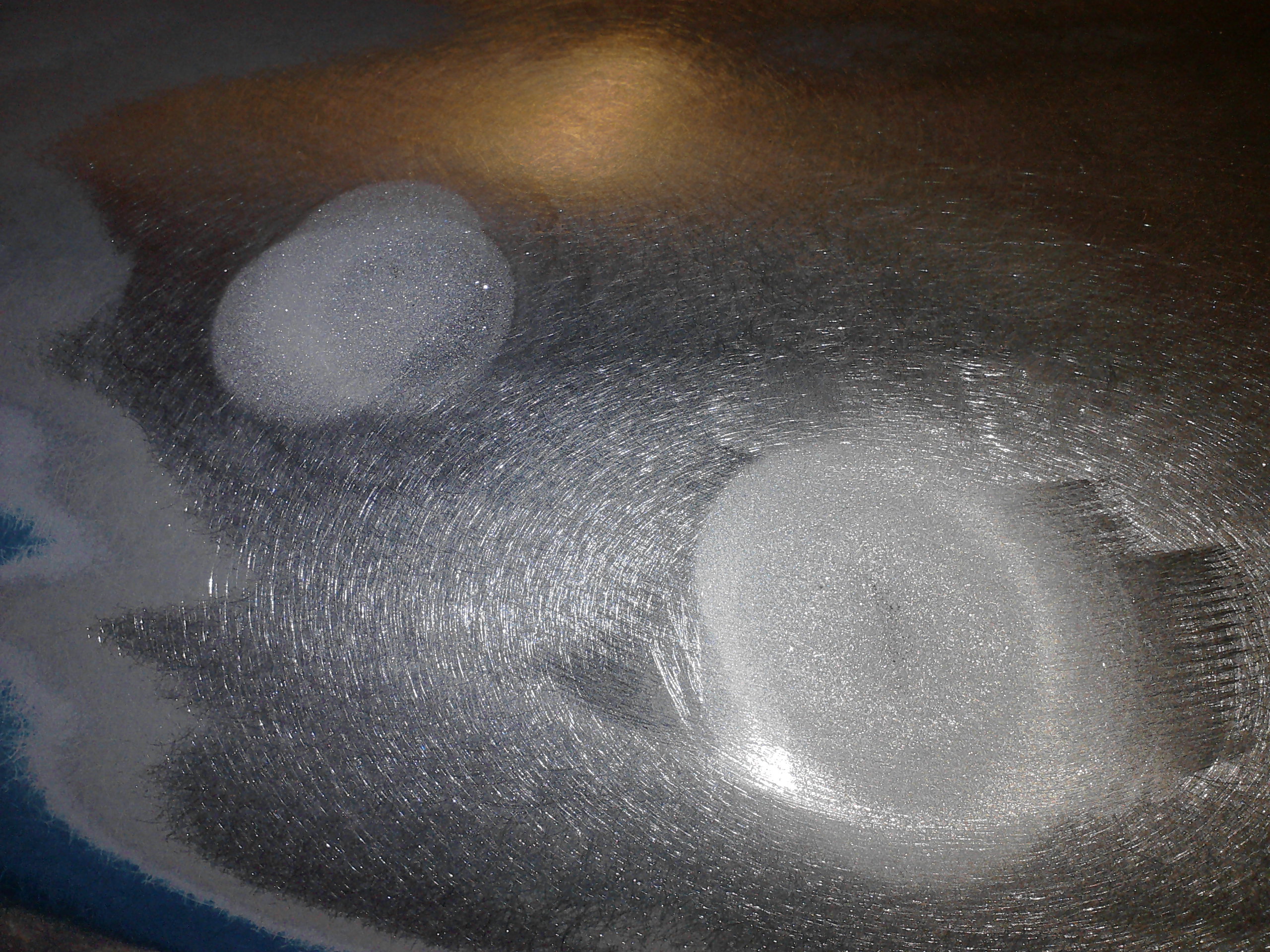

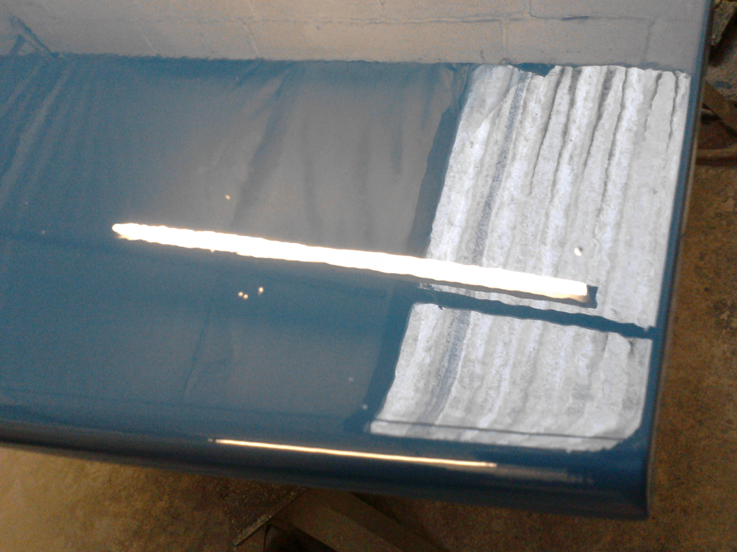

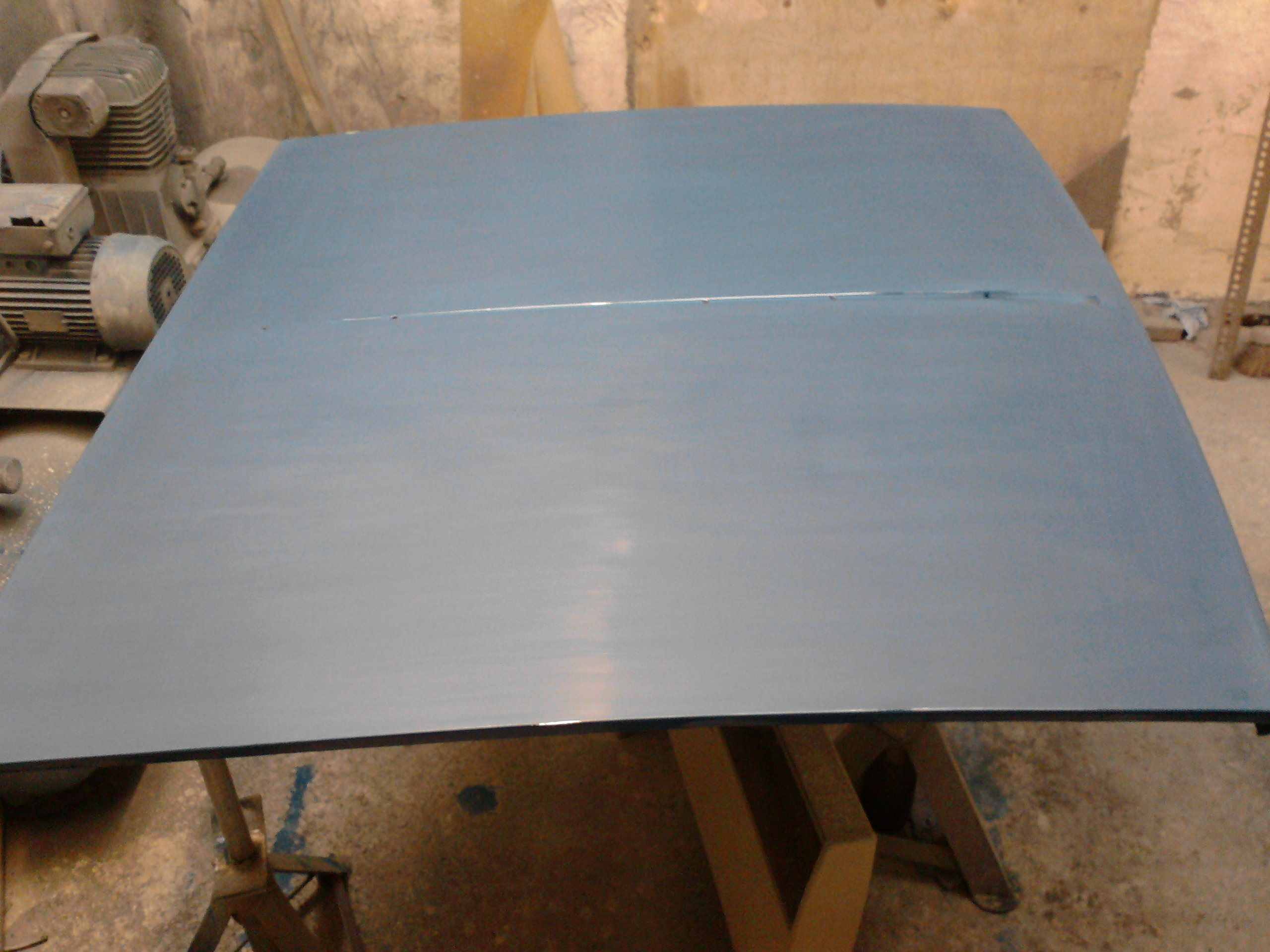

got a couple of hours yesterday evening to flat off the primed panels so this morning it was the simple task of masking up, cleaning and prepping the panels for paint.
doors and loose parts have gone ok but the bonnet has some overspray dust in it due I think to where I had stuff, the extractor fan drawing the spray towards the bonnet but not lifting it off it.
i'll flat it off and do the bonnet again if it looks like the dust won't disappear. doing just the bonnet will mean the fan will work ok, no spray from the doors.
if only I had more space these little things wouldn't happen but it's better than doing it outside!
pleased again with the results of the new door bottoms which have blended in really well, no wavy lines where the joins were.
feels like a big hurdle has been cleared now with all the painting done, the refit can begin soon. just in time too, snow forecast for the coming days....

Looking good Kev. If it's light overspray , you could mop it
Hi Kev, as JB says it will probably polish.
If you are giving it a bit of a flat and mop up that will cut through the nasty's.
Worst case scenario, if you break through a bit it is ready to re paint.
Nothing to loose trying a flat and polish first.
yes, plan is to give it a flat with 1500 wet & dry then if it looks like it's coming clear i'll mop it over.
i'll go up tomorrow and have a dabble, hoping it's gone off enough, not exactly balmy weather today!
got over 1/2 litre in the tin left over so a few passes won't hurt if it's still not up to scratch..

took some flatting out, gave up with the 1500 paper as was too tedious and used some 320 pads like I did with the primer...then 1500 after that.
all the dust came out nicely but with so much taken off there was only one thing to do, mix up some more paint.
4 more coats and it's come out much better this time, still got some dust but it'll come out with a light flat so happy with that.

as it was still pretty chilly out and I wanted to keep going anyway I decided to flat off the front doors and bootlid that i'd painted a while back, once the dust had cleared of course
fair bit of orange peel in the doors but it all came out pretty well, machine polished with G3 but forgot to use the pad on the DA so that meant more hard work than was necessary!
now, finally the painting is done.....until I find some small pieces of trim I've probably forgotten about
