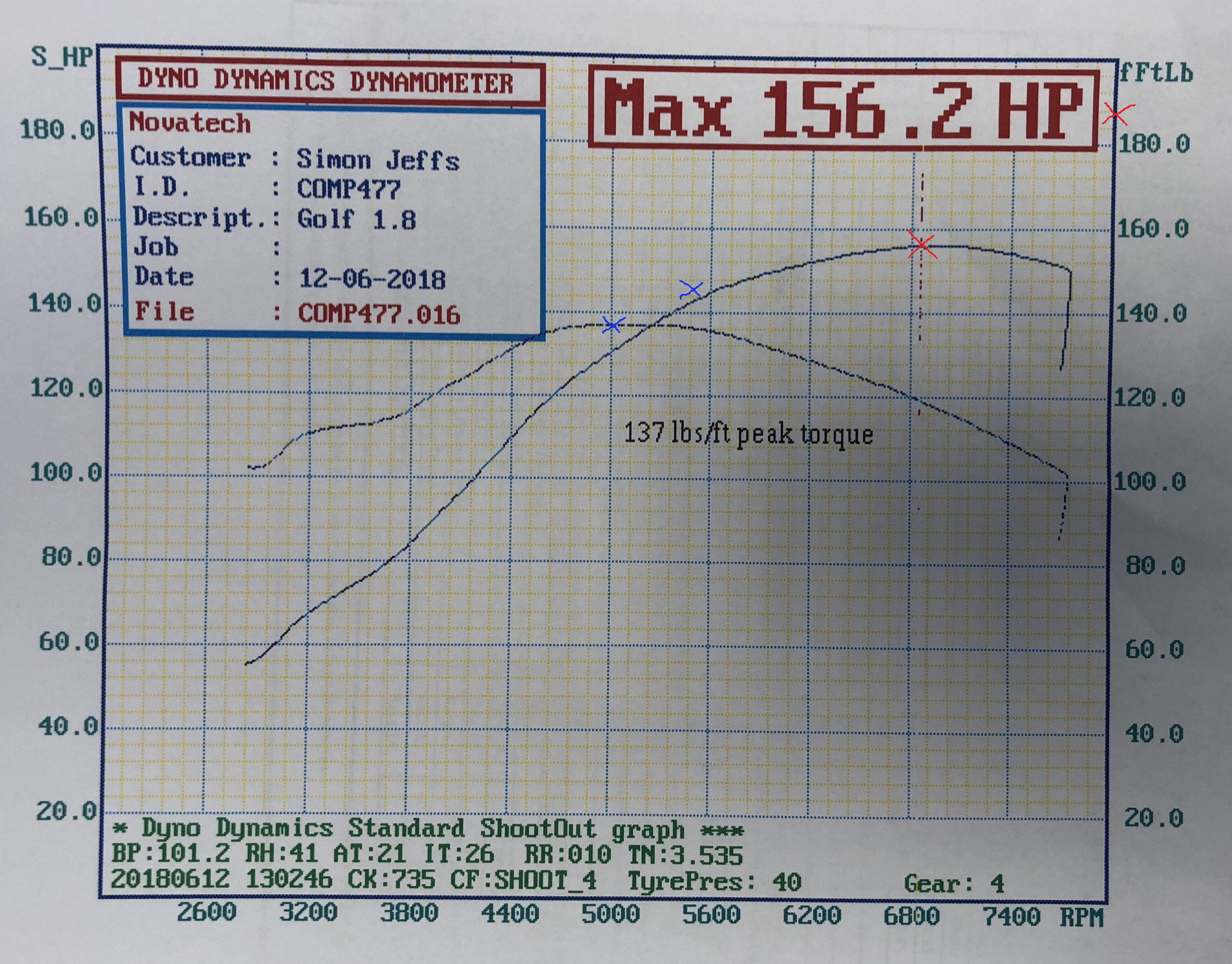

I need to get a like for like performance comparison so I will get a plot from the same rolling road for that when the new engine is in the car.
In the mean time plotting the new engine performance figures from the test-bed onto the old engine performance figures chart from the rolling road is like this:
Blue = torque
Red = bhp at the flywheel
Re: Escort Hunter Killer
I should think you are very pleased with that figure. :D

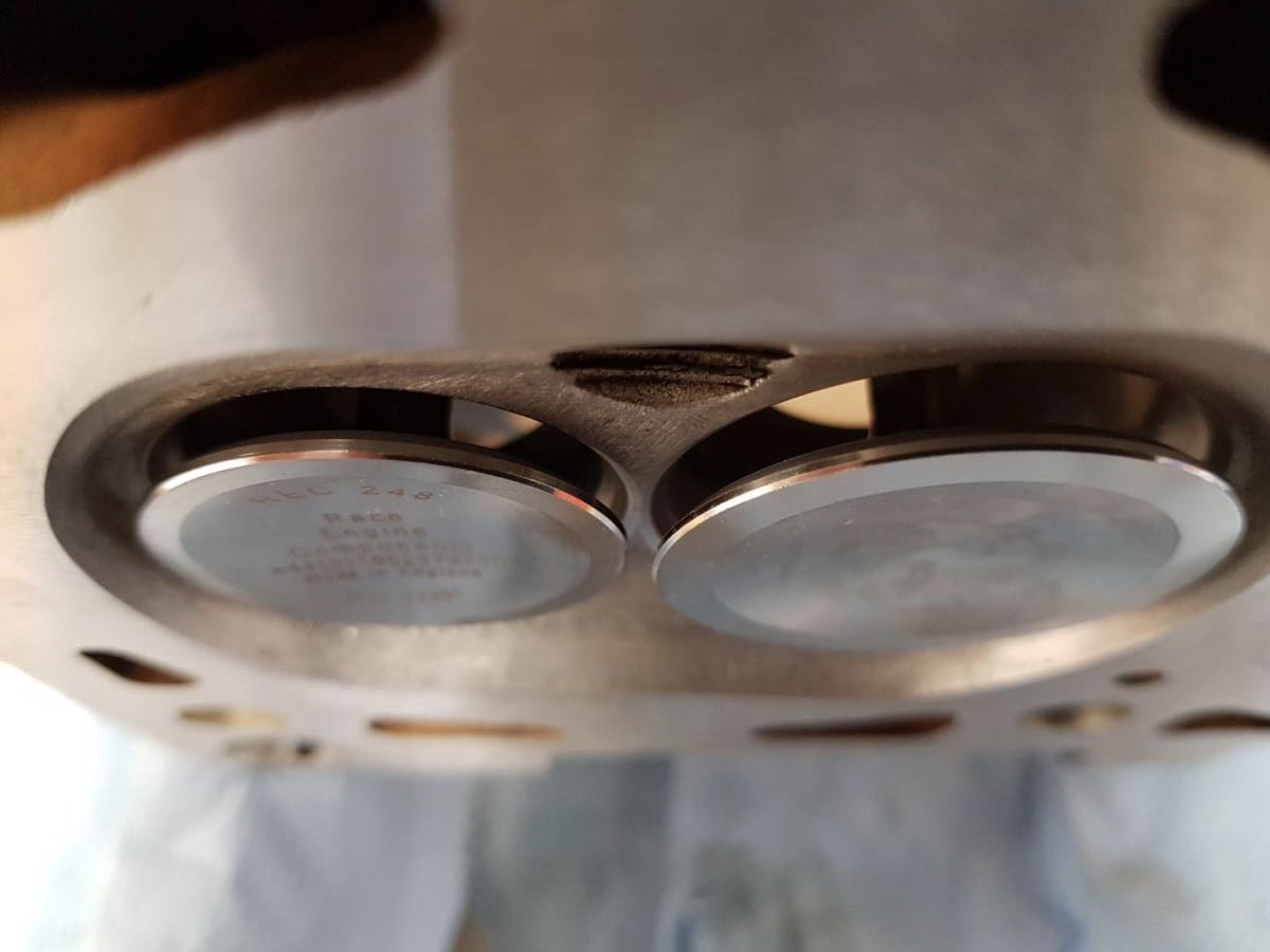

This is the artistic shot of the recipe posing quite a few questions that are to remain with the engine builder:
This is TDC.

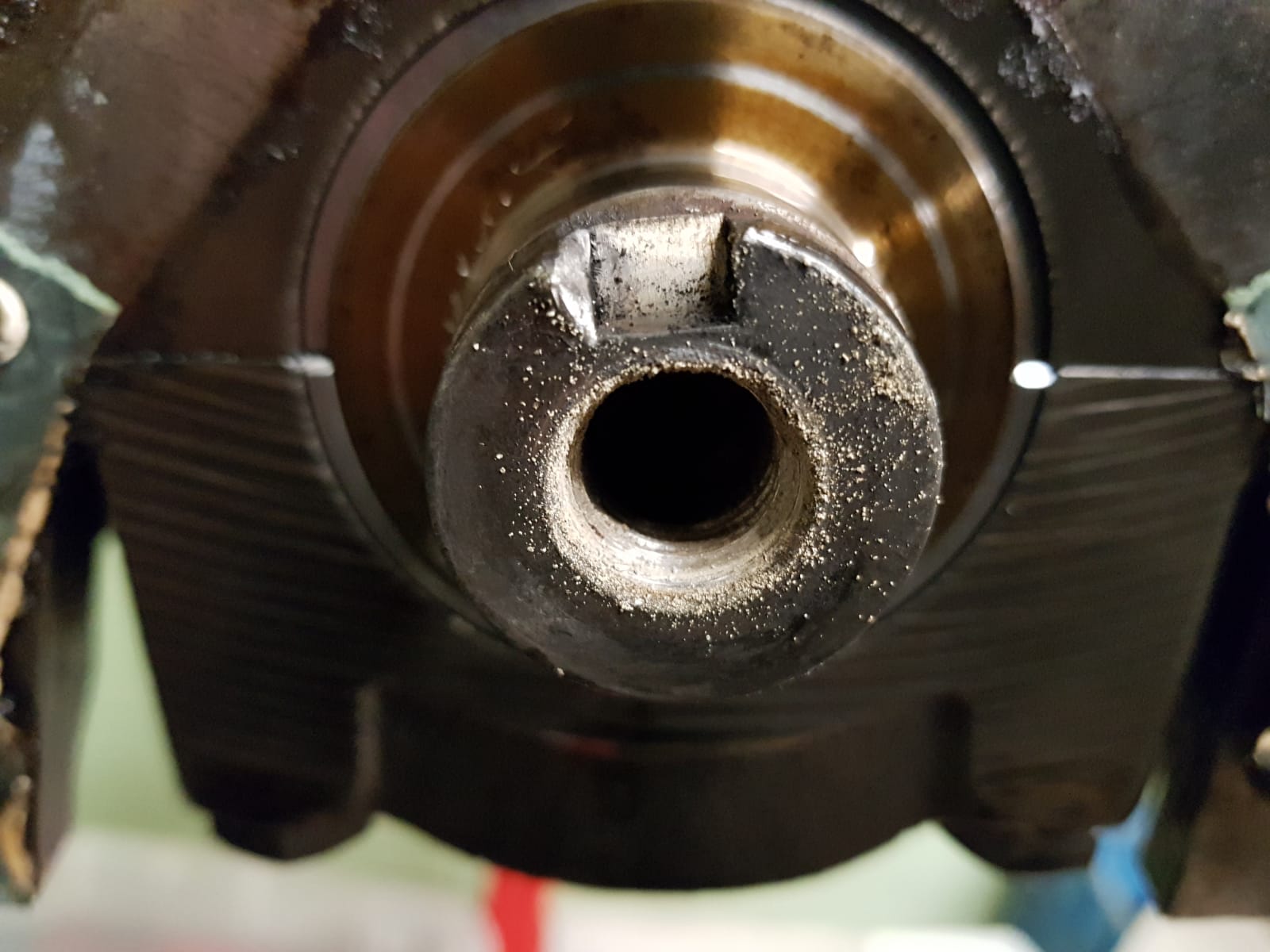

My last race at Brands was pretty miserable as the cars behind me on the grid all passed me one by one.
The car was down on power and popping and banging.
The engine is out and stripped. The reason it was down on power was because the cam timing was out. The crankshaft pulley had loosened and the pulley key only had 1/3 width left. The key way on the crankshaft is also damaged.

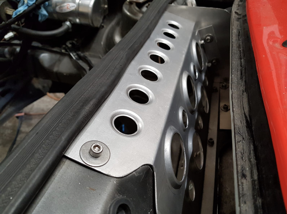

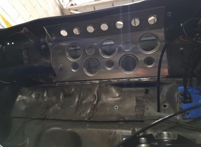

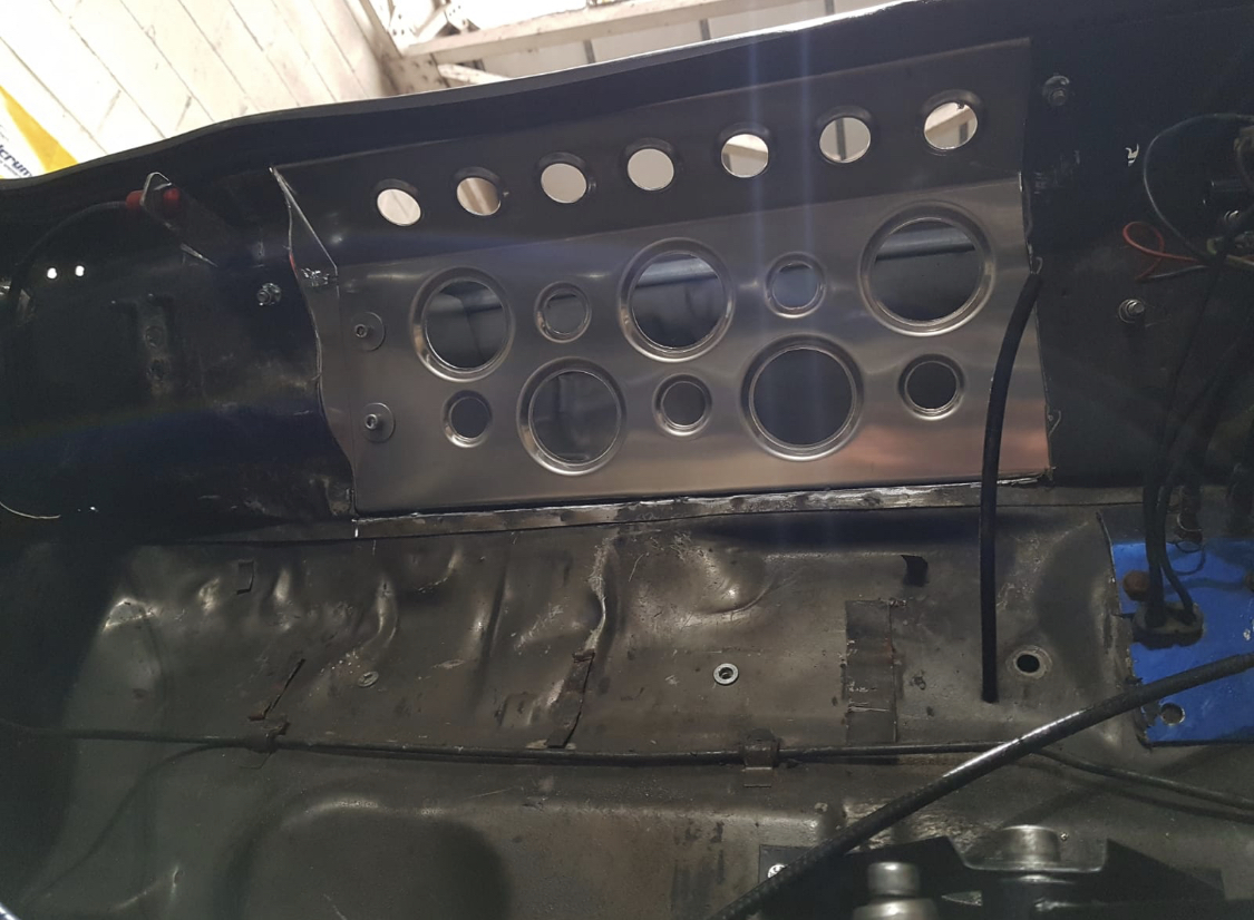

Getting fresh air to the Golf carbs at the rear of the engine bay is a challenge so JMR have been busy modifying the bulkhead. I am sure it will sound better as well as breath better!

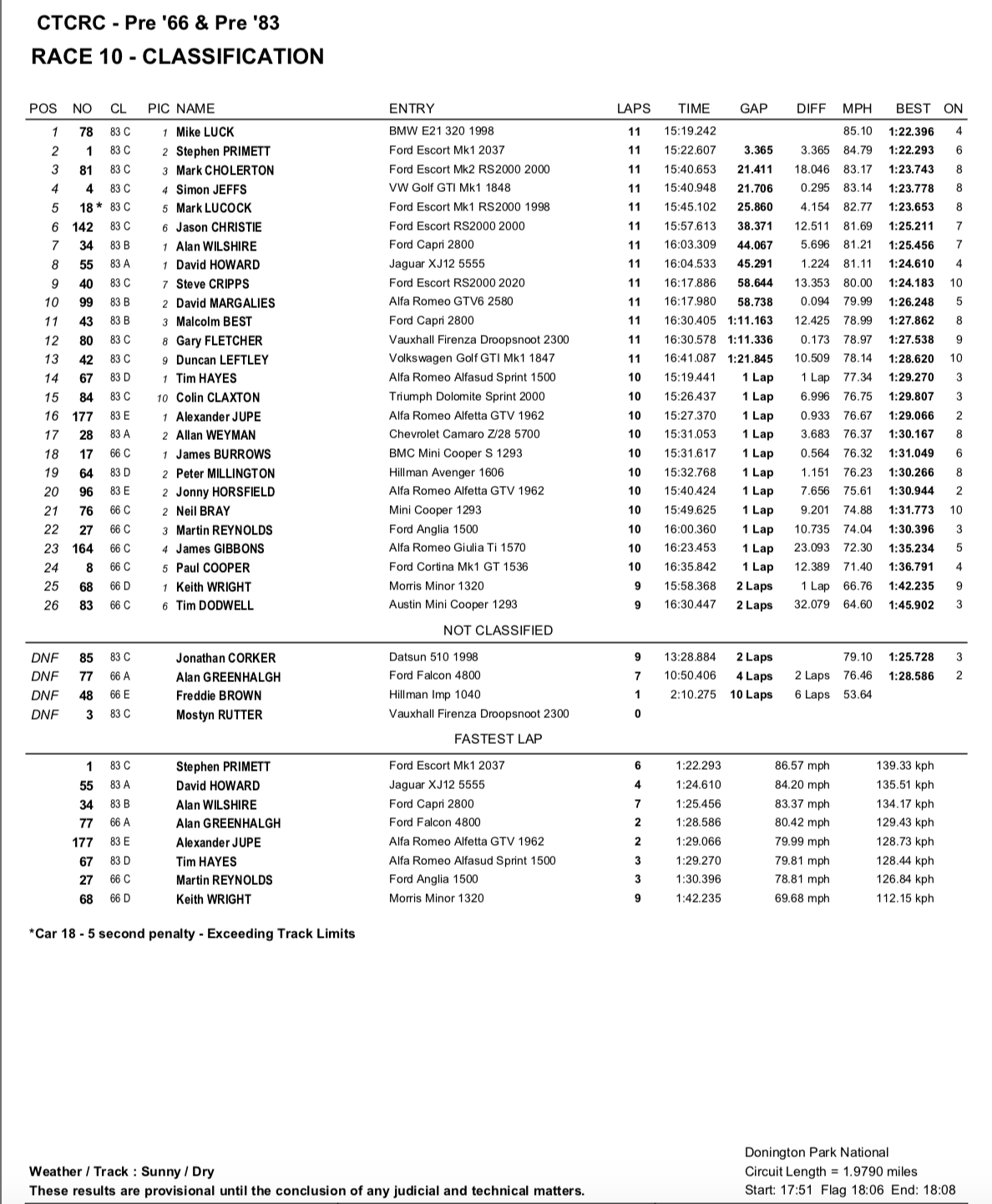

Hi Guys,
I finished fifth at the end of the second race. Details here:
