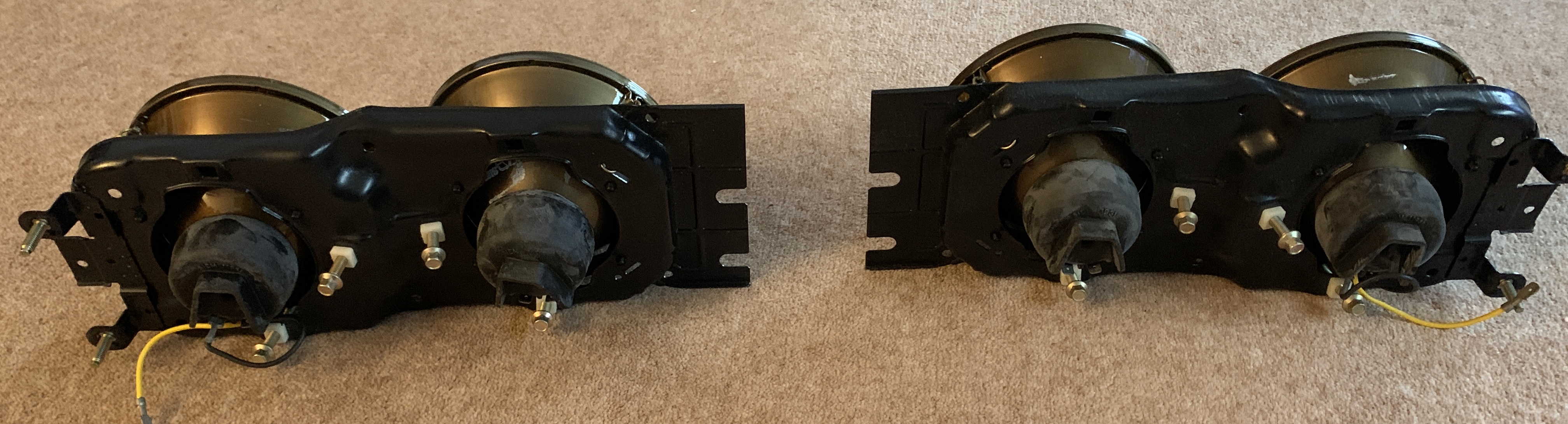

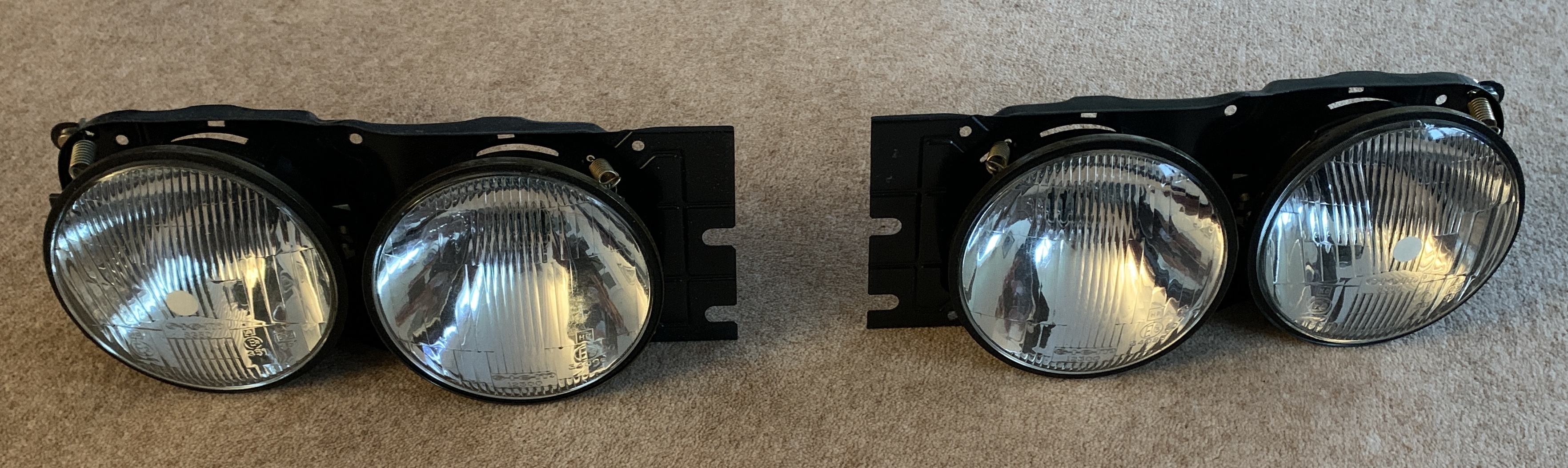

More new parts coming for the Sud project. These are coming from far far away. info when they arrive
Re: My 84 Sud Ti Project
More new bits arrived. All the way from down under. Not cheap but they are NOS and genuine RHD
- Posts: 799
Looks very nice Loo. Metal backplates so should last and no problems with plastic going brittle. Have you got everything now?
Hi Ade. No I need a pair of the plastic frames I am in touch with Bob wright and he says he can make them if I can get a pair to him to make moulds from. I’ve left a “wanted” in the parts wanted but so far no nibbles
I may be able to use my original plastic “pop in lamps” mtgs to get the moulds made. It’ll just take a bit of fibreglass engineering to get them right.
Could the original plastic Mountings be restored and painted?
John at Justsuds had new push fit clips made
Hi Dave. Yes they could but these new lamps are the earlier style. ( late S2 early S3 ) My original lamps used the plastic housings with pop in lamp units. ( I even got the clips off John). These new lamps won’t fit in to the later plastic housings as they don’t “pop in” so im looking at making some fibreglass replacement frames because I don’t want to butcher the plastic housings but I should be able to use them as a pattern for the exterior shape

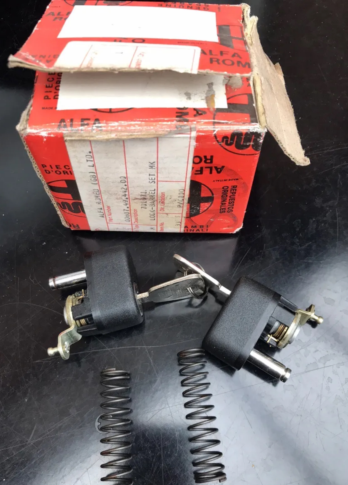

Got new door locks aswell
Looks like Crimbo has come early Lou. Those headlights are a rare find now.
Hope you can sort out the bezels.

Hi Keith. Yes progress in the shell has been a little slow. But m still picking up bits and pieces when I can. It bugged me that I didn’t have a spare set of keys. I know I could have got generic spares cut. Call me a stickler for detail but I wanted genuine Alfa keys. Ive got a NOS ign switch aswell.

Hi Lou, - I'm pretty sure I have a pair of these, I'll have a root and send you a message and pics.
Cheers, John.
Cheers, John.
Thanks John. Please let me know if you find them.

There was a guy at Spettacolo who was cutting keys from genuine blanks but I can't remember his name, maybe one of our Dutch friends know of his details.LooLooSud33Spider wrote: ↑Sat Oct 21, 2023 5:44 pm Hi Keith. Yes progress in the shell has been a little slow. But m still picking up bits and pieces when I can. It bugged me that I didn’t have a spare set of keys. I know I could have got generic spares cut. Call me a stickler for detail but I wanted genuine Alfa keys. Ive got a NOS ign switch aswell.

Looks like, John has saved the day again. Should be picking a good pair of frames up from him on Wednesday.

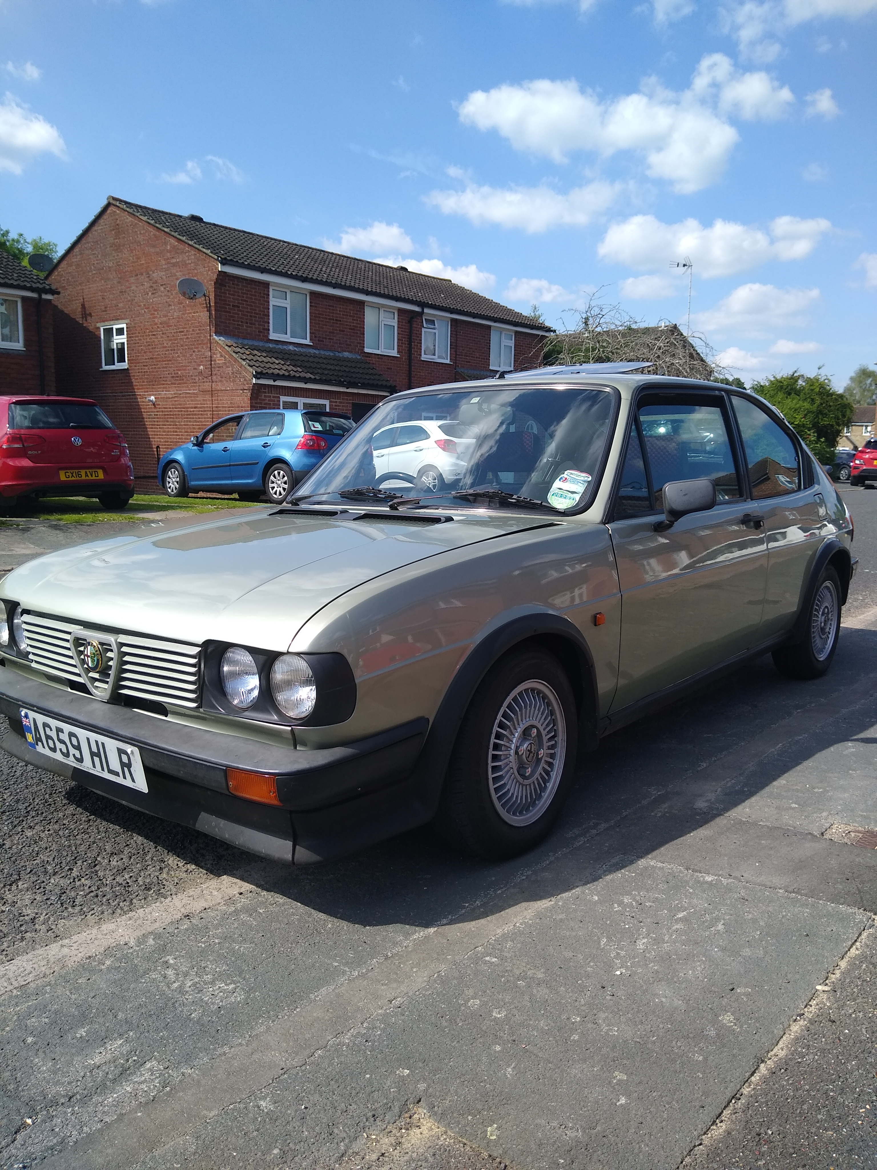

Quick question do we know how many Aqua verde met suds are left out there. ?.
Ian Brookfield will possibly know from the sud register.
My guess is 2, teds racer and another road car that was for sale a year or so ago.
Plus yours.
Plus yours.

Not forgetting Tony Goulds
Yes I'm still here - thanks Lou.
looloosud1984
- Posts: 75
- Contact:
Looking good Tony. As usual. I’m just trying to decide if I should keep my car visually original. And Aqua verde is certainly one of the rarer colours for a sud.
