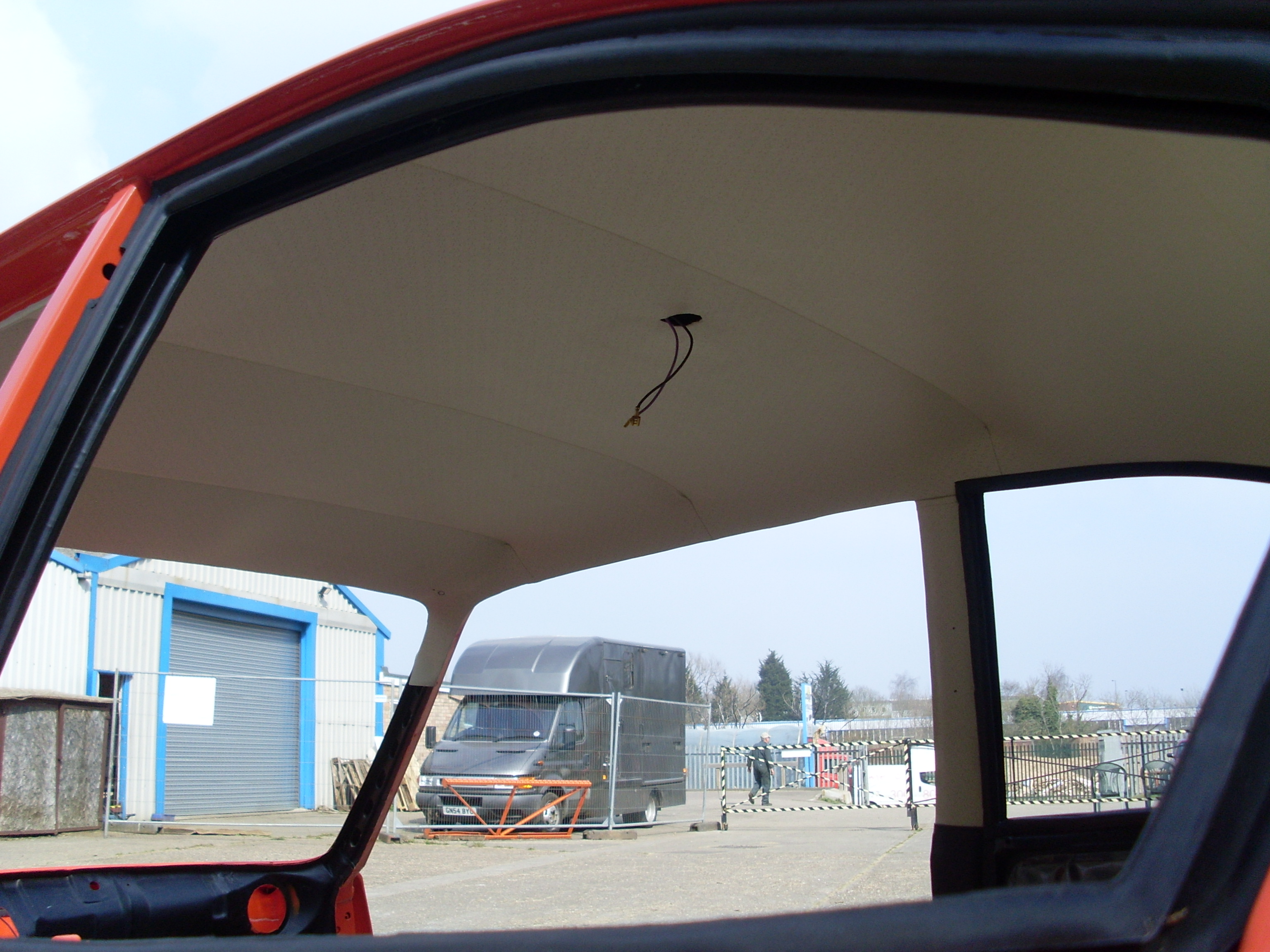

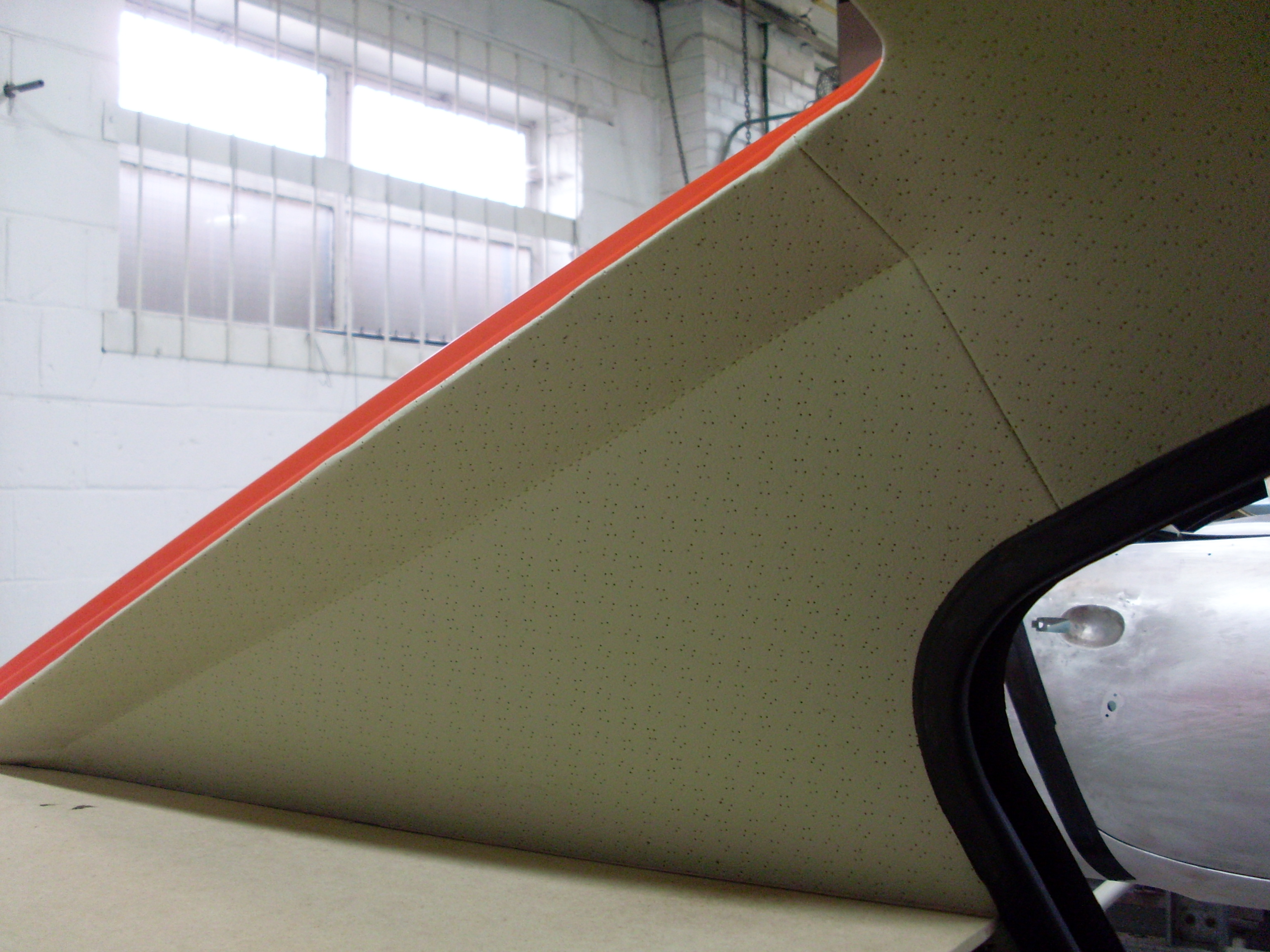

Here is my headlining.
Once again, great repairs. Do you plug weld the joints or have you a spot welder?
that headlining looks amazing, the area near the rear the C pillar top is tricky to get right.
can see me getting mine done properly by the proffesionals![Wink ;)](./images/smilies/icon_e_wink.gif)
