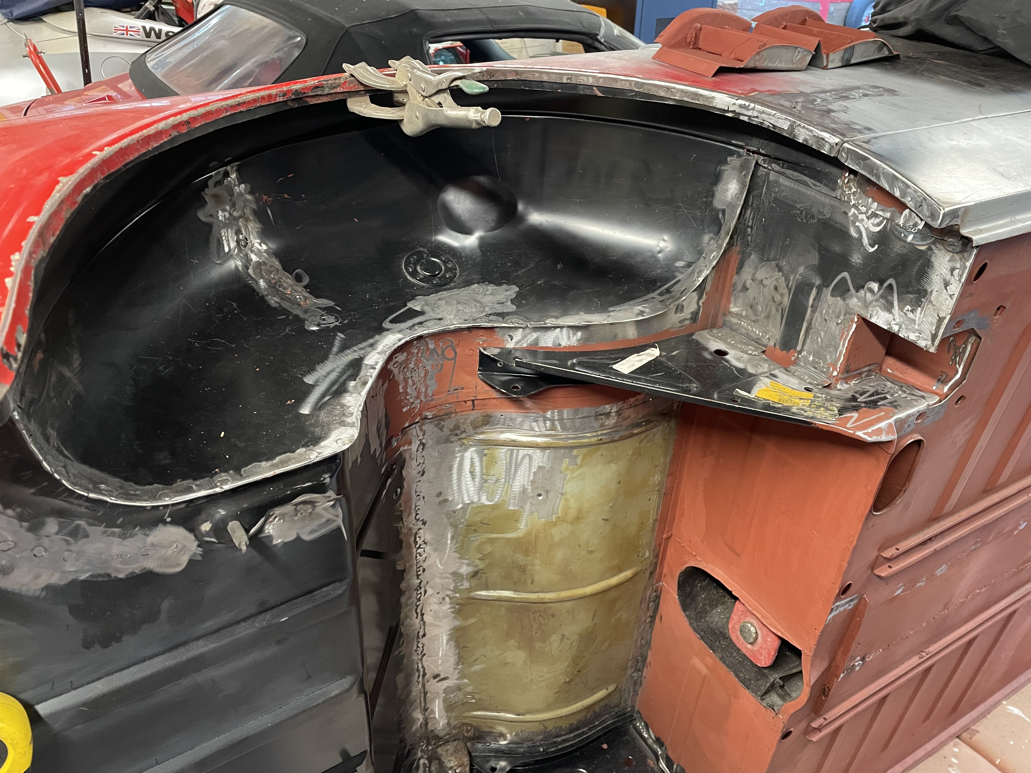

More midget work
New boot floor and both inner wheel tubs. I’ve also fitted a new rear panel. We’re fast approaching the end of all the major welding. There’s still a few welds that need tidying up then it’s on to the actual prep for paint etc. the underside will then stripped back to bare metal again and I’ve decided to treat the underside with U-Pol Gravitex textured finish. The underside will then be sprayed body colour
