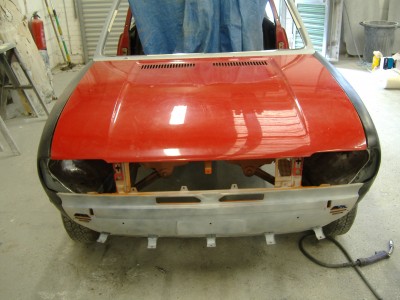

It helps. Thank you. Are they all the same size?
Posts: 2891
Re: Front spoiler support brackets
I think so. They look it in this photo.

I have managed to fabricate the one on the side. Just need some dimensions for the front ones

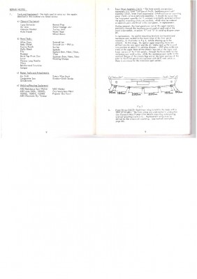

This shows the dimensions of the spacing rather than the brackets themselves.

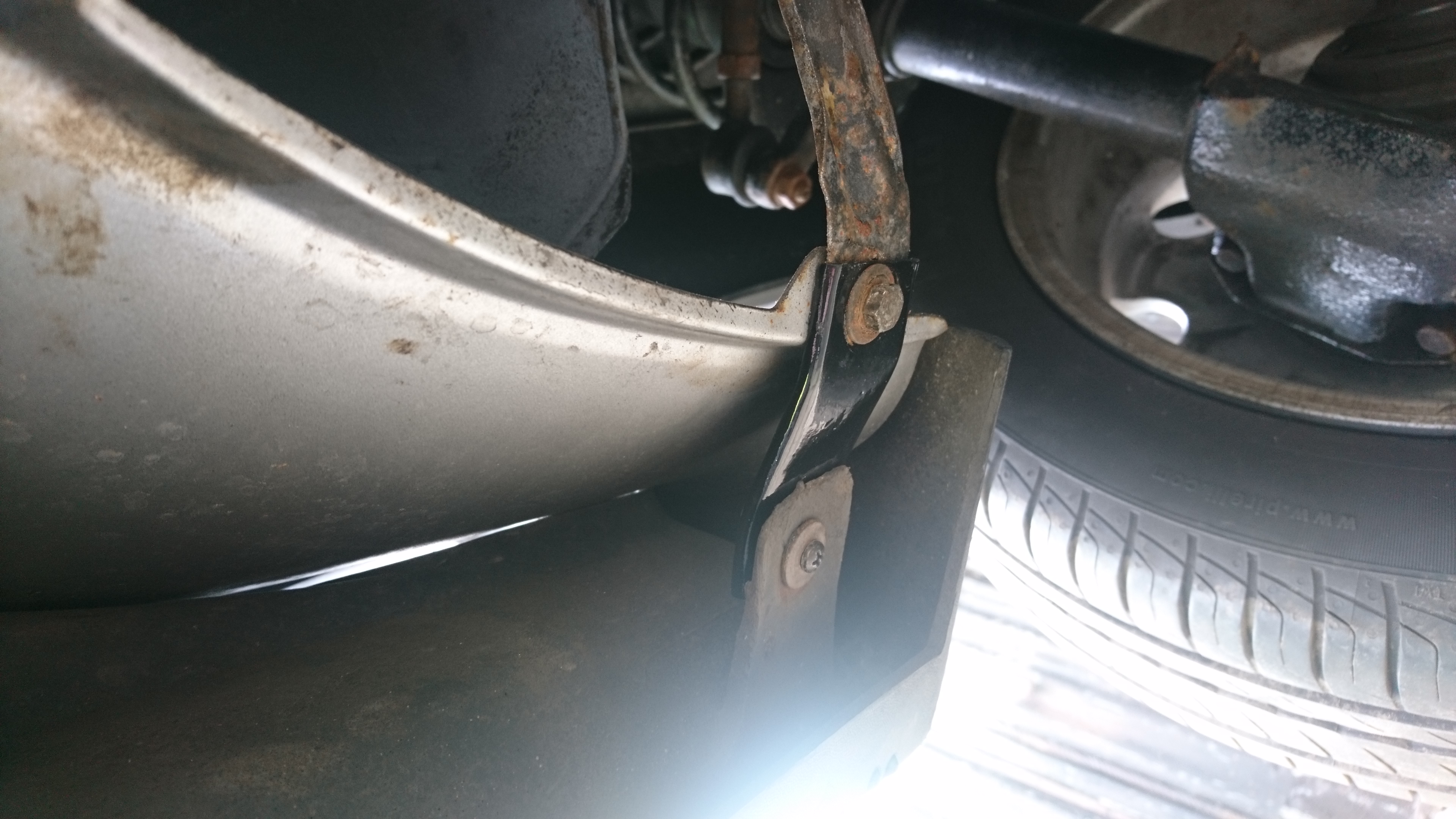

Is this how the wing to wheel arch bracket is supposed to fit?
Posts: 1511
Just get some 2.5mm galv builders straps on ebay, and bend to suit.
Much stronger that the original crap.

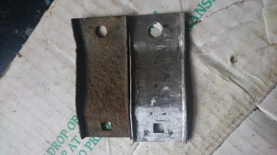

Just attempting to tidy up the shed a little, came across this, one only I'm afraid. Any use?

KevJTD wrote: Sun Apr 19, 2020 3:12 pm Just attempting to tidy up the shed a little, came across this, one only I'm afraid. Any use?
Thanks for the offer. I have managed to get 3 from John at just suds. I should be able to fabricate two more now I know what size they are. Let loo have it for a pattern since she is asking so nice.
