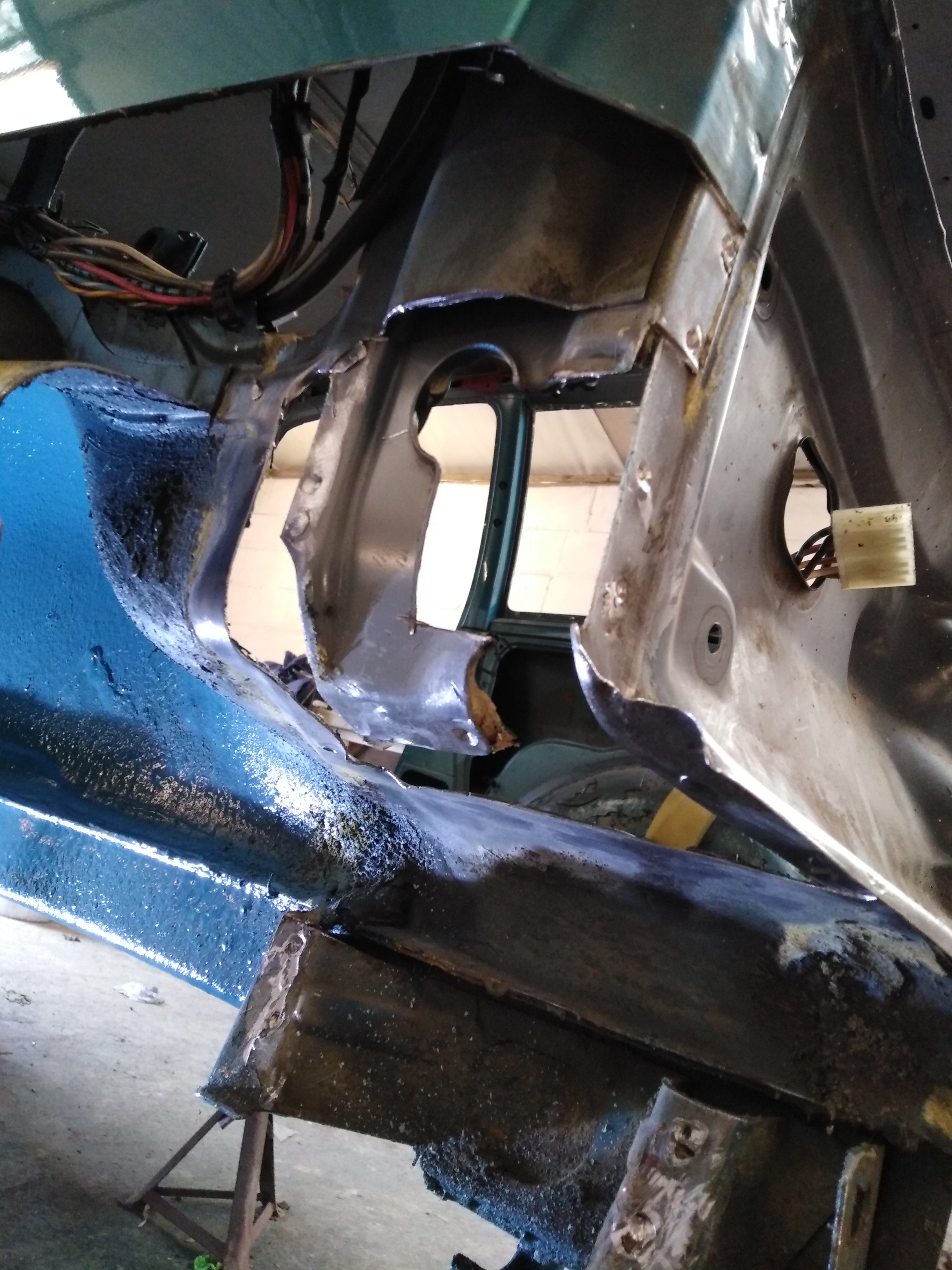

Car back on axle stands now so work on the rear bumper mount area started today.
I couldn't do it whilst on the tilter as the car was hanging off the brackets restricting access!
Just a small hole on the outer quarter panel with a scab behind the light fitting... How bad could it be? :roll: Knotted wheel had a dig at the scab with predictable results..
Outer panel will need a new bit making so why not cut off plenty to allow a good view inside..
Light in the wheel arch makes new paint look blue with the mobile phone camera, its not that much of a miss match, honest! :lol:
Bumper bracket needed removing to have a better look behind it as there appeared to be a bit of rust..
Re: Kev's workshop projects
Bumper bracket off and still a layer or two of rust..
Like a game of pass the parcel another layer with rust still behind..
So down to the last layer and yes that too had rust, which meant I finally found solid steel but ended up with some fresh air too! :D
Brought the bumper bracket home to be electrolysis rust removed so it can be rescued as it is pretty much solid and once treated and painted it will last another 20 years, I hope..
