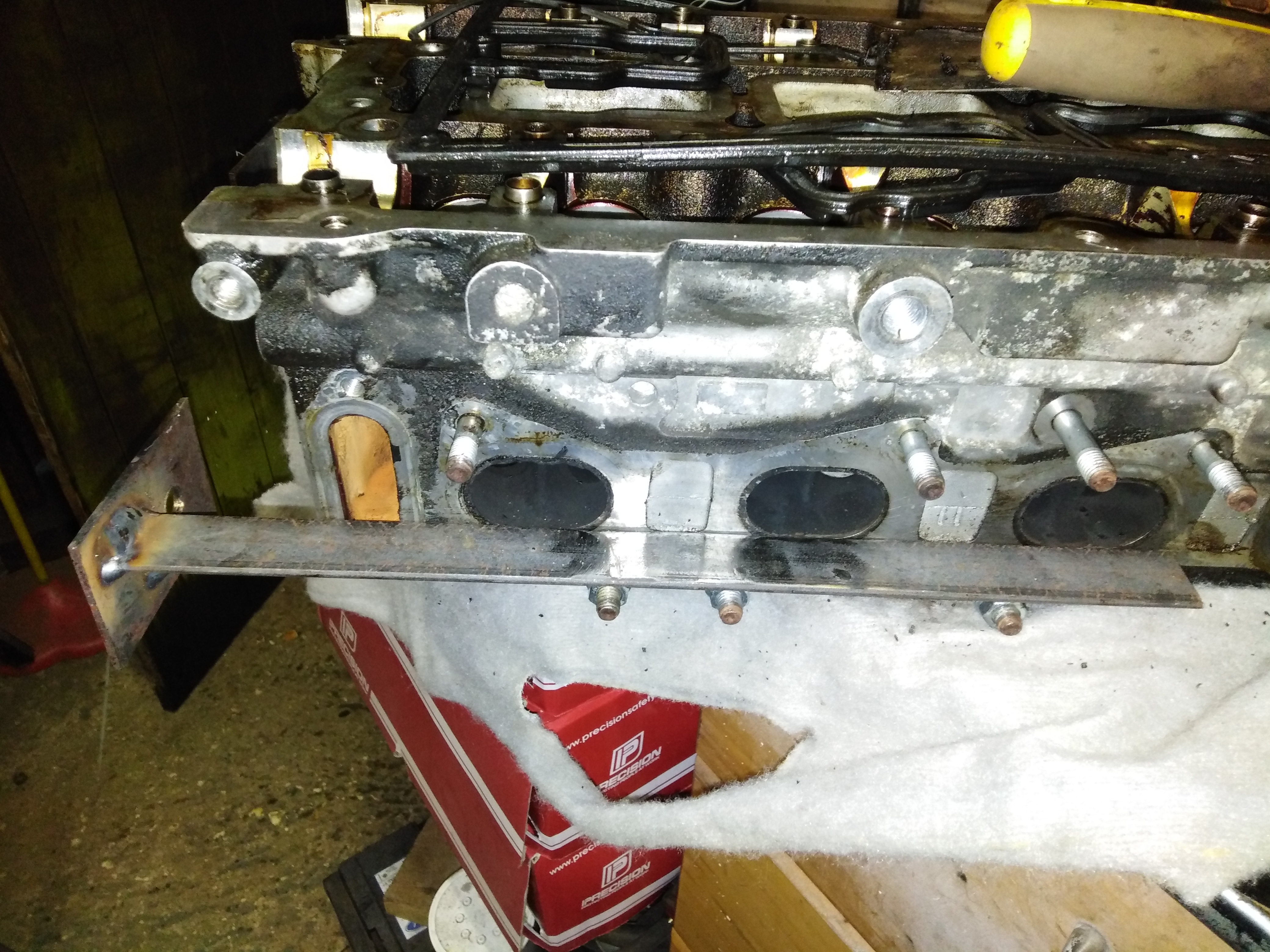

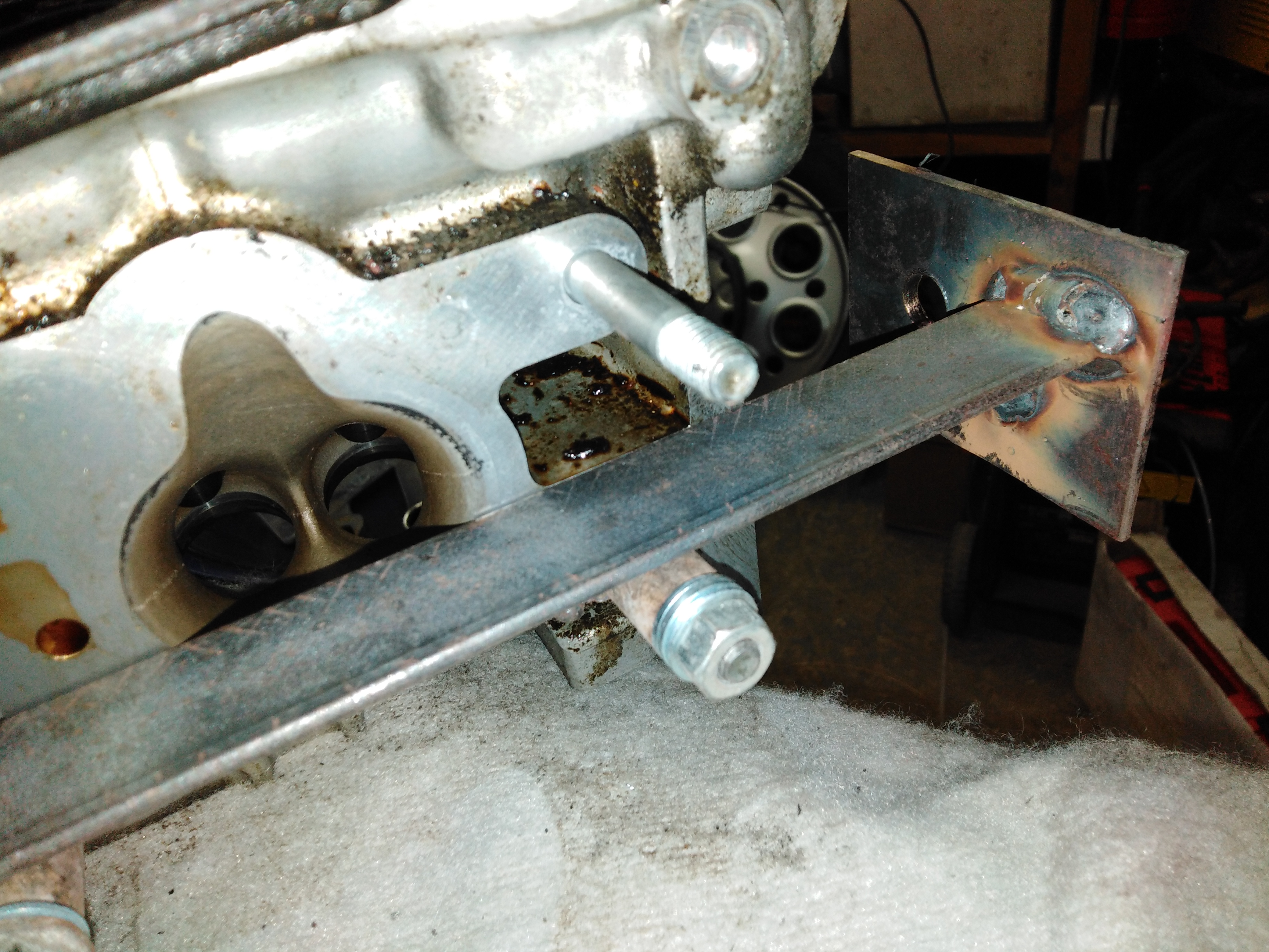

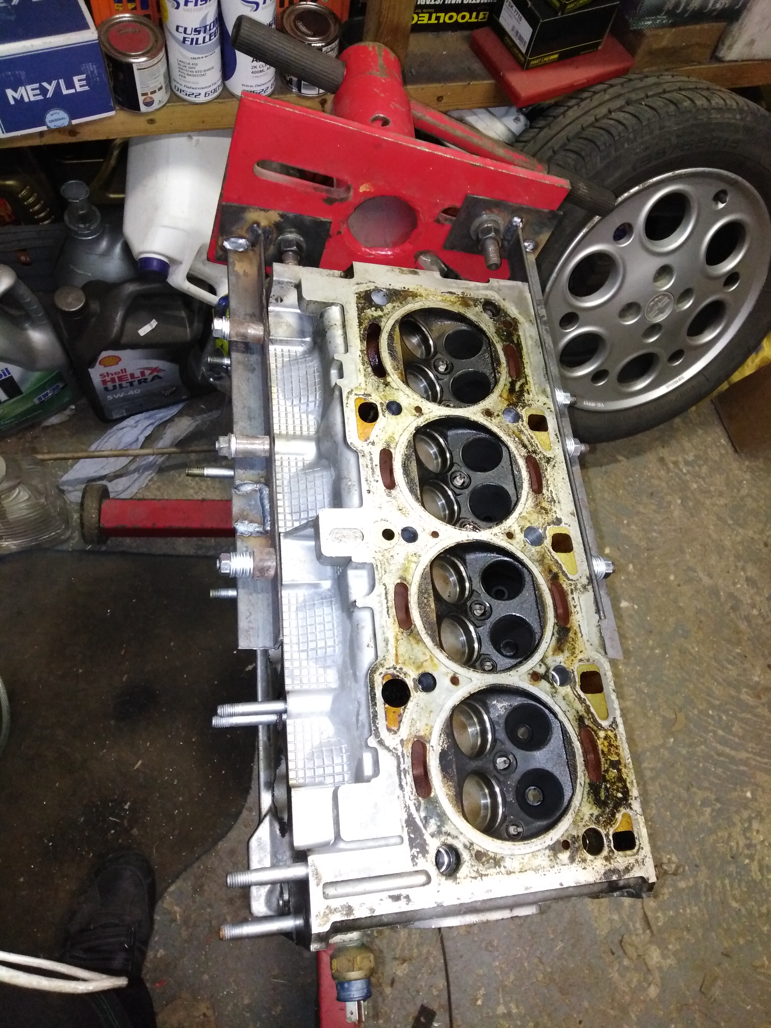

Stripped the valves etc out of the head which reared the usual issue, a heavy yet delicate enough not to want to drop it cylinder head that you need to be able to get to the top and bottom of to lap the valves in, decoke the ports etc then be able to build the valves back up which needs to be accessed above and below.
My workbenches are wooden so as not to damage the faces but with shiny alloy pieces and a bit of oil about things soon get slippy.
The thought of the head sliding off the workbench and dropping onto the concrete floor gave me the shivers.
So a plan was made, a better and safer way to do things.
A couple of lengths of angle were cut and drilled to suit the inlet and exhaust studs, 3 each side to spread the load then a flat piece welded to each end.
Fit like this to the head.
When attached to the engine stand it makes access to the upper and lower really simple and safe, I'll lap the valves in then take it off for cleaning.
Then back on so I can easily fit the valves back in without any fear of slipping and damaging it.
Bit excessive maybe but for an hour or so tonight and a few bits of scrap it's well worth the effort to me.

Looks wise to me having dropped a fine expensive chisel on the concrete floor heard it bounce and took two hours to find it.
Inside a work boot. Doh !

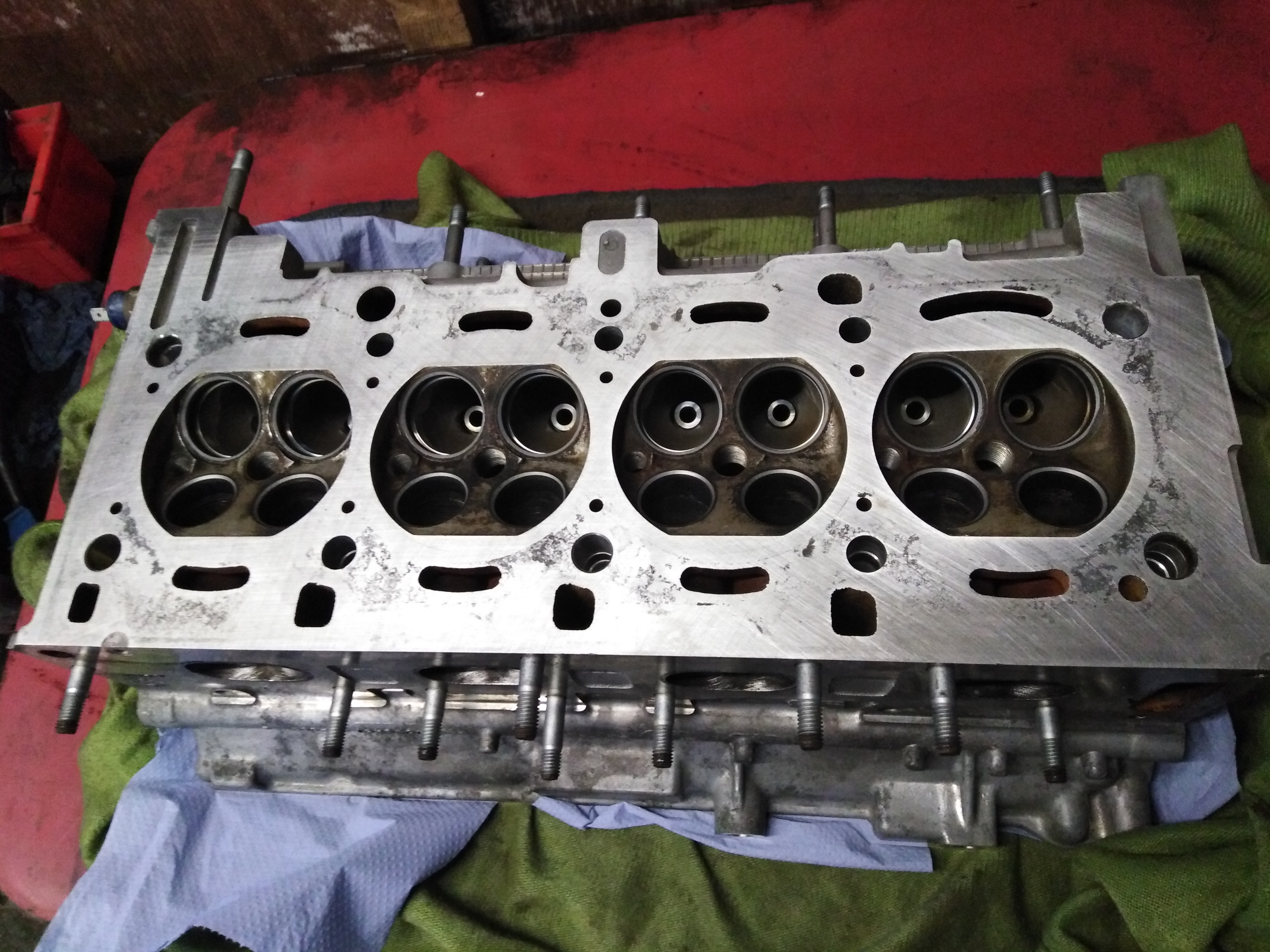

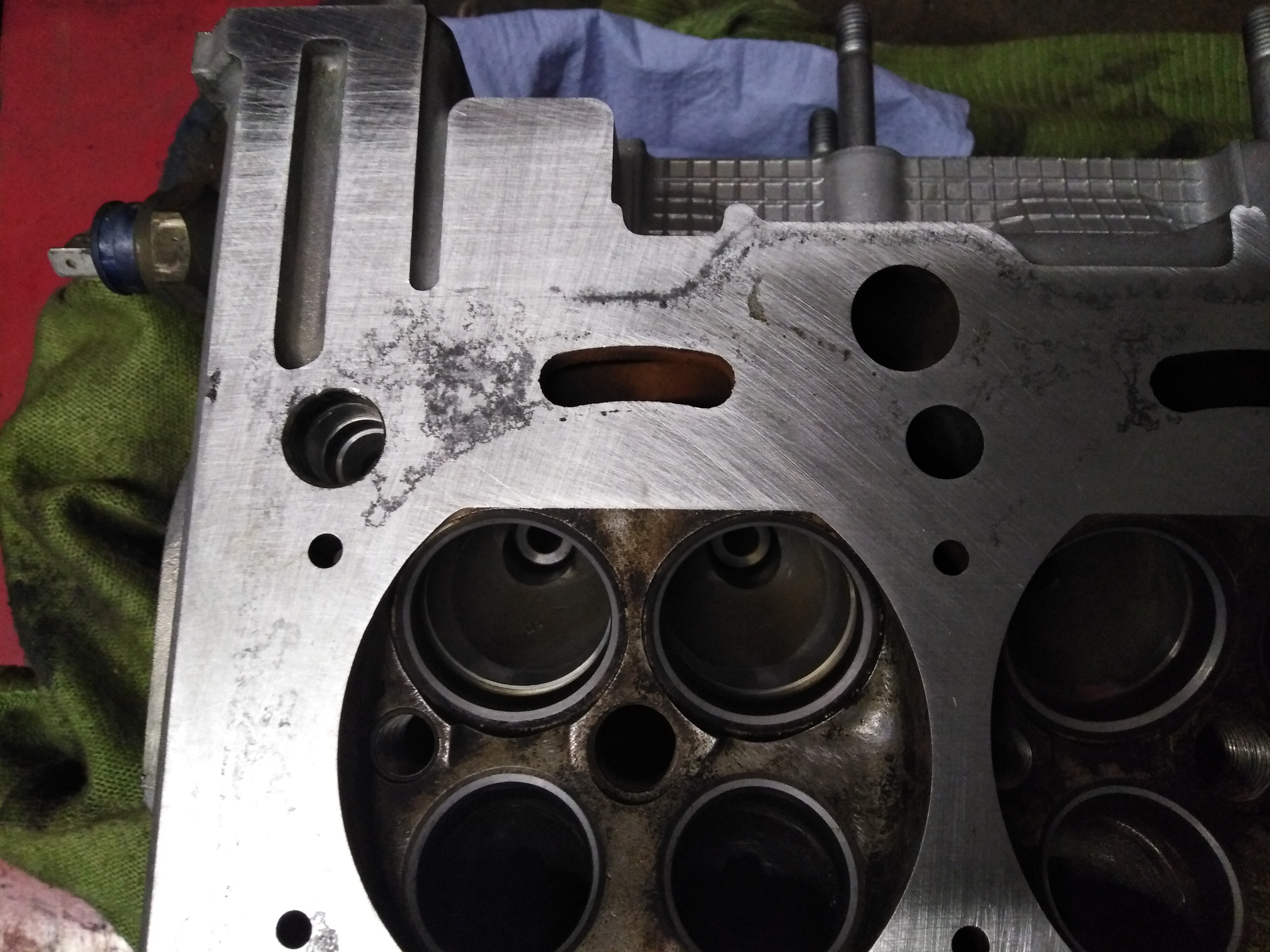

Valve seats lapped in, hardly took anything doing as in great condition.
Gave the head a clean up with some fine paper on a block but although I'm sure it's flat enough to be perfectly useable there's enough pitting for me to go the extra mile while apart and get it lightly skimmed.
Local guy who did my Delta head says he's still working being pretty much a one man band so I will drop it off to him Monday.

Hi Kev. When I did a 147 head I found the aluminium to be really soft. I had to be really careful with the spring compressor. Have you had any problems?
Re: 145 QV
no issues so far mate....

Keeping busy Kev, nothing new there !!
Handy bit if kit making there. As you say keeps things safe while working on it.

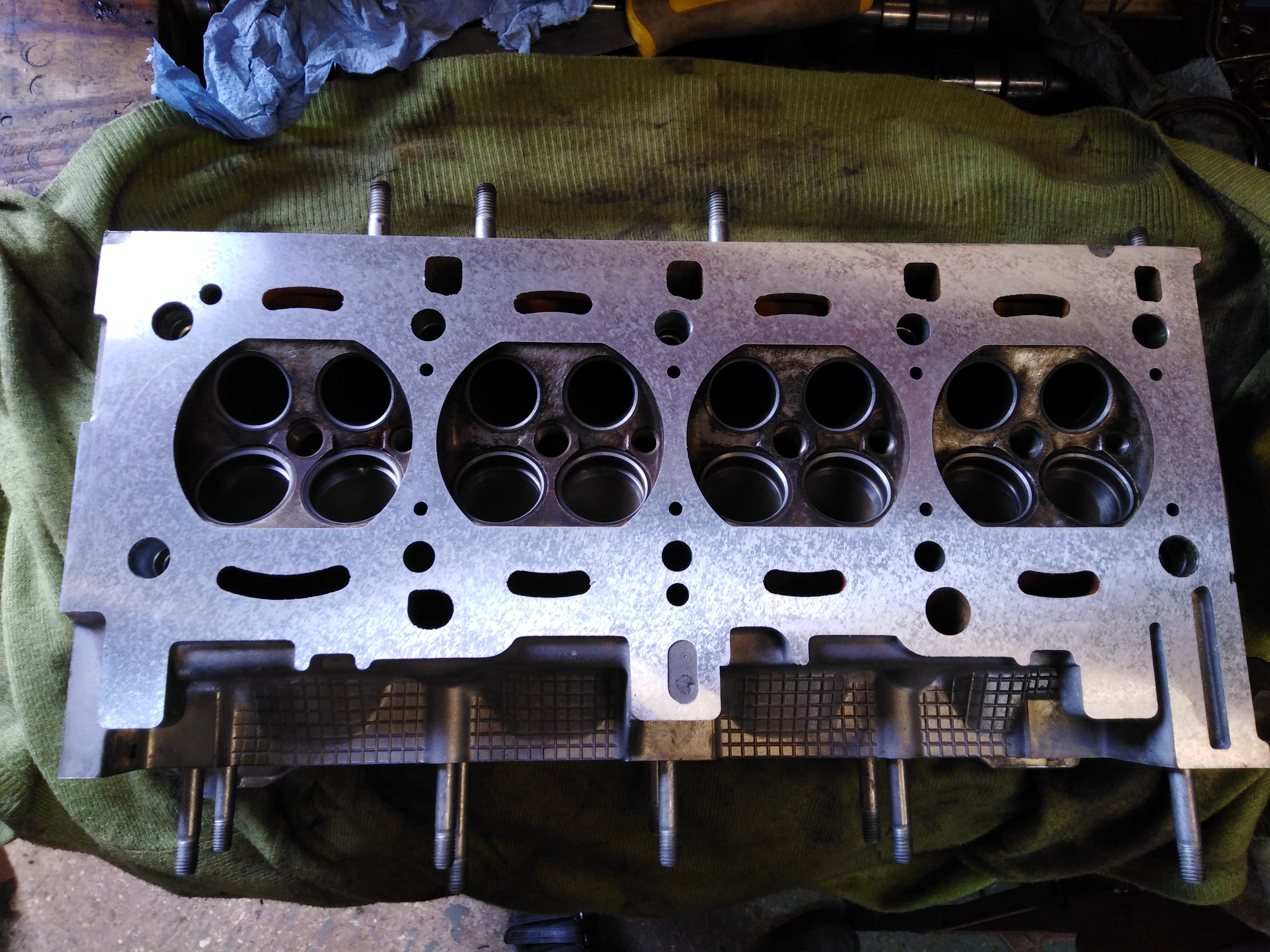

Got the head back from the machine shop this afternoon.
Turns out one corner had warped a little, guy couldn't recall which corner but no prizes for which bit I d guess, so at least it was worth taking!
Pressure washed again ready to be built back up.

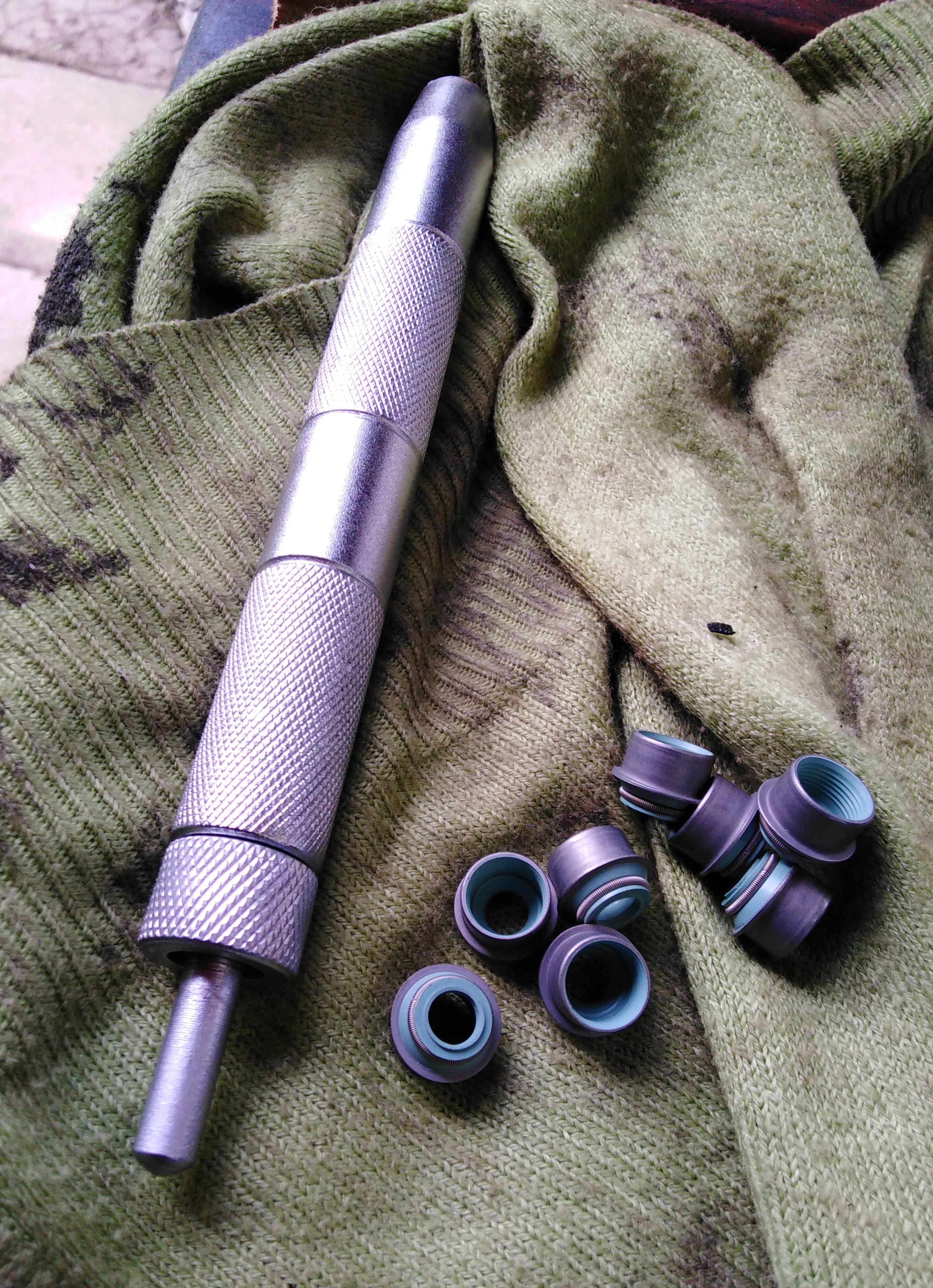

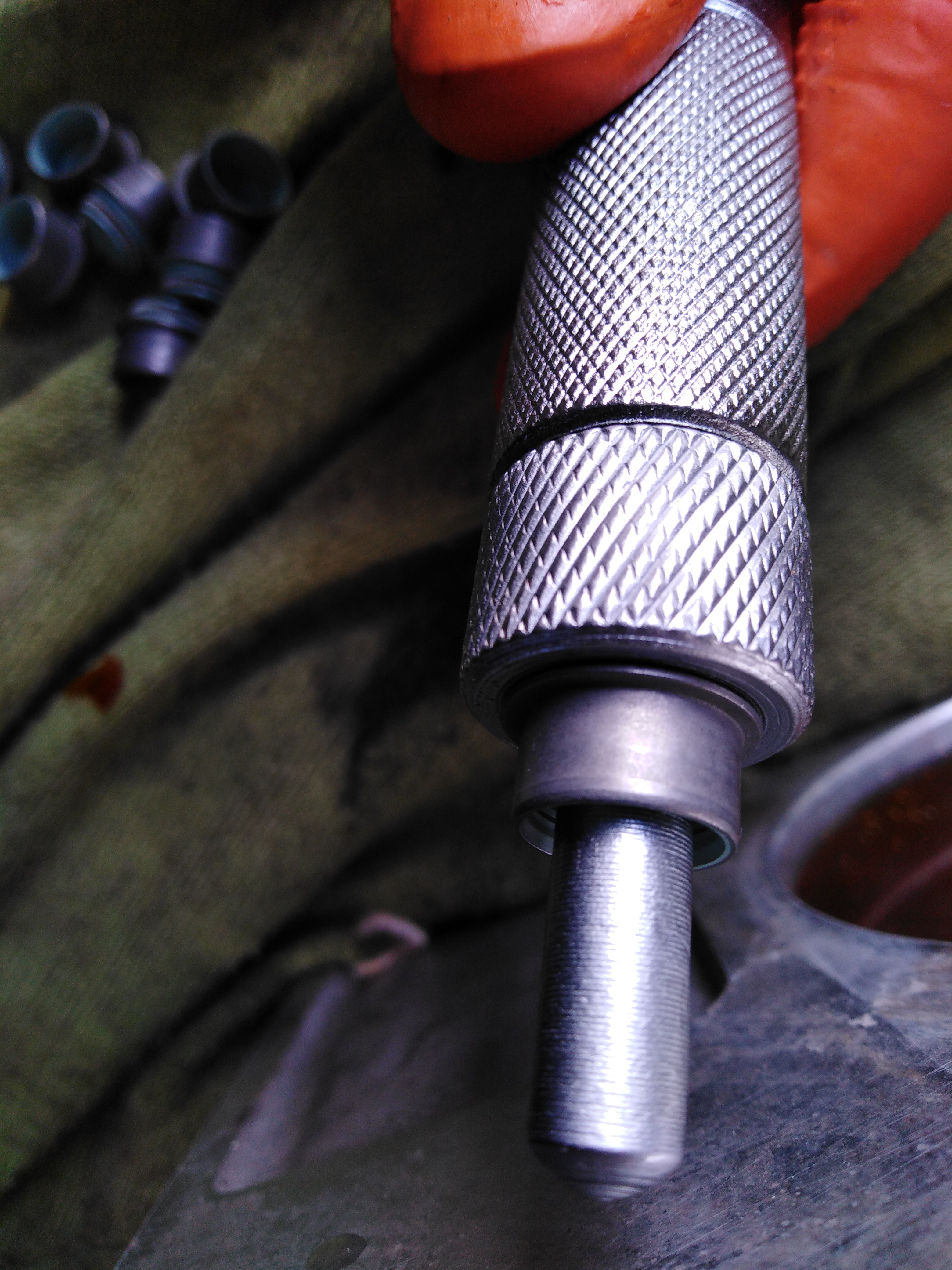

For those like me that do the occasional rebuild this tool set is handy to have.
It's a valve seal removal and install tool set.
The top pliers looking tool is for removing the old seal, jaws are curved and serated so they grip the old seal to make removal effortless even in deep recesses like on this head.
For installing the new seals you select the correct size attachment to suit the size of the valve guide you're dealing with, so the tool will slide in the top of the guide and centralise the new seal, like this...

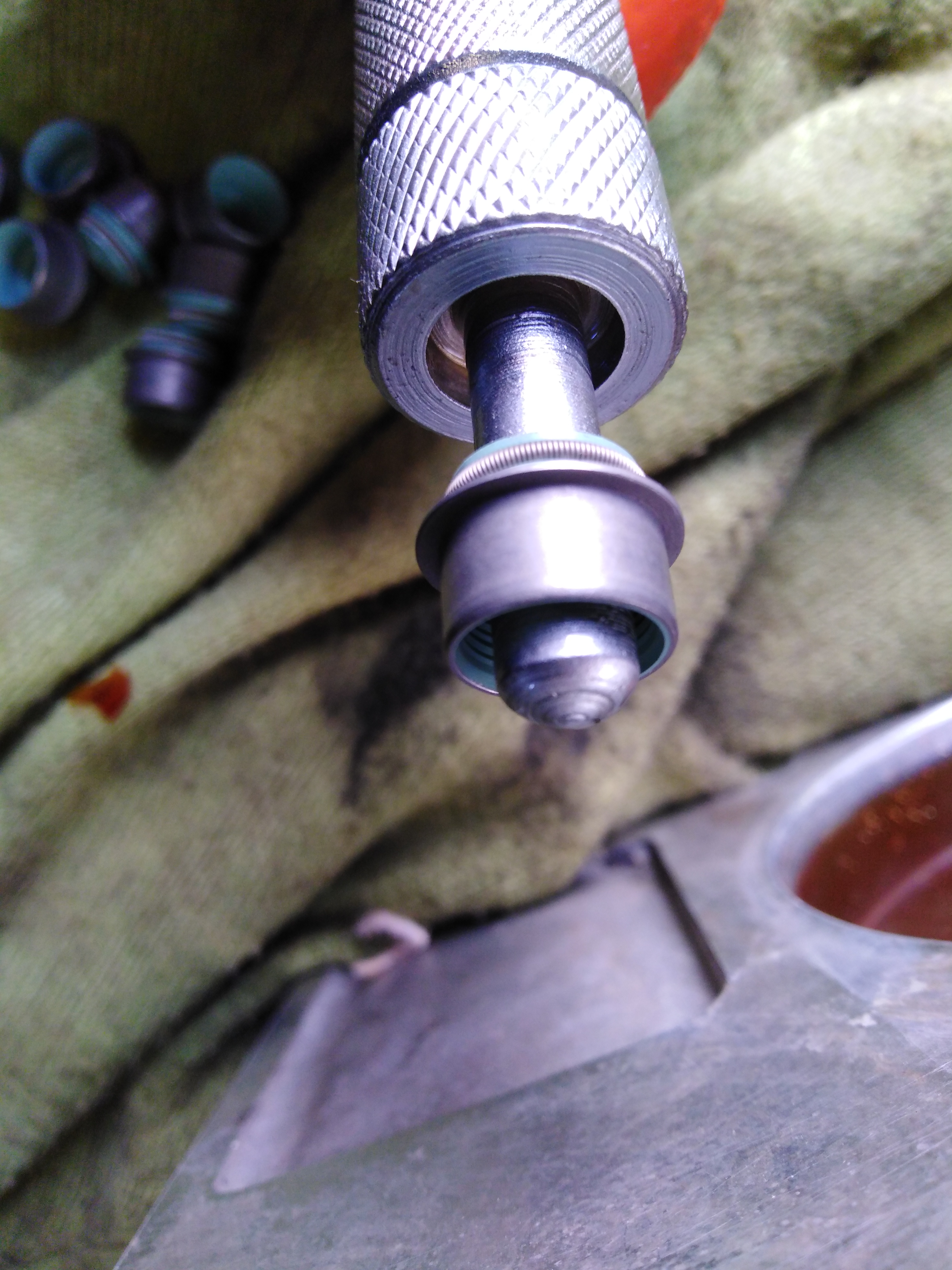

Seals and tool ready for fitting.
Put a new seal onto the tool with a little fresh oil for lubrication..
Slide it up I to the recess which protects the new seal and means you drive the seal onto the guide on the correct part of the seal to prevent damage.
Slide the tool into the valve guide again which lines the seal up correctly and squarely, a few hammer taps and the seal is driven home.
