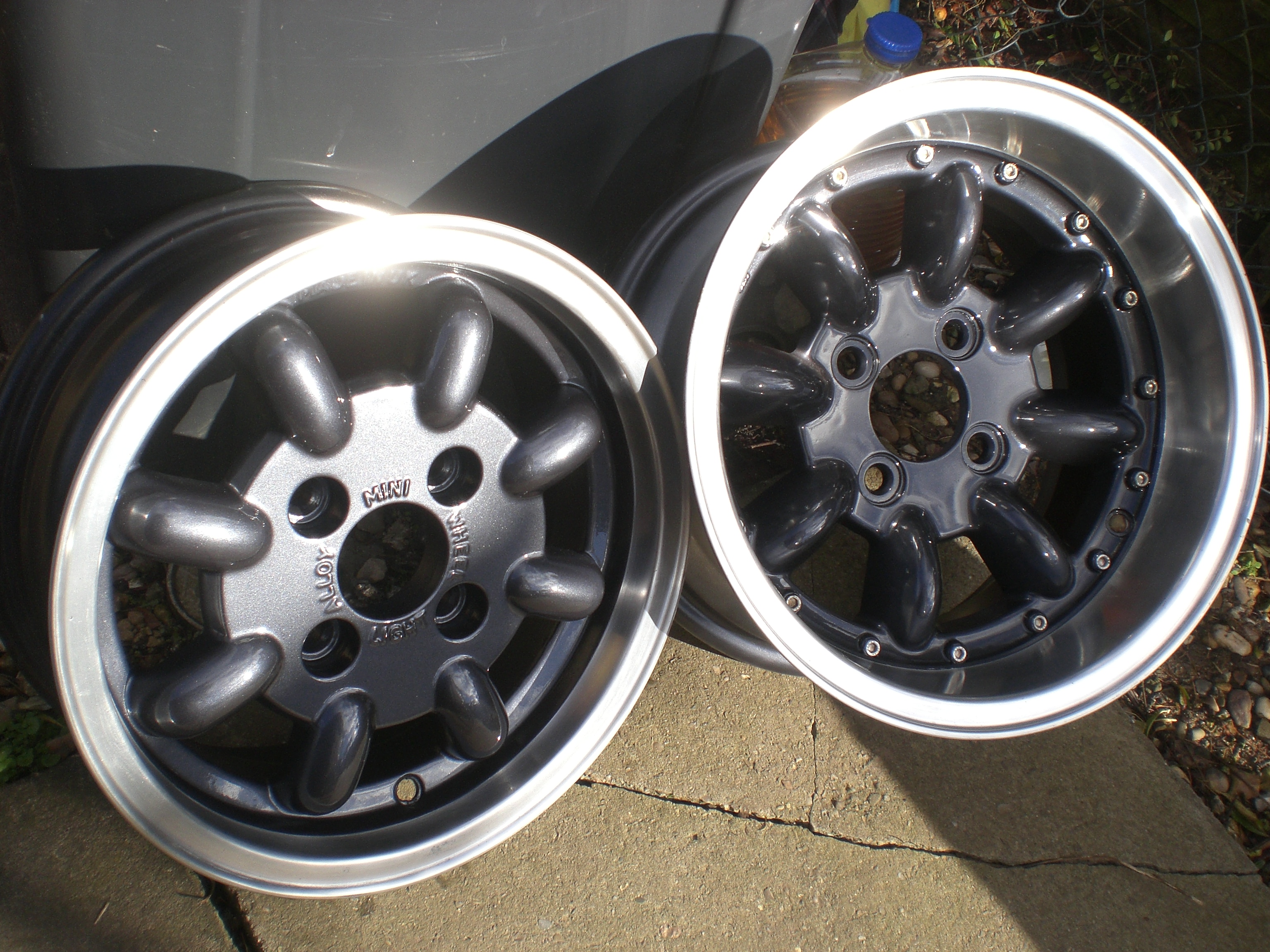

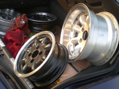

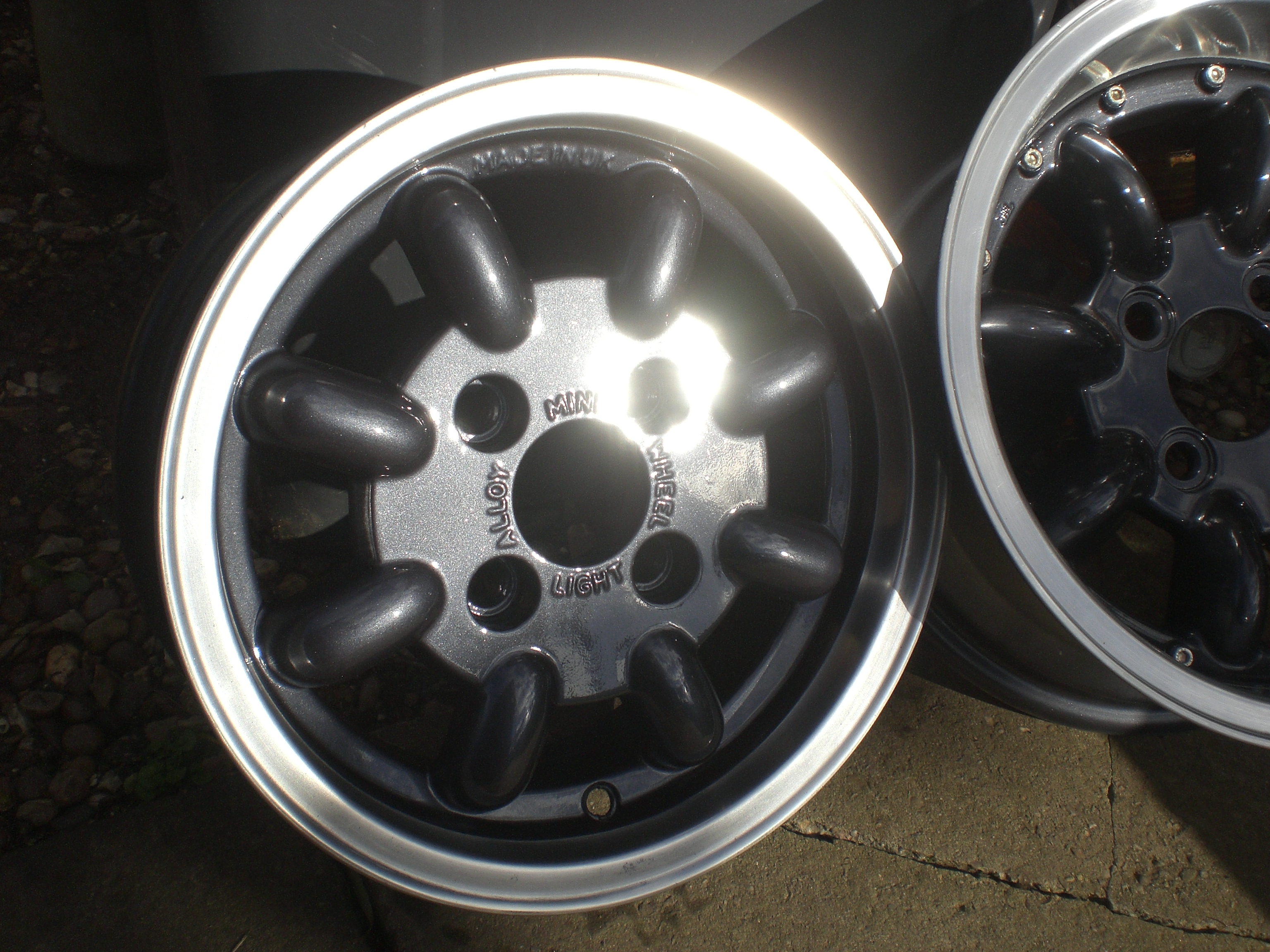

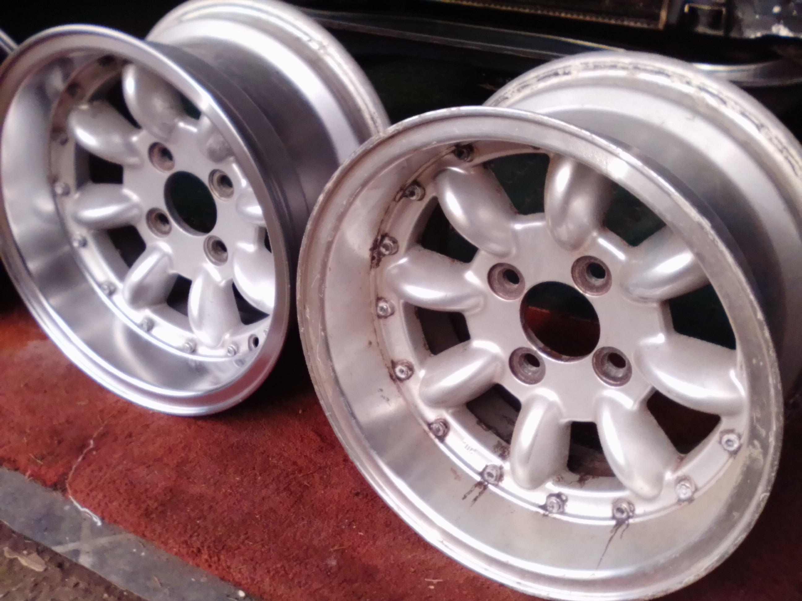

As you mention the wheels....
I spent a few hours down at Shrews today to polish the lips on the rims, the fronts were powder coated so that was a tough start, luckily for me Shrew did that bit for me, cheers again mate
The rears have a wider dish as they are 7x13's, front's are only 5x12 so we ground a bit of the powder away to create a lip. Centres I will paint in a metallic colour of some sort, Rob is making that choice....think he has bought some grey metallic, similar to the anthracite ones I think, we'll find out when it's on!
Shrew made a start for me, leaving me the easier part to make it shiny
The lip then went through varyingly finer grades of paper down to scotchbrite pads then metal polish, here's a before and after on the rears which had been lacquered which was now getting stains under it
The full set all done, ready for a bit of work on the painted bits..

Looking good Kev. Are they really going to fit under the arches?
						Re: Kev's workshop projects
Yes mate, rears we've already tried. Have actually got a set of 4 of the 7" ones but they wouldn't go on the front!
Broke the habit of not working on a Sunday to do these, but was actually quite enjoyable. Shrews' machine set up takes all the hard work out of it

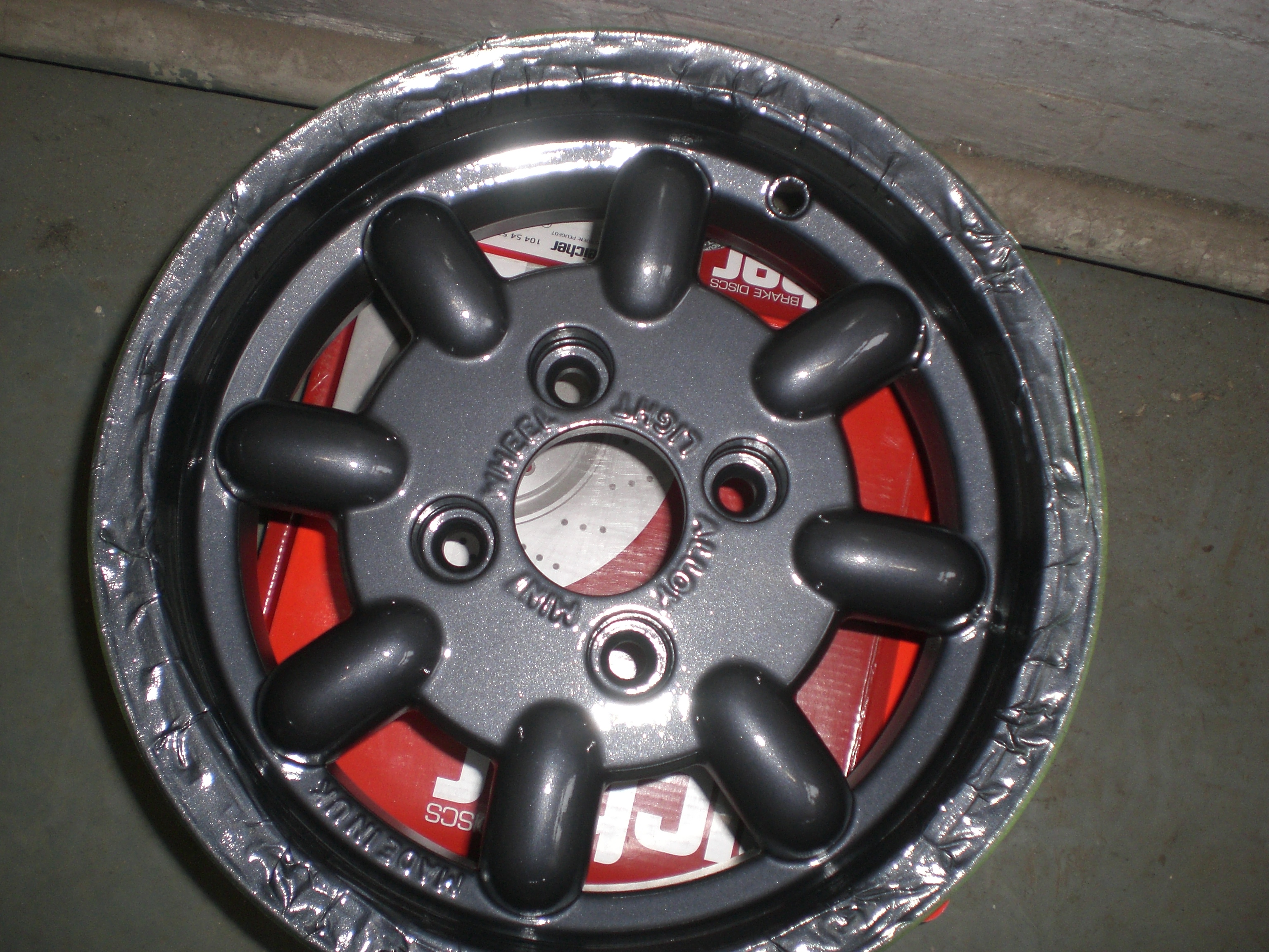

Spent most of my tea breaks this week sanding and sorting the wheels, stayed on tonight to spray them with Peugeot steel grey metallic basecoat and lacquer.
Thanks to Keith for putting my mind at ease when I got myself all confused, not used to lacquering stuff, cheers mate
A late finish, got away about half 9 instead of half 5, but at least they will sit toasting in the customers toilet with a nice warm heat on them all night, must remember to take them out in the morning when I open up!
Hoping they have come out OK....

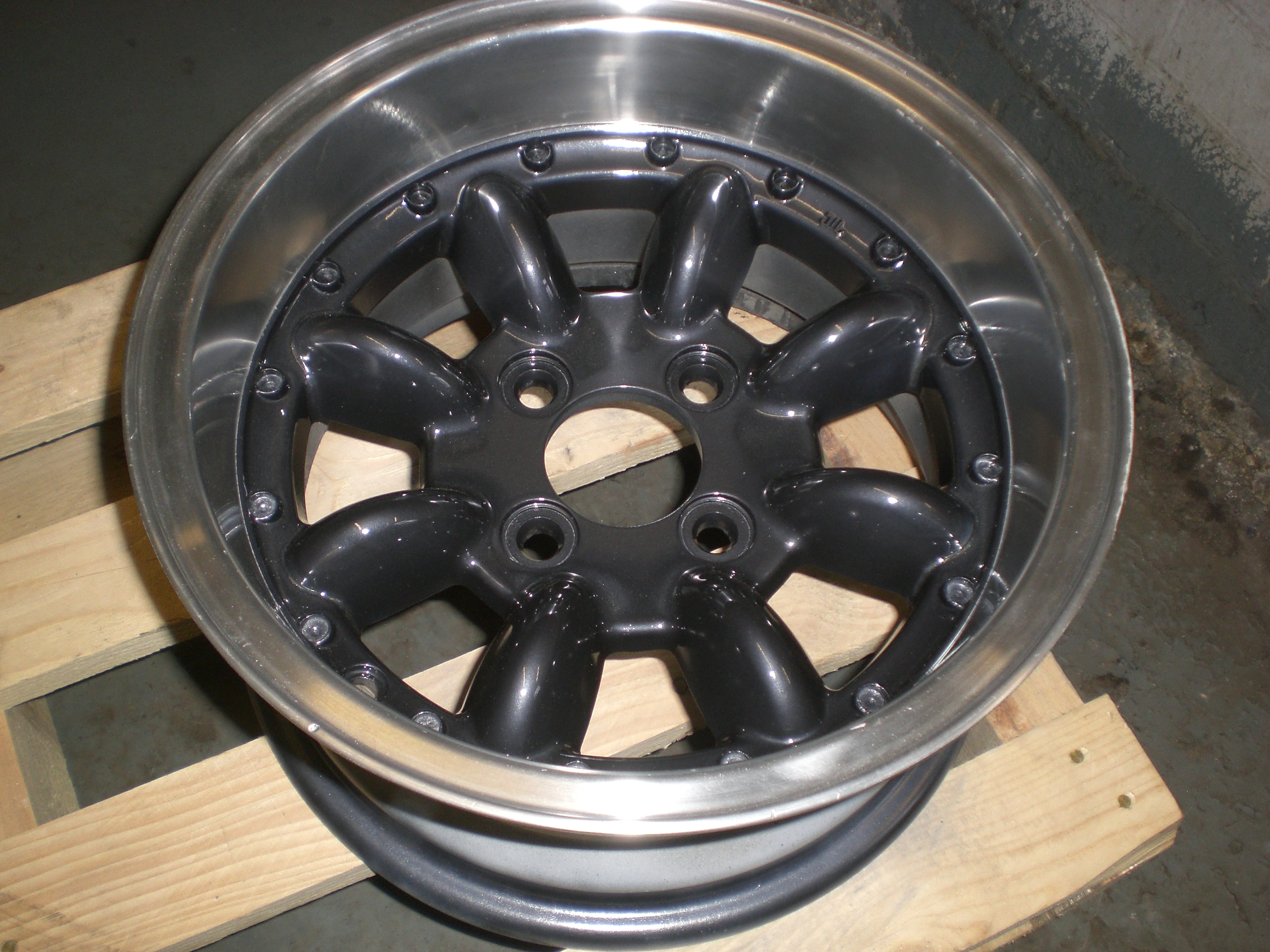

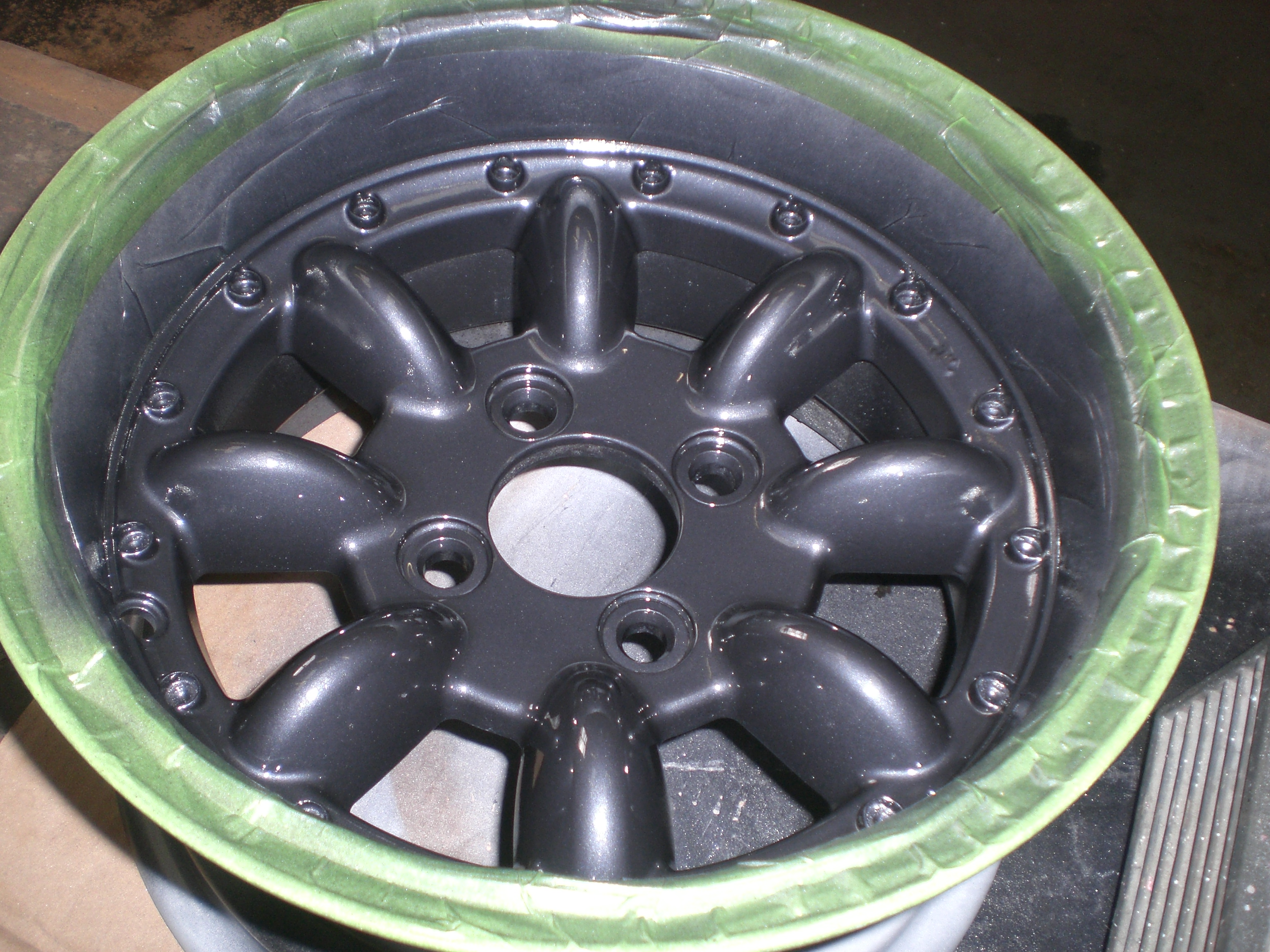

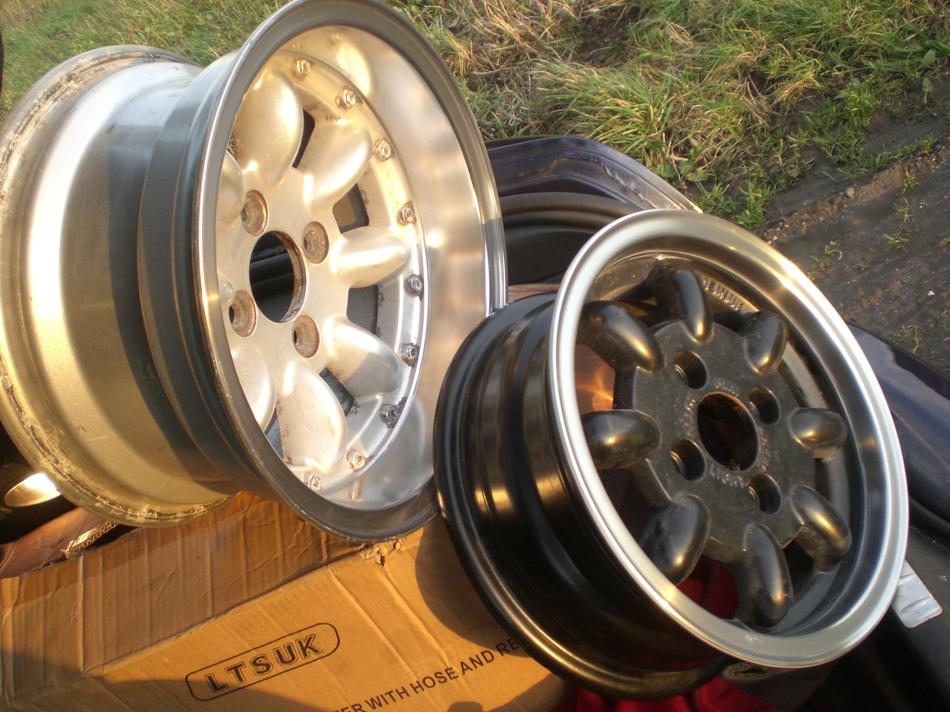

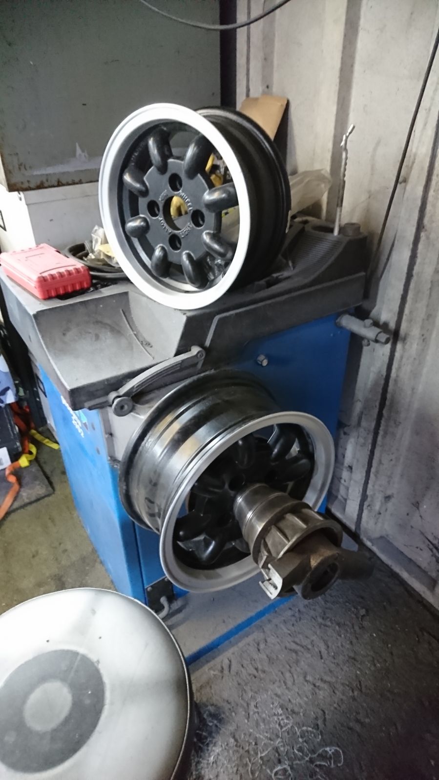

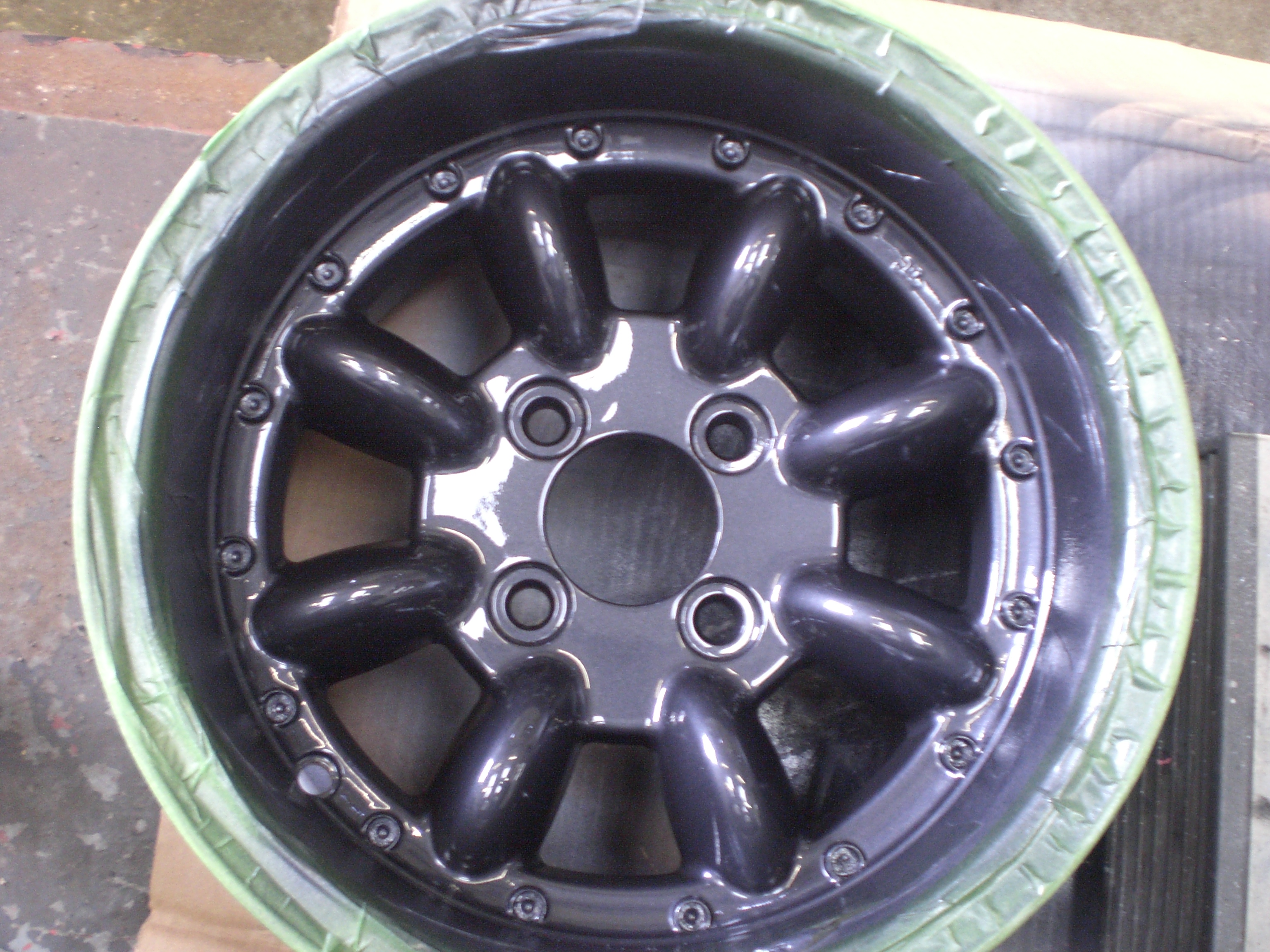

Think I made the amateur mistake with the basecoat JB, laying it on too thick on the spoke areas so I could get good coverage on all angles, only to overdo it! Looks like the base simply ran off the spokes onto the flat areas in a lava flow situation!
In these pics it's the different shades where the spokes meet the flat face that was the issue.
So today off I went back to work armed with a couple of fresh cans of paint and lacquer determined to make a better job of it..
They seem to have gone on OK but the morning will tell for sure, but confident they are OK.
This after they've had some baking time so should be solid enough not to start the volcano effect again!
I bought 32 stainless steel cap bolts which I can cut the threads off then bond into the holes in the rear wheels for the fake split rim effect...

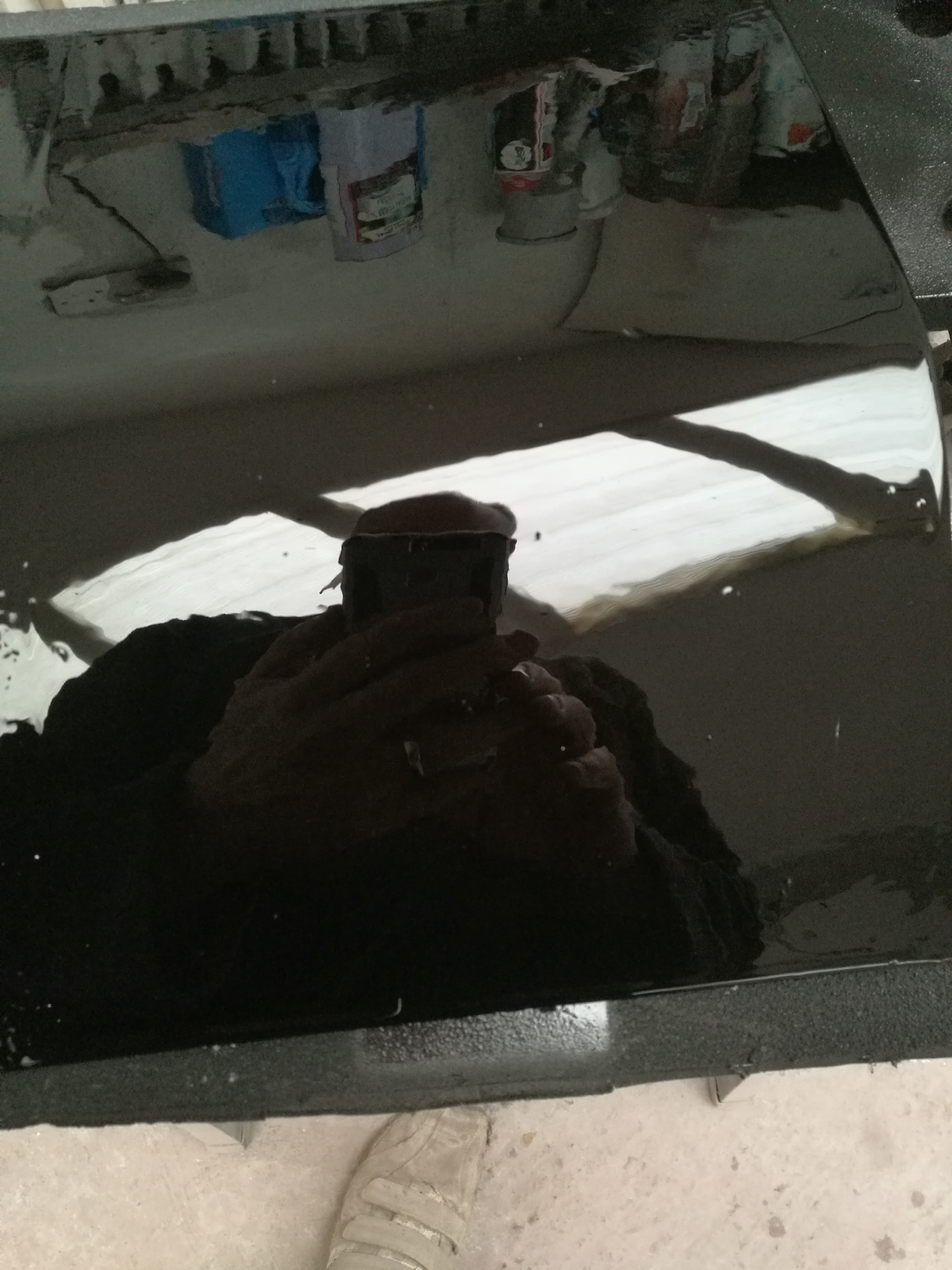

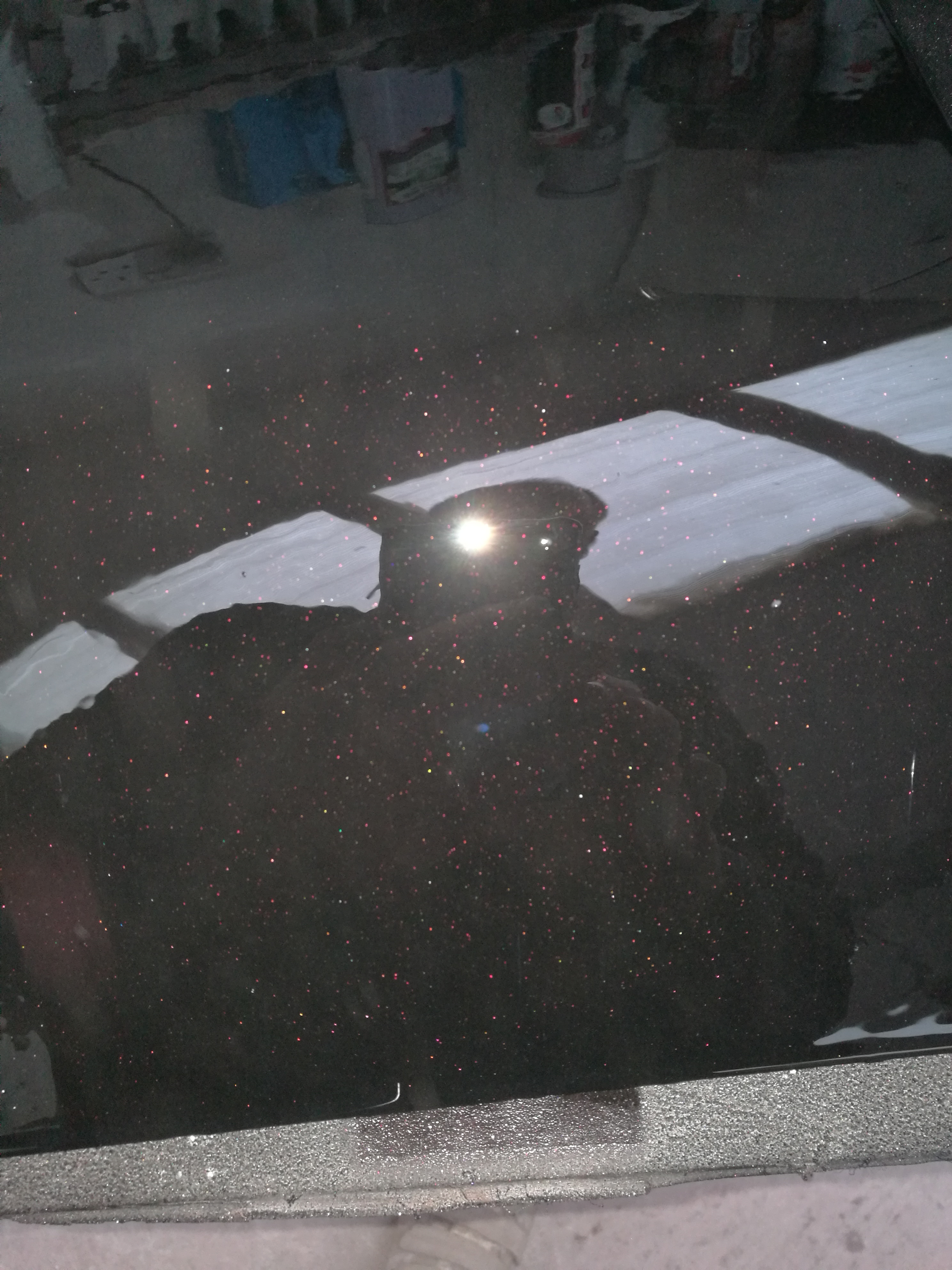

Talking of paint . I had a bit of a play today with some paint which maybe going on the 33 .
Test panel no flash just painted with loads of clear. Need to see what it looks like in the sun. With flash

Like the different colour flecs in that paint mate

Spray cans . That now makes sense .
This is the item number for the touch up gun 222531105091. You won't believe the price
As for the black . It's not a great photo. The Metallic red is already in it. As opposed to laying it over the top of the base . It's a Jag colour . I mite get the guys to add a bit more red . But I want it to look black until the sun hits it .

They came out good Kev.
Sorry you had trouble first time. Did you notice the shadowing before the lacquer went on or after?
You did well using a can as well. As you know, cans give just pressurised paint with no air so makes control tricky.
Trying to think back mate I think it was in the basecoat, I concentrated so much on getting coverage over all sides of each spoke that I ended up putting loads on, then didn't have enough left over to go over the face section!
Either that or the heavy handed use of lacquer to get a shine led to it sliding down the spokes and pooling, as JB suggests.
Either is a distinct possibility.
As long as the customers toilets look after them and bake them overnight I'll be happy, as will Rob!
The shadowing wasn't terrible but as you know, when you know something is there you know it's there and can't help but notice it. Other people would have seen it and made comments, which always makes you cringe and wish you'd made more effort when the chance was there!

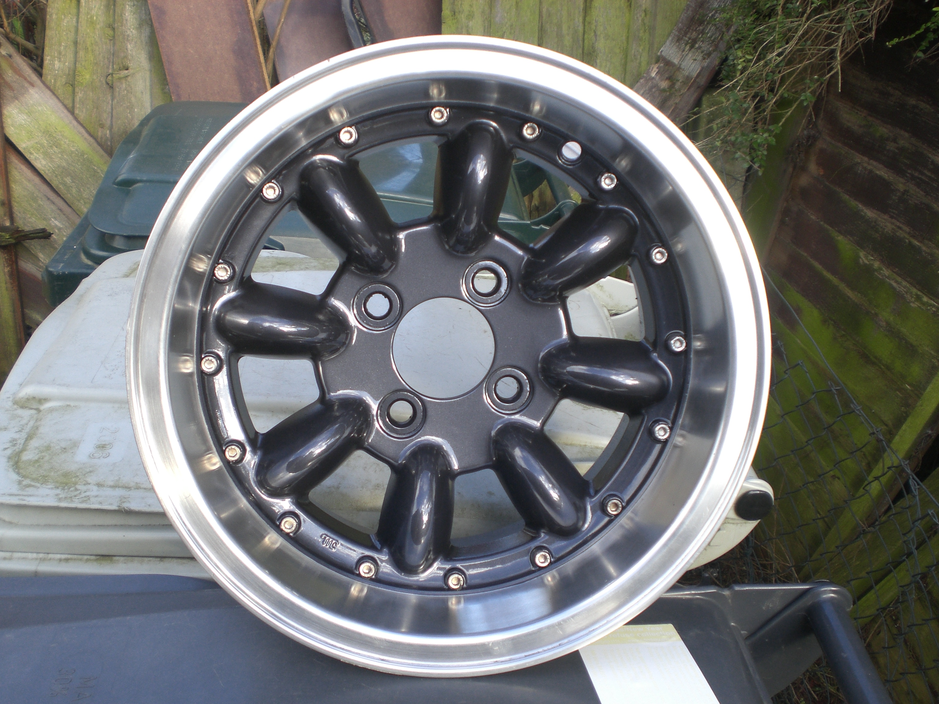

Well the wheels are finally done, apart from the polished sections needing another polish where they got marked with me scotching the painted bits, Rob can do that - get him used to doing them!
32 stainless bolts were cut down and threads ground flat to create just the stainless heads which I then bonded in place.

They look really nice Kev. I can not believe you got that finish with cans.
