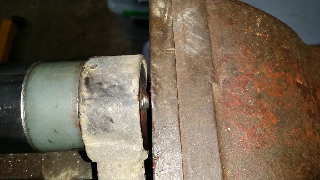

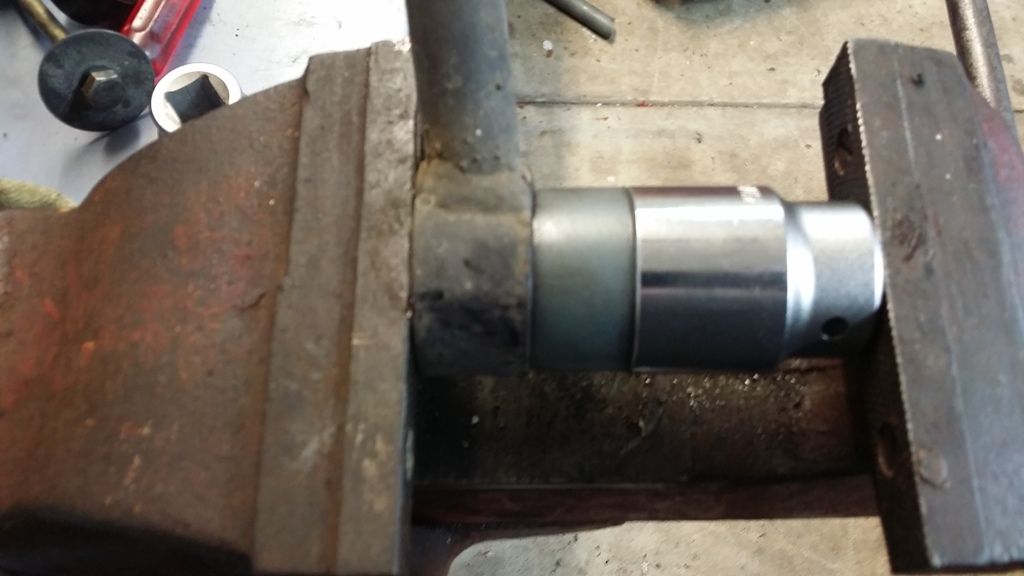

Not many tools required. Start with one of the short bolts that are used dto mount the arm to the car. Remove nut and all washers. Put it through the new bush with the long end out the same side as the chamfer.
See the pic.
amichie
Posts: 34
Joined: Mon Nov 24, 2014 3:19 am
Re: Tight bush . . . . .
Post by amichie »

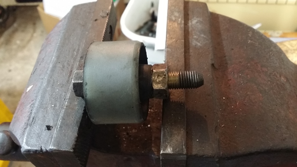

Next get a big socket to push the bush in from behind and assemble into the vice or press as shown below. Note when the bolt just nips up in the vice there is about 5mm gap between the arm and the vice jaw.
See the pic and note the gap.
amichie
Posts: 34
Post by amichie »

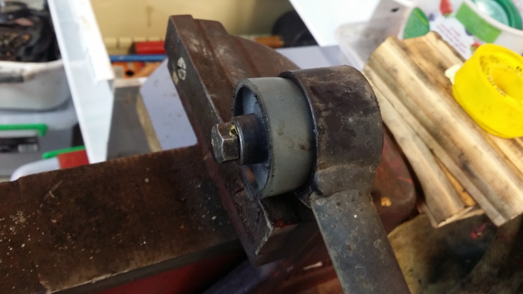

Next tighten the vice making sure everything stays lined up. As the tension increases the bolt pushes back on the centre pin deforming the bush and causing the outer Nylon shell to become slightly conical in shape. In the next pic the vice is just nipped up on the bush. It's important at this stage to have a close look and make sure the chamfer is on its way in.
See pic.

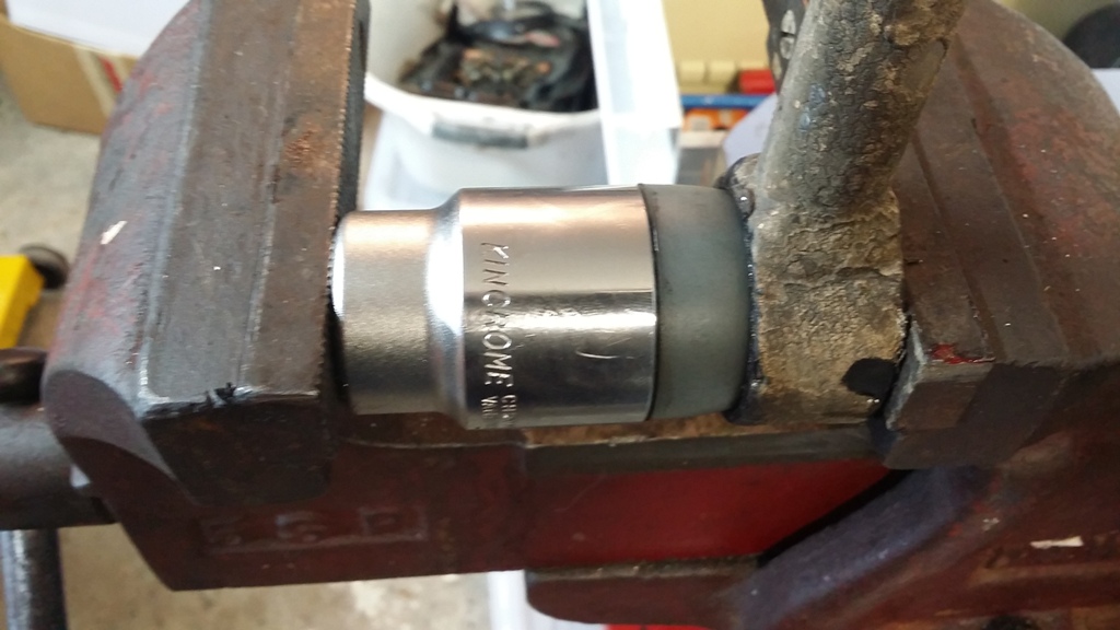

Next step is to push the bush in about 5mm. Important not to go too far or you may wreck the bush by pulling the centre pin too far through. So stop, undo the vice and remove the bolt.

It should then look like this.

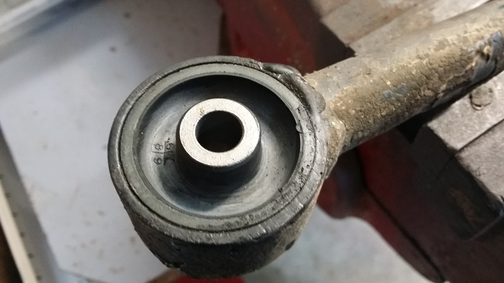

Now remove the bolt and press home.
Finished result looks like this.

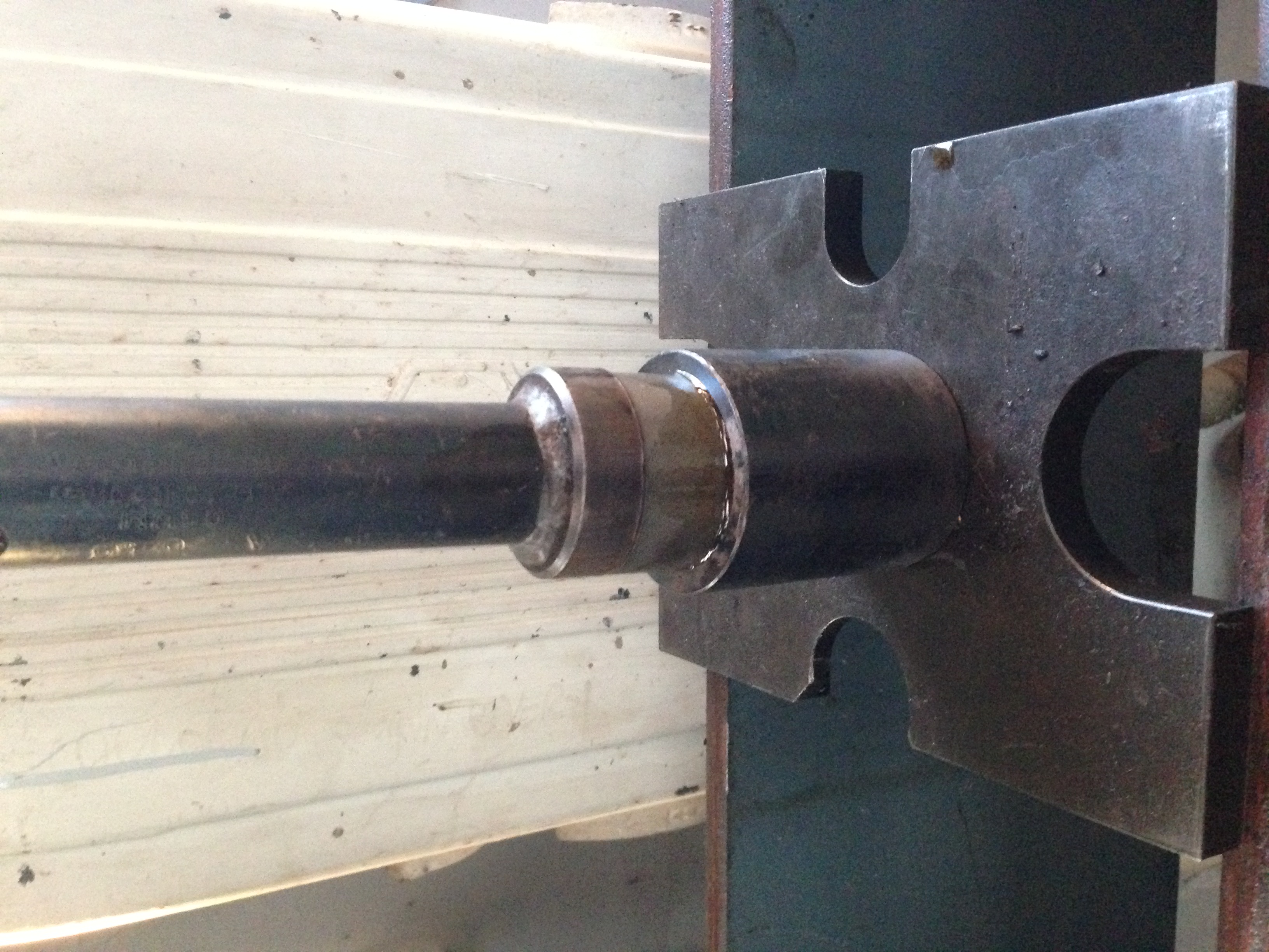

This is the factory tool which as TomS said in his post is an internally tapered tube - the bush is put into the top of the tube and pressed down with the "driver" part of the tool.
The bottom taper is the same size as the inner diameter of the arm so once the bush is at the bottom of the tube you place the tube with the bush in it over the arm and the continue to press it with the driver.
When the tube the becomes "loose" around the driver you know that the bush is in the arm
I guess these could be made fairly easily with a lathe
There a a few different sizes of this tool for all the bushes on the whole car
