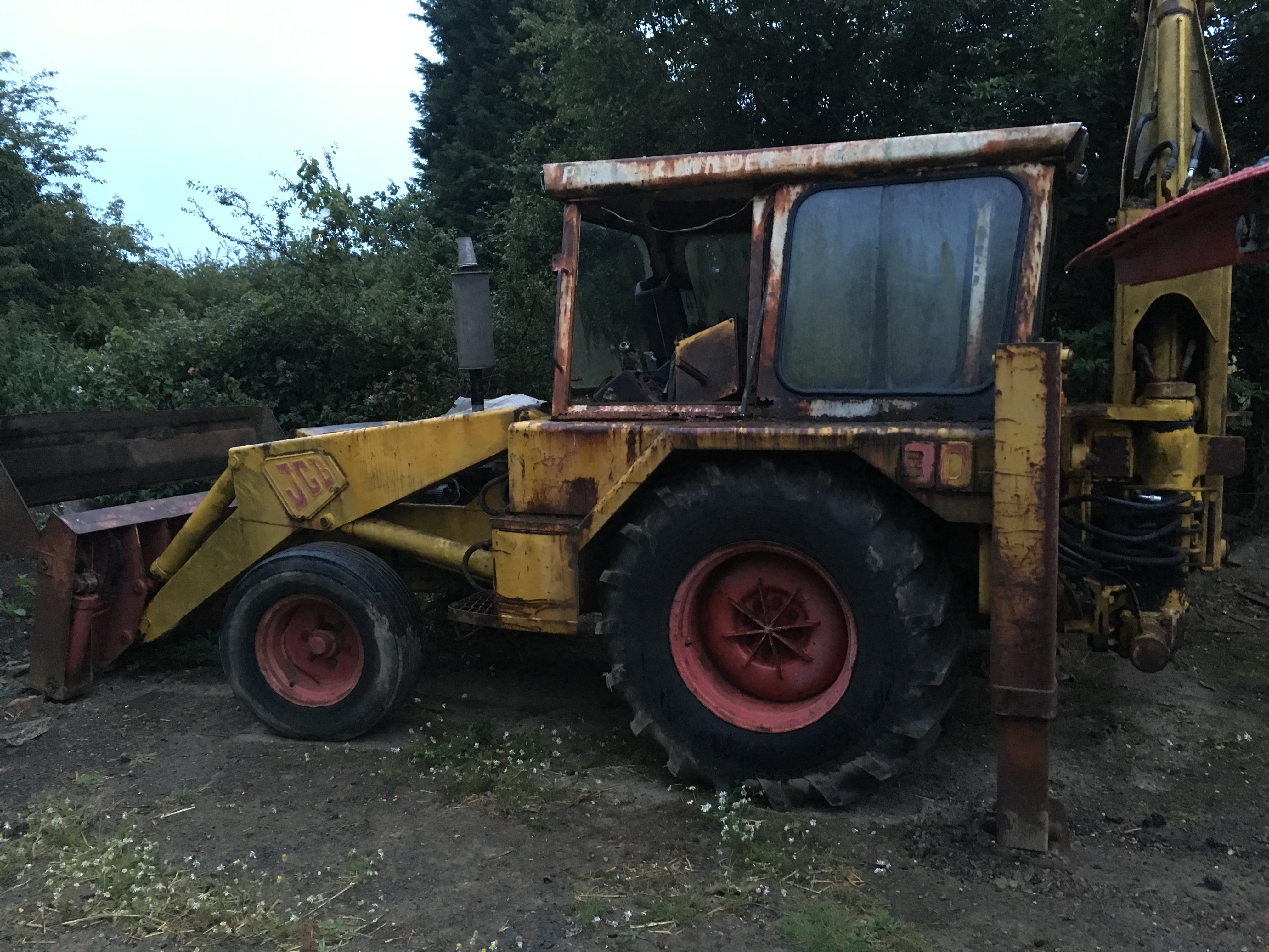

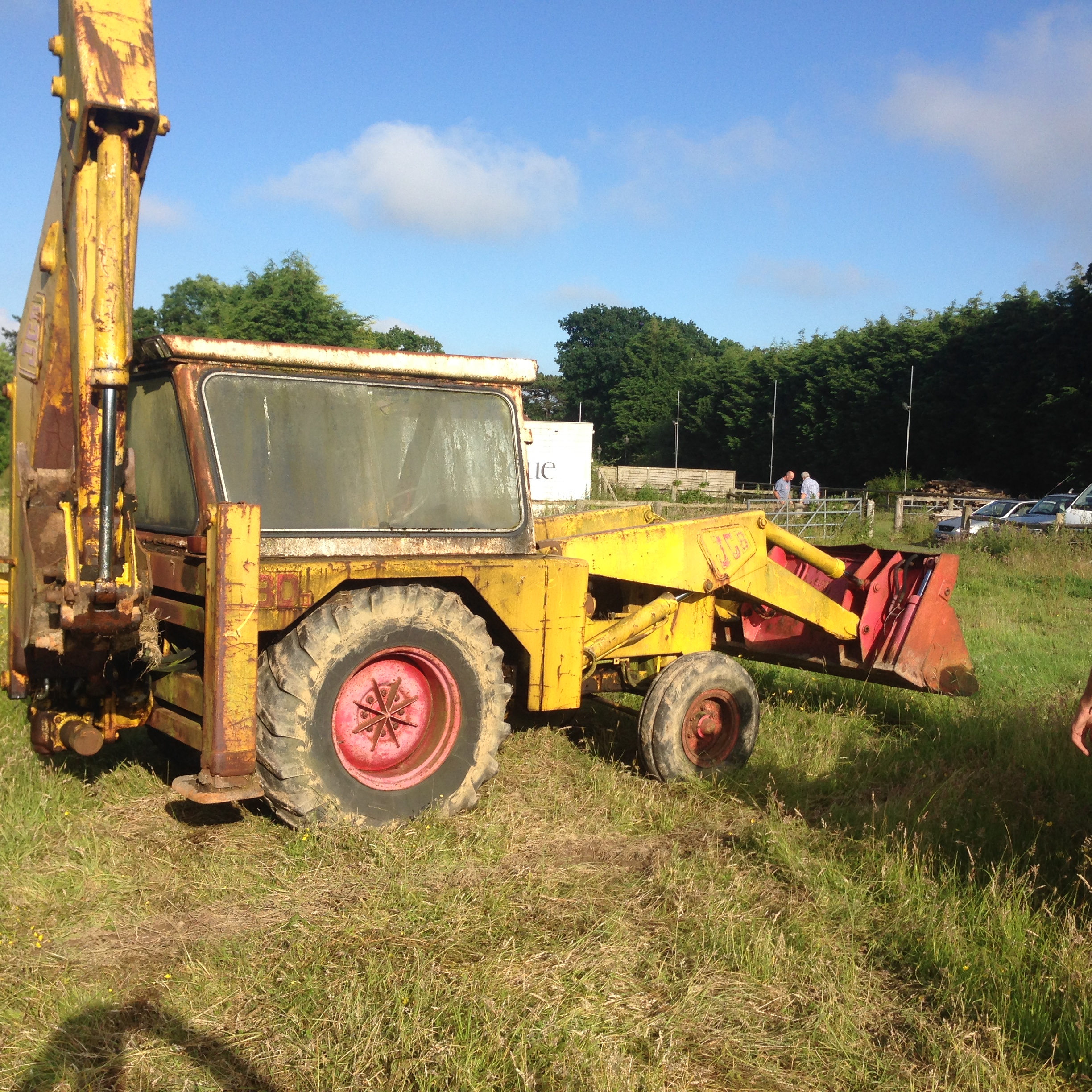

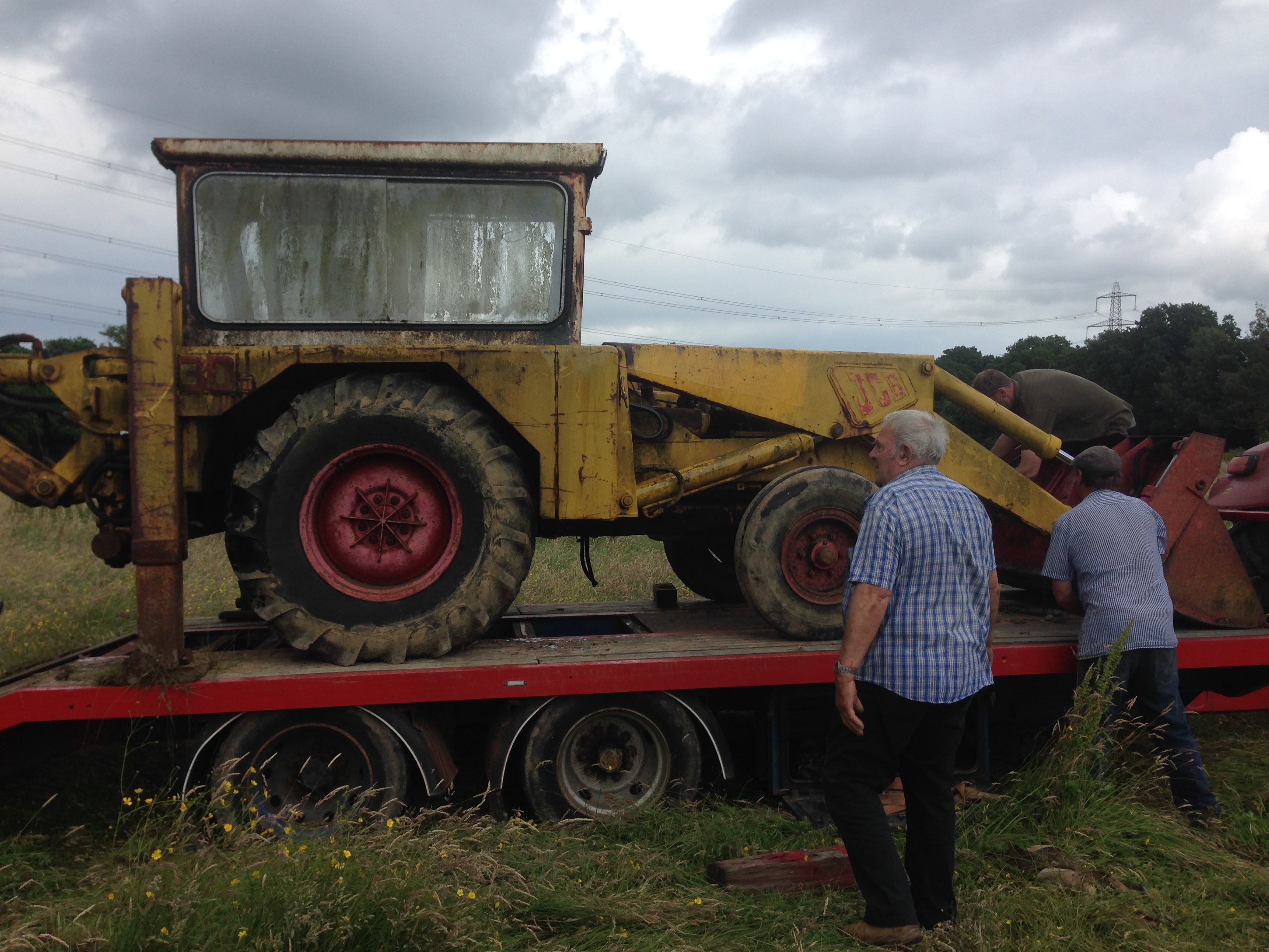

Been looking for a old job for a few years I did want a late 70s 3c mk3 but this 3d mk2 came up locally so had to have it
My dad has always been a digger driver and as a kid I spent most of my school holidays in the back of a digger or at the yard digging holes in 3c mk3 hence the resone I wanted one

And will you race it ?
Have fun restoring it, one of my friends drove to France in one delivering it. On to the ferry and off down the lanes. French customs did have a few words, but mainly what the heck are you doing?
He always said it was something he will remember for a long time so if you don't race it you could take it to the new Alfa museum.

No racing just digging random holes then fill them back in
It doesn't need to much doing its all running and complete just a stuck clutch, split hydraulic hose and rusty cab
So plan it to free off clutch fix some wiring so it starts on the key instead of a screw driver on the starter then when that's all done unbolt cab and weld it all up and a repaint

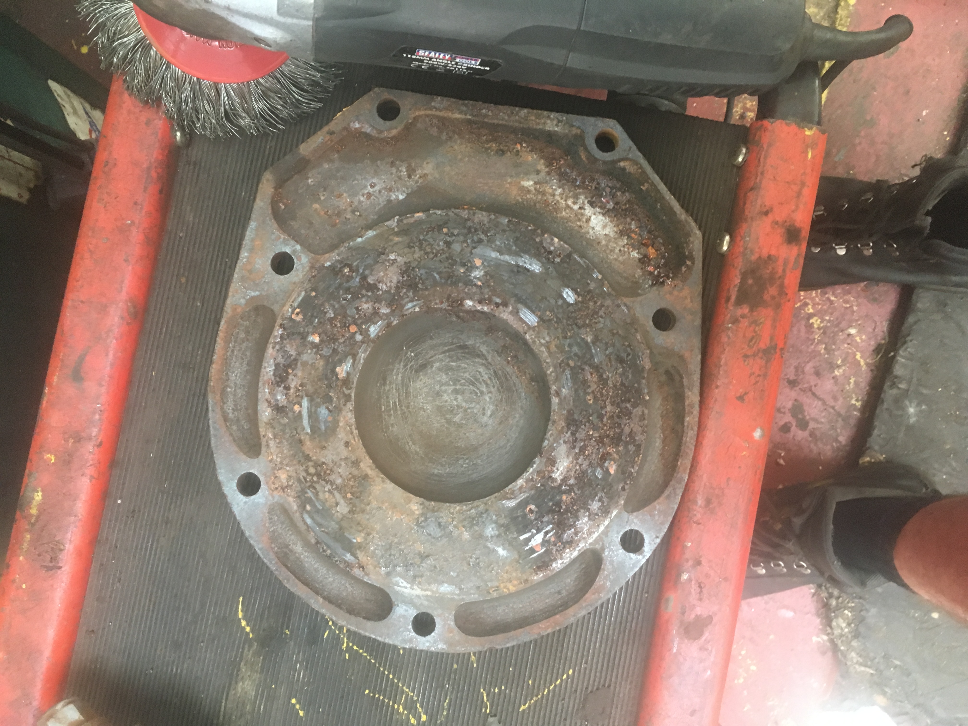

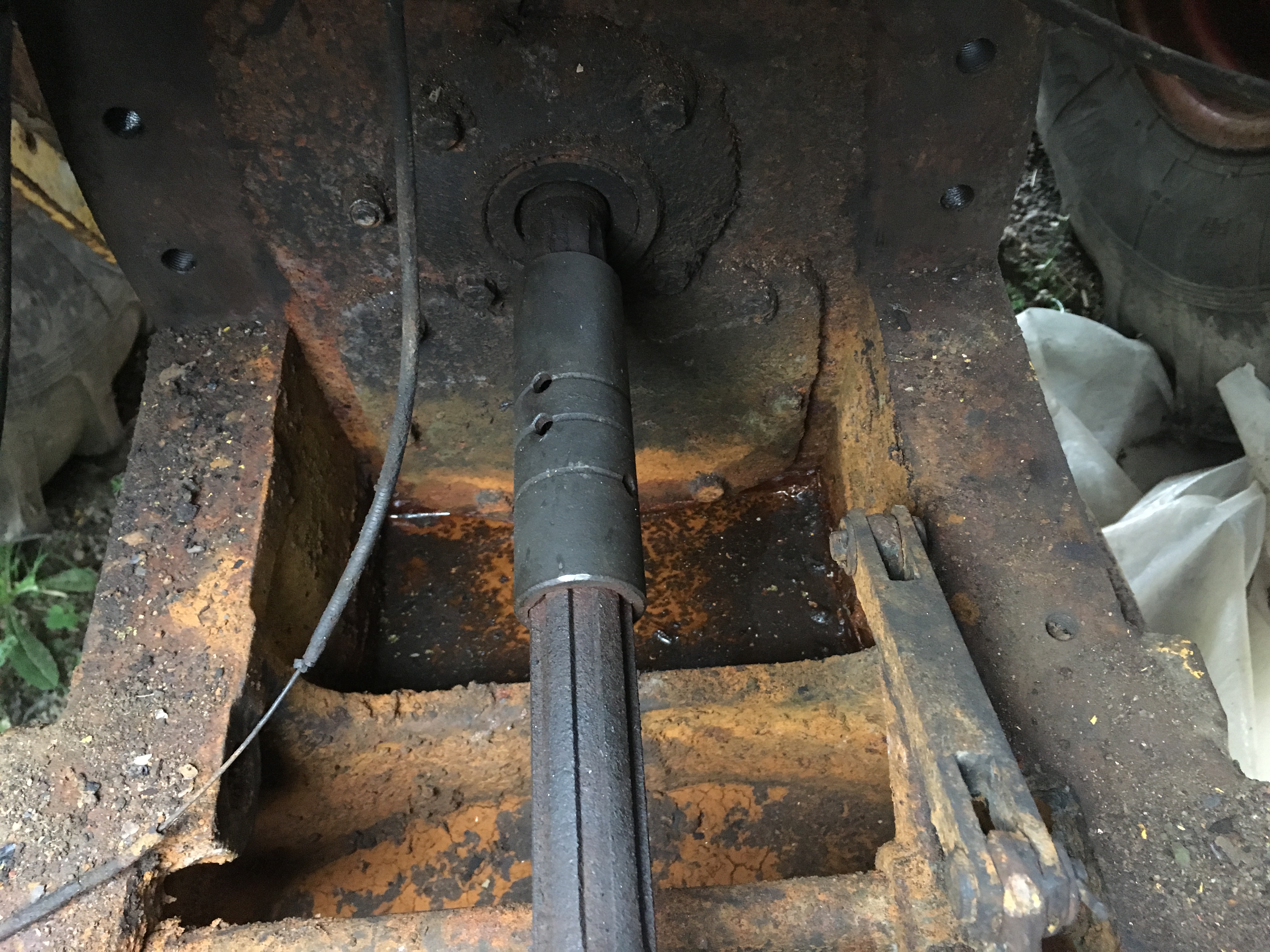

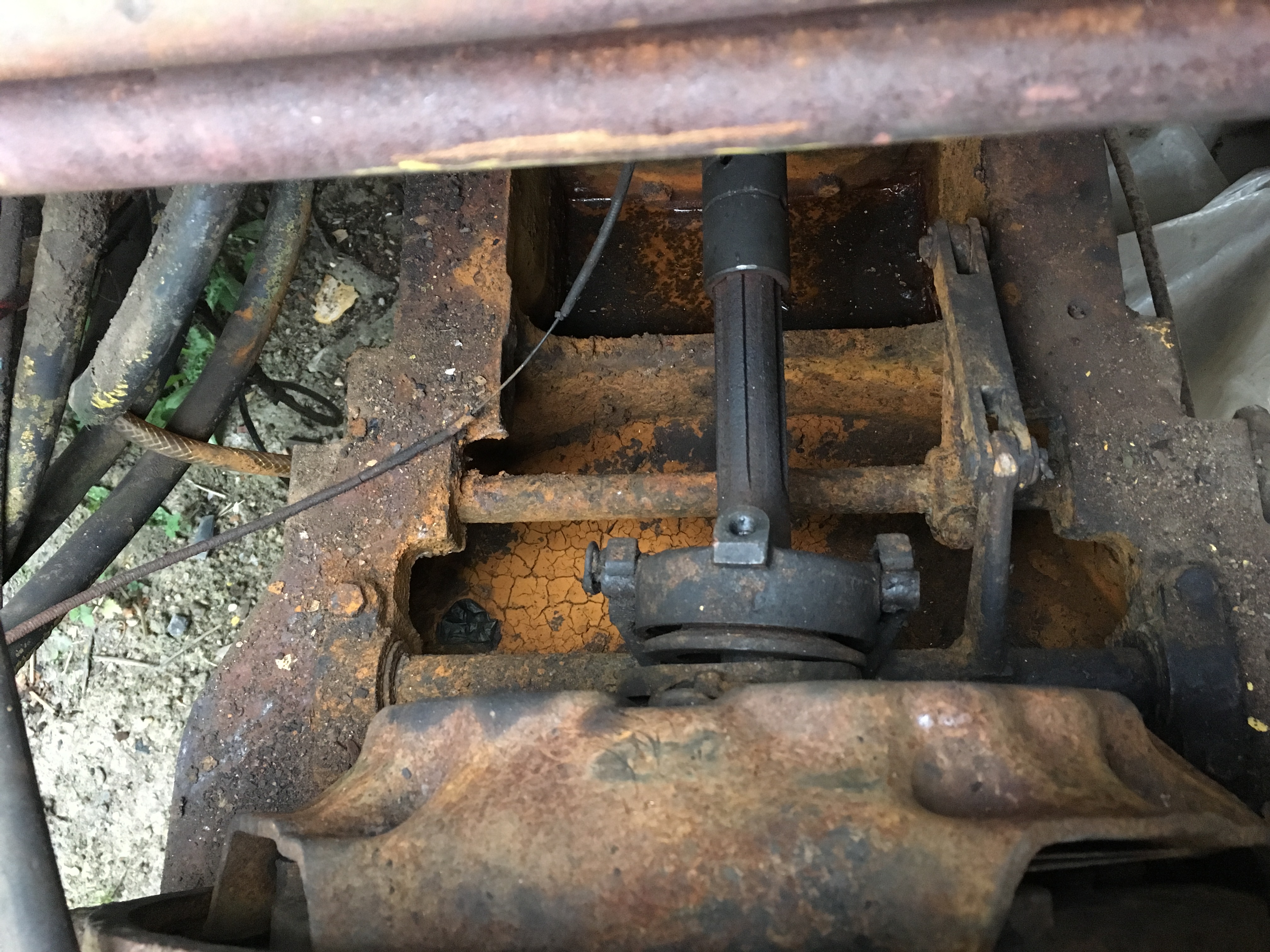

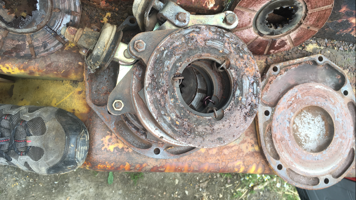

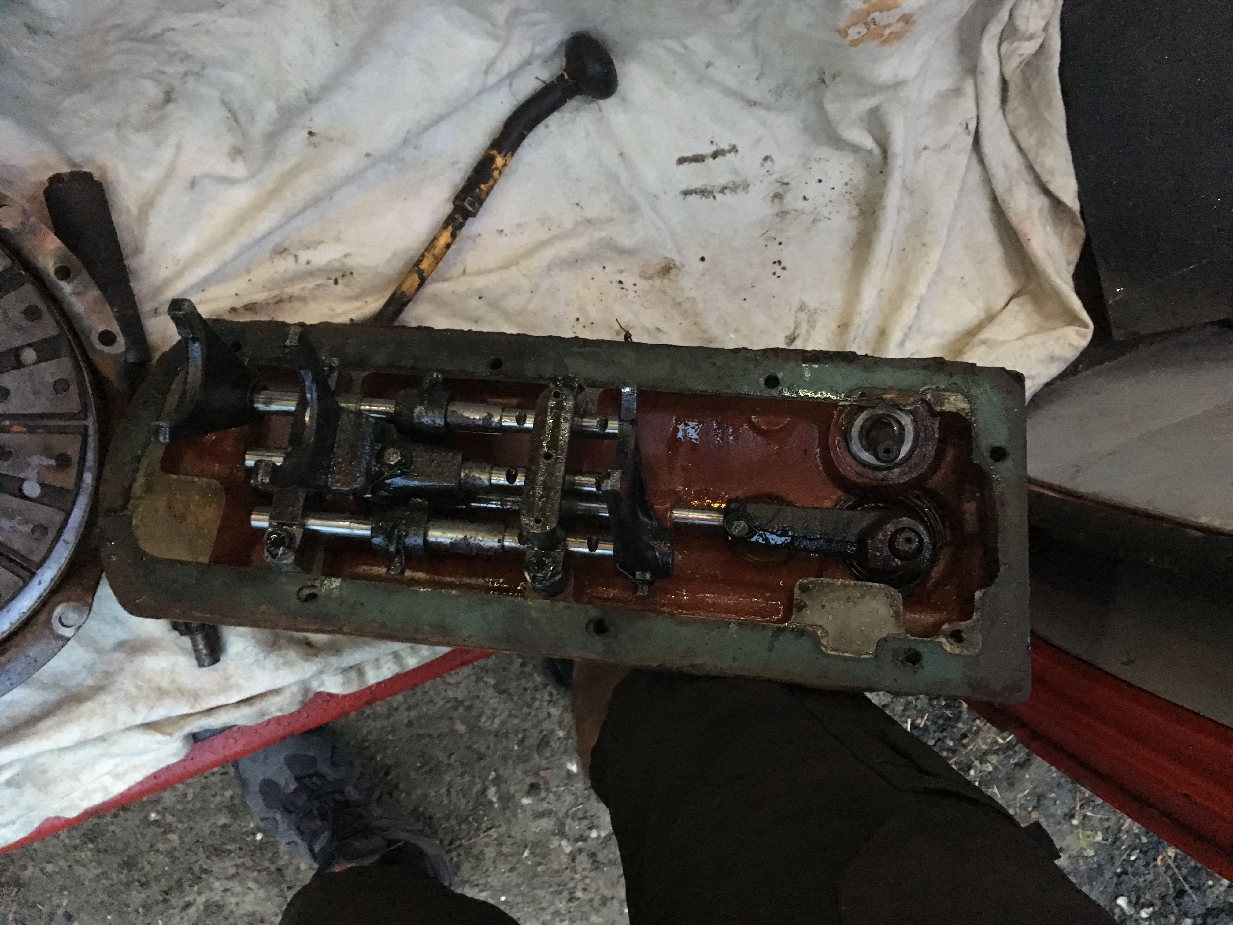

Not photos as phone full will take some soon has the afternoon on jcb and got all floors and bellhousing cover off there was a inch of water and mud in the bell housing so no wonder clutch is stuck on . Nearly got clutch out all bolts for pressure plate are off and clutch looks like it will go again I just need to get some heat on the sliding shaft as it only moves about 1mm because of all the rust once that's done it will slide out of the clutch and all can be removed would be easier to explain with pictures just need to free some memory on my phone .
Re: Not a Alfa Italian or even a car
makes sense now Simon, clutch plate fused itself to the input shaft, or whatever design it has, rather than just stuck to the face of the flywheel.

Yes I think that's what's happened just hope it's not siezed in spigot bearing

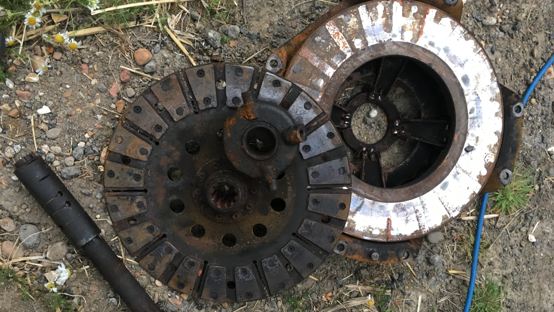

Clutch finally out didn't get to do anything over the weekend as I was riding the southdowns way Eastbourne to Goodwood circuit there was a rich boys track day with plenty of porches and Ferrari 's being driven slowly .and Sunday I was st a family party mostly drinking beer

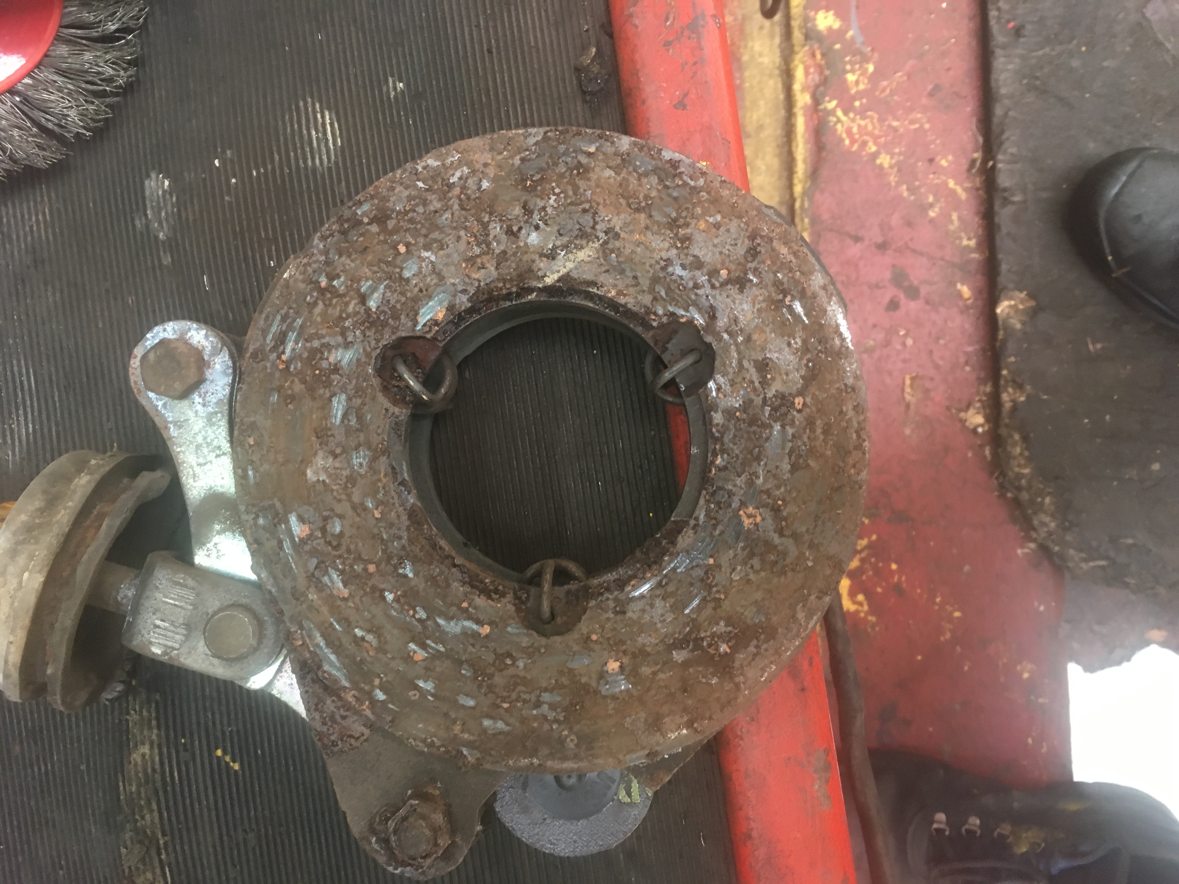

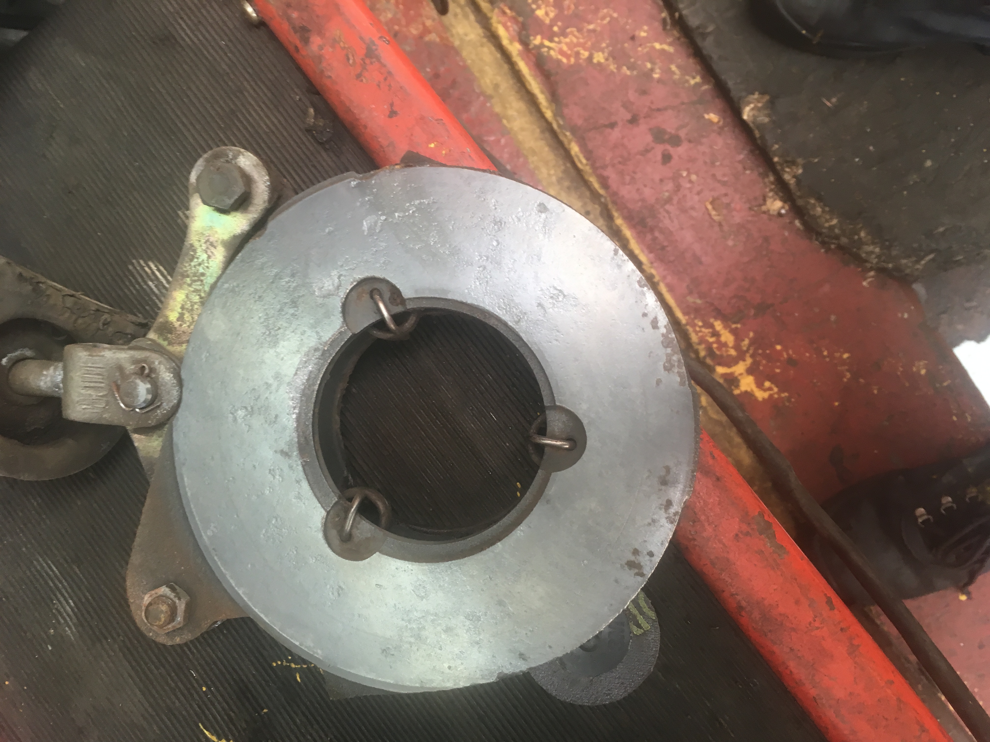

Big is not the word when I left school I wanted to be a plant fitter (be carful what you wish for) it's good fun just bigger hammers and spanners

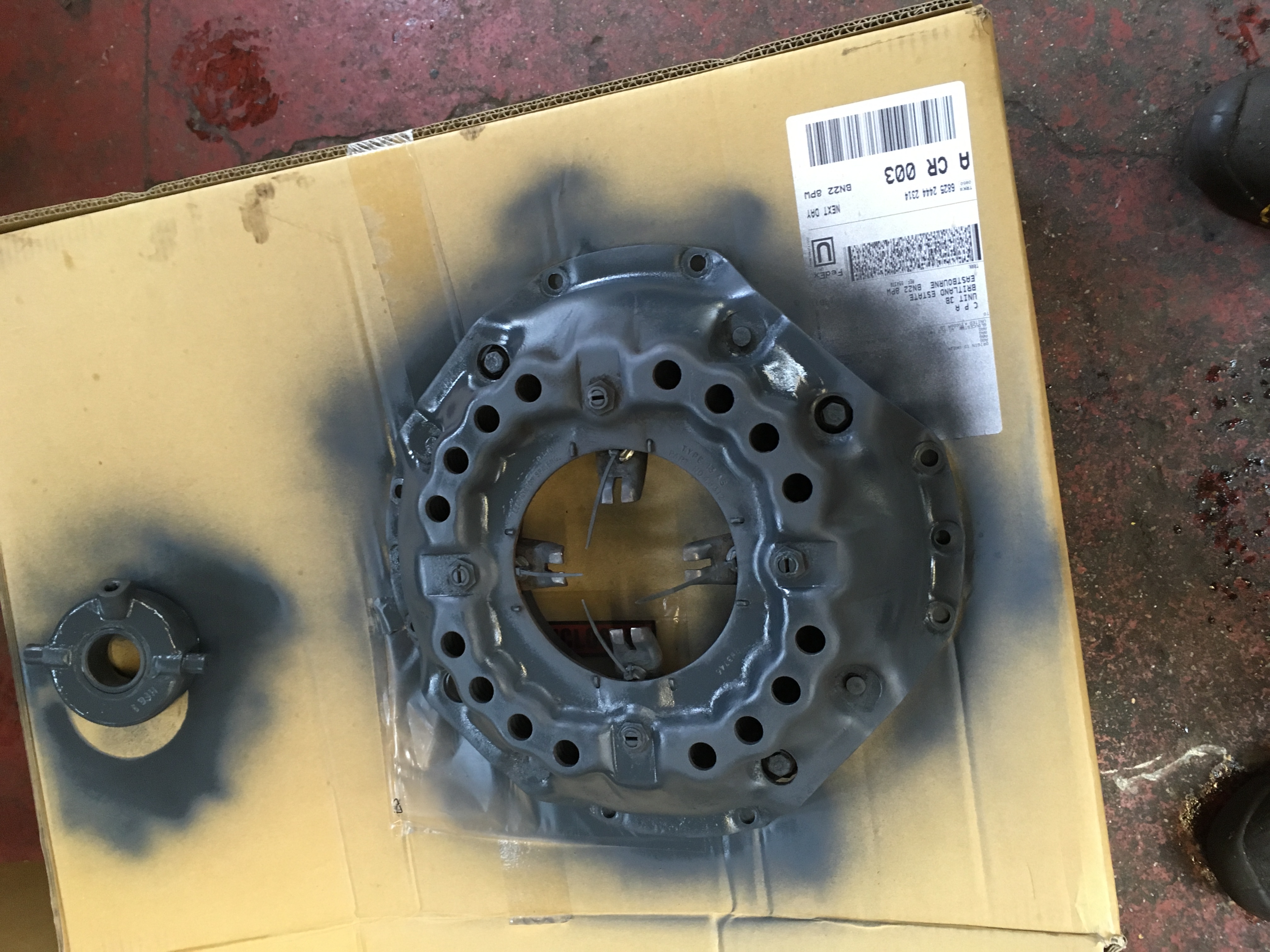

Clutch all cleaned up knew I might need a centre plate and found plenty for the tractor it's based on but mines got the heavy duty 13 inch sinster paddle clutch 150 + vat common 11 inch plate is only £50

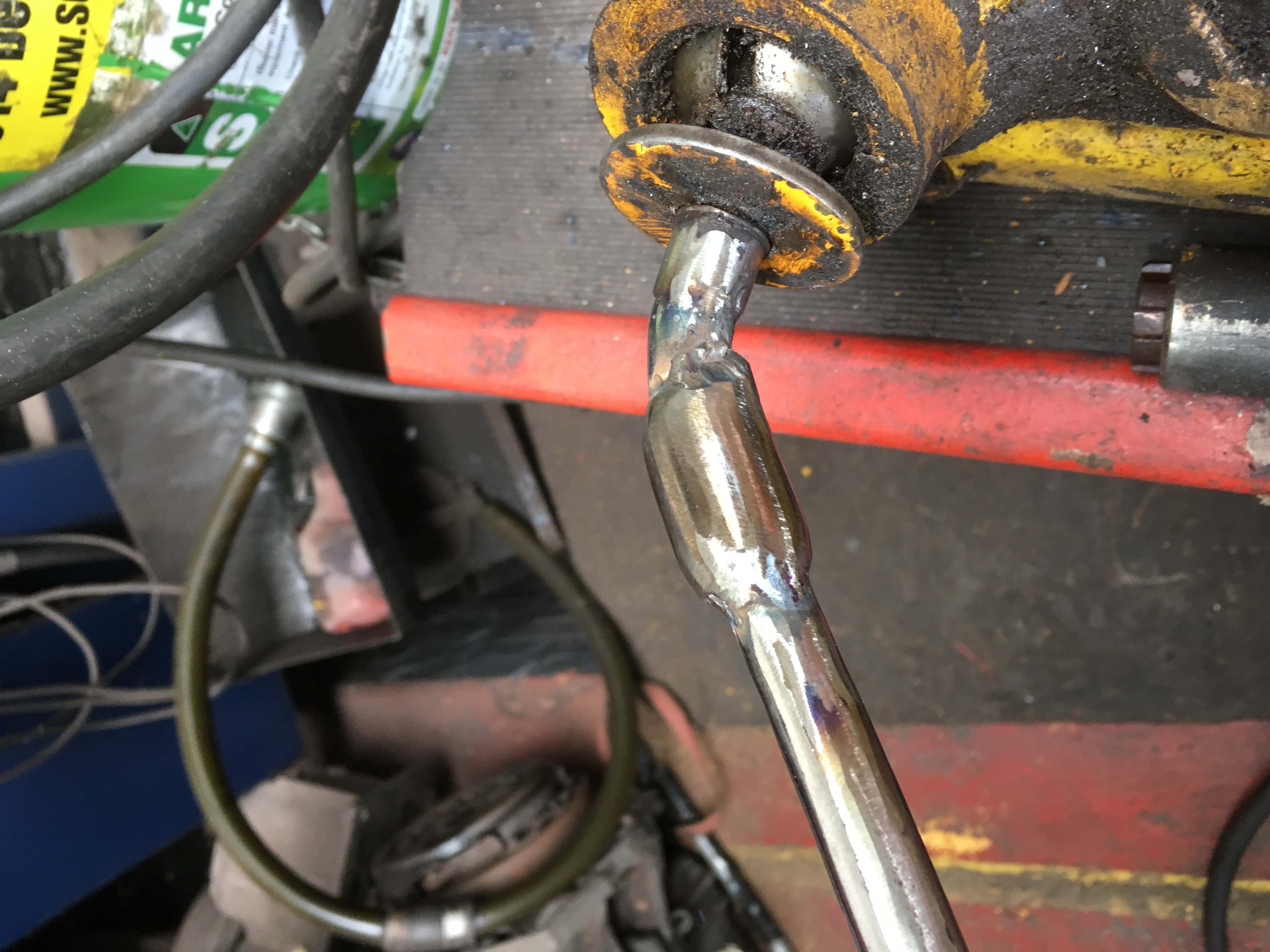

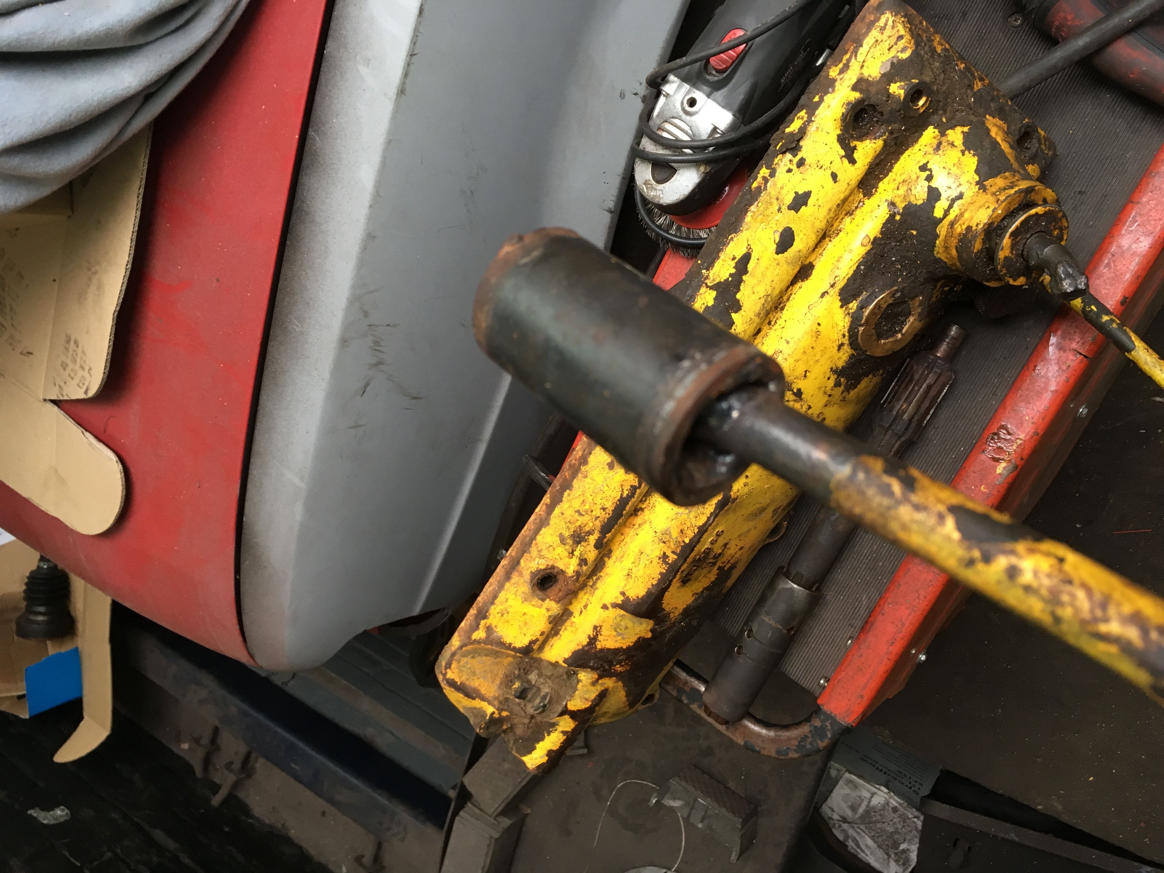

Next job weld gear lever last person to have a go told me it's strange metal and it wouldn't weld !!!
I hope I can do a better job

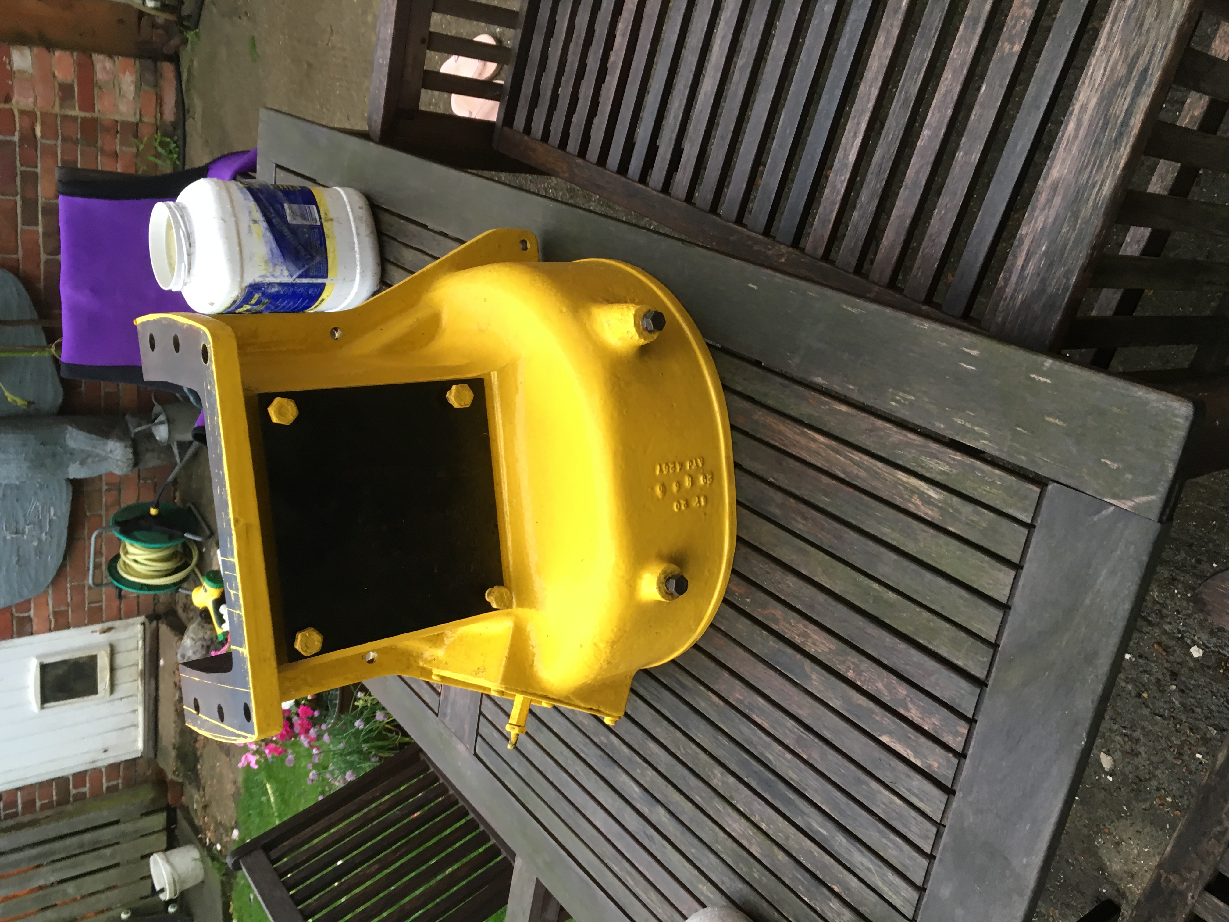

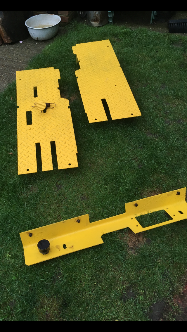

Floors and bell housing painted and ready to fit when I find a clutch note grease pipe for release bearing don't think it will ever wear out clutch is Borg & beck but jcb grind of the name so they can sell them for twice the price . I keep looking for something with the same clutch pressure plate is easy to get but most centres aren't solid and have damper springs and standard friction material which will fit fine and be less grabby but not sure if it will last

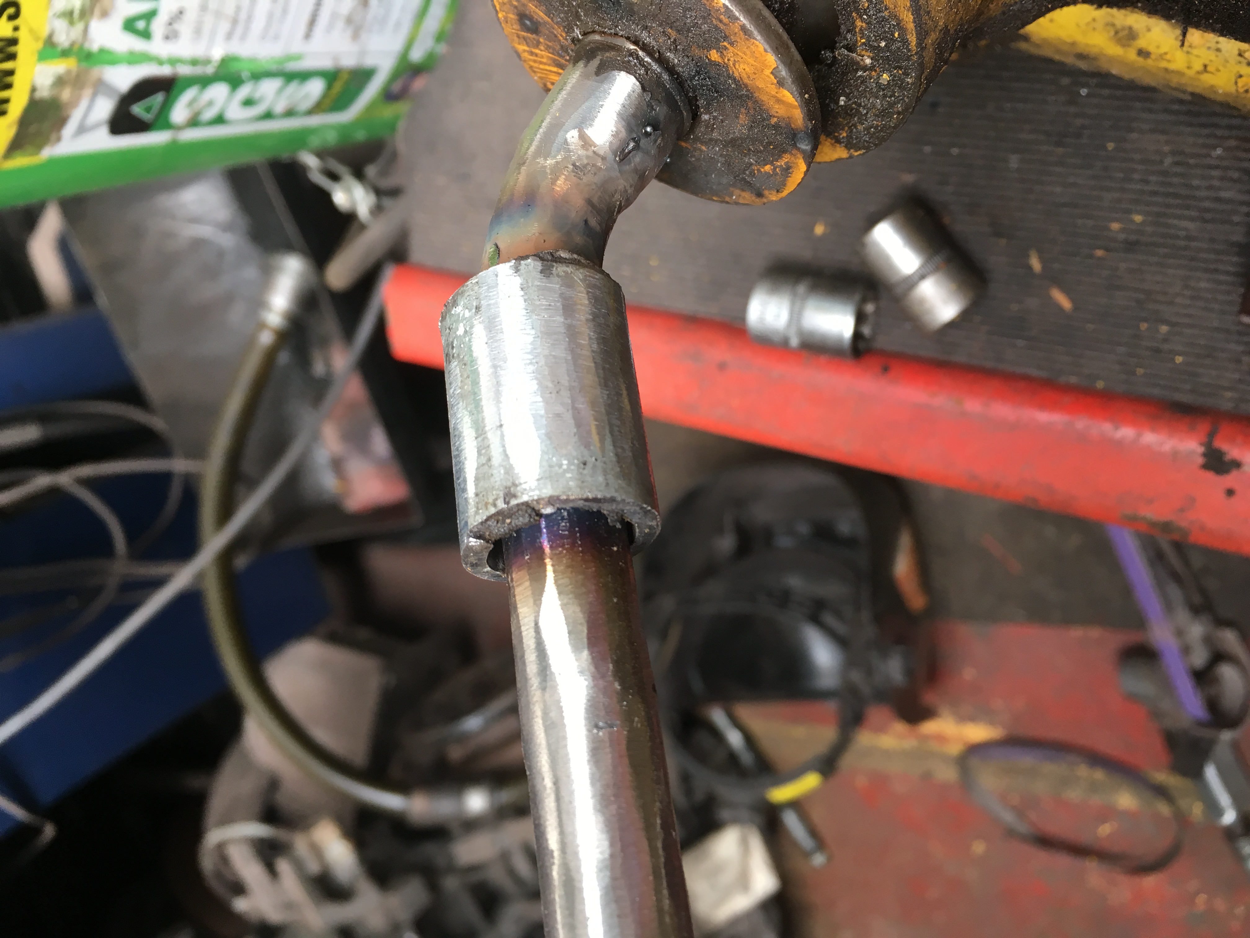

Gear lever butt welded sleved and welded so hopefully it won't snap again

Been down to jcb today gearbox top all back on and all gears present. Fitted old clutch and had a test drive all gears and drive good so will order new centre plate and brakes

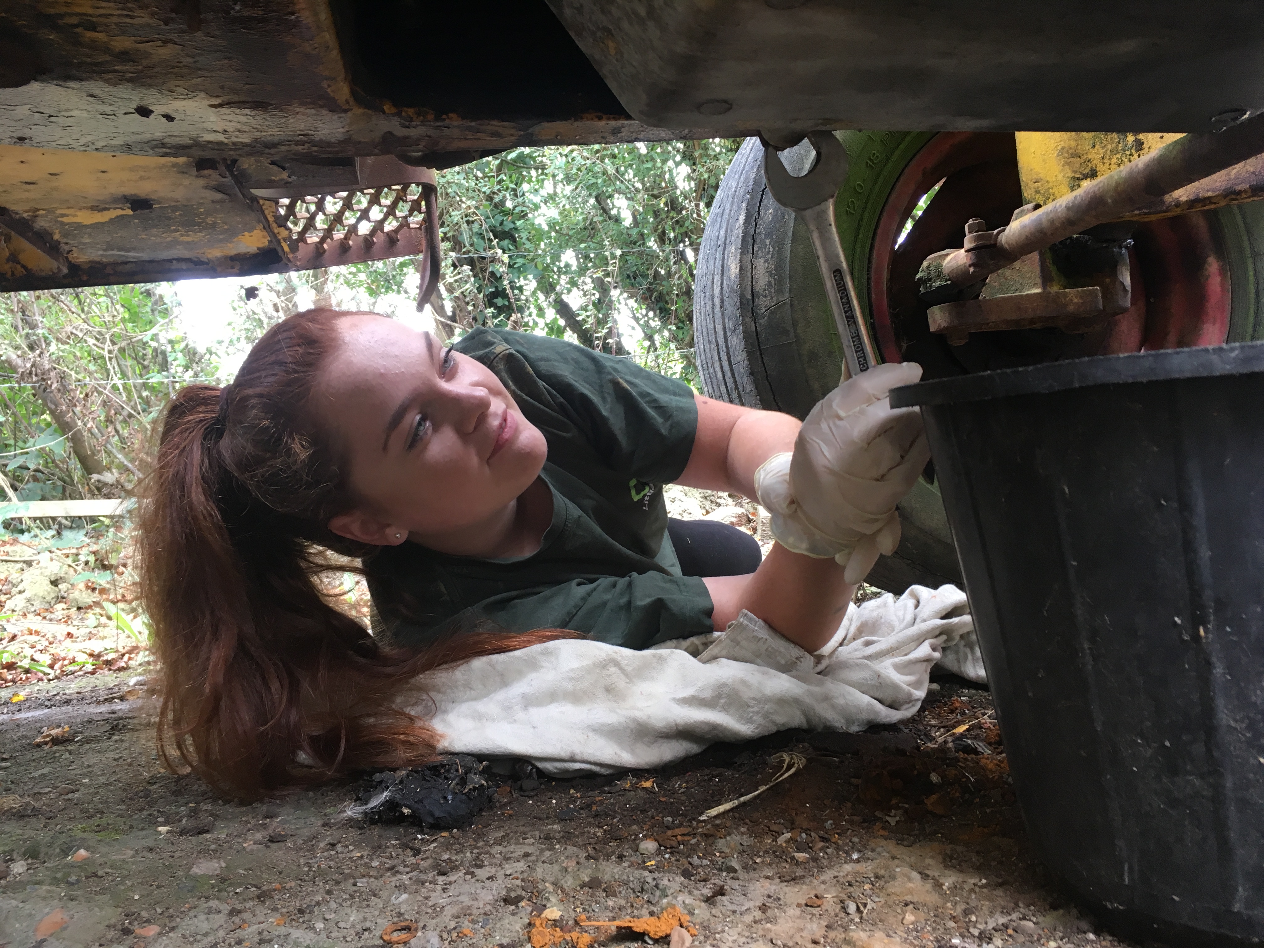

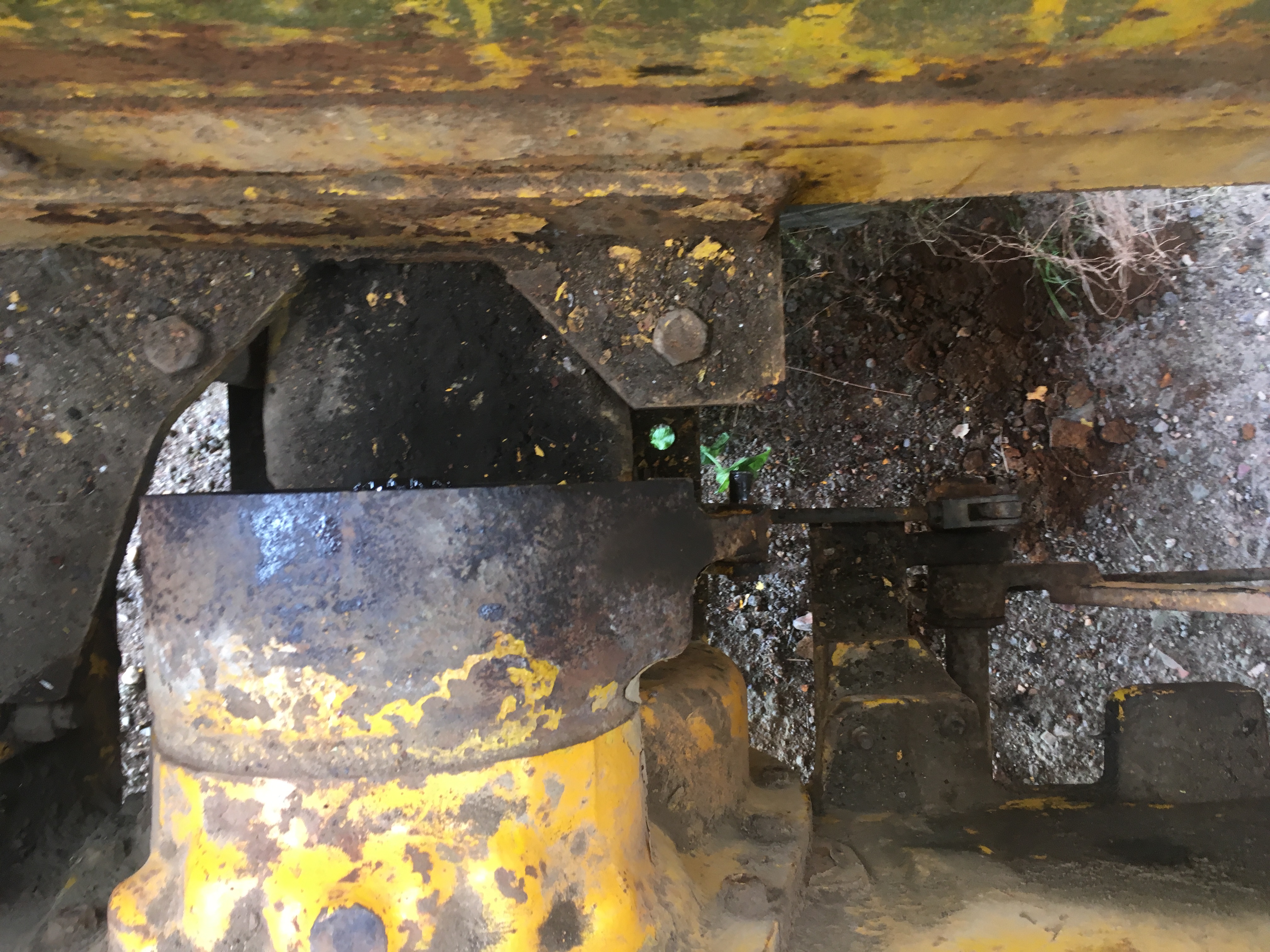

Sunday's work remove brakes all look a mess but are brand new just surface rust from standing and linkages and clevis pins all siezed good job I didn't keep driving it to clean brakes as rust would have ripped linings to bits
Brakes all cleaned up and ready to go back in

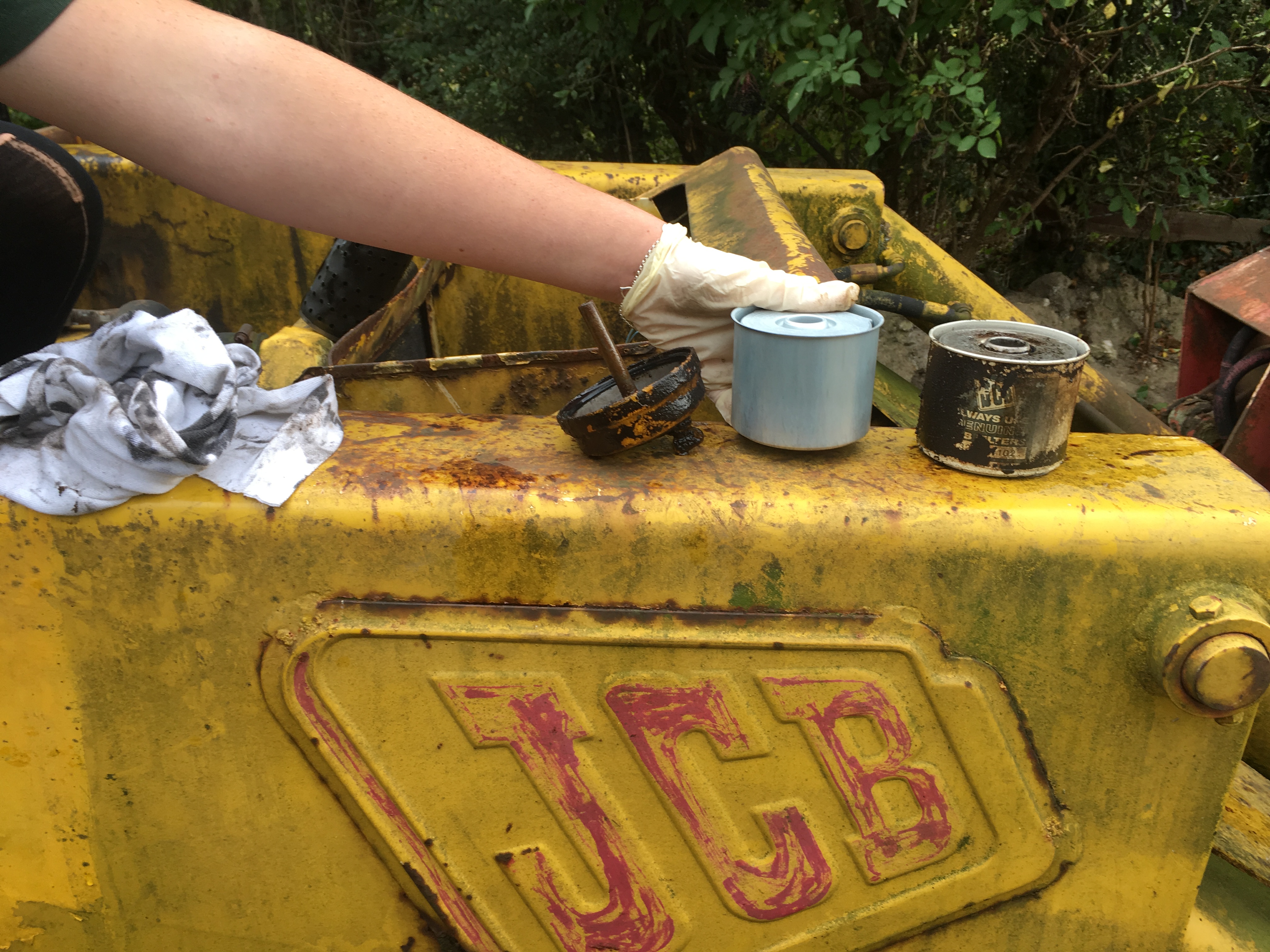

Log book arrived yesterday was expecting it to be a hassle as its been off the road at the previous owners place for 30 years but it can through in 3 weeks I did send off photos of digger with number plate and chassis plate so that must have helped . Also serviced engined last weekend with my 13 year old daughter as she need a project over the holidays for scouts and week before put all brakes back on so getting there . Only set back is air in diesel after filter change as filter housing bleed screw thread is worn out so needs tapping out .
